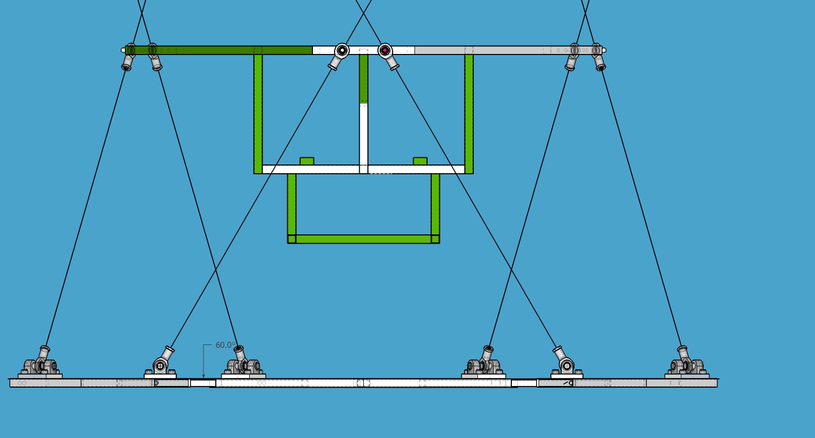

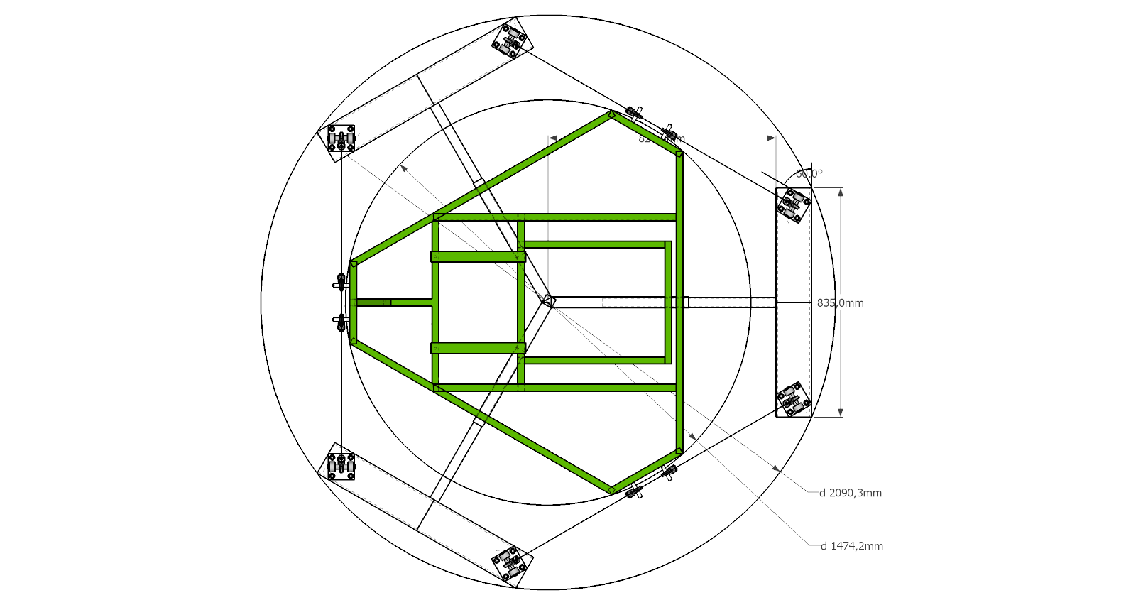

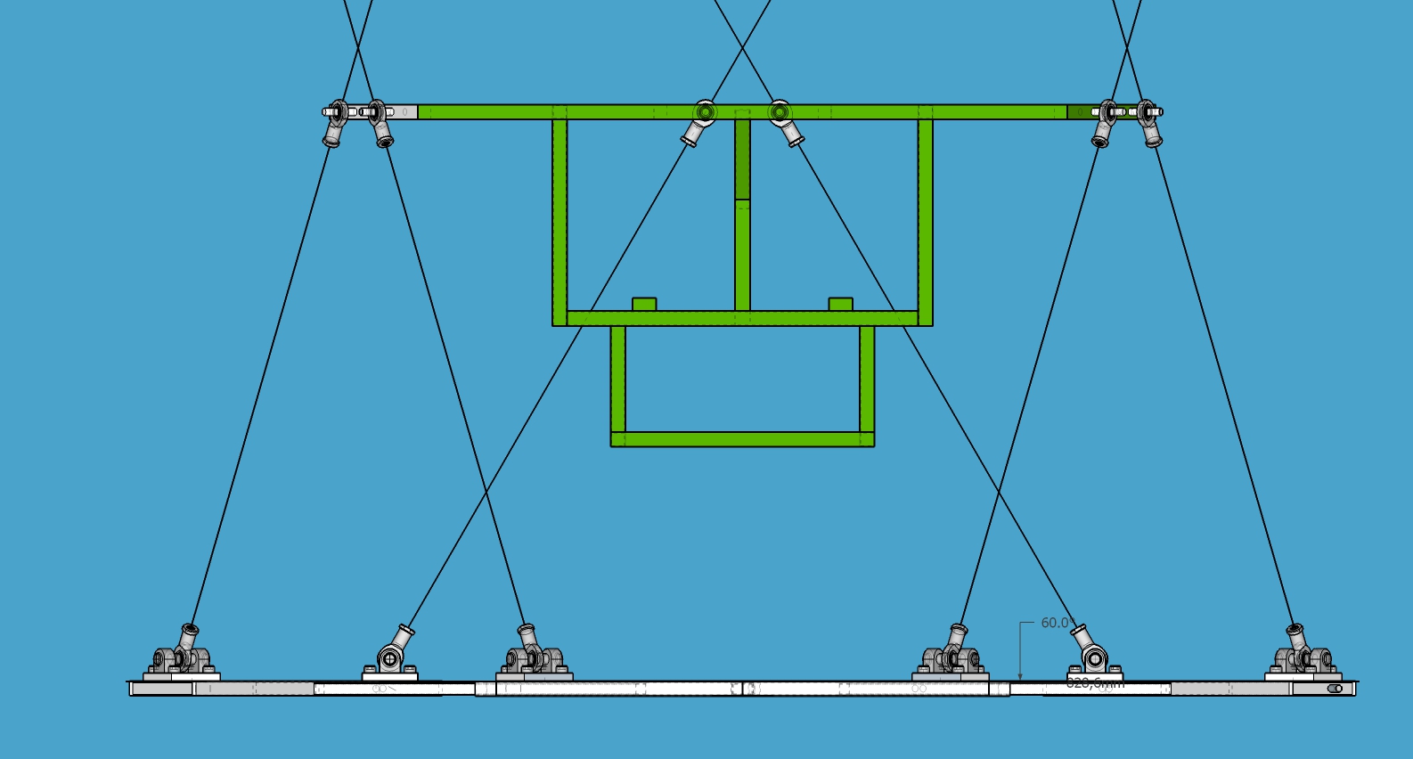

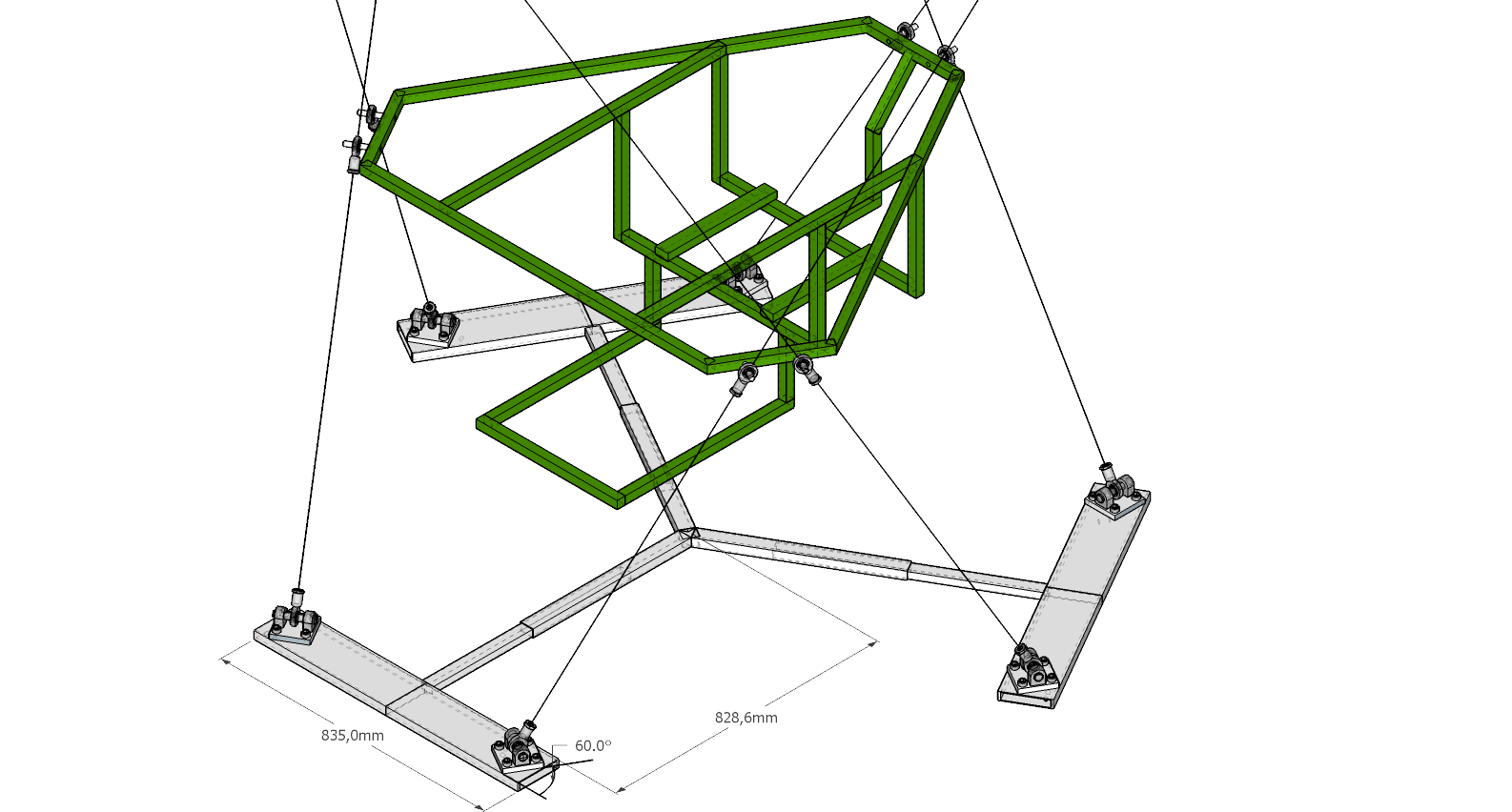

    So I think I did it. The drawing is ready.
    The rod ends are now just parallel to the frame so that enough play between screws (axis) and rod ends.
    I hope I am right. It would be nice to get your opinion.

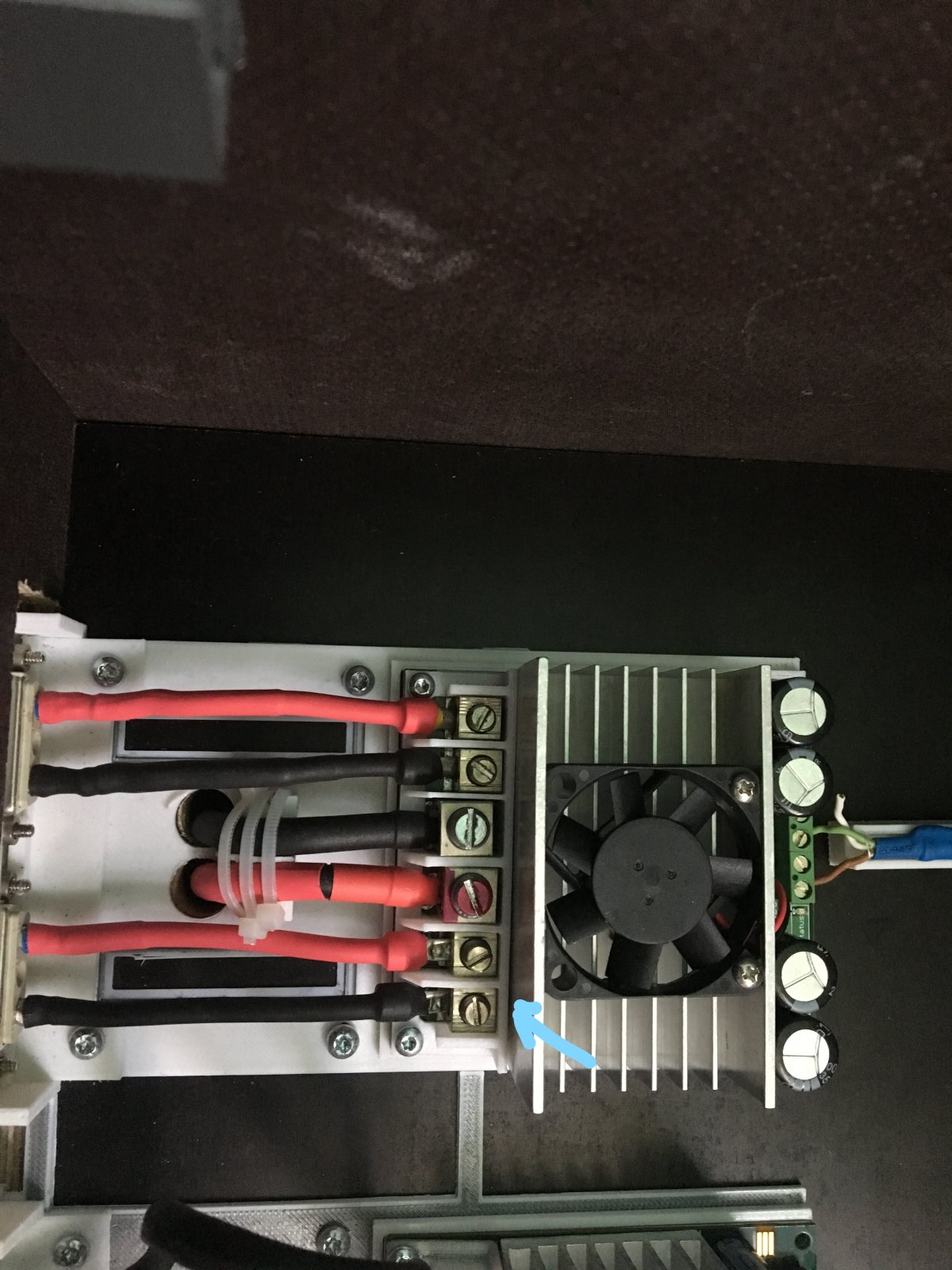

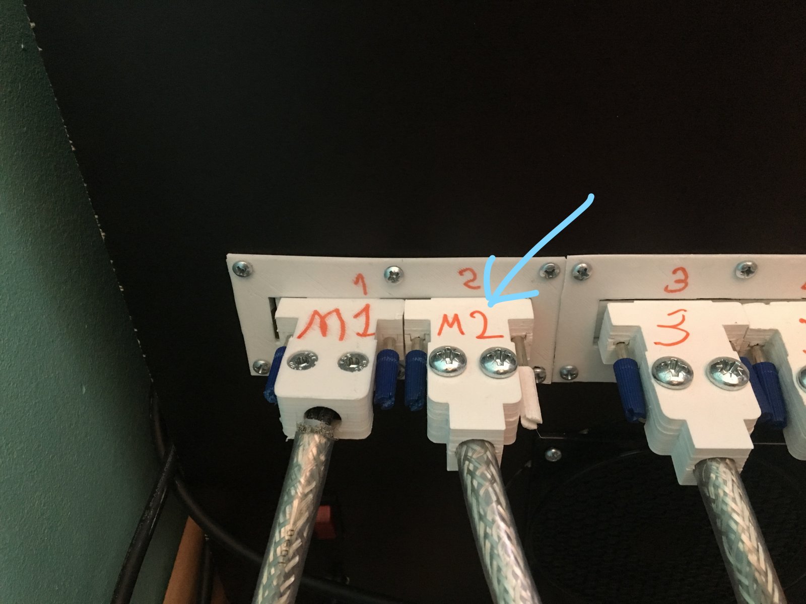

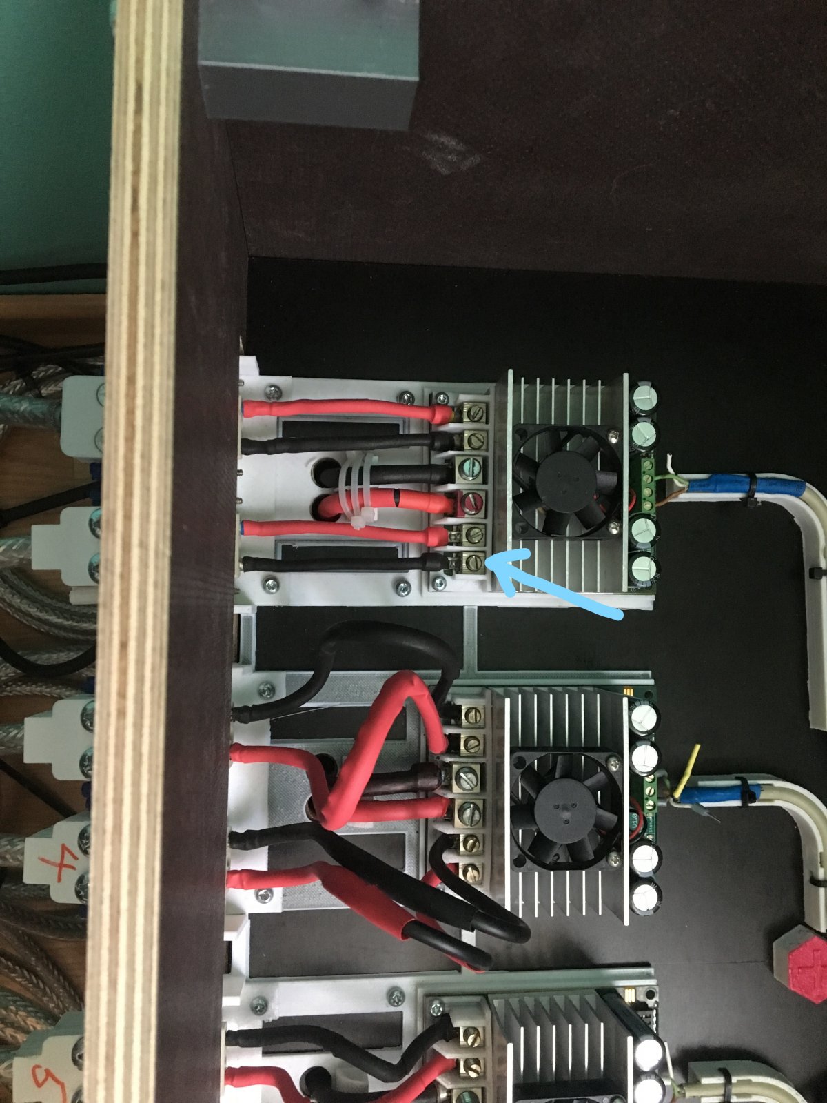

    Hello everyone! I need help from you! My Sabertooth 2X60 does not work on port 2.
    I have already tested the engines are ok.
    Can someone give me a tip as I think I think he is really broken?

    Here is another video from Sabertooth 2X60
    Engine 2 is at the back and engine 1 is at the front

    ok , you can switch output( Sabertooth 2X60) Engine 2 and Engine 1 . Like this you will see if the problem is number 2 engine or output power of your Sabertooth .
    and if the engine 2 work good like this , and engine 1 no working ... the problem is Sabertooth

    So, I did. Engine # 2 works one-way.
    Do you know how to reset an EEPROM on Sabertooth?

    Switch a good one sabetooth for the bad one !! you will see if is the control ( Arduino uno ) or no !

    Have now connected another Arduino. No improvement. I think the Sabertooth is really broken.

    hi @Vitalius before you send it back set the dip switches on sabertooth to analogue input and connect a regular 10K pot connected to 0v and S2 input on Sabertooth .
    this quick test should let you know if the sabertooth is a problem, Cant remember the Default Dip switch settings for analogue control but ii have done this test several times in the past due to mistakes i made wiring and thought i'd killed my Sabertooths .. hell i even managed to get the polarity messed up at one time and the Sabertooth survived ( even though thats the worst thing you can do to these Controllers) .. might be worth a shot , :)
