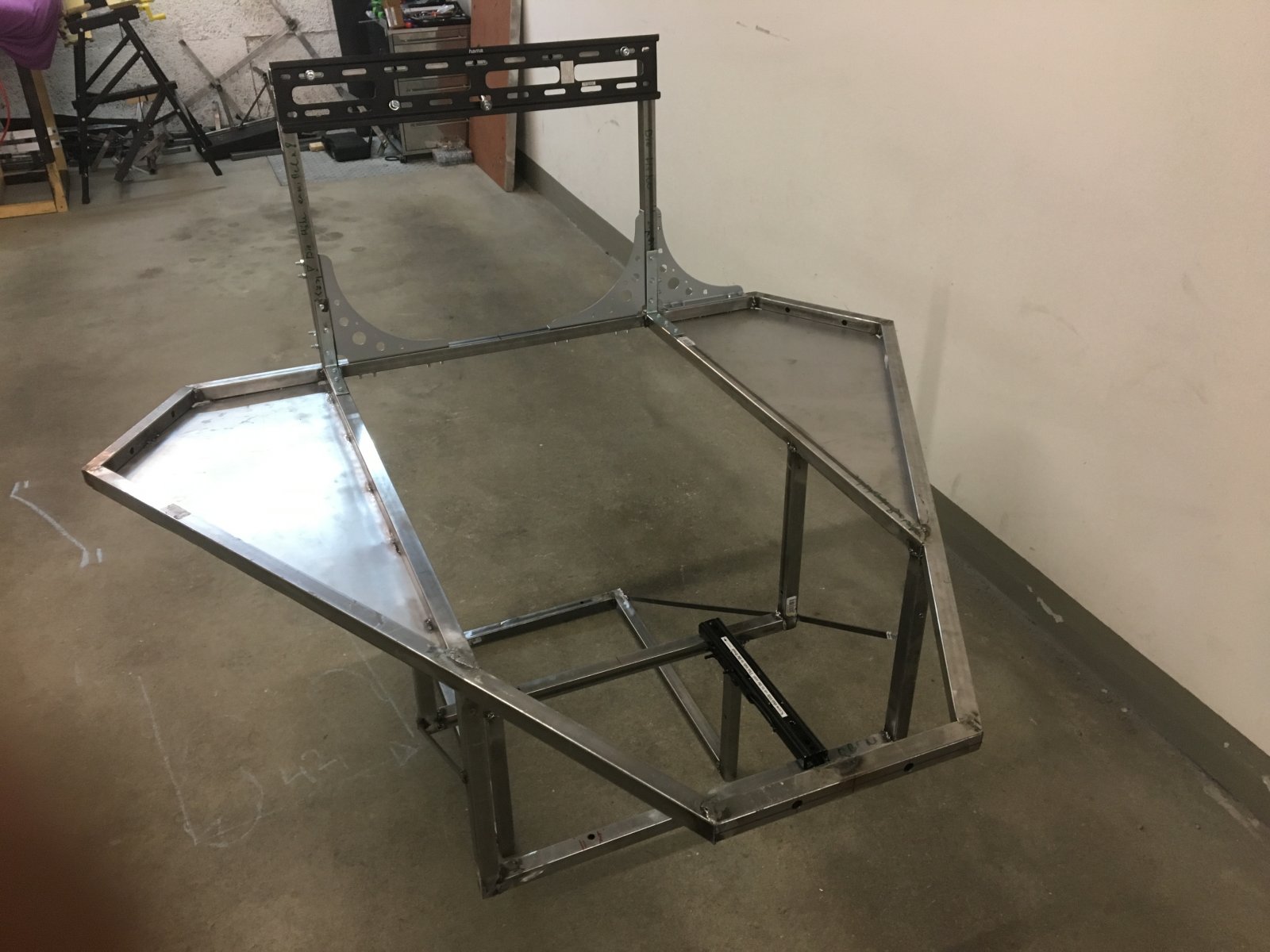

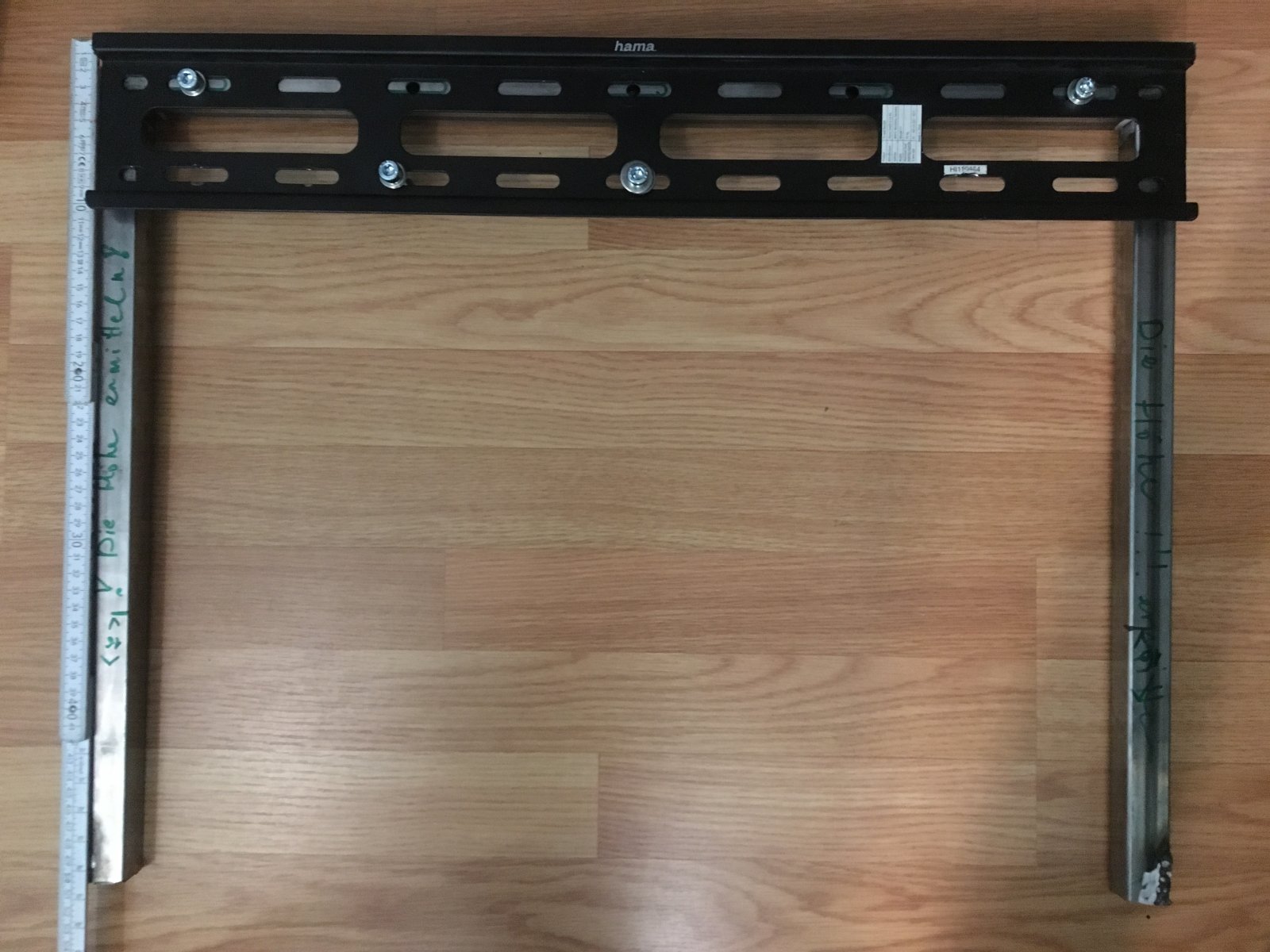

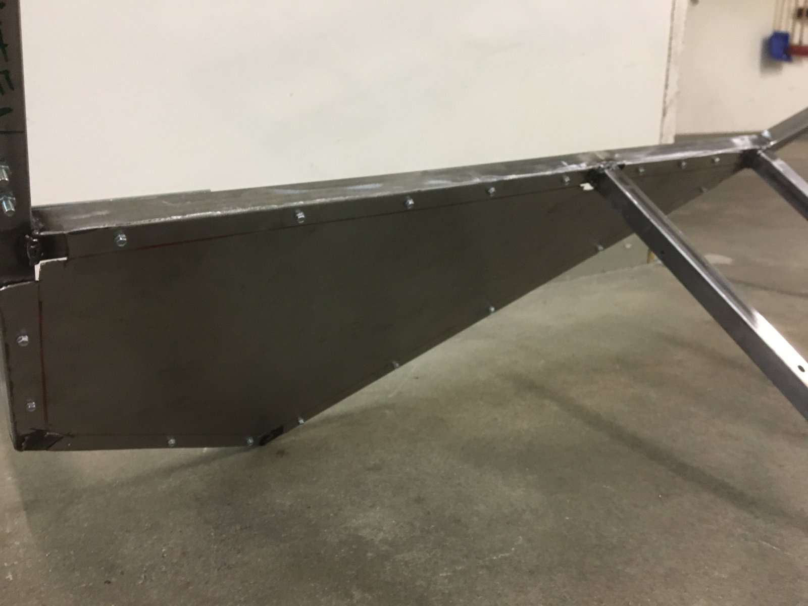

    Unfortunately I had to realize that my 4K-TV mount :) too big for the whole construction is so that I will not fit through the front door. I have to think now how I can fix the TV mount with screws. So tomorrow we go back to the hardware store.

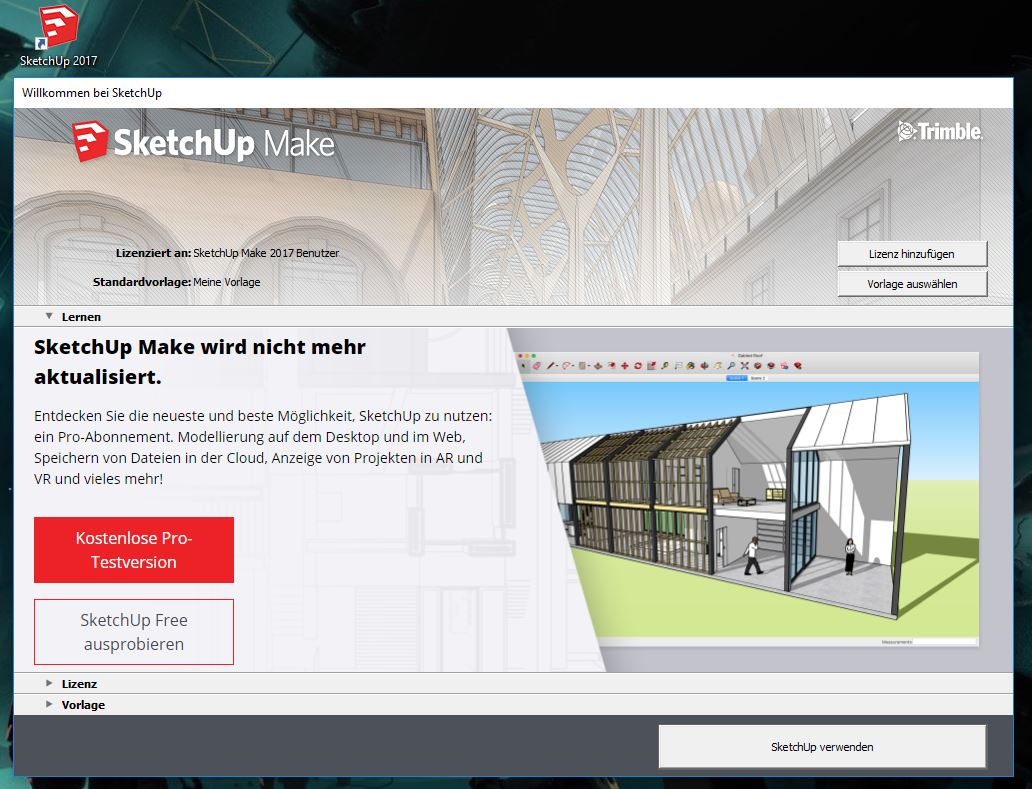

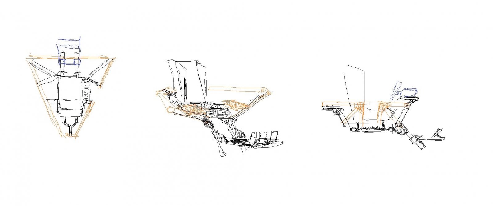

    What is the size of that thing? I can't see the ruler. It's huge!
    I like the way you attached your seat to the platform. I might steal that idea for my carbon fiber platform.
    What 3D app do you use for the sketch?
    Keep on the good work!

    Hello Pierre, I use SketchUP Make. Is free. Very easy to learn. There are many learning videos i youtube. I can really recommend the program.

    Ok, thanks. I know SketchUP even though I have not used it a lot.

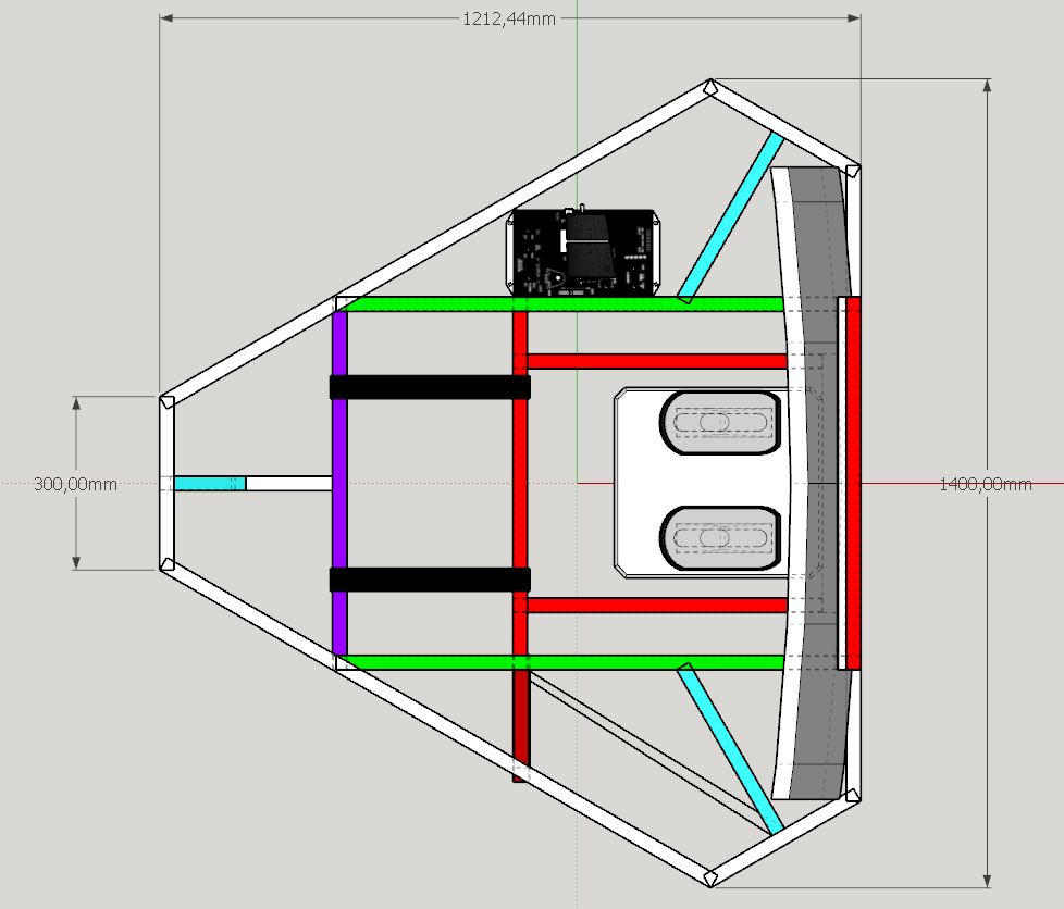

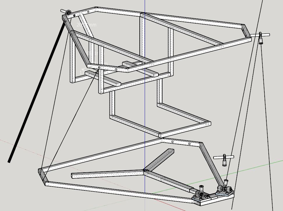

  7. Vitalius
    Vitalius Active Member Gold Contributor
    Jul 2, 2018
    153
    Bonn
    550Coins
    +74 / 1 / -0
    Motion platform, 6DOF

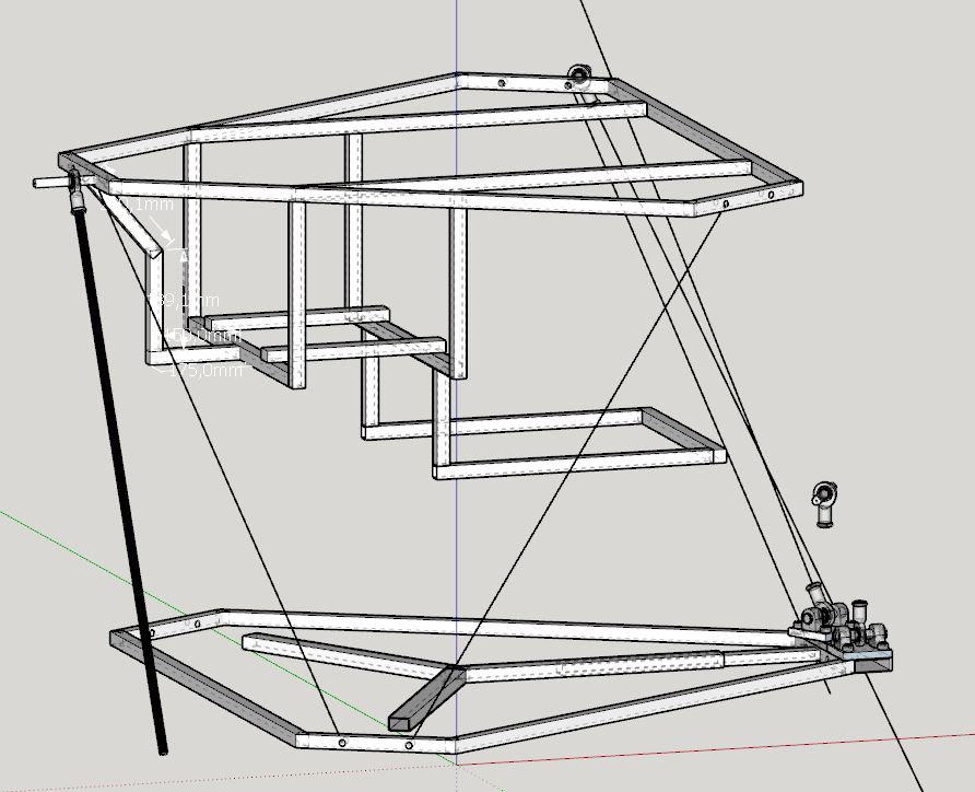

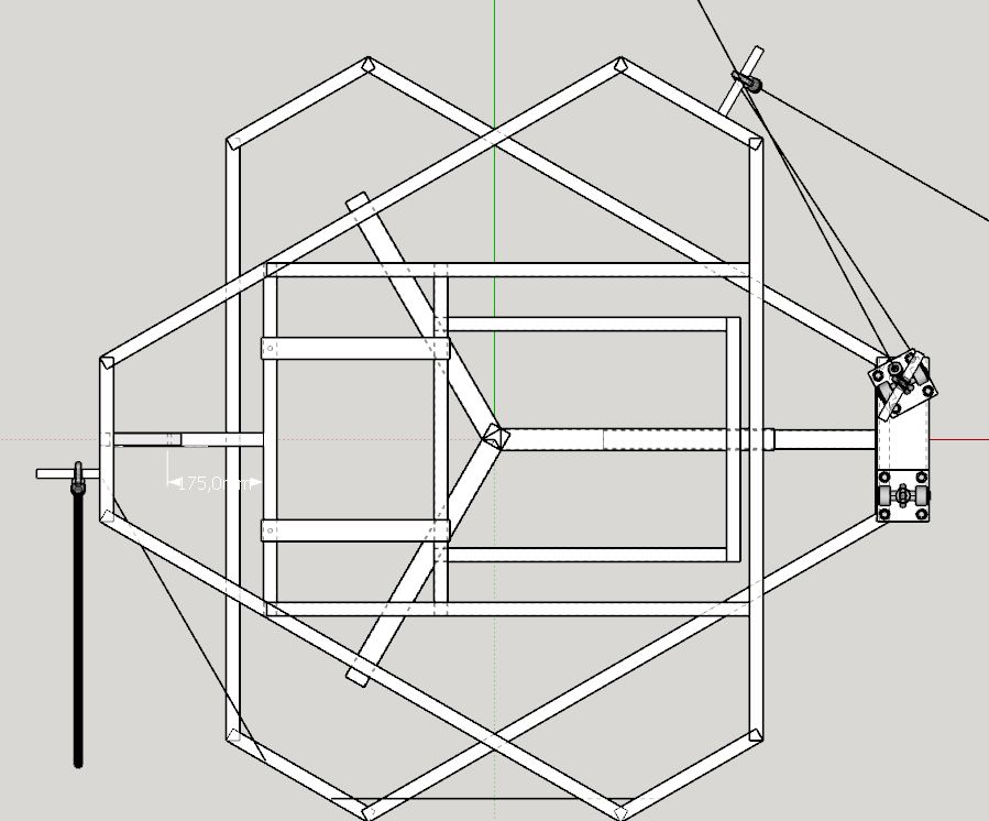

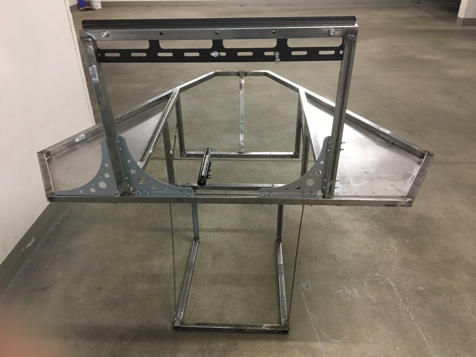

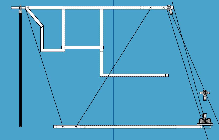

    Hello, here are the dimensions of my platform

    Well, my platform triangle is almost identical to yours. So, either yours is not that big, or mine is huge too.

    Main thing just fits in the room that you can sit next to it. :)
    The mass I have determined more or less read here from the forum.;)

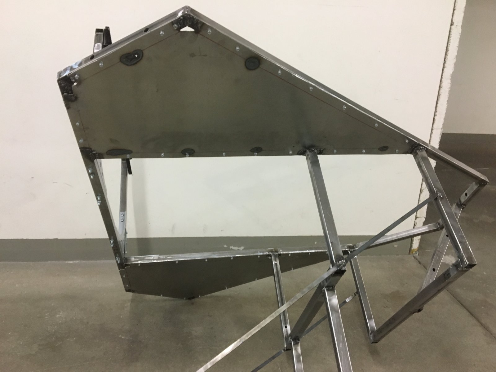

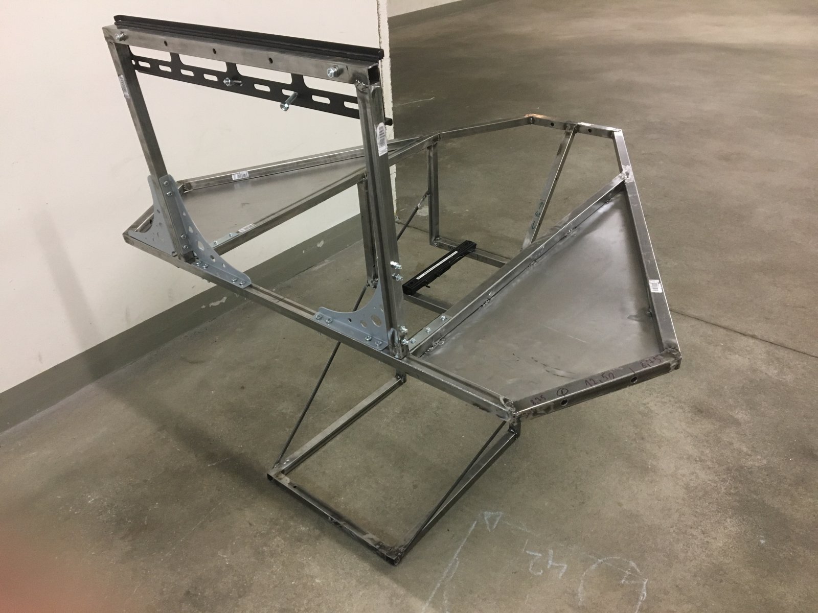

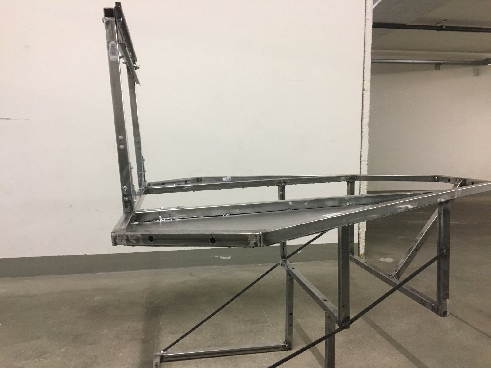

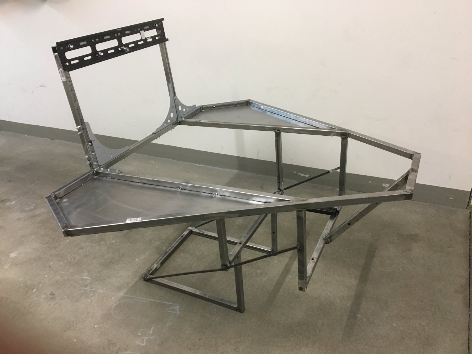

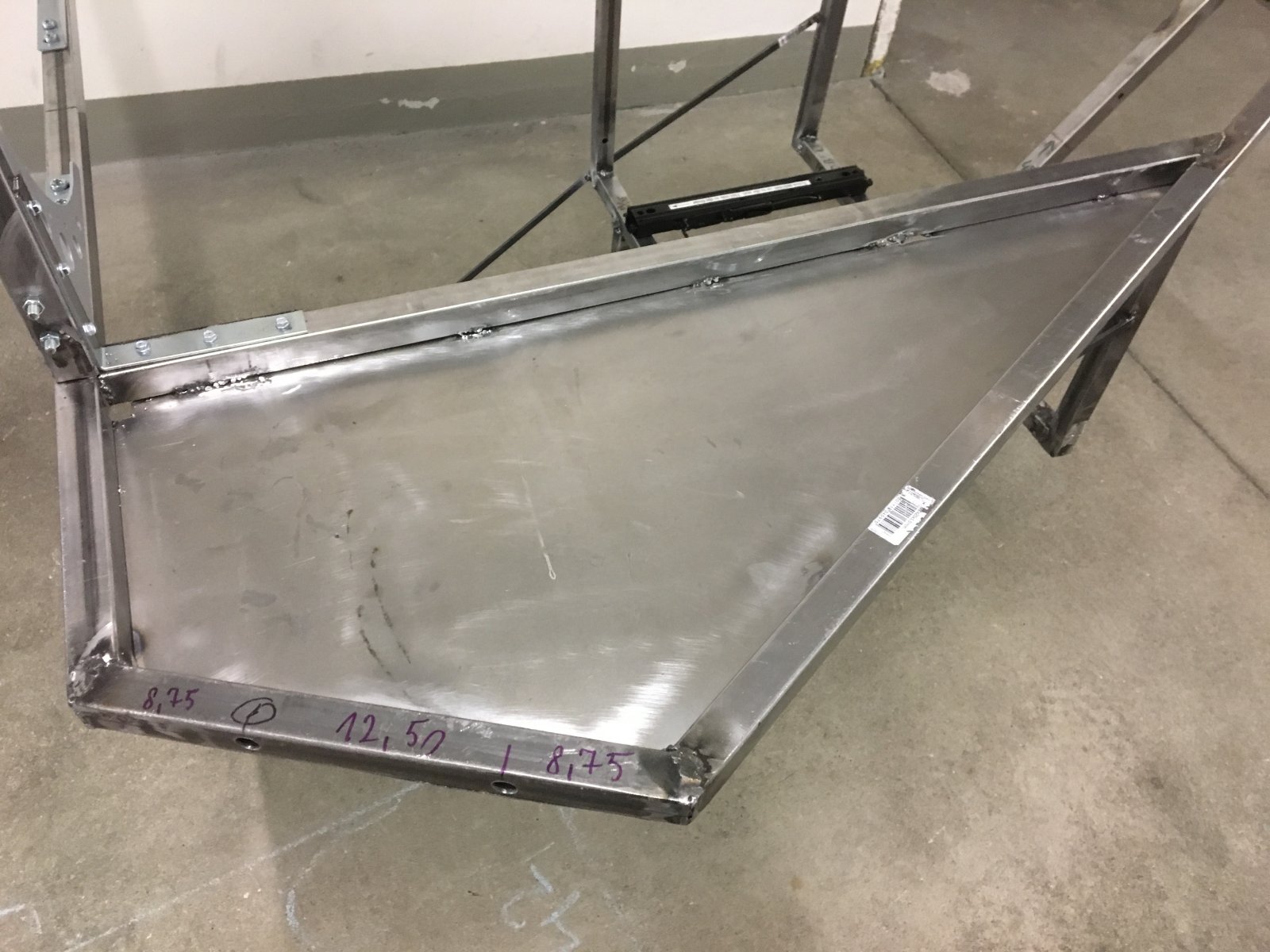

    Unfortunately, yesterday I realized that my monitor mount is wobbly. So everything dismantled and taken to the garage. I planned that.Unfortunately, yesterday I realized that my monitor mount is wobbly. So everything dismantled and taken to the garage. I planned that. The TV mount is now firmly welded!

    +3,570 / 34 / -0

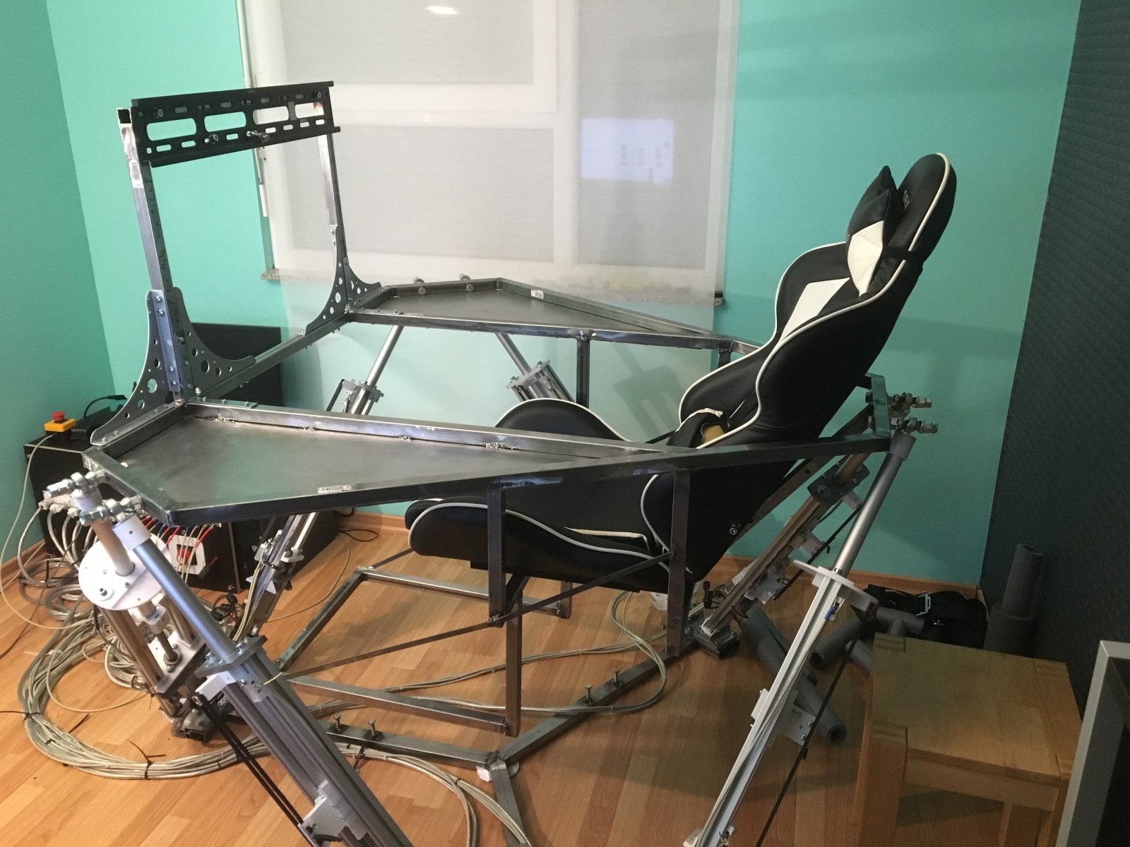

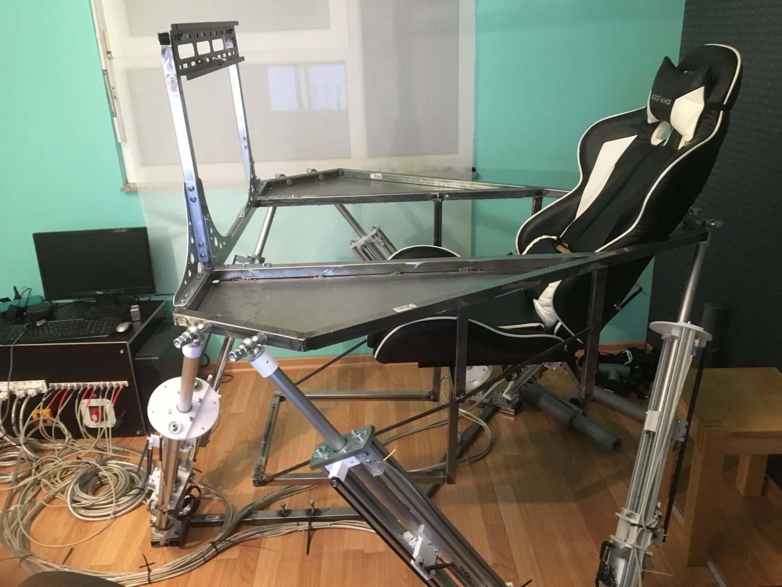

    How heavy is your platform now ? Looks like a lot of metal there
  12. Vitalius
    Jul 2, 2018
    153
    Bonn
    550Coins
    +74 / 1 / -0
    Frame = 18.1Kg
    Playseat Seat Slider = 2,3KG
    Chair = 11Kg (I wish you a carbon like in The Expanse:thumbs)
    TV = 16Kg
    Total = 47.4KG

    hi, what will your carbon fiber platform look like? Have you already made designs?

    I have tried, using SolidEdge. I used something that I'm not used to use (assembly) and I had only one size of tube. This is why they are all the same size in my design.
    I did not show them because the sketches I made to start are bad, the design ain't that good and since I've seen yours, I change a lot of things. I really like the 2 bars on each sides of the seat that are parts of the main triangle in yours.

    My platform weighs 50 kg and kept off (no power) motors so that does not sink.
    Weigh 85 kg and must switch on engines before boarding!
    So now I want to compensate for my weight with gas spring. I thought of 350N per gas spring per side.
    So these are 3x350N total 1050N = 105kg. Am I right or wrong with my considerations?
    Maybe someone has another solution for my problem?
    Or is it enough for a gas spring under the platform to be exactly in the rent?

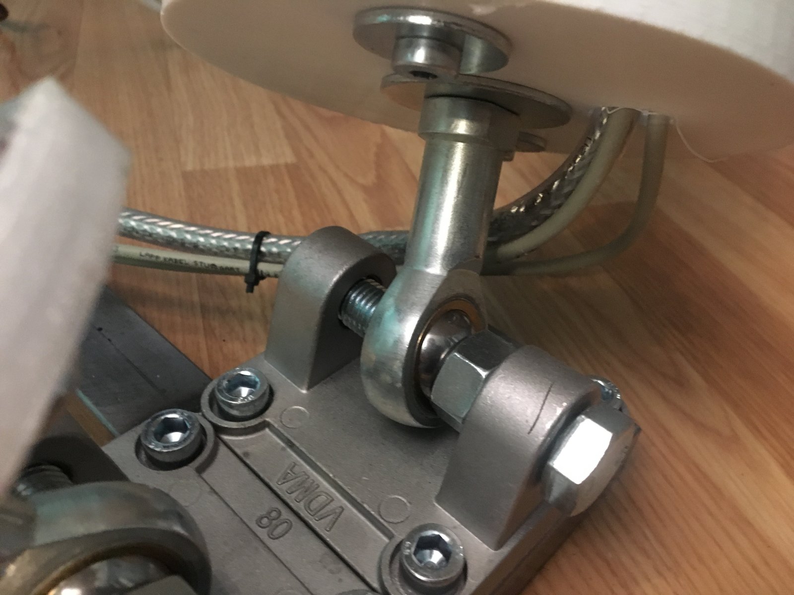

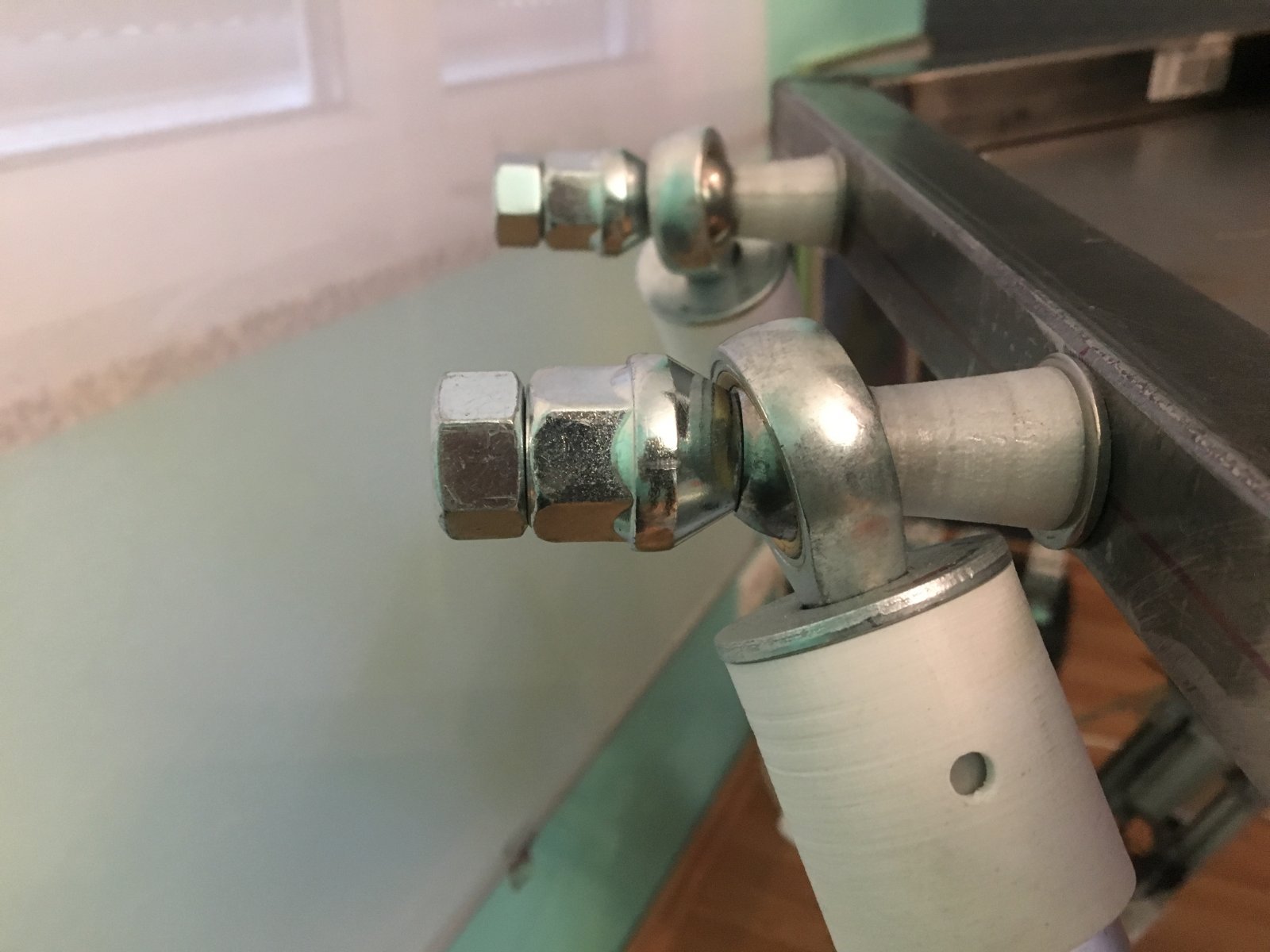

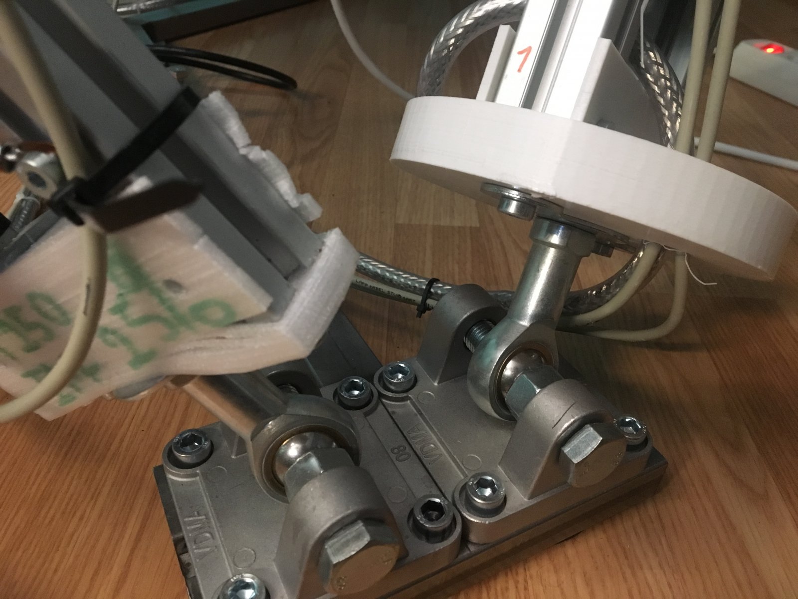

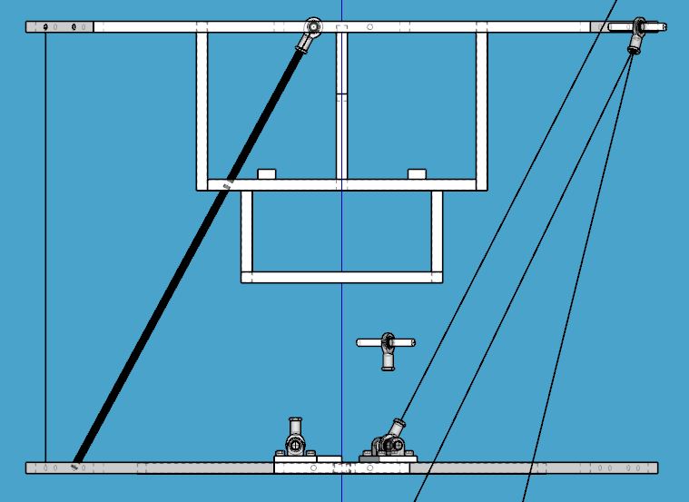

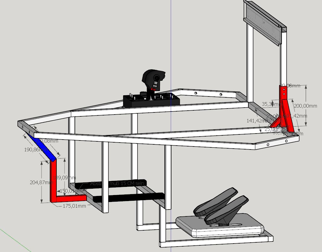

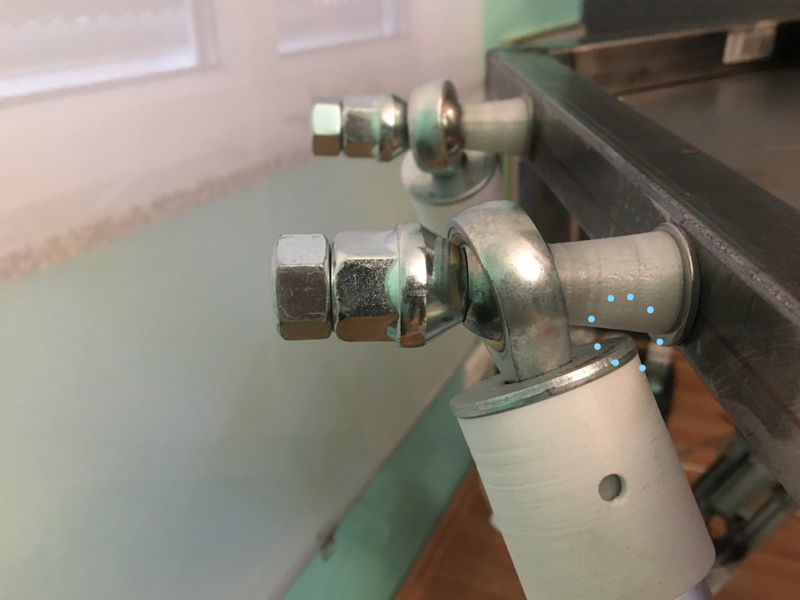

  20. Vitalius
    Jul 2, 2018
    153
    Bonn
    550Coins
    +74 / 1 / -0

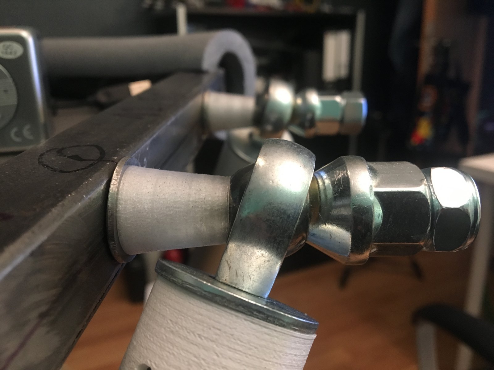

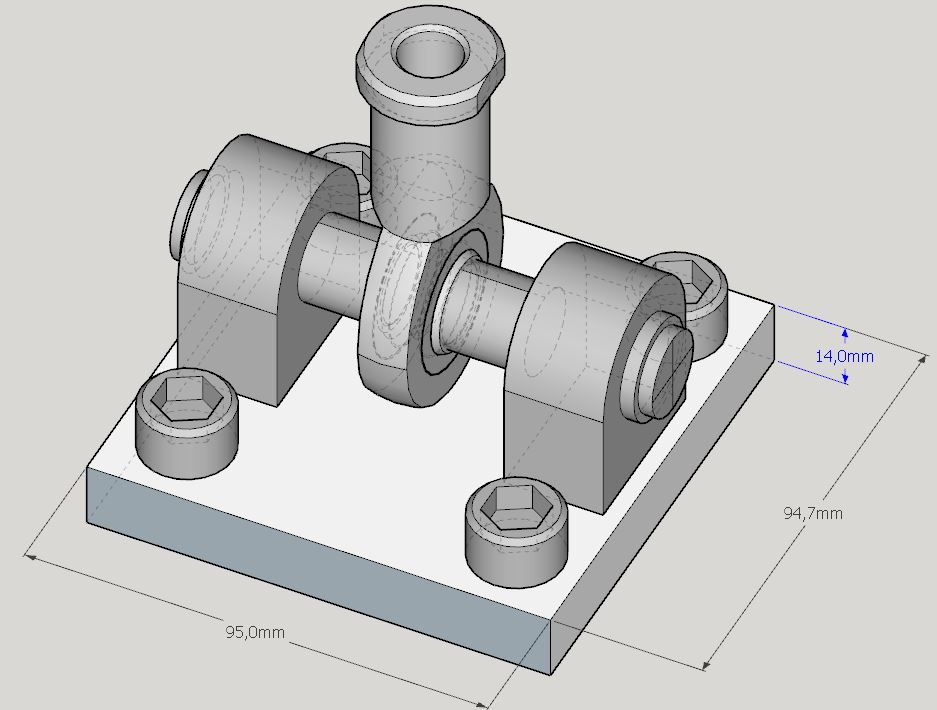

    Hi, I'm trying to solve problem with condyle. In the photos you can see that I have very little distance between the condyle and the axis. I tried to eliminate SketchUp problem in which I turn lower brackets for condyle about 60 degrees. Unfortunately, I am not so good at SketchUp and can not afford it. Does anyone have a tip for me as I get the problem under control?
