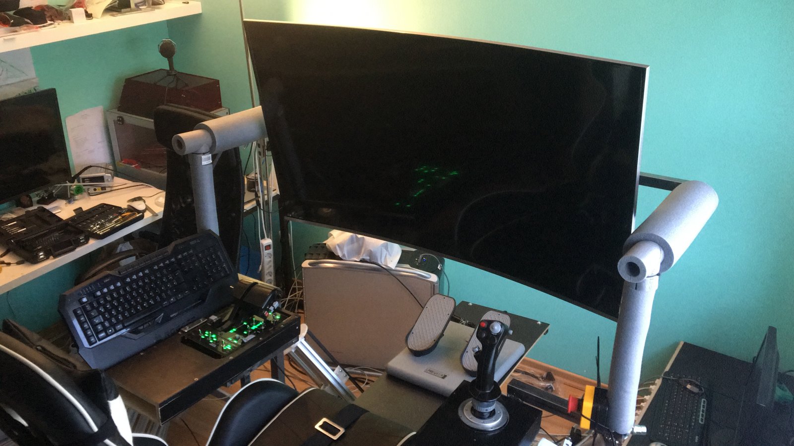

    :) I hope I get the joystick mount ready. Throttle is tightly screwed. Then I can finally fly loss. ED is already waiting

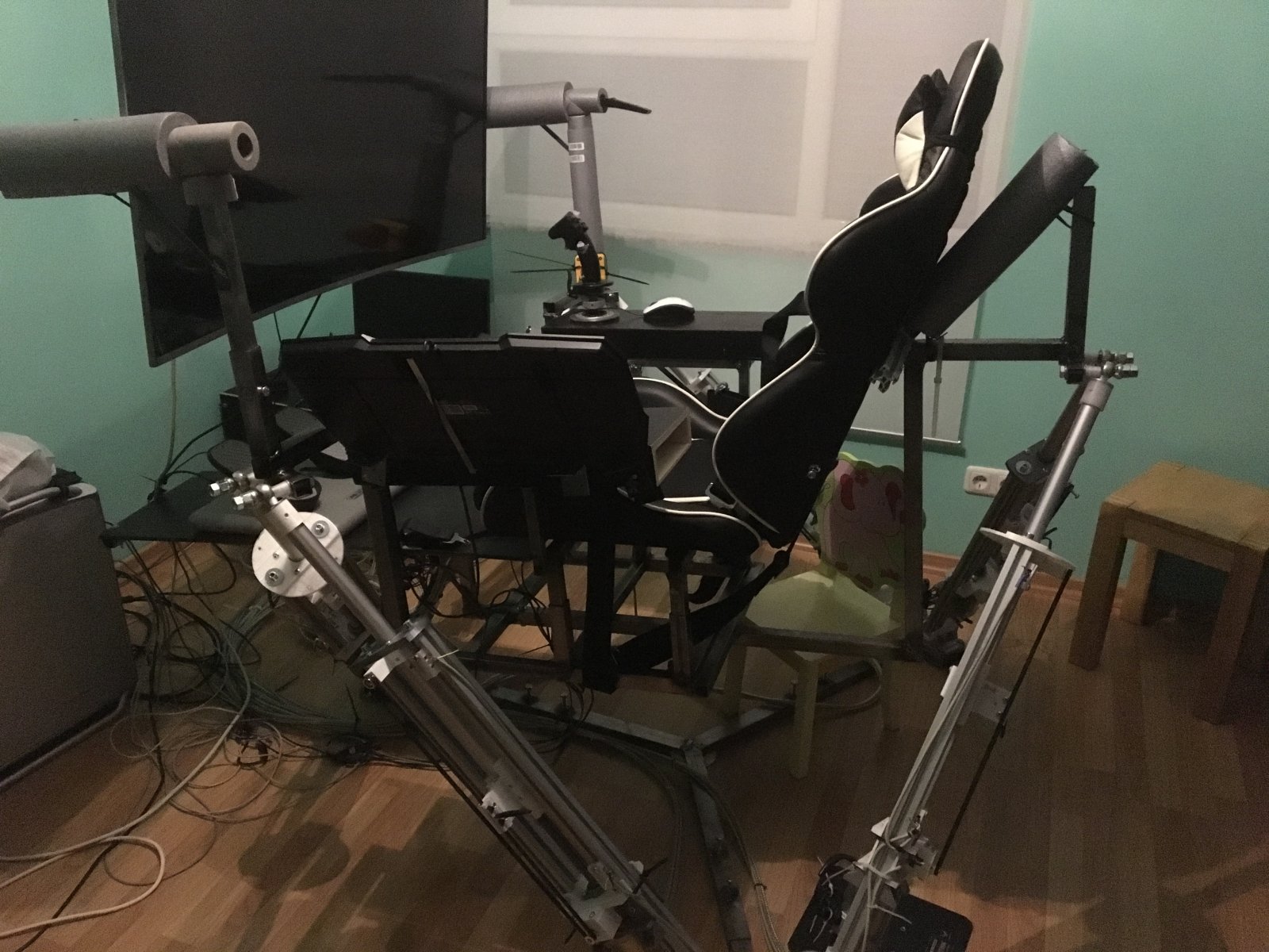

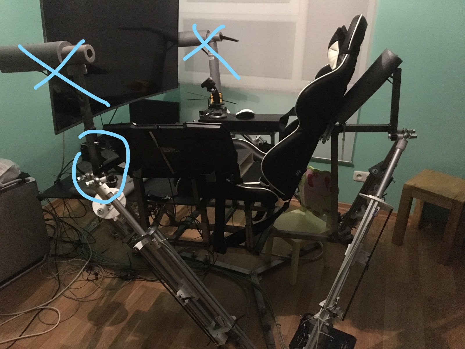

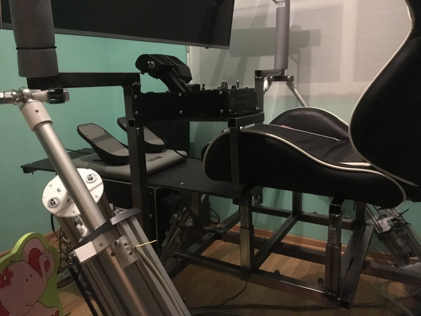

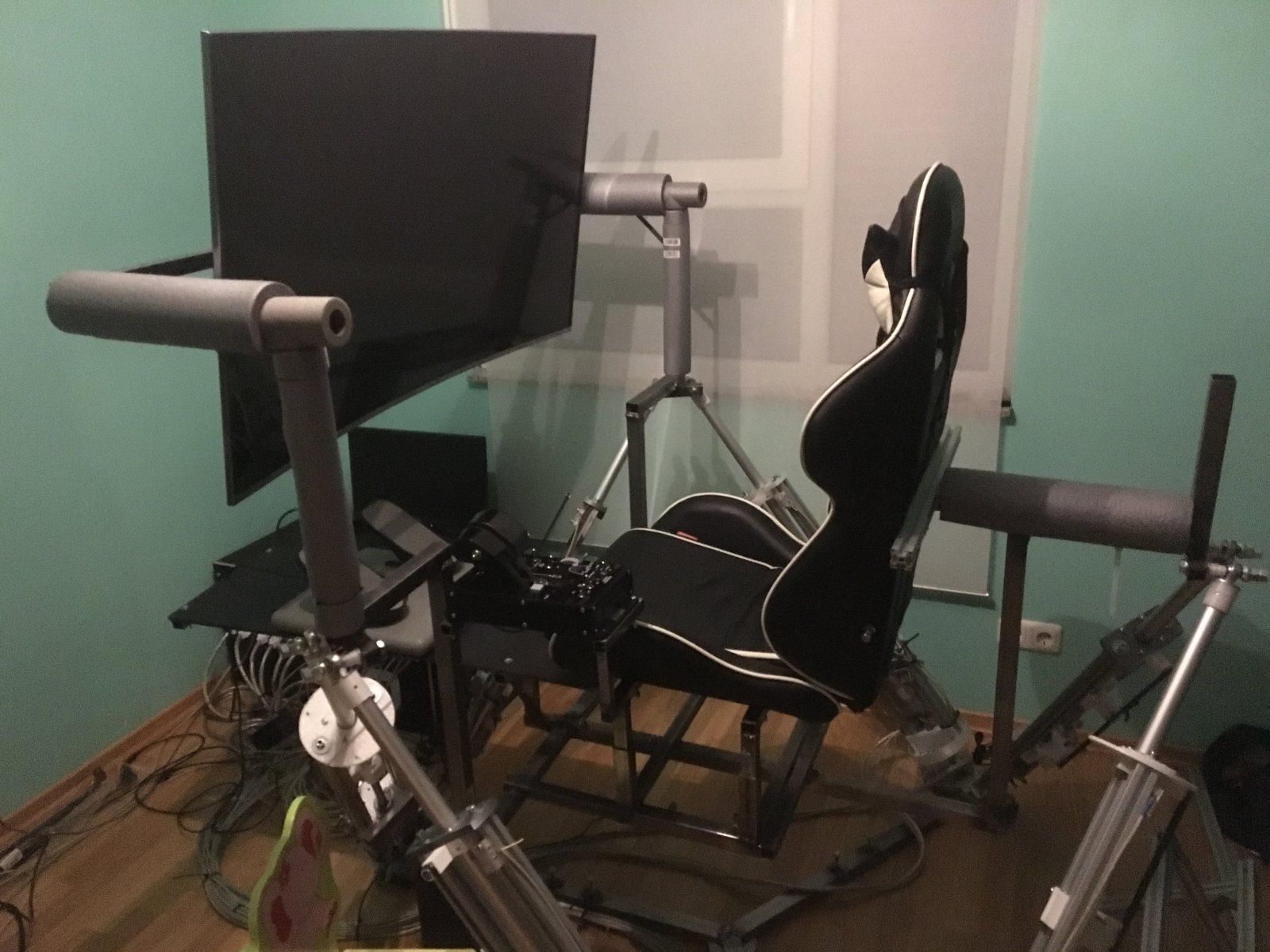

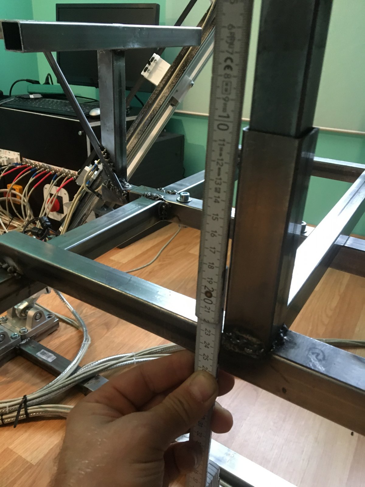

  15. Vitalius
    Vitalius Active Member Gold Contributor
    Jul 2, 2018
    153
    Bonn
    540Coins
    +74 / 1 / -0
    Motion platform, 6DOF

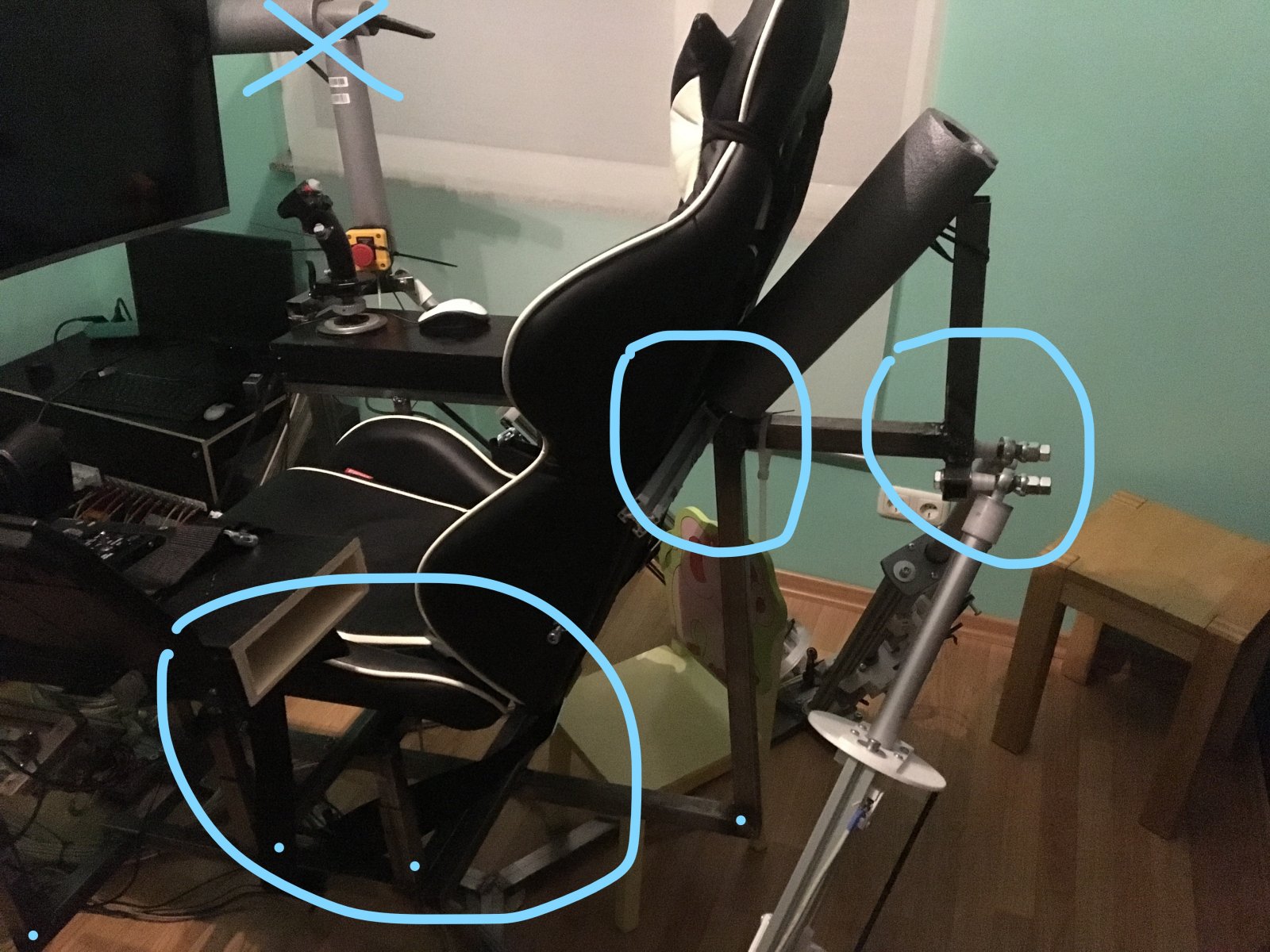

    Unfortunately, I have to disappoint you. Sorry

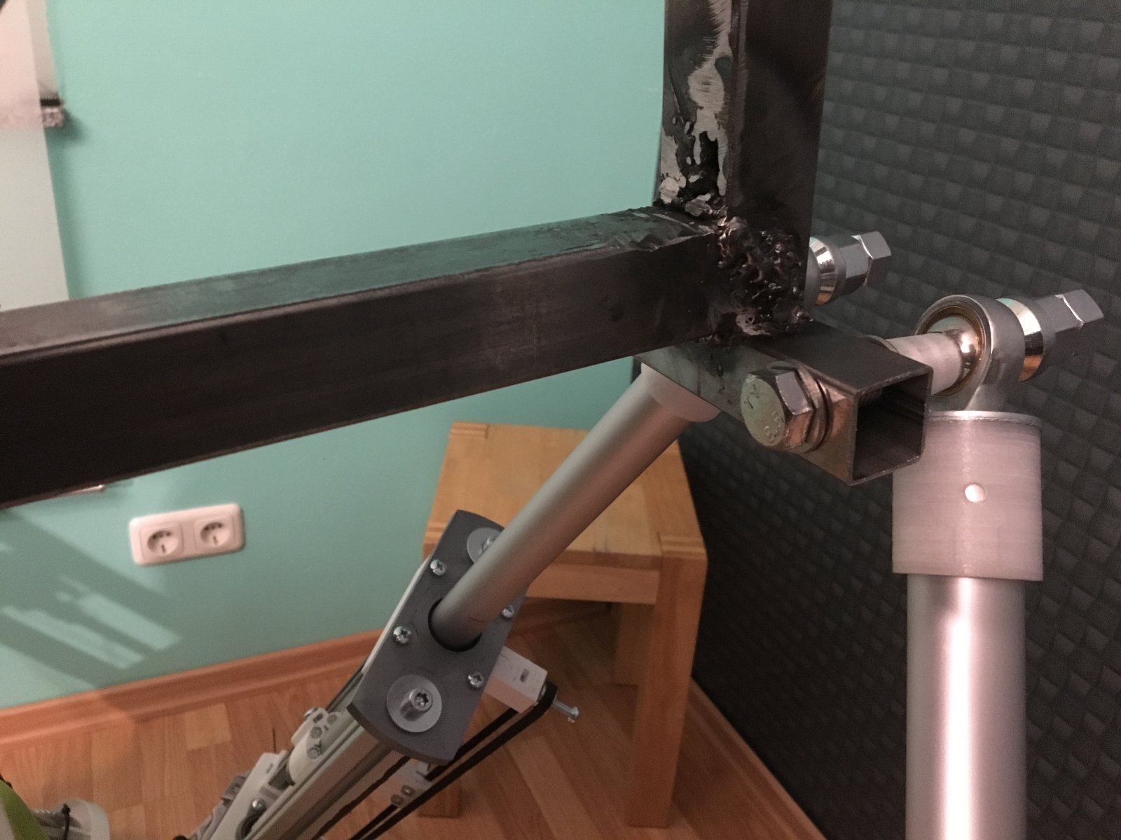

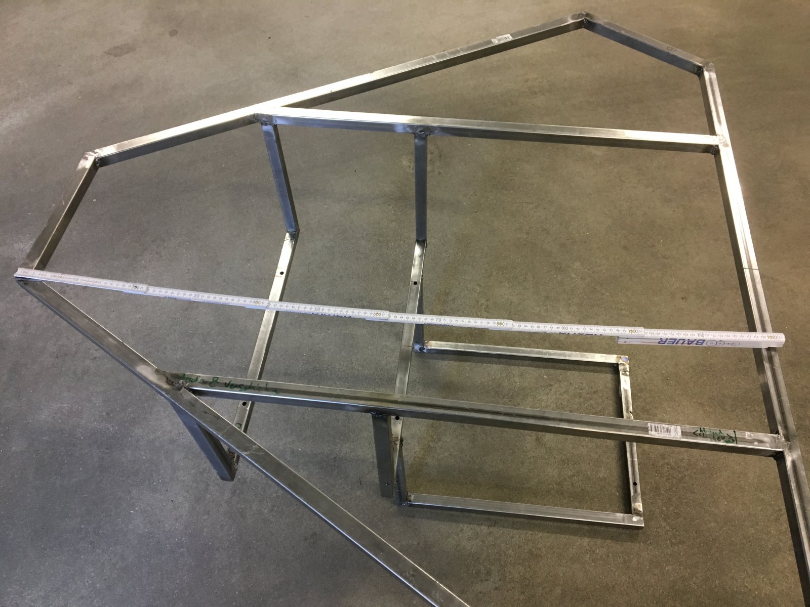

    In yesterday's test, I had to conclude that the kanze platform is unstable. Wakelt like jellyfish :(. So I start to dismantle again and will amplify that whole and a little differently designed.
    So go back to the garage. :)

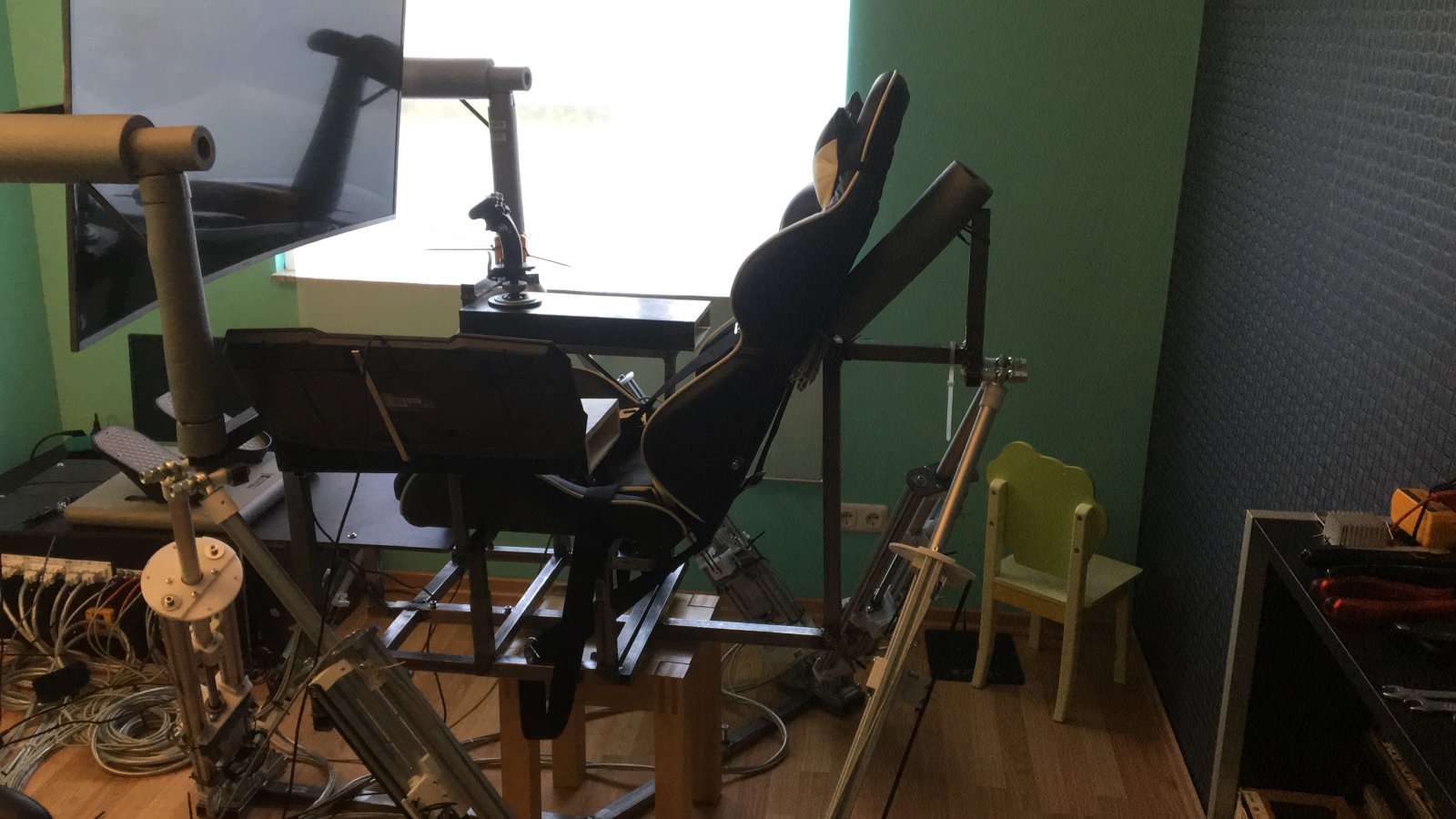

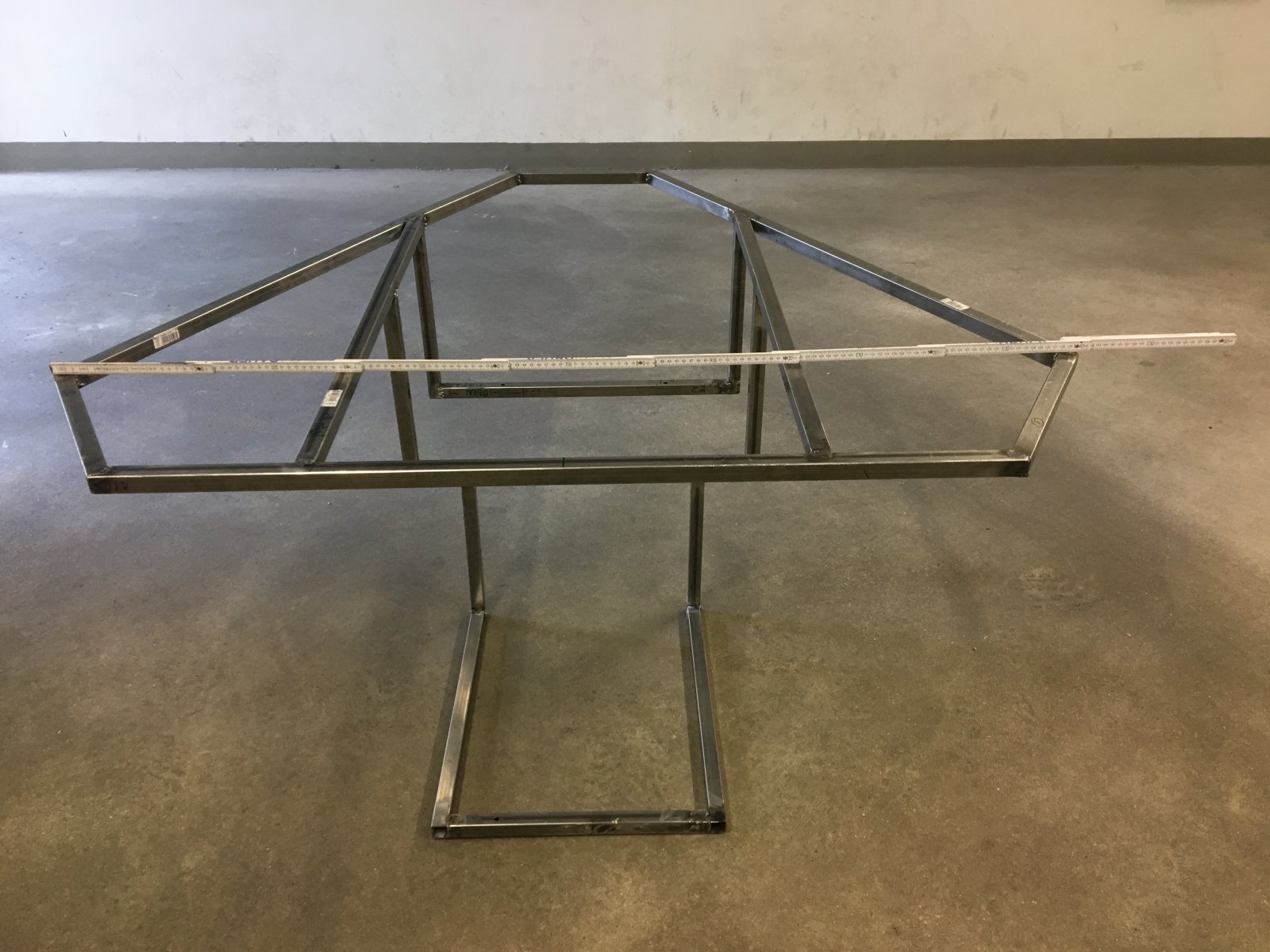

    I will shorten the shelf for the pedals and connect it to the monitor holder.

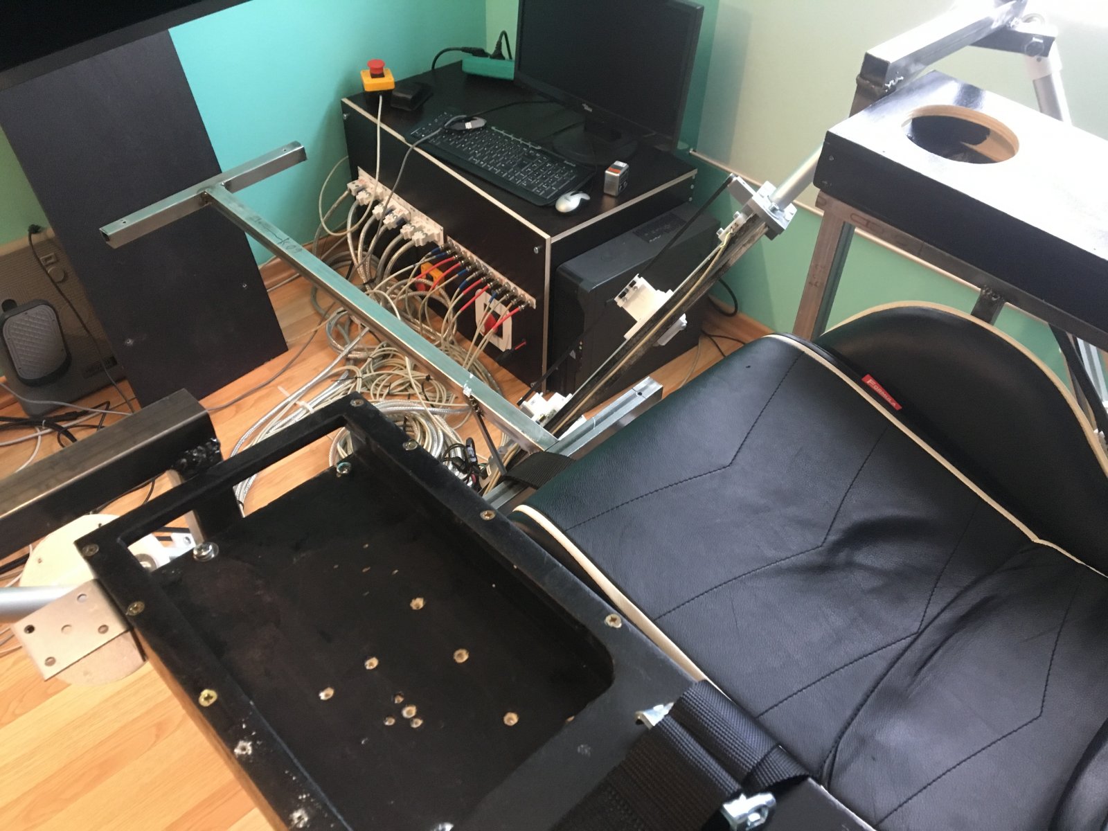

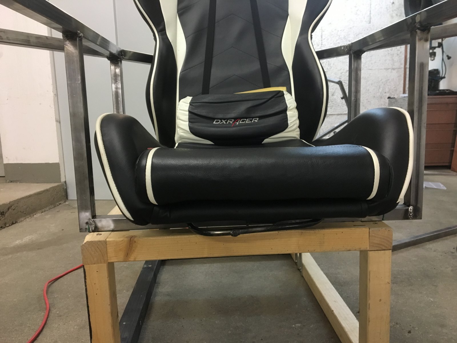

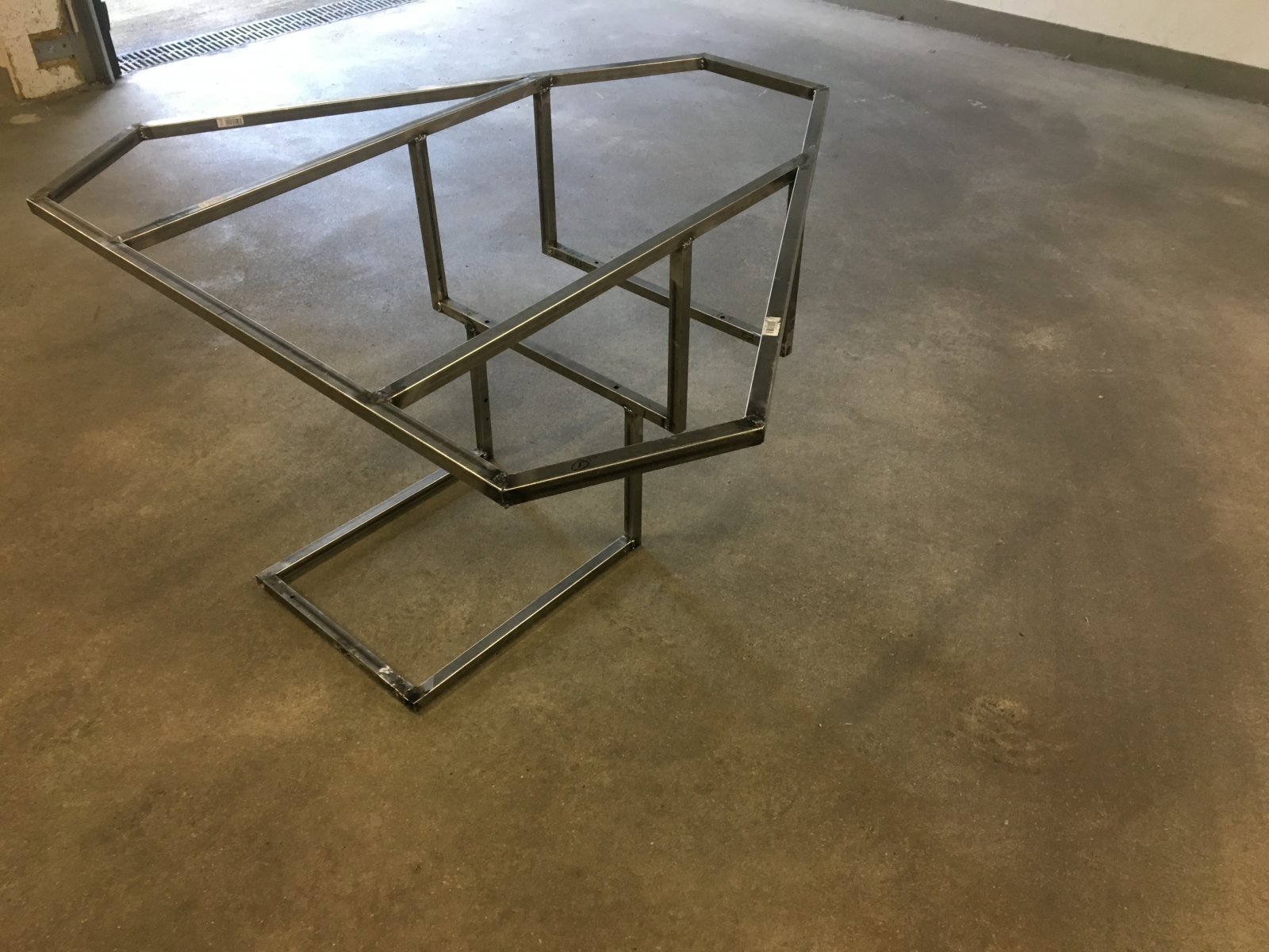

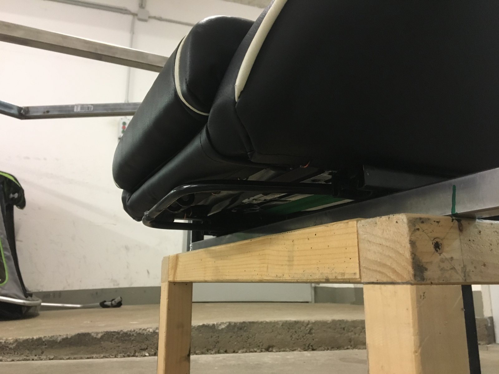

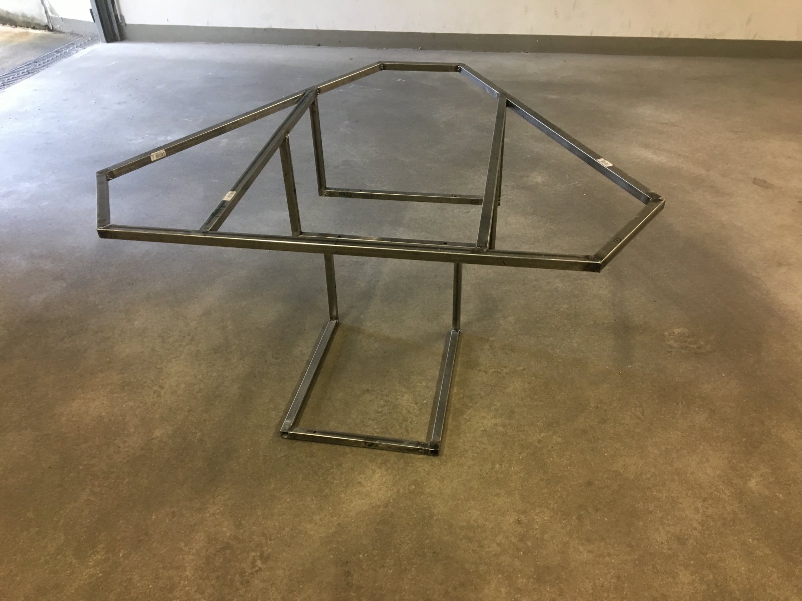

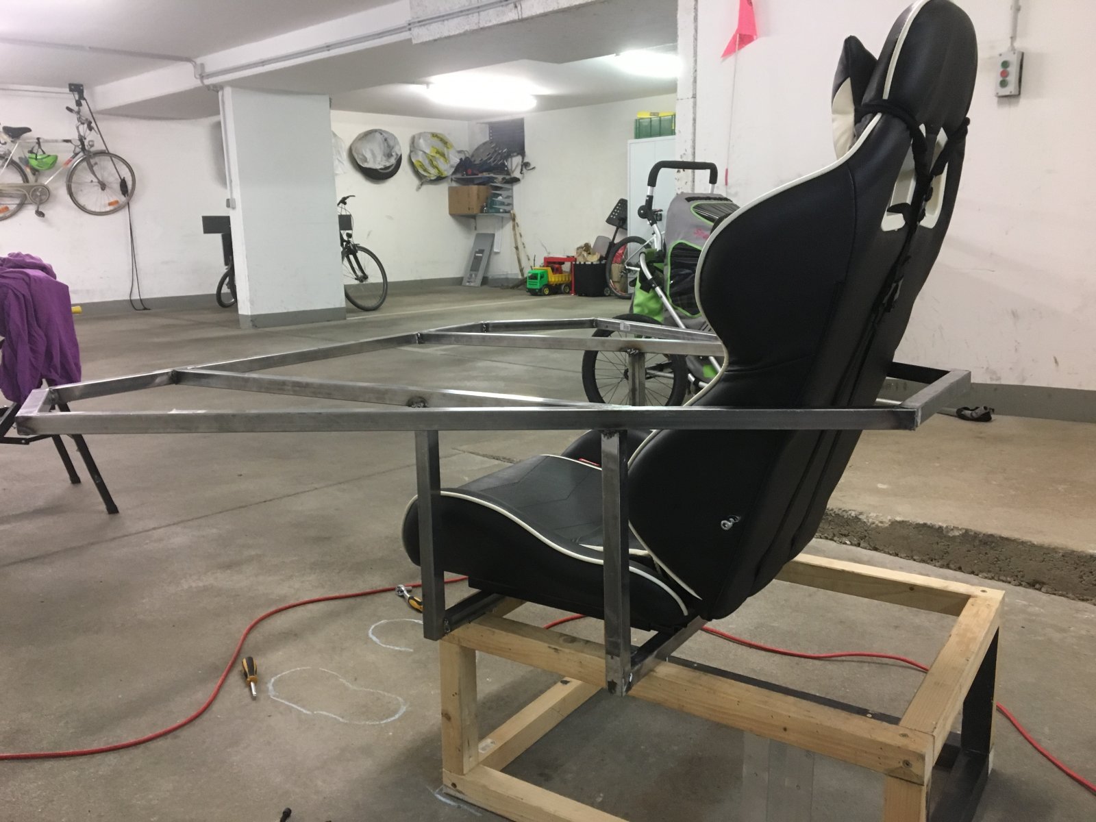

  18. Vitalius
    Jul 2, 2018
    153
    Bonn
    540Coins
    +74 / 1 / -0

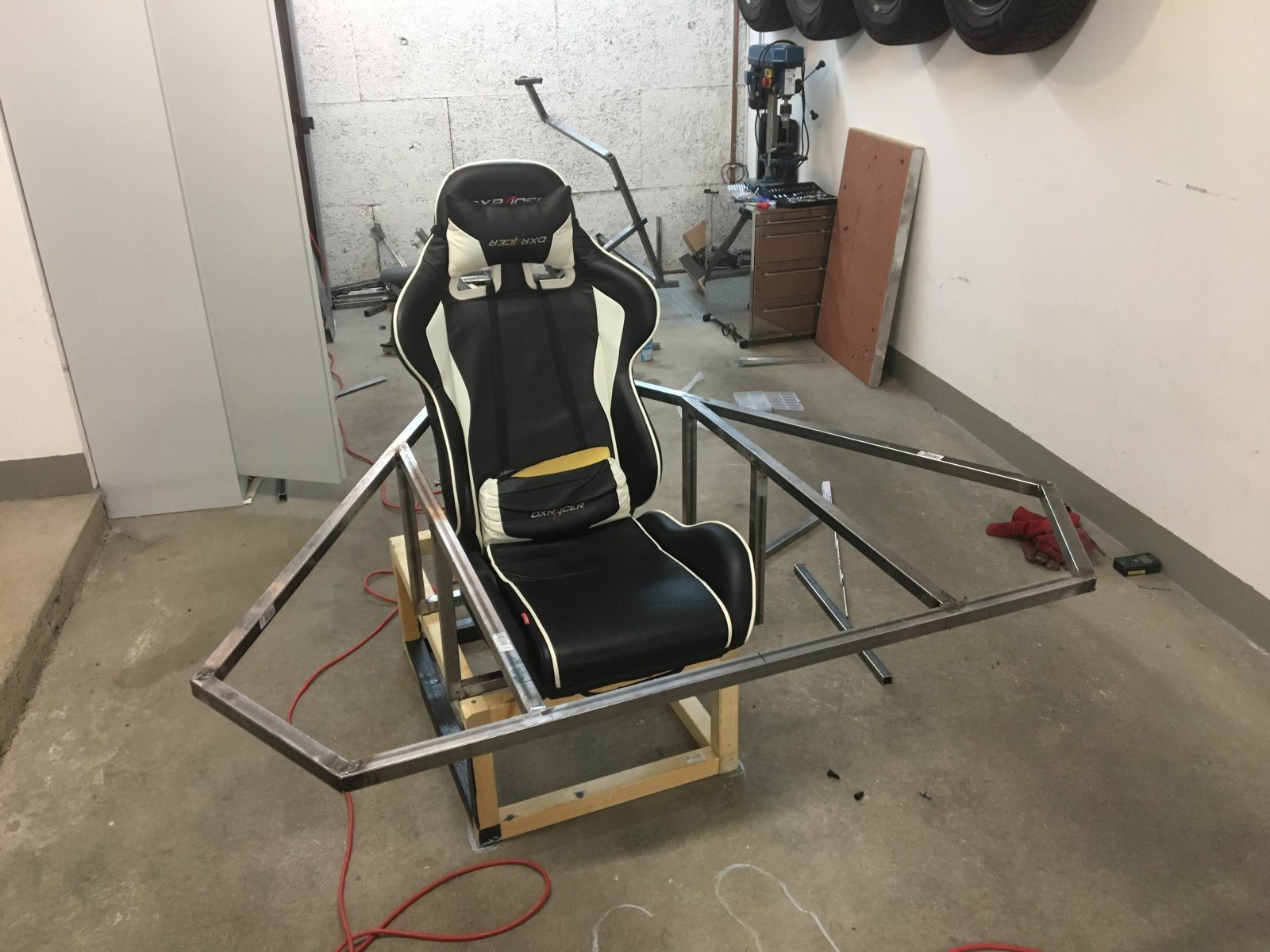

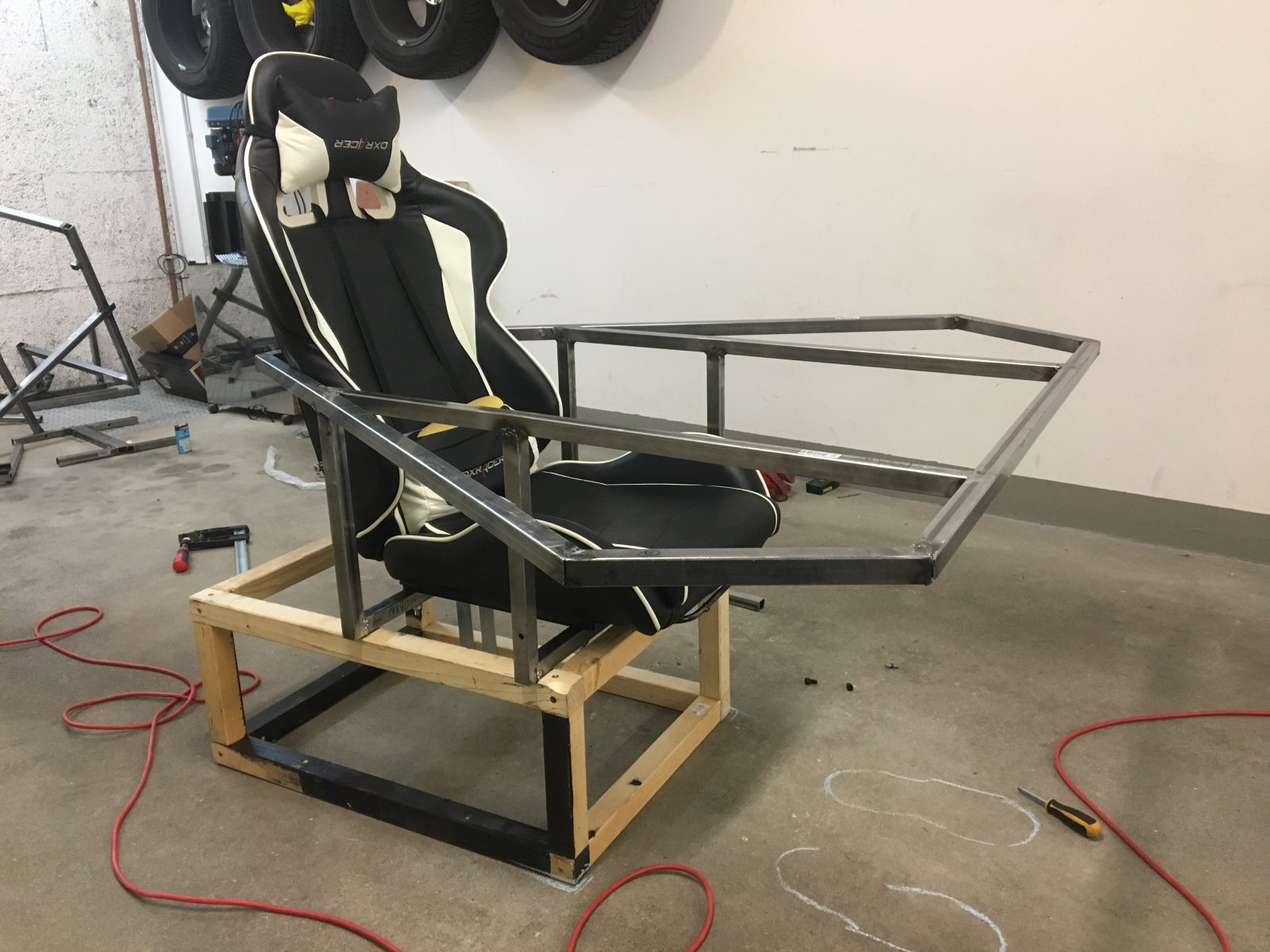

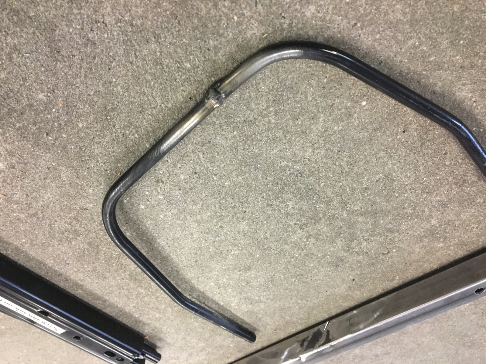

    Holder for chair I will weld firmly to the frame.
    Bishen weight is also saved by it
  19. Vitalius
    Jul 2, 2018
    153
    Bonn
    540Coins
    +74 / 1 / -0

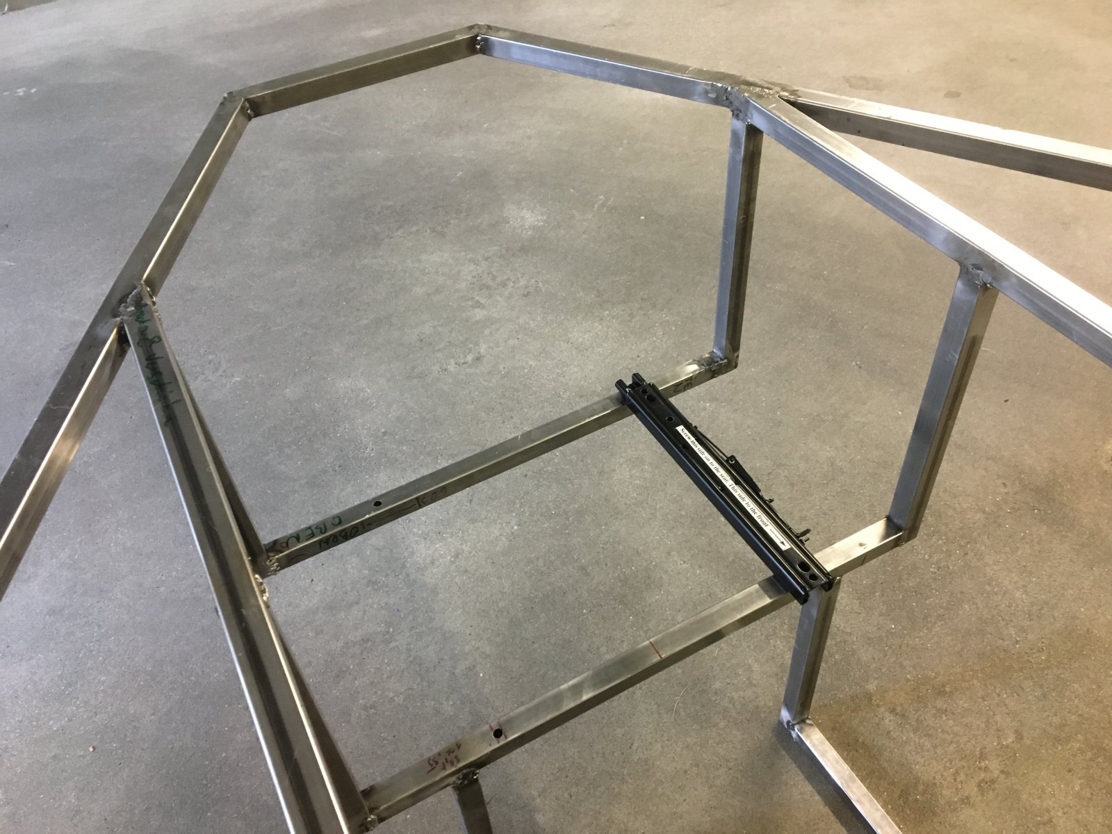

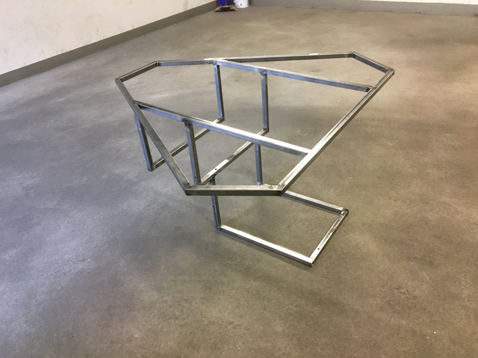

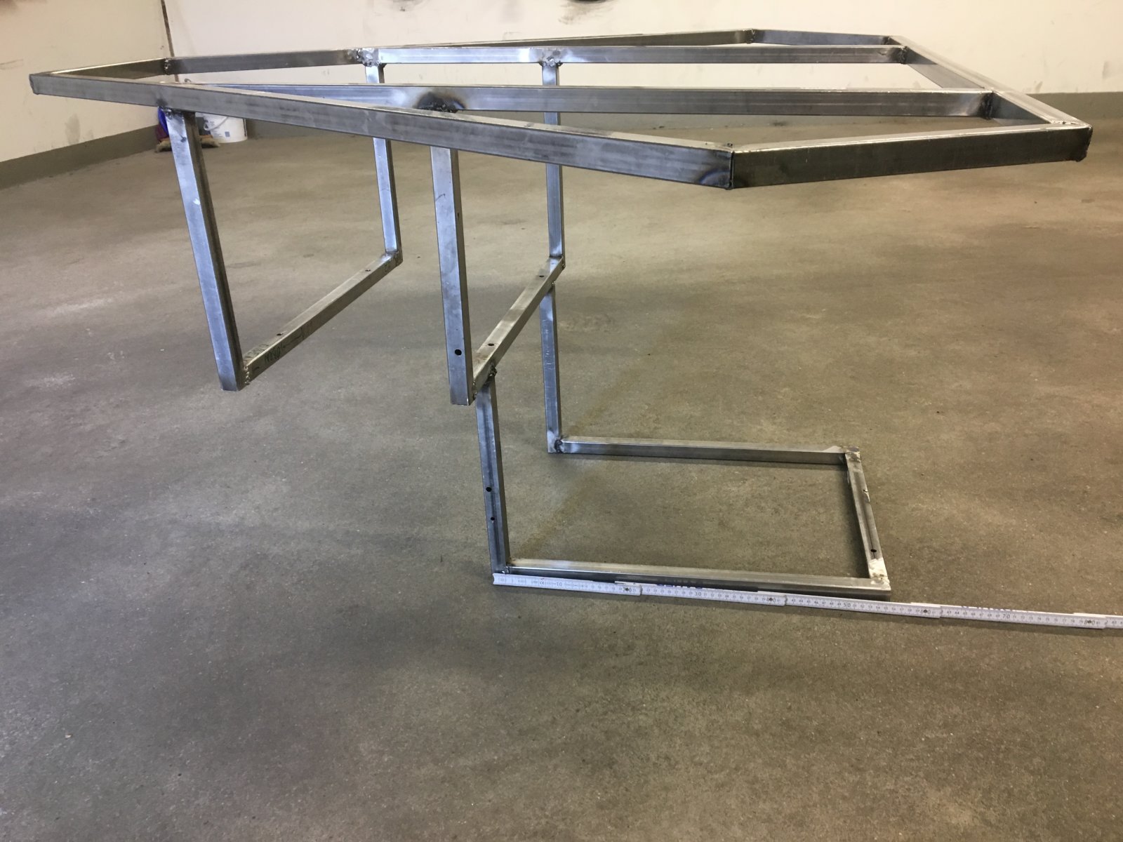

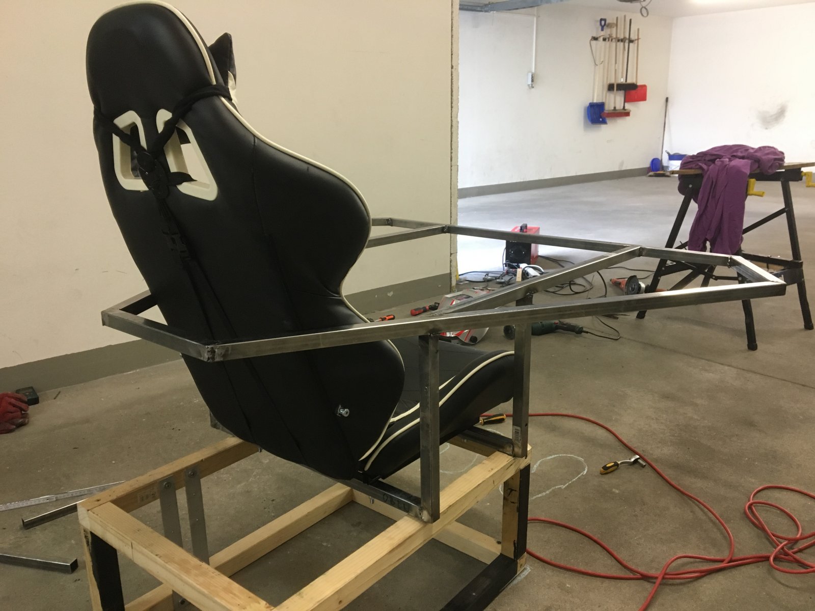

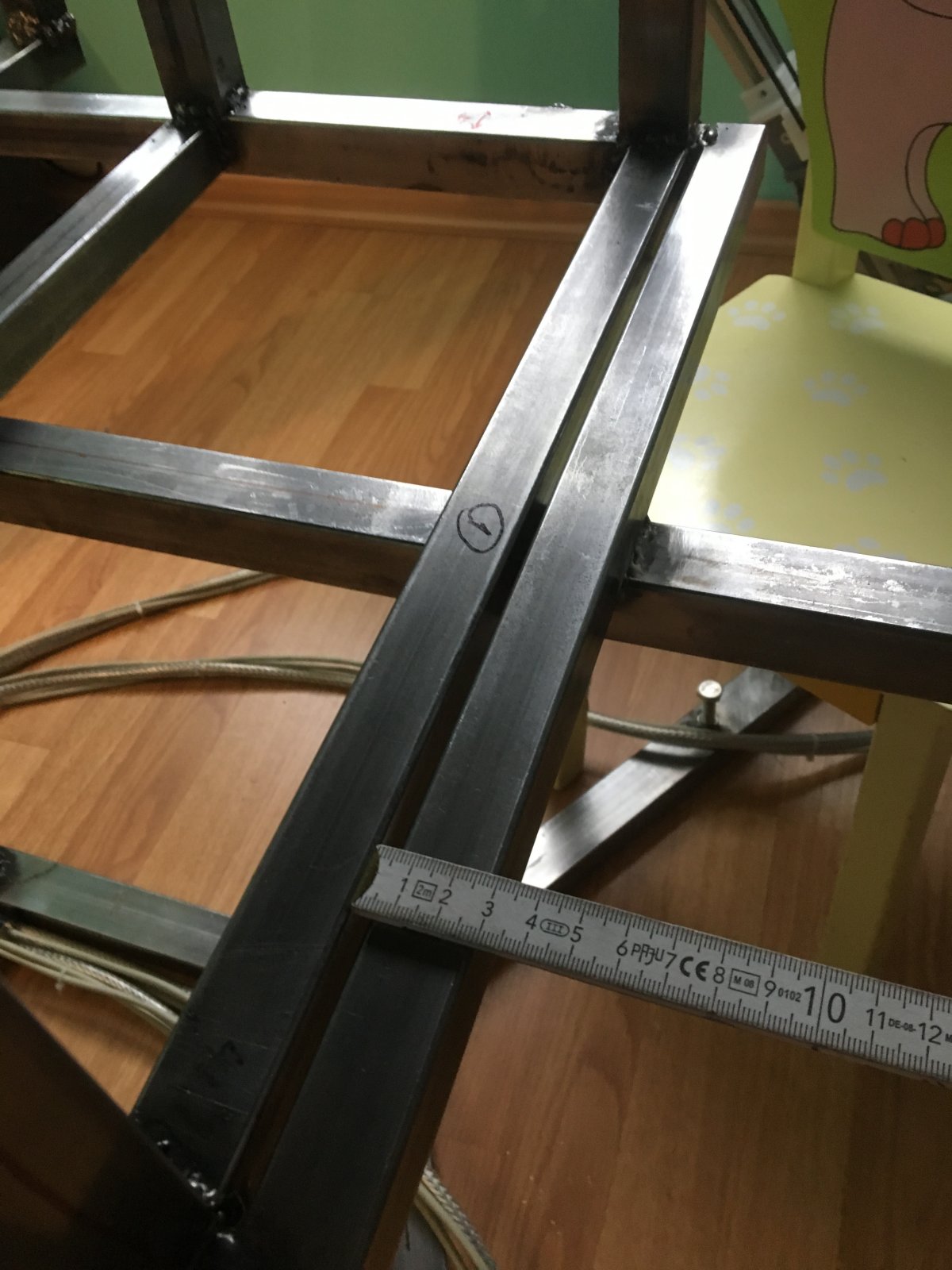

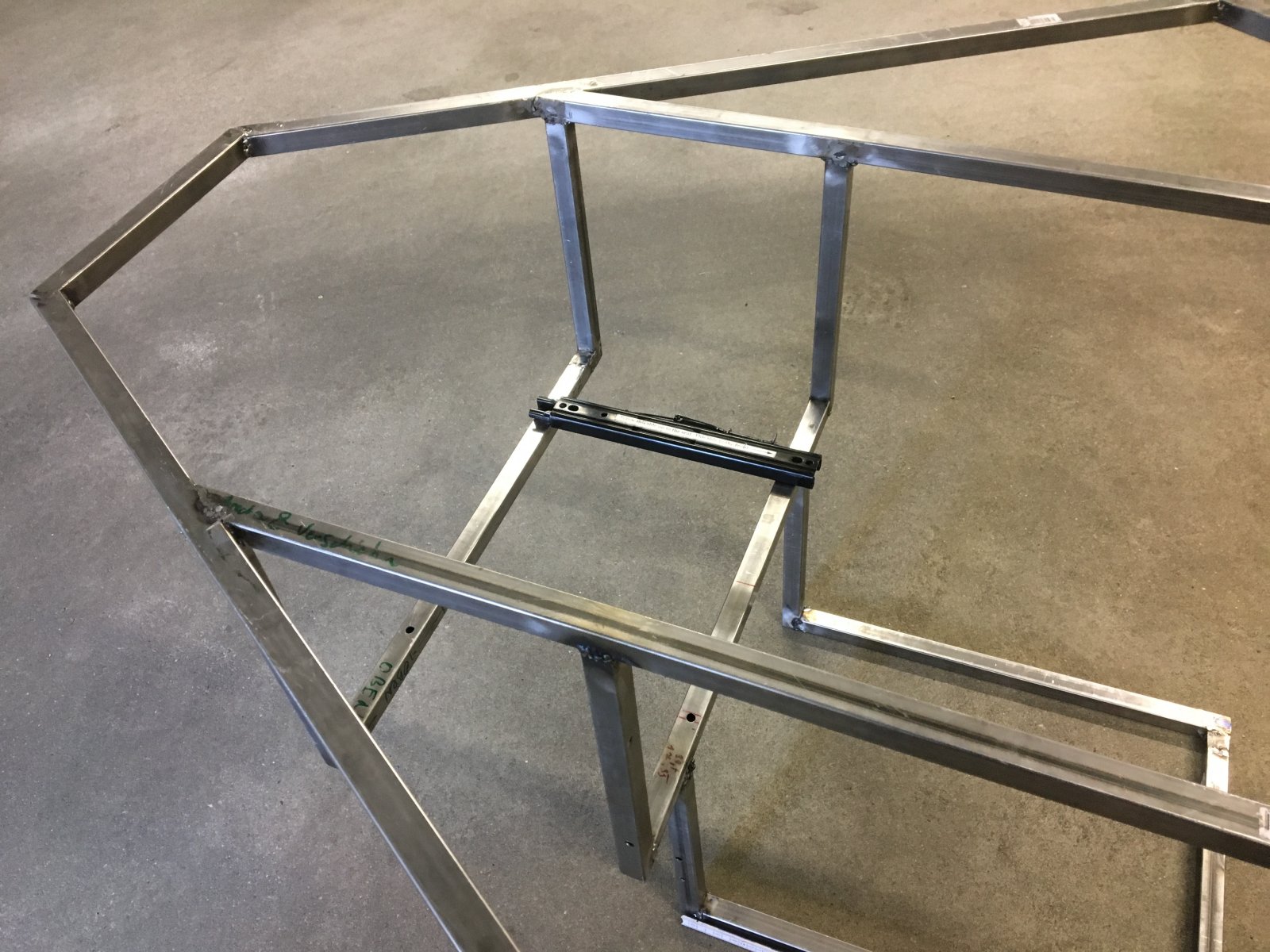

    So my new frame is almost done. A few more weeks ;-) ... and

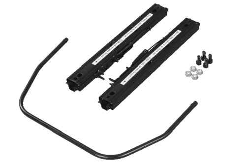

    I bought a useful Playseat Seat Slider at Amazon and integrated with drilling, cutting and welding.

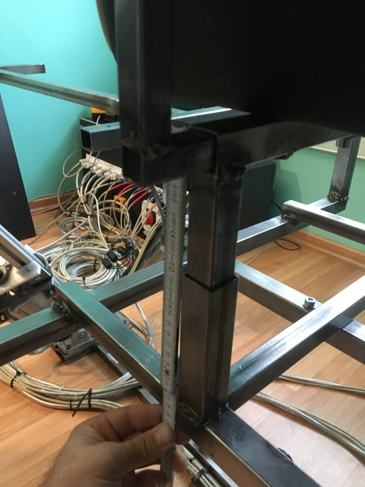

  20. Vitalius
    Jul 2, 2018
    153
    Bonn
    540Coins
    +74 / 1 / -0
    I hope this construction holds. Or maybe you still have some bracing, wait and see
