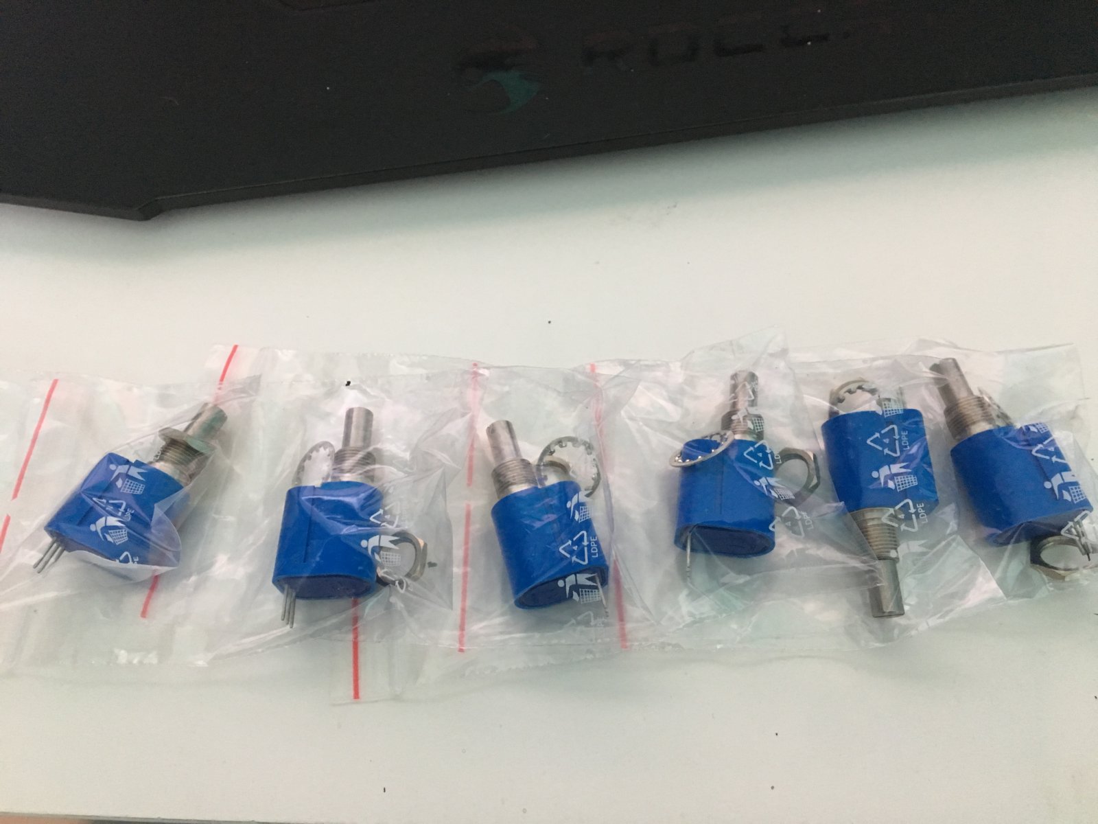

    Hi everybody, so finally my 360 degree Hall sensors are here.
  4. Vitalius
    Vitalius Active Member Gold Contributor
    Jul 2, 2018
    153
    Bonn
    540Coins
    +74 / 1 / -0
    Motion platform, 6DOF
    Now I have a question! How are they connected?
    Plus (+) to 5v, GND to minus (-) and S1 to A0 or A1?
    I just want to play it safe.
    Can you solder the contacts?
  5. SilentChill
    2,645
    20,601Coins
    +3,570 / 34 / -0
    Yes thats correct ;)
