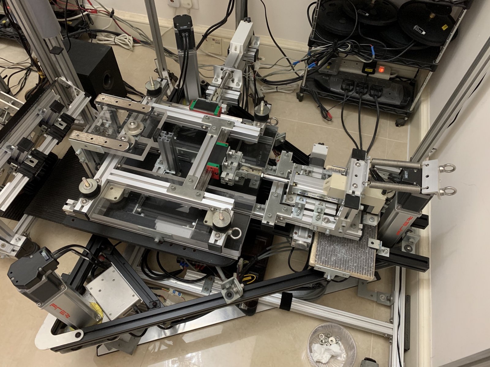

    Finally come back for the unfinished project. Spent quite some time cleaning away the dust & rust. Luckily the actuators still work fine. Two problems were identified.
    First one is when I sit, the seat will tend to lean backward adding torsional stress to the ‘sway’ actuator & radial stress to the ‘surge’ actuator. So I further added a platform at the front of the surge-sway table & another platform at the back right below the ‘surge’ actuator.
    Second problem is when I step on the brake pedal strongly, the backward force applying to the surge actuator sometimes overstress it & cause it to beep. I don’t want to buy another ‘stronger’ actuator right now & so end up adjusting the seating position to a more upright one & turn the pedals to a less vertical position, the surge actuator no longer beeps when I brake strongly. Now playing with the axis settings & will update soon, cheers.
