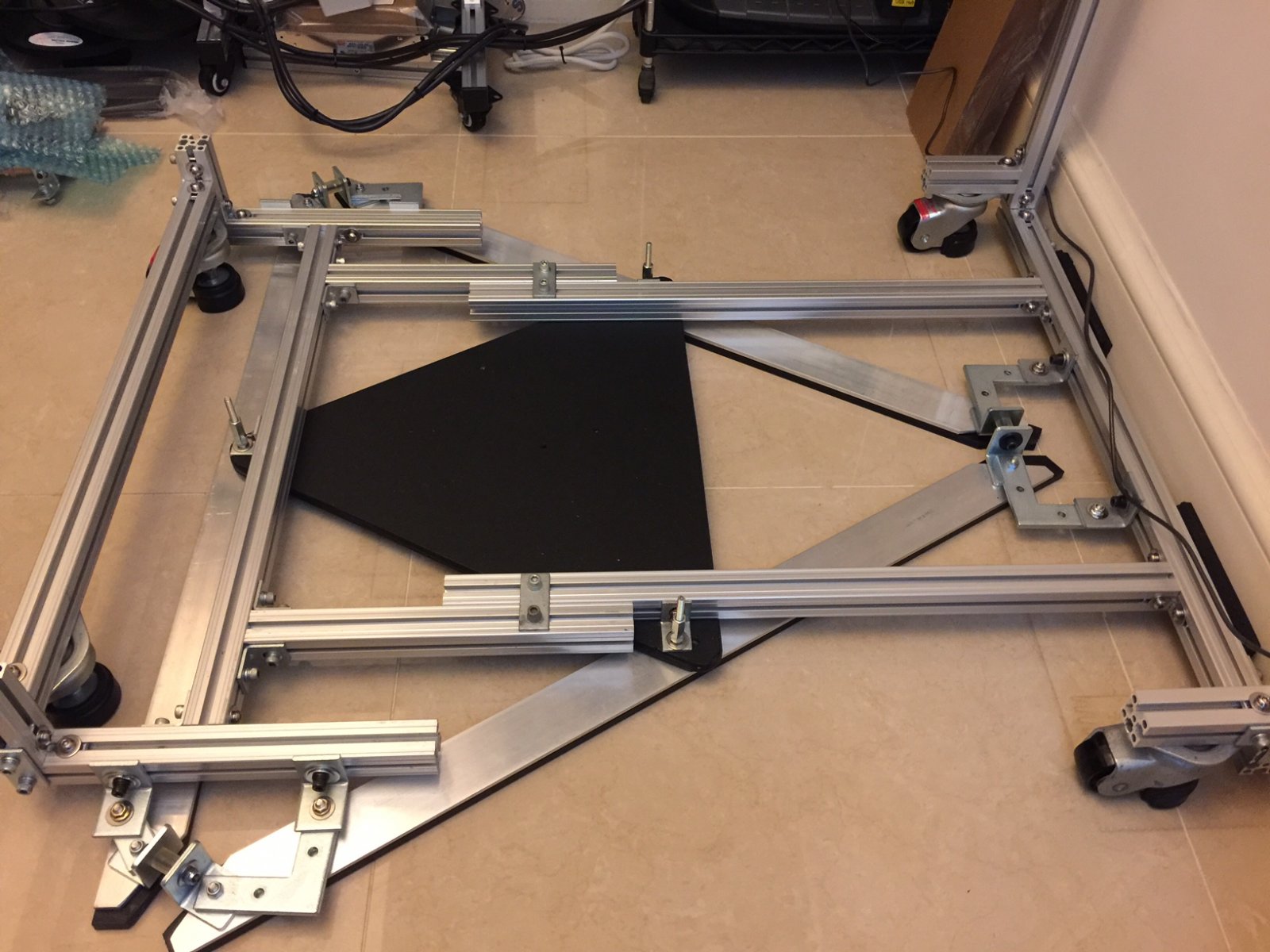

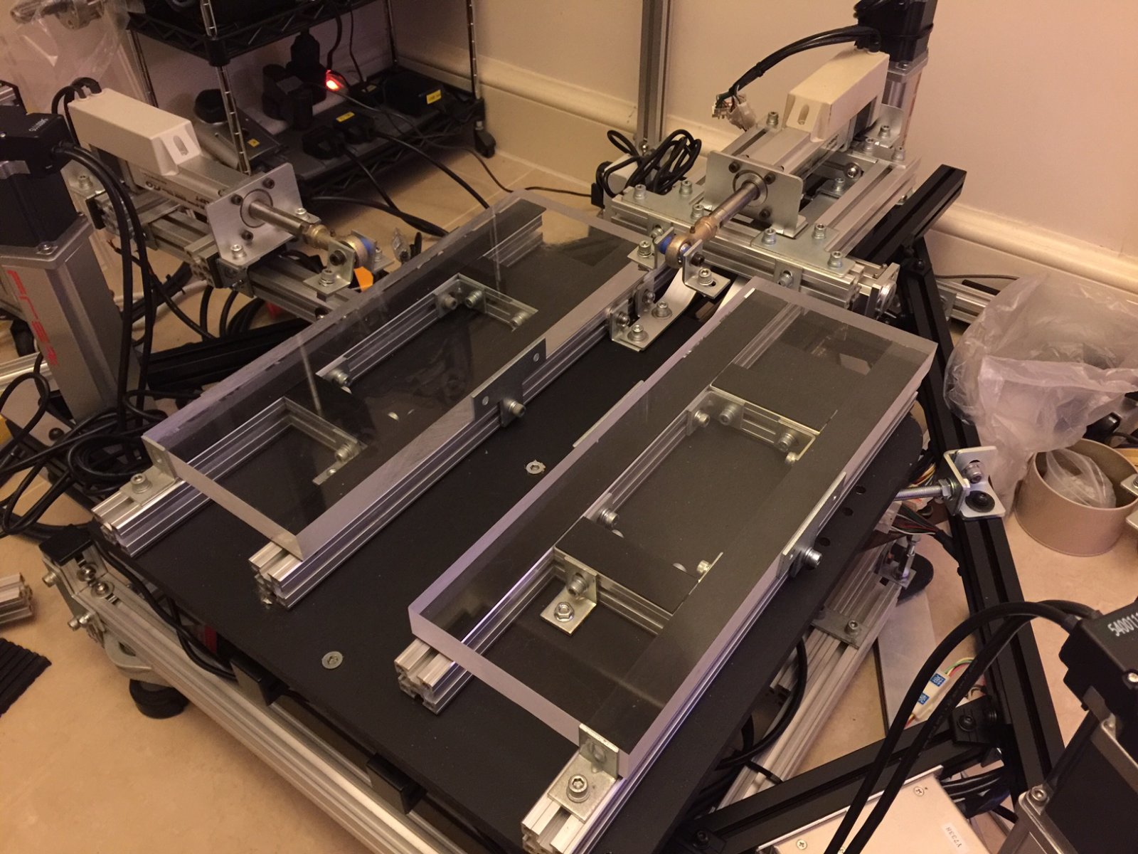

    Earlier this year I resume my project and want to try out a 6dof setup. I bought extra parts and linear actuators from Frex and built a base 4dof (Frex Quadmotion) for heave + pitch + roll + traction loss (yaw) and on top of it DIY a 2dof platform for surge + sway. Below is my progress so far:

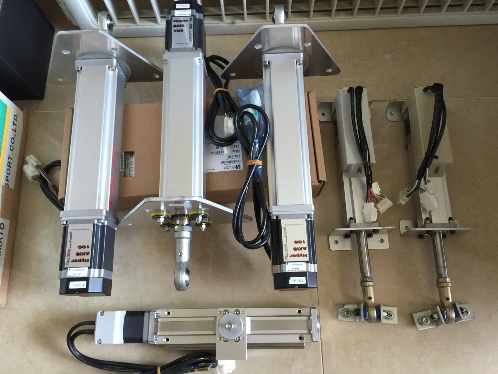

    The six scn actuators including 3 scn6, 2 scn5 and 1 scn5 rodless
    The base is strengthened with frame parts and added carrying mounts so that the whole setup can be relocated if needed

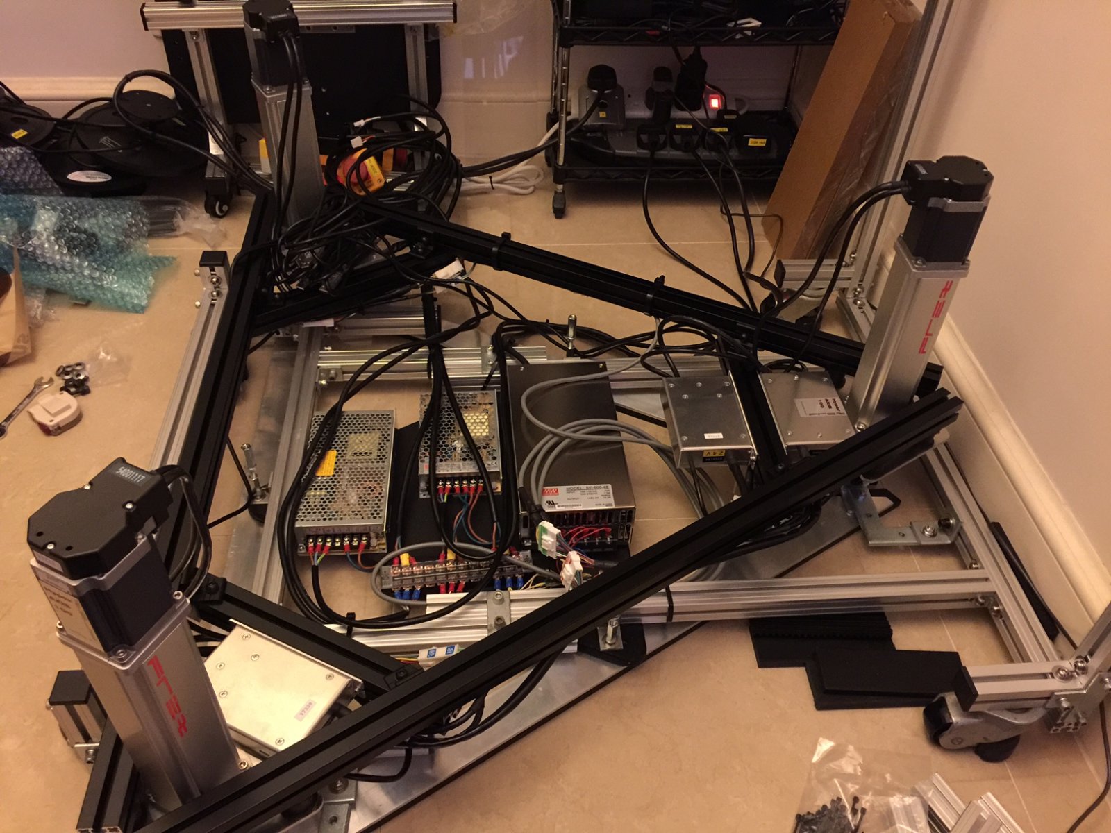

    Triangular base frame with 3 scn6 installed

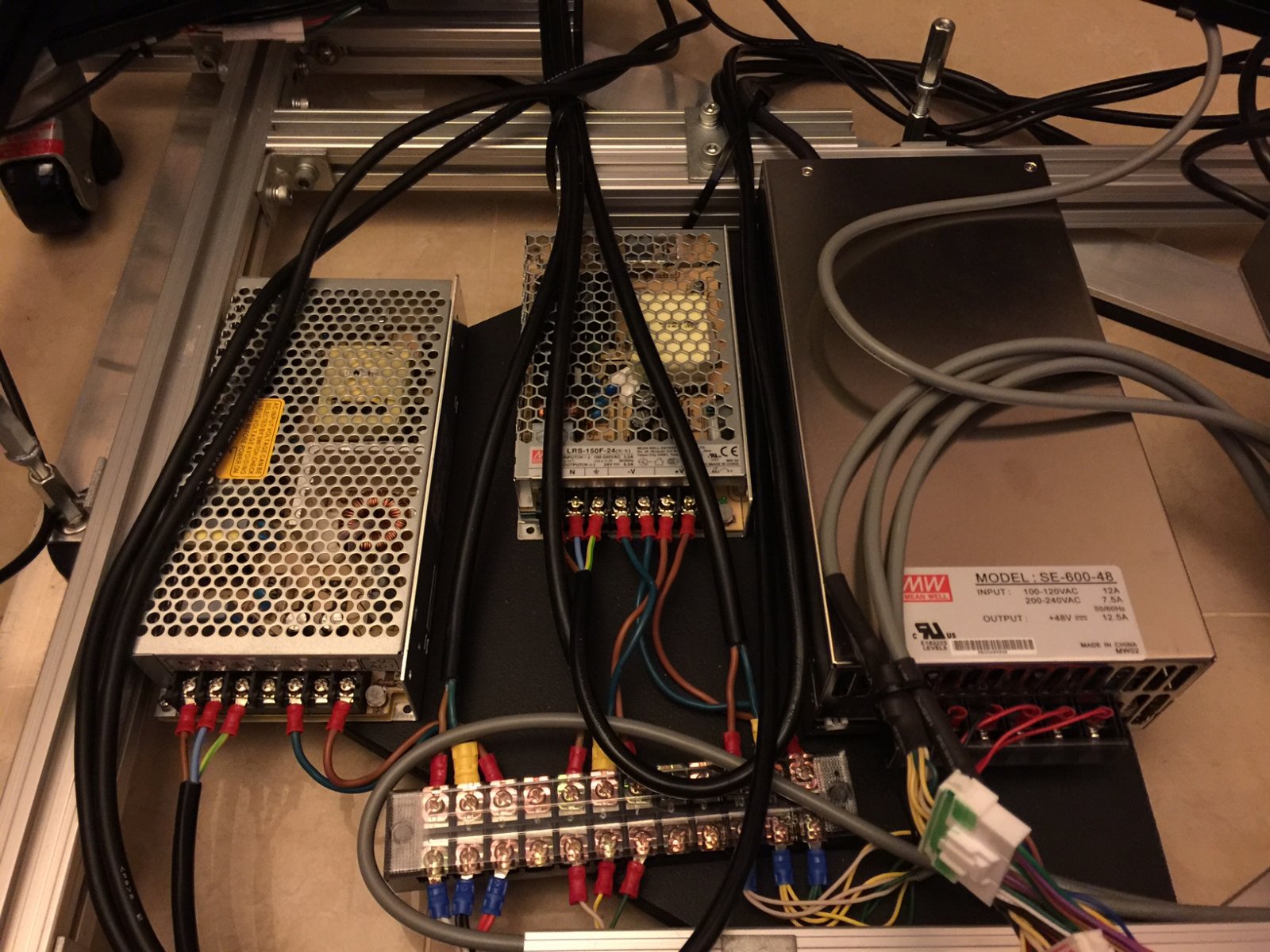

    2 x 24Vdc & 1 x 48Vdc transformers for driving all 6 scn

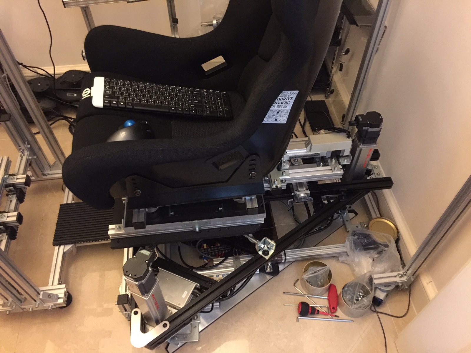

    Installed scn5 rodless and swivel base for traction loss
    Traction loss base finished

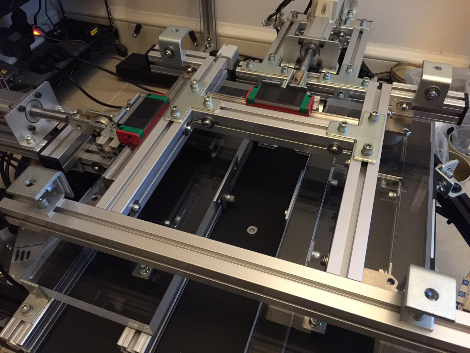

    Added 2 scn5 for surge-sway platform
    Surge-sway platform finished
    Seat installed

    Very much looking forward to seeing the Surge/Sway table in action. Curious what is the seat sitting and sliding on the plexi ?

    Hi, the surge-sway table is sliding on acrylic boards, I also tried granite boards and found both work fine but granites are much heavier so I am using acrylics right now.
    Hope I can set up the profiles and test out some sims this weekend.

    that is impressive and that gave me the idea to build that one too. I have a question: would you tell me, what the pieces are that you attached at the SCN5 the red/green glide pieces? Where did you find that?

    IMO if this is going to be a seat mover, then I think that the amount of movement available may be an issue with stationary pedals/controls.

    Hi, the rail blocks & rails are manufactured by HIWIN, a company in Taiwan:
    http://www.hiwin.tw/Products/Products_gw.aspx?type=gw&subtype=gw_hg

    are these SCN5 100mm and the SCLG5 also 100mm?
