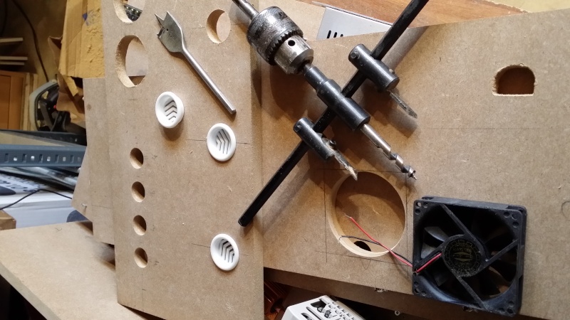

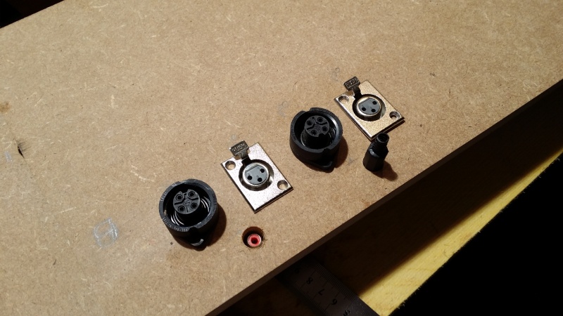

    Today I received the cinch. for 12v fans that I may be put on the engines.
    a large hole and a small :)

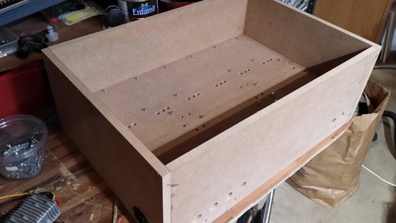

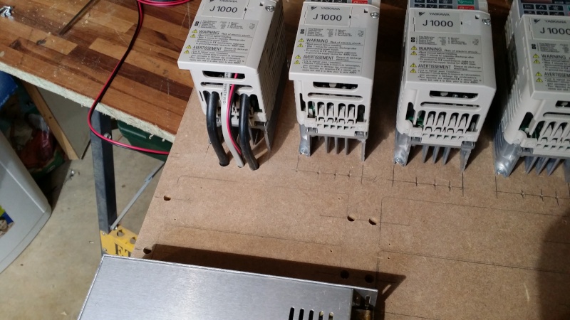

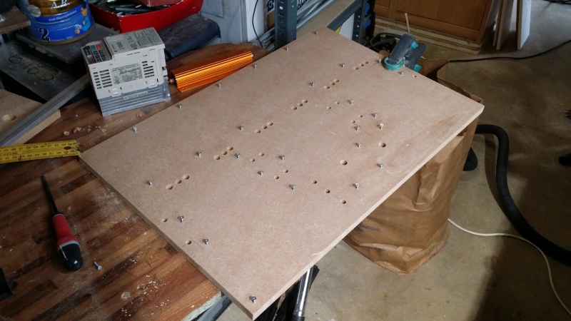

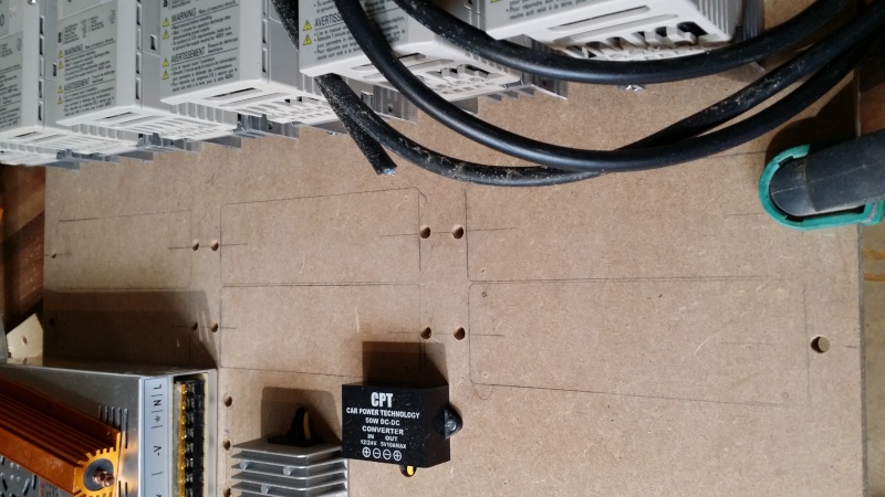

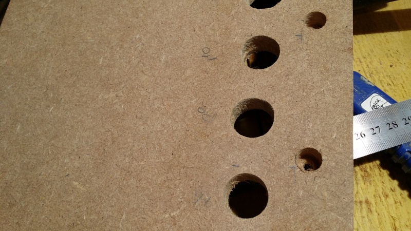

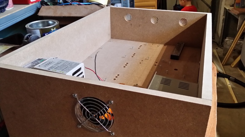

    hello,
    I prepare the hole for the wire :
    drilling before the drives.
    one wire for power supply, one to the motor, one for the resistance, one for card amc1280.
    paints remains
  9. cthiggin
    cthiggin Active Member
    Jul 1, 2012
    672
    Self-Employed
    Montgomery AL USA
    15,210Coins
    +435 / 0 / -0
    vulbas,
    Continuing on with your "beautiful" work....looks super - If your finished platform looks as good as your electronics box, it will be spectacular.
    What weight of wire are you using - going to your vfd's (power) and going to your motors?? Looks to be AWG 14.
    Thanks, Tom
  10. vulbas
    vulbas Active Member
    Jul 28, 2009
    208
    france
    1,102Coins
    +216 / 0 / -0
    AC motor, 6DOF
    thx :cheers
    I will do everything in 1.5 mm ²

    Thanks vulbas,
    You're using what equates to AWG 17 for us......"me" thinks I am going to use 1.63mm or AWG 14.

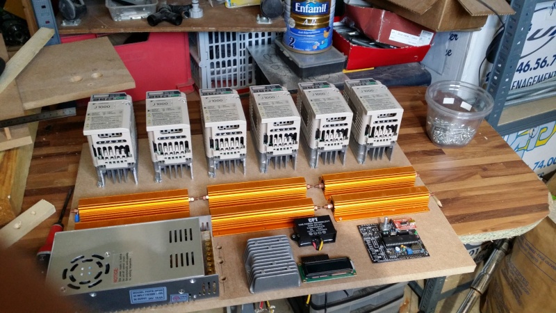

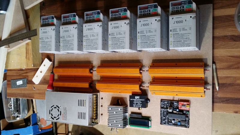

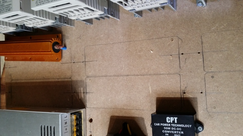

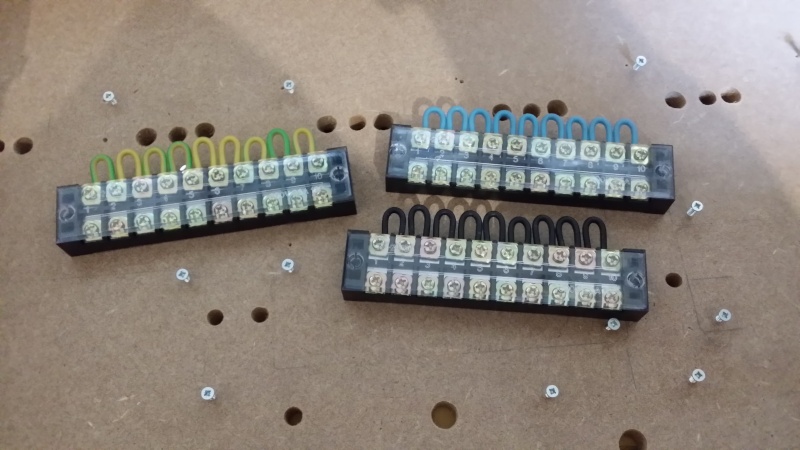

    preparation of terminal strips
    ventilation
    I'll put a bright red 80mm fan ;)

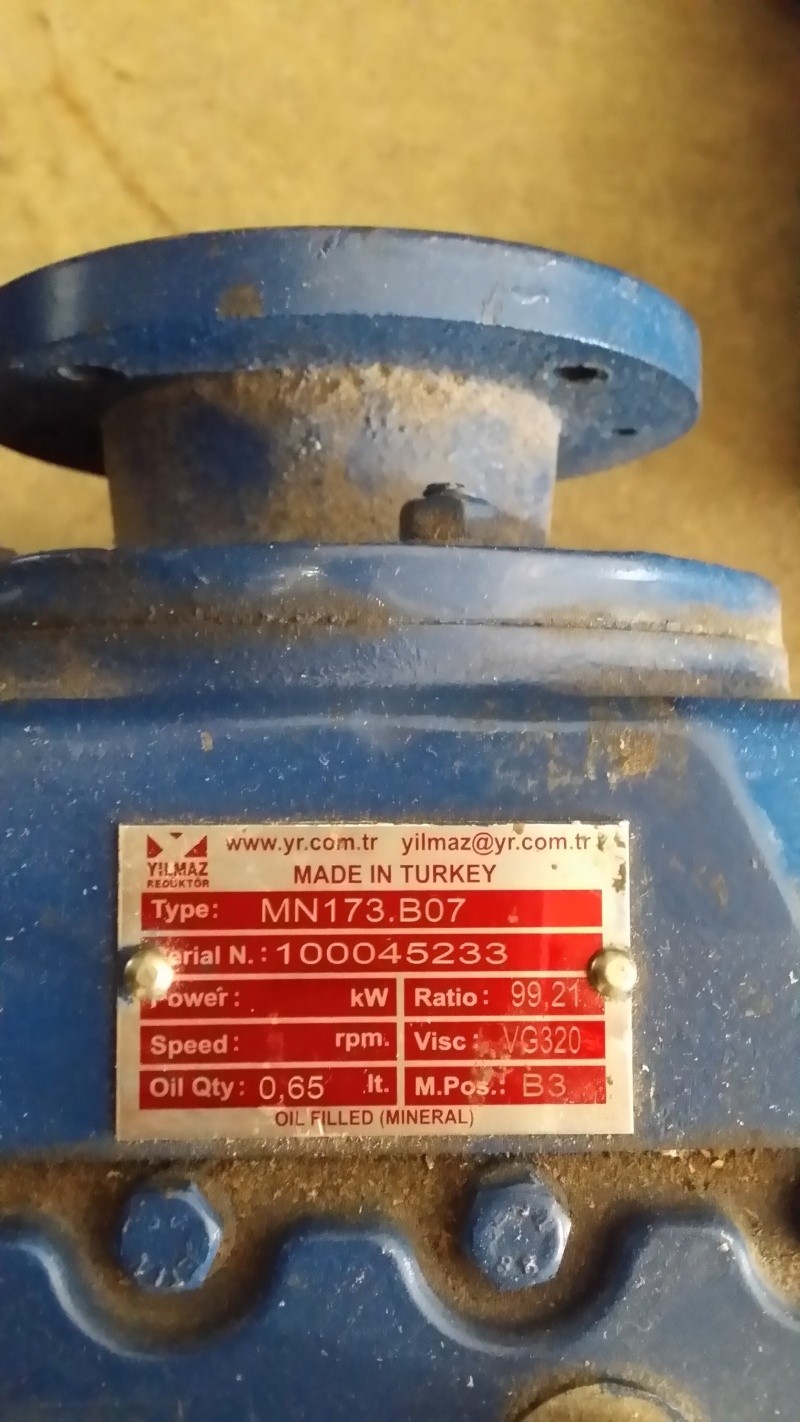

  13. speedy
    speedy Well-Known Member
    Feb 1, 2012
    1,193
    Alexandria , Egypt
    7,944Coins
    +1,287 / 10 / -0

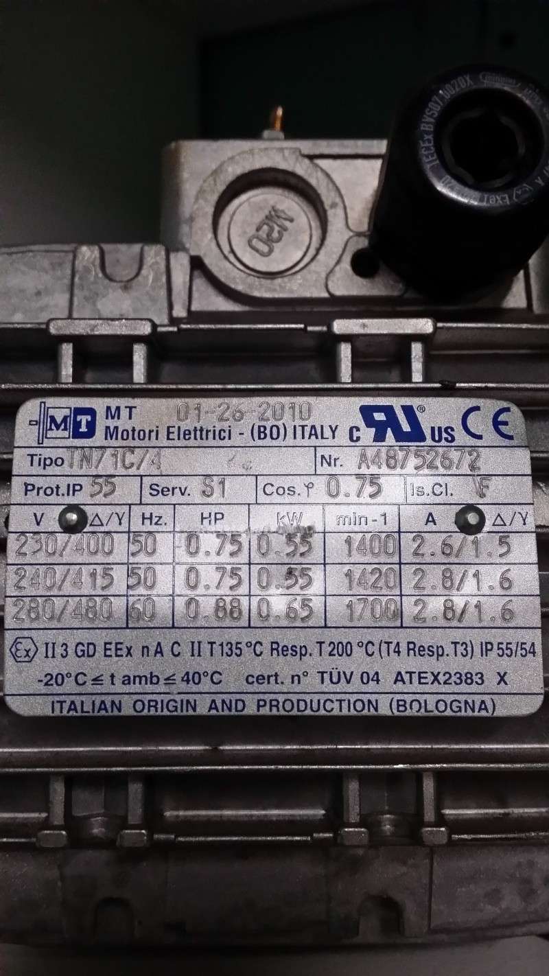

    Great job @vulbas ... Wow you have a good project to do here :thumbs very very good ... Que c'est beau .

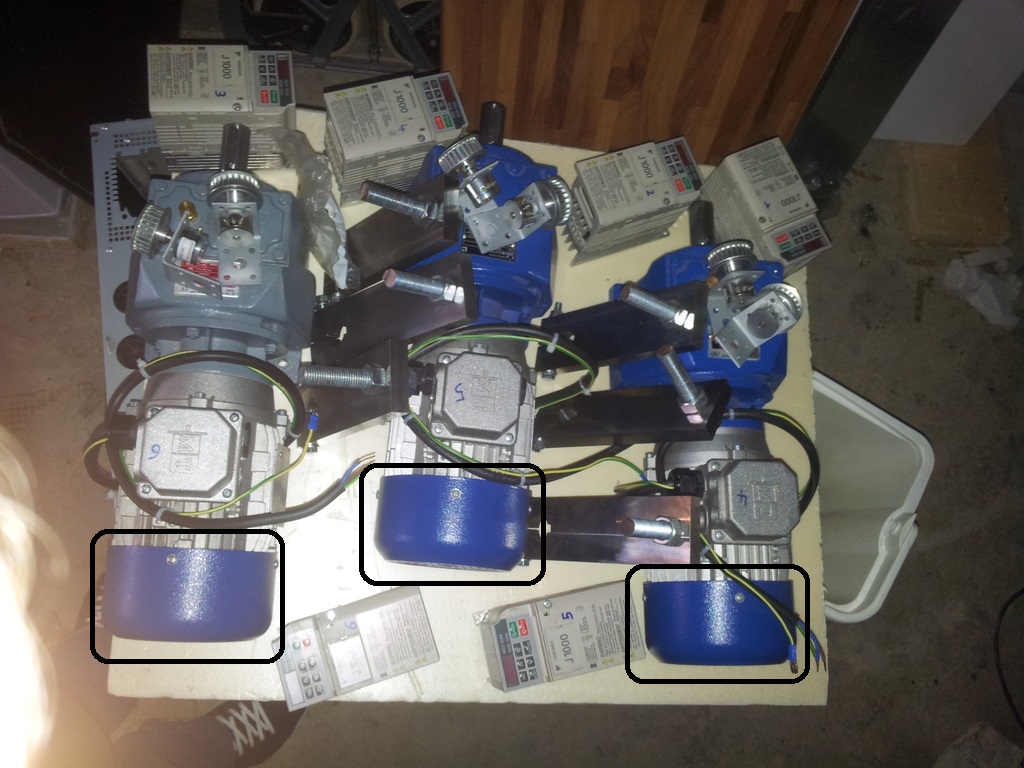

    I have a request please ... I see something that I hope I'm wrong .
    I want to know where is the break clutch wires connected to in your motors ?
    The motors on the first page are not with break clutch to connect the break resistor to ... I need a picture of the name plate of your motors please ... I saw the inspiration picture and these motors are with clutch ... can you make sure please ... please I hope I'm wrong .
    and what is the model of your VFD's "I can't get more than they are J1000" ...
    Thanks my friend ... have a good time .

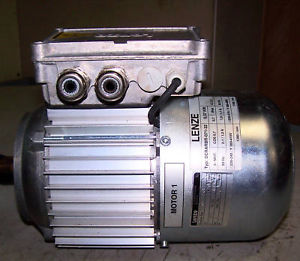

  16. speedy
    Feb 1, 2012
    1,193
    Alexandria , Egypt
    7,944Coins
    +1,287 / 10 / -0
    Thanks @vulbas ...

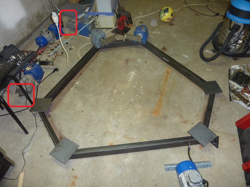

    My point for asking all of this, If you allow me ? ... is this next photo which took my attention to some motors that uses a brake clutch connected VFD ...
    look How these motors back cover are bigger than the blue ones you have in first page ? ...
    especially when you disassembled them ... like this .
    How about another photo for the VFD side sticker ? OR, How did you choose this dinamic 200Ohm resistor ?
    :thumbs thanks in advance .

  17. vulbas
    Jul 28, 2009
    208
    france
    1,102Coins
    +216 / 0 / -0
    AC motor, 6DOF
    ho ok, my engine does not use brake, it is not useful
    the braking resistors are used to absorb the return current motors. when they start in dynamo. this is not essential, but as I had the cheap ....
    200ohm, it was marked in the user manual of the J1000 ;)
    http://www.yaskawa.com/site/products.nsf/staticPagesNewWindow/j1000dboptions10.html#200_240_Single
    CIMR-JUBA0003BAA for me
    resistance braking plugs into B1 and B2
    http://downloads.industrial.omron.f...se/J1000/I81E/I81E-EN-01A+J1000+Datasheet.pdf
