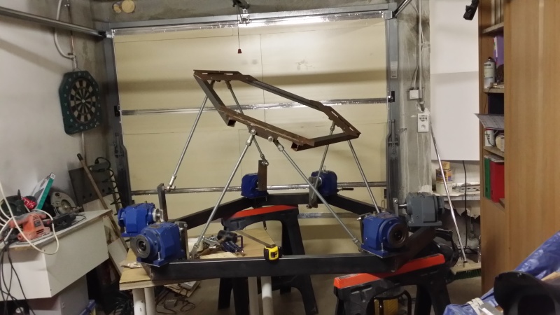

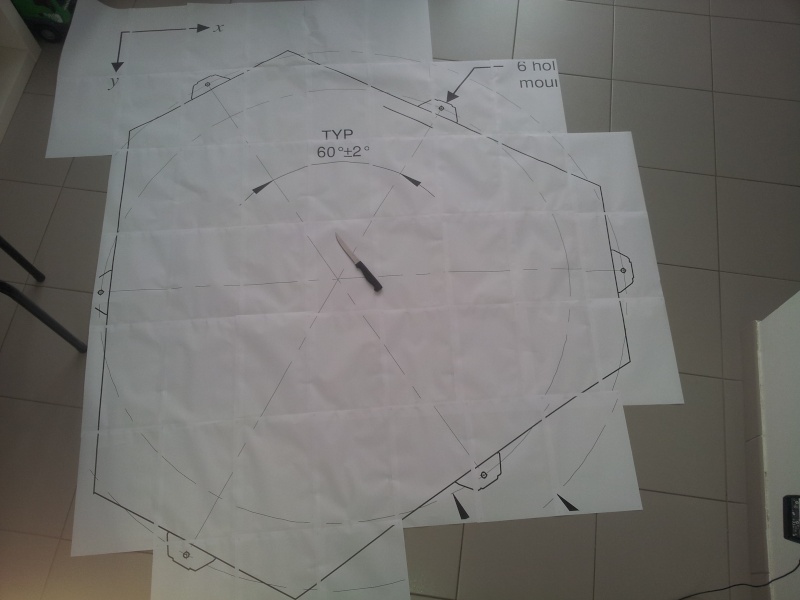

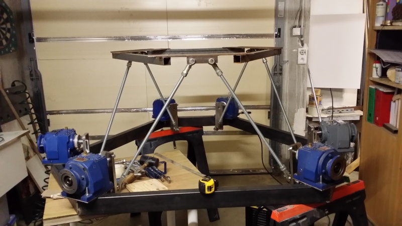

    I'm doing a 6DOF, a reproduction of Ckas.

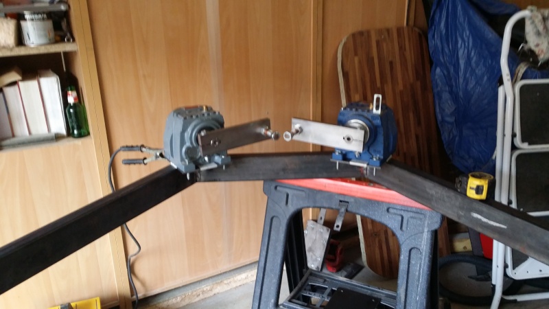

    550w engines. reducer 14rpm. 375nm.
    braking resistor and connector
    6 j1000, pp27 and motor
    base
    my first simulator 2dof

    I use Italian engines. buy in France. I think the price is 400 € / piece. 14rpm, 375nm.
    drives cost a € 180 I think.
    I just watched your achievement, superb!
    I'll finish the weld plates. and manufacture the electronic box.

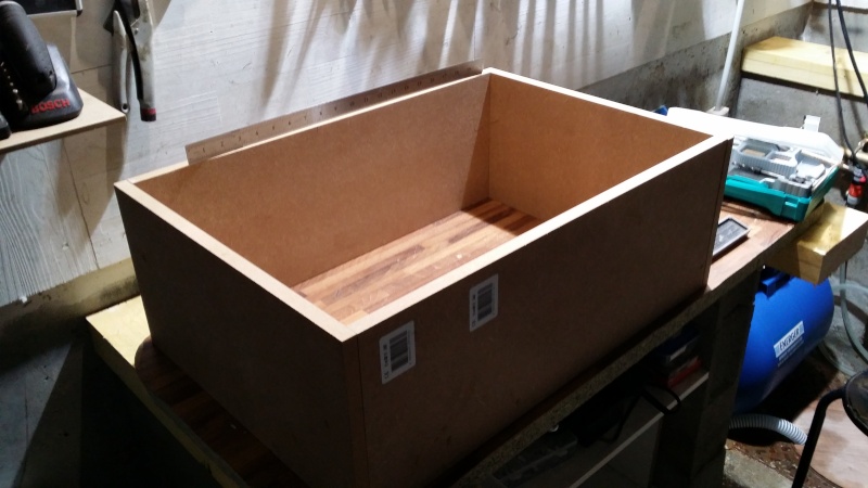

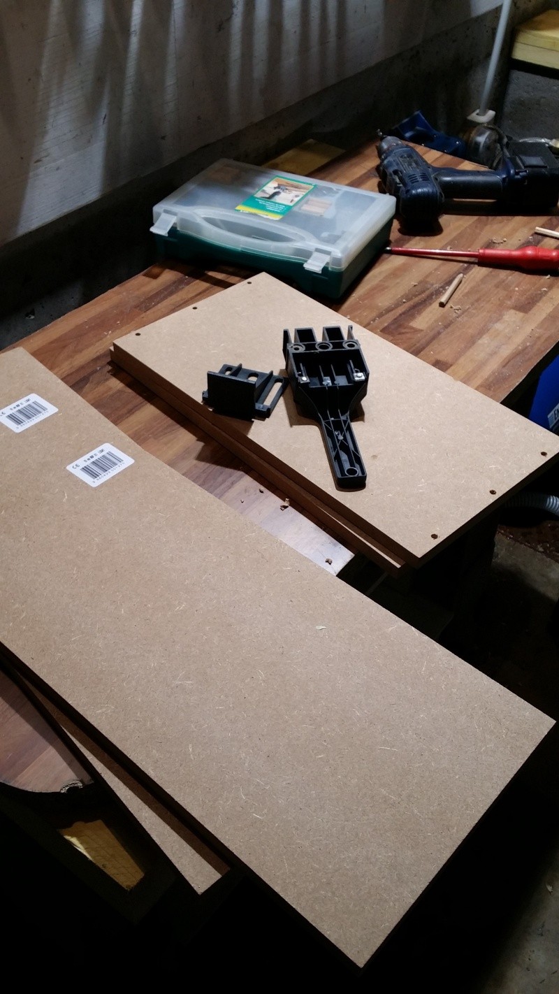

    Tonight I decided to make the electronic box :)
    mdf, 15mm. 60x40cm.
    there will be a double bottom to hide all wires

    Hi vulbas,
    Love the double-bottom idea - I'll probably incorporate it in my electronics box - hate a bundle of wires showing.
    I have to get my VFD's in, and rest of electronics before I know size of my electronics' box - I know yours has to be big for 6dof.
    ?? - Are you going to drill exhause holes and put a fan in for cooling?
    Great work.
    Tom

    AC motor, 6DOF
    thank you tom.
    I also do not like wires lol
    I'll put a fan, I still do not know the size, 40, 60 or 80mm
