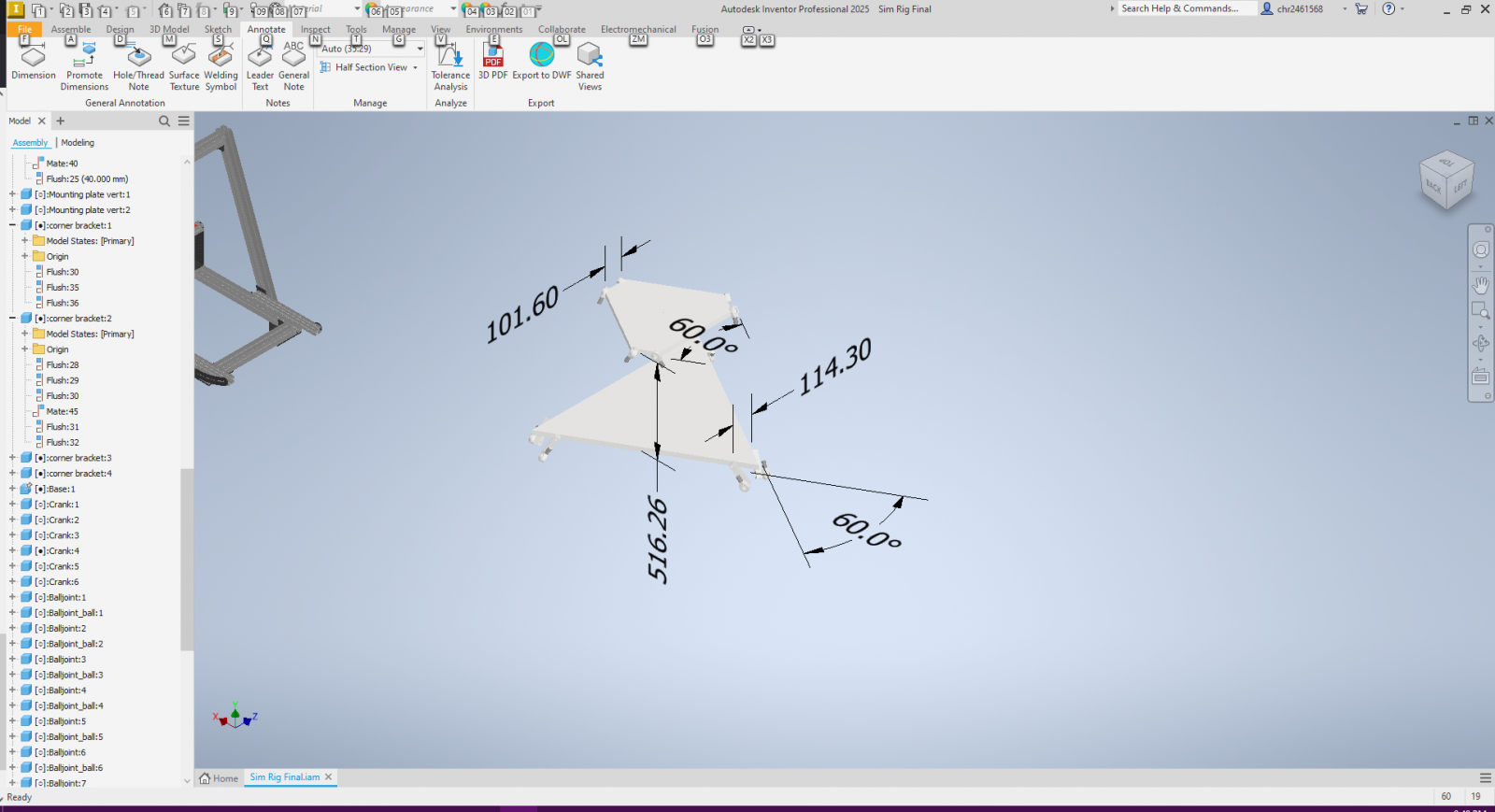

    So far i have a 6DOF stewart platform made from hobby servos using an ESP32 dev board and FlyPT software
    I also have a rig in process of being built(based off of Next level racing F-Gt Elite)
    Crappy cad model of full scale stewart platform
    next up is motors. Still at a loss of what to do for cheapest motor setup for moving 150kg(me and rig)(total is less than that but using that as a benchmark)

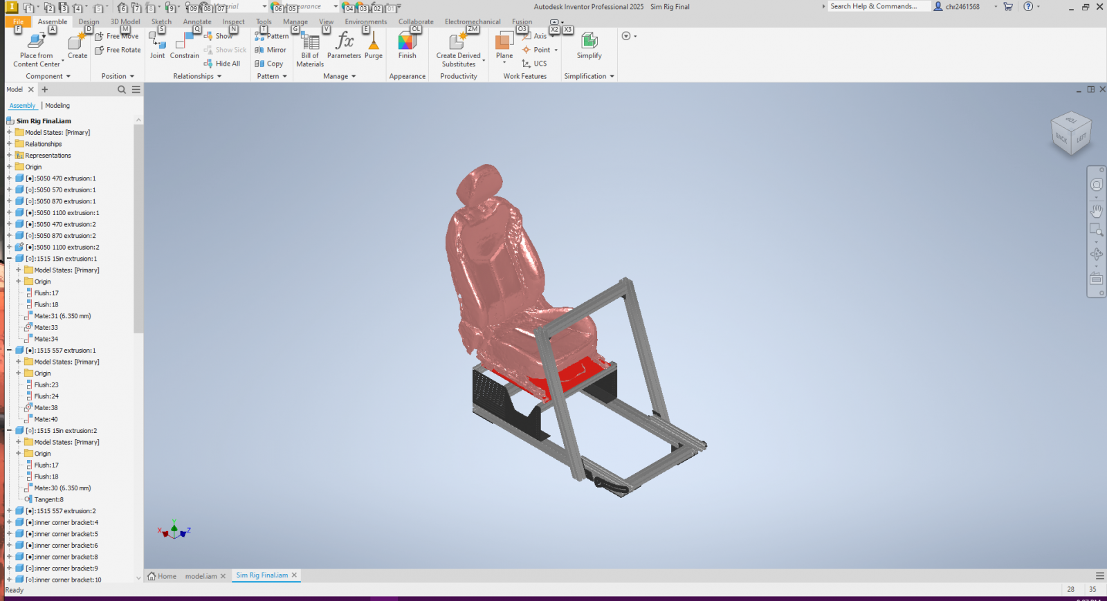

    Here is my cad model for my rig, made with 5050 aluminum extrusion and 1/4 aluminum for the brackets
    very adjustable, from my real car seating position all the way to f1 position.

    My rig rough draft dimensions are as follows:
    1200mm base
    600mm platform
    500mm height

    After looking at it a bit, ive found a robodog example using odrive, hoverboard motors, and absolute hall sensors.
    im using that leg force excel with the rough draft dimensions and each leg will have 300N resting force and 600N at 1G heave acceleration.
    if at a crank arm of 100mm that 30-60Nm of torque. I would need 1:5 reduction to be able to use the 13Nm hoverboard motor. since its only 1:5 i was thinking of a capstan reduction drive(would be minimal backlash too)
