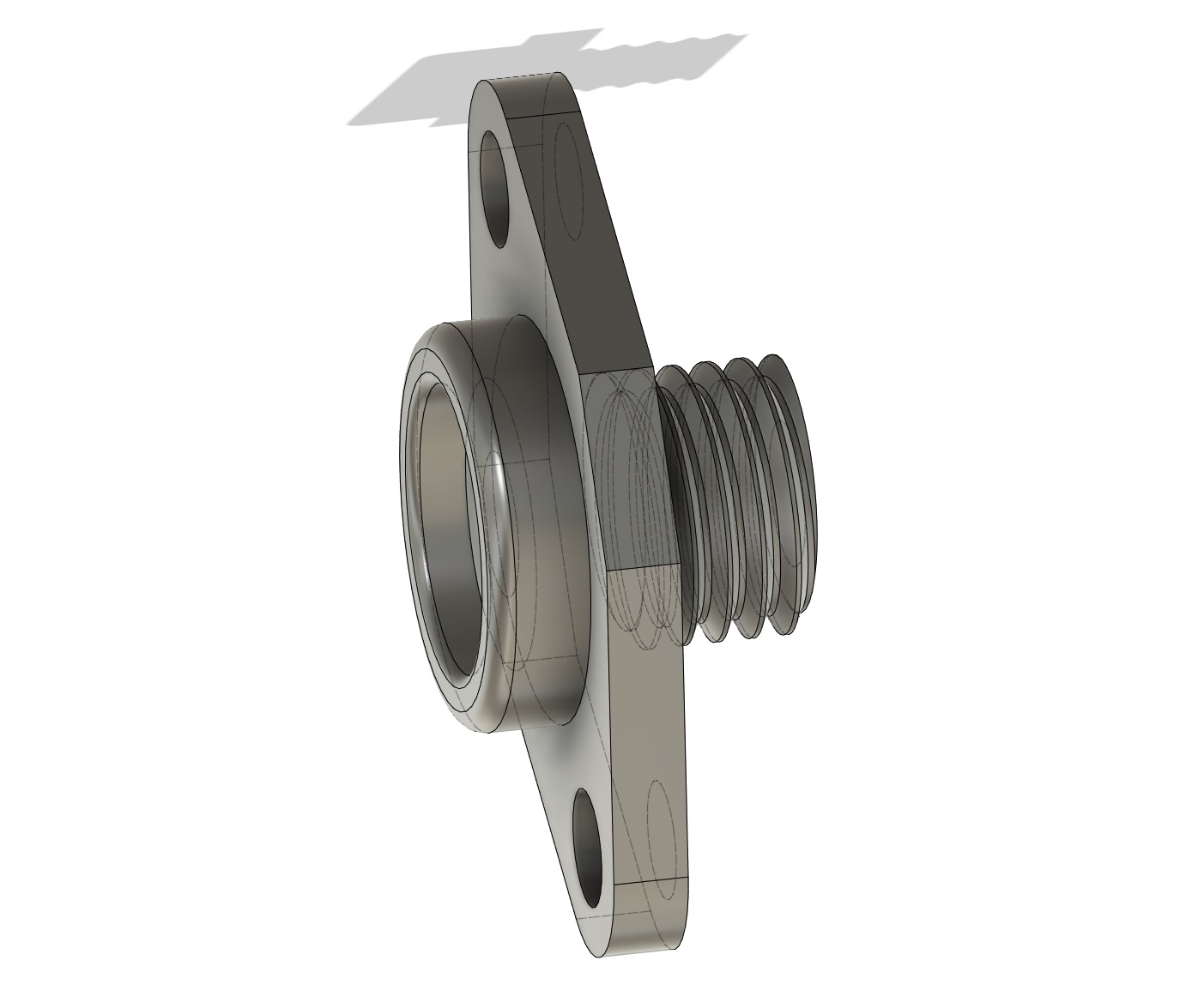

    Since its Friday i figured i would post a quick update...
    Only thing that had arrived was a the bag of knobs for the rotary switches. Other than that I finally tracked down an Arduino UNO and was able to burn a boot loader onto my Ender5 and installed the TH3D firmware and fine tuned it a tad, and now printing a few parts for a button box along with its paddle shifter parts and other accessories to go with it. the big MiGE is now stuck in US / Canadian Customs and i might not see it till Monday at this point. Today i spent the better part of the day playing around with Fusion360 and working towards finishing up the accelerator pedal position sensor housing resolved as by the time the master and slave cylinders arrive i can easily just mount, plumb and plug them in. Here's a quick peek...
    As can be observed this bushing will bolt onto the back my wilwood pedal set just like a master cylinder. There's a few more parts that go together to form an assembly but this is a teaser for now.. more to come as im slowly picking away at it along with covers for the OSW Power supply as well a beauty plate to cover up terminal block and act as a housing for the IEC connector. Right now the printer is working on the SimuCUBE motherboard enclosure I had posted earlier.

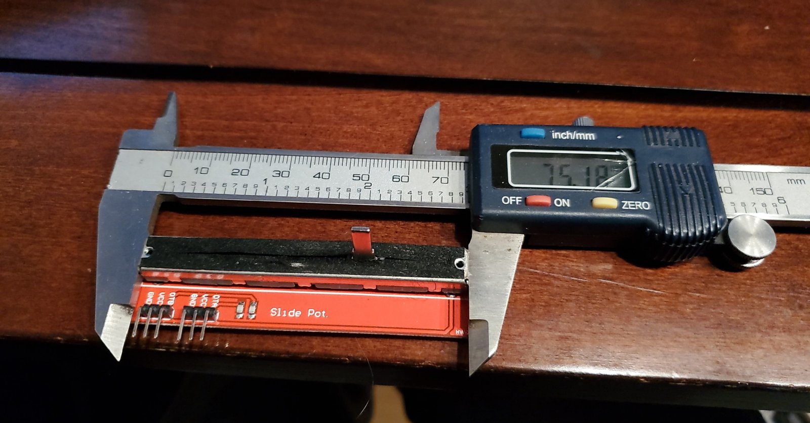

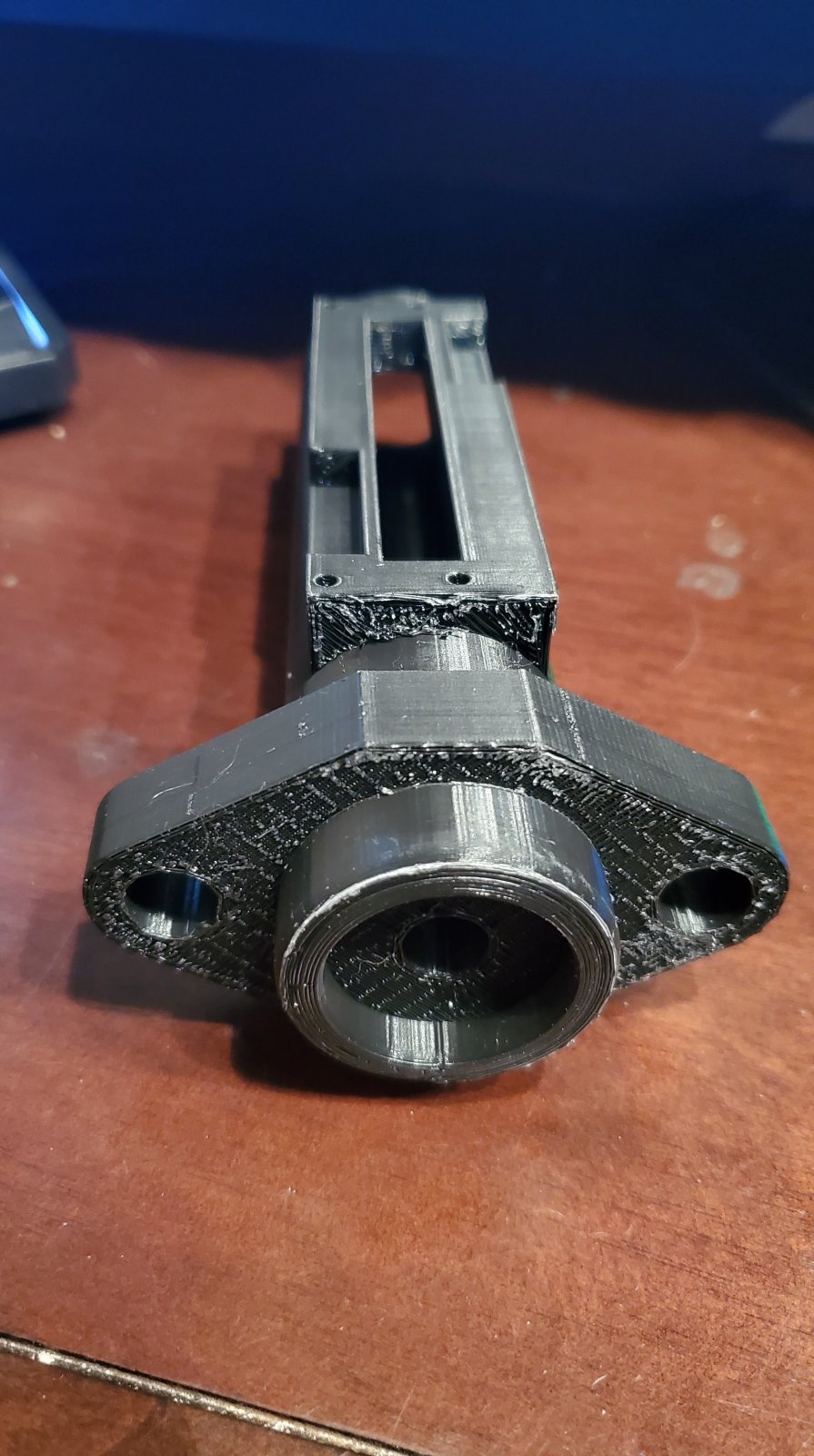

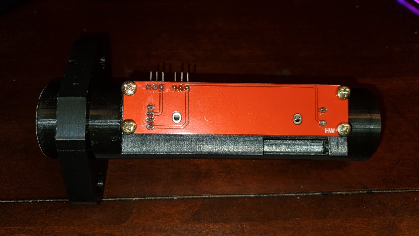

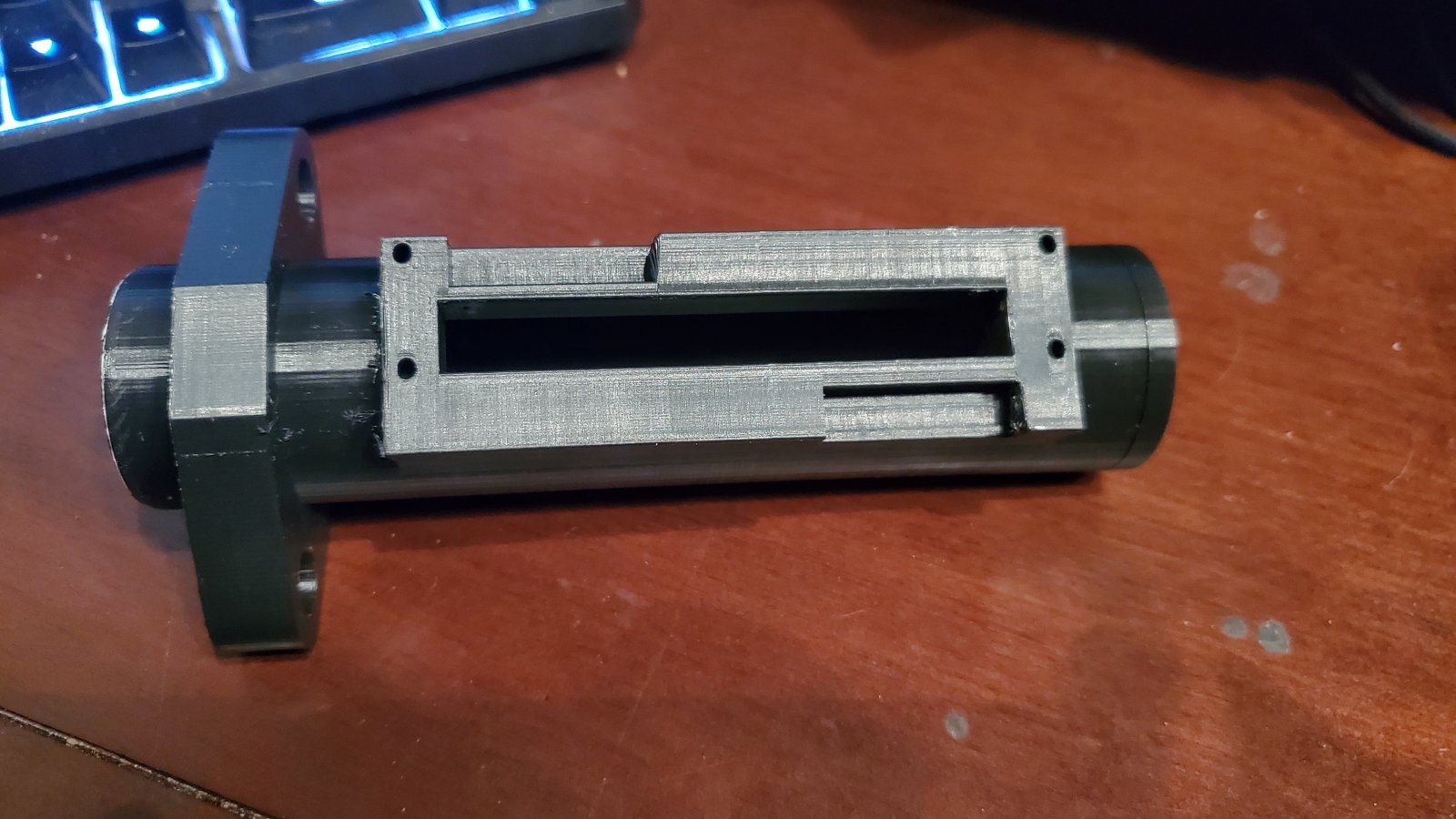

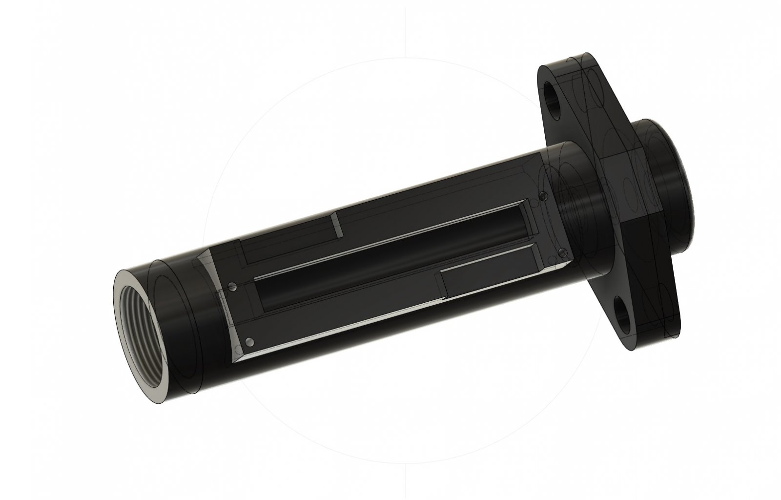

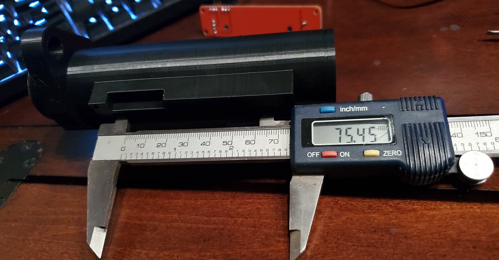

    Welp..

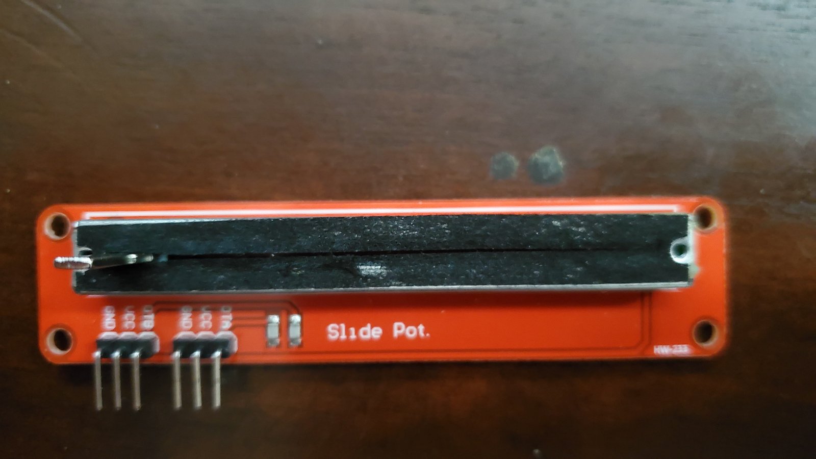

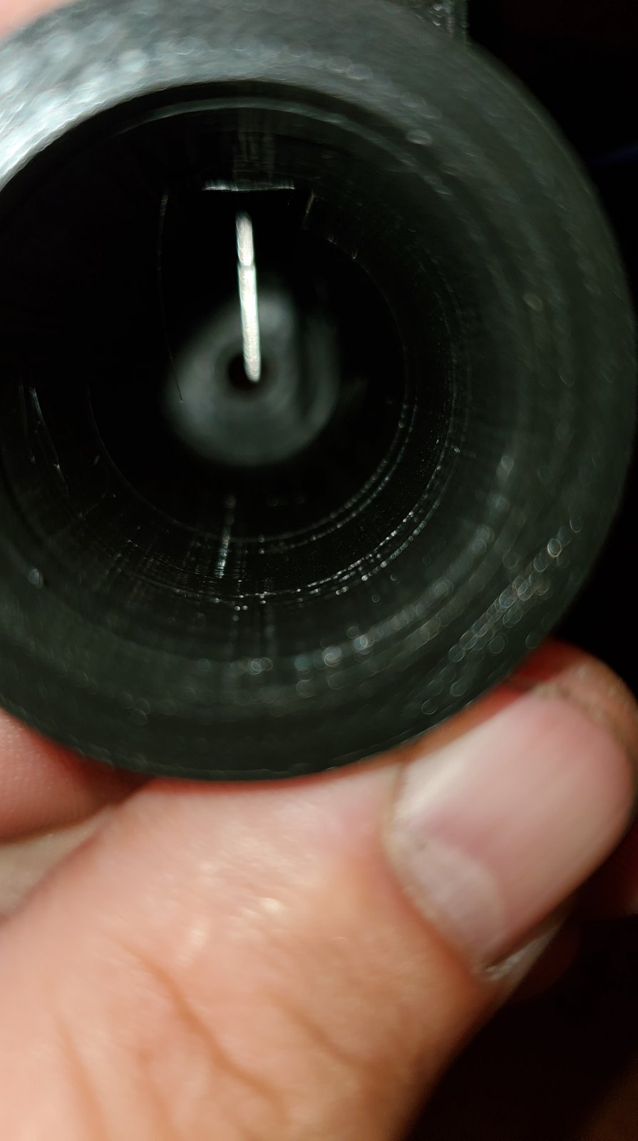

    A quick sneak peek at the main body
    Changed my mind mid design and decided to avid the headache of clocking the threads between the front cover and main body together and decided to make them as one.
    this way if you want change out the spring its as simple as removing the rear cap.
    The body will be 3D printed with PLA+, same with the piston, and there will be 2 shims also printed from TPU to act as a cushion and reduce "banging" when you go off the gas pedal suddenly and smash it to the floor again. The back cap will have a conical stopper the same way not only to stop the spring from being crushed but also act as a soft landing. When everything is printed and proven/tested, I will have it machined out of T6061 and have it powder coated black to match the Wilwood GS Master cylinders.

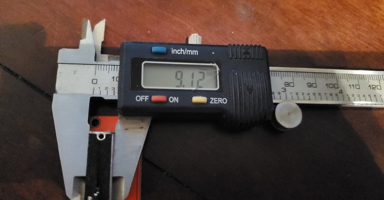

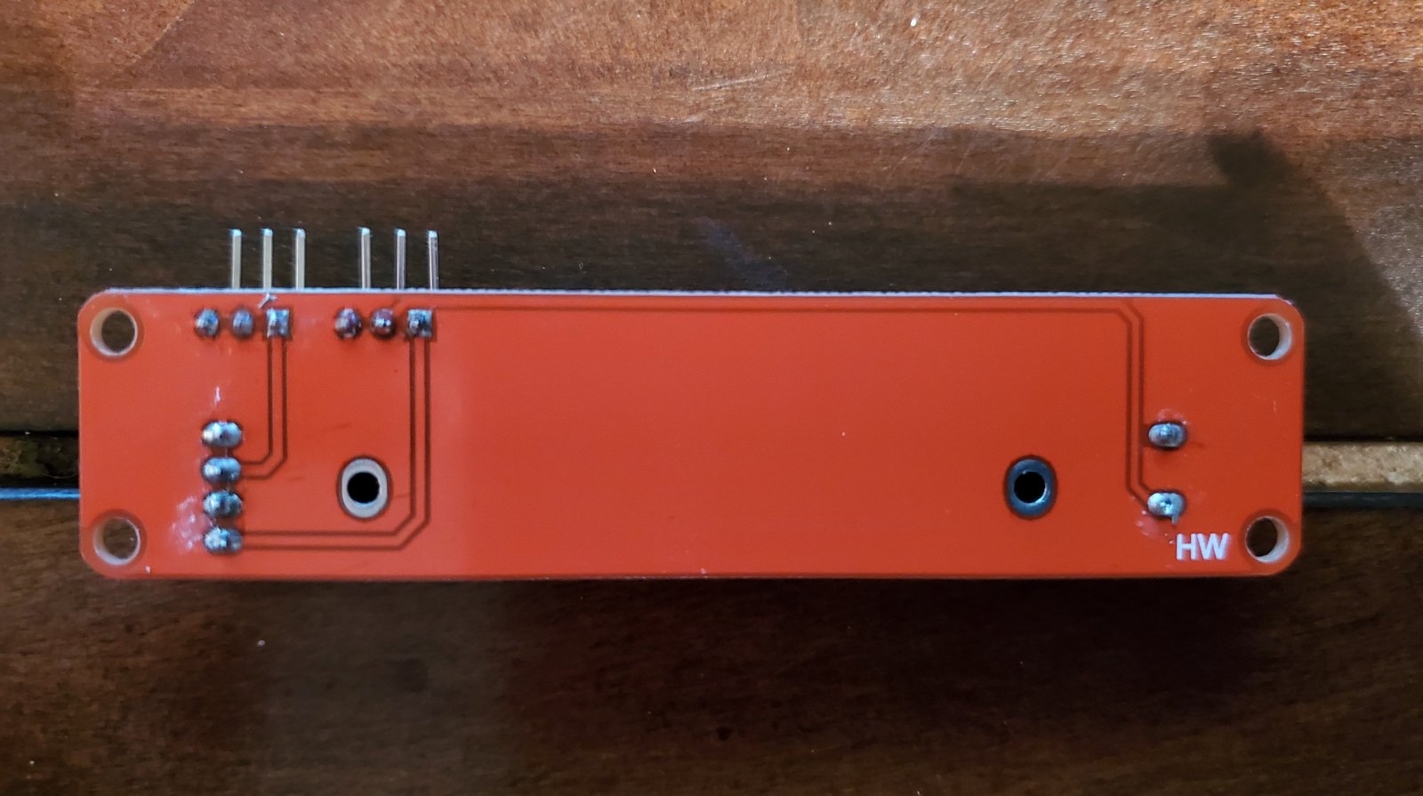

    By the way, this is the Linear Potentiometer i decided to use:

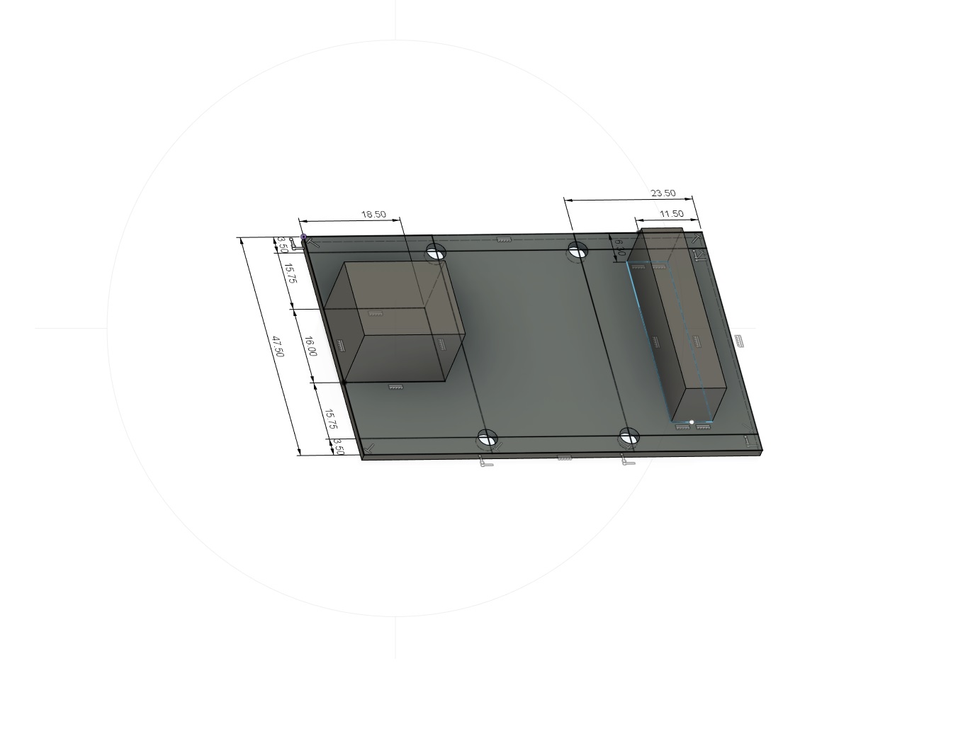

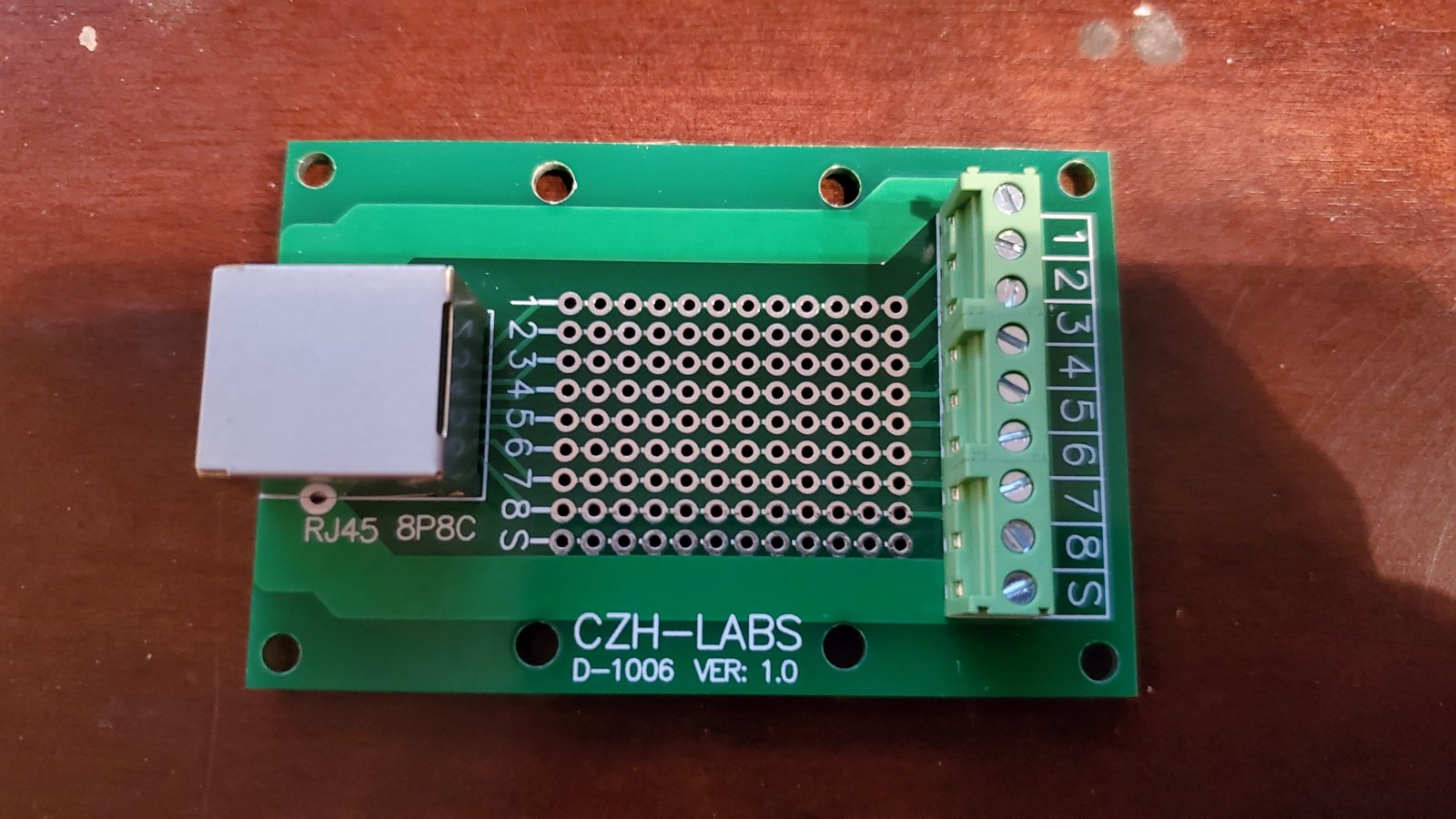

    Mid week update...

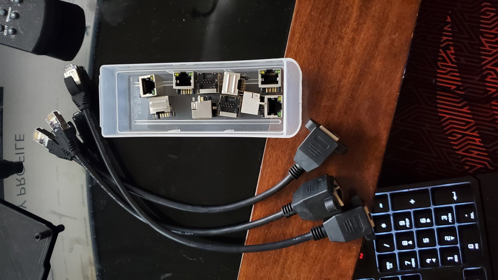

    The flow of packages has slowed down MiGE is stuck in US/Canadian Customs... lack of paperwork apparently. Other than that nothing much to report other than more CAD work.
    From 95948856_1147443408941516_2675752990341595136_n.jpg to RJ45 Breakout Board.jpg
    Now since the PCB has been modeled, I now can start making the enclosure for it.

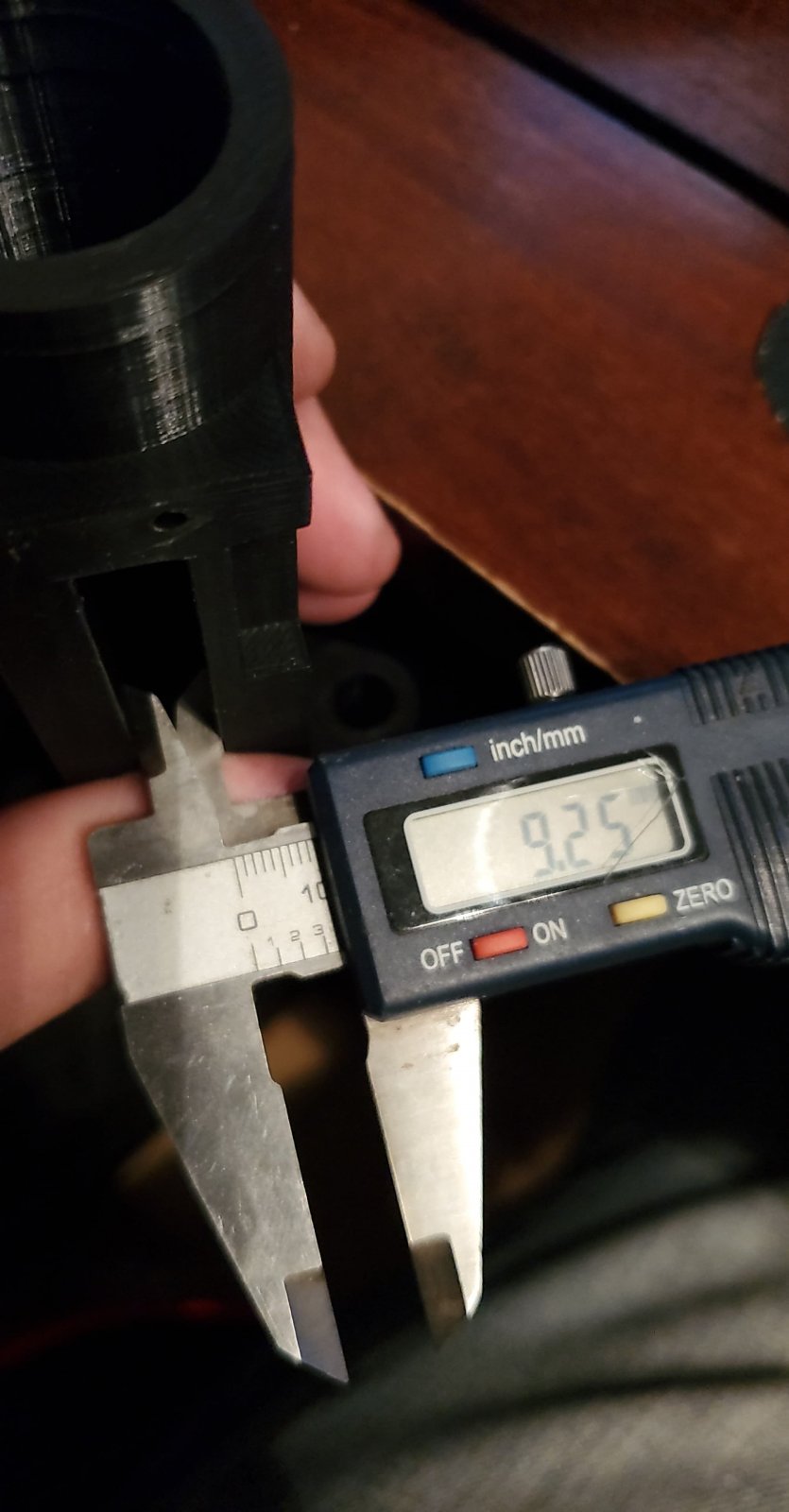

    Well... Week went by, back to work and nothing much to report on other than dialing in my Ender 5 and finally upgraded to Marlin 2.0.x and getting some pretty decent prints now! Seemed like the factory Creality firmware sucked at larger prints and had a large percentage of failed vs successful prints. that all changed once I build a custom version of Marlin for my setup... can be seen in the following pics :p
    97751970_936342193460882_3023039506115723264_n.jpg 96234942_274613320339284_7737975511841767424_n.jpg 96364637_2497483383915242_4037741352455241728_n.jpg 97356654_535113797167226_6328861531605827584_n.jpg 97998248_1415659135302787_1705566766333165568_n.jpg 96413836_594451914541957_5369067908683005952_n.jpg 96800617_232308808031449_8061242380063342592_n.jpg
    Now onto building the "piston" assembly and end cap which will house the spring.
    MiGE has cleared US customs and hoping to see it at my door step tomorrow.
    Will post more pics as the prints roll off the heated bed :thumbs
    But all in all looks like she fits :)

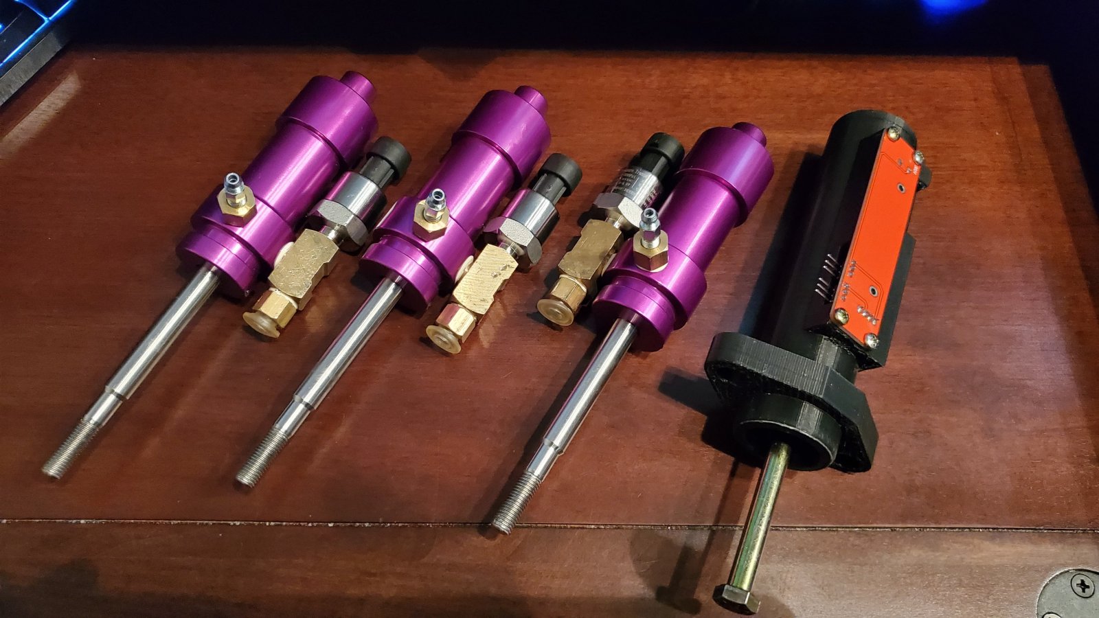

    Welp...

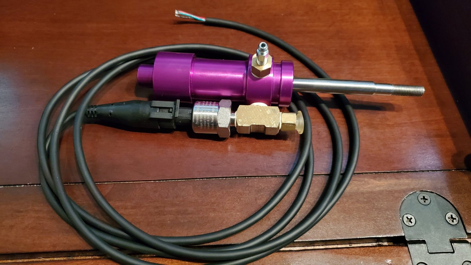

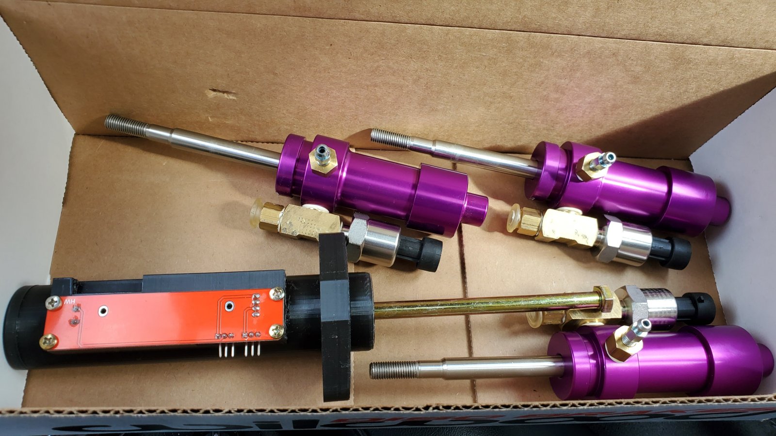

    Tee Fittings came in today at NAPA and put the slave cylinders along with the pressure sensors together today.
    96845212_244942773266647_8205763575692656640_n.jpg 97466057_859637984448847_4019456611524280320_n.jpg 96520194_927012231084284_6647507135275991040_n.jpg
    E-Brake still hasn't showed up but i did order the 1/8NPT to AN3 fitting for the slave cylinder as well as an assortment of die springs and a few different durometer skateboard bushings from soft to hard, which in the we will call the "tuning kit".
    Placed my order with the Metal Supermarket today for some 6" x 18" x 1/2" and 2" x 18" x 1/2" 6061 T6 plate aluminium.
    Just realized my E-brake unit i ordered comes with a master cylinder :D

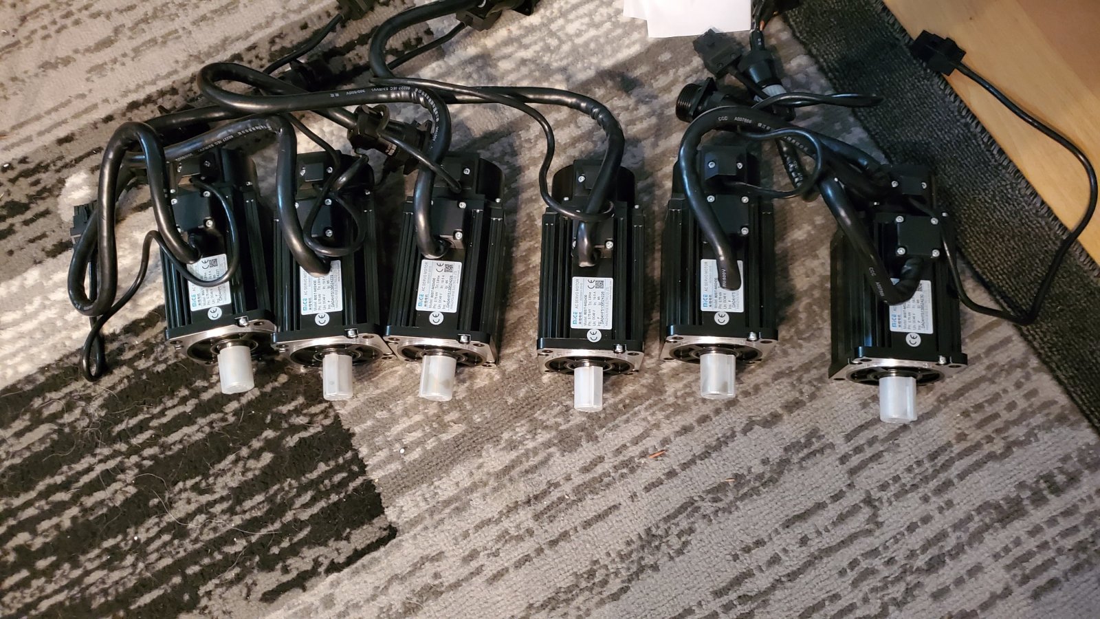

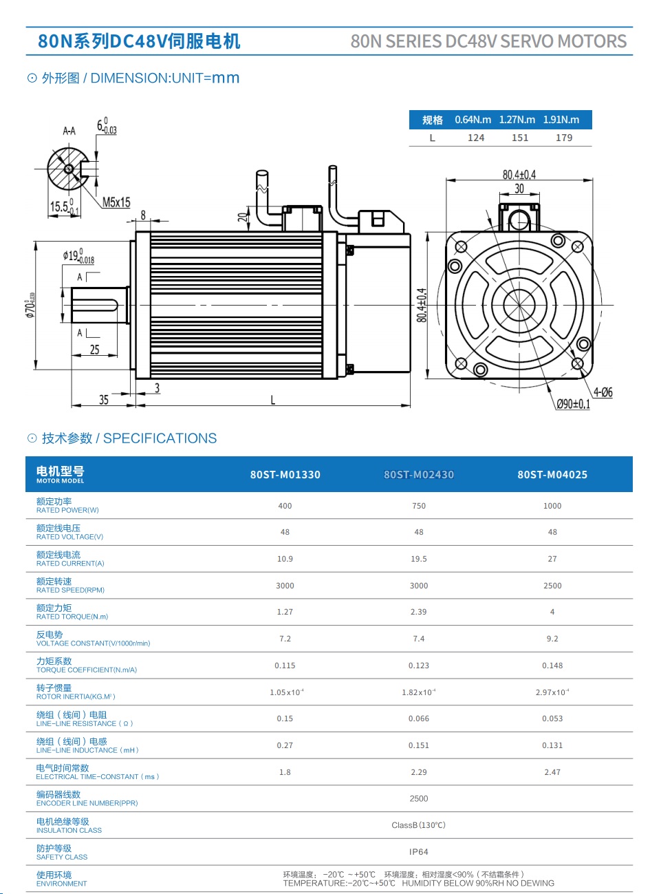

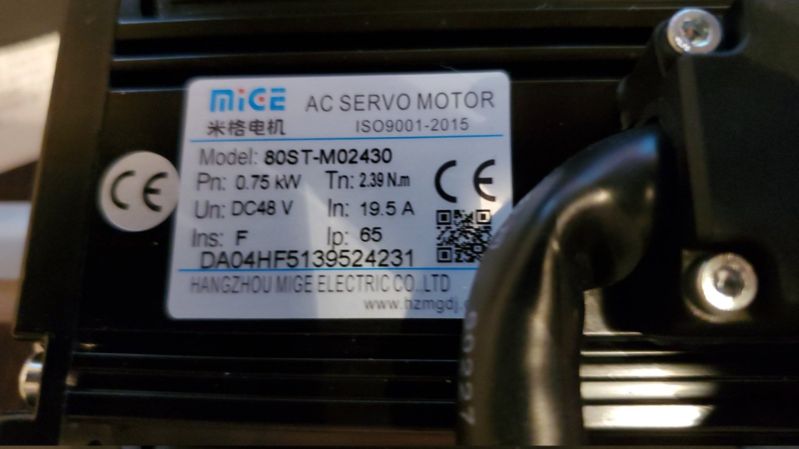

    Decided to have a peek at the catalog that MiGE sent me when I got my Big MiGE in. I did not see any DC offerings so i shot a quick message to Lisa over at MiGE early this week. After a few messages were exchanged, I ended up pulling the trigger and ordering 6x MiGE 80ST-M02430 in a Permanent Magnet without Brake configured for 48VDC. Nice part is that they already come with a 2500PPR Incremental encoder which is the better option when pairing with ODrive boards.
    Specs are as follows :
    Size : 80.4 mm x 80.4 mm x 151 mm ( 3.165" x 3.165" x 5.944 " )
    Shaft : 19mm
    Shaft Keyway : 5mm x 25m
    Weight : 2.9 Kg
    Rated Power : 0.75KW
    Rated Voltage : 48VDC
    Rated Speed : 3000 RPM
    Rated Torque : 2.39 NM
    Peak Torque : 7.1 NM
    Encoder Type : Incremental 2500PPR
    Insulation Class: Class F
    Safety Class : IP65
    Termination : Shielded Cables - 3.0M - No Connectors
    Leaving this here as note for future use to make life easy when wiring it up ;)

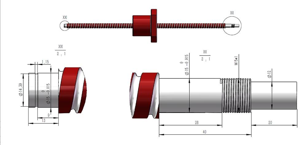

    Well.. got an email last night that my ball screws have been shipped Friday and upon inspecting the receipt i realized they have sent me 2005's instead of 1605's, guess chalk this up win of the week :)

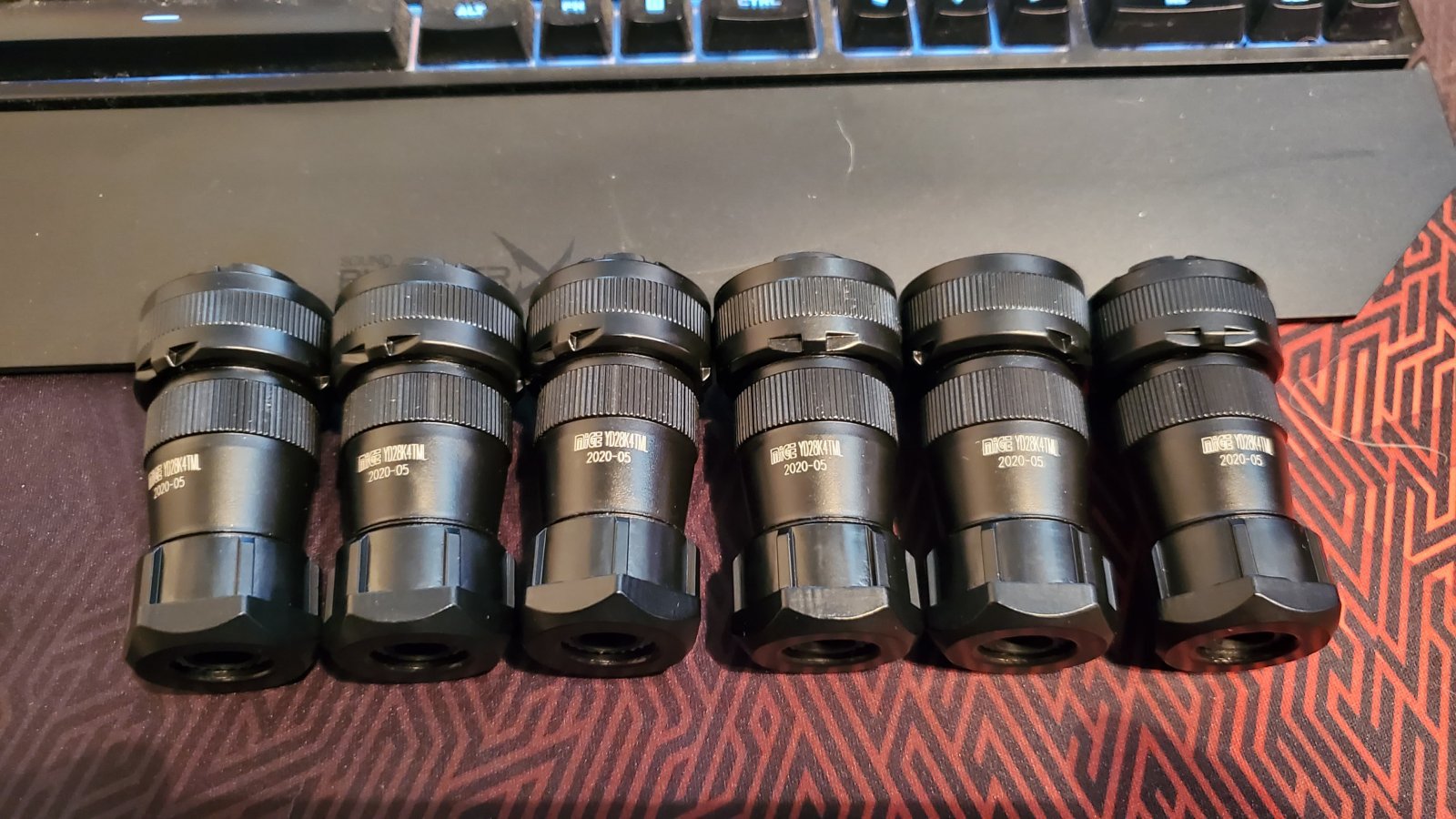

    Well.. this never happened to me where a package showed up 4 DAYS FASTER than the estimated time !!
    Holy batman DHL !!
    Shipment was picked up at 1507 on Tuesday, June 30 in ZHEJIANG PROVINCE - CHINA MAINLAND and was dropped onto my doorstep today at 1413 !!
    Yes.. it was a tad north of the $450 mark with insurance and customs for 2 boxes weighing in a total of 21.5 Kg ( 48lbs ) but well worth it.
    Here's a few pictures :)
    106128323_602593854019487_9024375999049564208_n.jpg 79092920_703217297138133_8731799335644510100_n.jpg
    And a few extras they have included:
    107035067_1706790149504274_8813977531573694010_n.jpg 106069819_959103551196503_8875841367451723914_n.jpg
    I may change out the encoder plug for a DB15 or DB25 connector... but we shall ponder on that later on.
    first things first though!!
    That panel mount connector will be swapped over to the other end as they are retained by a small clip and will swap the housings so the motor side is male x male and the panel mount is female x female. This will make life easy when designing the Power Packs ( 1x oDrive V3.6 + 1 1000W 48V Power Supply ). This will it easy when setting 3 of these things up :)

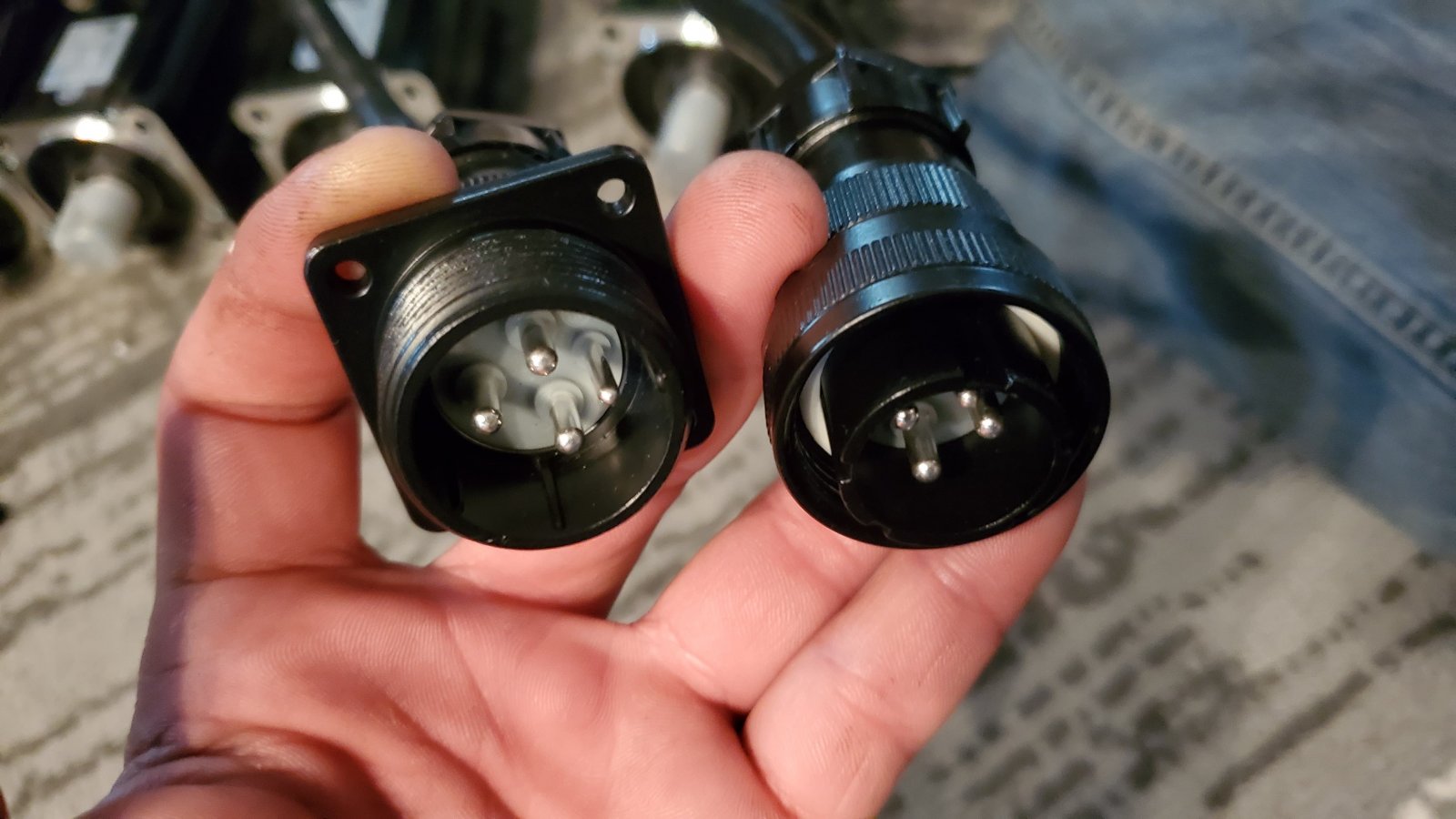

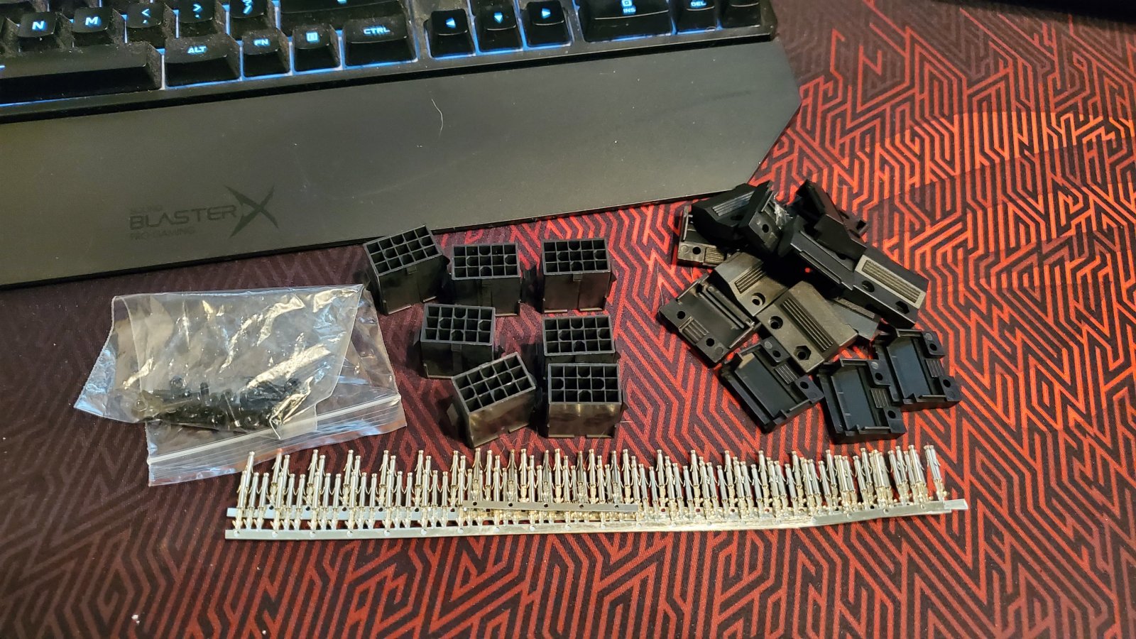

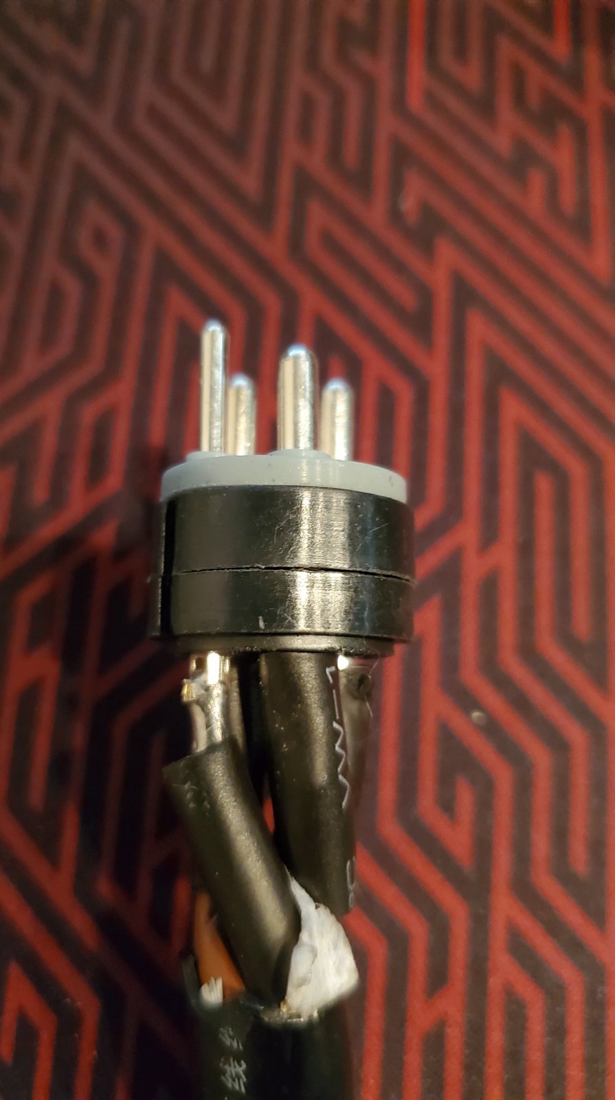

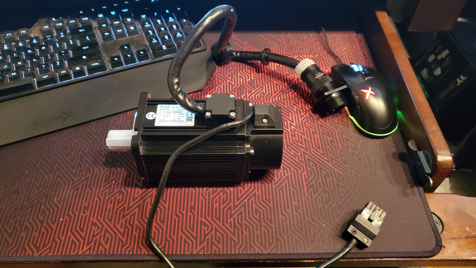

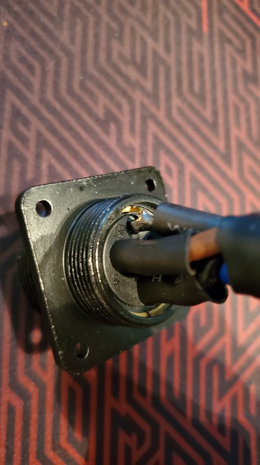

    Well, lets get to work...
    Connectors were fairly simple to work with if you have a bit of mechanical background...
    106368870_407019650199744_2601485031745281283_n.jpg clip the retaining clip and remove, set nut shell aside...
    105482688_740879266685906_7219213376669435978_n.jpg Slide back protective cover and repeat on motor side to "recover" panel mount shell..
    106244173_312483320154032_5289586096490513368_n.jpg try not to disturb the 2 half's as pins are keyed and they only go in 1 way
    push pin into new nut housing, reinstall lock ring and solder back in place, slide protective cover back on. Make sure lock is fully seated before soldering! at the end of it all you should have something like this...
    Factory on left, right side is my "fix", now can use the panel mount plug at power pack where it belongs.
    All power connectors have been successfully swapped and panel mounts have been set aside for the power packs :)
    Here's a better pic of the label on Servo
