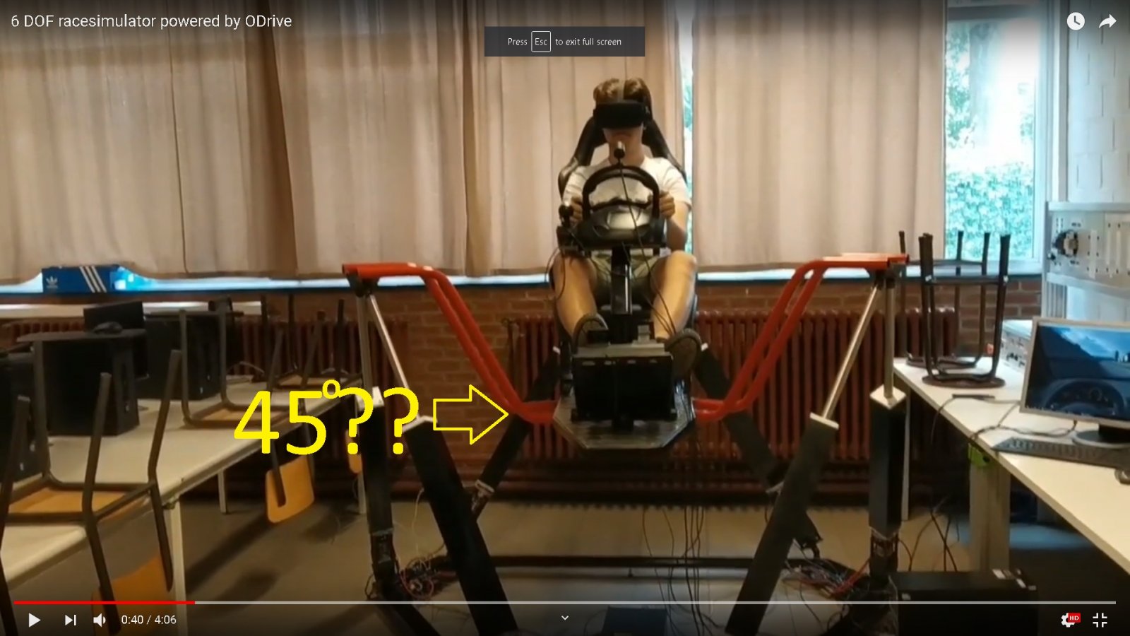

    i have one question.. what is the angle that you make the chair frame?

    The tubes are bend 120°, first I wanted to do the same angle as my chair (±100°) but I knew that the more you bend the tube the worst the bend looks so I dicided to do it 120° because this also caused the bend to be close to the frame which looks kinda cool.

    nice! i liked the way your sunken frame looks.
    what kind of tube material did you use?

    Hi, the 'sunken' frame is because its now rotating around it's center of gravity so the motors are being less stressed. I used steel tubes ±∅35mm and a wall thinckness of ±3mm.
