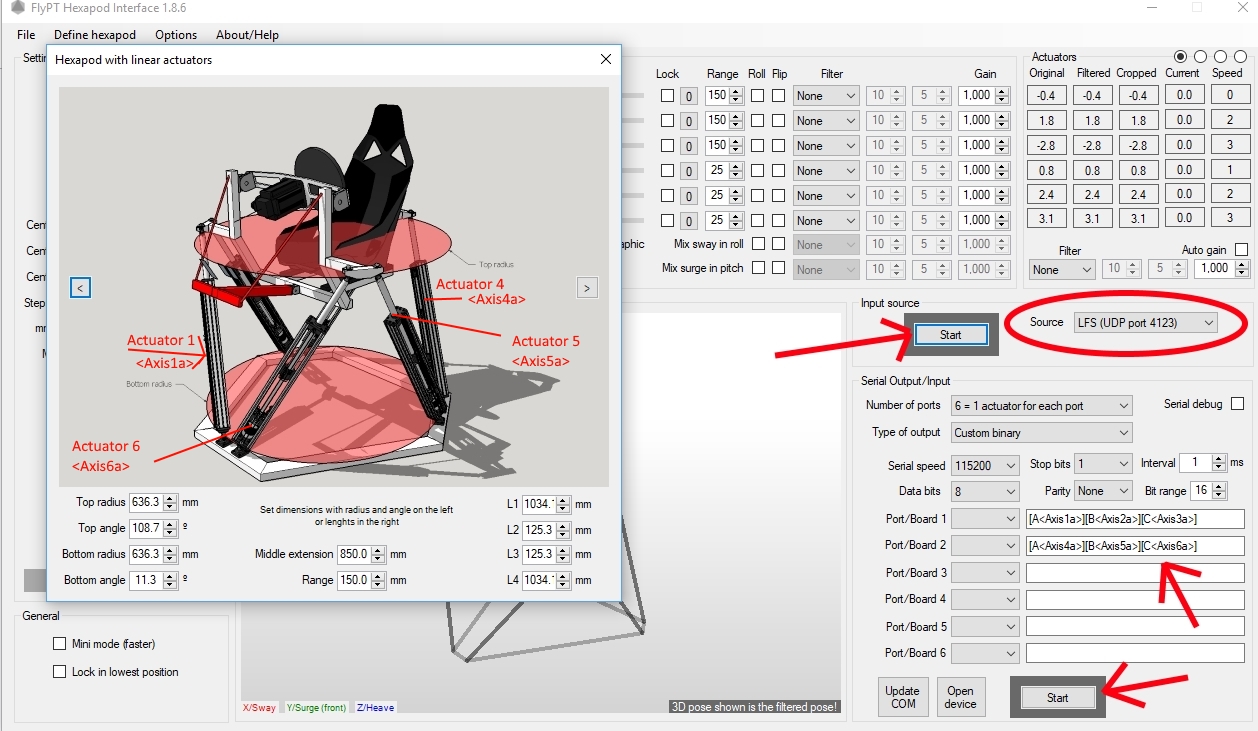

    Hi guys, it's me again, Ive almost finished my build now, but I'm a bit stuck on the software. Maybe you can help? How do I know what axis is what axis in real life in FlyPT? What happens when 1 axis starts moving randomly, What do we have to do ther

    Yes but how do I know in the hardware what actuator is what axis? In FlyPT the image doe'snt show what the first and send one and so on is.
    Cheers

    Actuator 1 is the first one on the front right and they increase in the clock direction.
    Last one, number 6, is the first in the front left of the rig.
    So <Axis1a> is actuator 1 and so on...
    Just send that data to the correct actuator port with the correct config.
    In the last version, you don't need simtools to test LFS.
    Just select LFS in the direct input.
    For LFS to send data, first make some laps in LFS.
    It generates a cfg.txt file inside LFS instalation folder.
    You have to edit to output the telemetry.
    Open in notepad and search for outsim.
    Replace values with:
    Code:
    OutSim Mode 2
    OutSim Delay 1
    OutSim IP 127.0.0.1
    OutSim Port 4123
    OutSim ID 1
    OutGauge Mode 2
    OutGauge Delay 1
    OutGauge IP 127.0.0.1
    OutGauge Port 4124
    OutGauge ID 1
    Now run LFS again and try to connect with The FlyPT Interface directly.
    Need any help just call me with @pmvcda

    I have a few questions:
    1) The position command that I send with simtools are from the form: "p 0 <Axis1a><13>". Can I also do this with your program?
    2) When my actuators are in the minimum position I want the position to be zero instead of being in the middle position when being zero, is this possible?
    3) I'm not getting data from LFS, what could be the case?
    Cheers
    Carelsbergh Stijn
  19. pmvcda
    pmvcda aka FlyPT
    Nov 3, 2010
    2,180
    Portugal
    15,394Coins
    +2,601 / 17 / -0
    1) Yes
    2) No, sorry
    3) Did you make a complete lap before changing the cfg file? Also try to disable the firewall.
    Sorry, fast response in a phone...
  20. pmvcda
    pmvcda aka FlyPT
    Nov 3, 2010
    2,180
    Portugal
    15,394Coins
    +2,601 / 17 / -0
    For number 2) , the interface sends to the rig a value between 0 and the number of bits selected.
    So middle is half the value, while lowest position is zero.
    What we see in the interface is different. Middle is shown as zero, but not zero in the bit output...
    bit confusing...
