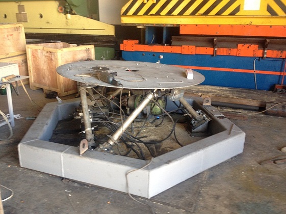

    Нello friends !!!
    Finally I made a 6-DOF motion base (proportional hydraulic) ;)

    - Probably worth paying attention to an interesting technical approach, the base platform is 3 in 1;
    1) the basis for sustainability
    2) So as it serves as a container for hydraulics
    3) due to the large area is a cooler for oil
    - At this stage are scratching their heads over the design of the cabin, but could not wait to drive the simulator just screwed desk and chair to the platform))) sensations of 6-DOF indelible compared with 3-DOF, after 10 minutes of riding and shaking hands adrenaline gushing :thumbs
    P.S. if you have any questions - feel free to contact me, I'll help to the best of my technical skills :cheers

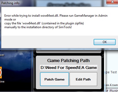

  5. Ashraf
    Ashraf Member
    Nov 8, 2013
    66
    1,034Coins
    +65 / 0 / -0
    3DOF, Arduino, Motion platform, 6DOF
    does not work !
    I tried all the options ... including
    1) run as administrator
    2) reinstalled SimTools - Beta v3.2
    NFSSeries_Plugin - folder don't have the file named:
    wow64ext.dll
    MFS-X plugin gives a different message on the second picture
    PC specification:
    Intel i5-4460 CPU@3.20GHz 3.20GHz
    RAM 6.00GB
    OS. Windows-7 ultimate 32-bit
    antivirus: Kaspersky PURE 3.0

  7. value1
    Jan 9, 2011
    2,184
    Zug, Switzerland
    14,462Coins
    +3,318 / 11 / -1

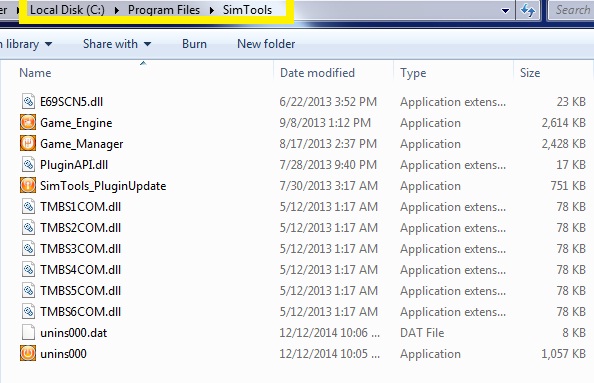

    For patching, please run GameManager in Administrator mode.
    Unpatch the games and repatch them. Check in C:\Programs\Simtools if there is a file wow64ext.dll and/or GameManager.exe.config.

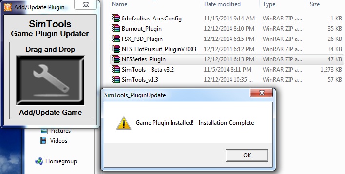

  8. Ashraf
    Ashraf Member
    Nov 8, 2013
    66
    1,034Coins
    +65 / 0 / -0
    thnx-100x, hard work ;)
    plz. check the attached file....

    Yes. So now you must start GameManager in Administrator mode and patch both games (NFS and FSX)
  10. Ashraf
    Ashraf Member
    Nov 8, 2013
    66
    1,034Coins
    +65 / 0 / -0
    get the same message that I posted above.......
    wow64ext.dll

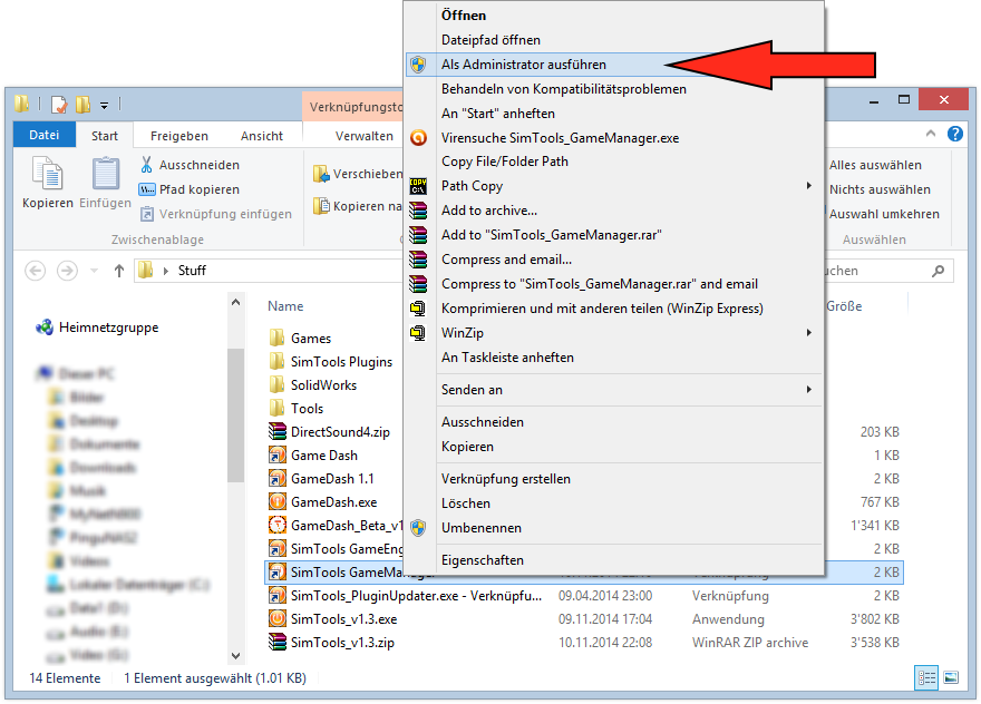

    Why are you using SimTools - Beta v3.2 anyway? The current version is V1.3
    So just for my understanding:
    1) You start GameManager by right-clicking on the GameManager icon and select Run as Administrator
    2) You open GameManager from the system tray and click on Patching.
    3) You patch the game and receive the error message
    Error.png ?
    Please confirm.

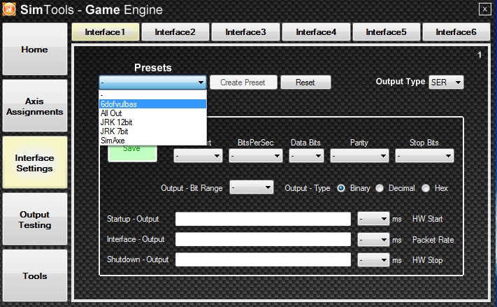

  20. Ashraf
    Ashraf Member
    Nov 8, 2013
    66
    1,034Coins
    +65 / 0 / -0
    Thank you all for participating in my project (a special thanks bsft for coins ;))
    - I downloaded Sim-Tools 1.3 version, all load at once and without any problems,
    the only thing now that can not upload 6-DOF preset
    - In particular, not loaded interface settings,
    I would appreciate if you can help tell how to set settings manually
