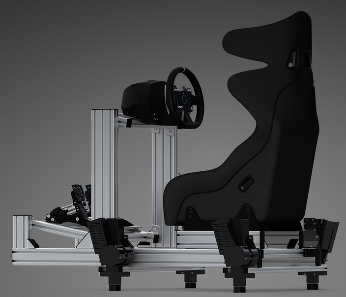

    I have already started my 4dof project using a 12 or 24V DC motor.
    I will use the engine specified below and would like help in choosing which would be the best option to control these engines and which power supply would suit the 4 engines.
    Is it possible with simtools to work 4dof? which controller card is recommended?
    Thanks.
