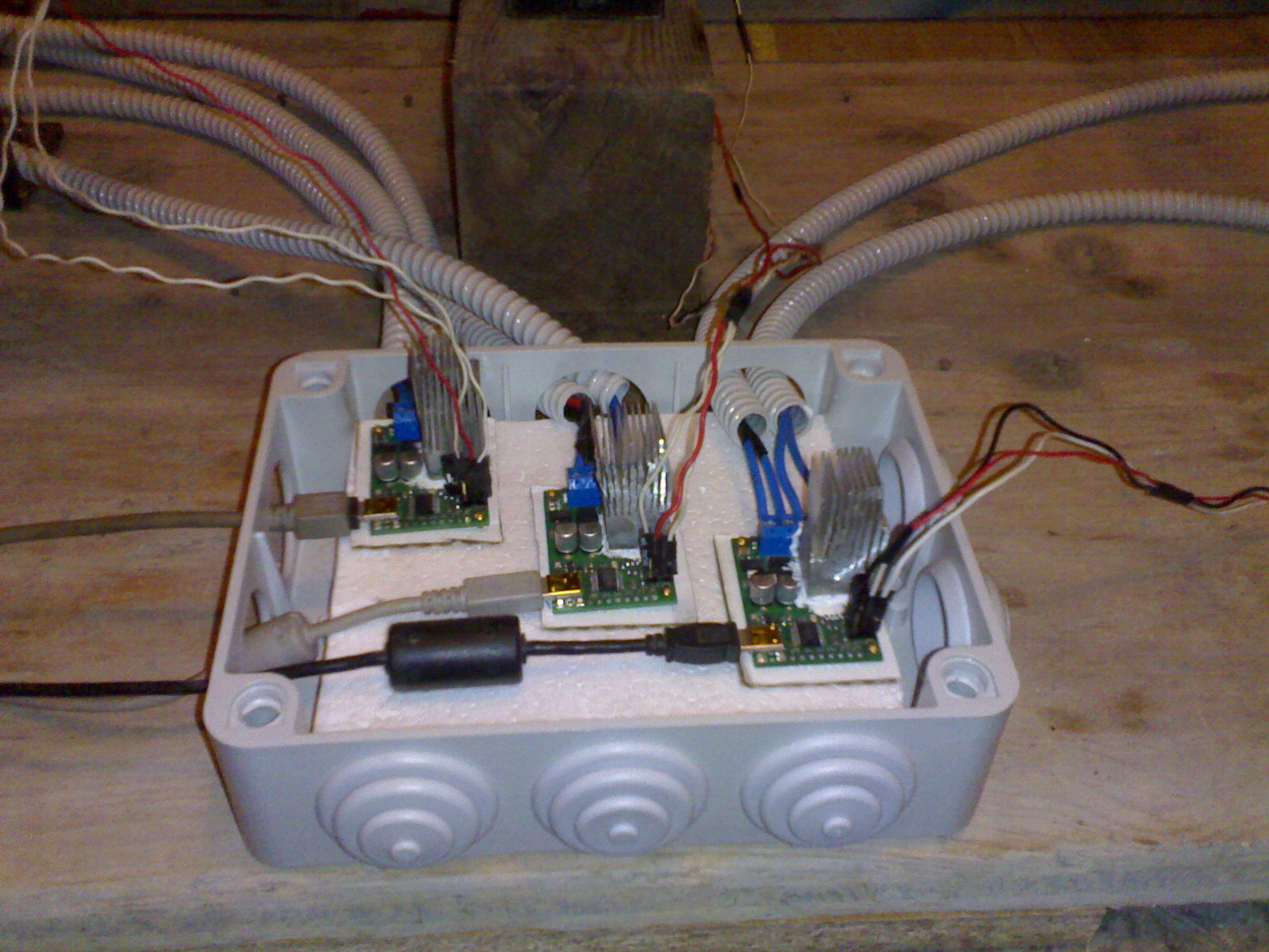

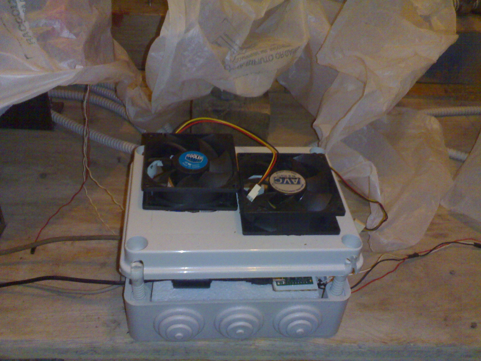

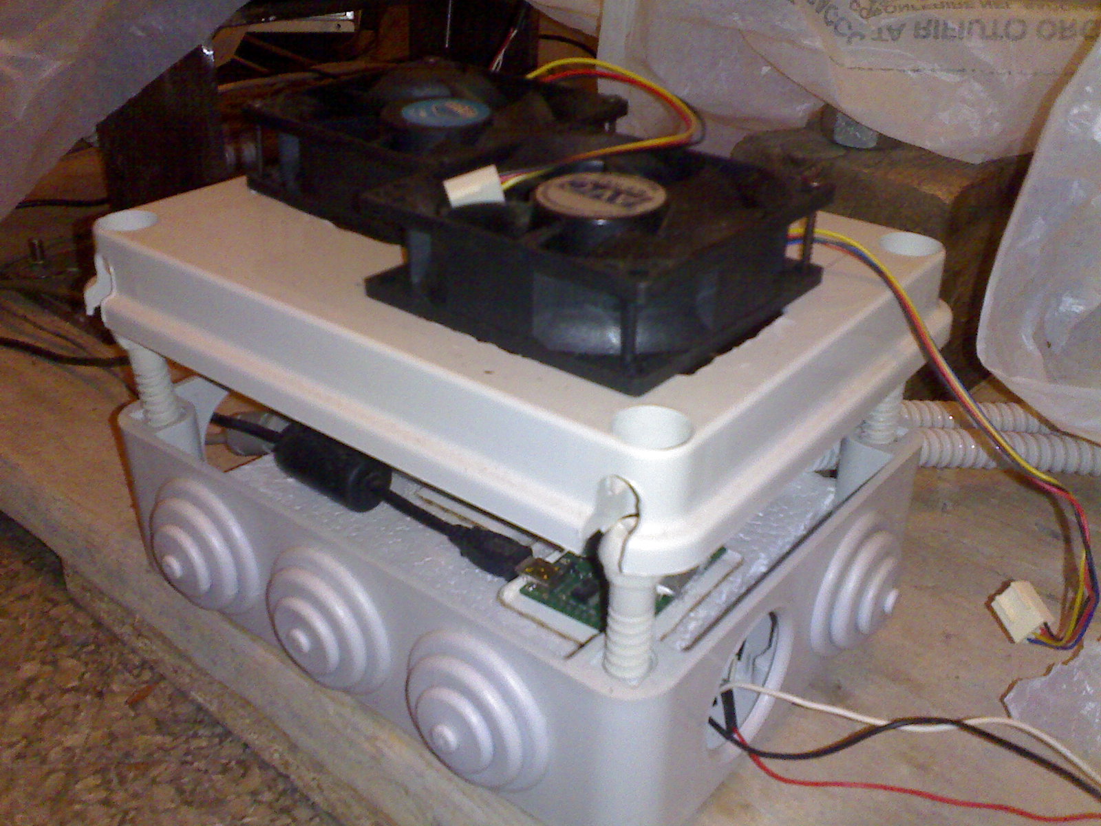

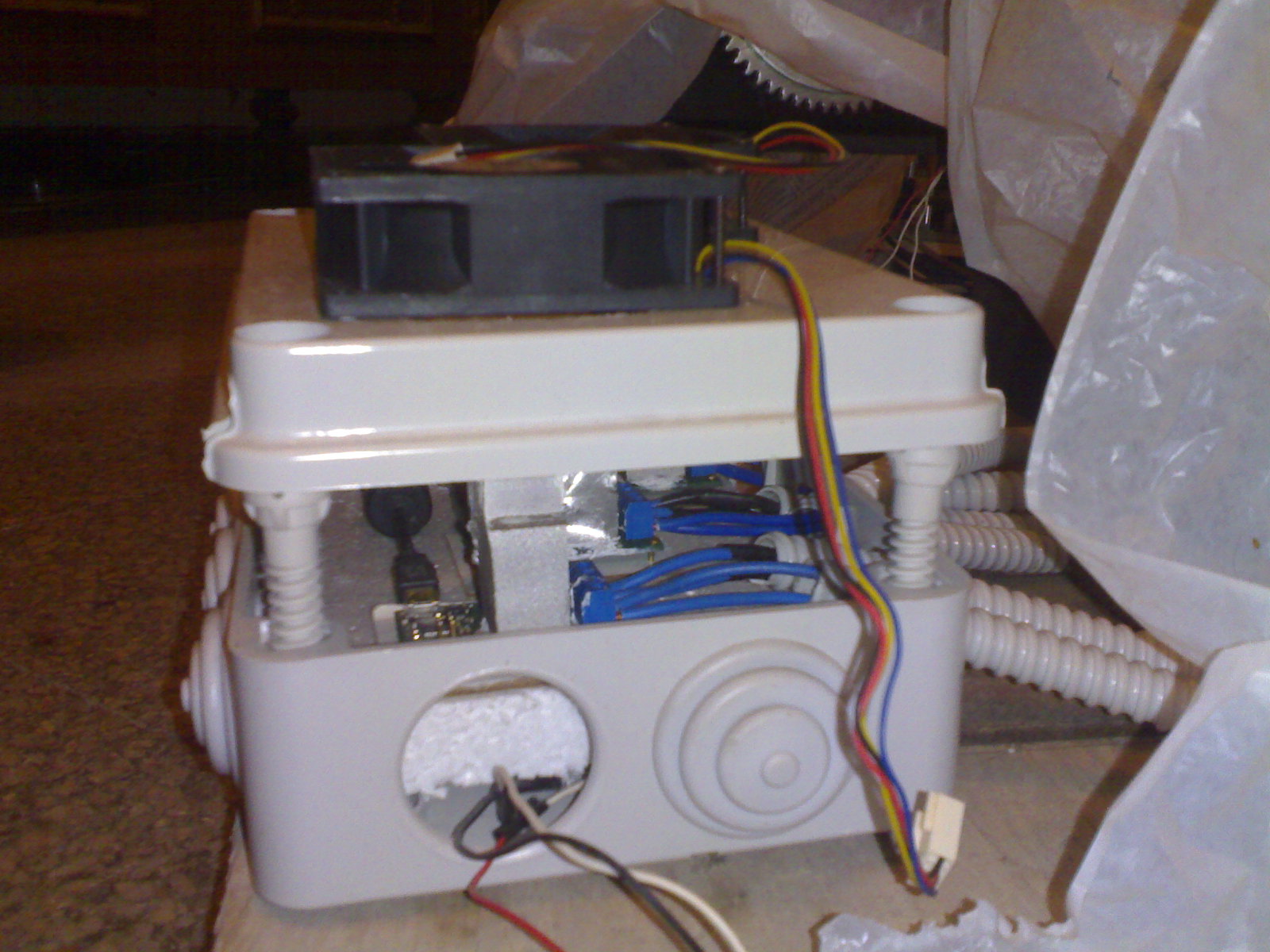

    How big is your exhaust hole? It should be bigger than the fan sweep area for efficient airflow.
  2. bsft
    True, not quite as big as the fan, forgot about that, will hack it tomorrow.

    Hopefully that will improve the cooling. These axial fans are not suited for installations with any back pressure.

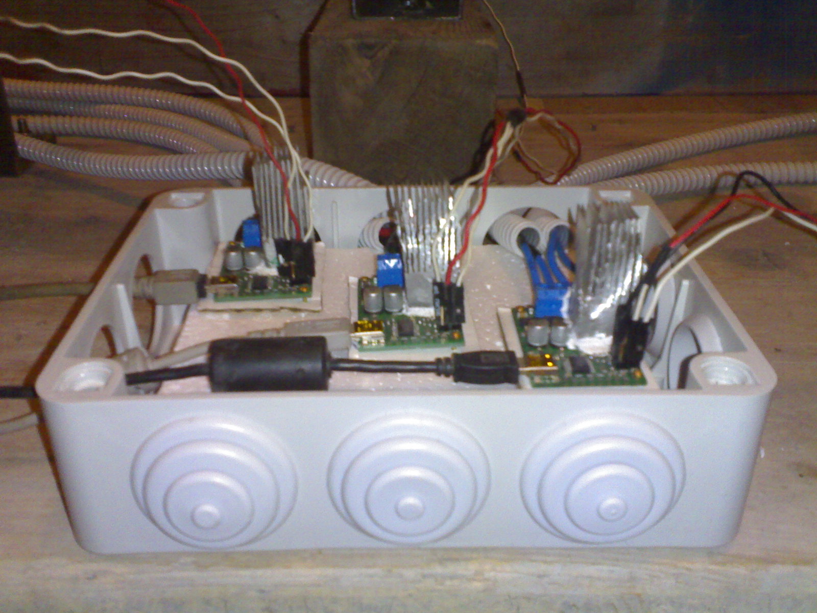

    Hi bsft ,tahustvedt, stowaway and all guys!
    bsft thx for the answer about amps, I think I will go to set my jrks from actual 22.5 to 25 amps. I have my jrks all with aluminium heatsinks and 2 fans on the top of my jrk box so, following your words, I feel comfortable about 25 amps.
    The exhaust hole is the the lateral space that make my box in 2 parts, should be enough for a good air ventilation.
    Here the pics:

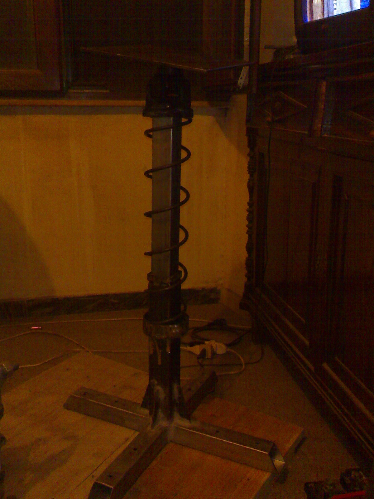

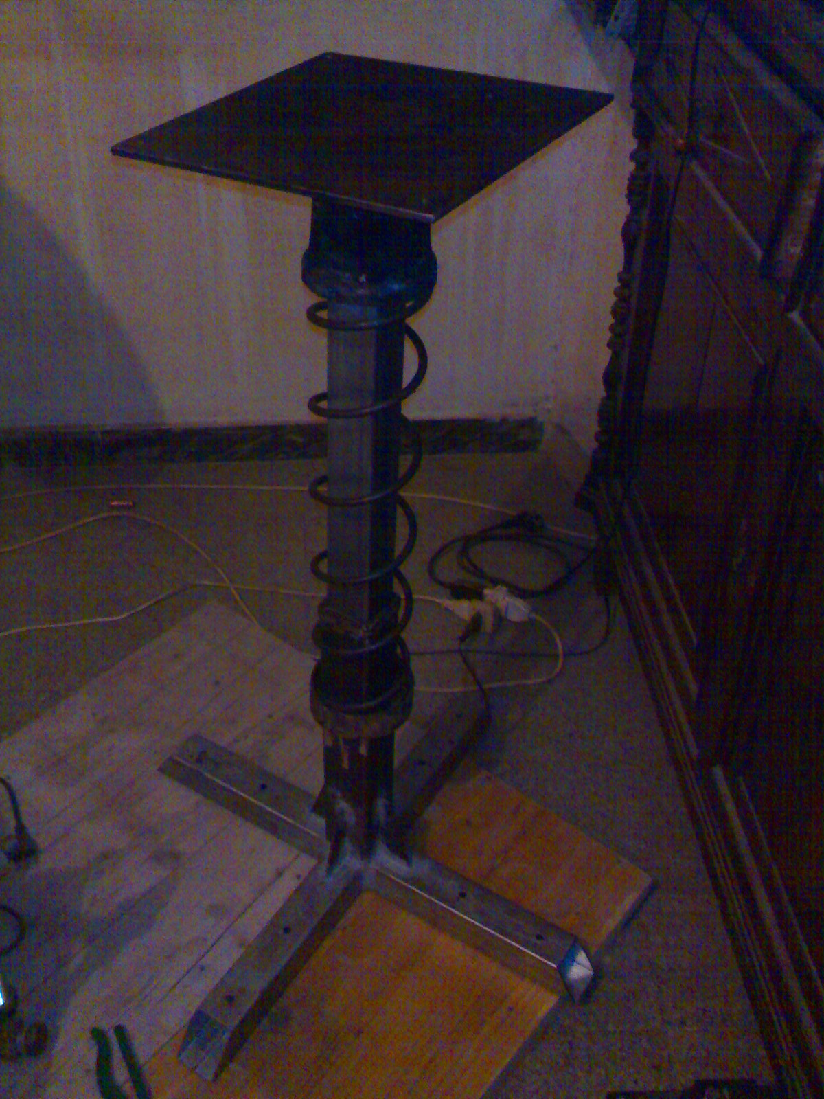

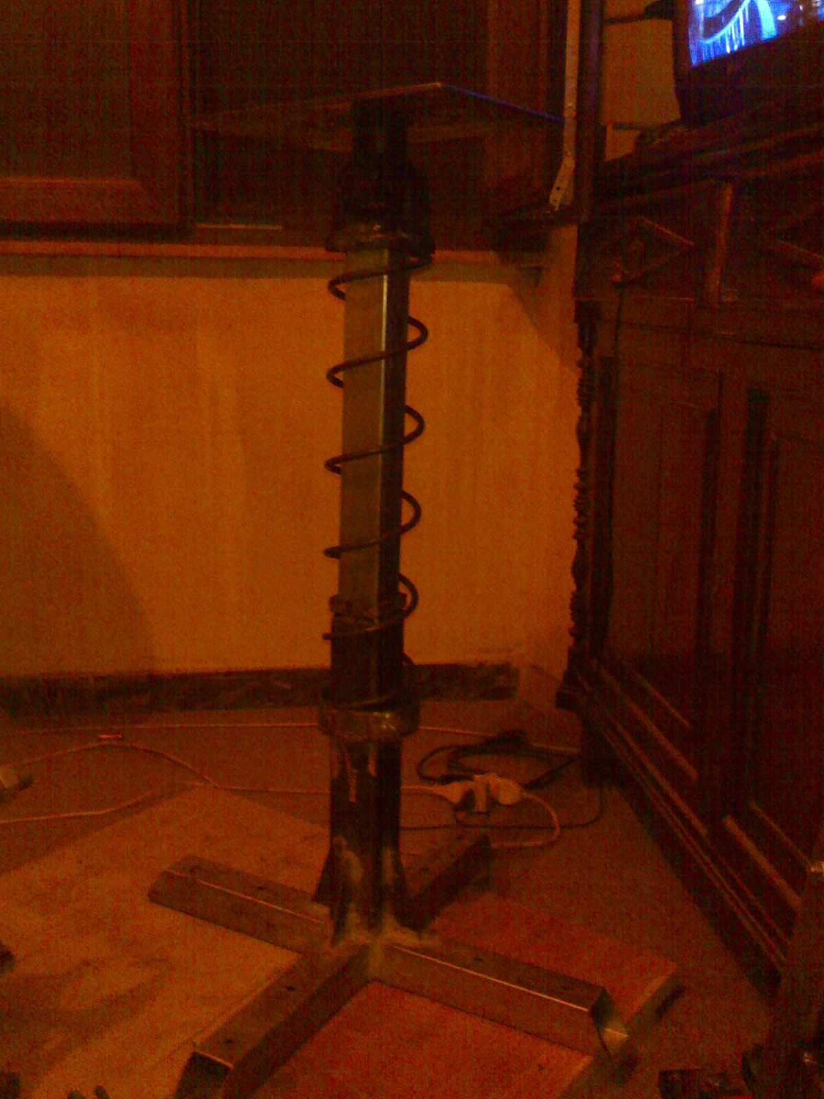

    And today I get my new cylinder-piston-spring!!! 2 days of hard work of my team mate! and a big THX for him for having followed perfectly my project design! This object is really born from a lot of calculations and I am really really happy about!!!
    Price = 196 € for the custom spring and 20€ for the steel. My team mate made a lot of work for build it and lucky I have him because I would have built the same thing in at least one month.. :eek:
    I am really proud about this object because for the first time in my life I can feel what a lot of calculations and work can do.
    I hope that all this theory turn into big results :thbup:
    35 cm of maximum vertical travel available, all with no possibility of danger or mechanical stress and/or problems!
    here the pics of the new cylinder-piston-spring!
    I hope to remount all soon, I think next monday I will have all ready for the DAMN FEAR TEST!! :happy:

  6. stowaway
    stowaway New Member
    Mar 16, 2009
    213
    Gold Coast - Australia
    1Coins
    looks awesome! you have a square piston now?
    have you put your motors in box's yet? just wondering if it helps with sound?

    @ tahustvedt:
    Thx mate I hope too.. I am a bit nervous waiting the test 'cause I done a lot of modification and a lot of thing have to work correctly... :gl:
    @ stowaway:
    Thx to you too stowaway! yes I am using squared cylinder/piston but before was squared too. The main differences are about the travel, from 7cm of vertical travel with a lot of effort and mechanical stress to 35cm of travel with no mechanical or motor issue now! unfortunately I not again done the boxes in where I will put my winches.. there was a lot of most important work but If all will go fine so these boxes will be the next things to do!
    Today I have to put correctly the mechanical grease in the cylinder, this may sound simple but it is not 'cause the grease have to enter correctly in the 1mm space between the cylinder and piston sides, for all lenght of cylinder. FInally with this new cylinder/piston I also solved the old problem that made swung of 2 cm the platform as a yaw axis. Now the main structure is pretty stable and stopped.

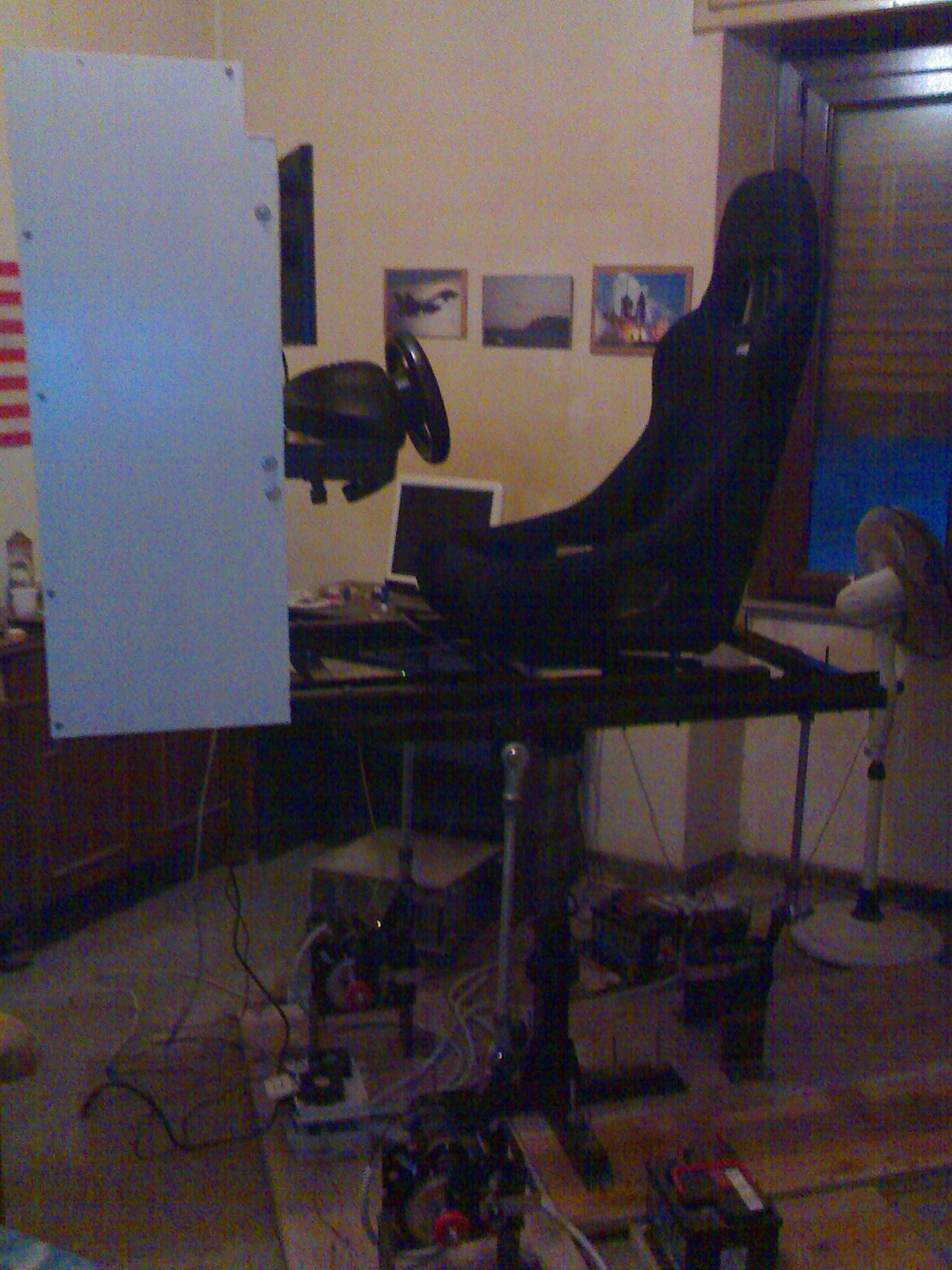

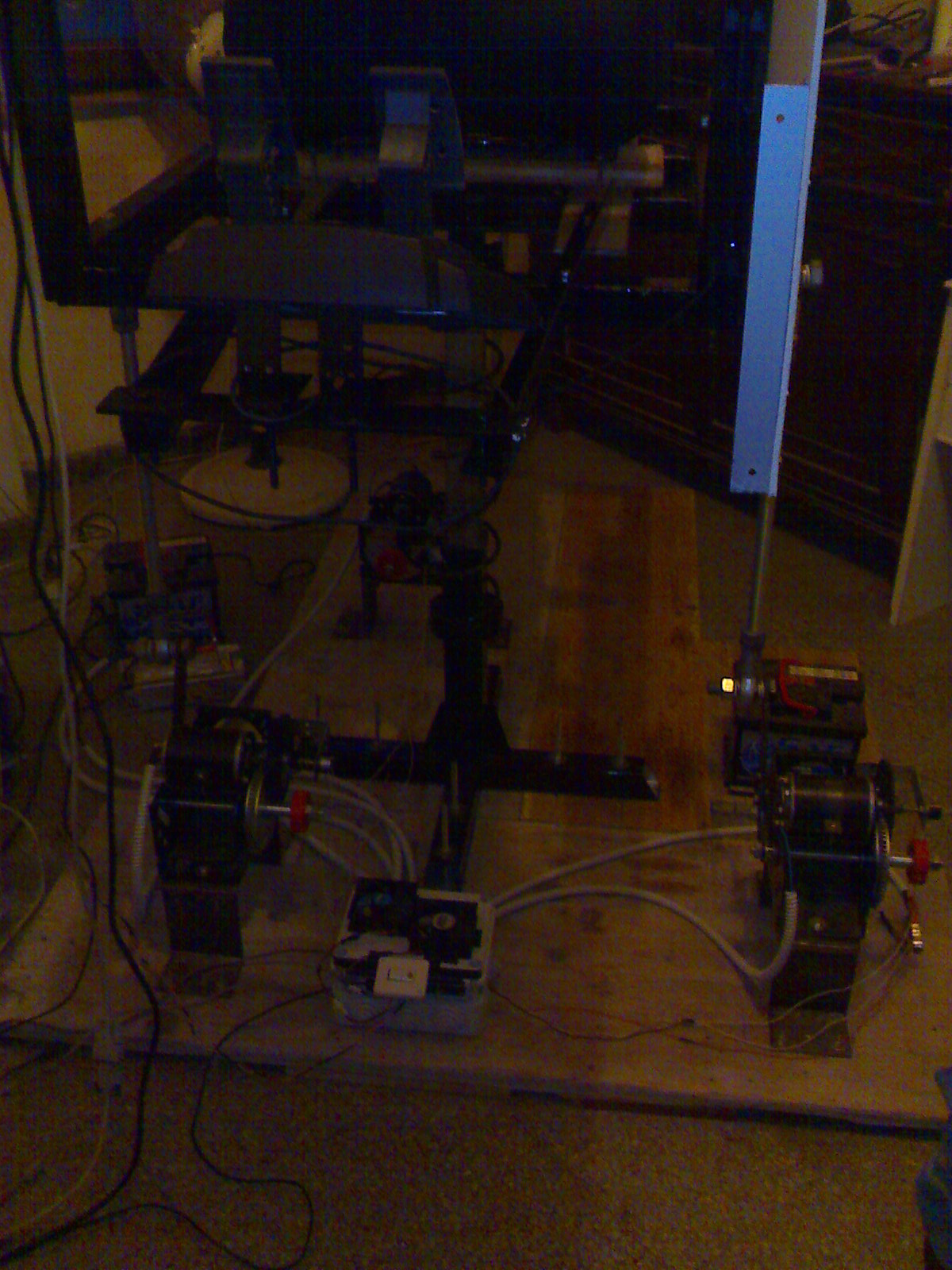

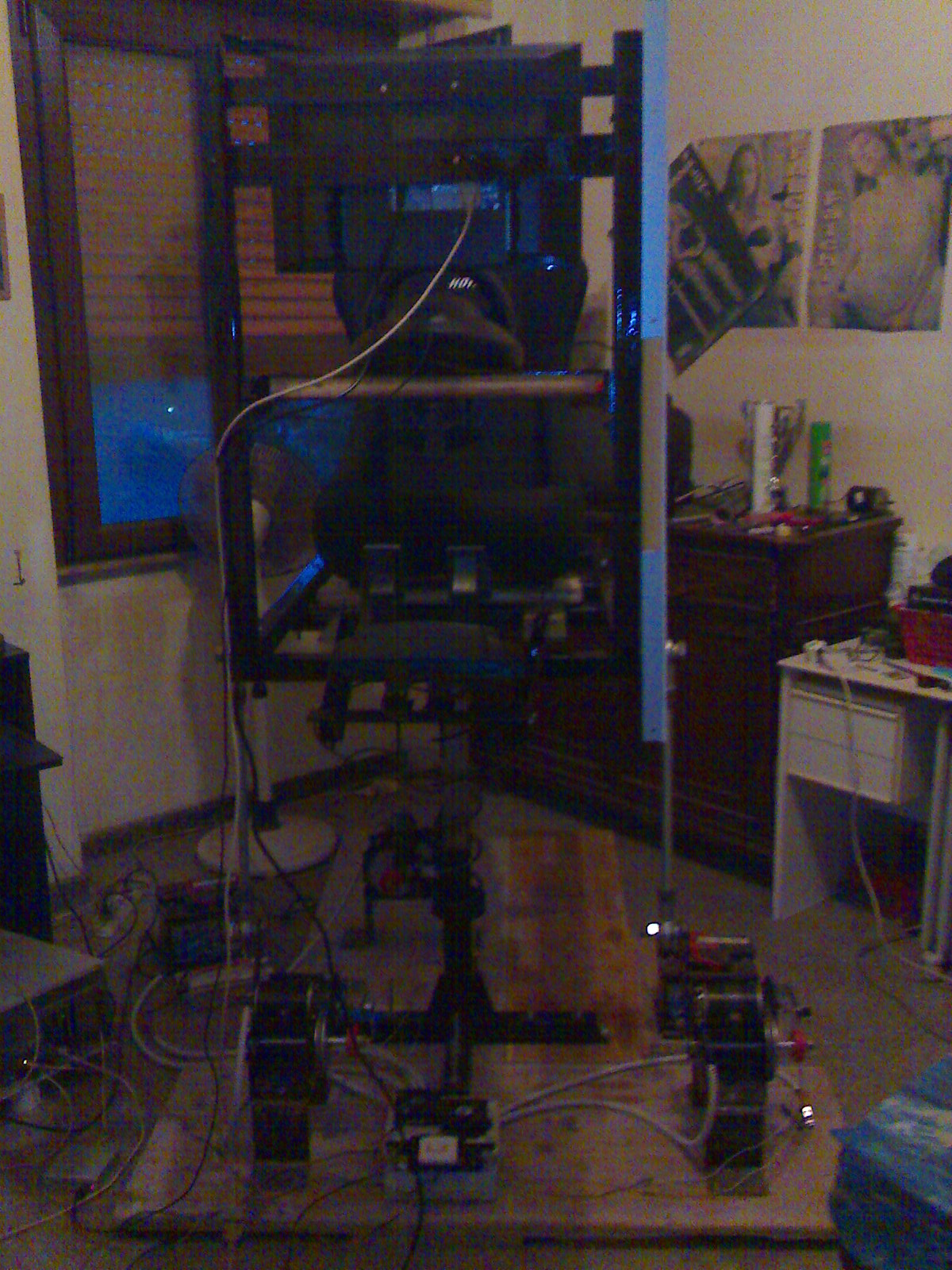

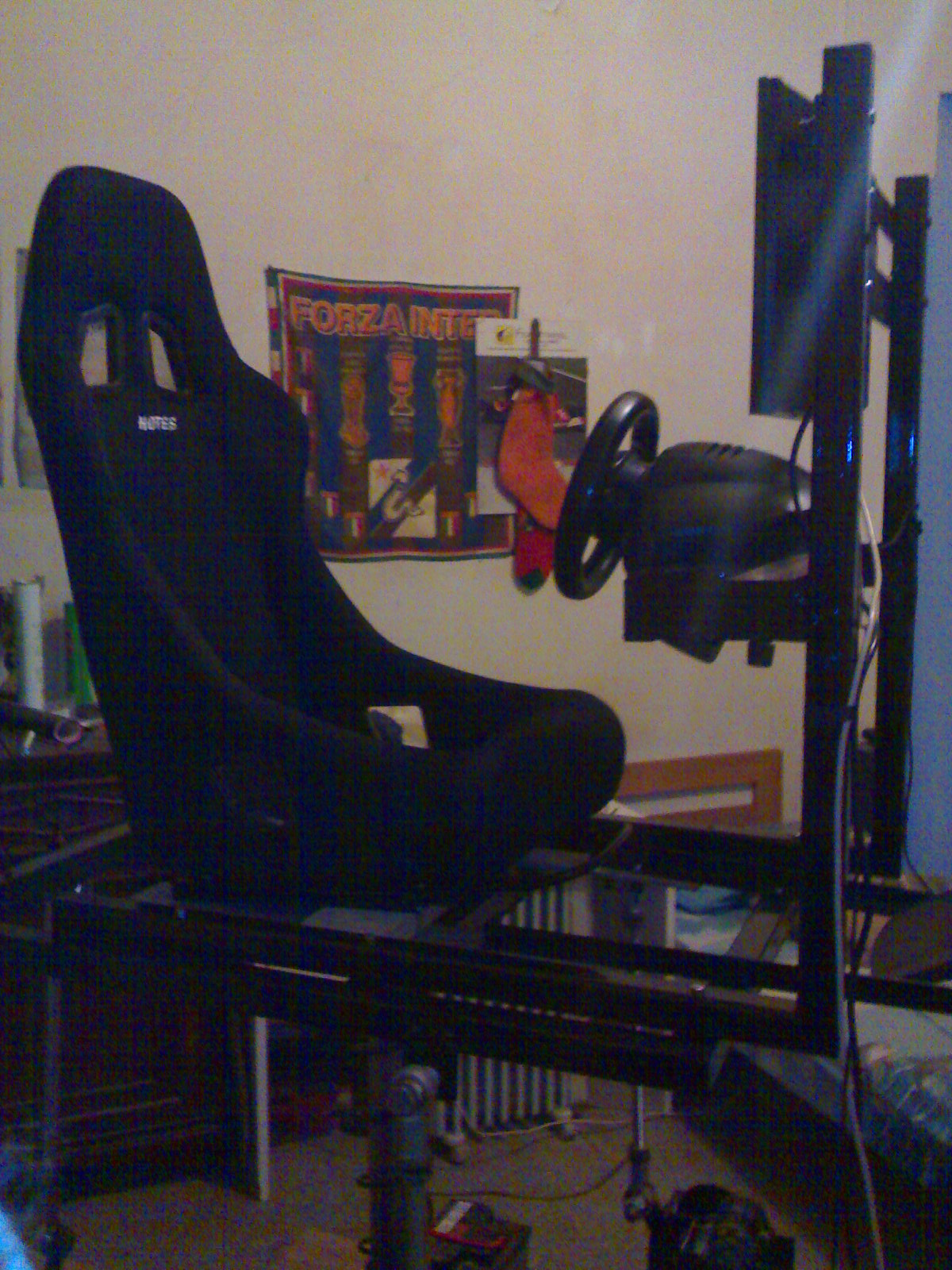

    Hi all, after 2 weeks of hard work I finished to reassemble my 3dof.
    Unlucky today I have no more time to do some test but I am very happy to finish to remount all.
    Today I notice that with the X-SIM offline version I had to add three zero to all my profile values.
    If before the 26 effect was max 500 and min -400, so now is max 500000 and min -400000.
    When I loaded the my rFactor profile so the X-SIM telling me that now the matter is 16bit and no longer 8 bit.
    THen no problem, adding 3 zero to all my variables and I get the same old motion behaviour.
    Here the vid of my 3dof, ready to action!:
    http://www.youtube.com/watch?v=RXsfToZg6g8&feature=youtu.be
    http://www.youtube.com/watch?v=mzMZVsv2iCE&feature=youtu.be
    (sorry for the bad vid quality..) :??
    You can notice the fans button on the jrk box! now I can turn on or off my 2 fans (1,70amps both fans!! :brows: ).
    The air flow seems good and 3 heatsinks protect my 3jrk too!.
    You can see the greater height of the platform than the old version (now the seat is at 1,10 meter and when the platform is on so the height is 93cm).
    Now I have 35cm of pure vertical travel so was impossible to get a shorter platform. (I am using a 3 step ladder to get inside the platform).
    The last thing to do before the test is to use the gear components grease in the pot gears
    to avoid any problems regarding the friction between the drive shaft and the pot wheelr, considering the high speed to which this wheel will travel (600/600 motor cycle and 600/600 accelleration using 22.5 amps).
    Then I hope tomorrow or in two days I will do this final version test! I am really anxious but everything should be fine if all the calculations was good! :?
    here the pics (very bad quality :( ) :
