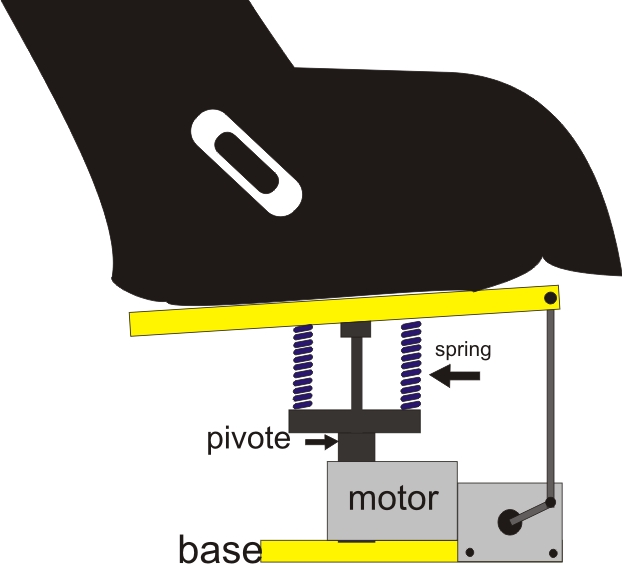

    This will work, it may take some different positioning of the springs, but it will help reduce load on motors. Just watch the springs do not cause too much load Resistance on motors, I found that , but experiment.

    If I would make a wiper motor sim, I'd put a small gas spring where the motors pivot arm connects to the chair (one for each motor) Size of the spring would have to be calculated or tested. I'd also take the load of from the wipers gearing with external bearings (something along 20mm ID)

    We are taking over Aldoz thread here, I will add that I have built 3 wiper style sims, all with springs to alleviate the pressure that wiper motor gearing is under as it changes direction. Springs on mine helped stopped the gearing wearing out and reduced backlash.
    I have not gone further in spring design, like Aldoz has done, but all is possible. I have some thoughts and sketchy plans on a small suspension adjustable strut to under each corner of a sim, just havent spent much time going further. I need to figure out a way to calculate that works for me.

    My 3dof problem isn't the weight but the spring resistance (despite all the calculations done, I overestimated a bit the jrk resistance to hold a really high amps for a time of >1,5 seconds.)
    I notice that you can be 100 or 120 kg guy and no problems here! you can get lifted without problems! :)
    The problem is the resistance of the spring when it's pushed to the MINIMUM motor position (35 cm of spring pressed, using my spring so and so 292kg of total torque needed.. yeah there is the pilot and platform wheight to help to press the spring but the various inclinations and tilts make the understand of the value of this help really hard to find..).
    It's not a problem about if the jrk can handle this! In fact the jrk can provide (with a lot of effort) to motors the right amps but if this effort time is over 1,5 seconds so I get lost connection.
    The solution should be to obtain a new spring (a bit less rigid) but I done a too long battle to obtain my actual spring so I need to use it now.
    Ok, the solutions are:
    1) to use less vertical travel. (so to push less the spring then less newton torque needed then less amps needed)I I could reduce the vertical travel to 20 cm instead the actual 35. This would still be very positive vertical effect and I would get no more connection errors.
    2) to use the relays method. Then the 292kg of total torque needed would no longer be a problem and my jrk's would be quiet and fresh!
    3) To reduce the motor duty cycle and accelleration to 300/600 both and slightly reduce the vertical travel and I would get no more connection errors. Many peoples prefer to have a less rude platform so many peoples can obtain a 3dof with jrk's and winches without problems!!!!! this must to be really clear! :thbup:
    BUT! I want to use all my 35 cm vertical travel :brows: and to obtain my motors on full power so tomorrow I will go to buy 6 realys to do some tests!.
