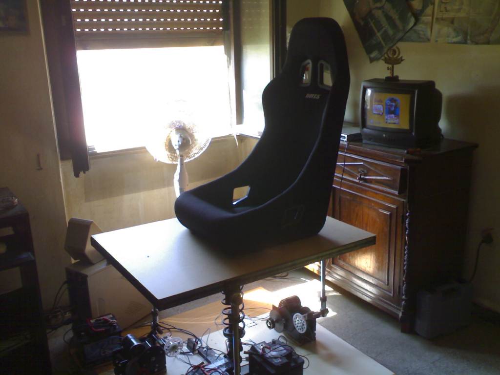

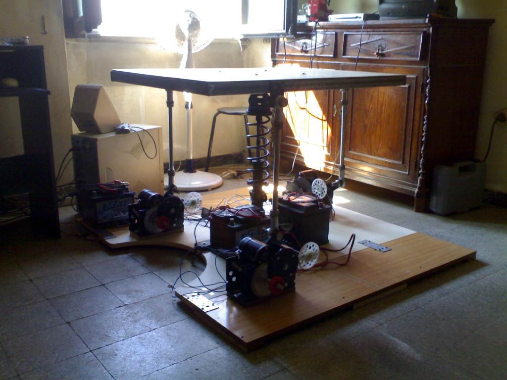

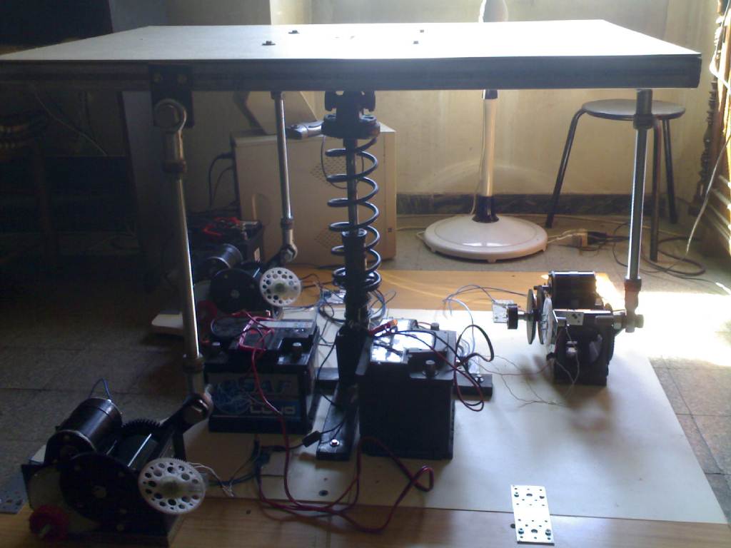

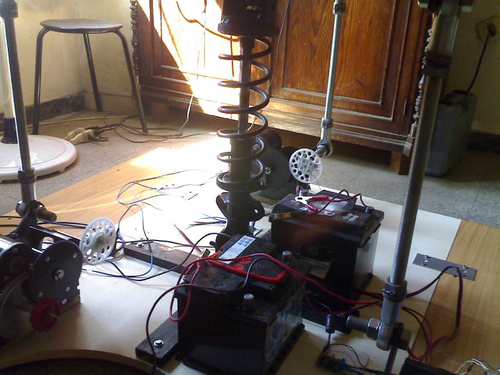

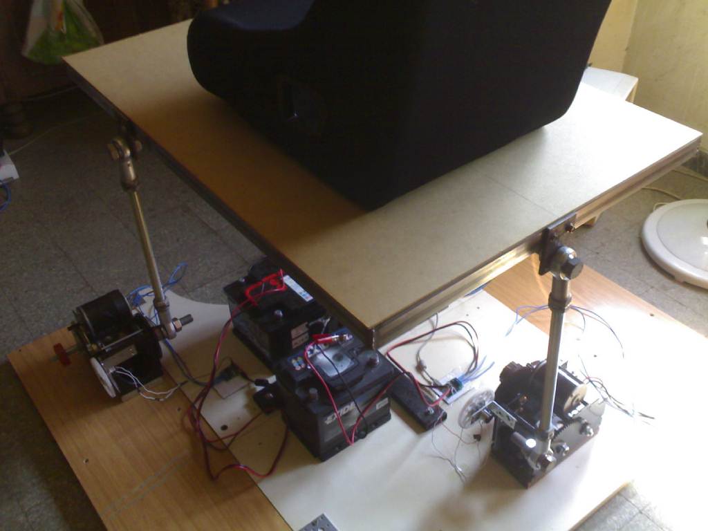

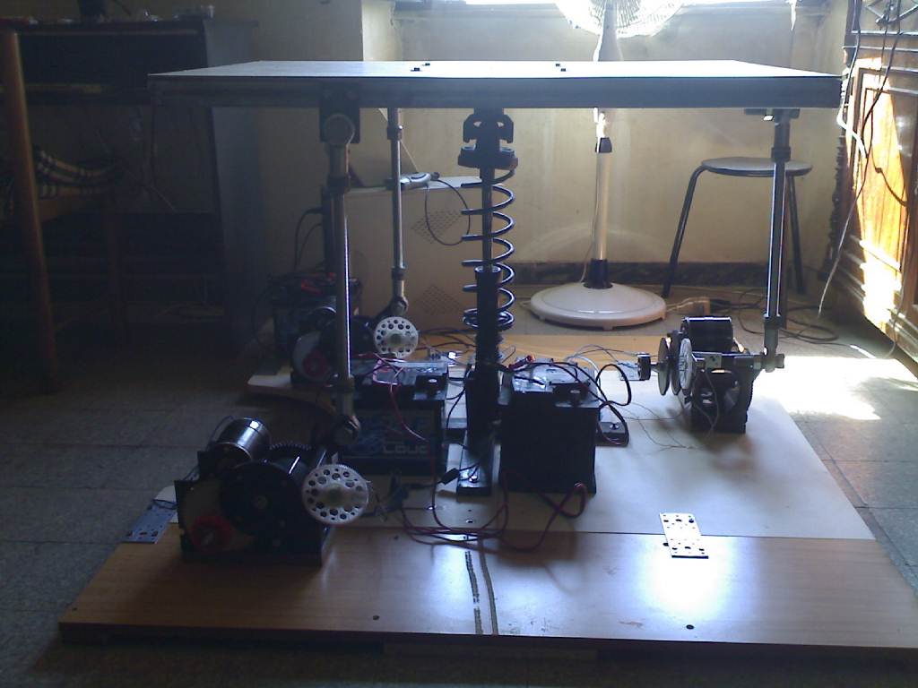

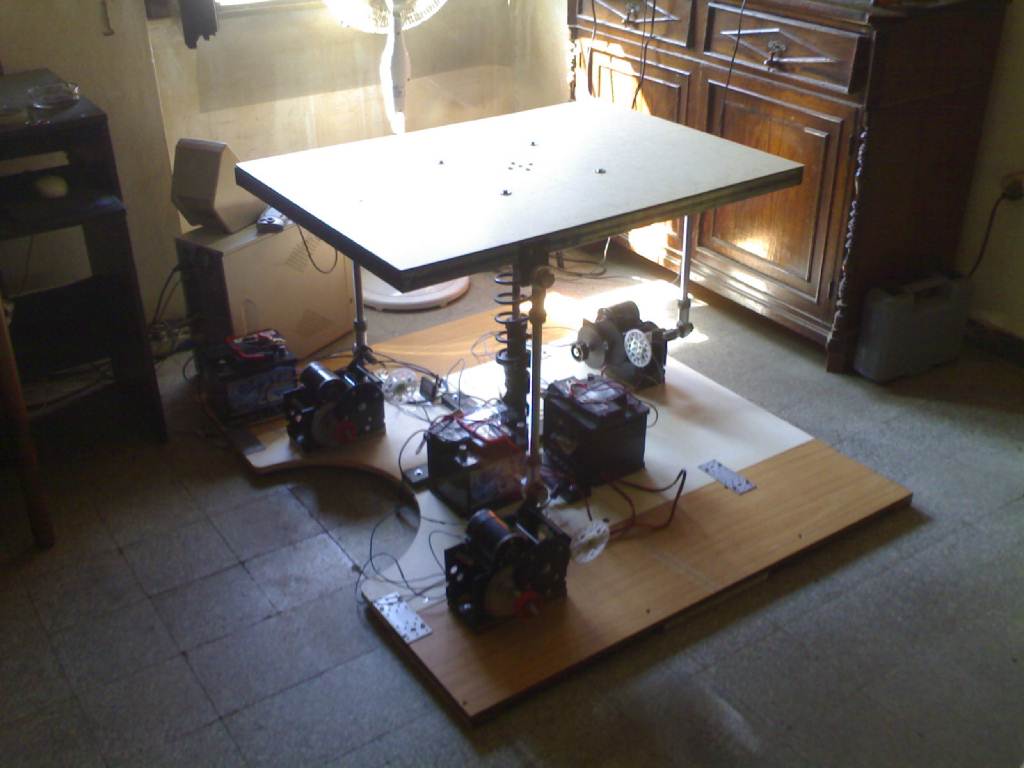

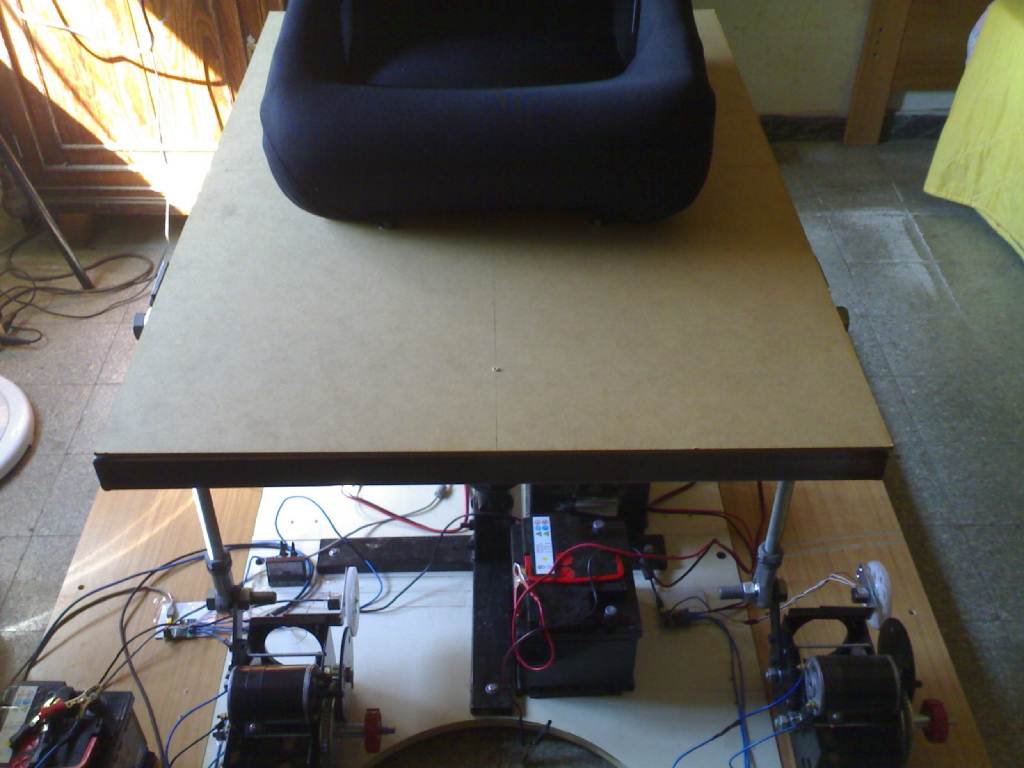

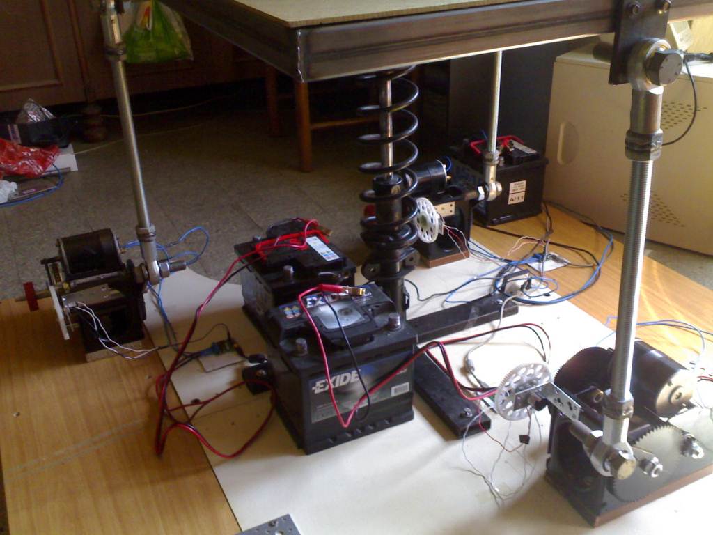

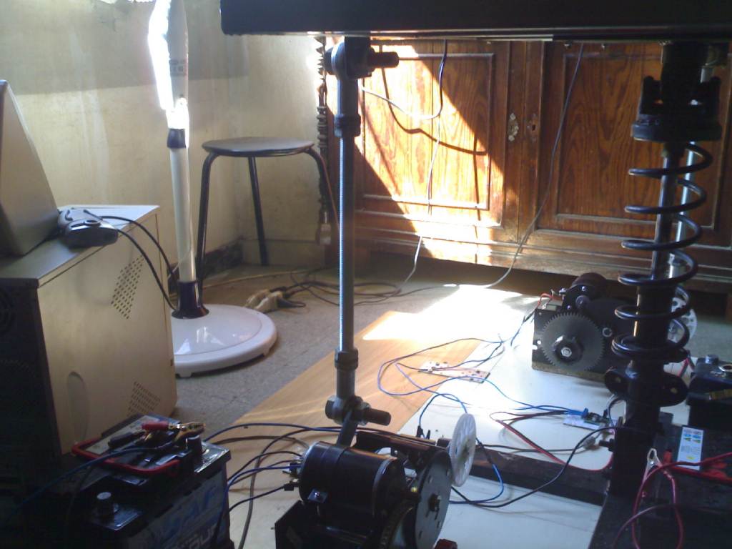

    Hello dudes.
    After the great help of this forum, eaorobbie, frakk and the other guys, now I can to show to you my newborn 3DOF project :)
    I am in full test time but unfortunately my third Jrk12v12 is broken so I have to stop main experiments for the time I need to buy and to have another one jrk12v12 :( .
    first to see that one of the Jrk was broken, I could do various experiments about how many amps my motor draws and especially many tests about mechanical limits of the three platform legs in the various type of movements and inclinations.
    I am very sad about my broken jrk because without this forced stop now I made ​​my first experiments with the rFactor running under the X-Sim :resent:
    Sure the joy about my creation is very high but believe me, to be almost to the top and not be able to reach it is a very bad feeling.
    If you want to understand the Jrk problem you can go to this link (pololu forum):
    forum.pololu.com/viewtopic.php?f=15&t=3735
    Now I am forced to do just the tests about left and right leg with my stern leg in stop condition. Better than nothing.
    Here the pics:

    Good job Aldo! I would try to make the moving upper part much lower for stability and safety.
    Have you tried if the motors will be strong enough for vertical movement?

    wow looking good but agree with Frakk on height of top platform reducing this will take some forces of the motors,
    power for vertical lift cant see a problem mate tested my units on me joyrider with 200kg in chair for extreme weight test and not slowing in motor movement or excess heat. Units can dead lift 150kg easy, so when ya times the power by 3 plus spring backup cant see an issue.

    @EL-CORAZON:
    Yes you are perfectly right. I was wrong when I wrote of different amps relay to choice the power percentage and when I wrote that is the Jrk that to excite the relay.
    The relay is connected directly to the battery so the motor will take directly the max amps from battery. Just a 25Amps relay will broke if it handle over the 25amps. A 30amps relay will broke if it handle over the 30amps ecc
    @Frakk:
    Thank you frakk, now I have no more doubts about the input that the jrk12v12 receive from X-SIM. Just the position based on the PID.
    @eaorobbie:
    Mate, now I am trying to find the better legs and spring position so that the engines make less effort possible.
    For now I decide to use my system without the use of relay.
    when I did some tests with a person sitting on the platform, I'll know better what my engines strive.
    I hope that all my calculations about force/effort/legs and spring positions are correct to obtain my platform working without the relay trick.
    I would to have the possibility to configure how I want the duty and accelleration of my motors!
    Today I cut my spring, and tomorrow I will cut my platform legs for the new spring height. Tomorrow I will to try to remount all too.
    Soon I will show to you all the new configuration pics :)
