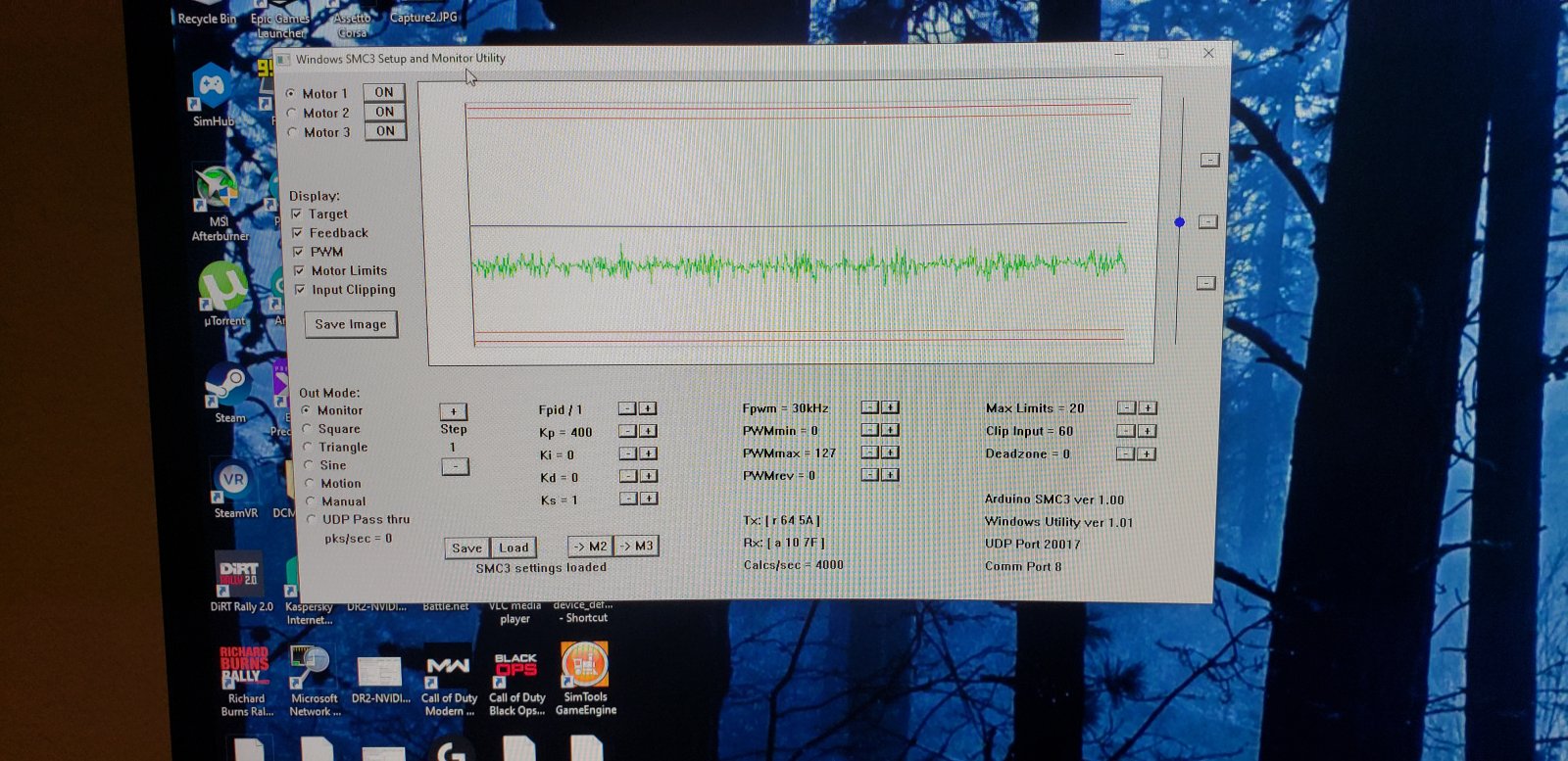

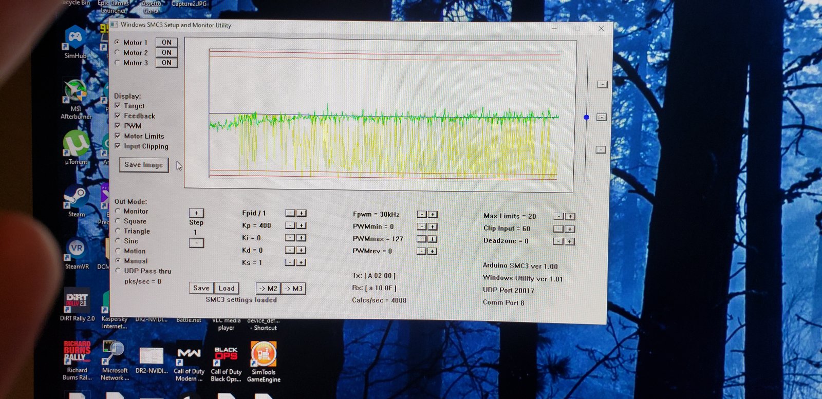

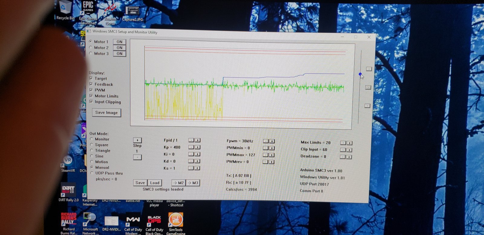

    Ok so having a different weird problem now. After fixing the motor that wasn't moving lets call that one front left now front right wont move up from starting position (will move down and back to starting position) in either smc3, DR 2.O or output testing. If I unplug everything, remove potentiometer and manually move the crank shaft up with a battery back to slightly above starting position then in smc3 i can move the motor up and down in manual mode. If i go back to either the game or output testing it will only move down and back up to starting position but no higher. Wtf is going on?
    21,597
    151,245Coins
    What are your SMC3 settings and what is its graph showing you?
  6. Cameron Olson
    Cameron Olson Member Gold Contributor
    Mar 25, 2021
    84
    610Coins
    +26 / 1 / -0
    Smc3 settings when its not moving up are normal except when I try to manually move the motor up the yellow lines go down to nothing. Once reset and working in smc3 settings are how they should be exempt when I manually move the motor up the yellow lines go up following the slider.
    21,597
    151,245Coins
    Please post pictures of your SMC3 settings.

    Initial settings after game/output testing (motor not moving up) 20210422_035919.jpg
    Turn potentiometer so green line is in the middle

    Initial settings after game/output testing (motor not moving up) 84126
    84127
    Trying to manually move motor up 84128

    If I restart my computer not just the arduino board it fixes the problem in smc3 same as the other solution.
    Moving motor up manually

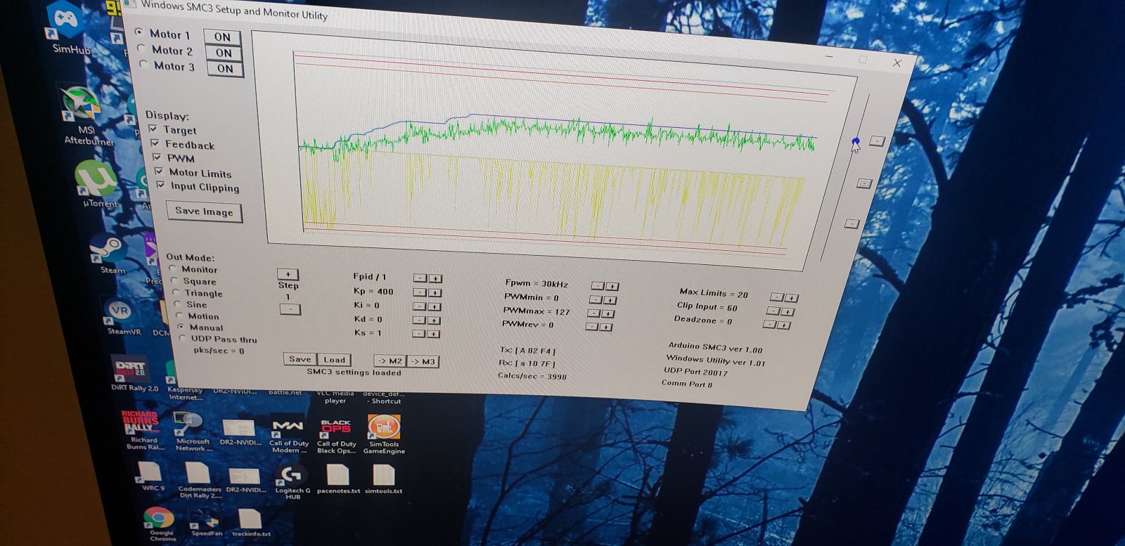

    Still can't figure out why simtools won't move the motor up and is causing it to be needed to reset every time

    Now it went up and down in output testing but when I went into DR 2.O it doesn't move at all..
  13. noorbeast
    21,597
    151,245Coins
    If Output Testing is working then something is getting in the way, first try unpatching then repatching DR, if that does not work then temporarily turn off your firewall and anti-virus, unpatch and repatch, then re-test.
    Make sure your Tuning Center values are reasonable and check if data is in the top row when the game is running.

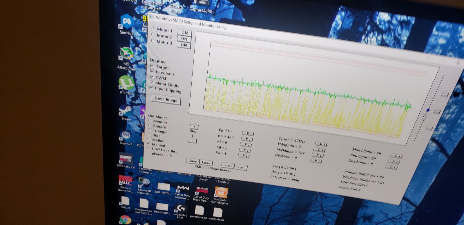

    Now the other front motor won't move up. I don't know what the hell is going on... seriously about to give up on this project grrr

    Its seems like the only way to get them to reset and move up again is to turn the computer off and cut the power to the surge protector the computer is on. Anything else won't allow the motors to move up

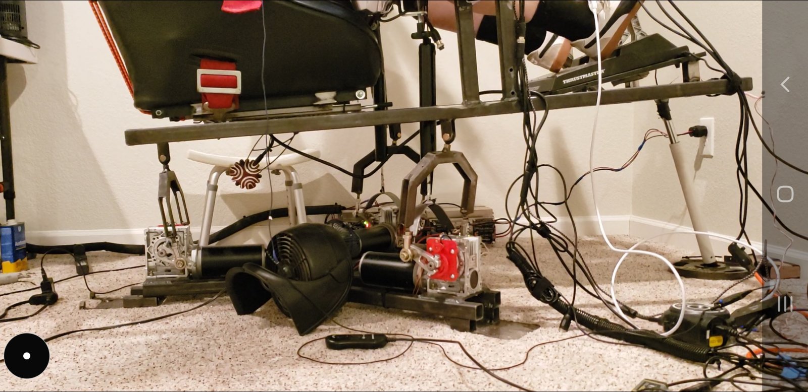

    What a shit show but I got it working again. Took apart both front motors and the brushes were way out of line not really touching the motor. Then shortened the cranks by half. Added 2 large door closers upside-down to always be pulling up on the cranks as well as a spring in the front of the rig. Everything works now, motors still running slightly warm but nothing compared to before. I think the 2 front motors were half shot when I got them since the previous owner blew one (back motor) out. Was able to track down and get in contact with the manufacturer from China and was able to order new motors for $60 a piece. I also ordered another motor/gearbox to mount at the front of the rig when those get here.
    Ordered a right hand motor/gearbox as well for when I add traction loss. But at least I got it somewhat working for now lol

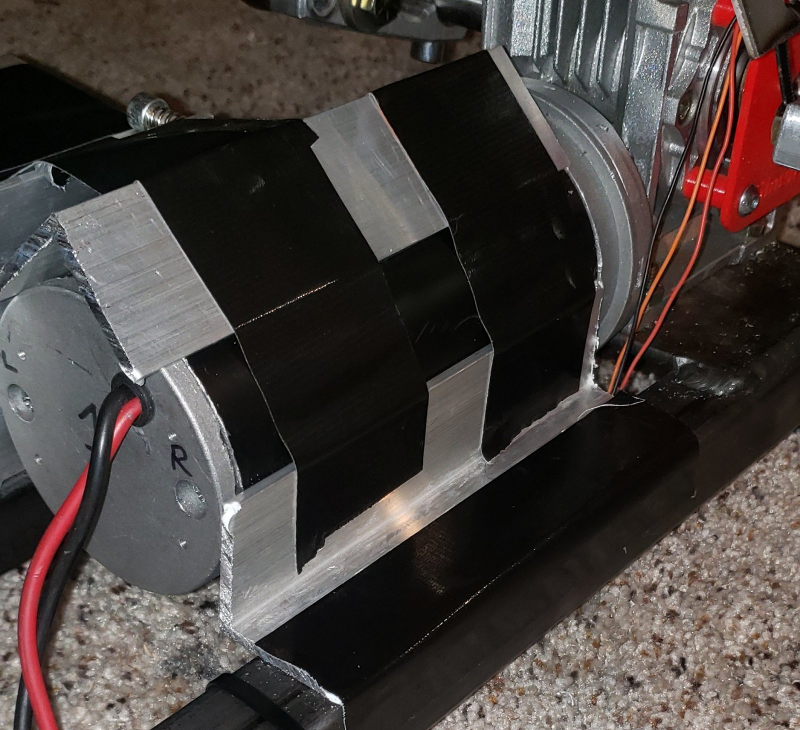

    Haha!! had some spare angle aluminum, cut 3 pieces for each motor to act as a heatsink. Played for about and hour and checked motors with infrared thermometer none went over 100°F (resting temperature around 75-80°F) would you say that is a decent temperature range to shoot for?

    On my rig the motors are just slightly warm to touch after hours of use, if you are getting up around 100°F I suspect motor life will suffer, as I imagine they are pretty hot when touched.
