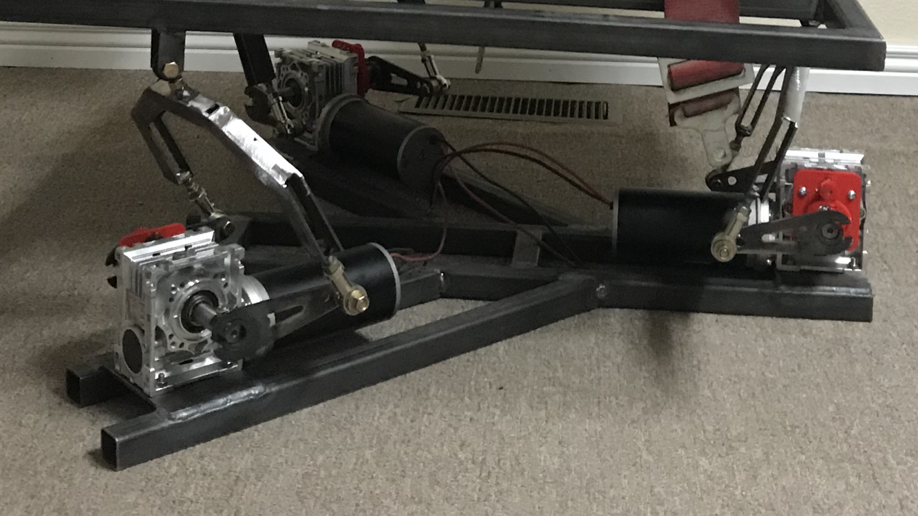

    They really shouldn't have a range issue, the motors could spin in circles without any binding because it is a triangular 3dof design. They are 24v dc motors. There is a picture of them on the first page. I didn't ground isolate them. Edit: When I start up smc3 should I have my motors in any particular position?

    IMG_6405.PNG What do you mean by putting the motor rod at 0? Is that a starting position? Are you saying the crank? Ill post a picture maybe you could help me understand. And when you say change the potentiometer do you mean change the polarity? Thank you for your help

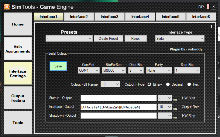

    If I recall you were using 2 Arduino's, is that correct?
    If so you will need to use the Interface2 tab and configure it for the 2nd Arduino, including the correct com port.

    21,611
    151,323Coins
    +11,034 / 56 / -2
    In that case you have an incorrect bracket in your Interface Settings, it should be: [A<Axis1a>][B<Axis2a>][C<Axis3a>]
  10. Hale L
    Hale L Sim Racer
    Jun 16, 2020
    71
    Welder/auto fabricator
    United States
    286Coins
    +14 / 0 / -0
    DC motor, Motion platform, 4DOF
    Ok thank you that worked just a typo. How can I change the default starting positions of my motors? because the second motor starts lower than the rest? Can I do it with the programming? Or do I have to do It manually with a battery?

    @Hale L great work on your build so far. I have been keeping track of your build and its coming along nicely but it seems your having some problems setting up your motors so i thought id try to help. Other members have already posted some of the info and you may already know some of it but this may explain it in more detail.
    You mentioned that you require 180 degrees of movement on your motor arms. I would reduce this to 150 degrees. The potentiometers that you posted you are using are single turn but use 320 degrees of sensor travel. If you geared the pots 2:1 you would have 160 degrees of motor arm angle for a full turn of the pot. To be honest anything above 120 degrees becomes really inefficient and will reduce linear speed of your rig.
    Now in the SMC3 you need to set the max limits to about 25. This is the point that the SMC3 will disable the motors if they go into that zone. The arduino will read the voltage of the pot and convert 0-5v to a value between 0-1023. So if max limits is set to 25 then the motor will disable and turn off the power if the sensor reads between o-25 or 998- 1023. This is a great feature of the SMC3 software and is used to stop mechanical damage. With the max limits set to 25 you will loose 50 points of resolution of the 1024 available ( 8 degrees) so final motor angle would be 152 degrees without using any clipping. I would use some clipping though as in this zone the motor will drive hard in reverse to stay out of the clip zone. This will help as gravity helps to move the motor in one direction so can overshoot the position. No clipping means it will drive into max limits zone and shut the motor down Clipping will reduce the final motor angle further so you would need to adjust the pot gearing to compensate.
    To set the motor up in the SMC3 software you need to disconnect the gears that drive the pot. Move the motor manually or connect it directly to the power supply to move the motor arm to the required centre position. In your case parallel with the floor. Open the SMC3 software and move the pot buy hand until the green line is in the middle point of the graph. This is your pot centre point. Now connect the pot gears together making sure the motor arm centre point and the pot centre point stay aligned. Connect any motor wires back to the driver if removed to align motor arm.

    What is the tooth count on your pot gears, From the pictures it looks like they are geared higher than 2:1 so you will get less motor arm angle than you require.

  20. Hale L
    Hale L Sim Racer
    Jun 16, 2020
    71
    United States
    286Coins
    +14 / 0 / -0
    Ok thank you. I was able to get it running in dirt rally 2.0 and live for speed without heave. I think my motors are to weak with the current length of my cranks. I will be shortening them, but for now I will just use pitch and roll. I have an oculus rift s and I need to get motion compensation software, Not sure where to find it and how to install it?
