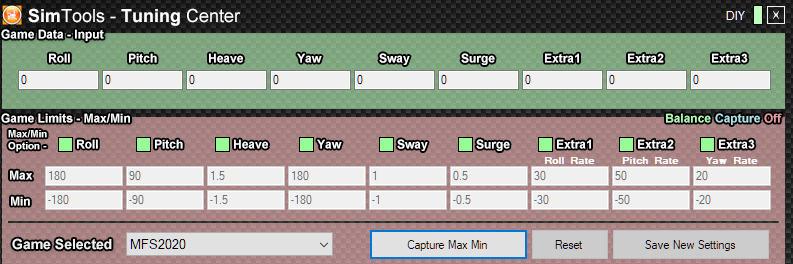

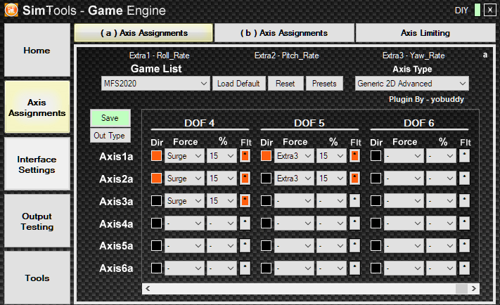

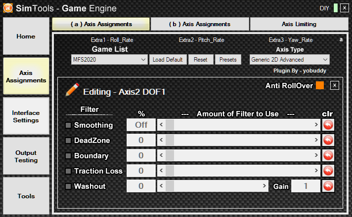

    I am currently in the process of optimizing the SimTools axis assignments, filters and tuning center settings.
    I started out flying a small single engine Cessna in Microsoft Flight Simulator 2020 and optimized everything for casual civilian flying (roll and pitch <20...30 °). I found settings that gave results that are satisfying for me.
    But I also want to do wild stuff with military jets like the F/A18 in MSFS 2020. So i went and changed the settings i found for civilian flying. Roll and Pitch are currently based on roll angle and pitch angle (not roll rate and pitch rate), so i need to use the anti-roll-over filter option.
    However, it doesn't work as expected by me:
    https://drive.google.com/file/d/1PlwZu5xYFxhQnm-yjrZSsoj0w-Gp4mdK/view?usp=sharing
    There is some delay between screen and seat motion, because of the smoothing I applied in order to reduce the violent nature of the motion that happens when i get inverted..
    As you can see, the roll angle of the seat increases while my plane rolls from 0° bank angle to 90° bank angle.
    When I increase the bank angle of the plane further (90 ° to 180 °), the roll angle of the seat starts to decrease.
    As the plane approaches 180° bank angle (almost flies inverted), the seat is almost level again.
    All this makes sense to me.
    But then, when I exceed 180° bank angle, i get thrown around violently. This happens no matter if i do a right or a left hand barrel roll.
    This doesn't seem right to me. I was expecting the rig to smoothly start to lean to the other side when i pass 180 ° bank angle.
    Do you guys have any recommendation on how to fix this?

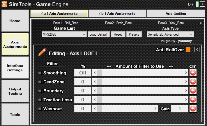

    I would suggest disabling every axis except roll, don't use any filters, and tune roll until it works as expected.
    You can likely use a larger Axis Allocation, as in flight sims you are less likely to have all axis maxed out at the same time.
    The larger the Tuning center value the smother the response, over a greater axis range.
    Once roll is sorted do the same for pitch.
    Filters should not be used except for fine tuning once the base motion profile is working as expected and refined as much as it can be.

    Noorbeast's advice was helpful. I deactivated all DOFs but roll and i found that anti roll over was working as intended. Then I slowly added the other DOFs one by one, always testing in between and was able to overcome all troubles. I think I can get SimTools to work the way I want it to, so I'll stick with it for now.
    I'm still in the process of tuning, though. The F/A18 in MSFS does 140 degree per second roll rate. So after 0,64 seconds i am at 90 degrees bank angle and after 1,28s I am inverted.
    With "Roll" as input and anti roll over activated, throwing the stick to the side will make the rig move to maximum roll angle within said 0,64 s and then back to center within the next 0,64 s. Thats quite a ride. Also, it doesn't feel right when the seat returns back to horizontal while I keep rolling the plane over. I guess anti roll over is not a good option for aerobatics and fighter jet simulation.
    I am currently experimenting with roll rate instead of roll as input. Unlike roll+anti-roll-over, roll-rate doesn't cause a reversal of seat motion while I keep rolling.
    But still it's quite a ride if I throw the stick to the right or left. Everything is cool as long as I do slow input changes, but if I move the stick abruptly, we'll, so will be the movement of the seat. Unfortunately, if the seat moves abruptly, this also leads to abrupt inputs from my arm to the Joystick. I had the situation that I wasn't able to stop the joystick from shaking because the seat (and thusly my arm) was shaking so violently. I had to press emergency shutoff...
    Smoothing, Joystick deadzone, decreased axis range - all those might be solutions to this problem, but they all have serious draw backs.

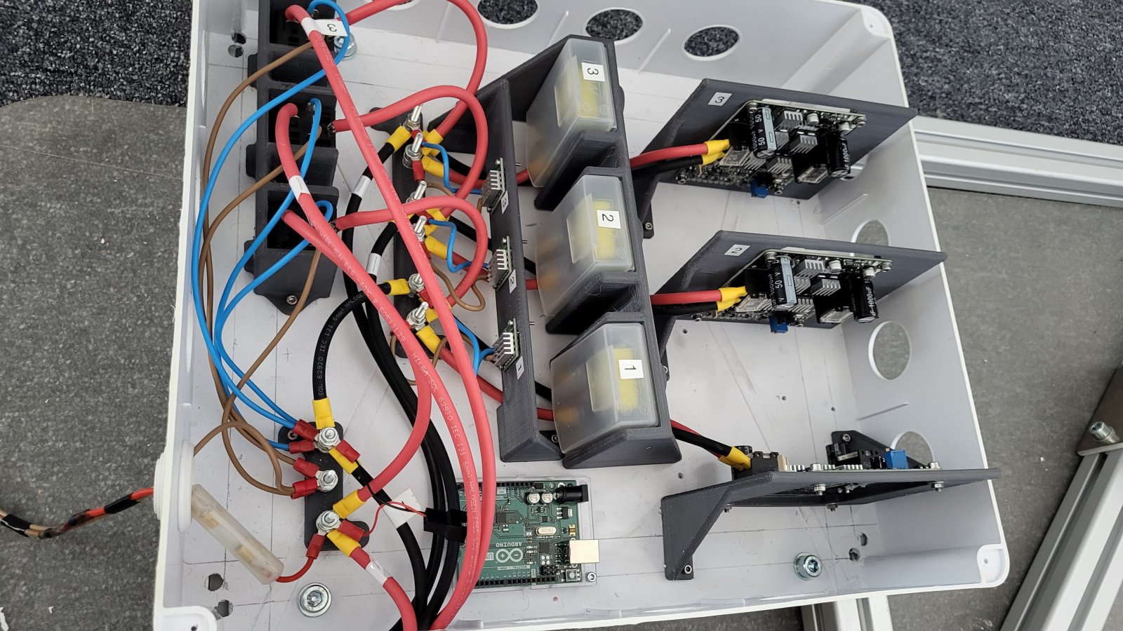

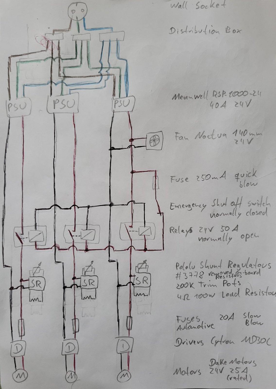

    I'll try to come up with a wiring diagram in the next couple of days. Do you have a specific question?
  8. Sebastian2
    Sebastian2 Active Member
    Dec 17, 2023
    119
    515Coins
    +67 / 1 / -0
    @Attyla.pl
    Attached you find the wiring diagram you asked for
    Feel free to ask any questions.

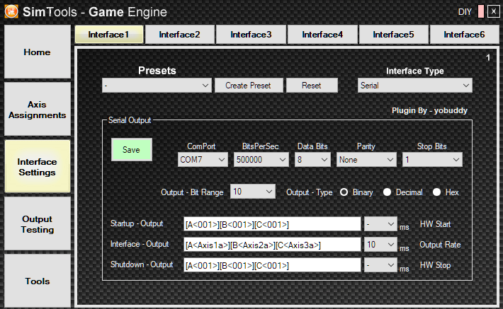

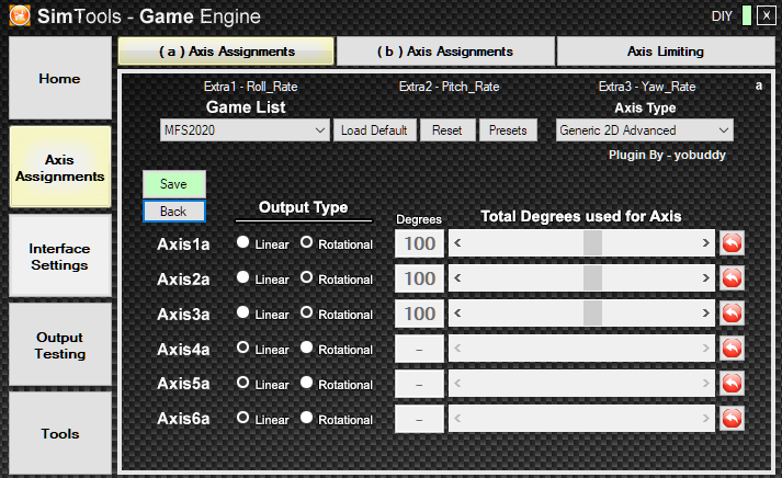

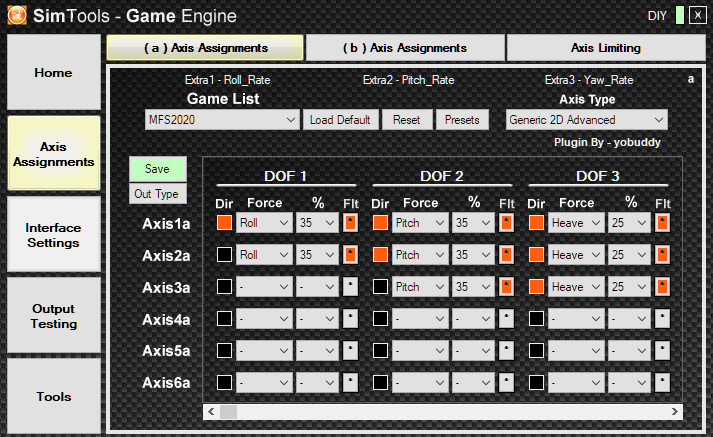

    I want to make it easier to get in and out of the seat. I found that there is a way to make the rig go to it's lowest position when outside of a game, by using the "Startup - Output" and "Shutdown - Output" options in the Interface Settings of SimTools.
    For both I entered [A<001>][B<001>][C<001>] - see the attached picture, but it doesn't work. Am I missing something?

    I still can't get the "Startup Output" and "Shutdown Output" to work. I noticed that the last screenshot I posted had no delay time specified, so i tried 10 and 5000 ms (see attached screenshot), but no luck. I guess not too many people are reading my thread, so I might try a new posting in the "DIY Motion Simulator Building Q&A" forum in a couple of days.

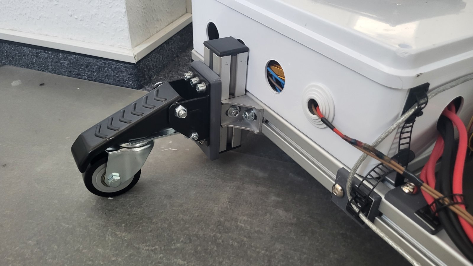

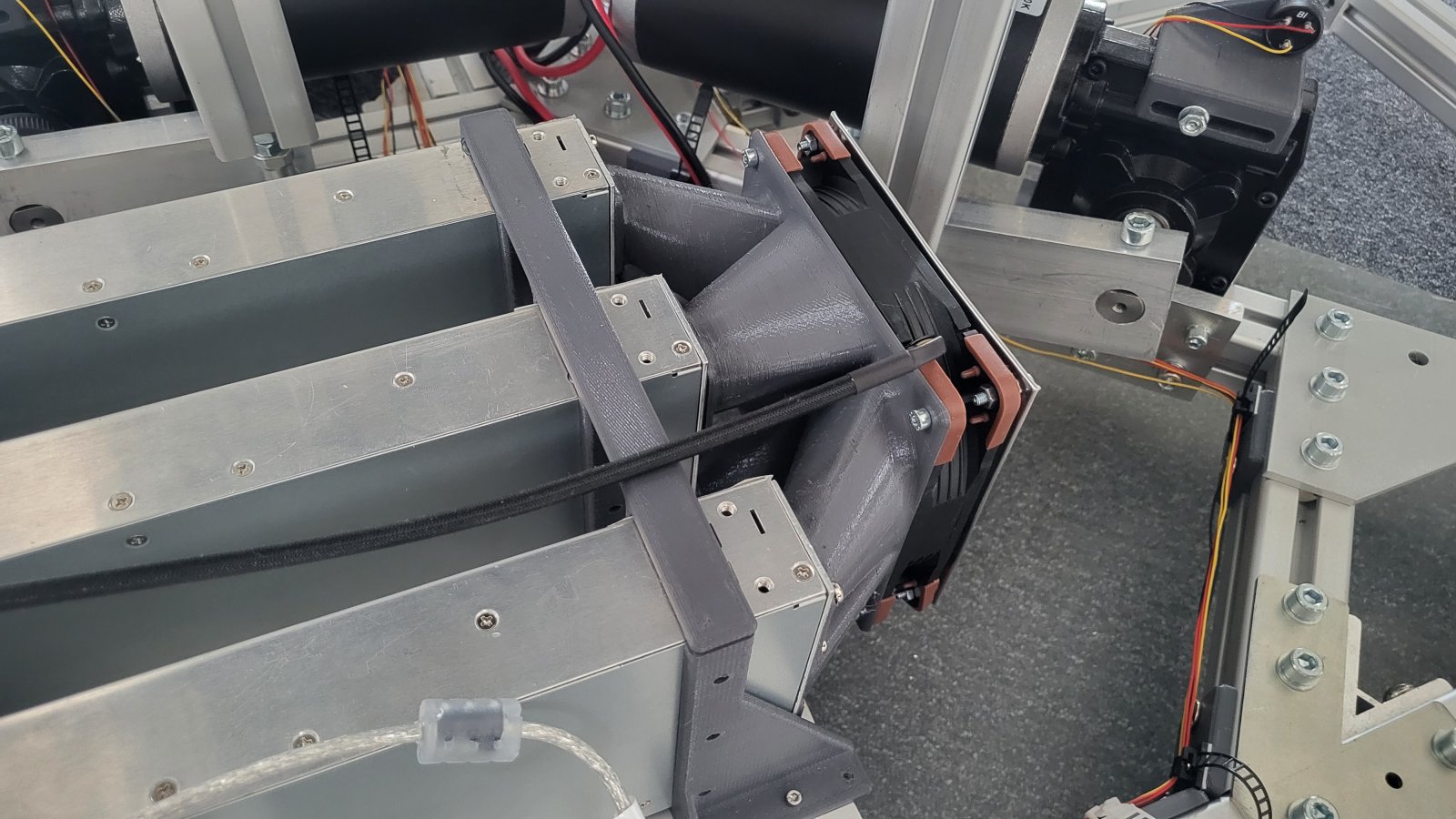

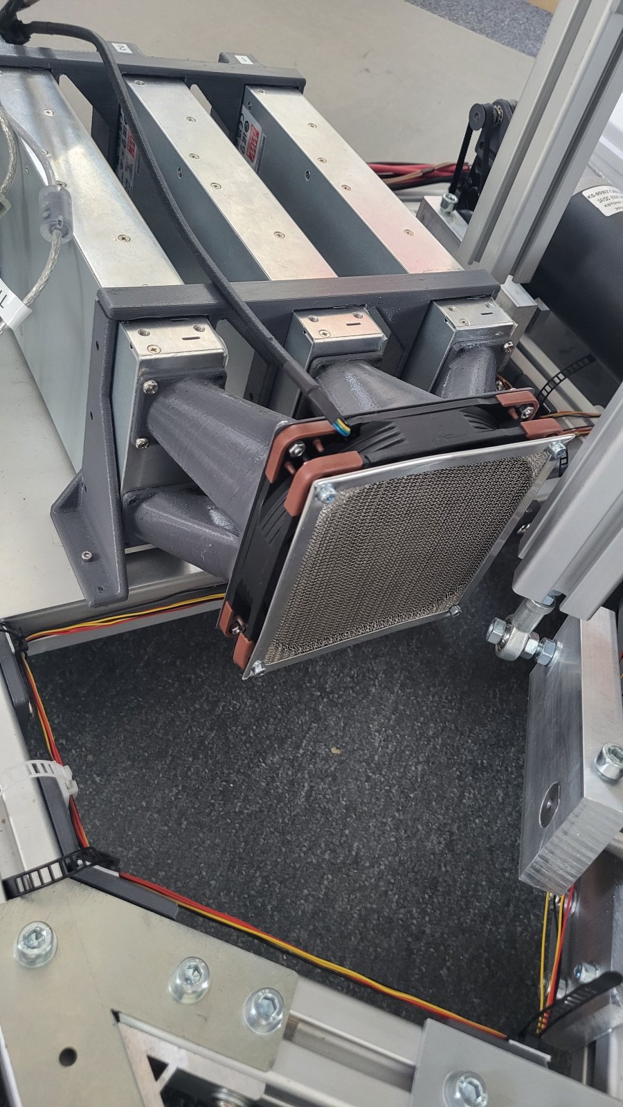

    Meanwhile I wanted to share the fan mod I did for my PSUs. Each of my 3 Meanwell PSUs had 2 fans, each of the 40mm type, that where runnig at 5000 rpm (or something like that) when the rig was idle and even faster when the motors were moving. They made a loud whining noise.
    I removed these 6 tiny fans, installed a 3D printed "adapter" and one single 140 mm 2000 rpm Noctua fan. It runs on 24V coming directly from one of the PSUs. See attached pics. It's much quieter now and the fan noise is much less whiny.
    The airflow of the 140 mm fan is about 3 times higher than the combined airflow of the 6 tiny fans, so i should be safe regarding the thermals. The PSUs also have a over temperature protection.
    I also added "workbench wheels". I need to move my ring before and after each use, so some kind of wheels was neccessary. Before, I used "normal" wheels that were mounted below the rig. But these gave me the problem that when the rig was moving a lot, the wheels added a lot of flex and bouncing back and forth to the entire structure. The new workbench wheels can be folded away, so the rig stands firmly on the ground when in use. This reduced the overall "wobbliness" of the rig.

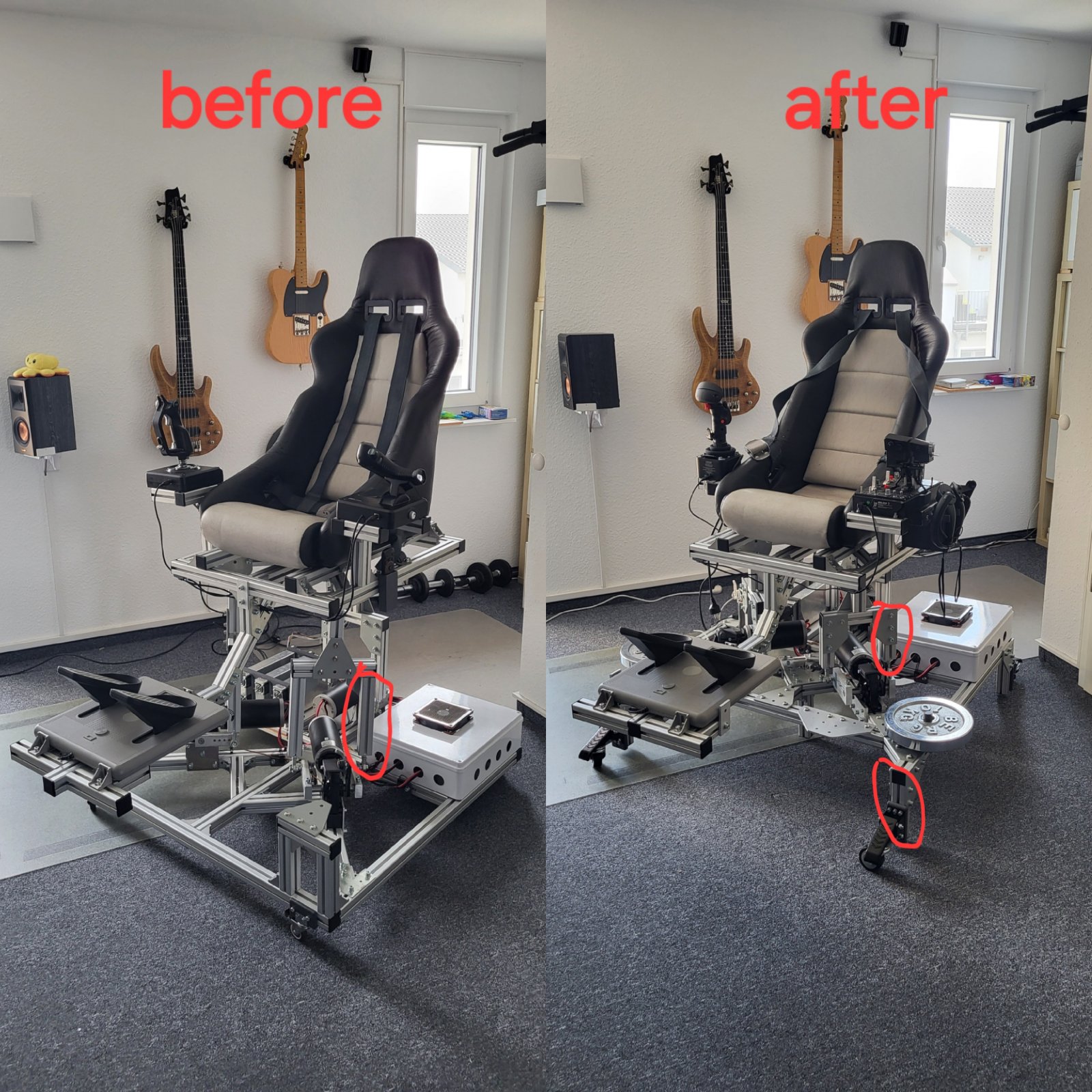

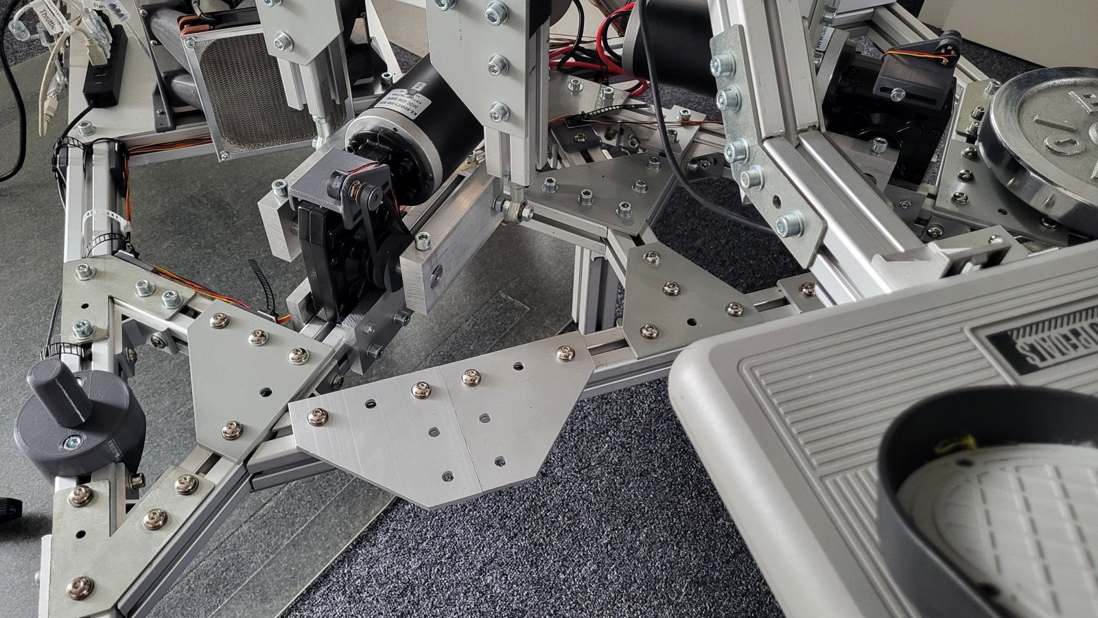

    Little stiffness update
    I put in a lot of effort to increase the stiffness of the rig and reduce the overall wobbling around after sharp and sudden movements.
    In the design phase in CAD I noticed, that I need to get the seat up quite high, to avoid touching ground with the pedals when the seat pitches foreward.
    Dummy me came up with the idea to do that by using long connectors between the motor levers and the seat platform. In the end, this caused a lot of lateral flex and wobbling back and forth and left and right when the seat made sudden movements.
    Now i use connectors that are as short as possible (to decrease lateral flex) and as long as necessary (to allow the desired range of motion of the motor).
    I also placed the bottom platform on stilts, to get enough ground clearance.
    I attached a before and after picture.
    Another problem was rotational flex around the vertical (yaw) axis. This was caused by my decision to put the 3 motors (and their connection points to the seat platform) as close together as i could. I did this to get maximum angular displacement of the seat. But the price was way too much flex around the vertical axis. Everytime I did a sudden roll maneuver, the whole seat kept wobbling around the yaw axis - my rig isn't even supposed to do yaw!
    Now I placed the motors and their connections farther away from each other (they form a bigger triangle now). Thus I get about 25 instead of 30 degrees of either pitch or roll (if I would allocate 100% axis respectively), which is still enough for my needs and the rotational flex around the vertical axis is now negligible.
    I consider the stiffness of the rig quite good now. I did a videos analyis of me using the rig while doing some wild maneuvers in a F/A 18 and the only thing wobbling around now is the squishy biomass in the seat (aka "me"). The top platform itself basically sits still as soon as the motors stop moving.

    About the Startup/Shutdown Output:
    I started a dedicated thread about this and got the answer that these options are basically broken in SimTools v2. They are supposedly working in SimTools v3 but I'm currently too occupied with other stuff to make the switch. Meanwhile I added some kind of steps to the rig, to make getting in and out easier. Hardware modification to counter software limitation.
