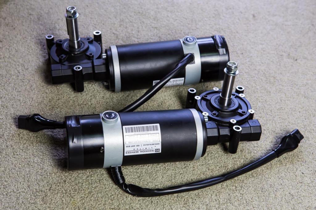

    I got my motors today.
    It turns out the back of the gearbox is sealed so I can't mount the potentiometer to the back. I am going to swap them over for a dual shaft model so I can connect the pots up to the other shaft.

    It is all good though. The supplier of the motors was really cool. He dropped them off to me this morning and I when I opened the box I saw that it had a sealed back (I couldn't see the back in any of the photos on his website) I emailed him and he said that the back of the gearbox was a oil seal so it couldn't be removed and that he was happy to swap them over to the dual shaft versions. He has already collected the old motors and will send me the new ones.
    BTW if anyone in New Zealand is looking for the motors that bsft and others use then the guy who supplied my motors has heaps in stock. Saves shipping them from Australia, I couldn't really find anywhere else in New Zealand that had these motors. His website is http://www.bgts.co.nz/styled-2/styled-10/index.html

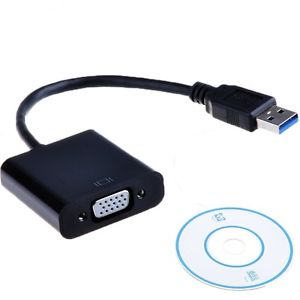

    IF you plan to run one of these, Do NOT use a USB extension, Go for a longer VGA instead.

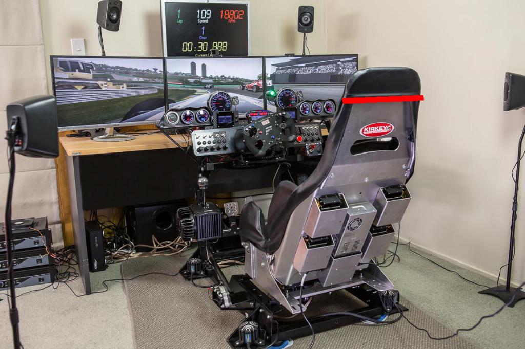

    @Avenga76 , I think I may have asked this, what is the dash display program you use on the screen above your main game screens please?

    Yes, all 4 monitors are hooked up to a single PC.
    This photos was taken when I had my old GTX 680 and it natively supports 4 monitors.
    I have since upgraded to a GTX 980 and it also supports 4 monitors.
    They are 2xDVI, 1xHDMI and 1xDP using a passive adapter.
    The dash display program on the top screen is Sim Commander 4.

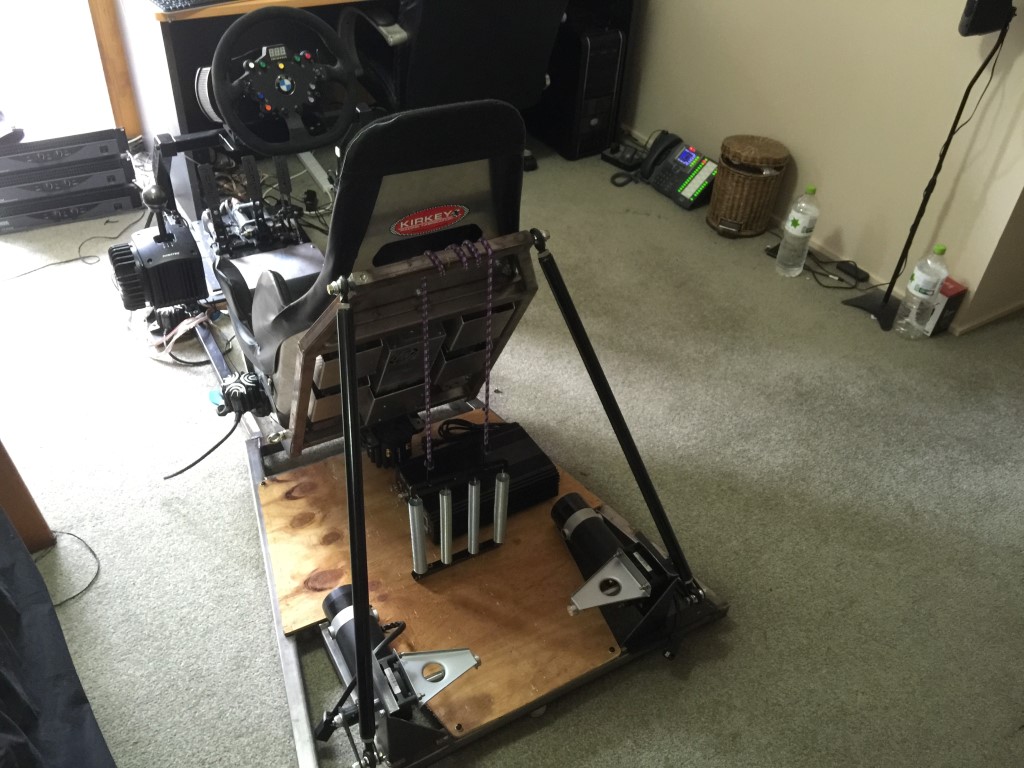

    Also guys. I have finished my 2 DOF build with a lot of help from @Nick Moxley
    I will update my thread with more photos and how I built everything soon but here are some teaser shots
  17. bsft
    rippa job there.
    But what are the springs for?
  18. noorbeast

    Thanks. The springs are for my seat belt tensioner. I am just waiting on the belts. On of my friends has an expired set from his race car which he is going to give to me.

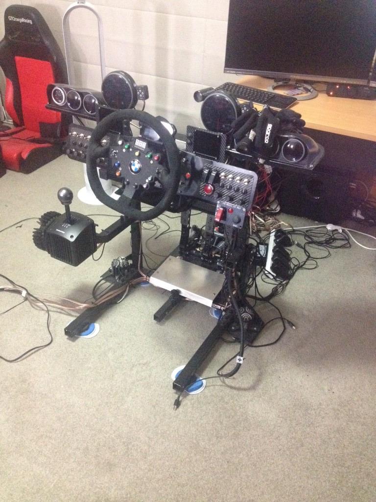

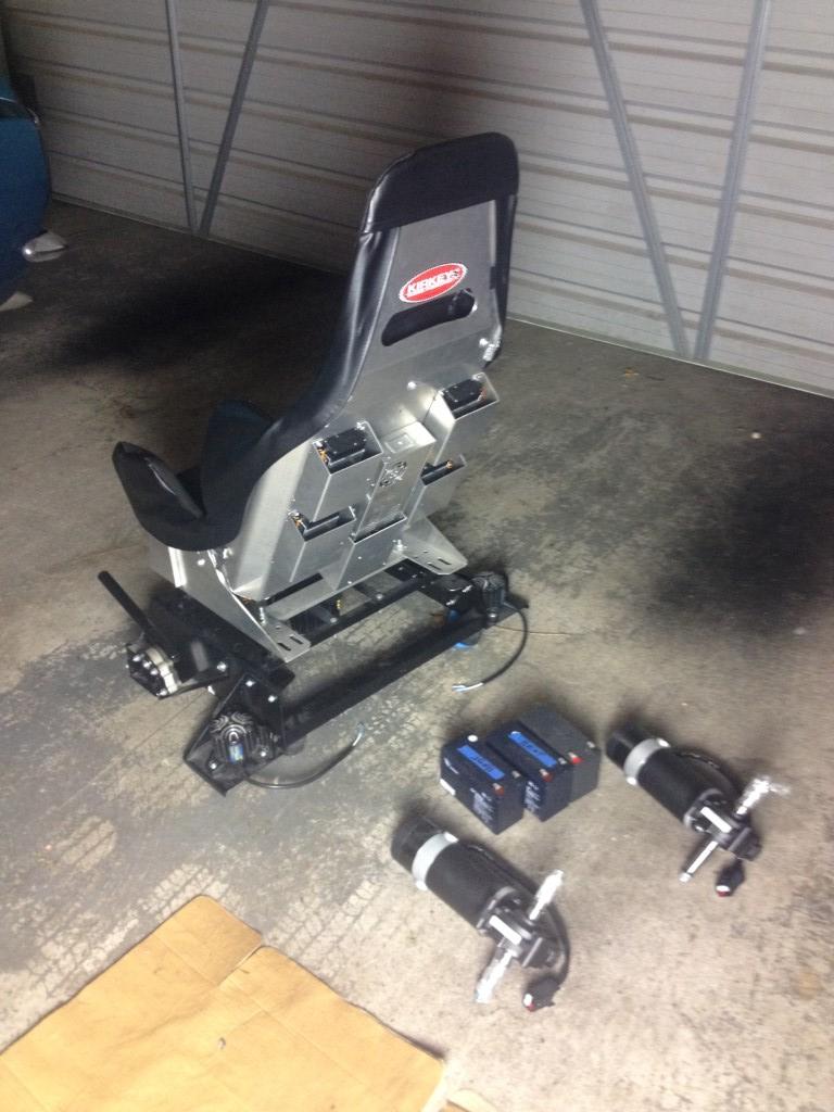

    Okay so starting from the start. This goes back a few months now.
    First think I did was split my rig in half so I could keep racing while I was building my 2 DOF seat mover.
    The front half can be stand alone so I could just wheel my office chair up and race. This was really hard to get used to racing without the GS-4, I really sucked at racing without it.
    The back half ready to get stripped down for the 2 DOF build
