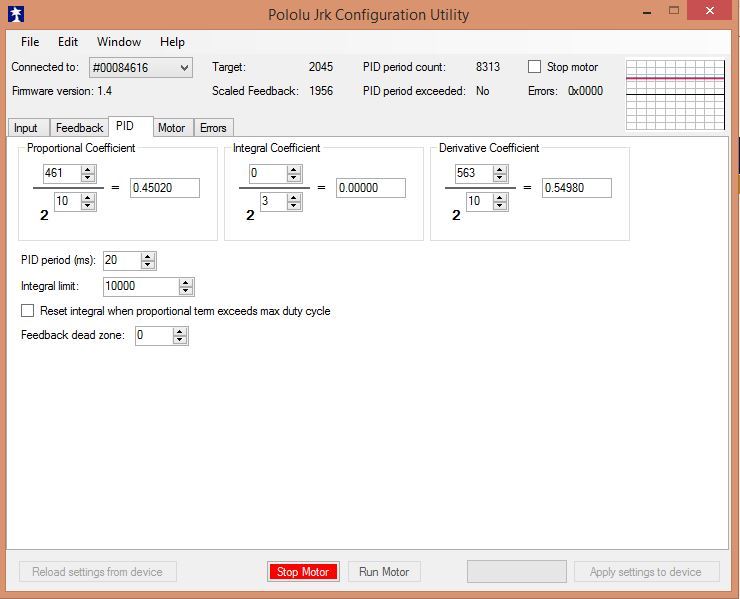

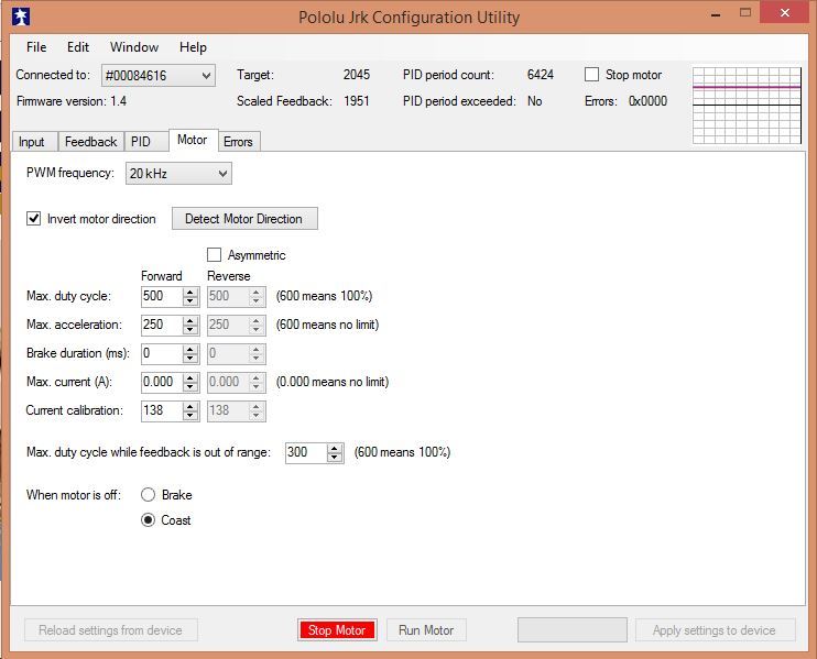

    +1,379 / 4 / -0
    @Avenga76 - Sorry to revive an old thread in the JRK Motor Driver error issues you had, however, would you mind sharing what your final P/D settings were with the Max Duty and Max Accel you are using?
    I've had a similar struggle, which at first I put down to Feedback errors, but then I watched the JRK tool output while I was playing games and sure enough the time the motors were going a bit silly was with a motor driver error.. I've adjusted my PID to be in line with your settings (mentioned in the thread) but keen to see what values you settled on.
    Screenshots of both motors settings would be great. Thanks :)
  14. Avenga76
    Avenga76 Well-Known Member
    Jun 29, 2014
    518
    Network Engineer
    Auckland, New Zealand
    3,260Coins
    +853 / 6 / -0
    @Archie
    Here are my current settings with my smaller 4,300RPM motors
    With these setting I only ever get motor driver errors very rarely while surging forwards under brakes but I think that is more due to the little motors having to move my fat ass :) I can tune the motion profile so I get zero errors if I can be bothered, it typically only happens on fast cars like formula cars so I just tone down the surge for that profile.
    With my 5,300RPM motors I had to go much lower, something like 200-250 duty cycle and a 20ms brake duration.
  15. Archie
    Archie Eternal tinkerer
    Dec 31, 2014
    1,081
    Wollongong, NSW, AU
    3,796Coins
    +1,379 / 4 / -0
    Excellent. Thank you for that. I was certainly in the ball park then.
    I notice your accel is half your Max duty. Do you find the motor's snappy enough at 250? I assume you do, as you've settled on that number.
    I have mine set to 400 at the moment, with a few motor driver errors (MDE). DIRT Rally is the biggest culprit for me, if I hit a ditch with large sway then I get the MDE. Will dial it back and experiment.
    Thanks again @Avenga76 - It's given me a good base to work from.
  16. Avenga76
    Jun 29, 2014
    518
    Network Engineer
    3,260Coins
    +853 / 6 / -0
    Yeah, I find it snappy enough at 250.
    I have it set up that way so it takes 2 PID periods to get up to full speed. My PID period is 20ms so it would take 40ms for my motors to get up to full speed. I think that is quick enough.
