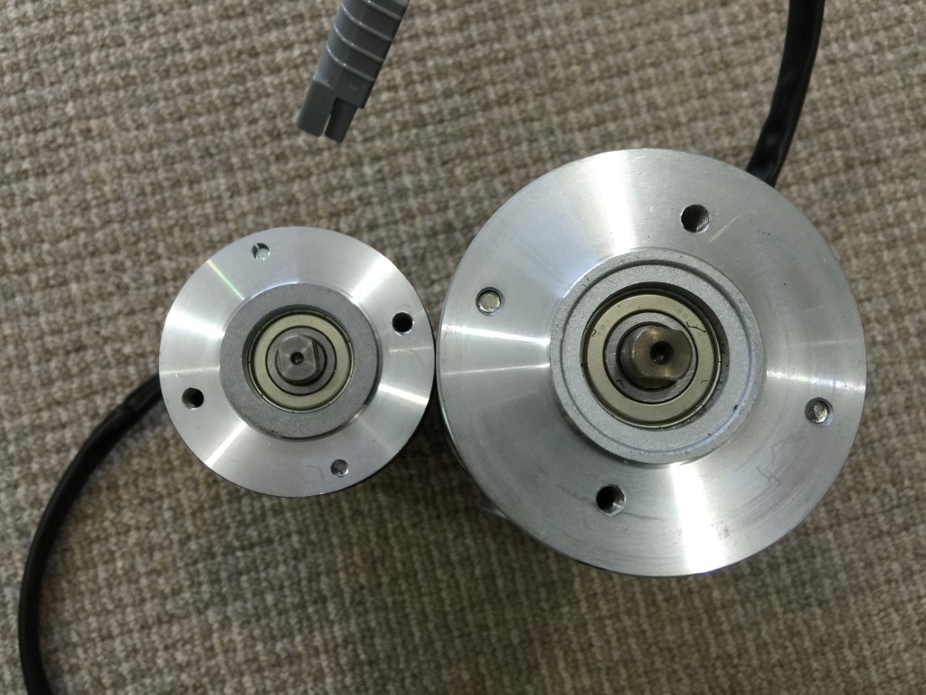

    So I did some more testing.
    To test the heat buildup I did 35 minutes non-stop in iRacing with the Skippy and Lime Rock, about 30 laps.
    The motors were warm to the touch but never got any hotter.
    I played around with the PID. I found that the motors are very sensitivity to P. I run both the new motors and these ones at P=0.5 and D=0.6. If I increase it to P=0.6 then I start to get the odd motor driver error and if I go to P=0.7 then I get more motor driver errors.
    I am happy with the performance at P=0.5 on the new motors. I get about twice the speed and no motor driver errors with the new motors.
    I am really pleased with these experiments. It seems to prove that my theory of the faster motors having problems reversing on the JRK's was correct.
    I will keep these new motors on my rig because they run twice as good as my old ones but I am going to build up a test rig on my bench so I can experiment with either a more powerful controller or ways to get the JRK's to work with bigger motors because I would like to find a way to get my bigger motors running at full speed because they have a ton more torque.
    BTW. Here is a quick size comparison so you can see the difference between the 4,300RPM motors and the much bigger 5,300RPM motors.
