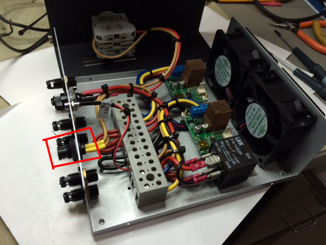

  9. tombo
    tombo Active Member
    Oct 5, 2013
    269
    2,443Coins
    +246 / 2 / -0
    DC motor, Arduino
    Thanks for the reply,
    this Info is also handy, but i mean the screwed connectors on the Box. I took your picture and mark it in red. I hope that is ok.
    Because i'm not shure which one to take that can handle the amperage.

    @tombo That connector is not for power. It is for the remote kill switch at the front of my rig. It is a "LTW IP67 Harsh Environment Circular Connector" http://jaycar.co.nz/productView.asp?ID=PP0542
    It is only rated at 5 Amps so it is not suitable for carrying power over it, but because my remote kill switch is just triggering a relay then it is perfect for that.
    That photo was taken before the big power cables went in. I didn't get any shots after we installed the power cables because it was very cramped in the box. The power cables just come through some IP68 cable glands and directly screw in to the JRK's. I can't remember what size they are, something like this http://jaycar.co.nz/productView.asp?ID=HP0720
    The gray Anderson plus I use are rated at 600V 50A do they are pretty heavy duty. I think that is the best way to do it, use a gland then have a big connector outside the box.
