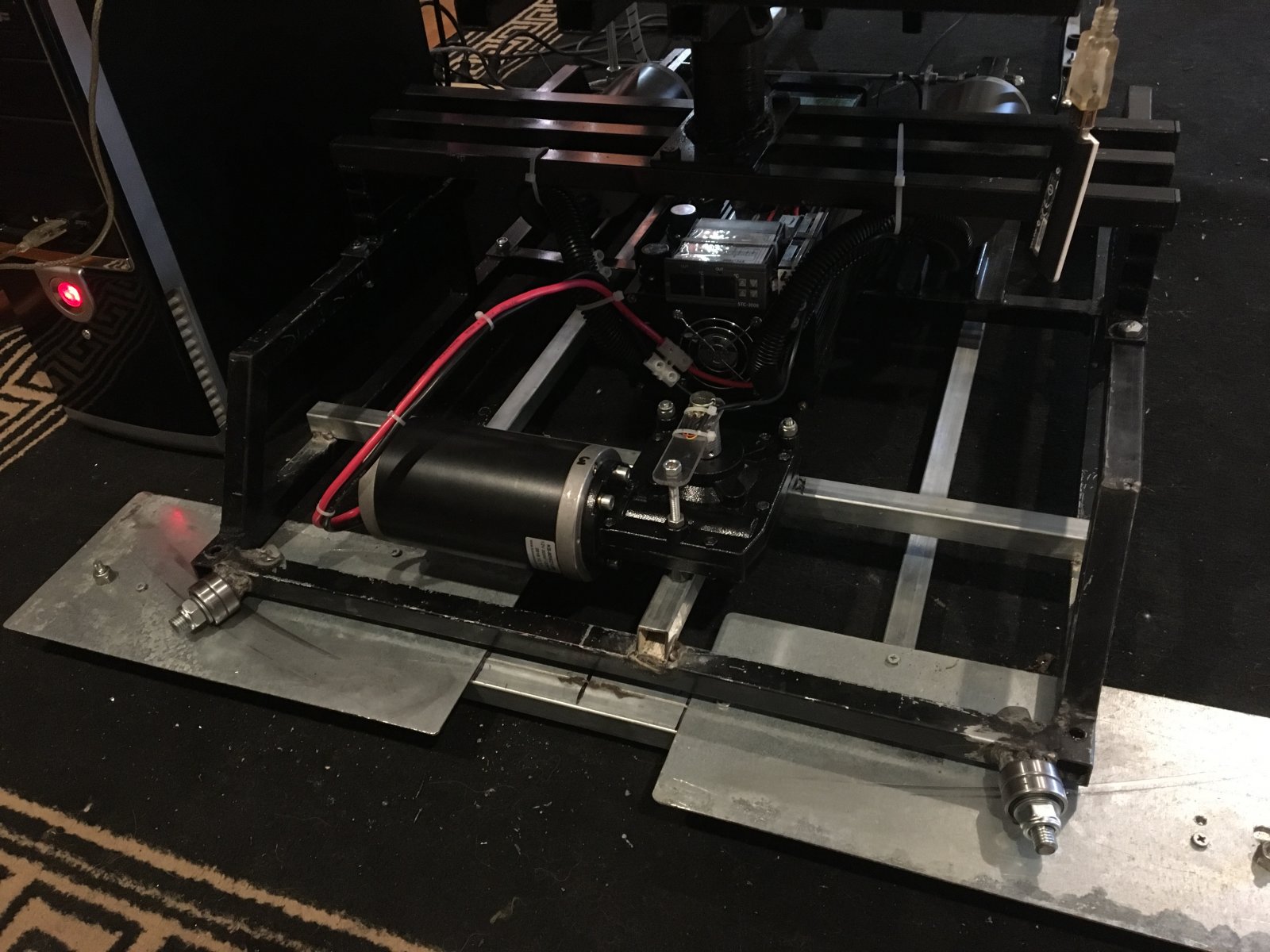

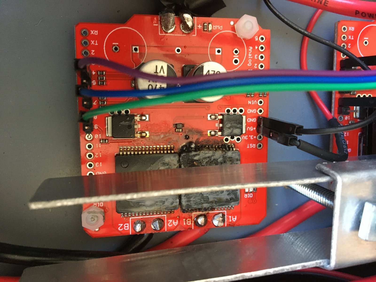

    What happens when testing and you can't set cutoff to more than 255 and comes off edge of slide frame. Was working well in AC until this happened.
    Magic smoke escaped so next project is to extend frame.

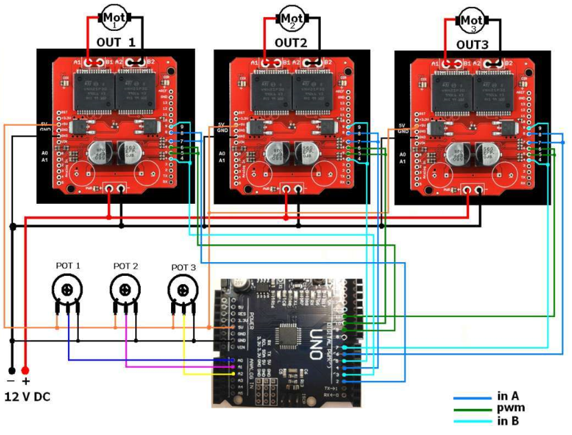

    Thanks to @steveh2112
    find this line in the main loop() function
    Feedback1 = analogRead(FeedbackPin1);
    add the following after
    Feedback1 -= 512; // STEVE Feedback1 is 10bit, 512 is center
    Feedback1 *= 2; // STEVE scale range by 2
    Feedback1 += 512; // STEVE
    do the same for Feedback2 and Feedback3 if you need it
    now your pots will have twice the effect as before
    (remember to download it to the arduino)
    This temporarily solved my issue with feedback not reaching clip and cutoff limits on my traction loss motor.
    Extending frame to allow full travel and a loose 10k pot connection was the root cause.

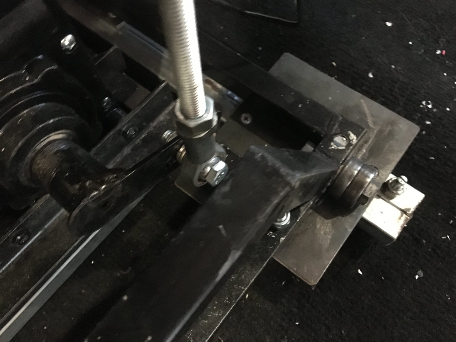

    Upgraded loss of traction (doubled) and aligned wheels to direction of travel , much freer movement.
    Also changed to steel slider plates as aluminum was to soft (bent and wore a groove in plate).
