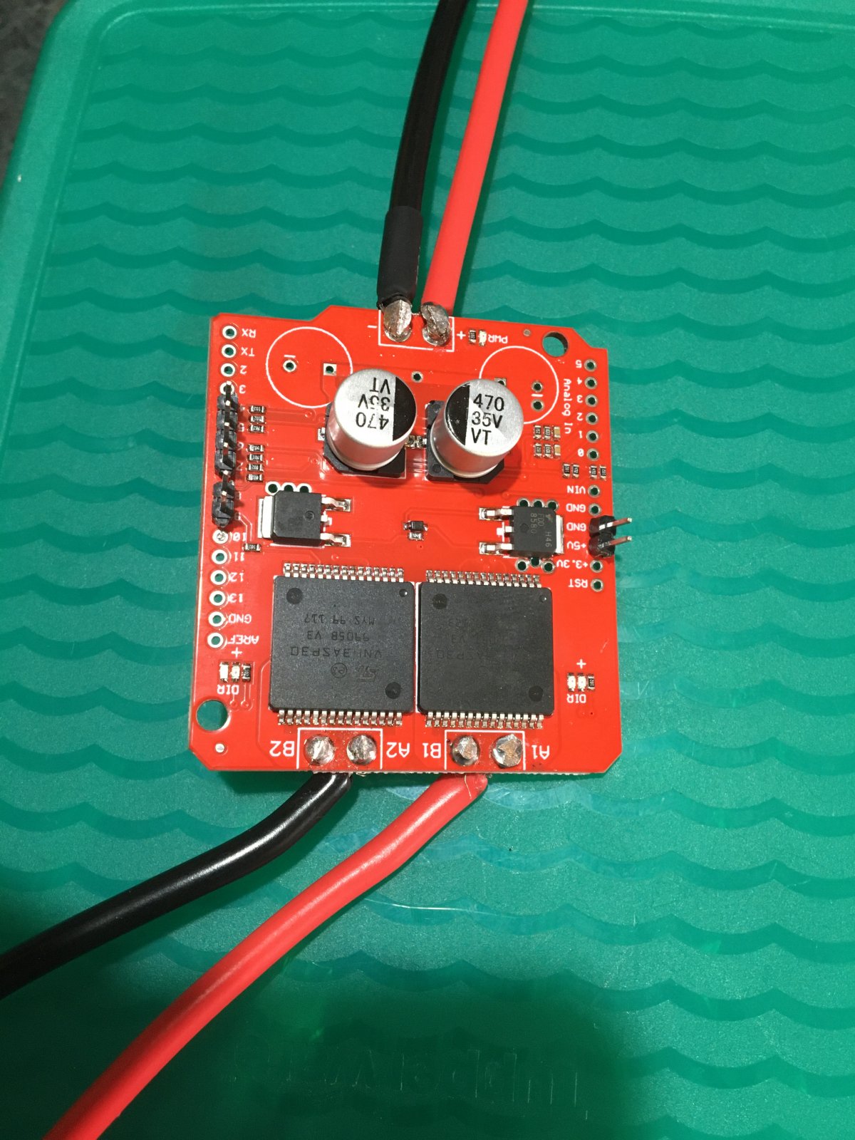

    Son testing - 1 hour later the Monster moto driver heatsinks did not get above 45 Deg C. The motors got hot but you can hold hand on them.

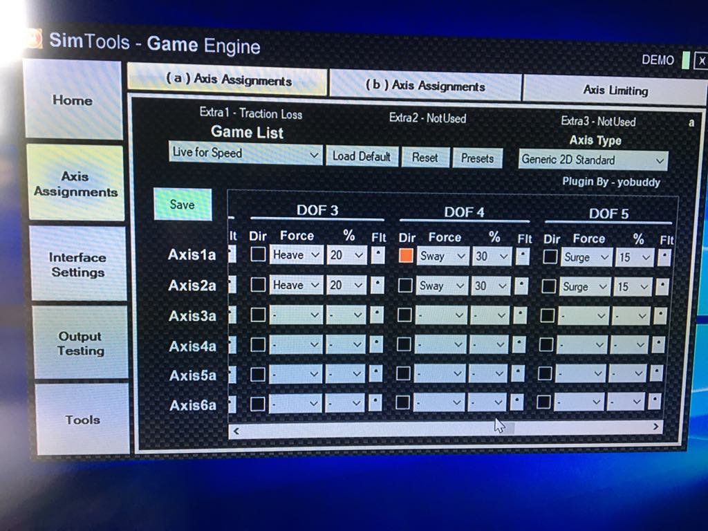

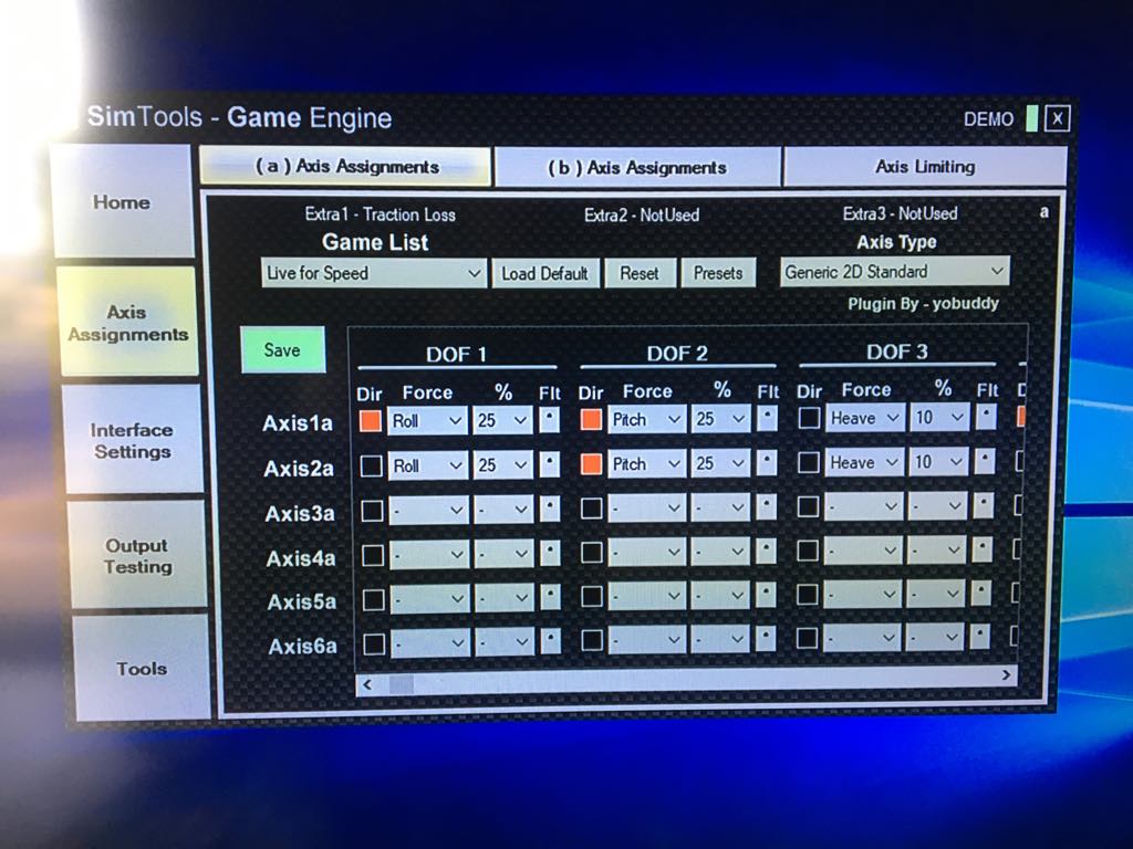

    Updated setting to smooth action:

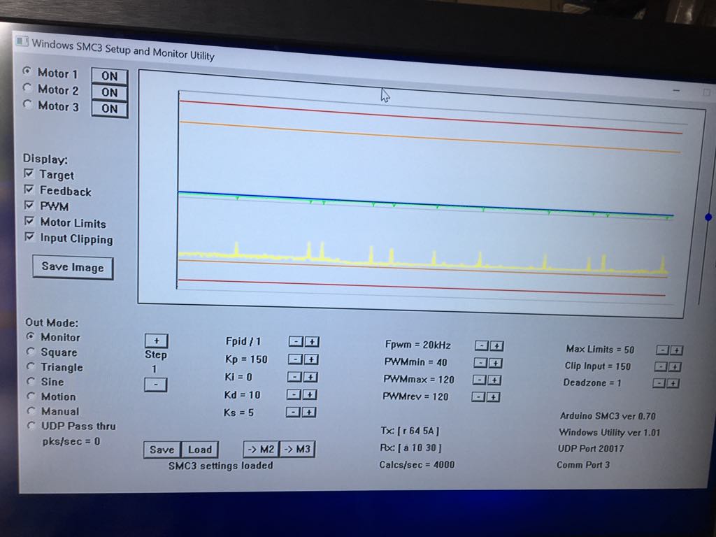

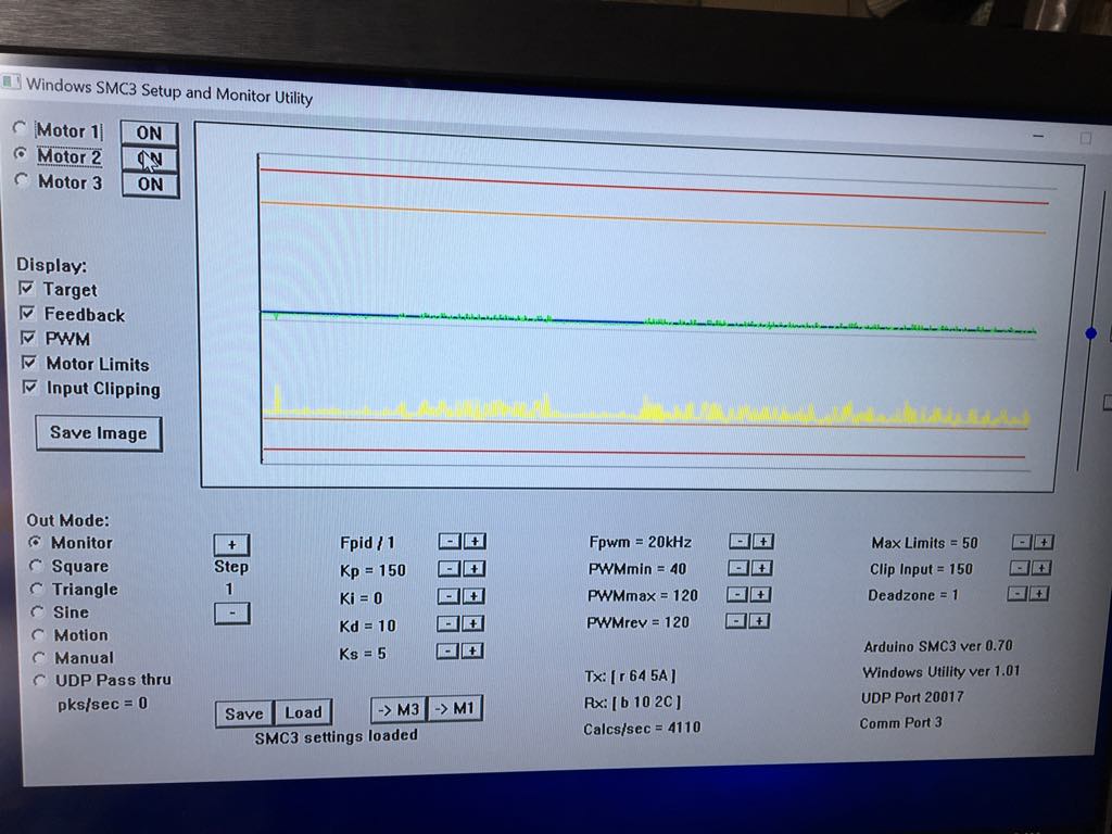

    SMC3 Settings for each Motor : Higher Kp caused jerky operation
    21,555
    150,950Coins
    +11,025 / 56 / -2
    The Dir boxes are normally one checked and the other unchecked (as you have them), but they should be opposite for sway and roll (sway should lean away from a corner, roll is set opposite that).

    +35 / 0 / -0
    After reducing Kp to 150 - Much smoother movement

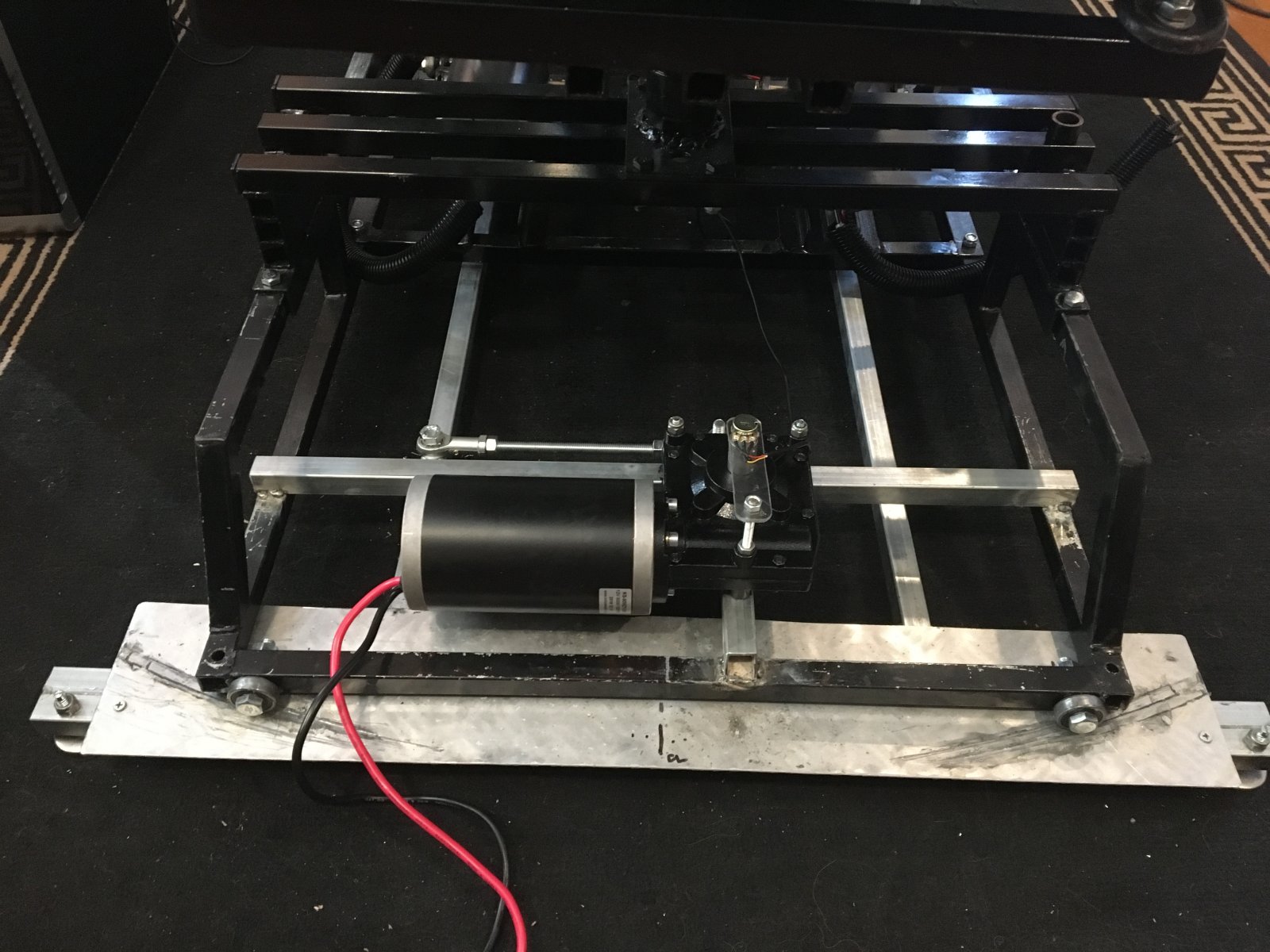

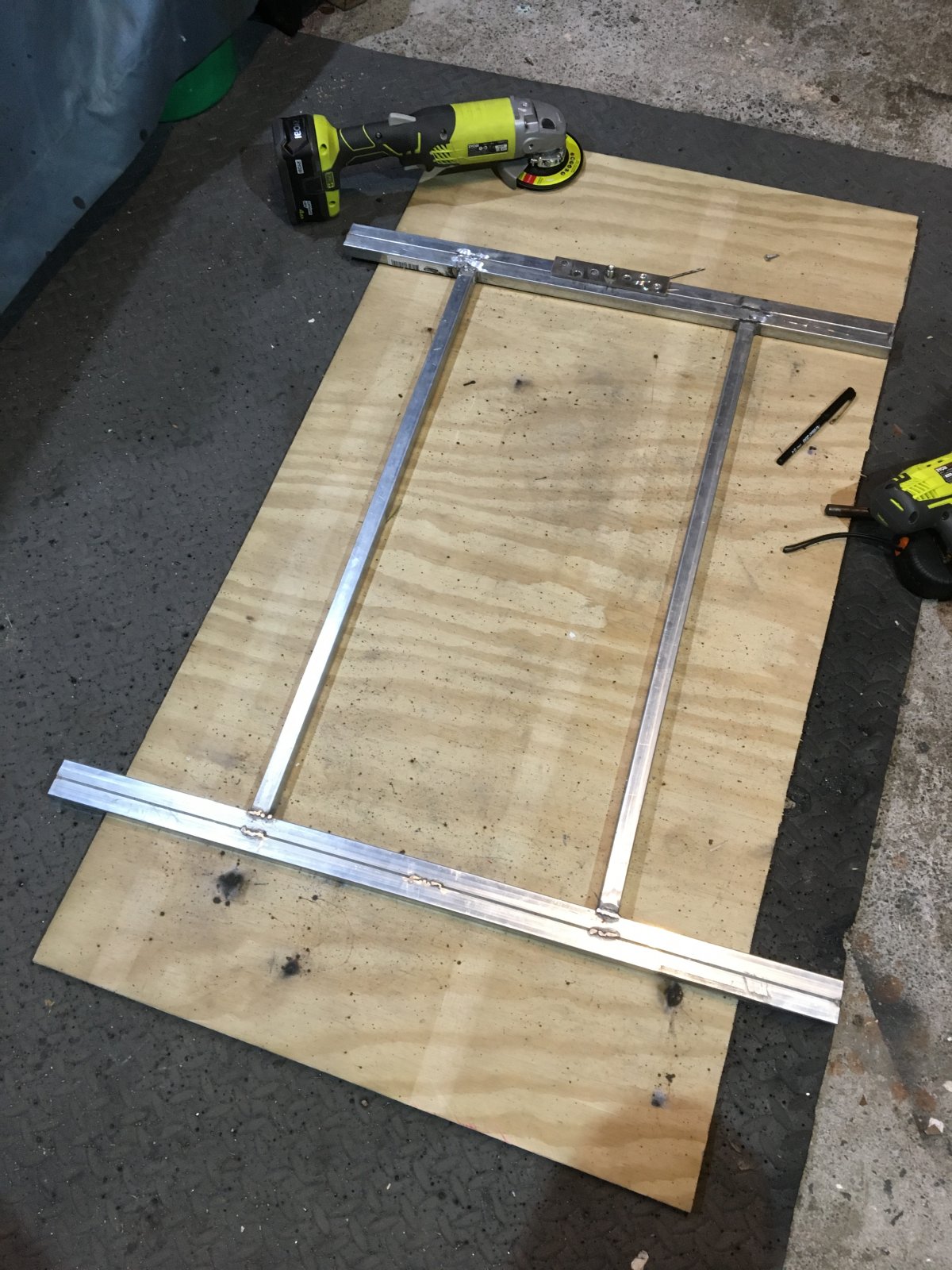

    Building frame for traction loss motor
  18. Petemnz
    Petemnz Member
    Aug 23, 2019
    53
    Sparky by Trade
    Auckland, New Zealand
    60Coins
    +35 / 0 / -0

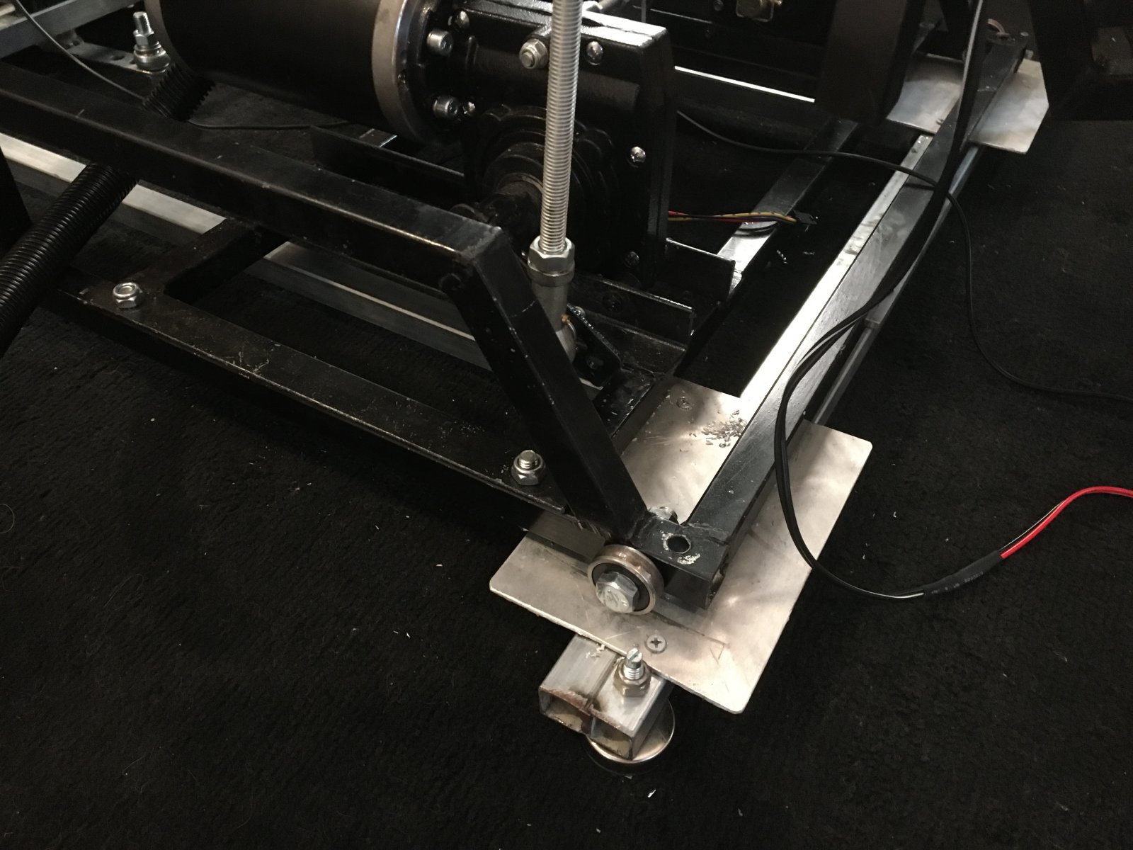

    Frame completed.
    Aluminum sliding bed is to soft - so need to upgrade and angle wheel bearings

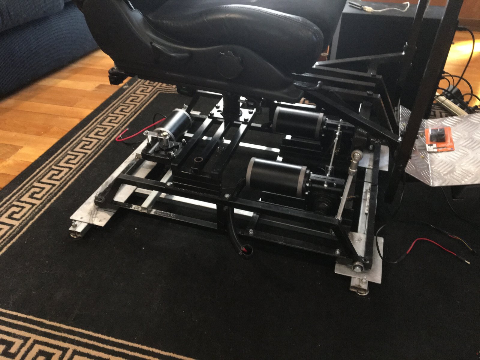

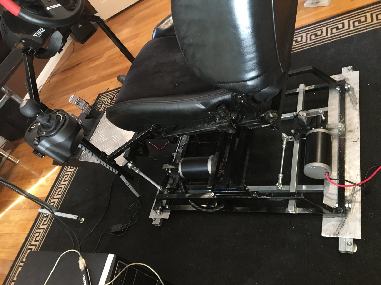

  19. Petemnz
    Petemnz Member
    Aug 23, 2019
    53
    Sparky by Trade
    60Coins
    +35 / 0 / -0

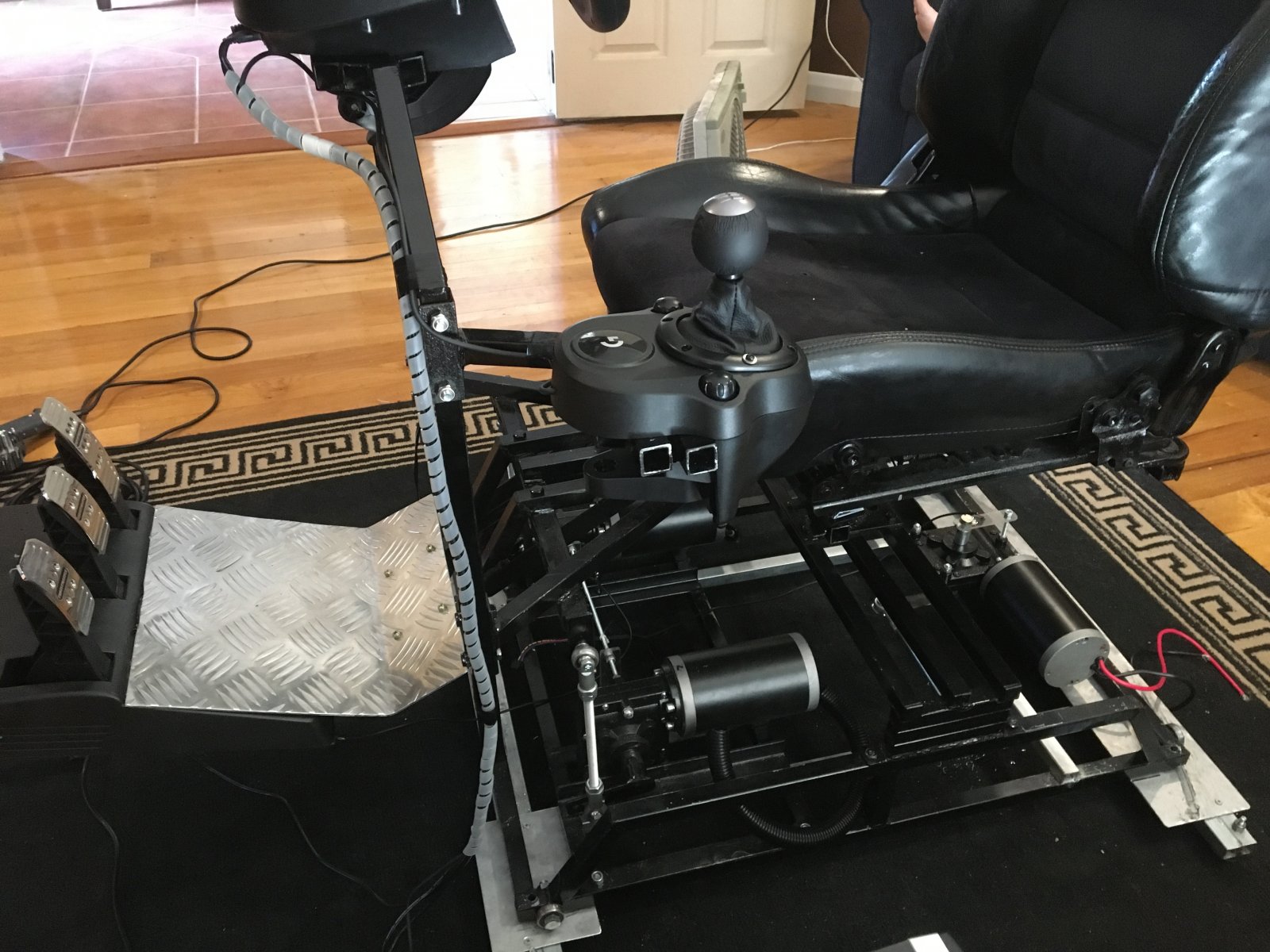

    Completed frame with motor installed.

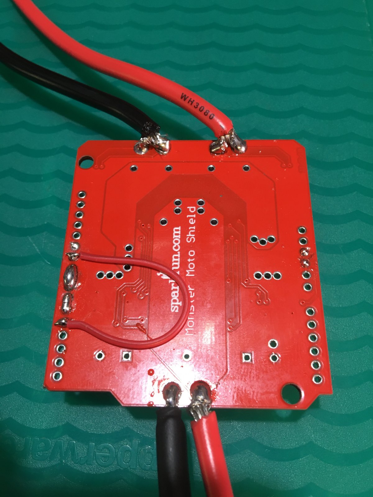

    Fitting additional monster motor driver.
