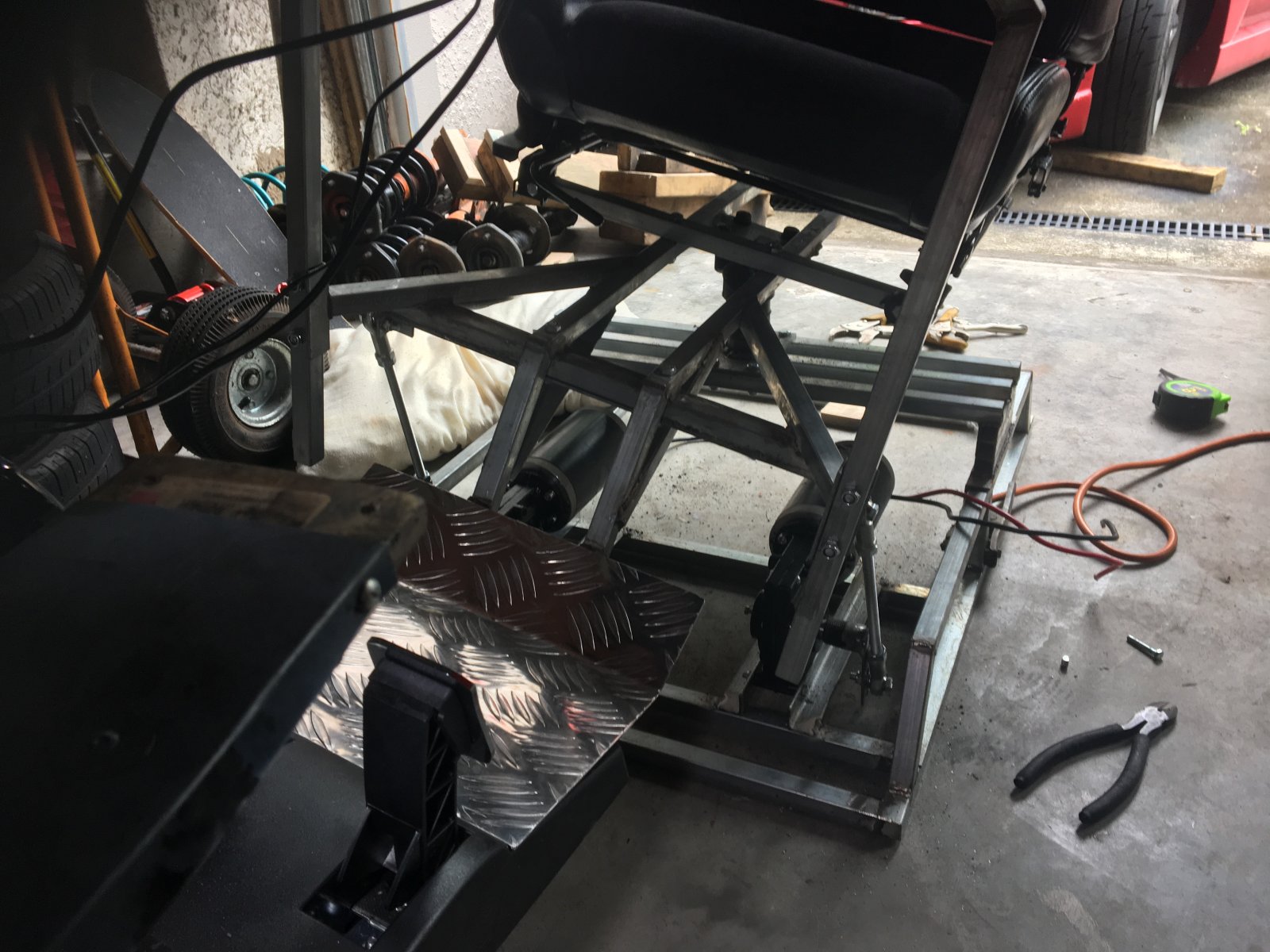

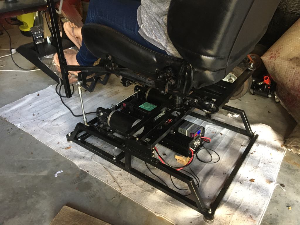

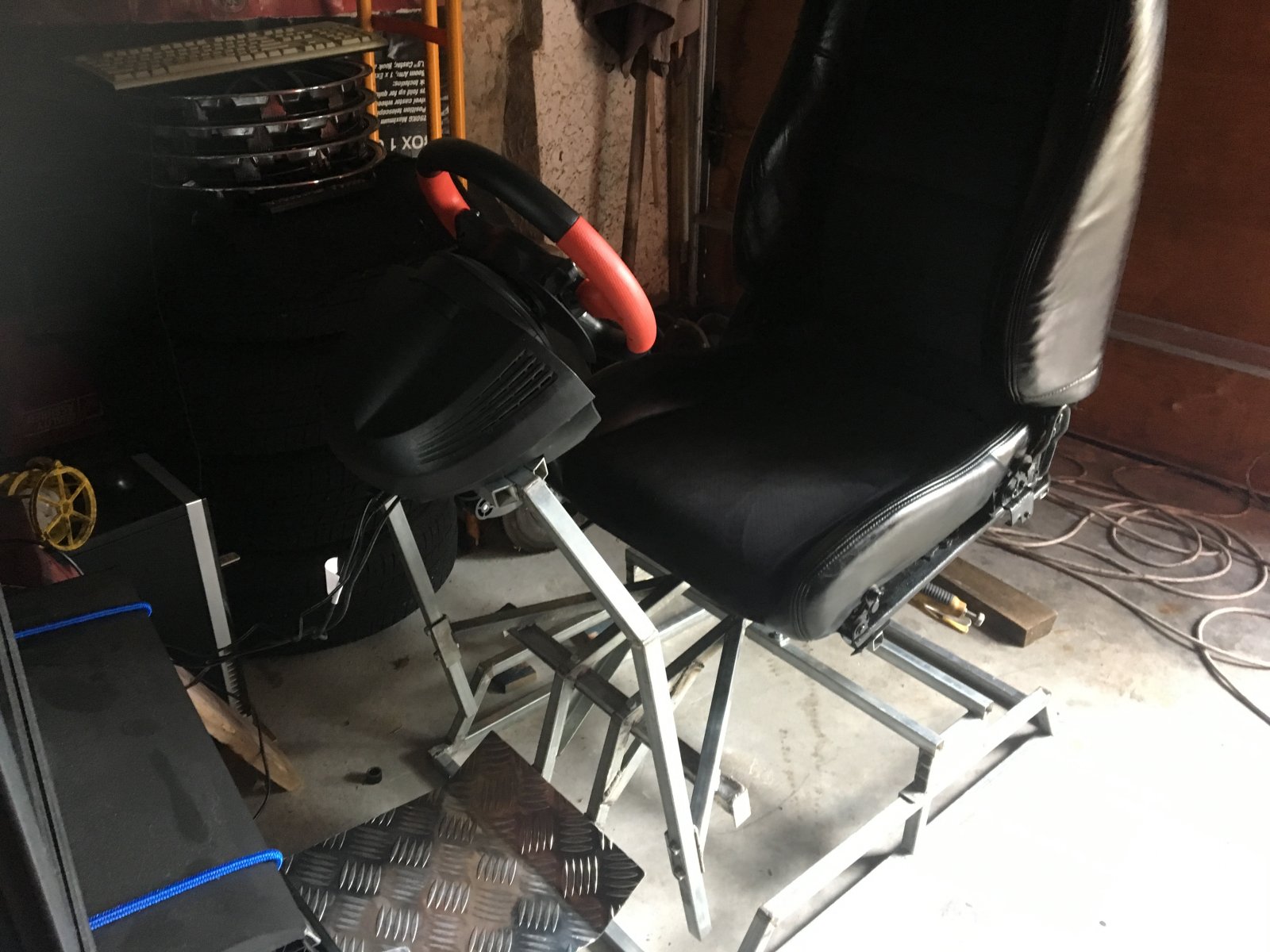

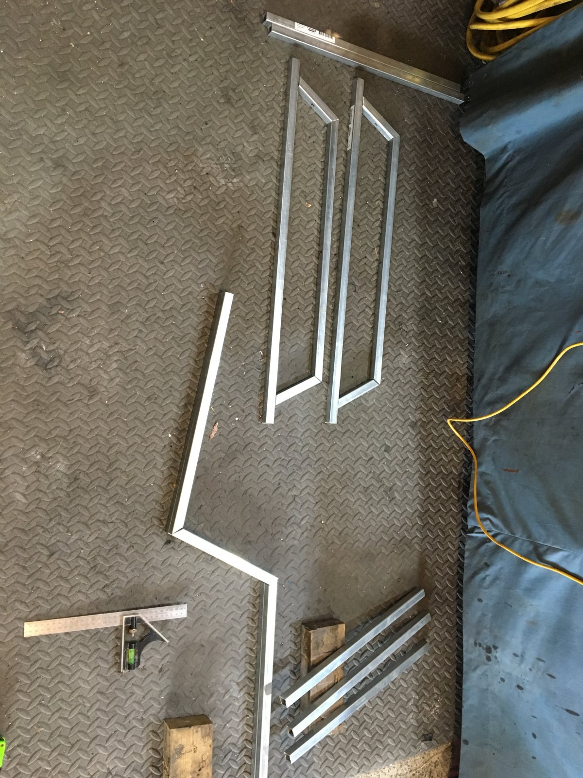

    After reading thru this site I decided to build my own sim. Settled on a design with the motors driving under the seat front. Built as 2 DOF first and add rear slider traction loss at a later stage. Brought a welder, wish I'd brought one years ago.

    Arduino UNO ebay $6

    First time welding, so pretty happy with result. :thumbs

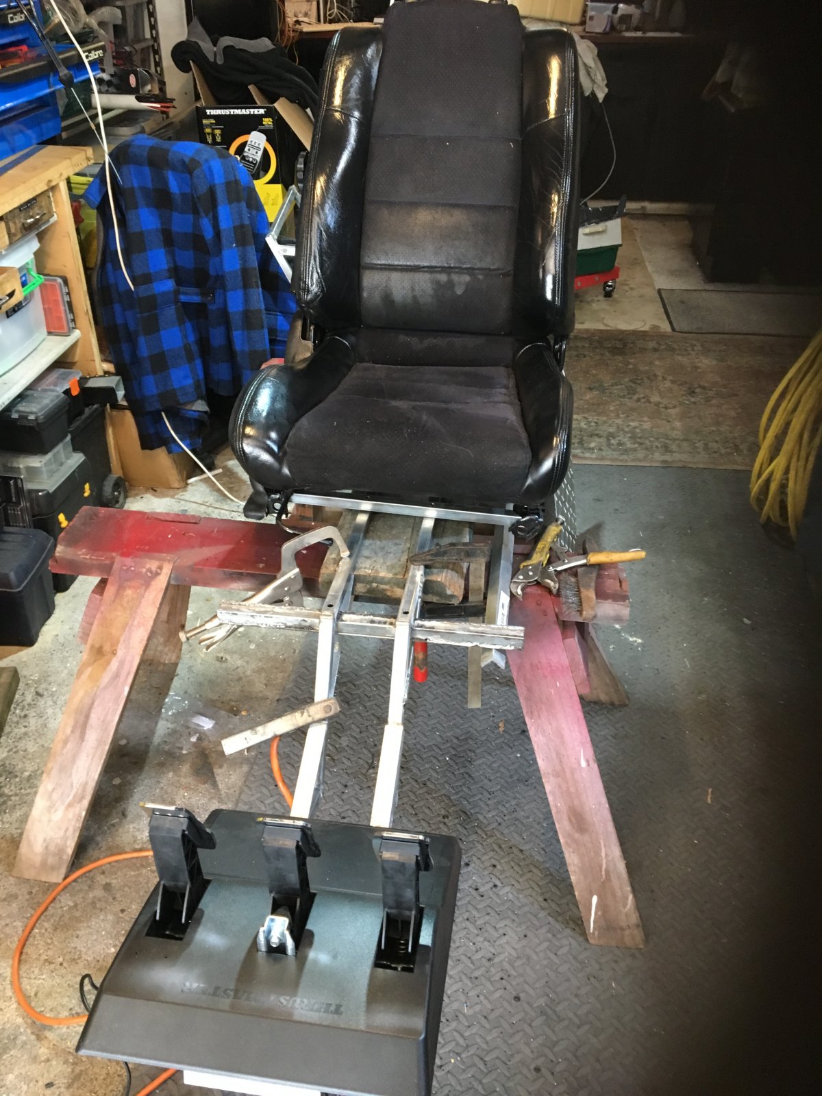

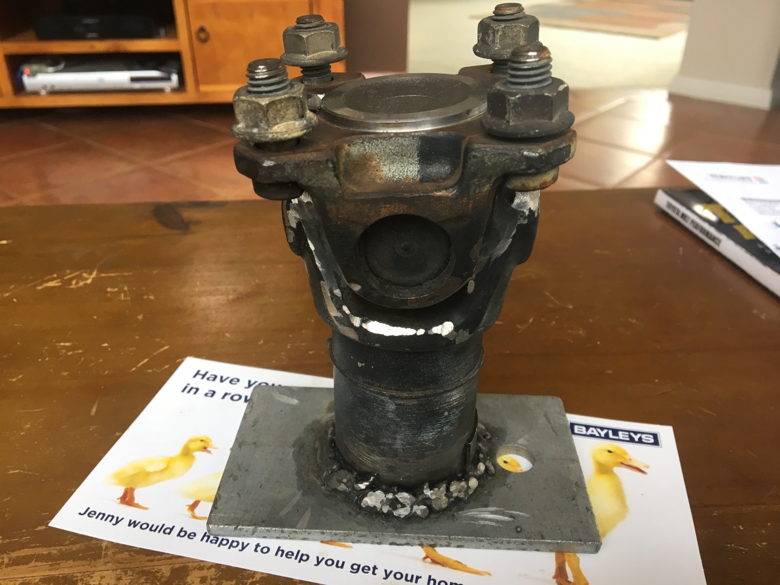

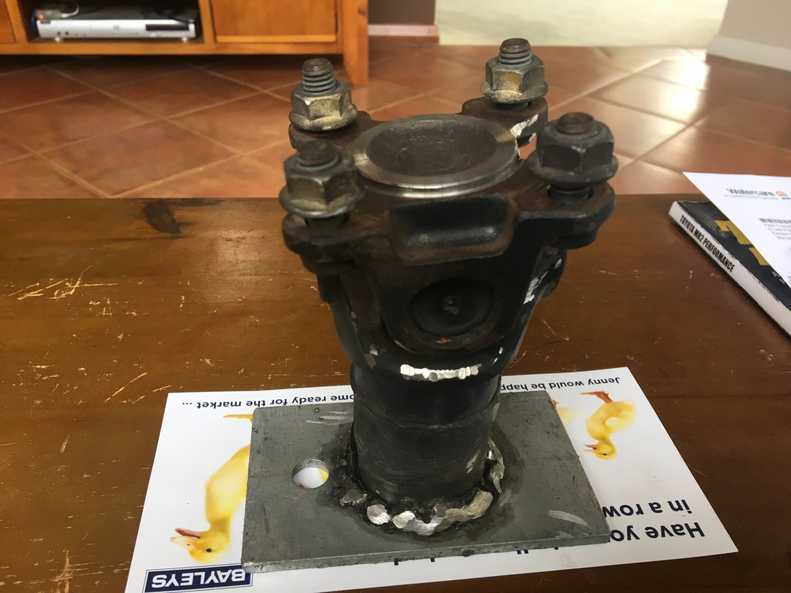

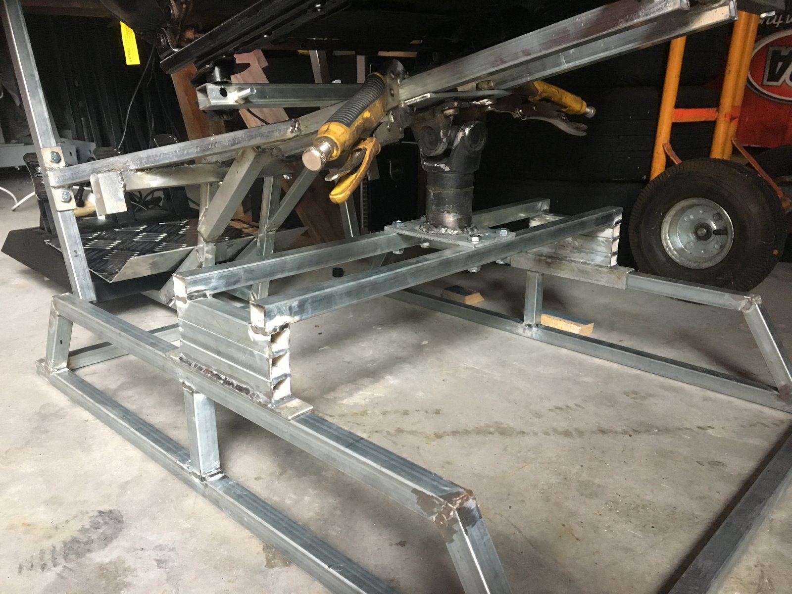

    Went to the wreckers today and removed a drive shaft from a 3 series BMW for my universal - cut to size with hacksaw and welded to steel plate from local hardware store (Bunnings). photo's show trial position , need a hand to find balance point.

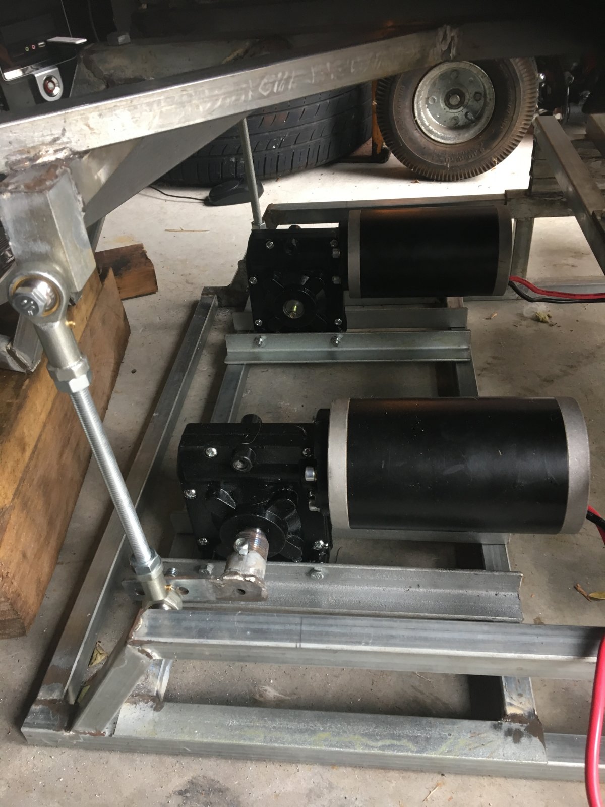

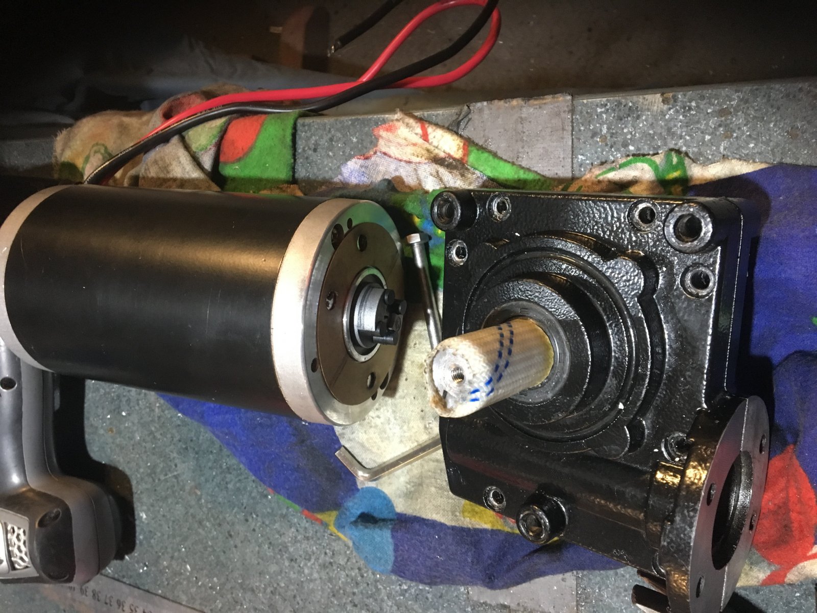

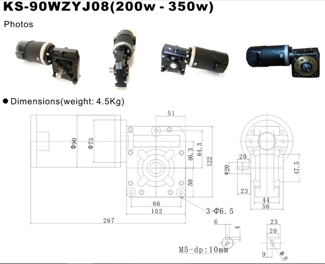

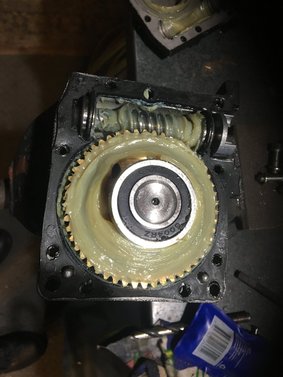

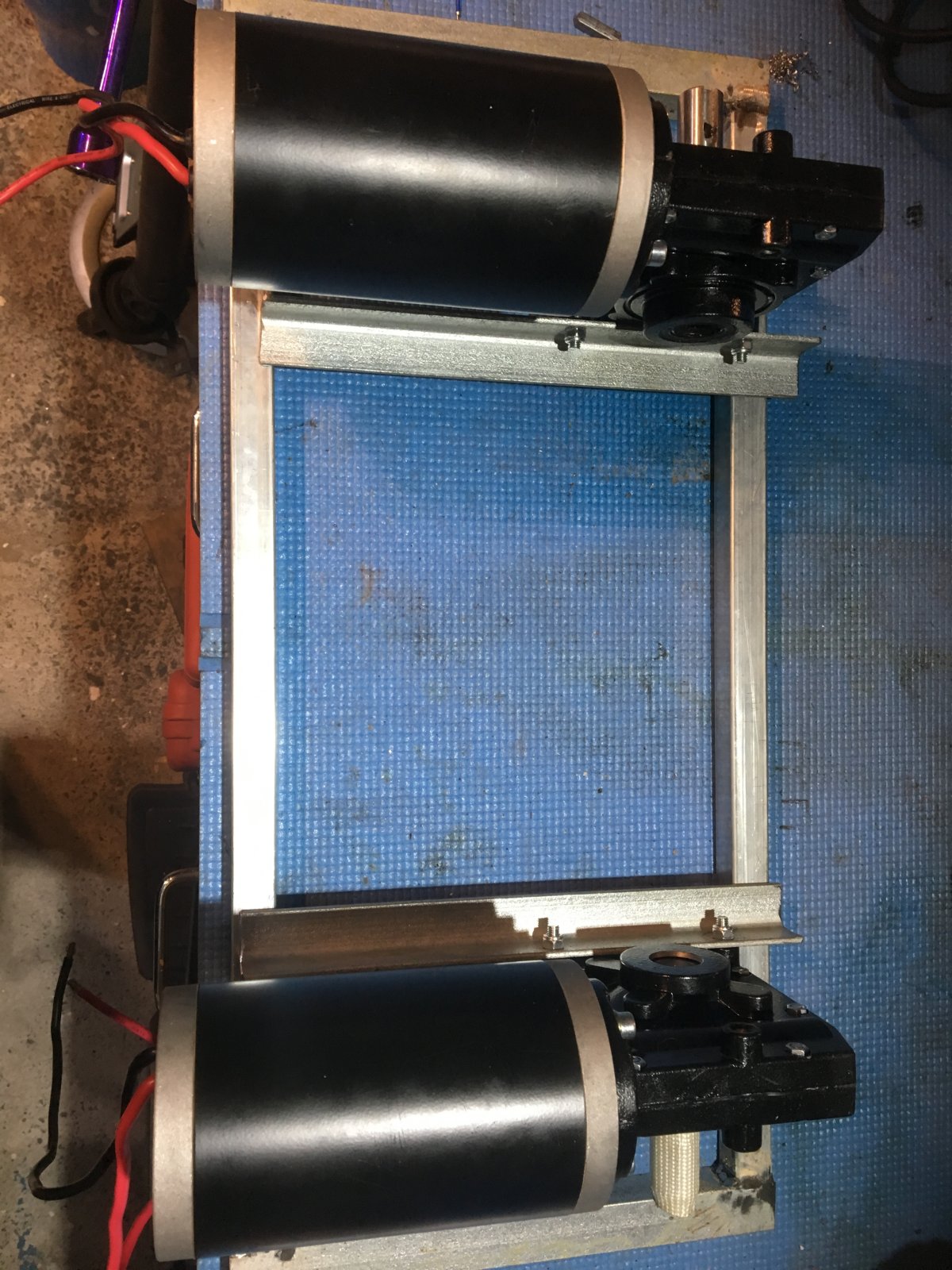

    Got the motors today upload_2019-9-28_20-18-49.png upload_2019-9-28_20-19-24.png
    Punched the rivets out of the gearbox and used a hole saw to cut hole for the shaft on other side of gearbox and made into lefthand box. Metal gears looks solid no backlash.
    I should have ordered left and right hand gearbox in hindsight. :)

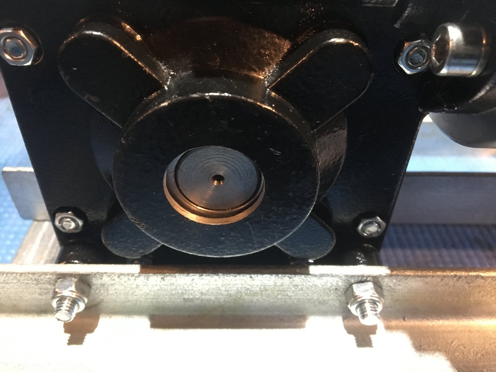

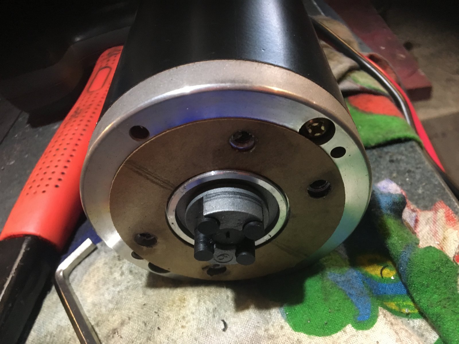

    Open gearbox - brass gears is a good sign.

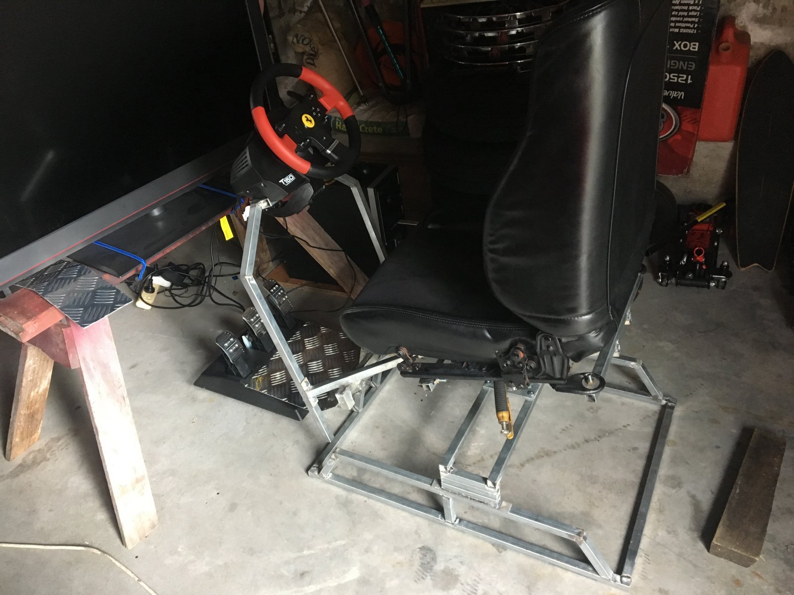

    Testing seating position :)

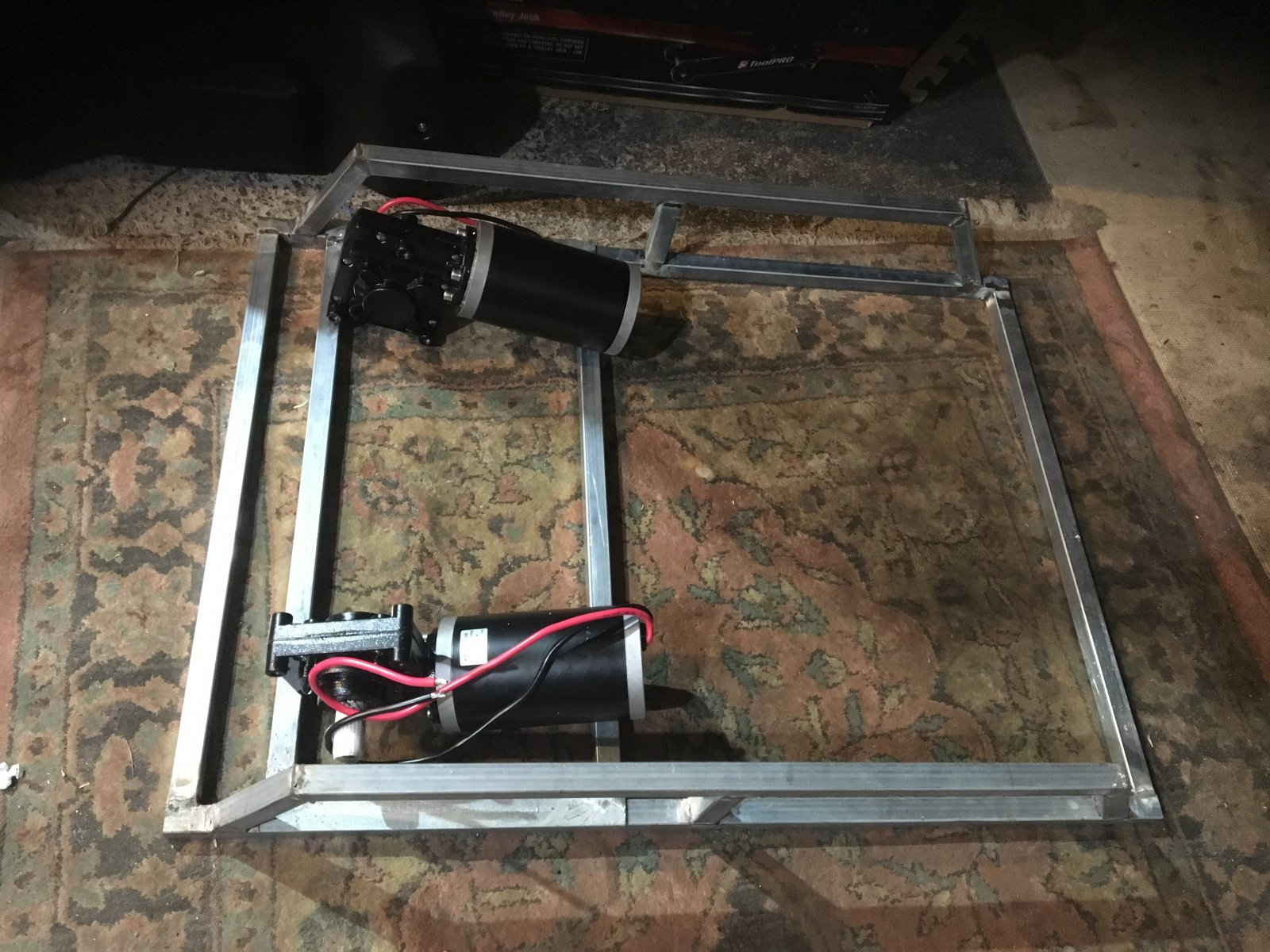

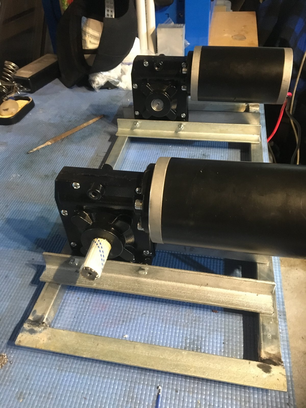

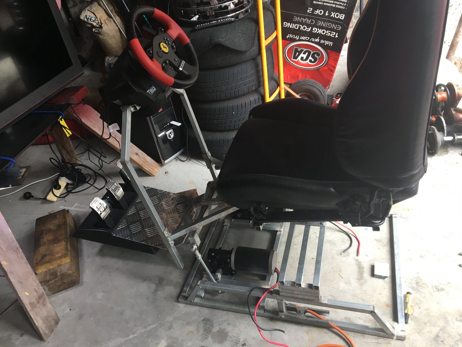

    Deciding on motor position and motor mounts.

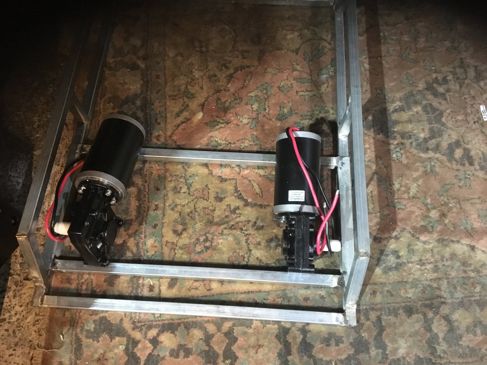

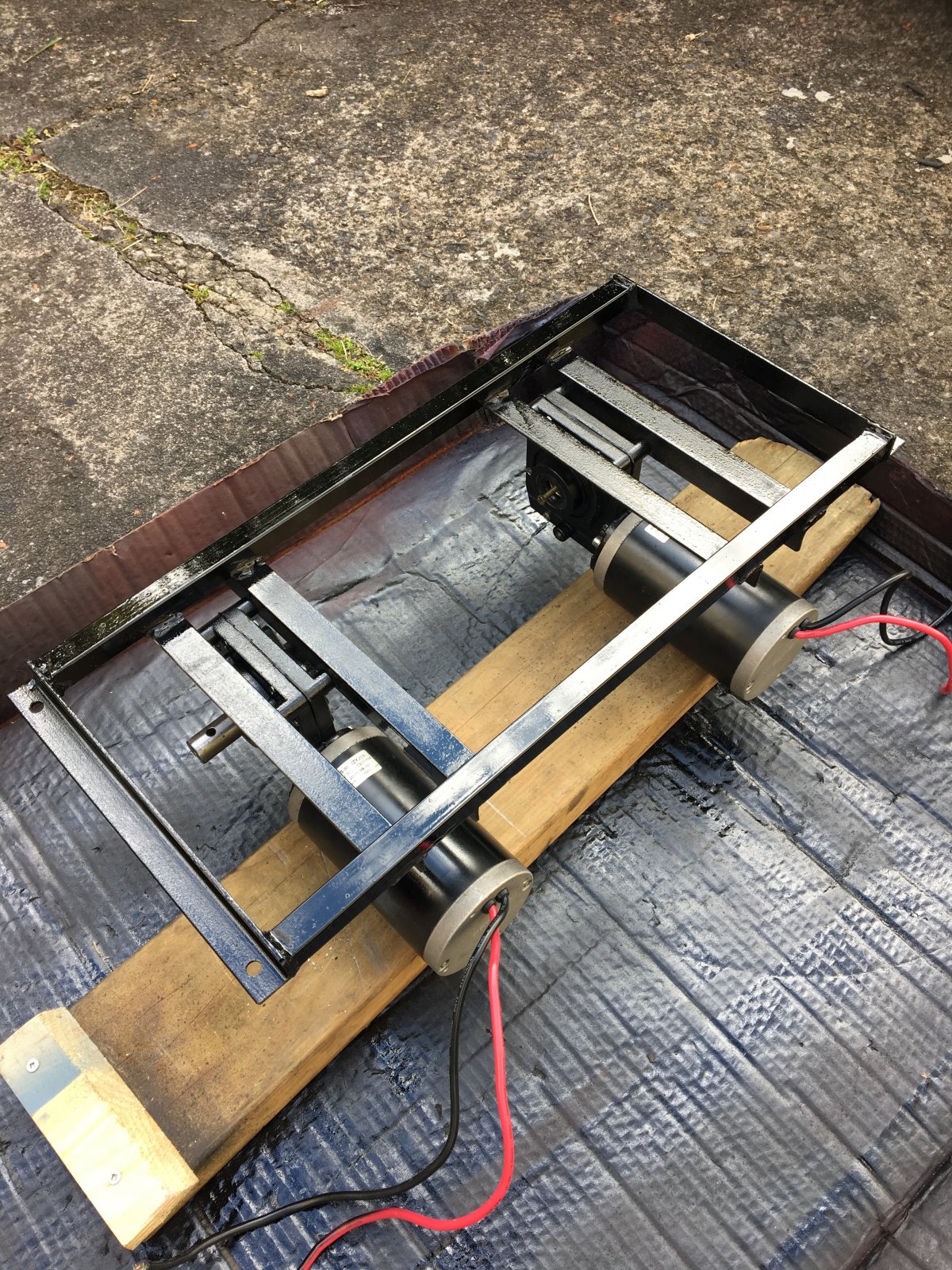

    Motors mounted to 3mm angle - will drill holes in frame once final alignment to seat made.

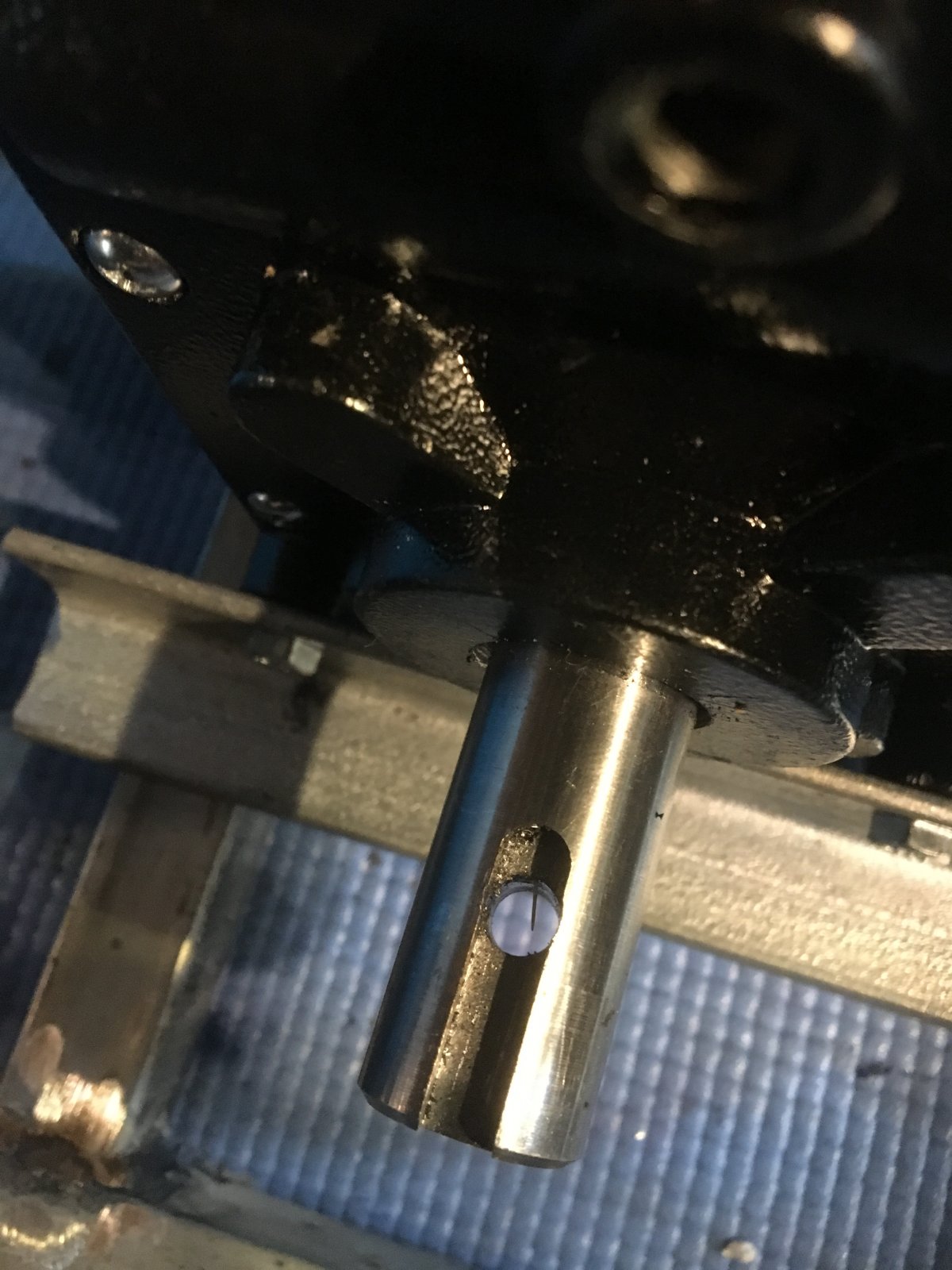

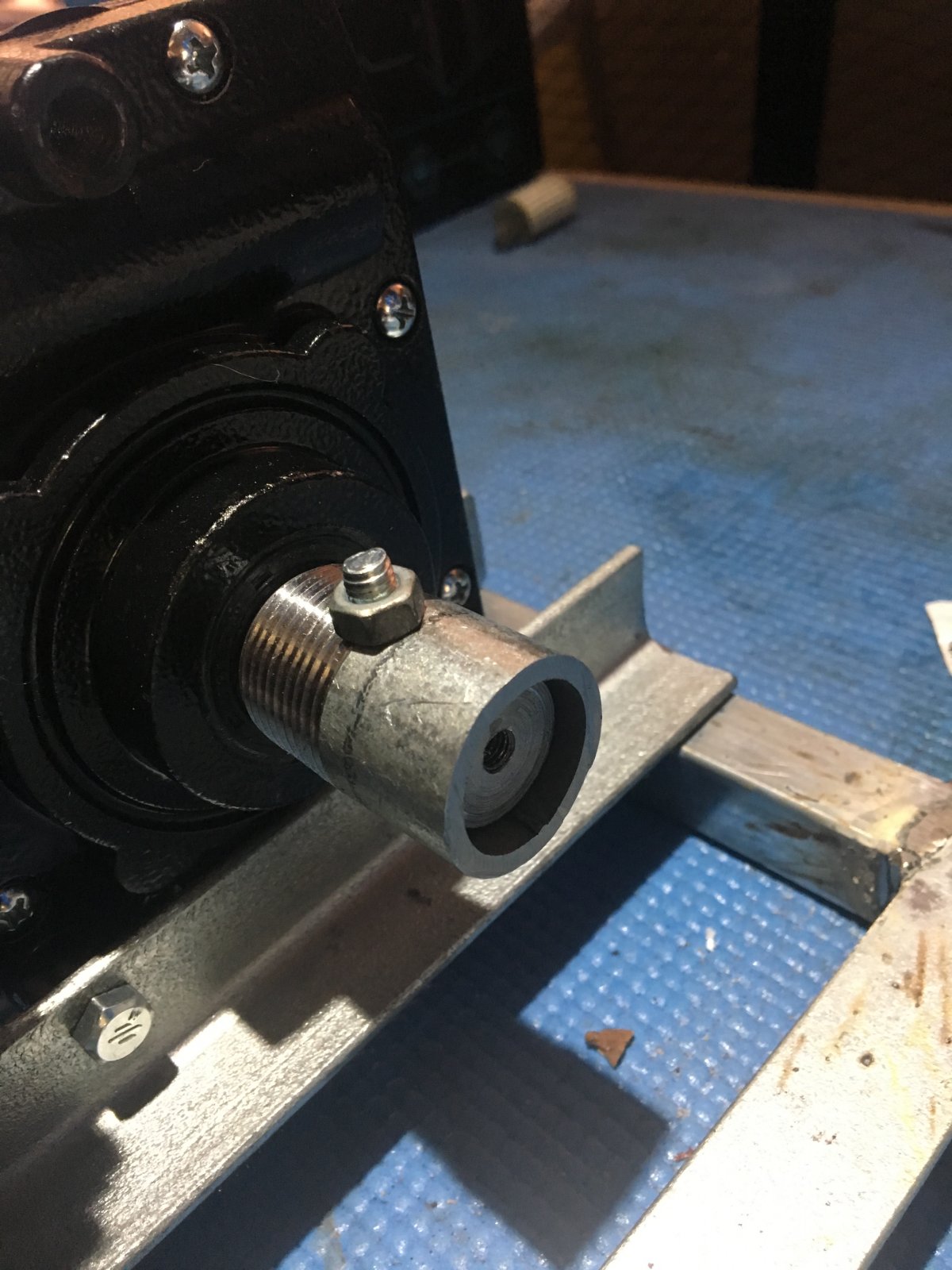

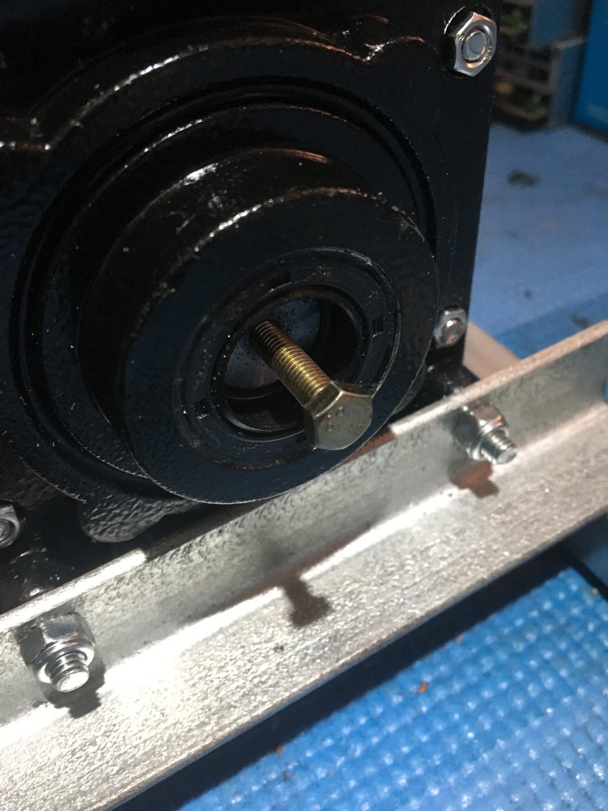

    Drilled & tapped M5 bolt into motor shaft to connect to pot.

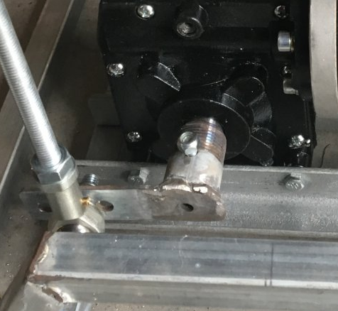

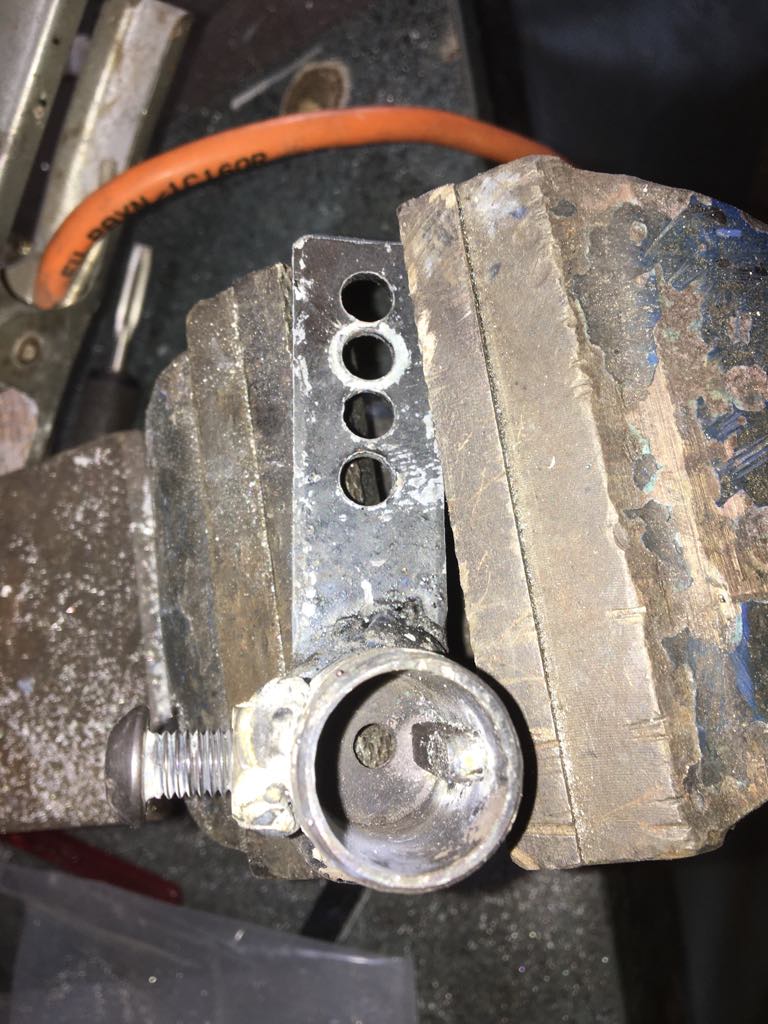

    Pipe sleeve bolted to motor before welding turning arm. ( Don't do this, it needs to be a key way or you will get to much play, I learnt the hard way).

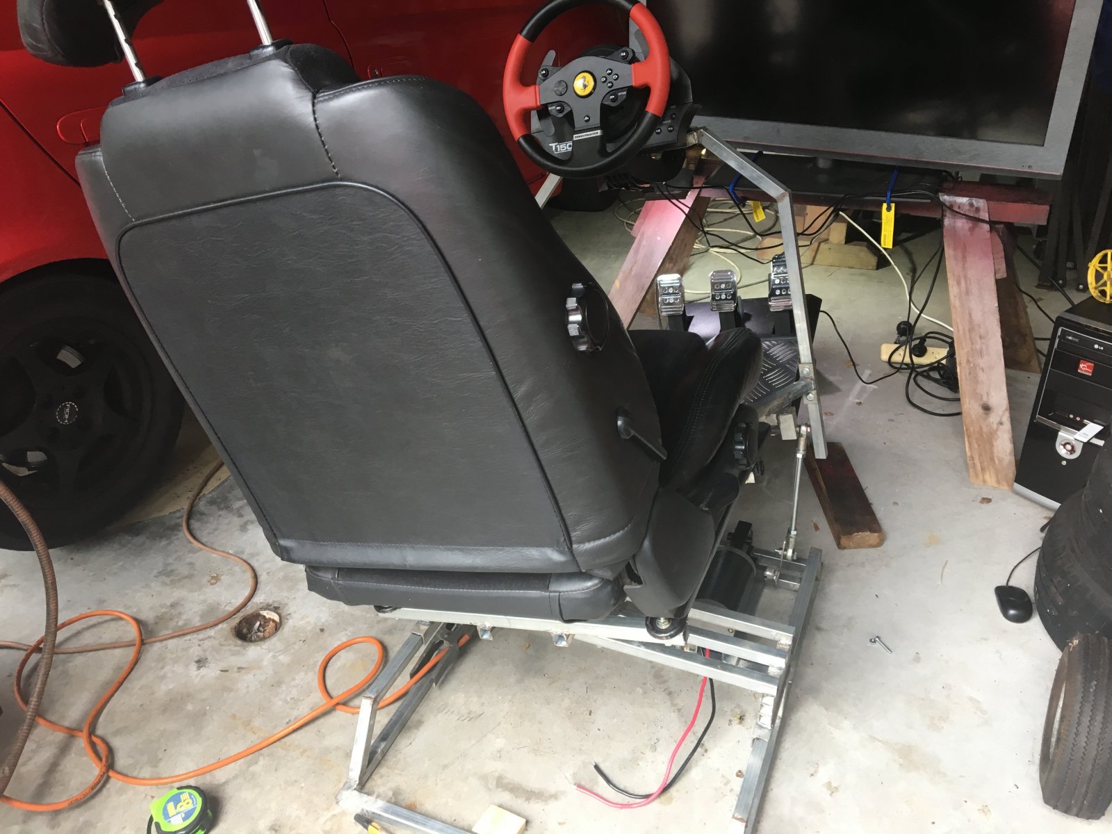

    Mounting motors and turning arms - checking motion limits, roll 12 deg, pitch 8 deg.

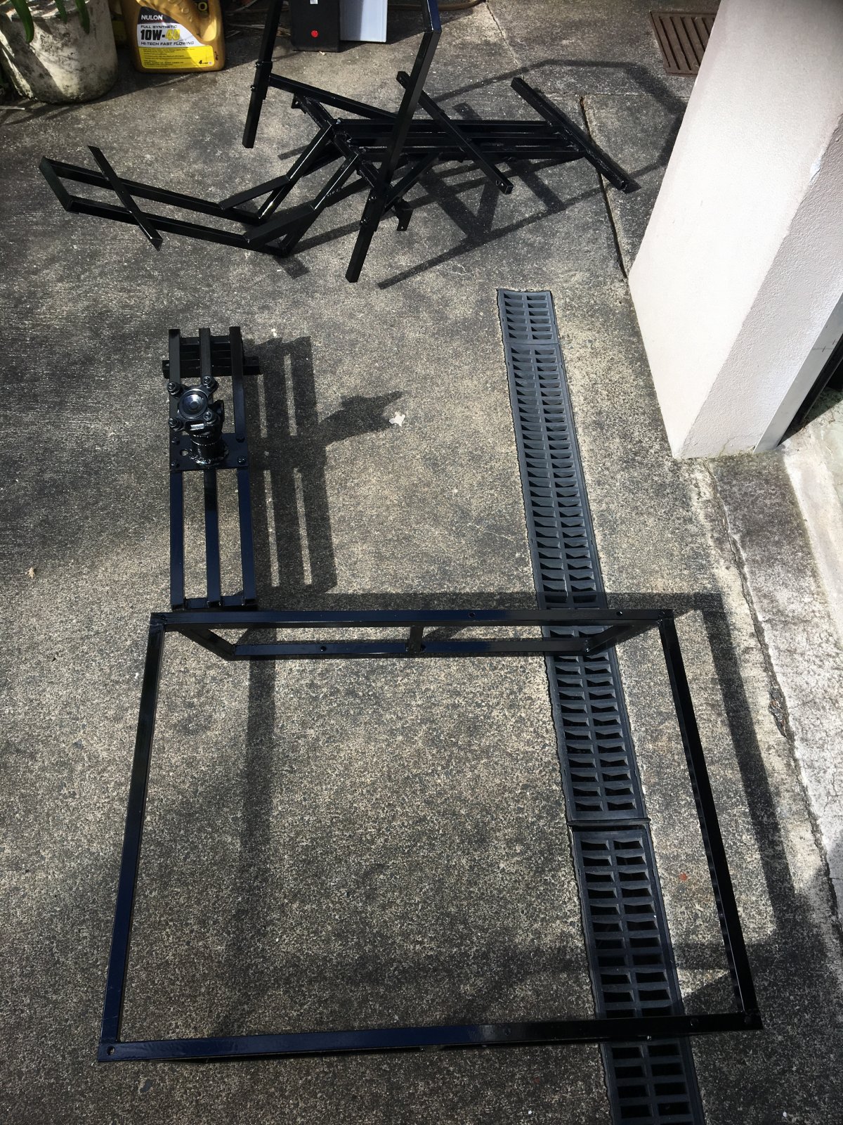

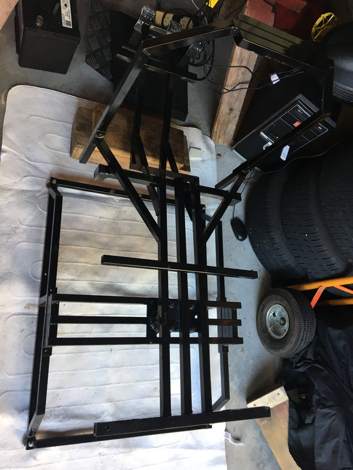

    Dismantle, paint and rebuild.

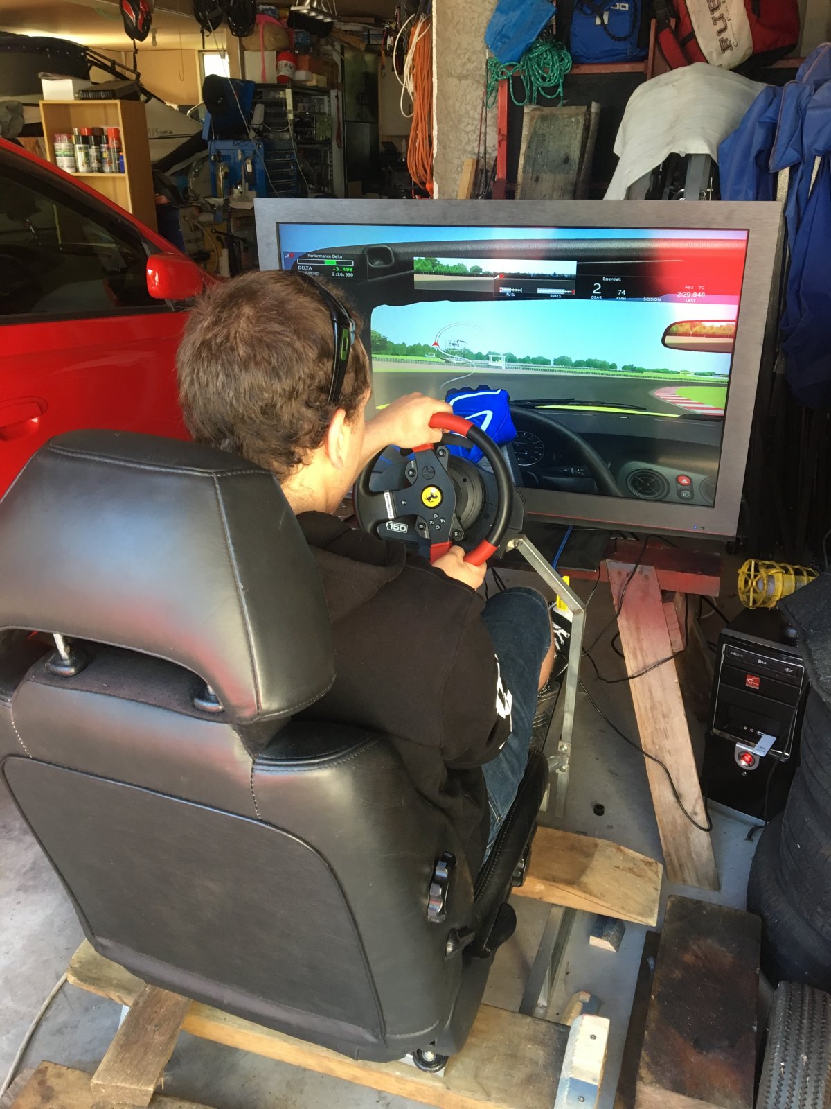

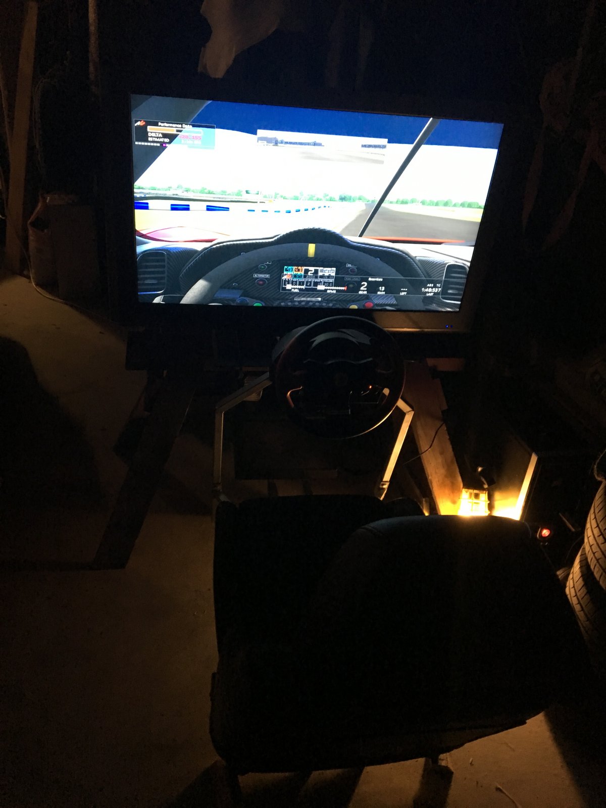

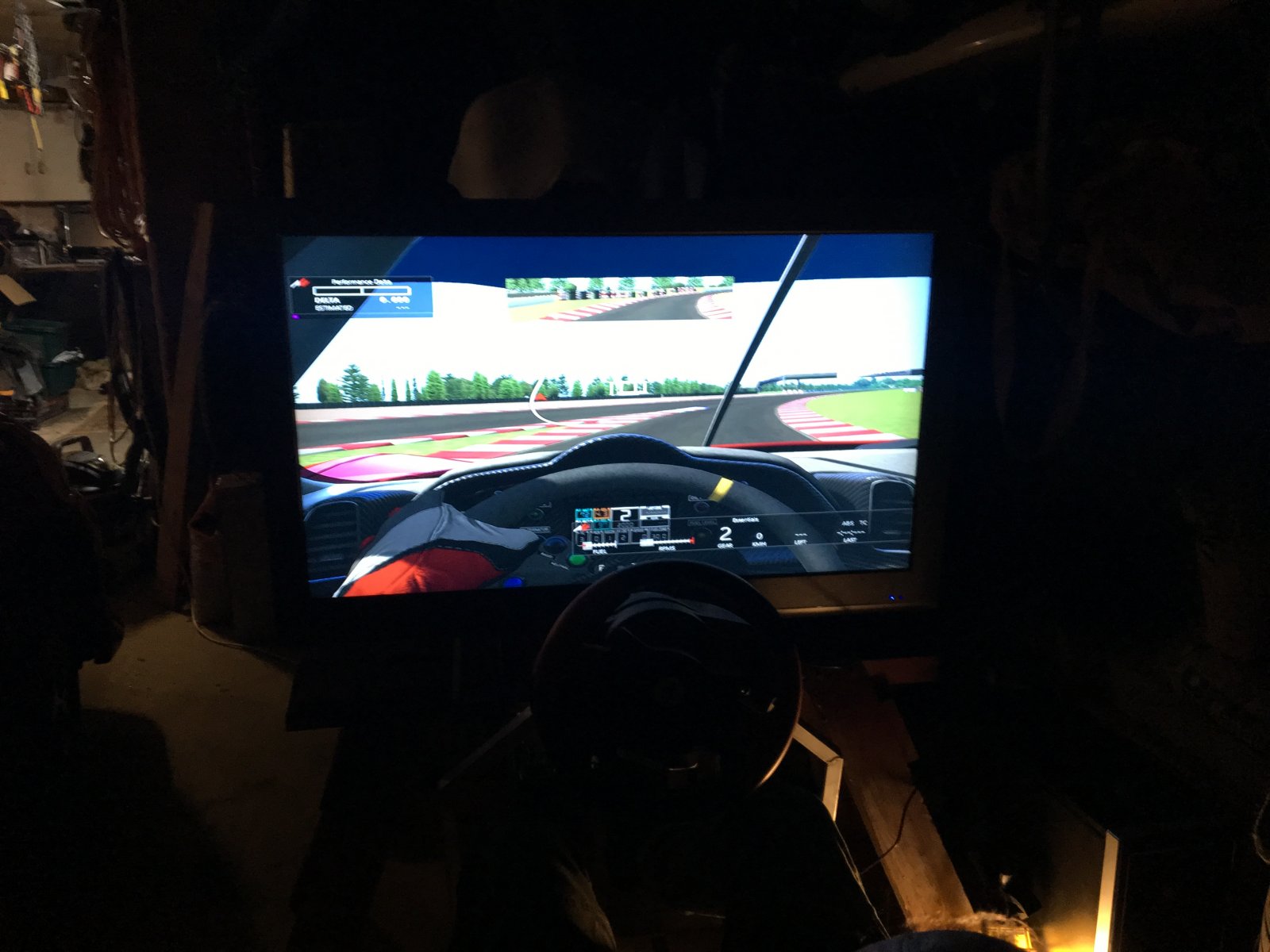

    Testing wheel and pedals on local track :)

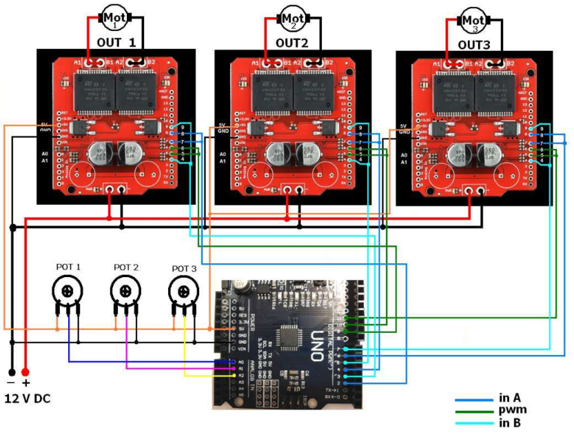

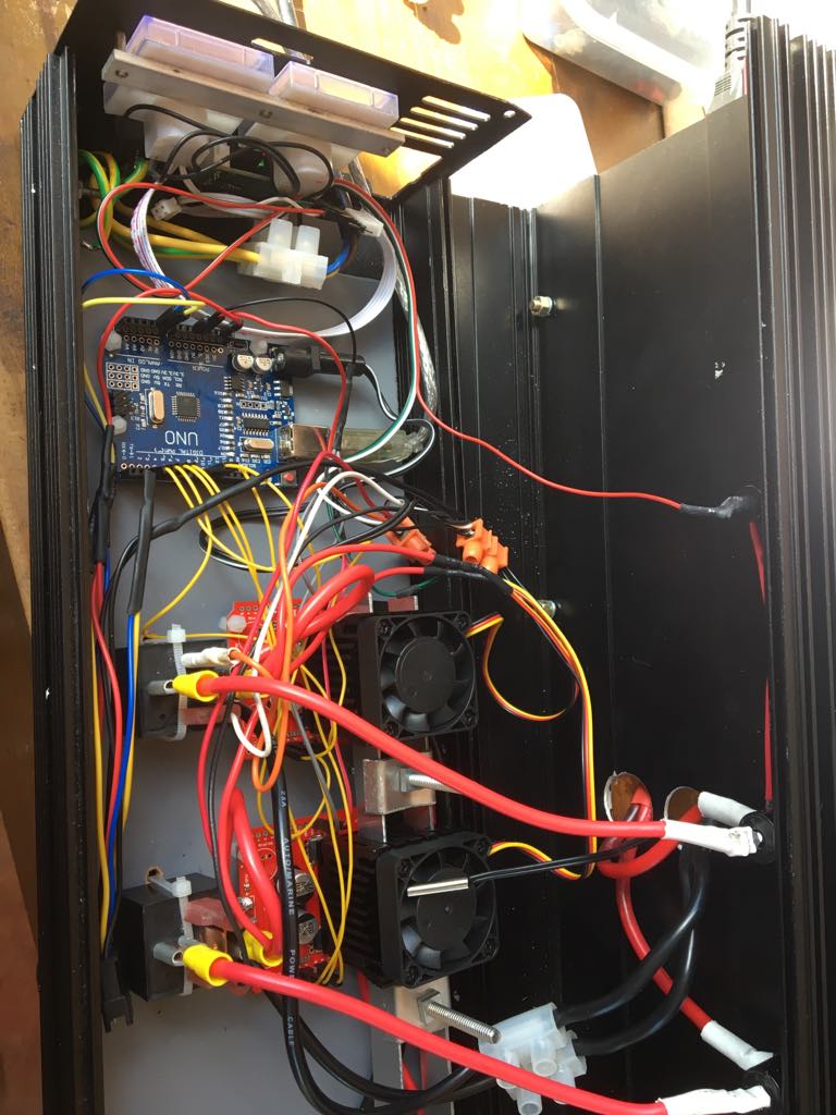

    Finally got back into it, the Monster Moto Shields took 2 months to arrive, lucky I ordered 4 as one was DOA . I suspected as much when the motor moved, even when I had turned all PWM to zero. Luckily the other one worked as expected and I used it to test both motors and pots before changing to a new Monster Moto Shield. All tested ok with SMC3 so setup on simtools demo and LFS once I got the interface working with help from https://www.xsimulator.net/community.
    Below is the wiring setup I used to parallel up chips and increase current handling thanks to another helpful post.

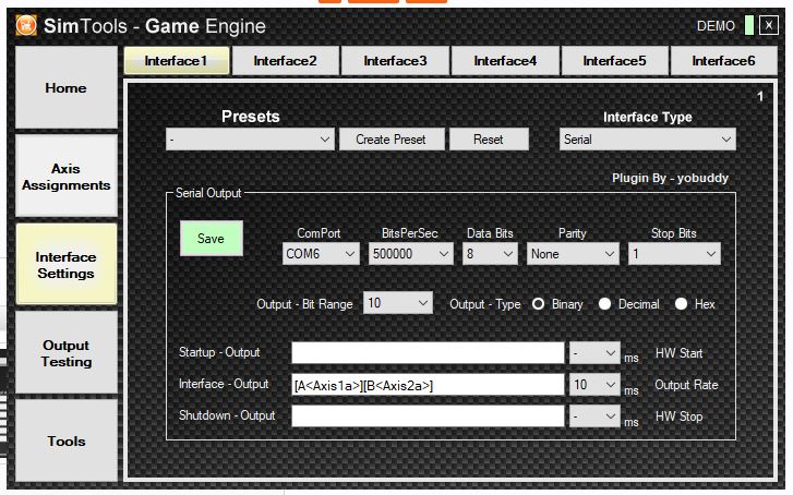

    Simtools setup with Arduino .
    Pic 1 - monster moto - link pins as wiring diagram
    Pic 2 - Simtools Interface setup - Note your com port could be different.
    Pic 3- Old UPS control box came in handy

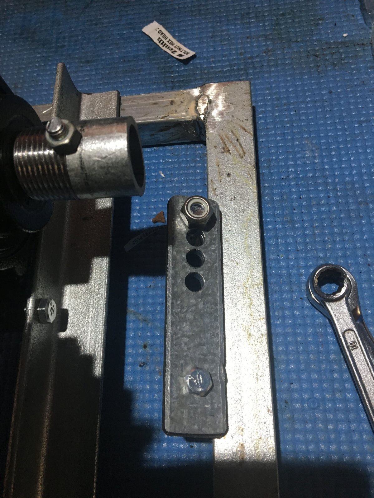

    Next issue - these couplings have to much play I need to use the key way. (it bent the stainless bolt) I should have known better but was in a hurry to get it all working.

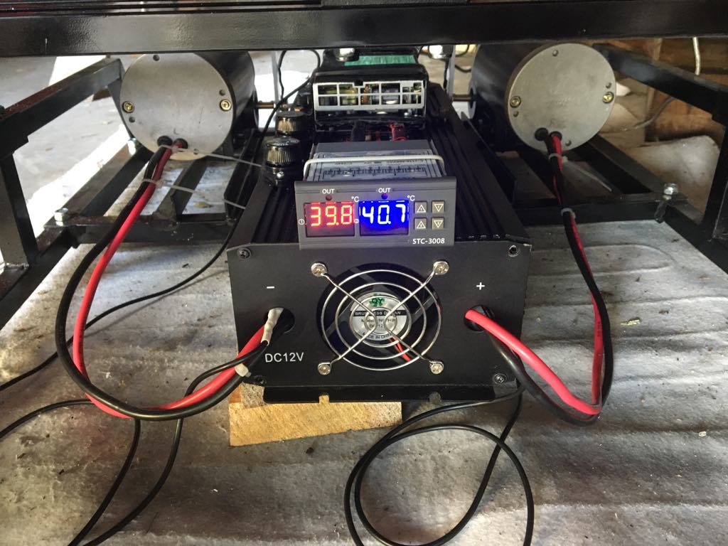

    Another update after refitting keyed levers and fitting control box to frame.
    Wife testing :)
    Heat sink temps on chips.
    I'll put grommets in holes and tidy up cabling later, but keen to test out first.
