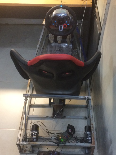

    Hello! I present here my project in test state. At this moment I am in the test stage of the forces of the motors, measures and heights of the seat, steering wheel and other components. I am using an Arduino UNO R3 board, and a Monster motorshield board. The initial configuration is done with SMC3Utils and really is an amazing application for ease and simplicity. You can see that at the moment is a simple cockpit since I do not want to waste materials so for now I'm recycling some old pipes to understand the mechanism well before making the final version.
    My son and I are very happy to have done this and the best part is that it works! We are very excited and we will make some upgrades to improve performance.
    Then I share some pictures so that I can see our little Frankentein. Regards!!!
