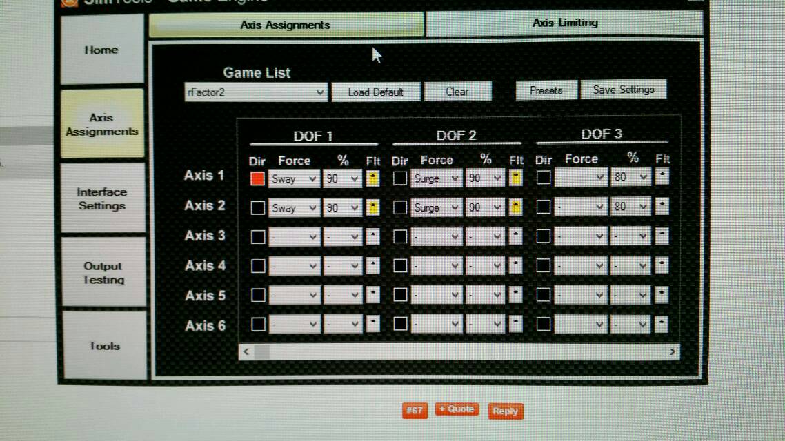

    2DOF, JRK
    Only simulate G forces no Roll.

    You can propose you a more appropriate settings for rFactor2?

    Recommend that you try a balanced Axis assignment, that totals 100% of Axis Movement.
    I mix Roll , Pitch, Surge, Sway, Heave all at 20% of Axis Movement , doing this you will never loss any detail in the motion profile.
    Some run higher values so the total axis movement is above 100% which is impossible to output so when your sim is near its extremes if another force is needed the motion cue is lost because it pasts 100% of the Axis Total Movements.
    Now with my Axis decided , I then run the game in a window and the tuning centre and tune my forces/angles to what I feel is right. The given Min/Max's in the tuning centre are only examples , some are way out, sorry.

    Sorry to make it clearer
    2DOF - with 5 Deg of forces , I set.
    Axis 1 Roll 20% Pitch 20% Surge 20% Sway 20% Heave 20% - Totals 100% of the axis used.
    Axis 2 Roll 20% Pitch 20% Surge 20% Sway 20% Heave 20% - Totals 100% of the axis used.

    I tried your settings, but feetback the very mild, they are not Summing thoughts about me, I only see that every move that shaft 20% of the total.
    And forgive, and con That's my inicial configuration Hecho video is THIS:
    And another question, "ROLL" which has an axis invert as with Sway, no?

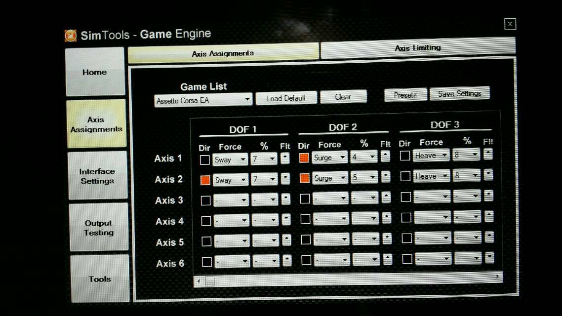

    @all: I suggest to open a dedicated FAQ thread, the information provided by @eaorobbie is completely new to me as well. After months of testing I am running my forces under 20% using low values in the tuning center (except for TL, one force = one axis = 100%). Not to forget my levers mounted on the motors are very long (15cm = 5.9 in) and already mentioned in an other thread I do not like way long movements (especially heave) for racing, but IMO the seat should move in the same way as the car on the screen does, neither less or more.

    I added this to my setup and tested the correct movement of each axis. Now the feeling is much more realistic. A much improved thanks your advice.
    N= Normal direction os axis
    R= Reverse direccion of axis
    Axis 1 | Roll N 60% | N Pitch 40% | N Surge 40% | R Sway 60% | N Heave 20%
    Axis 2 | Roll R 60% | N Pitch 40% | N Surge 40% | N Sway 60% | N Heave 20%
    These settings convey realism when upgraded or downgraded or inclination curves and convina well with the G forces Sway and Surge. Only if you have an accident too many forces to the axes are added and can be somewhat violent movement.
