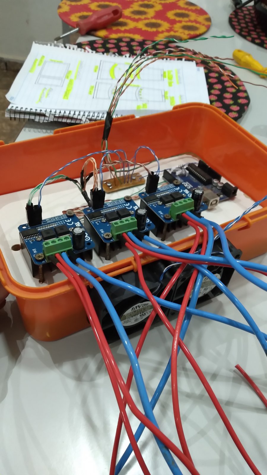

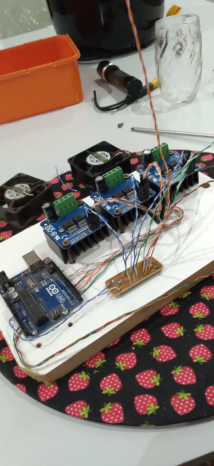

    good friends, i'm new to the forum and i'm building my 2 dof simulator with loss of traction based on some projects here on the forum. These days I've already assembled the electrical part I'm using 3 ibt2 and an arduino uno, I'll be using cleaner engines here where I live I don't have many resources besides being very expensive a better engine, but with time we'll improve, well I don't have much what to say, I'm waiting for tips from you to improve my knowledge, I'll be posting photos of the project over time.

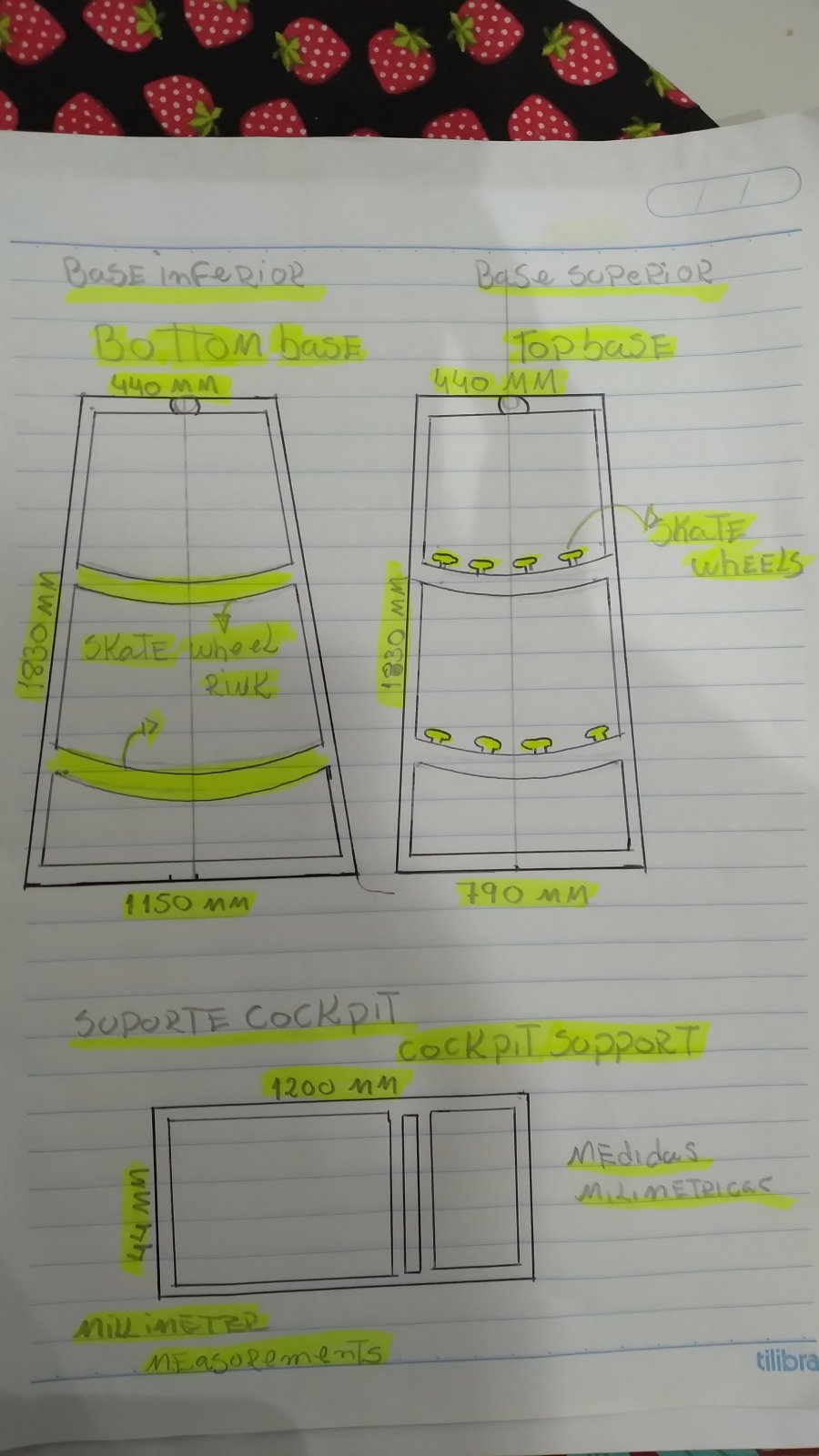

    today I made the measurements of the bases to be made, I will start building the bases right after doing the tests on the engines I am anxious to see them working 20210629_185703.jpg 20210629_185837.jpg

    good friend, today was my engine test, but I think ibt2 burns, I started the engines without configuring, as soon as I started the engines vibrated one of the engines took a turn, soon after that I saw what I had done, configured everything with some tutorial on the page, and so far the engine did not start, ibt2 burned?

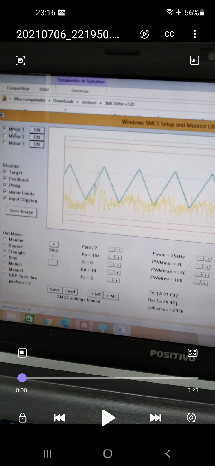

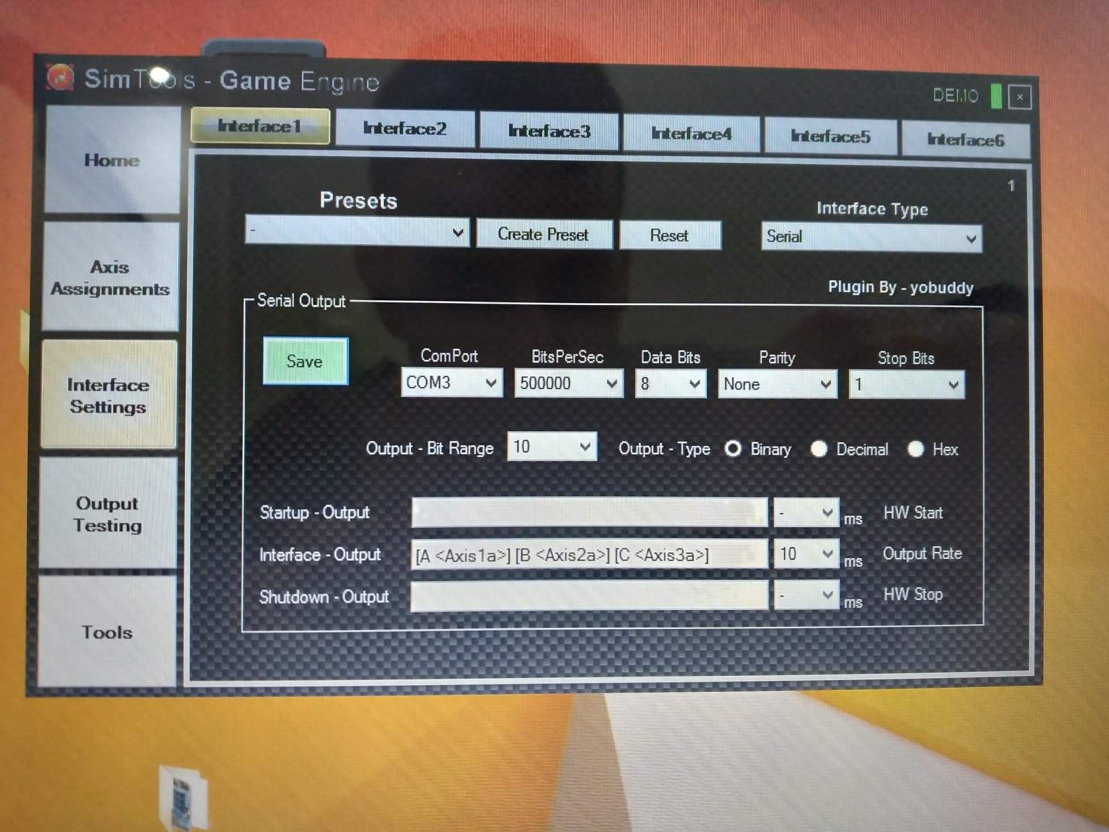

    the smc3 is running the engines what next step? tests the game live for speed more gave no movement, i'm using only one pc have some problems? what do i have to configure in simtools for live for speed, remembering that i just downloaded simtools i haven't bought a license yet.
    20210706_223341.jpg 20210706_223341.jpg 20210706_223341.jpg Screenshot_20210706-231611_Video Player.jpg
