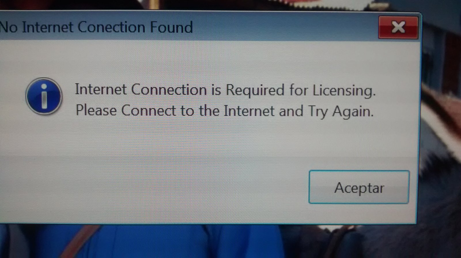

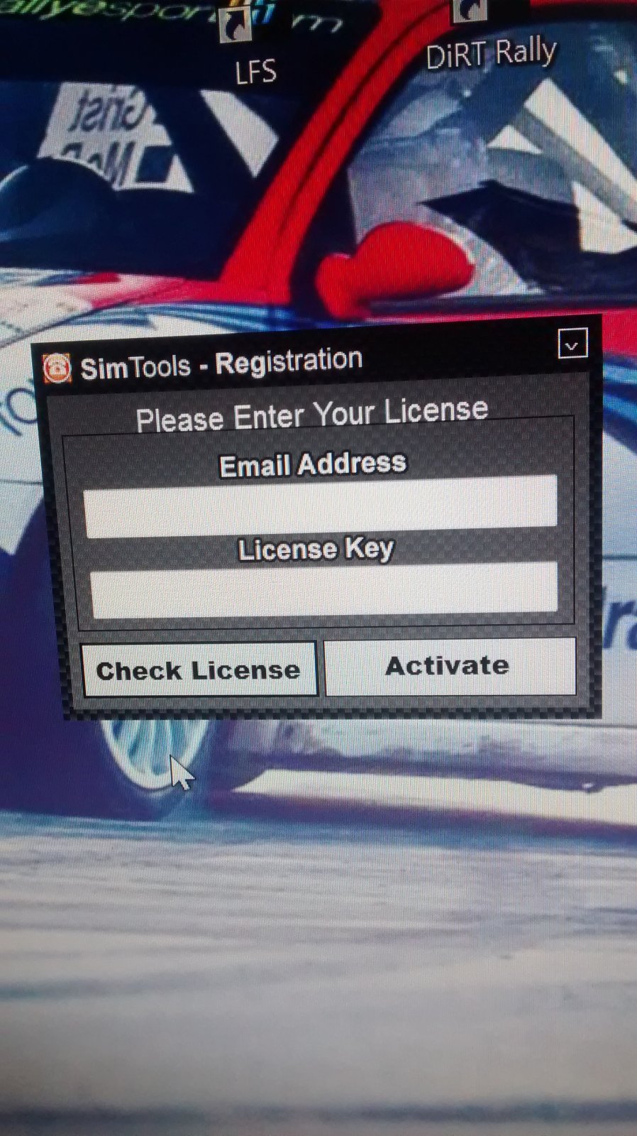

    I have several attempts to register and I have not been able to. I was using Wi-Fi and there was no luck, I brought the cpu to the desk and connected it directly to the network and I was not lucky. I have disabled the Firewall and could not register myself. I do not know what will be happening
    22,185
    154,750Coins
    +11,196 / 57 / -2
    Just checking, you can't have SimTools Game Engine and Game Manager running while registering, they have to be closed and the Registration program can then be started.
    Also are you using SimTools 2.1, as that fixed a Registration bug?

    SimTools Game Engine and Game Manager I have them closed and also I have no connection for registration. And I'm using version 2.1
    22,185
    154,750Coins
    +11,196 / 57 / -2
    I know you said you turned it off but what firewall are you using?

    As you said noorbeast just could solve it by updating framework 4.0 to 4.6.2. That way if I could register ... thank you very much, surely I did not find much result of this subject since not all happens to them this

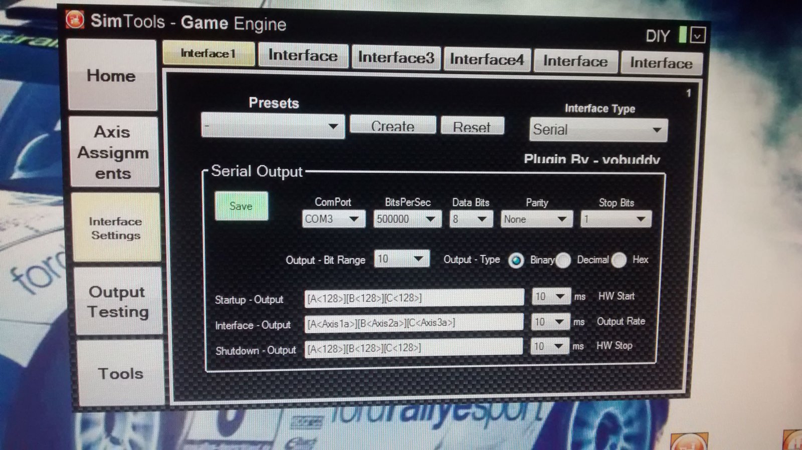

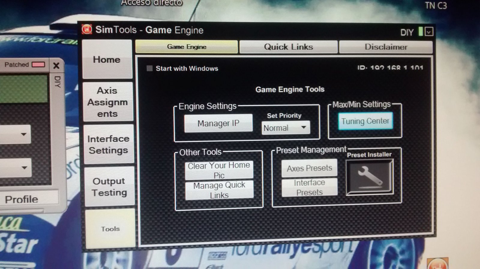

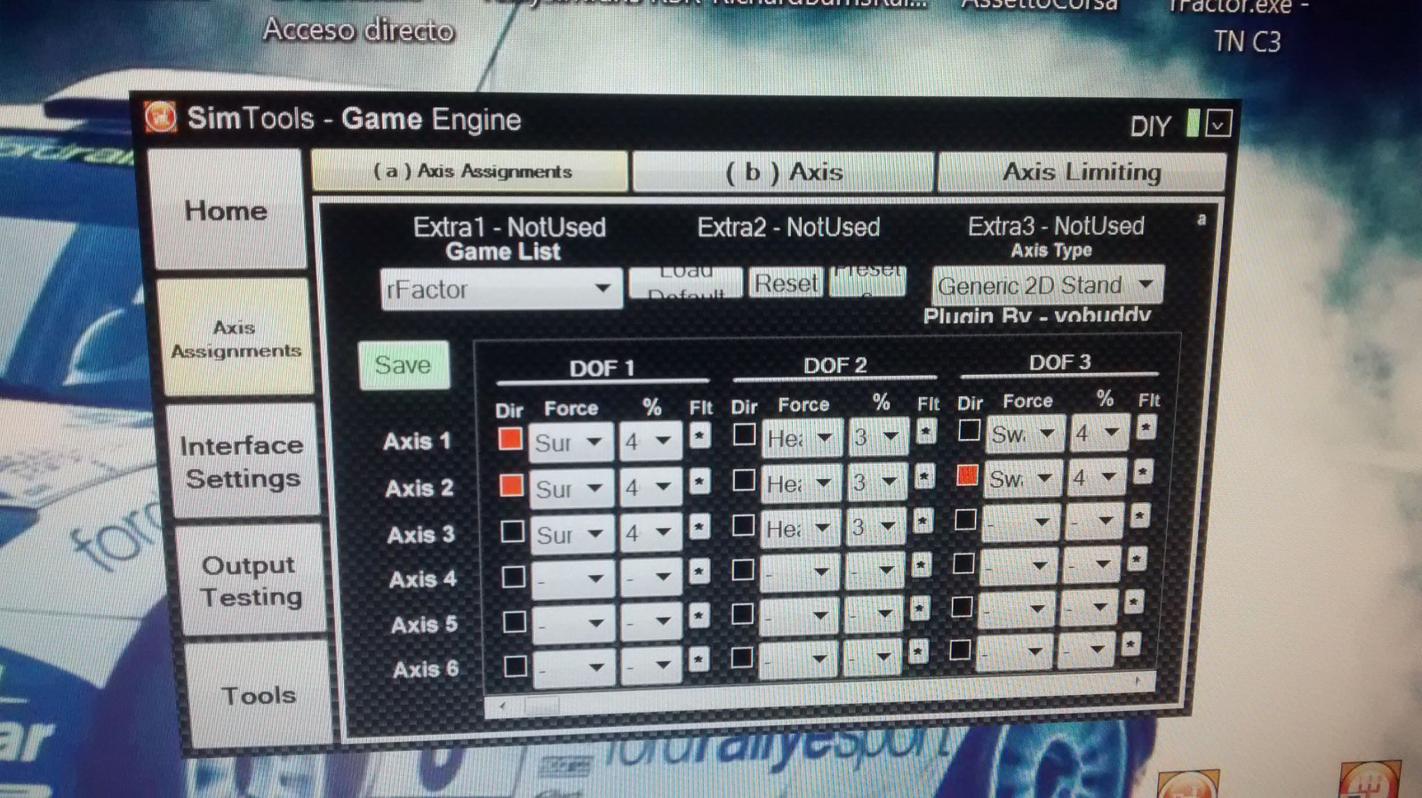

    I am not having connection between Gane Engine, Game Manager and rFactor like for example. I'm using Windows 7 Ultimate
  11. Pit
    3,007
    30,516Coins
    +3,098 / 31 / -0
    Try 40% instead of 4%...and please upload screenshots of the tuning center and game manager.

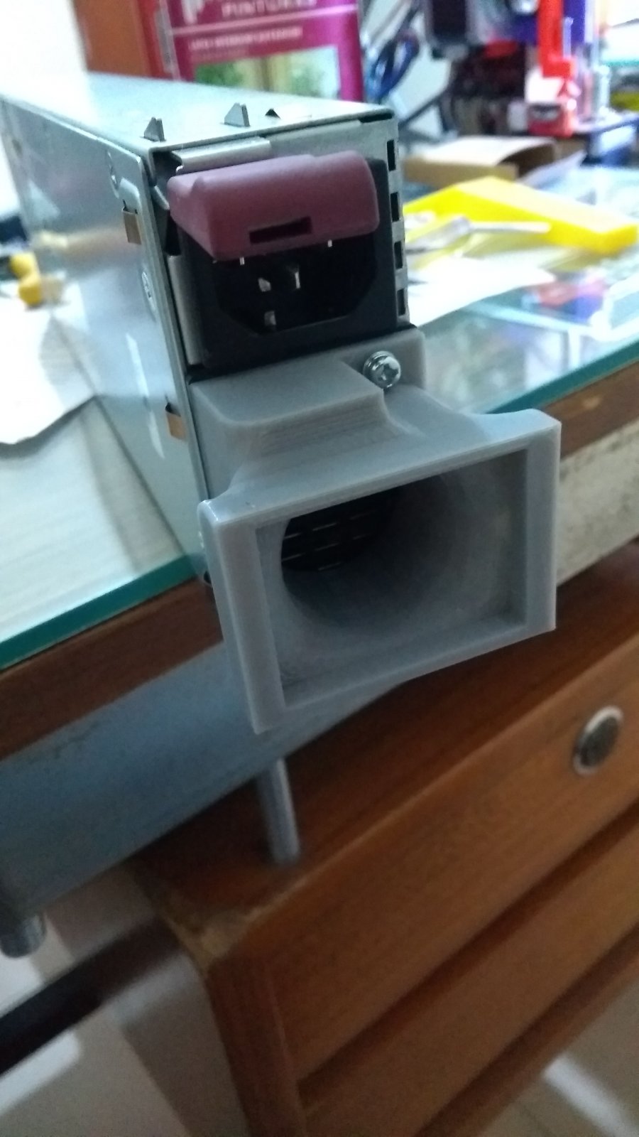

    Hello friends return after a long time.

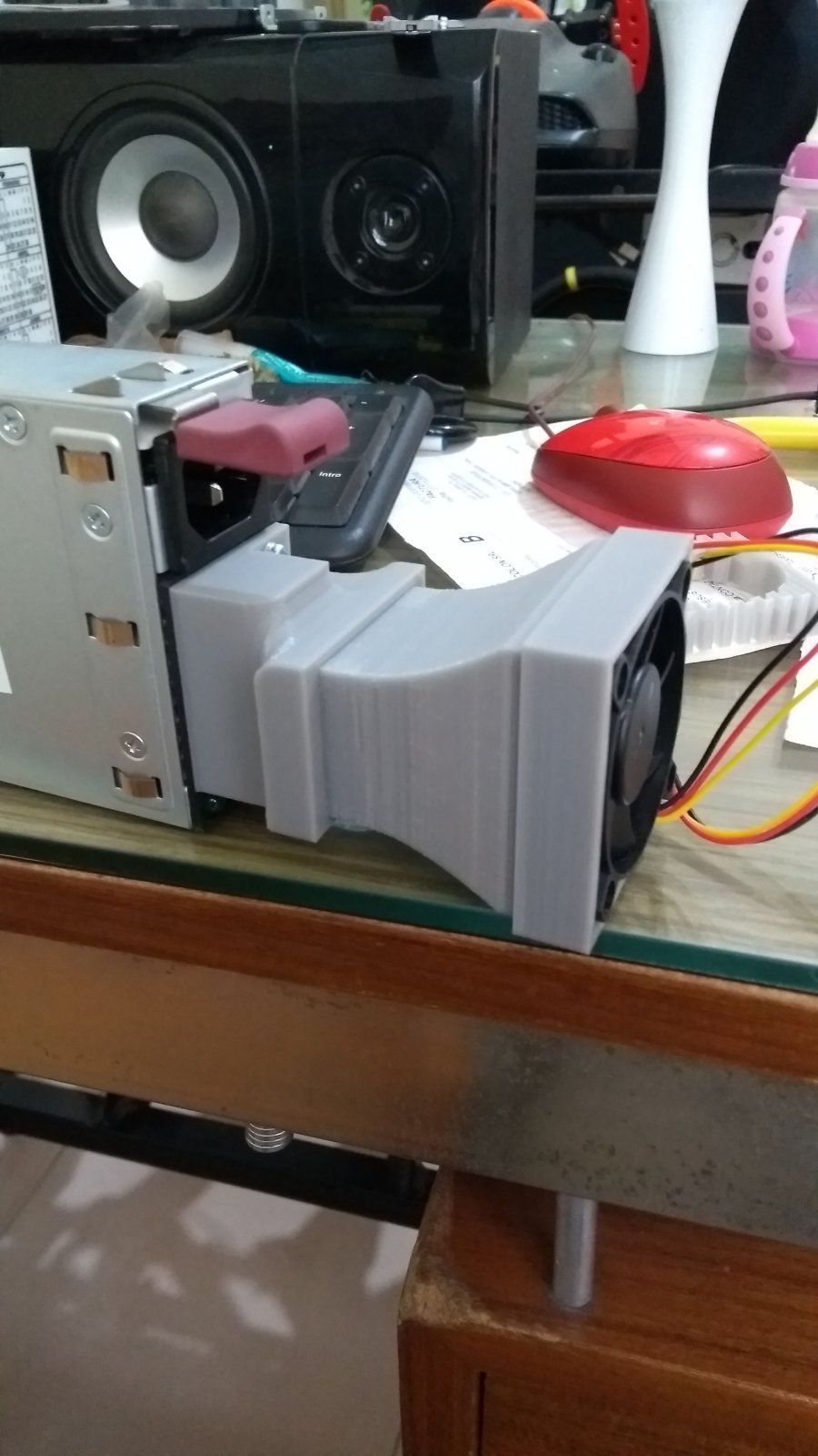

    I have the following try the source HP 12v 46am 575w. at some maximum consumption very fast it makes me mode protection ... I have to restart and returns to your normal.
    check your voltage and is well, in use not low 12,30v.
    another issue, my controller is armed with bridges H IBT-2. I want to change engines for 24V and put two sources in series ..
    I use my IBT-2 or do I have to change them?

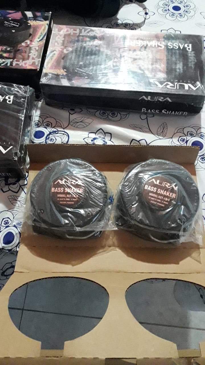

    come the bass shaker for the cockpit

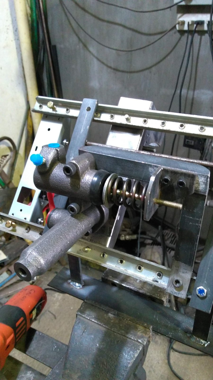

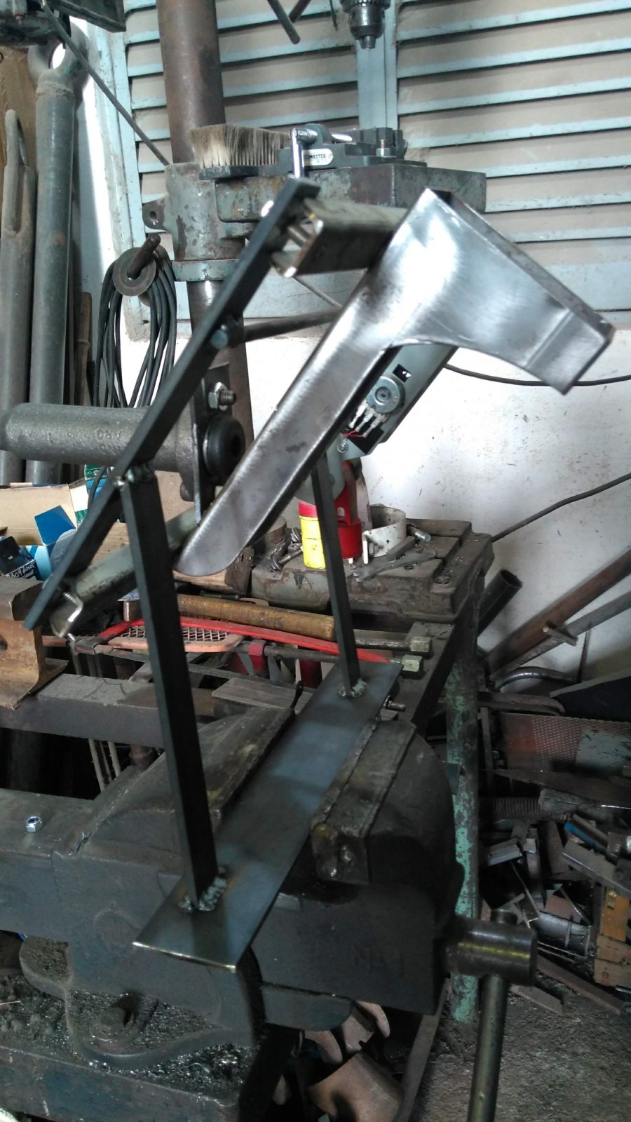

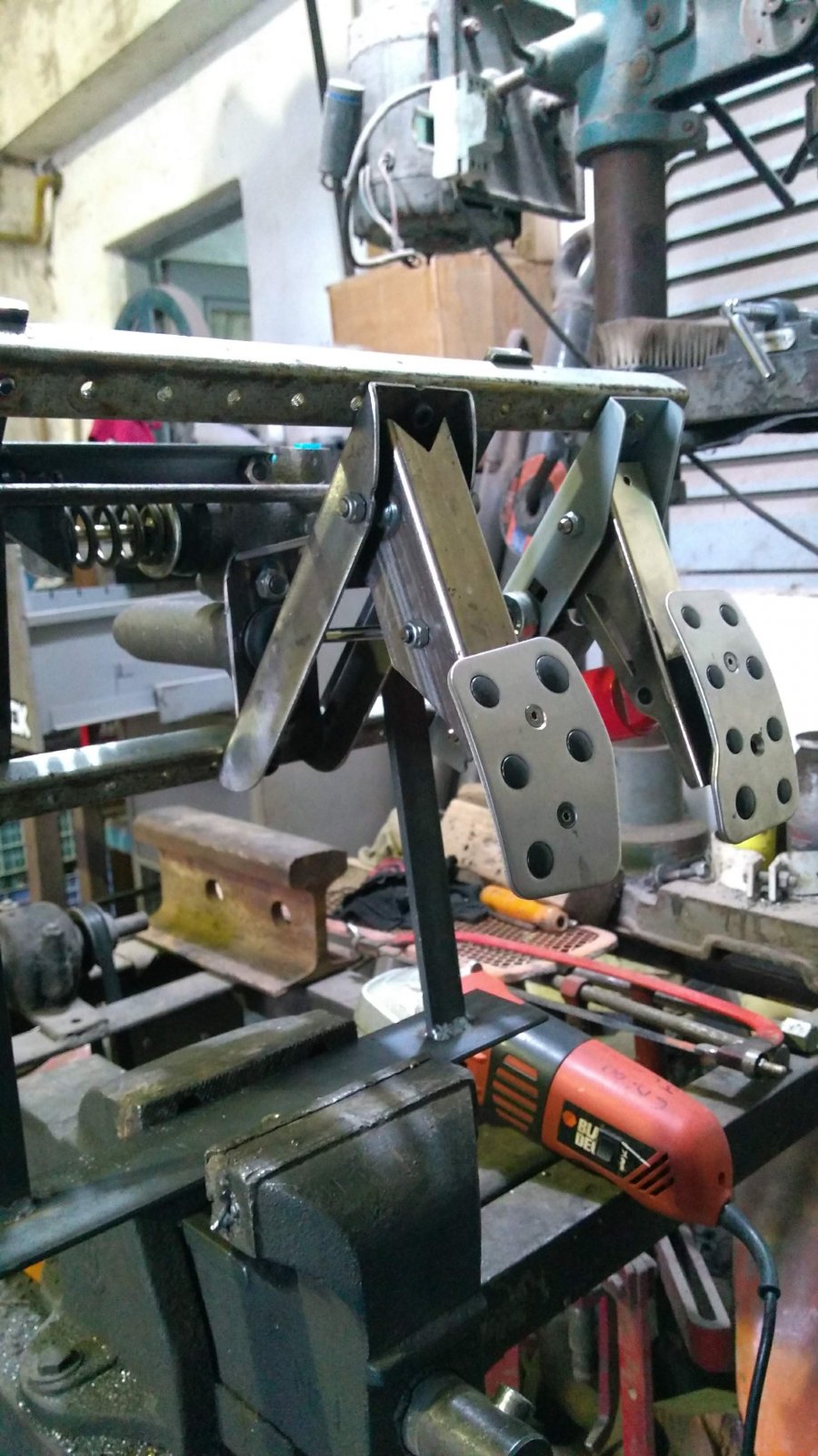

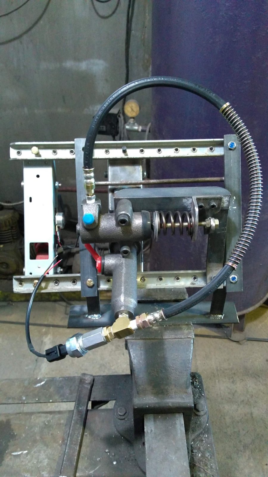

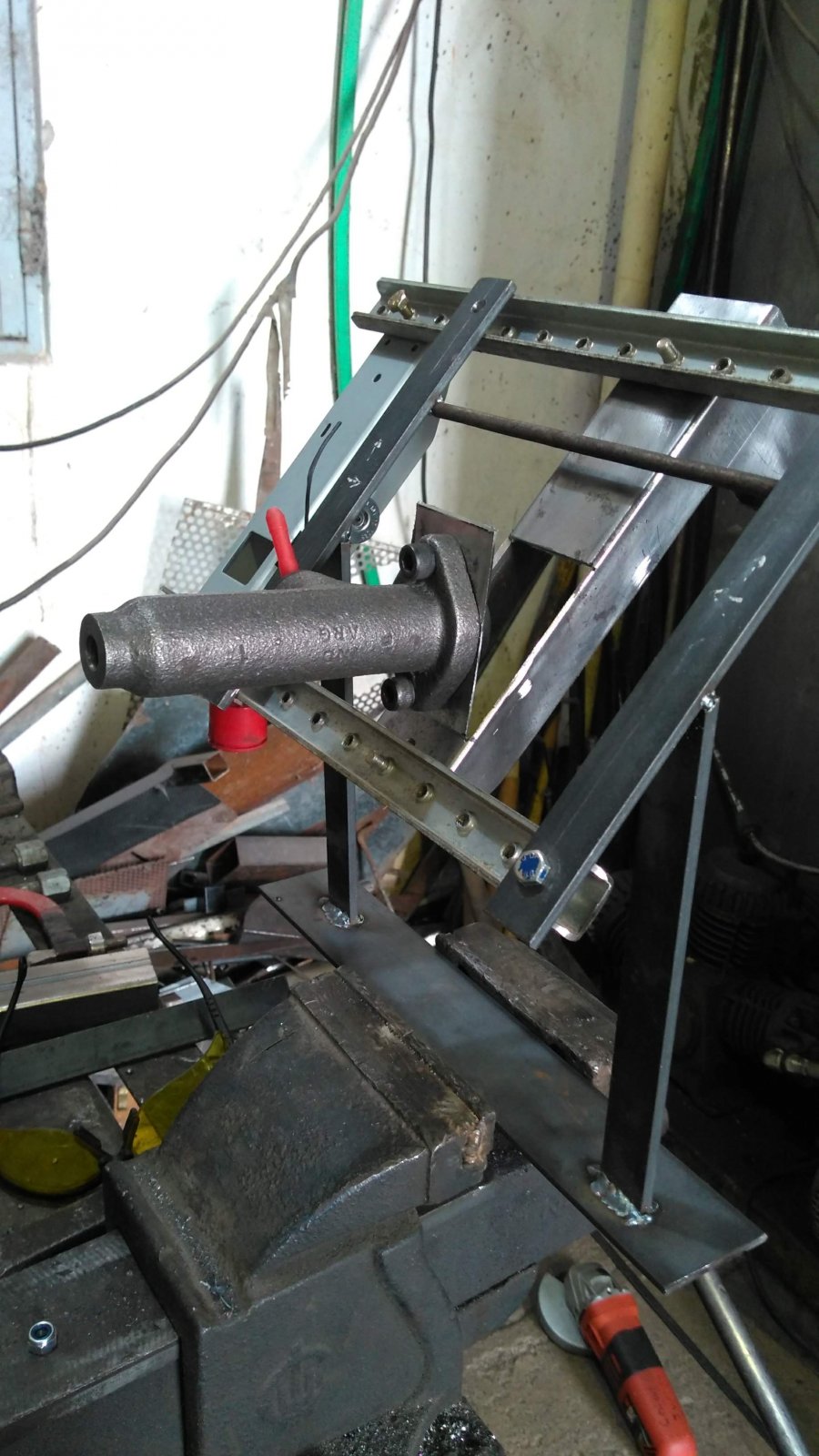

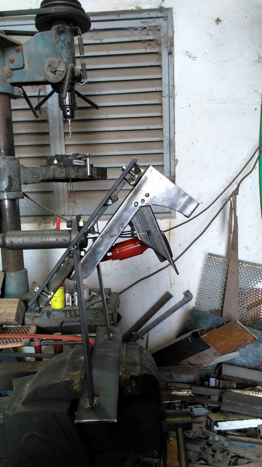

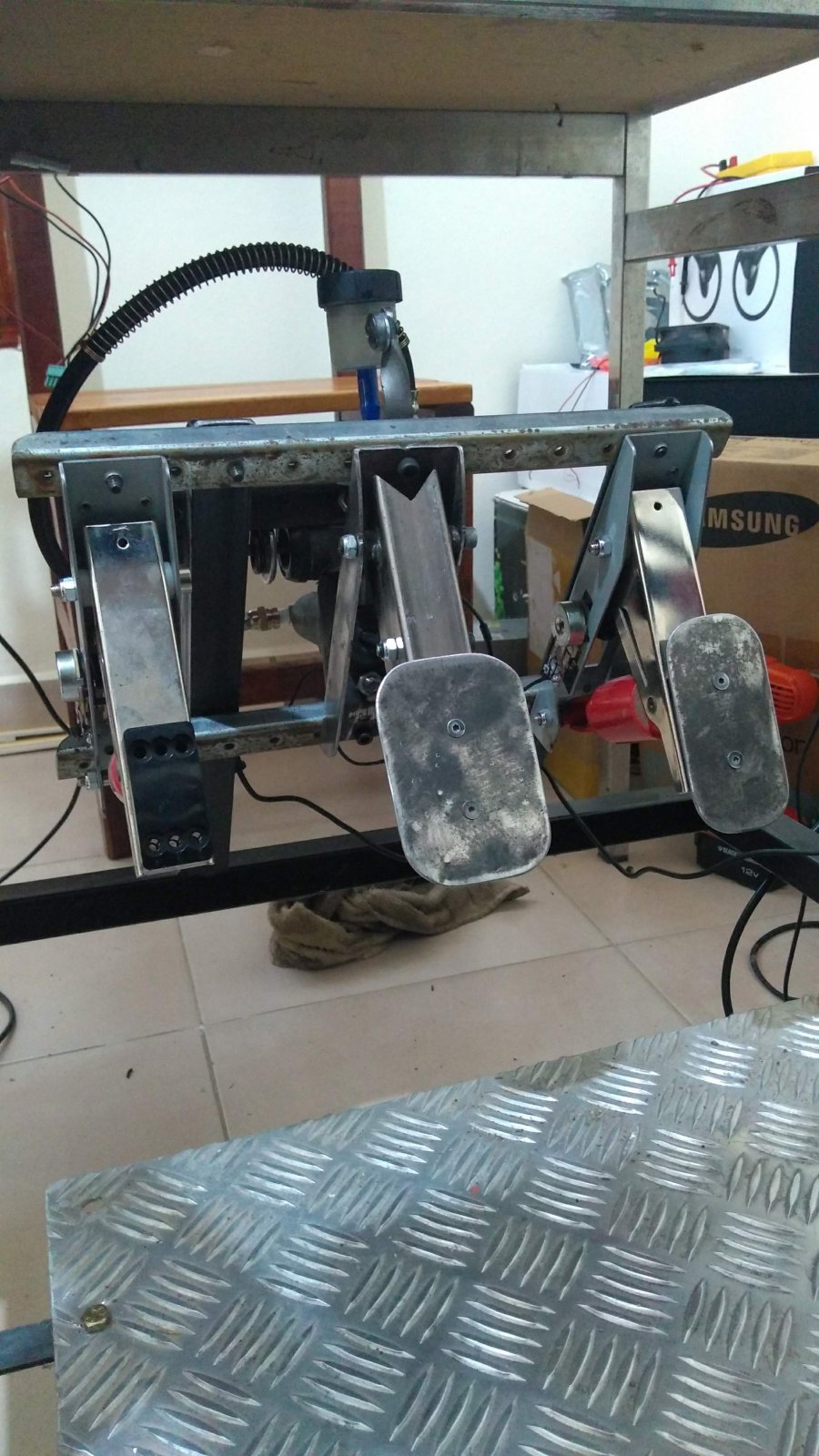

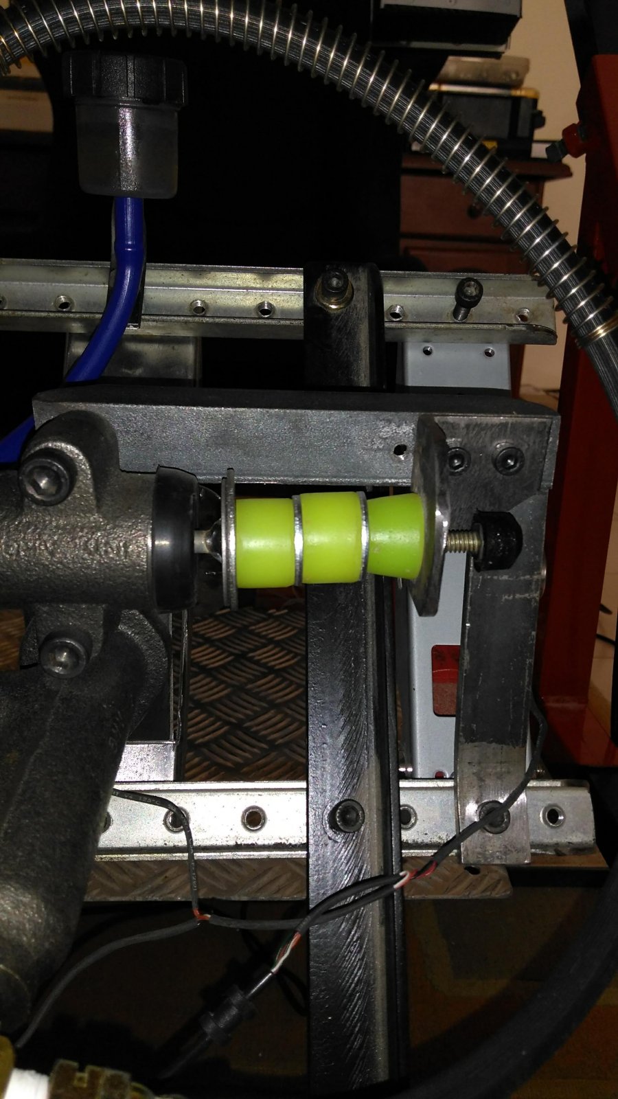

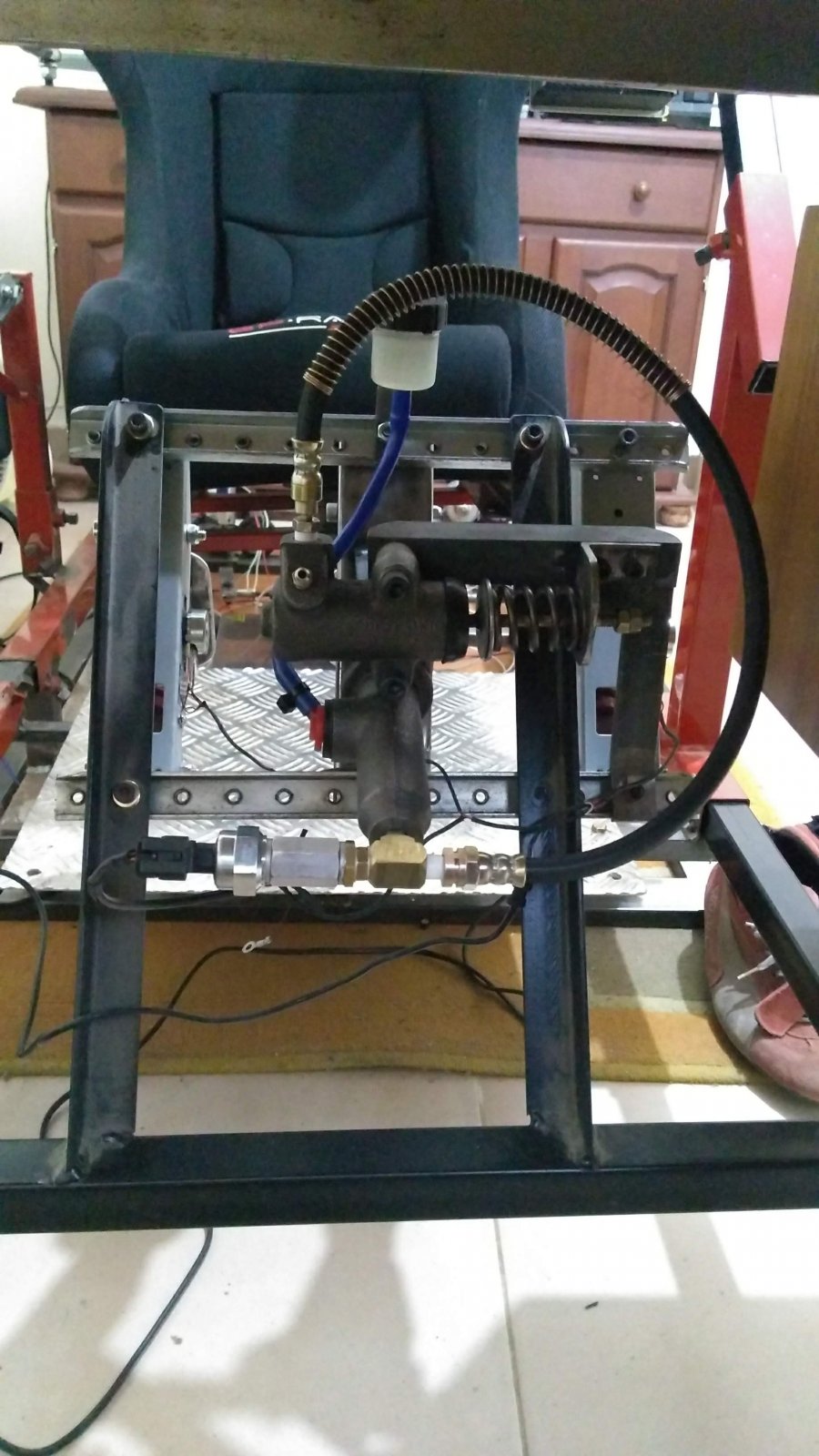

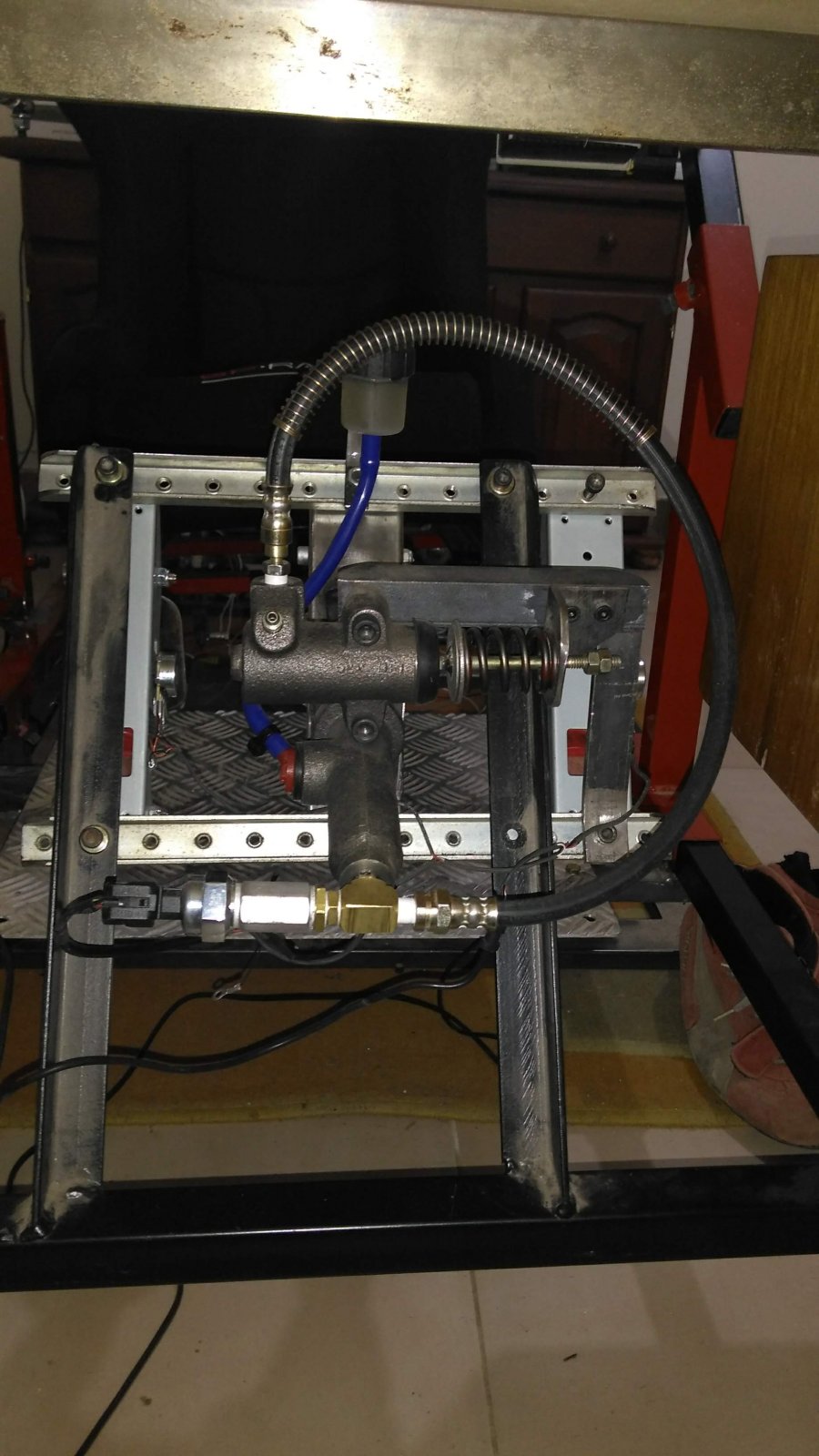

    Well I bring you some advances that a while ago ..
    Hydraulic brake pedal, use a Peugeot 504 embrage pump
    At that time I armed it with a Valve spring from Scort, but it was not hard enough, then I got the longspinners or skateboards and with that I achieved an interesting hardness.
    IMG_20181026_103017722.jpg IMG_20181026_103020684.jpg IMG_20181026_115236398_HDR.jpg IMG_20181026_115246815_HDR.jpg IMG_20181026_180005179.jpg IMG_20181026_183609938.jpg IMG_20181029_183423765.jpg IMG_20181102_151931624.jpg IMG_20181102_151937294.jpg IMG_20181102_151950286.jpg IMG_20181114_072922912.jpg

    hello I wanted to see if there is any tutorial of the isolate of the source model HP DPS-700GB A and make a connection in series to opt 24V
