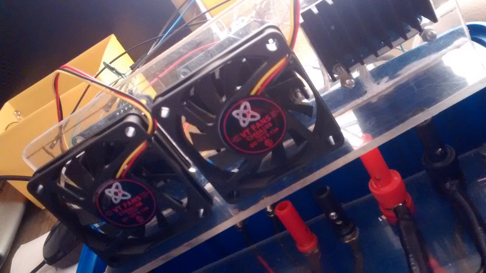

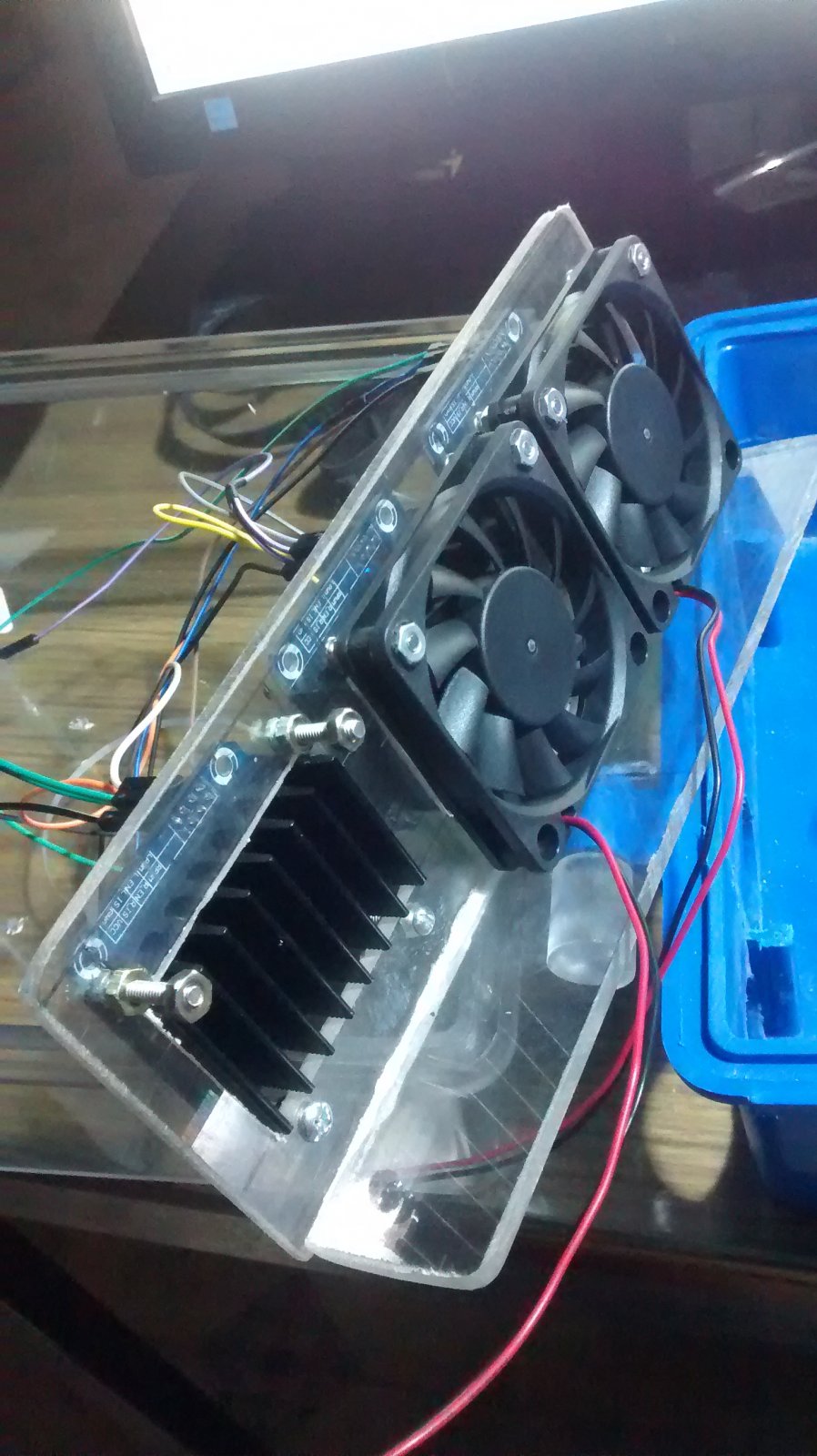

    In Pit's recommendation, I'm already preparing the coolers for each of the ibt-2

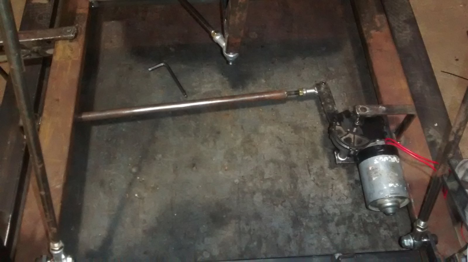

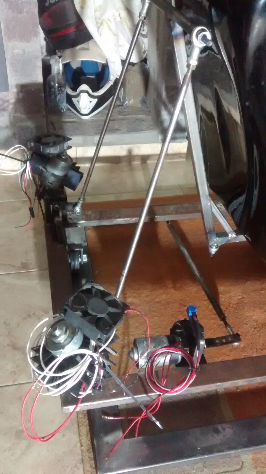

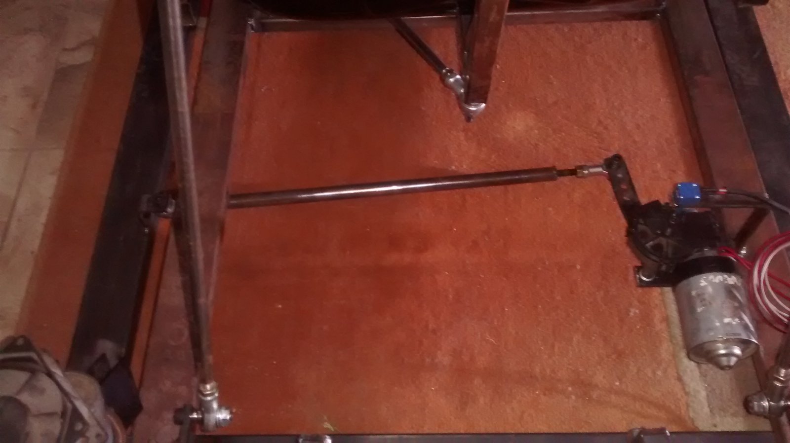

    very thorough job, but if I can afford I would recommend you to insert the tie rods for horizontal movement motor tl von links.jpg

    If I need to install the bar to block the rotation and some modification. I'm also going to put traction loss

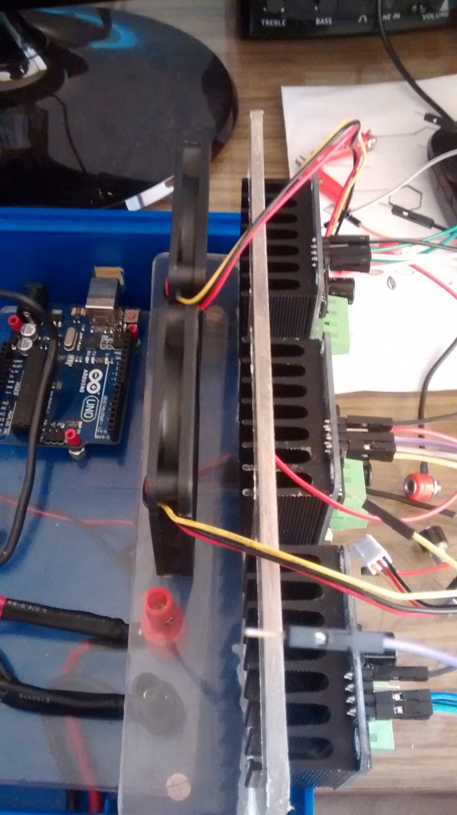

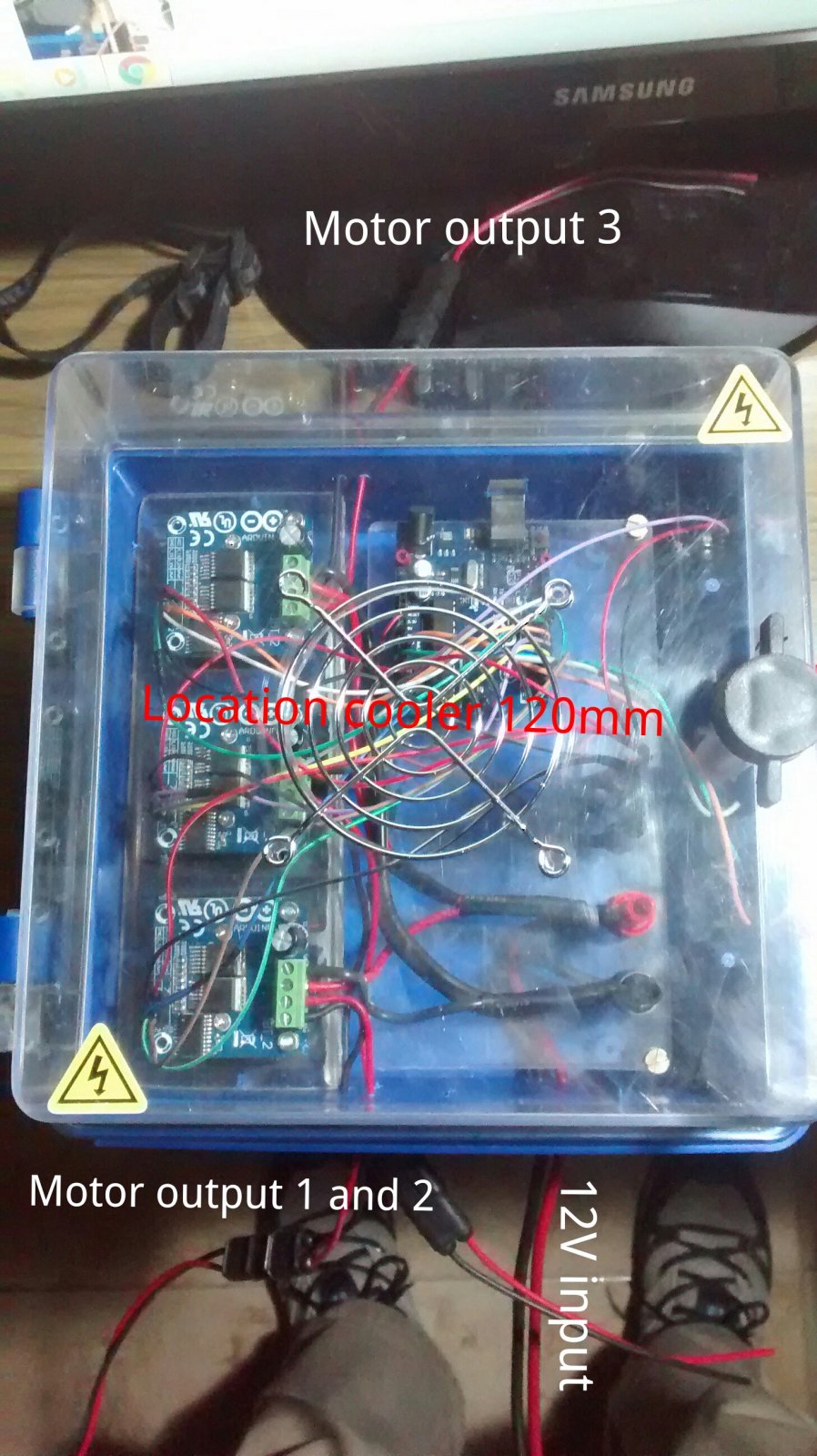

    Cabinet and finished house, a 60mm cooler is missing for the ibt-2 and the 120mm general extractor in the lid

    Is it necessary to put the two bars to block the rotation? Or is it enough with only one?
  7. dualclick76
    dualclick76 Active Member
    Mar 23, 2015
    163
    italia
    10Coins
    +40 / 0 / -2
    preferably two

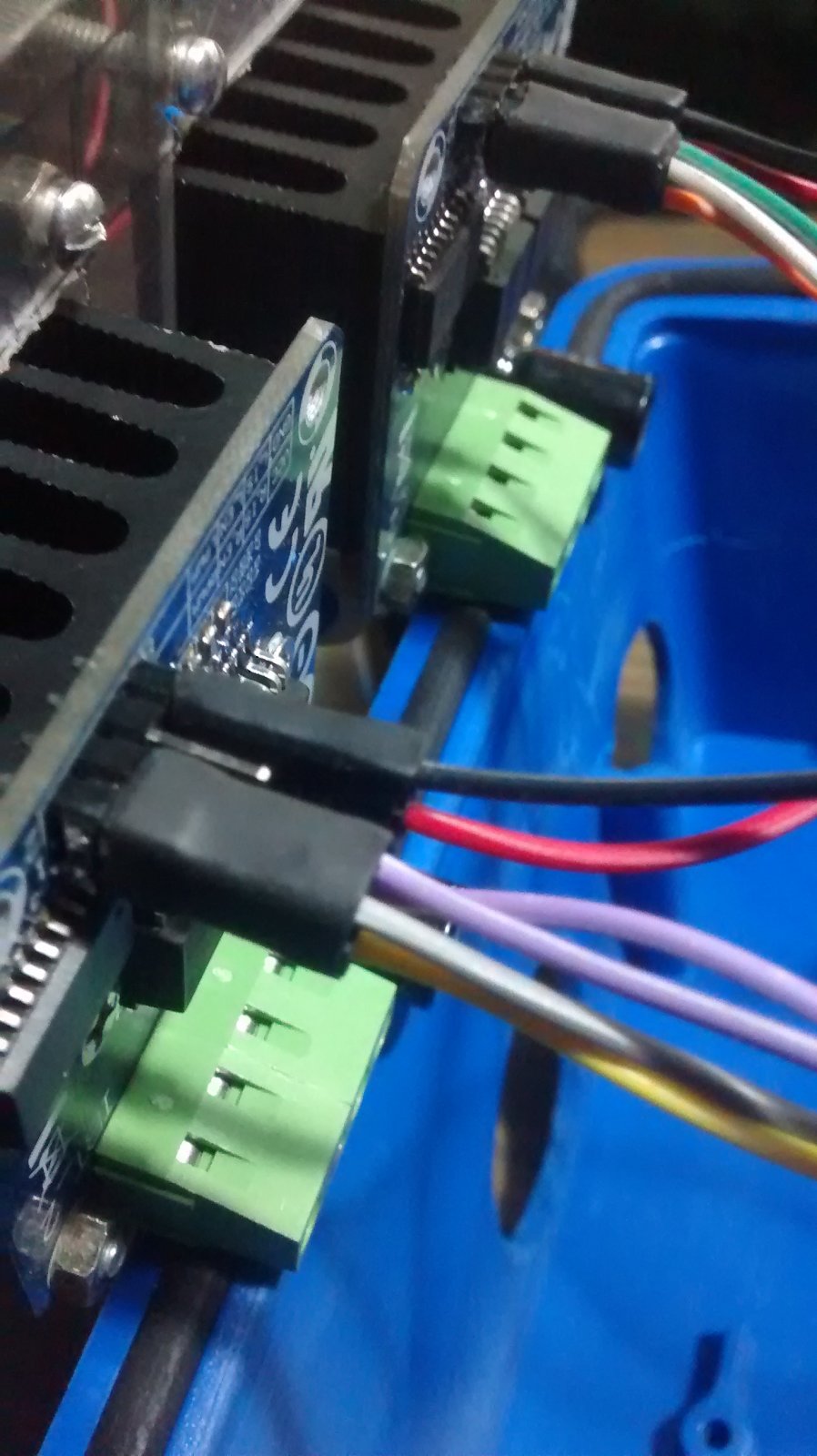

    Once the cables have already been placed in their respective pins, I came up with a penerle heat shrink so they can be firmer and there is no danger that one of them coming out, the same as I did with the + and - signs of 5v

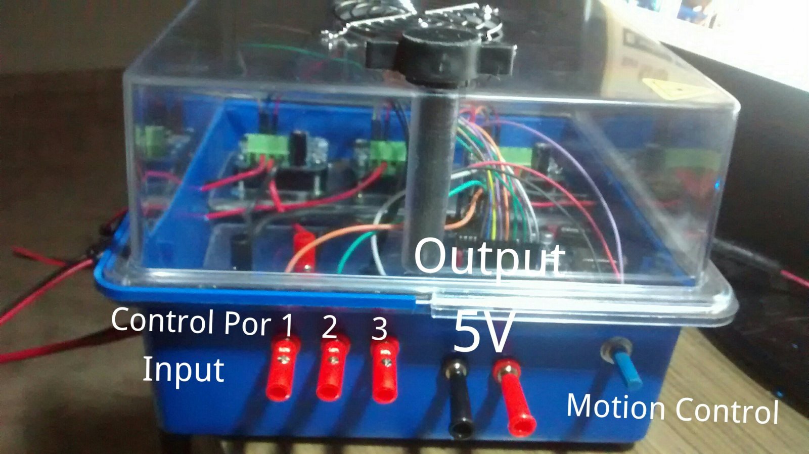

    Here I show the box where all the electronics are

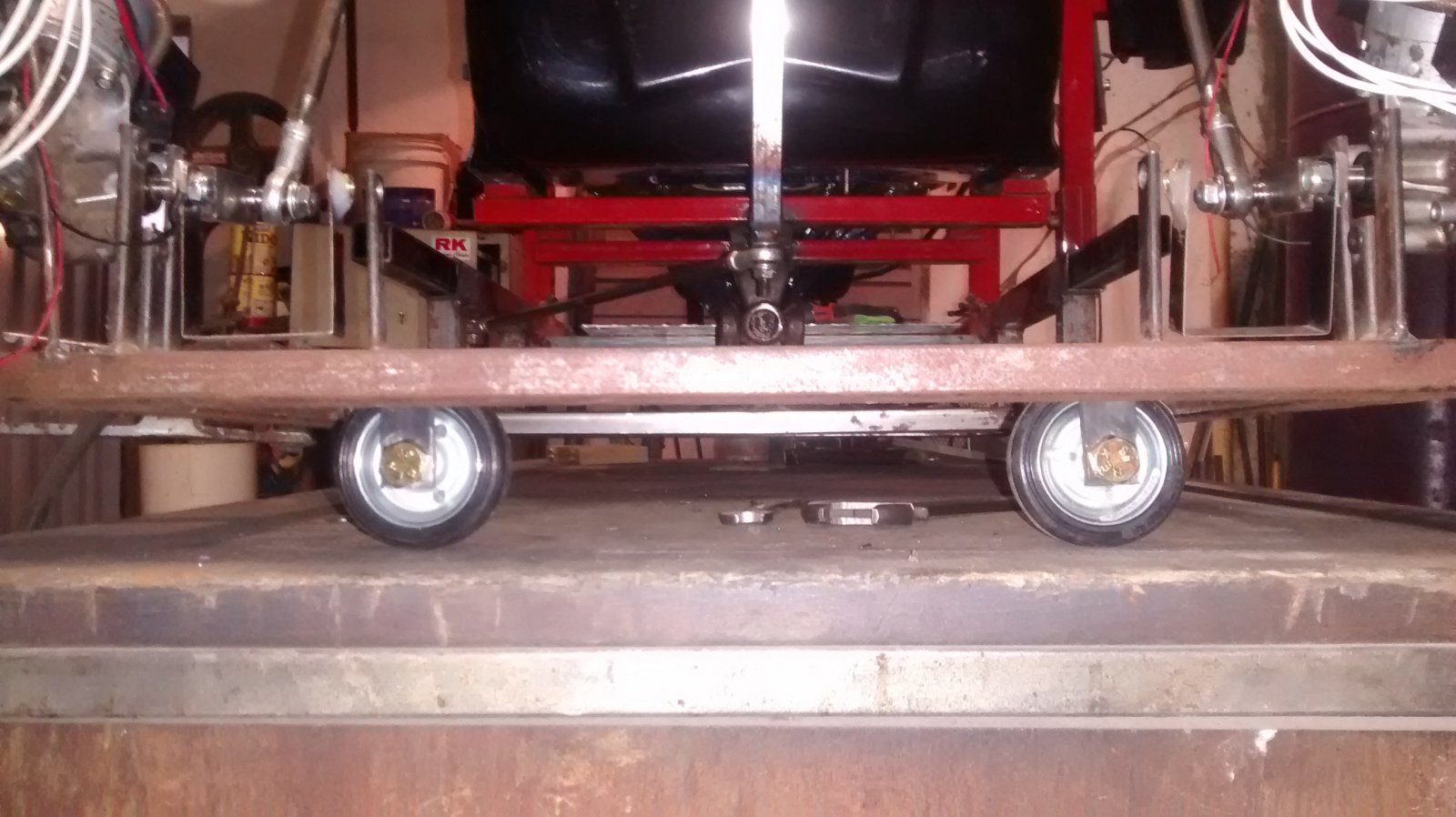

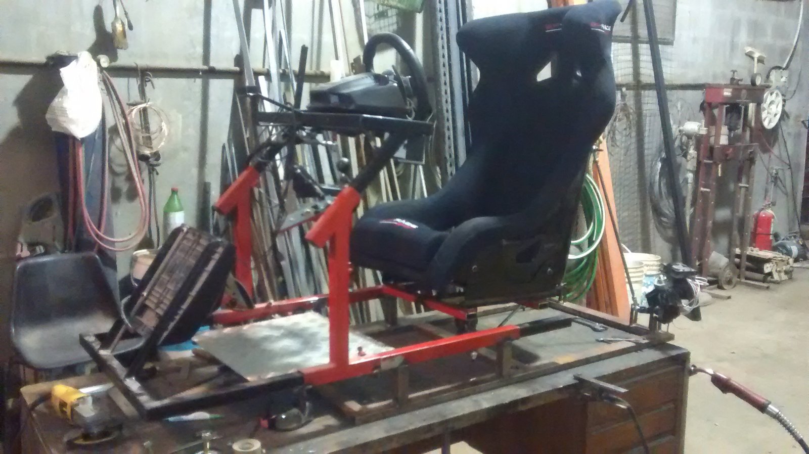

    One of the first test, it works, it makes me deny a little but walks ... I only need to modify the structure because the center of the movement I do not have it well under the armchair, because previously to move the whole structure and was a lot of weight. .. these days it is modified and it will be added more% of movement because it is short.

    Not having the pivot well in the center of the armchair, I am loading weight (kg) to the engines and raise temperature

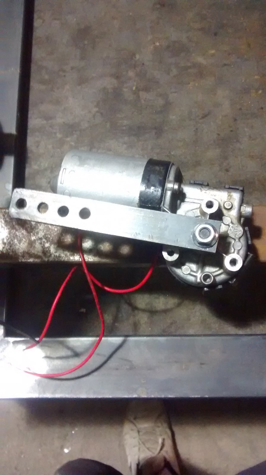

    Modification of the structure and adding traction loss

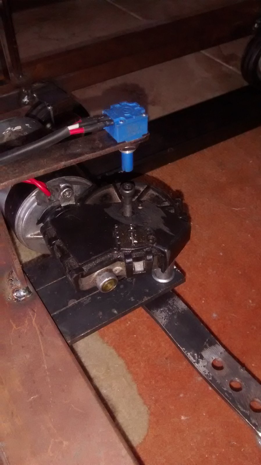

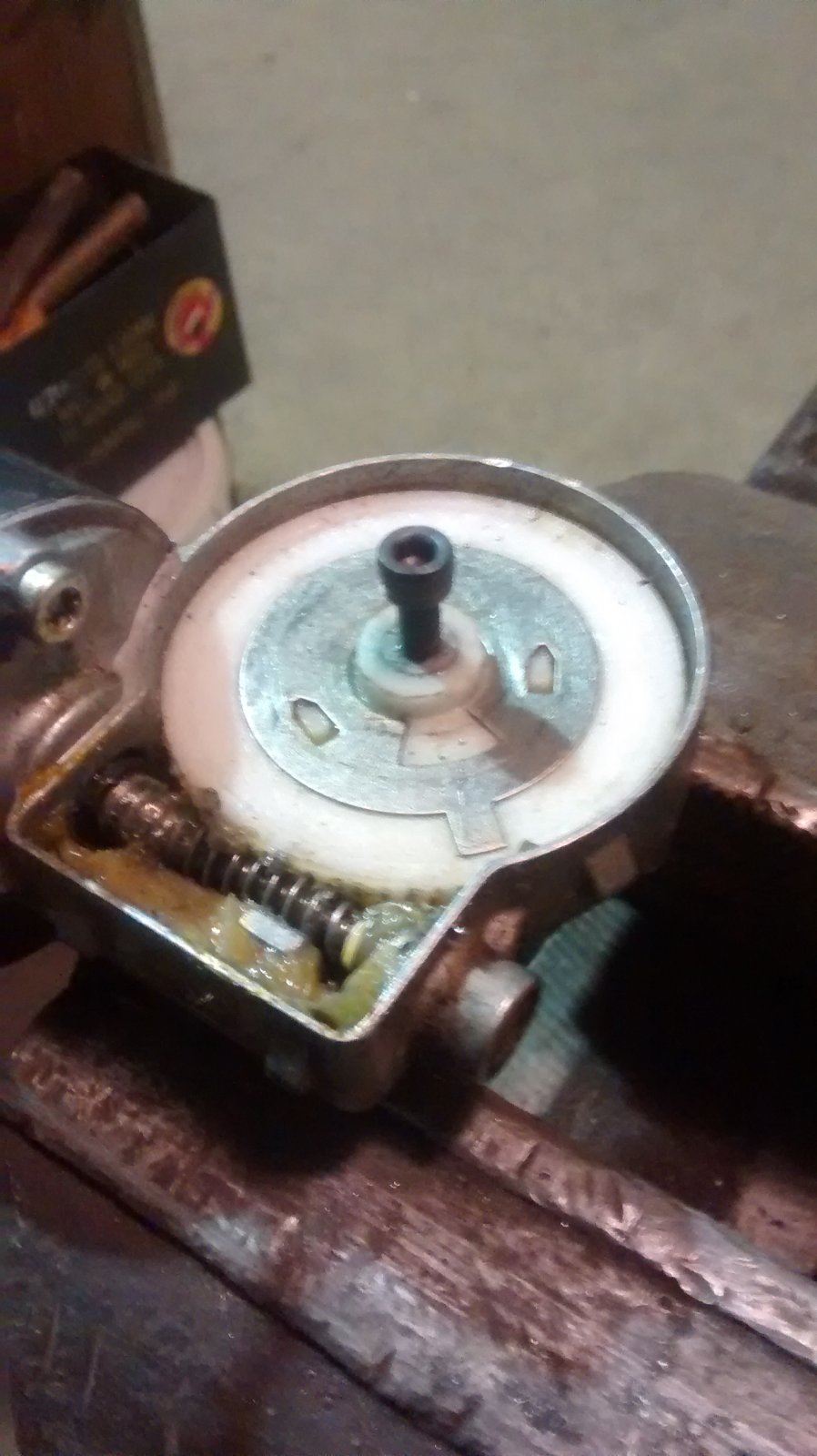

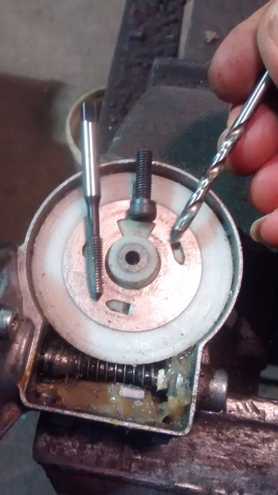

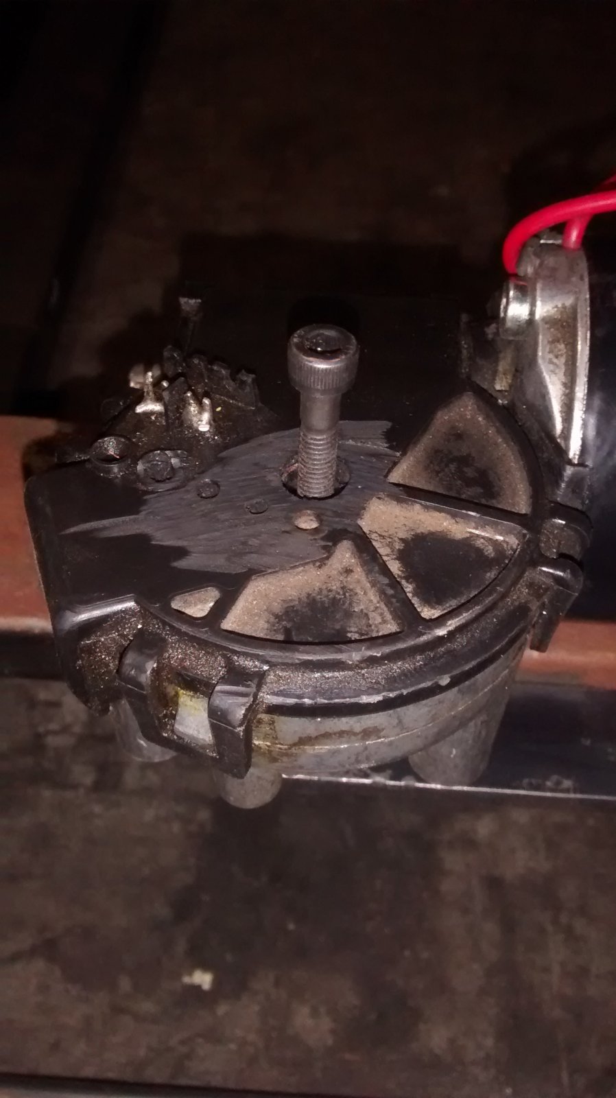

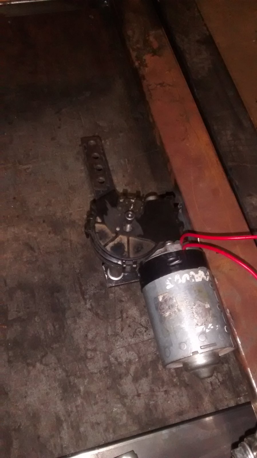

    Installation of the potentiometer on the opposite side of the shaft tip
    IMG_20170227_202000551.jpg IMG_20170227_202220785.jpg IMG_20170227_233553485.jpg IMG_20170228_020546310.jpg
    Pierce with 4.25mm wick and I made 5x0.80 thread

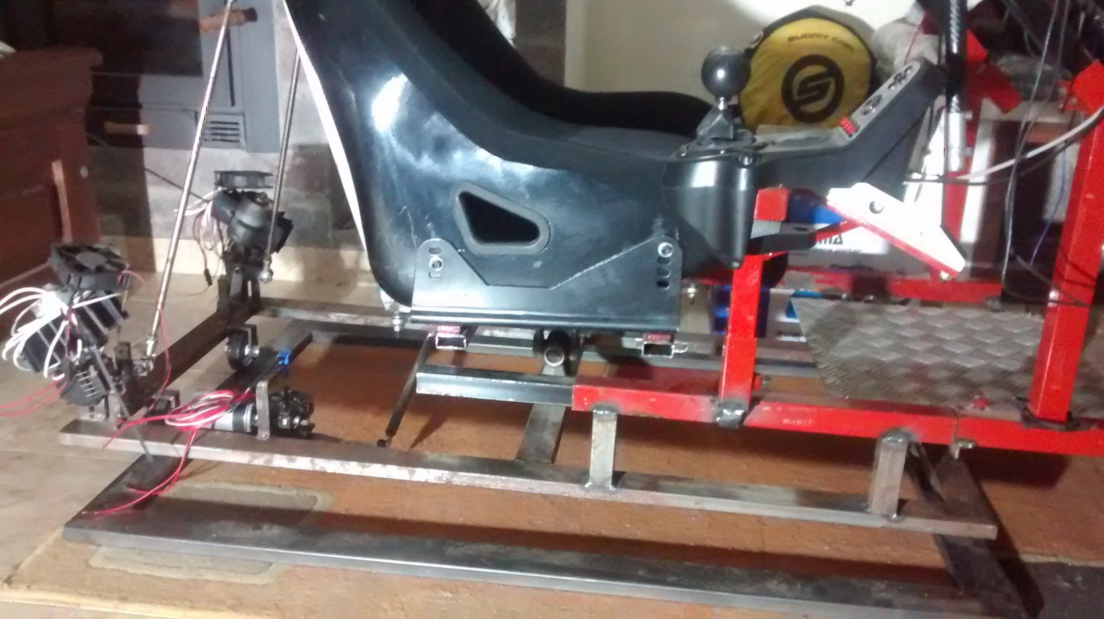

    Finished the mechanical part. Just do some test posts see that everything is perfect
    IMG_20170227_233524233.jpg IMG_20170228_240754270.jpg IMG_20170228_010732922.jpg
    IMG_20170228_020404061.jpg IMG_20170228_020914896.jpg IMG_20170228_020928217.jpg
  15. Nick Moxley
    17,054Coins
    +2,504 / 30 / -2
    Nice progress, However I highly doubt those wiper's will be able to deal with that TL lever length you chose. I suggest smaller to start off with.
  16. Juanjo1986
    Juanjo1986 Member
    Jan 6, 2016
    53
    Comerciante.. Copiloto Rally...
    Argentina
    489Coins
    +18 / 1 / -0
    Hi Nick, do you mean the traction loss lever?
  17. Nick Moxley
    17,054Coins
    +2,504 / 30 / -2
    Yes
