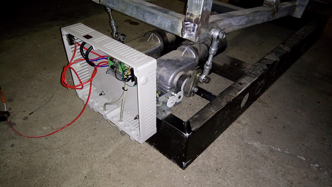

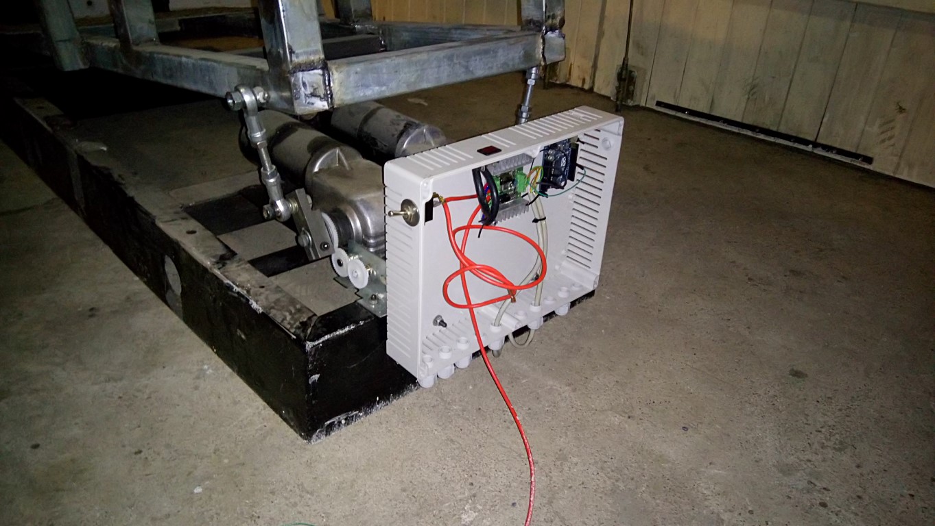

    I'm happy to present you my simulator 2DOF
    I use a truck cardan junction for the rotation.
    For electronic parts, there are 2 motors Wheelchair 24v + 1 Sabertooth + 1 Arduino

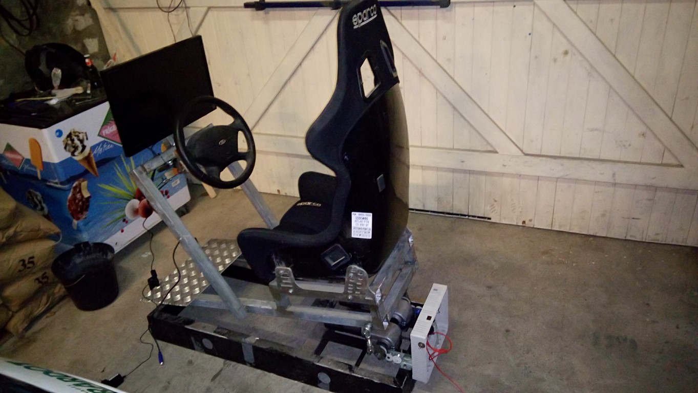

    It works Very Happy :grin
    For the adjustment I simply removed the drive gear of the potar, I put the crank horizontally by gently turning the potar, cut the power supply and put back the drive sprocket
    I will put videos of the functioning soon
    Everything is installed in temporary o_O
    Side game I installed DIRT and actually it looks much better

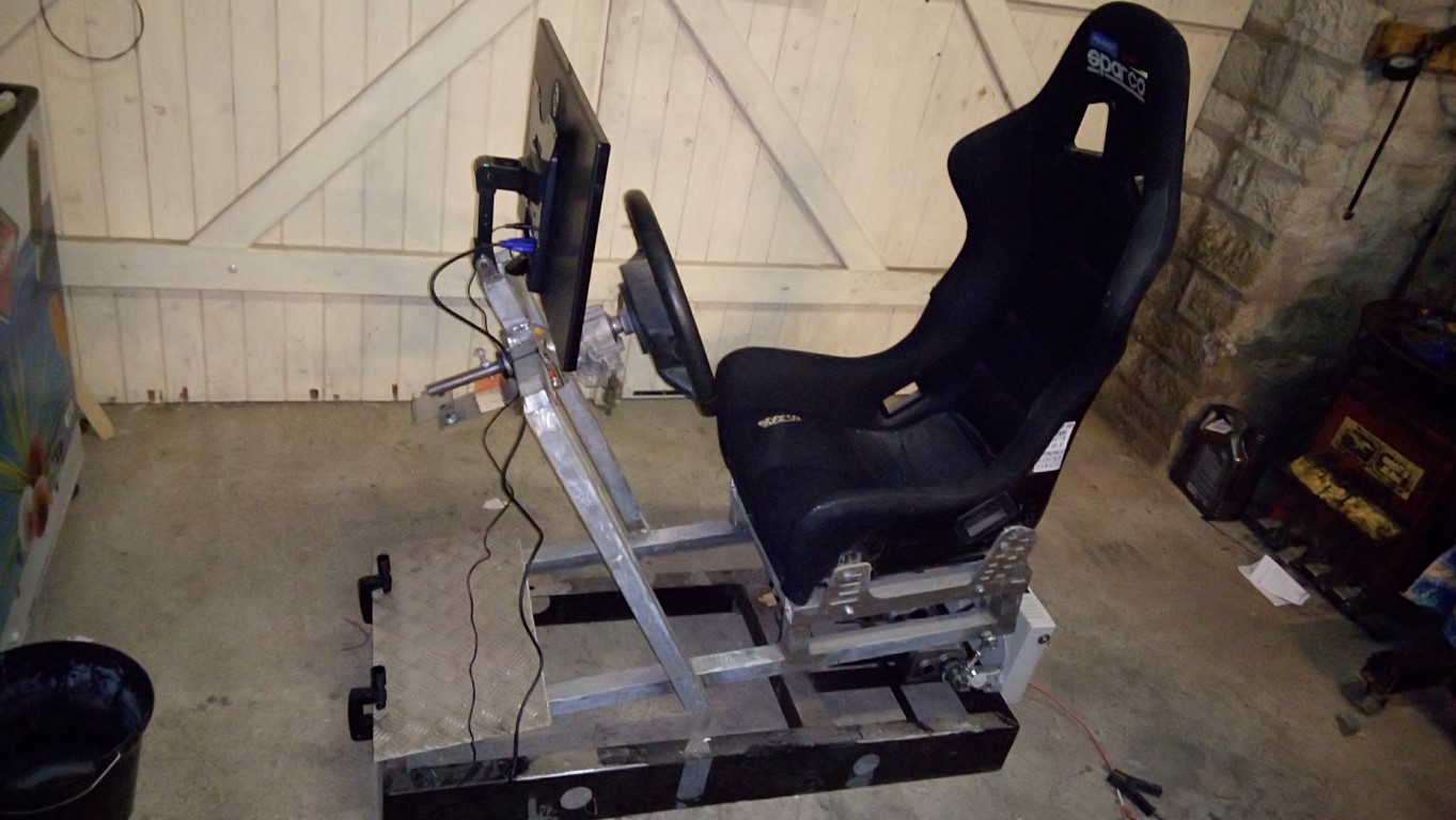

    here are some photos

    And 2 others :grin

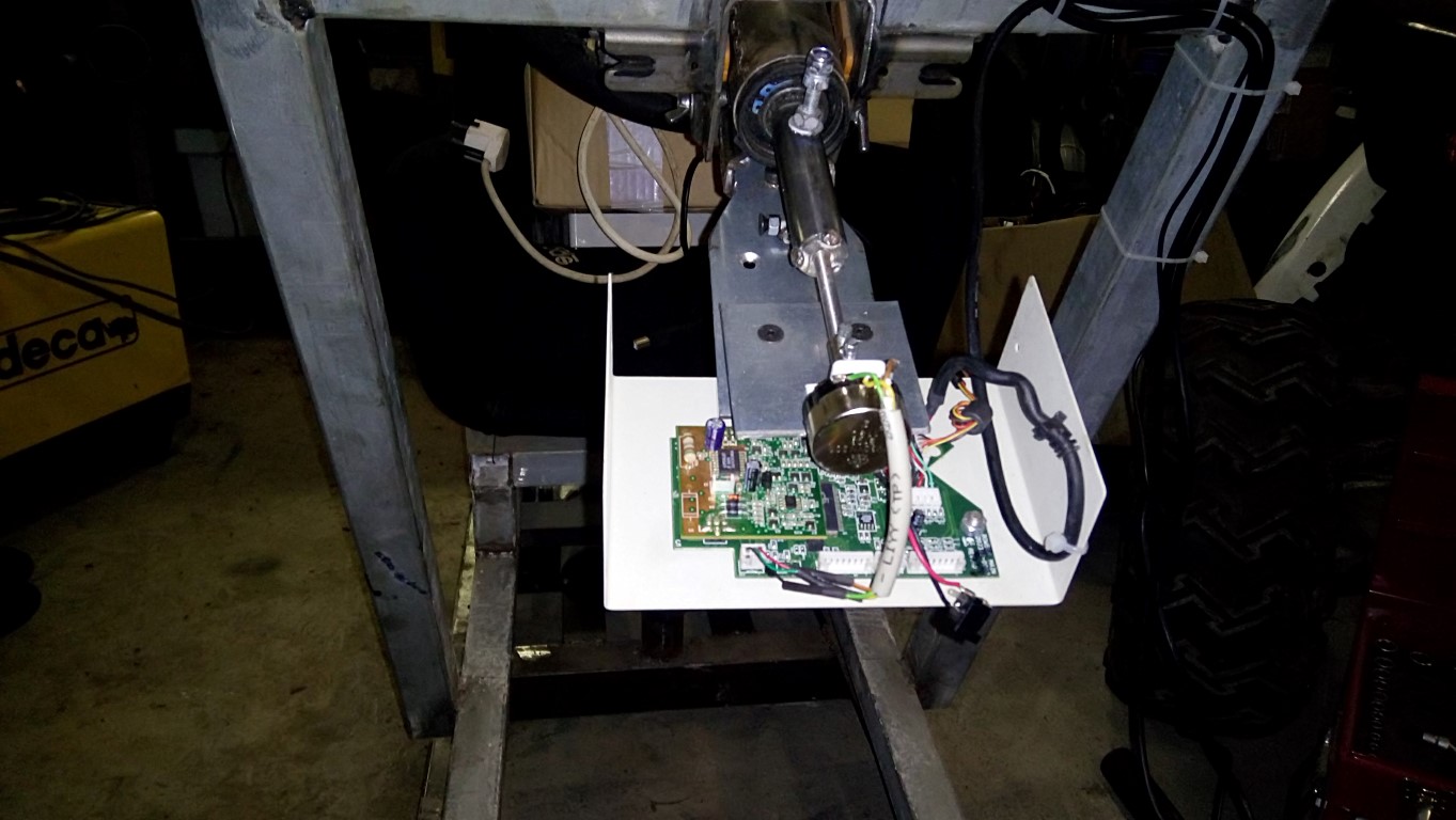

    Here is picture of wheel potentiometer
