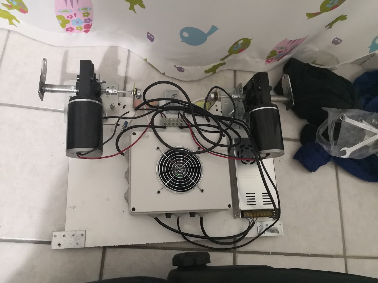

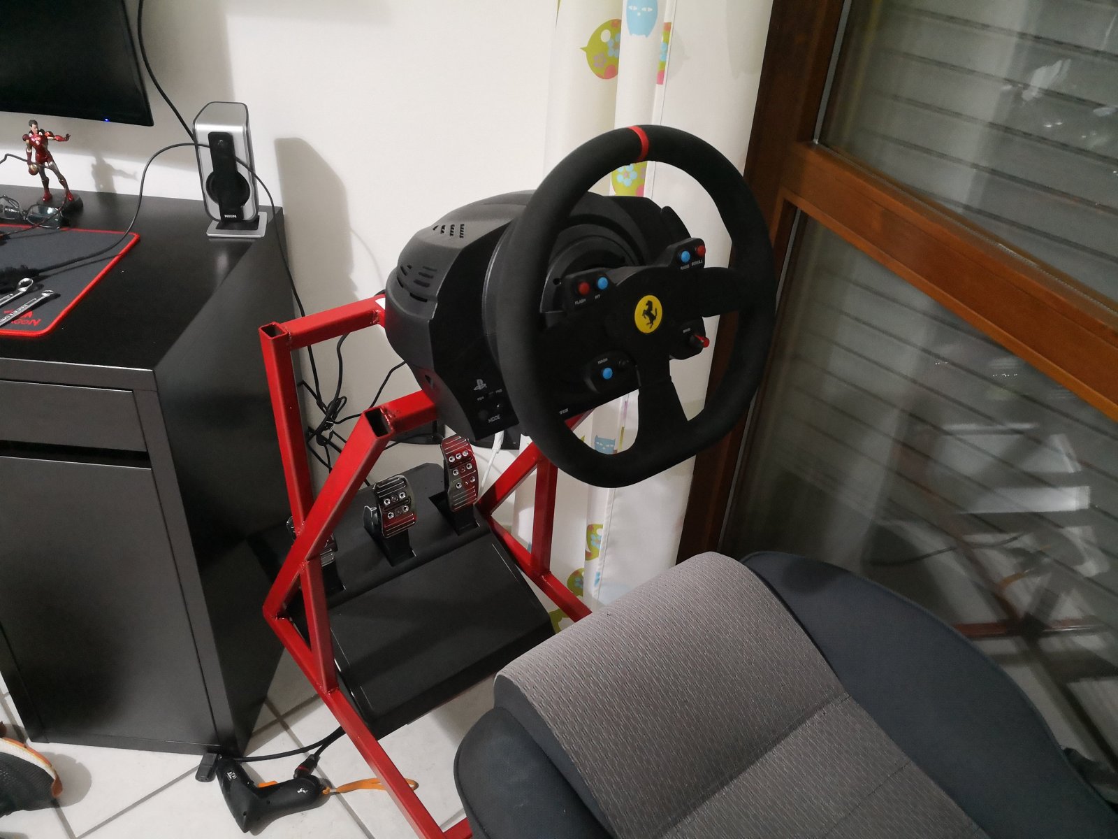

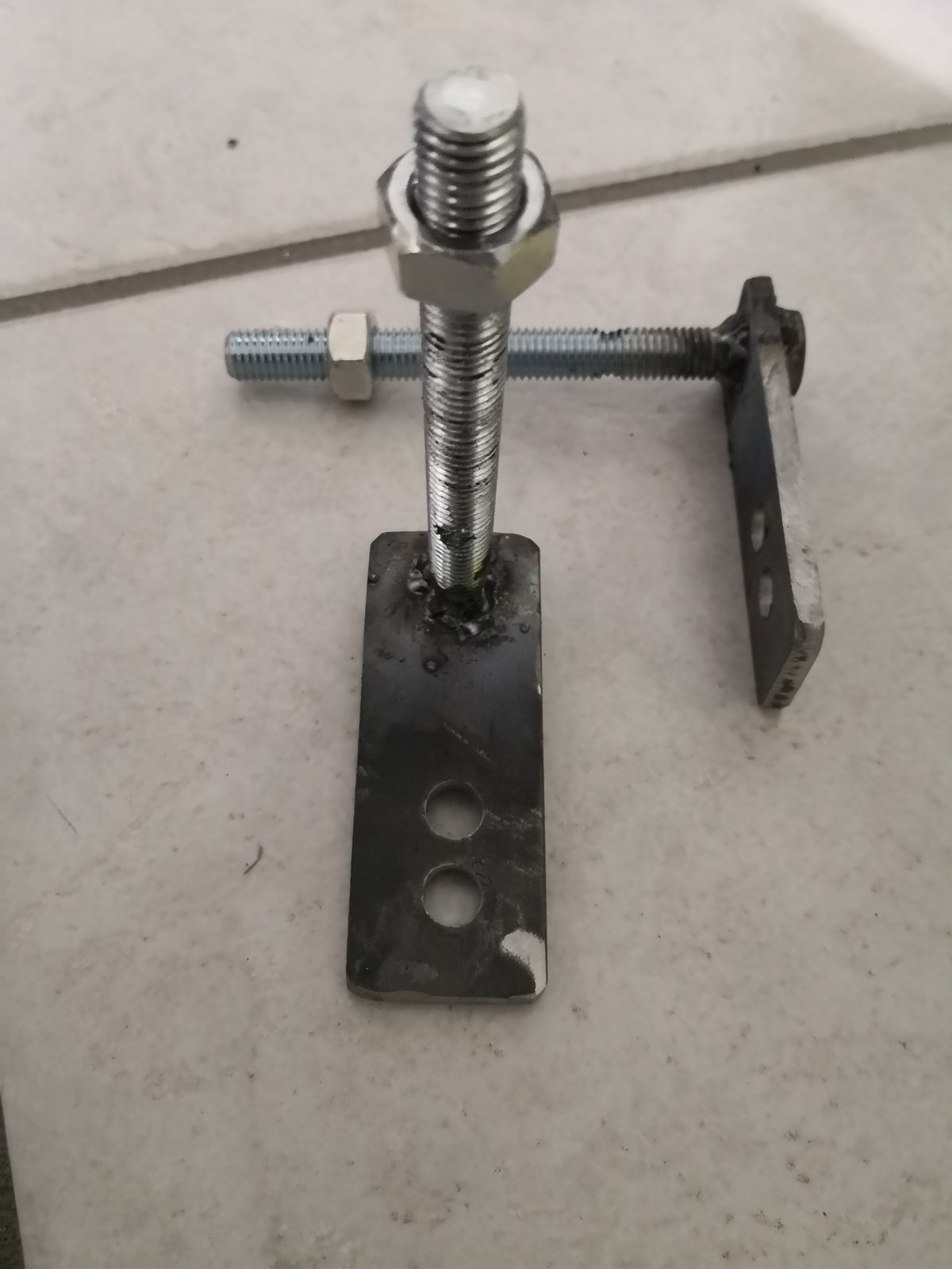

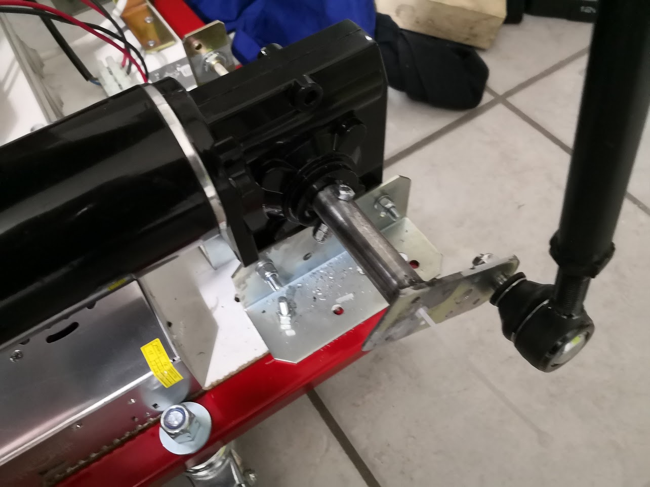

    Hello everybody!
    I've almost finished My 2DOF seat, with arduino, MM and RacingMat (thank you!) code:
    The problem is that i dont know how to attach the lever to the motor i've used that one in the last photo but the connection is not stiff enough.
    I think that i've to increase the distance between the motor, and the attach of the lever have to be shorter.

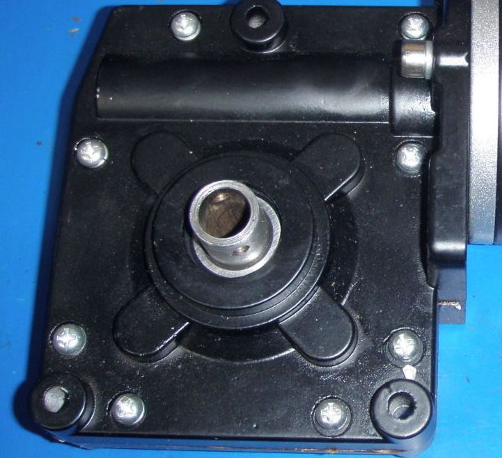

    this is the gear of the motor:
    what kind of lever i've to use to make a very stiff connection to the motor shaft?
    I've got another question:
    These motors are 180W 12V 150 rpm, i'm using only one 360W 12V (the one in the photos) power supplier connected to the MM for both the motors, it is ok?
    thank you very much!!!

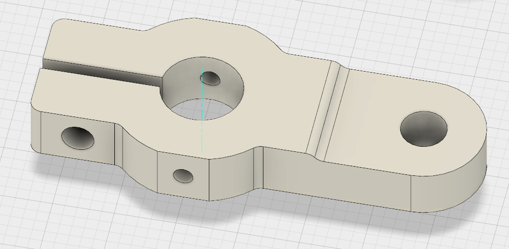

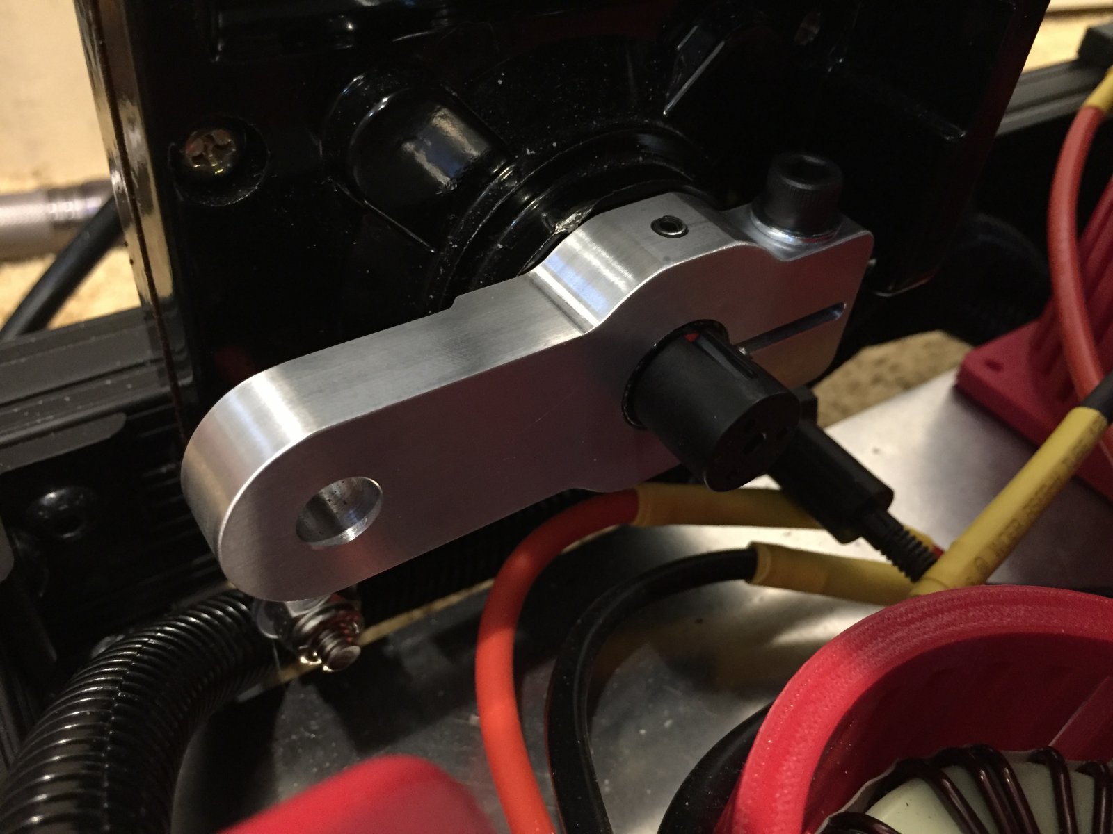

    @MikeSchumy - this is the design I came up with and had machined:
    77D07D7B-1809-4F15-ACC0-7011ECA08E17.jpeg 003AE91E-9735-4240-927E-19DB14D3B20D.jpeg
    It clamps around the output shaft and also uses a spring roll pin through the holes in the shaft. So far it’s been rock solid. 45 mm center to center. The only difference between the drawing and what rhe machinist did was he left a small bit of metal at the end of the slot away from the hole for the gearmotor output shaft to act like a pivot for the clamping action. The design as I drew it would eventually bend the tongs. His change made it where ther is no bending force - just clamping force. Not sure if that’s necessary or not but they have been rock solid.

    its a nice design, simple and compact - can we see a video of it in use ?
    i suggest you make the shaft shorter and move the motors so they are wider

    Thank you,
    I've another doubt i think to use a lever with 60 or 65 mm centre to centre is this too much or it is ok?
    @noorbeast - Thank you very much, I read that thread but there is no solution for me, i think that i'll approciate in a different way, my shaft is empty inside, i think that i will use a full iron rod (12 mm thick) with a hole to attach it at the shaft, welded to a thick lever to put inside the shaft.
    I will post a photo today or tomorrow, I think that will be a good solution.
    @Zed - very good solution! but my shaft is shorter than your and I have to make a 'rougher' solution I have only my grinder, my drill and my welder :)
    the distance center to center of 45 mm is enough? I think to make it 60 or 65 mm or it is too much?
    @Gadget999 - Thank you very much, I'm very happy that you like my work, I need a very compact RIG and i studied how to make it the smaller and the lightest possible. I will post a video when I finish the levers probably Tomorrow or Thursday.

    Which bit of @Nick Moxley's description and the picture is unclear regarding using threaded rod and welded lock nuts to properly secure levers for hollow shaft motors?

    +11 / 0 / -0

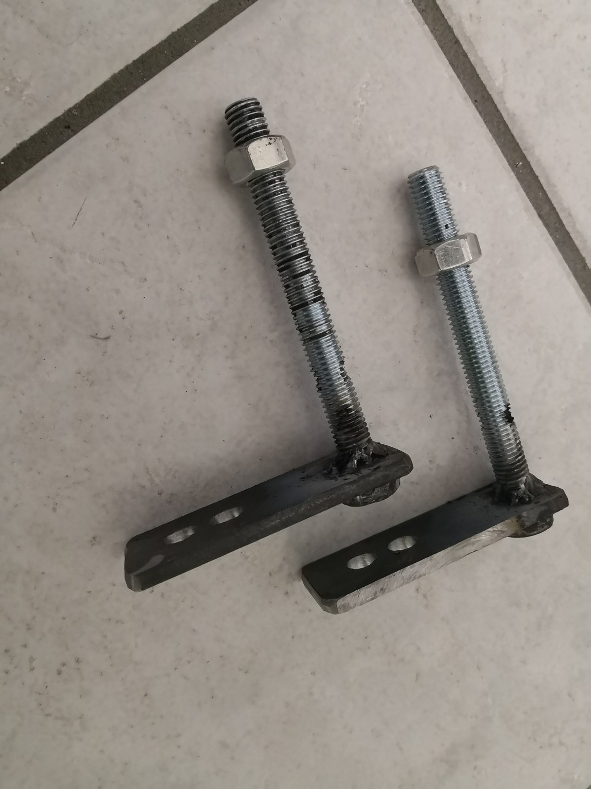

    It is all clear, at last I used a solution very similar at the one descripted by @Nick Moxley.
    Tomorrow I'll mount these, I hope that they will be good!
    The levers are 5 mm thick I think that they are very stiff.
    I welded a M12 x 120 mm bolt to the lever and I drilled on it a hole to connect the bolt at the motor shaft.
    With the M12 nut everything will be very stiff.

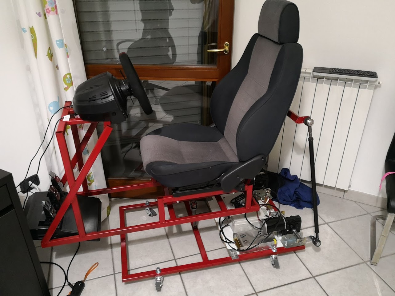

    Hello everybody! I think that I have finished my work, I have installed the sensors (woow they are very precise and I can use the entire resolution without gears) and I have made very stiff levers.
    It works great, I am testing it, I will post the video very soon.
    @Silvereng - I ll post a photo with all the measures in the afternoon.
