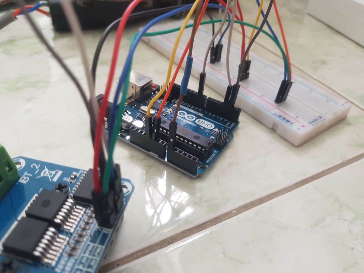

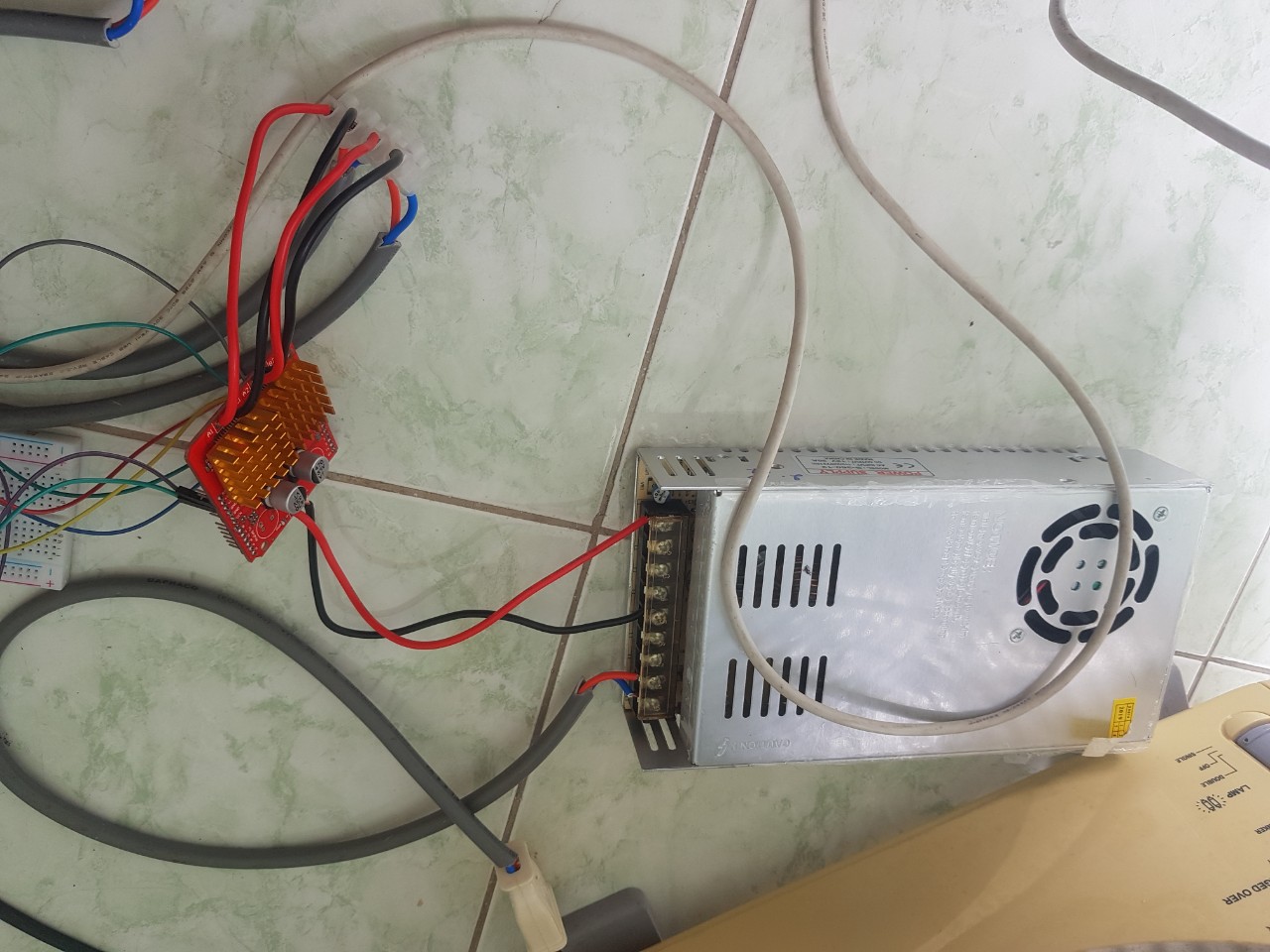

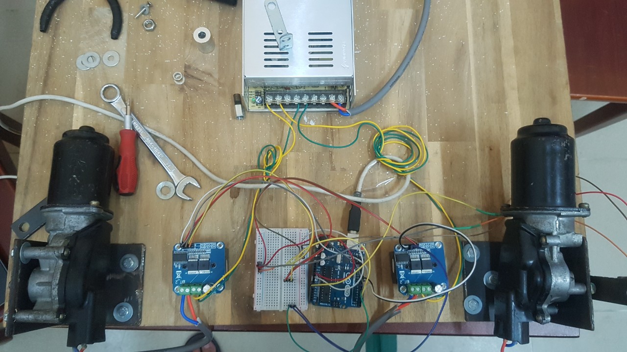

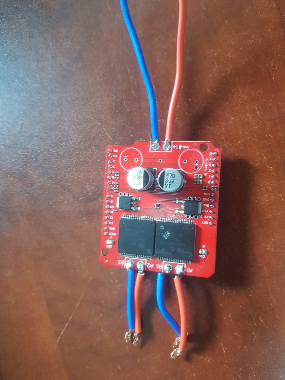

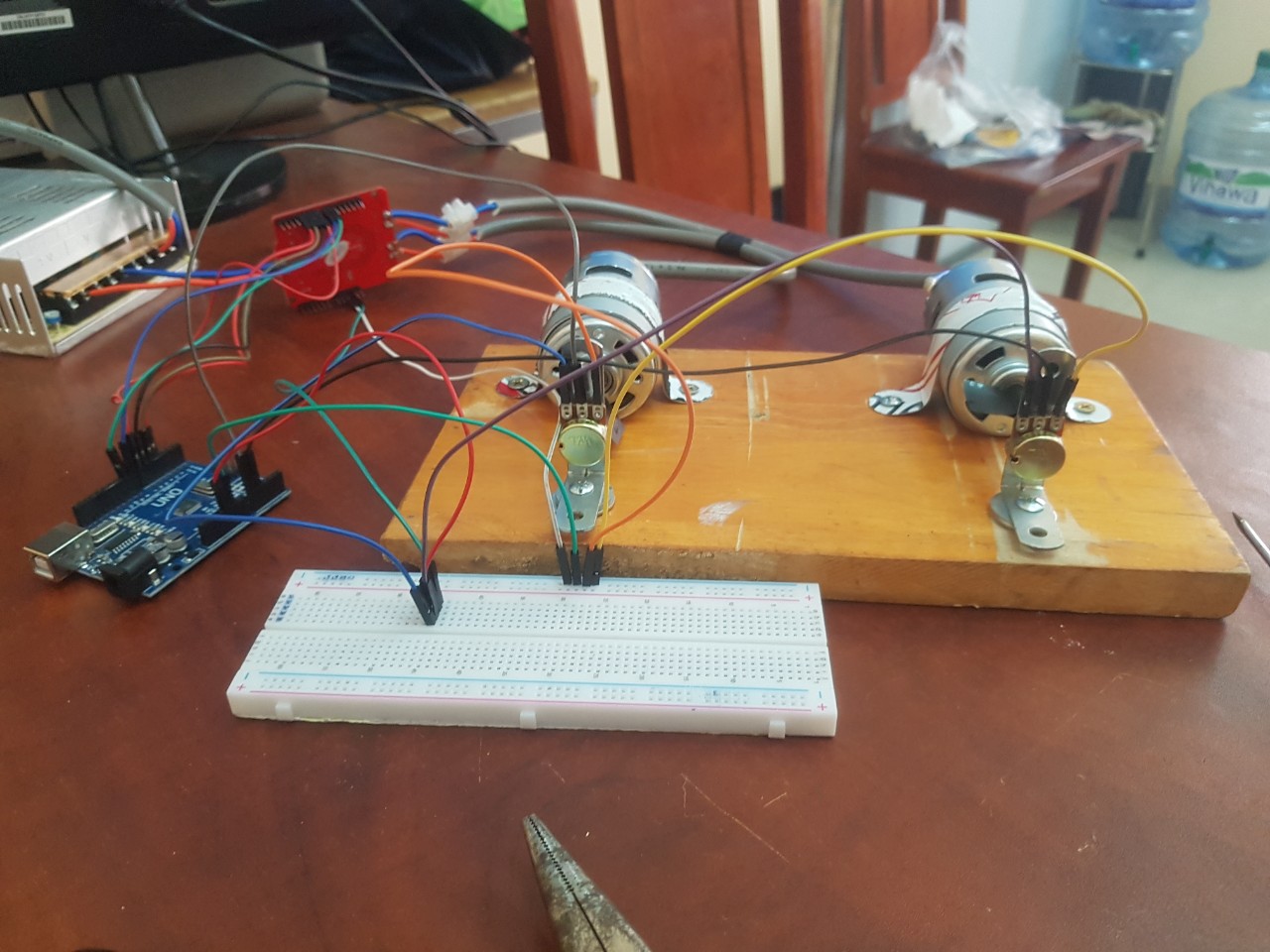

    parts in the project:
    1 Arduino UNO
    1 monster motor shield
    2 motors 775

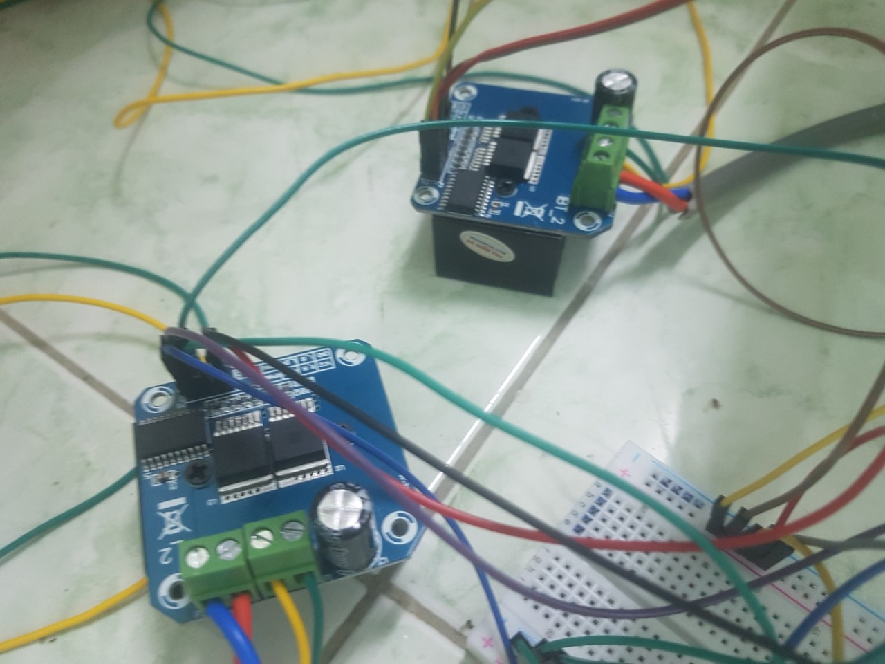

    However, due to not cooling properly, the monster motor shield has burned
    I changed the model, replaced it with H-Bridges
    After studying on the forum, I also gradually built a model for my project

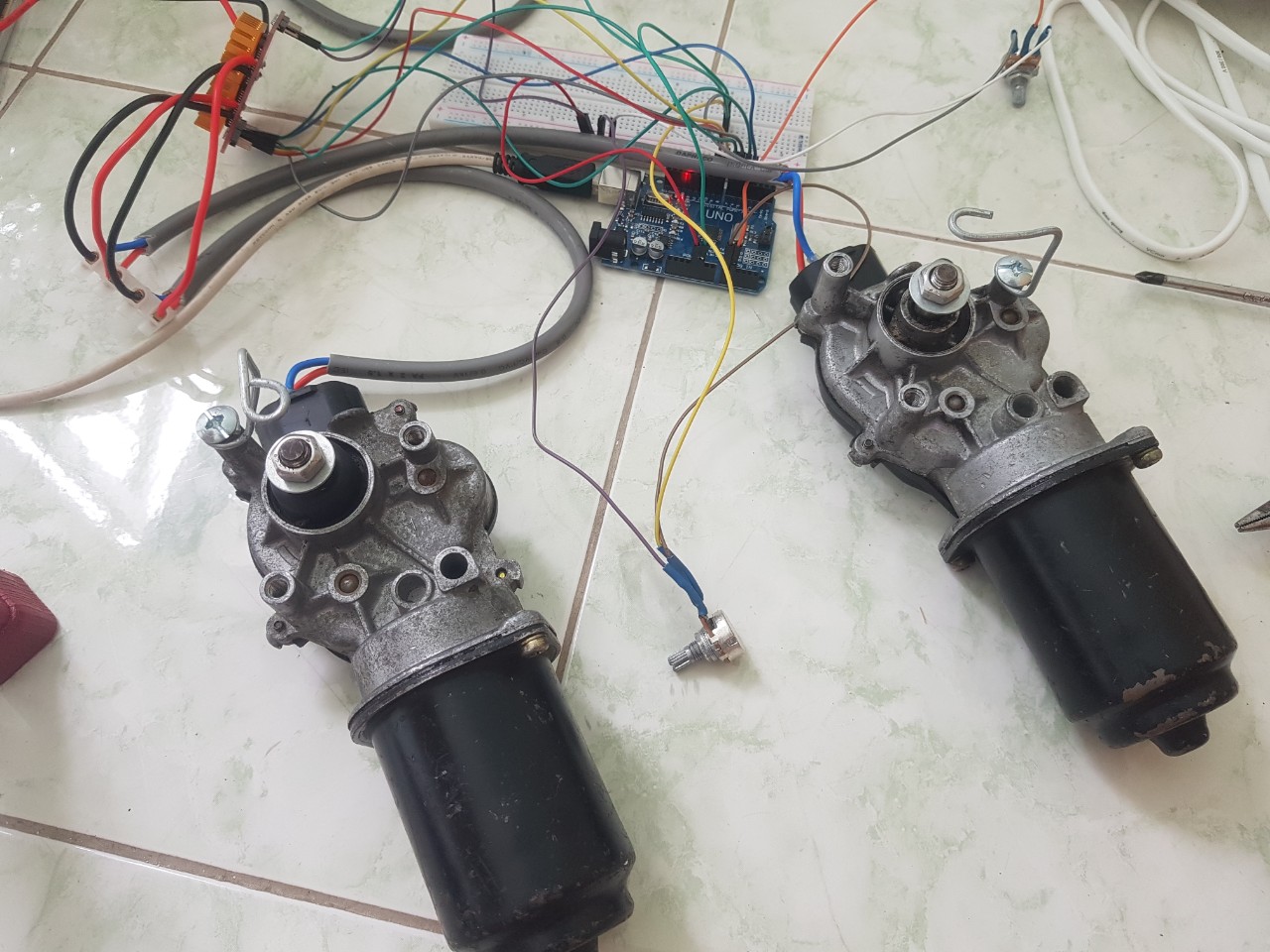

    please help me
    the left motor sometimes stops and does not move (video clips at 00:24 and 1:04)
    I don't know if the pot moves too much
  5. thanh tin
    thanh tin New Member
    Aug 20, 2020
    24
    173Coins
    +7 / 0 / -0
    the same goes for the right motor (clip 00:10)
  6. thanh tin
    Aug 20, 2020
    24
    173Coins
    +7 / 0 / -0

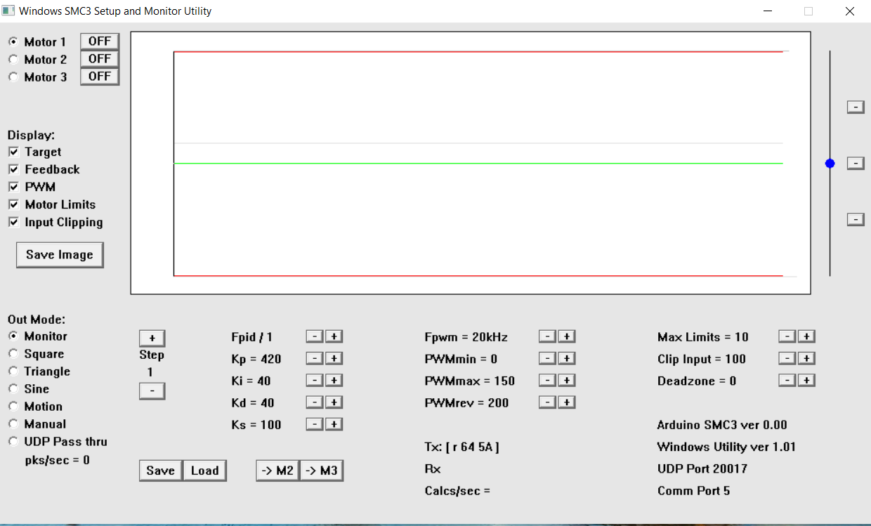

    and the parameters in SMC3, it seems that the PWMmax is too high

    your last 2 videos are private. we can´t see them.
    my first move would be lowering kp a lot.

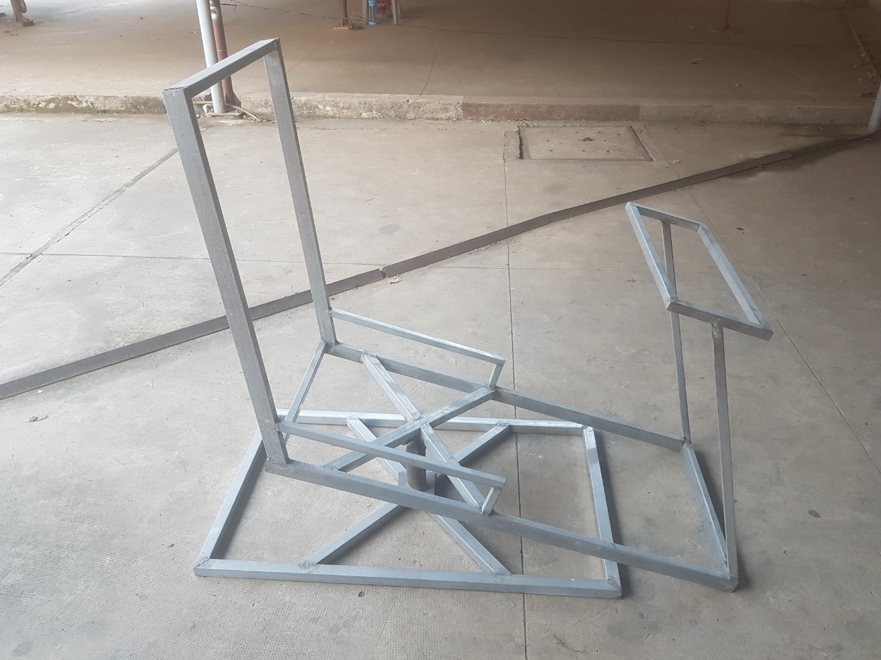

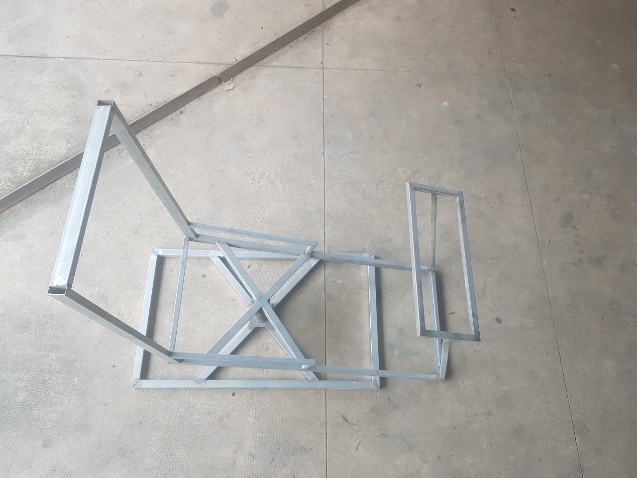

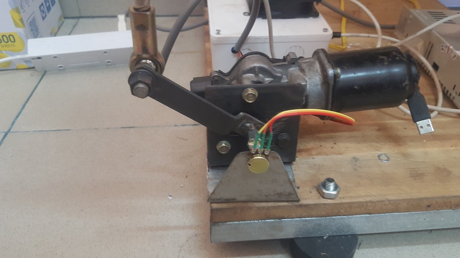

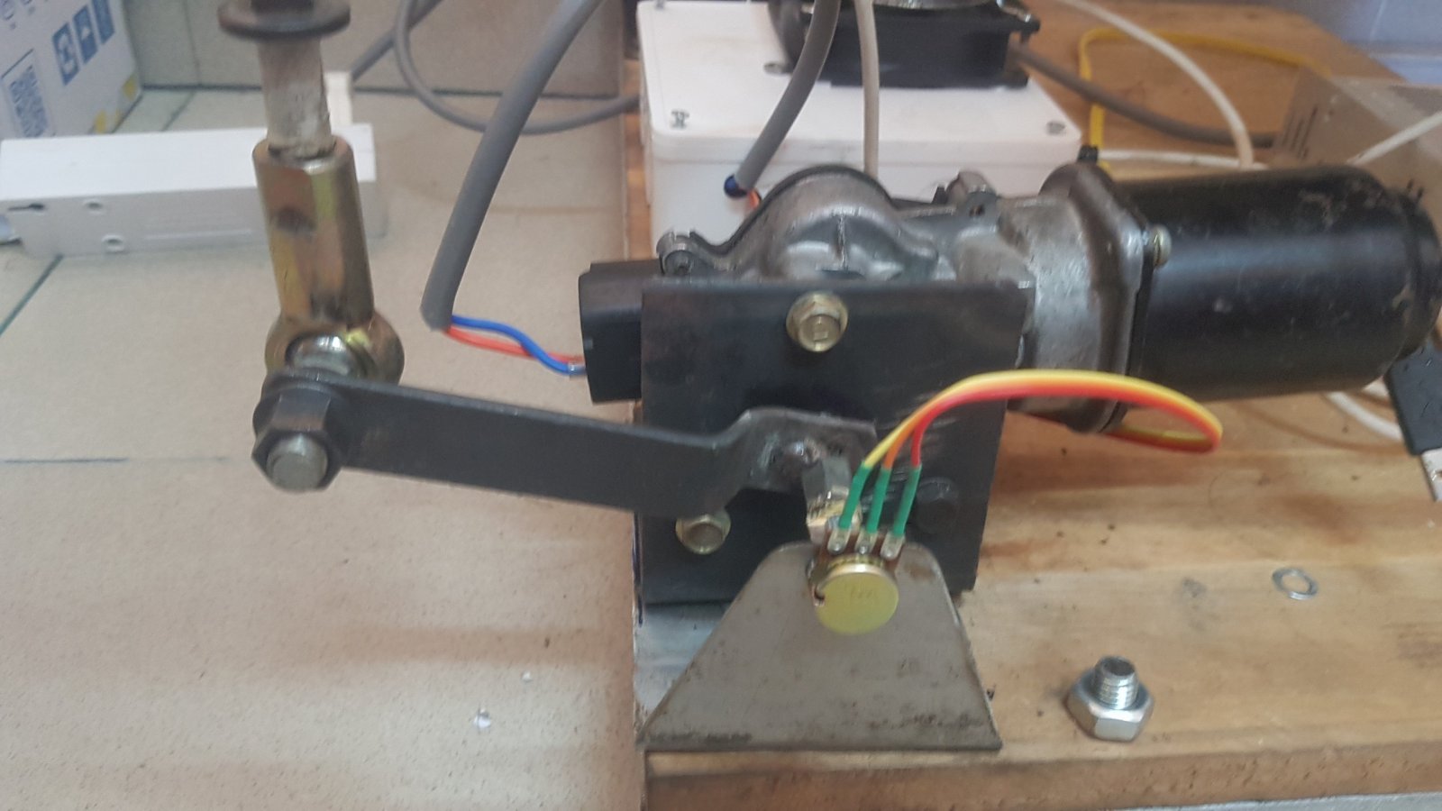

    Please post pictures of all of your settings, as it looks like the range is too great and the motors are overshooting the limits.
    Just some design related observations for you to consider.
    A lever provides maximum torque when parallel to the seat with the rod at 90 degrees, anything over 38-40 degrees up or down from there is very inefficient use of torque.
    For a relatively compact design torque is more important than speed, and I suspect you lever CTC length is likely too long for what look to be wiper motors, which aren't particularly powerful.

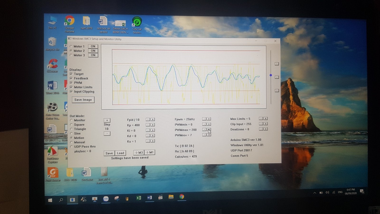

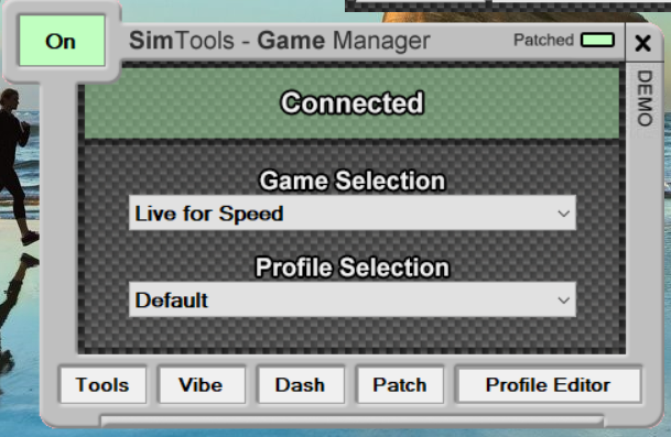

    some info in my simtools
  14. thanh tin
    Aug 20, 2020
    24
    173Coins
    +7 / 0 / -0
    with SMC3

    "A lever provides maximum torque when parallel to the seat with the rod at 90 degrees, anything over 38-40 degrees up or down from there is very inefficient use of torque.
    For a relatively compact design torque is more important than speed, and I suspect you lever CTC length is likely too long for what look to be wiper motors, which aren't particularly powerful."
  16. noorbeast
    21,592
    151,215Coins
    Think of an example like pushing a door, at 90 degrees to the door you can easily push it with your little finger using little force, but at an acute angle a lot of force is needed for little result.
    In addition the greater the Center To Center distance used on a lever the greater the linear speed, but the less the torque.
    The smaller the distance between the pivot point and the motor placement the greater the torque needed to drive a rig.
    Probably the easiest way to play with design Vs physics trade offs is with SimCalc: https://www.xsimulator.net/communit...e-linear-speed-and-forces-of-your-design.270/

    In your opinion, I should shorten the CTC to increase torque
  19. noorbeast
    21,592
    151,215Coins
    Yes, I suspect the CTC is likely way too big for such small motors with the mass of a full frame rig. Have you tried it under load for an extended period of time yet, that is the real acid test?
