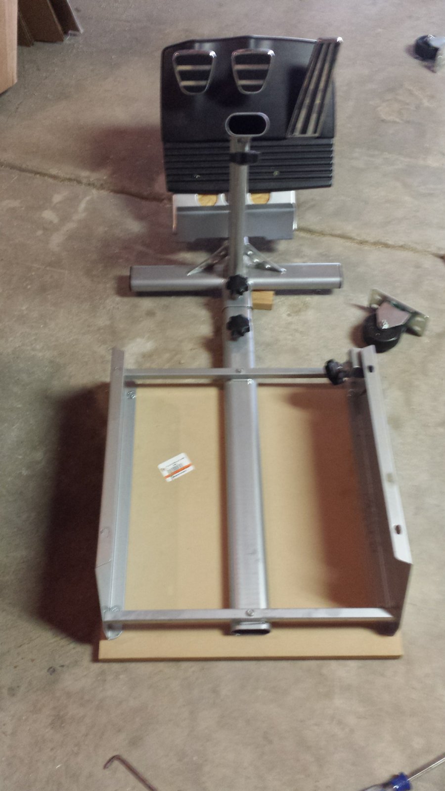

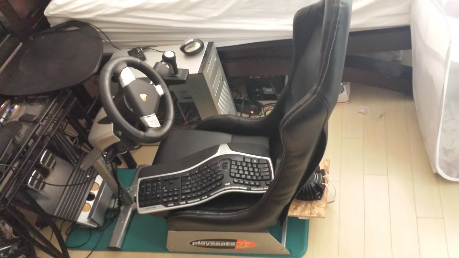

    Hello all, I'm starting a 2dof racing sim project with a budget of $200 and NO welding. (I have later determined to add Traction Loss with a budget of $100. Later in the thread [page 4], there is also added a H-shifter for $20 and a G-seat for $200).
    I have an Oculus Rift VR that has been sitting on the shelves for a good half-year, and when I discovered VR racing, I was hooked! I put my Aura shakers to my racing cockpit, and the immersion was even more real (although I don't have Simvibe). However, the turns made me nauseous, as I am very prone to motion sickness in VR. The solution? Make a 2dof simulator!
    My limitations:
    - low budget: around $200
    - no metal soldering tools or skills (although I can do electrical soldering)
    What I have already:
    - Oculus Rift VR headset ($400)
    - VR capable PC with 970 gtx ($400)
    - Playseats Racing Simulation Cockpit ($60)
    - Fanatec Porche Turbo S Wheel, shifter, and pedals ($60)
    - Aura shakers with amp ($60)
    - Basic wood-working tools
    Parts purchased so far:
    - 2 Motors: Volvo S40 2004 Wiper Motors USED on ebay - total $40
    I picked these because they already have the motor arm on them and they have a large mounting bracket.
    - Pivot Mechanism: Mustang drive shaft with 2 universal joints on Craigslist - $25
    - Power Supply: DPS-600PB server power supply on ebay - $16
    (only 1 since the wipers are probably low-powered)
    - Arduino Board: knockoff brand on Amazon with some wires, etc - $8
    - Monster Moto Shield: I got 2 (1/2 boards) off Amazon because the cheaper combined one would take too long to ship from China. The extra $10 hurts... $20
    - Potentiometers: 5pcs Single turn 10k - $8
    Total so far= $117
    I have $83 left
    Need to purchase:
    - heatsinks and heatsink tape for the boards (waiting, since I don't know the CPU size on the boards)
    - metal rods and end ball joint (I think I have to wait until I figure out the arm size on the motor)
    - coupling for the pots (I have no idea how I'm going to put the pots on)
    - I have a medium-sized 12v fan (smaller than PSU fans)
    - Wood
    I am waiting for my orders to ship -- but in the meanwhile, I'll be working on modifying the universal joint from the drive shaft :)
    I've uploaded the pics of my current set-up
    Am I missing anything? Do I have the wrong parts? Any thoughts or suggestions?

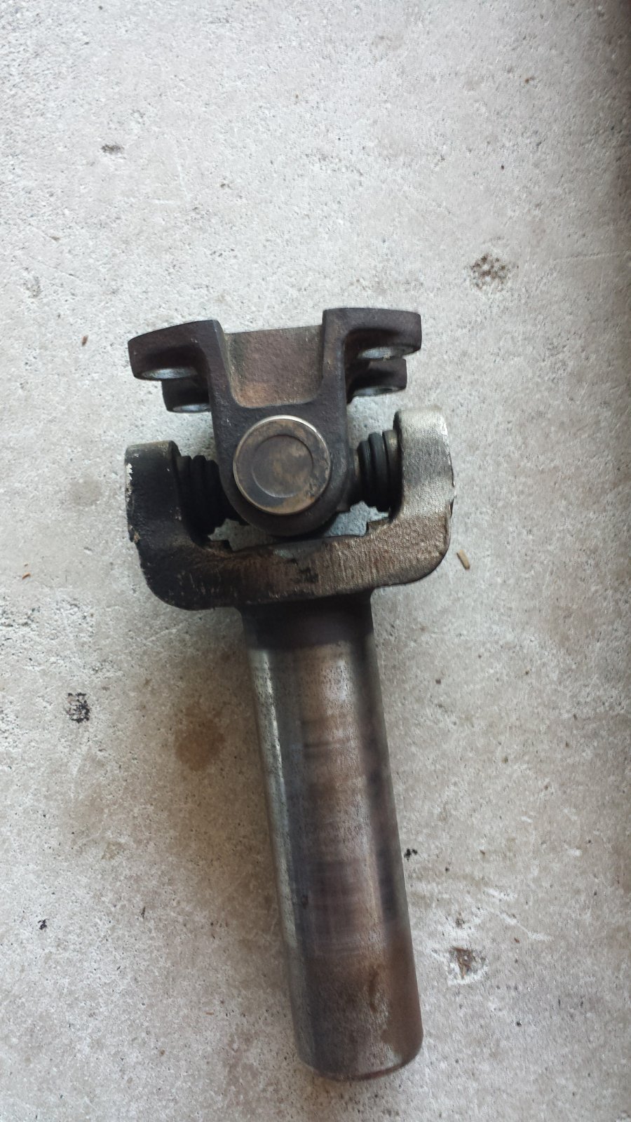

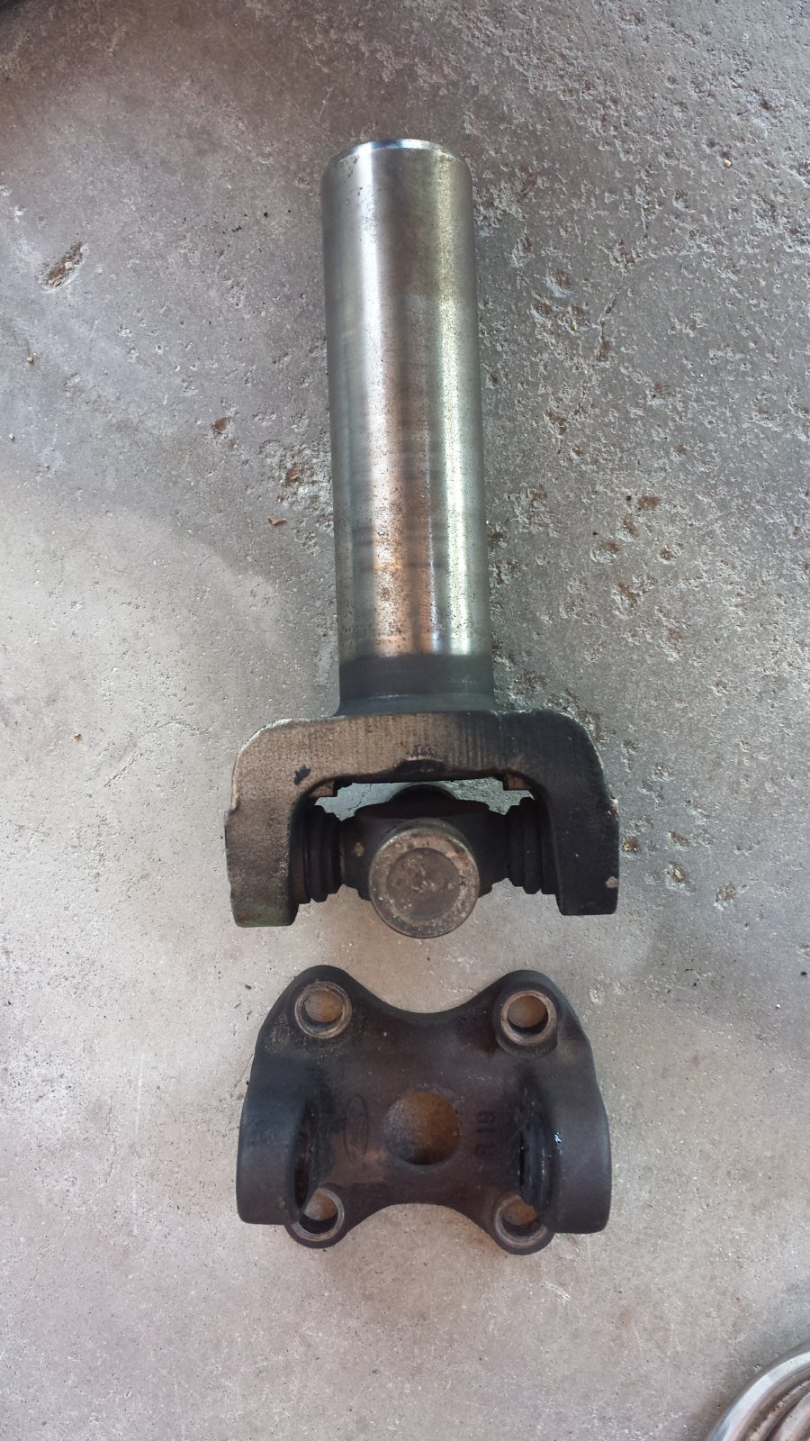

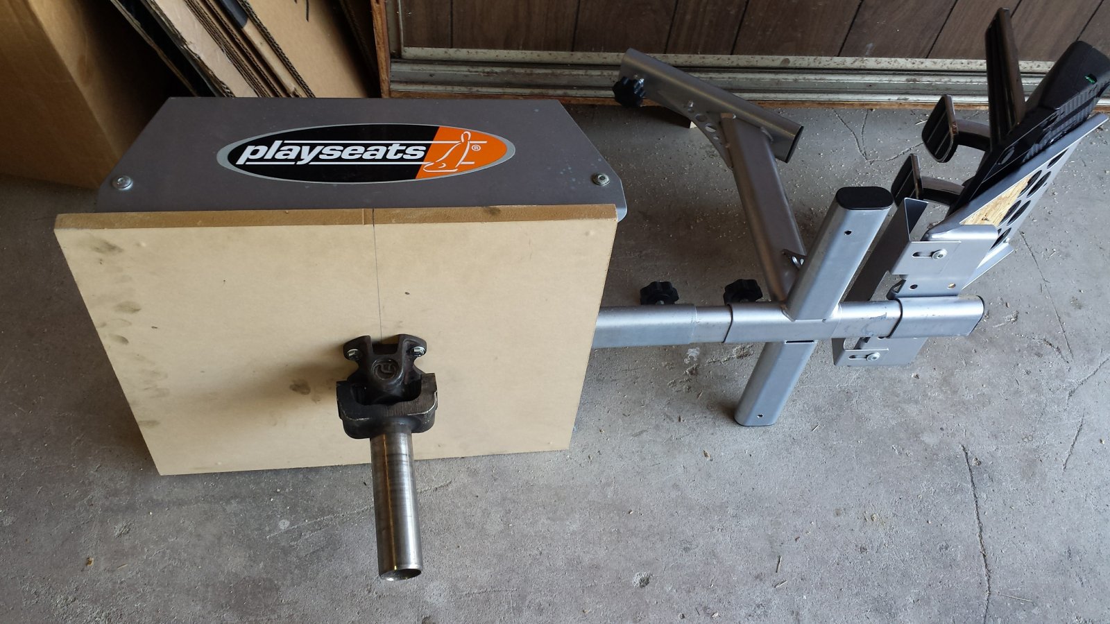

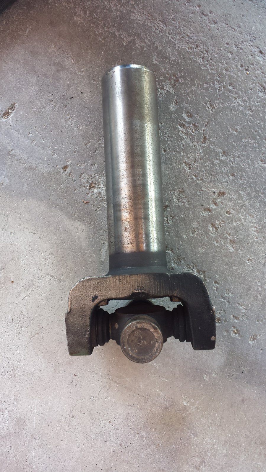

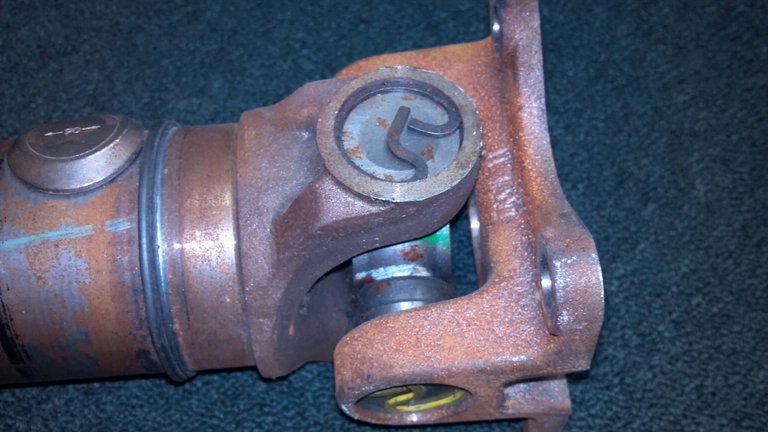

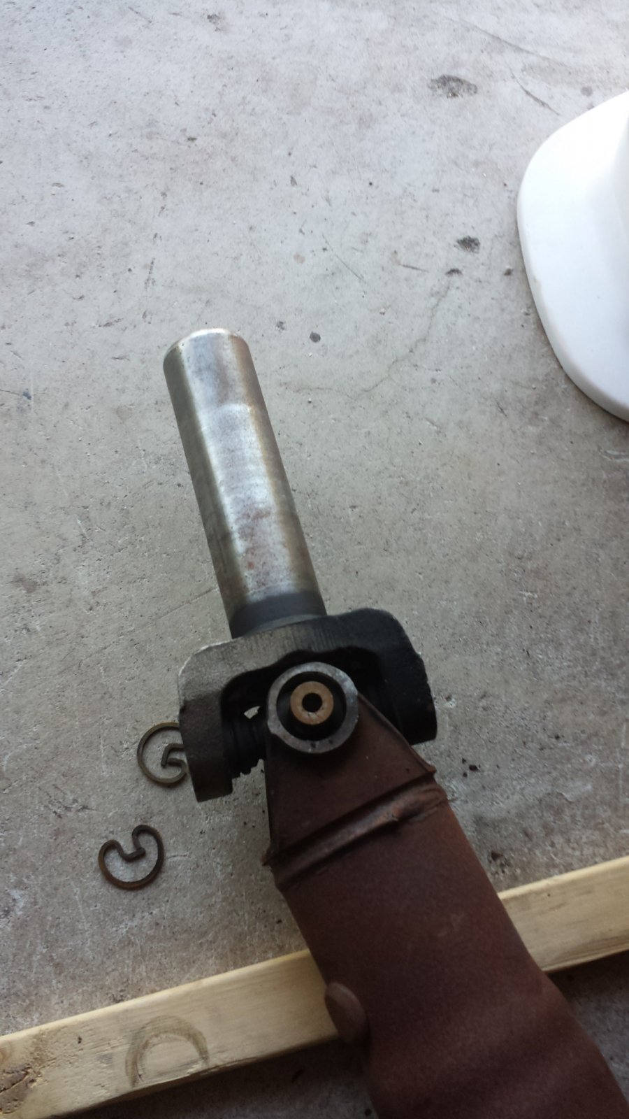

    Today I worked on the pivot mechanism.
    I bought a Mustang drive shaft off Craigslist for $25.

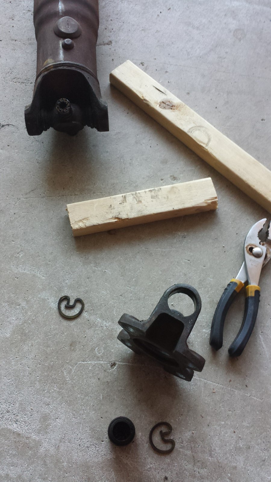

    Procedure:
    - This is kind of like what I have:
    - Take off one end base of the u-joint because it has 4 holes for securing it under my racing cockpit.
    OK, now that this base piece is off, I can work on the other end.

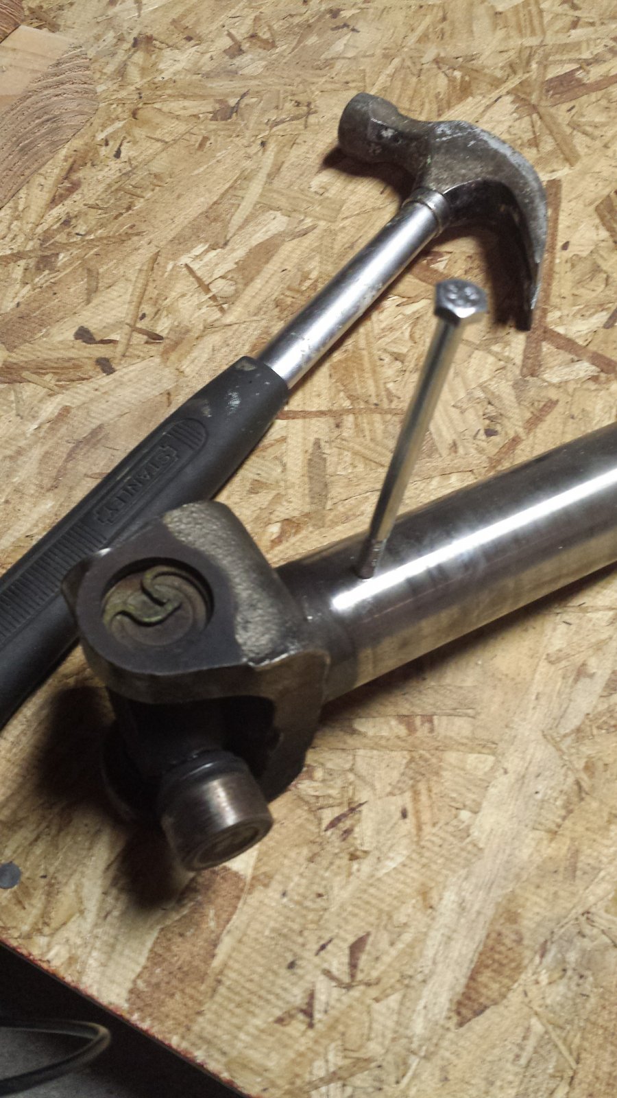

    Taking off the other end of the drive shaft that has the u-joint. This has a proper-length shaft.
    Take out the pin and hammer in so that the other side pops off
    Here is the shaft end taken off
    - the base and and the shaft end pictured together
    combine the ends together on the u-joint to form the pivoting mechanism.
    Finished for now!
    I need to attach the top to my cockpit base using wood and screws
    I need to make a wooden base and drill a tight-fitting hole for the shaft to rest on. I will also try to drill a hole on the shaft and nail it so that I can prevent it from wiggling left and right.
    That's it for today :)

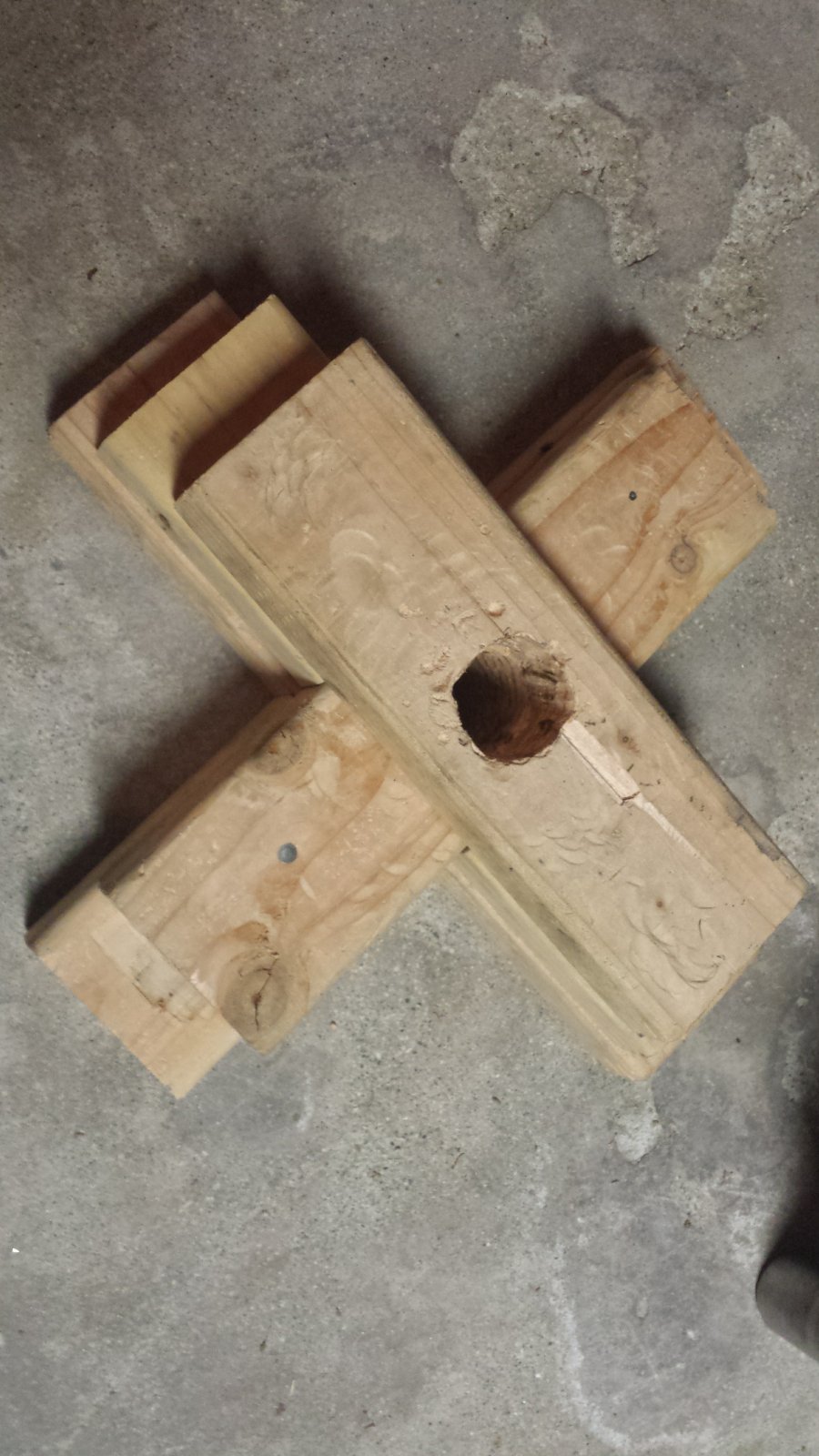

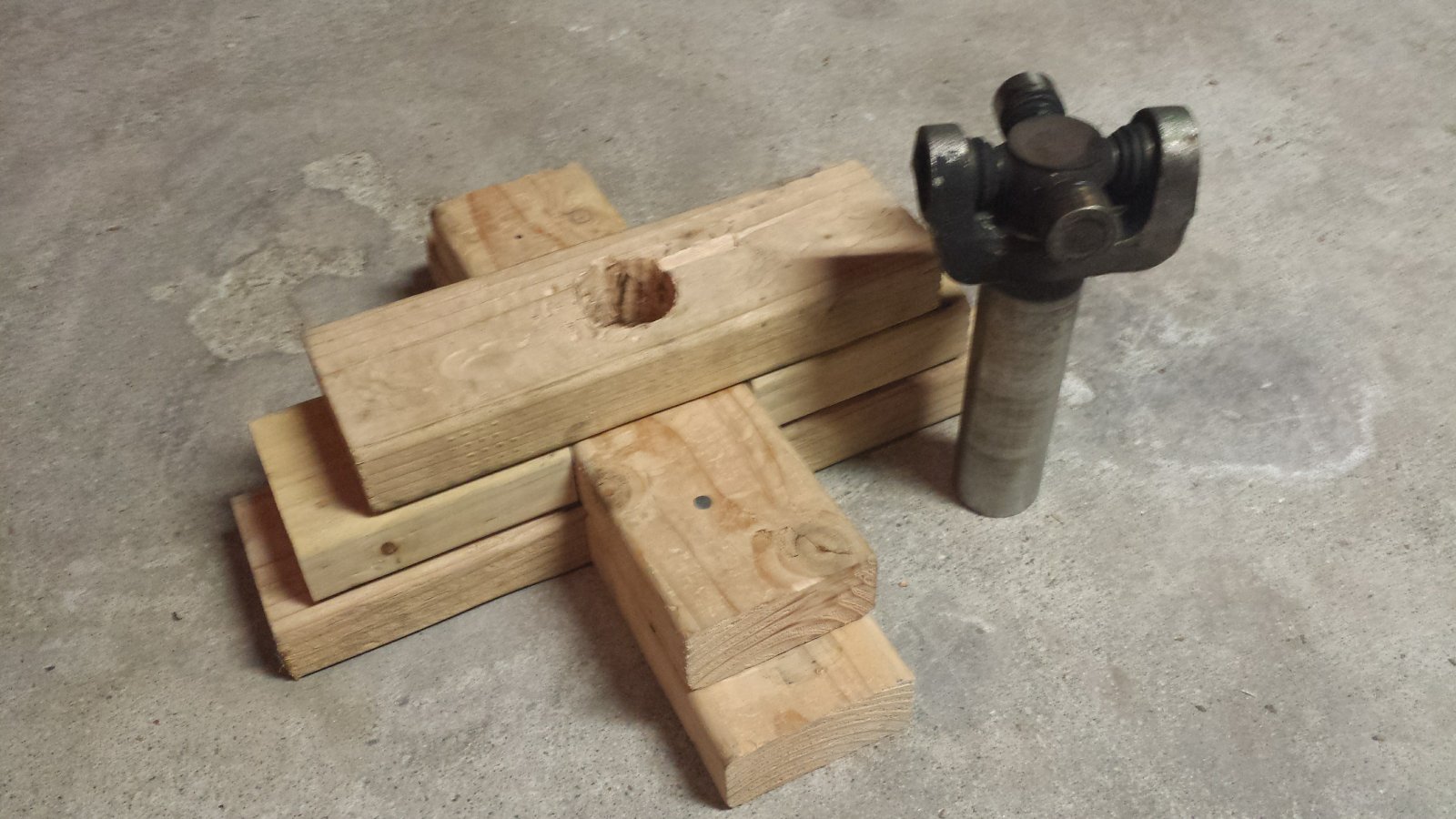

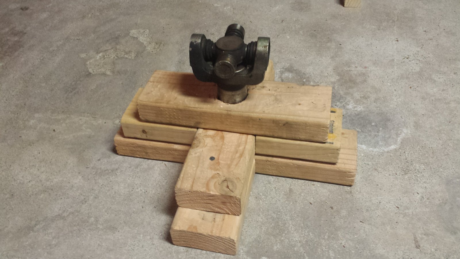

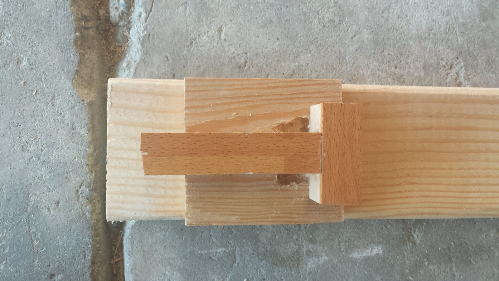

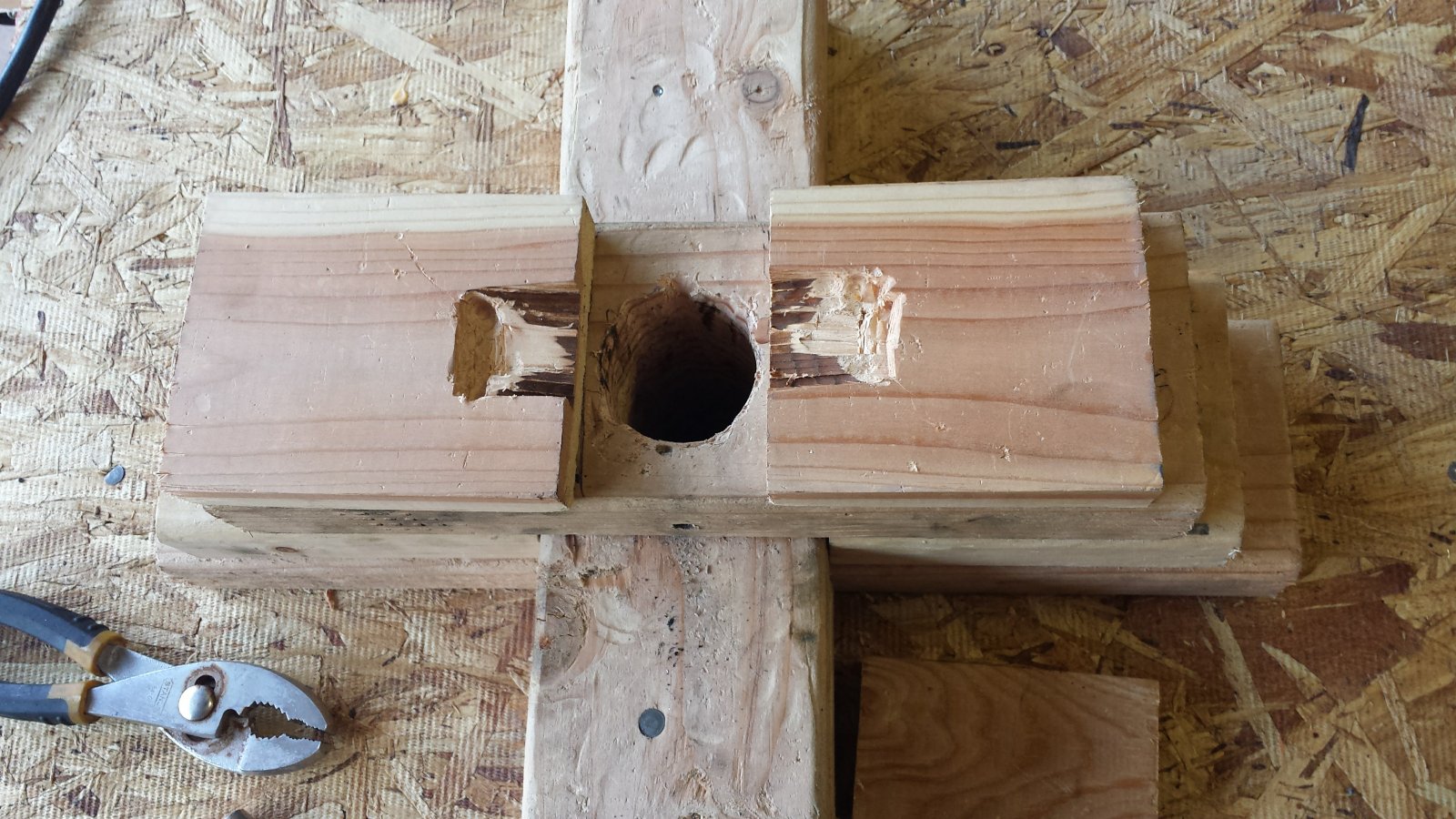

    Next, I'm making the wooden holder that will secure the pivot mechanism in place.
    I layered some 2x4 pieces, glued them, then drilled a large hole in it
    Here it is next to the pivot mechanism
    I had to spend some time to make sure that it was a perfect and tight fit. Here is the final result
    It is snug and secure!
    Next up is making the wooden frames

    Does the U joint have anything to keep it located, like a threaded rod sideways through the top layer of wood?
    I ask because it is subjected to a lot of force and what my start as a interference fit may not last, as wood can be compressed.

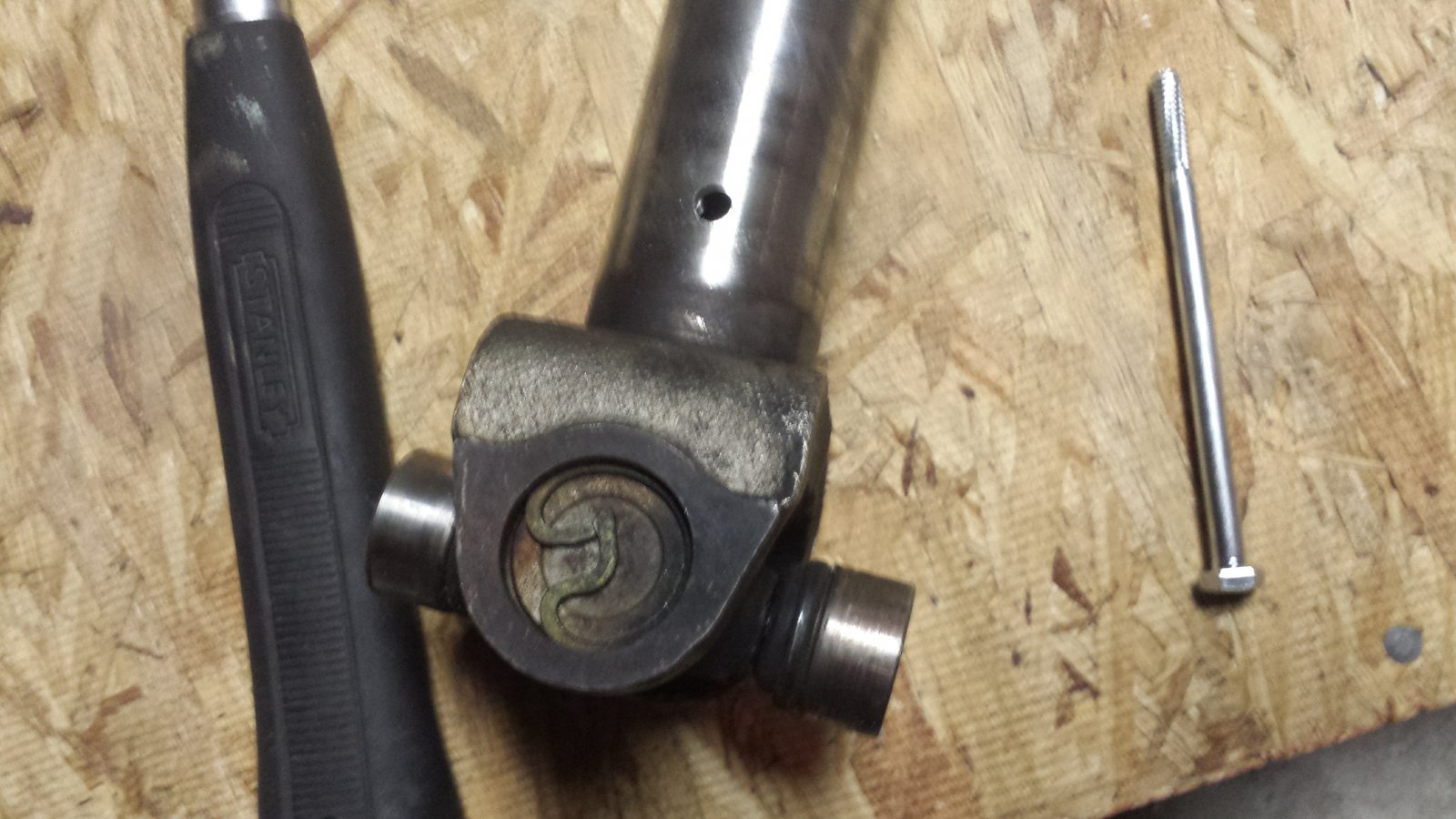

    Hello! First of all, thank you for your input and help :)
    I think your concern is that the u joint will swivel because there is nothing to hold it in place?
    I thought about 3 solutions. 1) drill the wood and the U joint shaft and put in a bolt through both (i think this was your suggestion) or 2) put in wood pieces right next to the U joint so that it has no space to swivel, or 3) nail in large nails (4) vertically down right next to the U joint so that it does not swivel.
    I guess your suggestion would be the most solid choice (but the most time consuming)? IF there is as much pressure there as you mention it, it sounds like it's worth the time?
    What do you think about the other choices?
    21,605
    151,287Coins
    +11,033 / 56 / -2
    I doubt anything but the first option will hold up over time, but of course it is your choice.
    It is more work but the very best option would have been a length of C channel steel that the top wooden block fits snugly into and then bolt through that, the timber and the U joint shaft.
    Another no welding option for a pivot that has been tested is detailed in this thread, though there are many others like it: https://www.xsimulator.net/community/threads/simulateur-2-dof.7228/

    i've opted to go with your advice and drill a hole in the pivot shaft, and additionally to put wooden blocks on the sides:
    drilled hole
    the bolt will go through the wood into the shaft.
    and i put wooden blocks on the sides for enforcement

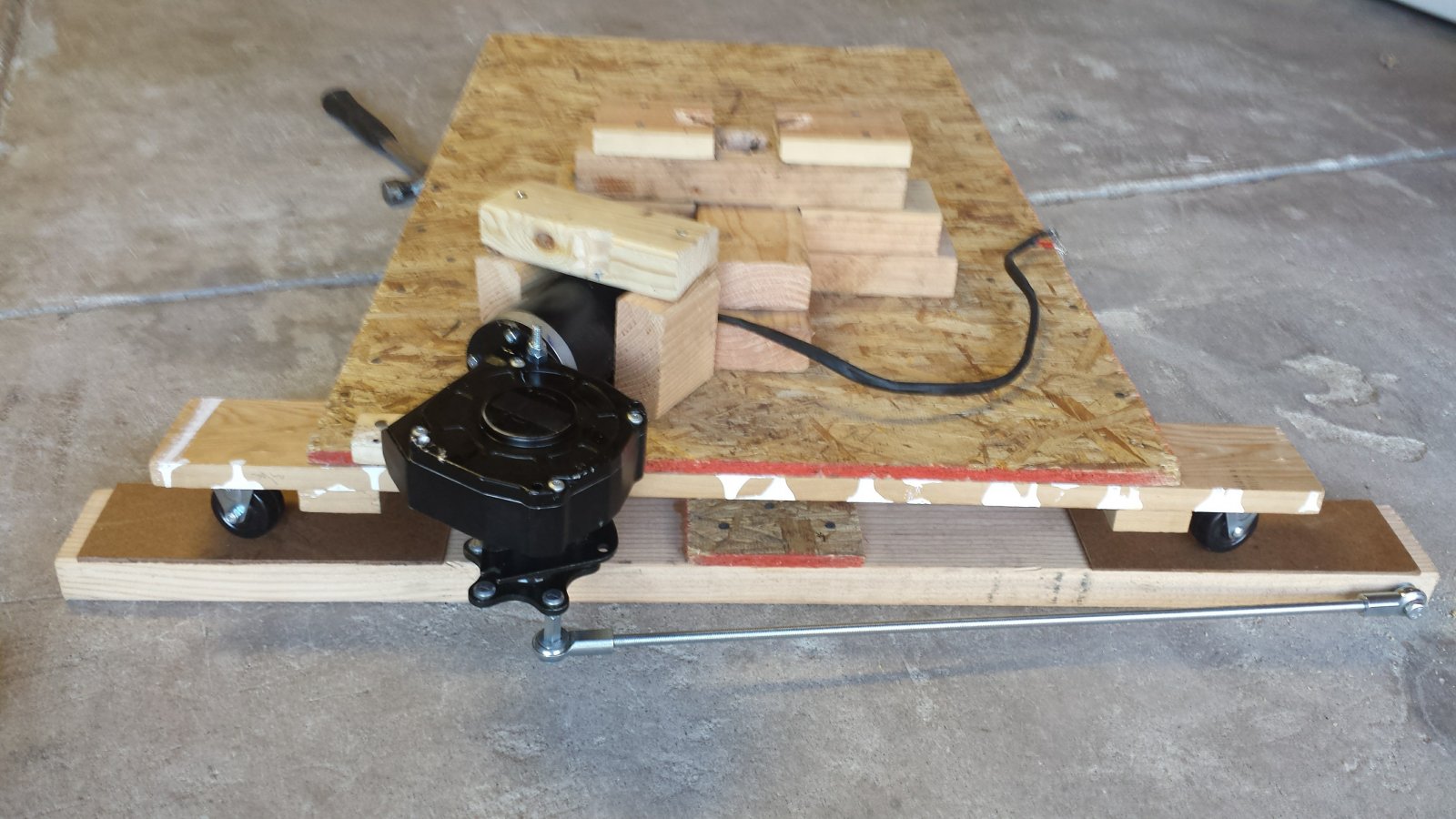

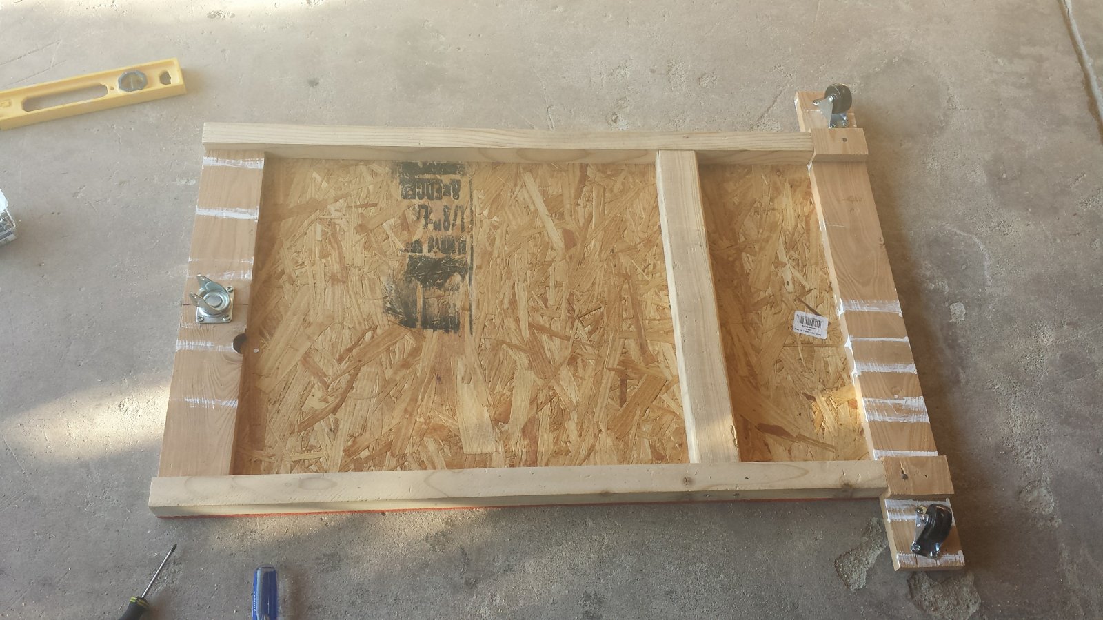

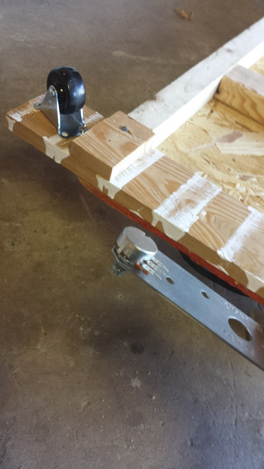

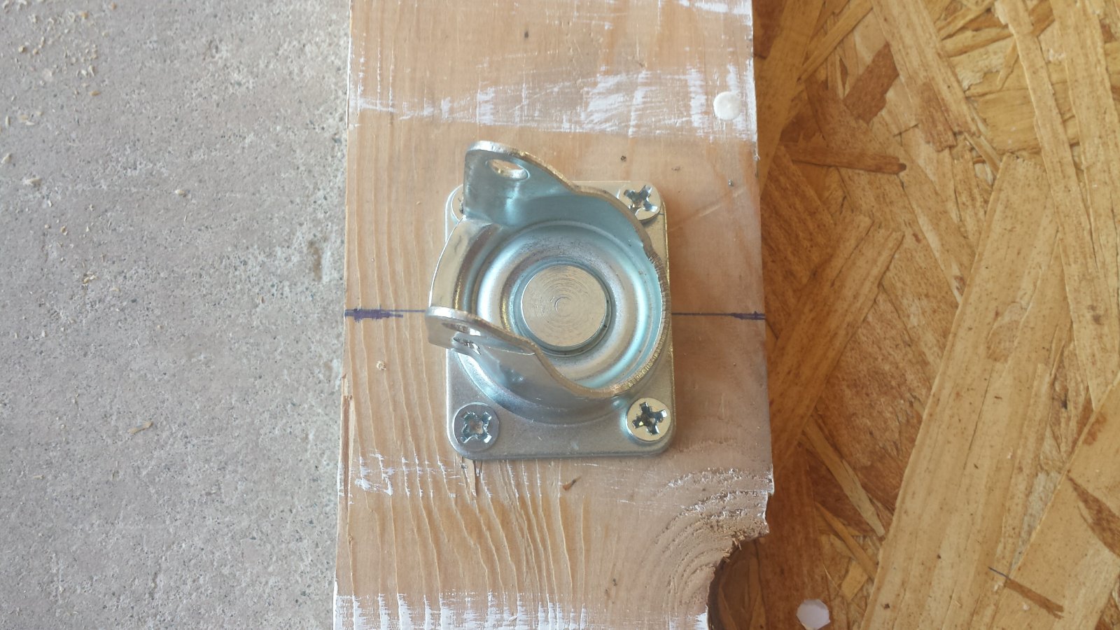

    I've made the top board and the bottom frame for the Traction Loss that swivels:
    Here is the underside of the top board. I put 2 wheels for movement and a caster wheel on the left for swivel.
    I pulled the wheel out of the caster wheel
    Here is the bottom frame
    This is where the caster wheel will fit on the bottom frame
    Here is the board, the pivot holder, and the bottom frame put together:
    if you look carefully, where the wheels meet the bottom frame, i put a 2 pieces of laminate boards to make the surface smooth.
    it swivels, but when i put about 50 lbs of weights, it takes quite a bit of force to move it.
    i hope the wheelchair motor is up to the task.
    i even thought maybe i need to buy skateboard wheels, as they are made to move with much weight on them (because of ball bearings)? idk

    I'm inclined to agree that you need wheels with ballbearings, but that caster swivel looks like it may be undersized for the load that will be on it, too.
    I've personally never done traction loss so take me with a grain of salt but it's in my future plans; I've seen a few heavier builds around the internet where they use boat seat swivels like this http://amazon.com/attwood-17720-Attwood-Boat-Swivel/dp/B001O0D6SI that would probably be able to handle the weight better without binding up IF you find the caster is your bottleneck there.

    ah! thank you again for your help. atm, i'm not sure what is causing the friction, but it doesn't seem to be the caster wheel (with only 50lbs so far). however, once i sit on the chair, i think it will become apparent where the problem lies. the main weight is away from the caster, so i tried to incline the board towards the front. if it ends up being the caster wheel, i have you to thank for a great solution that most importantly fits by budget :)

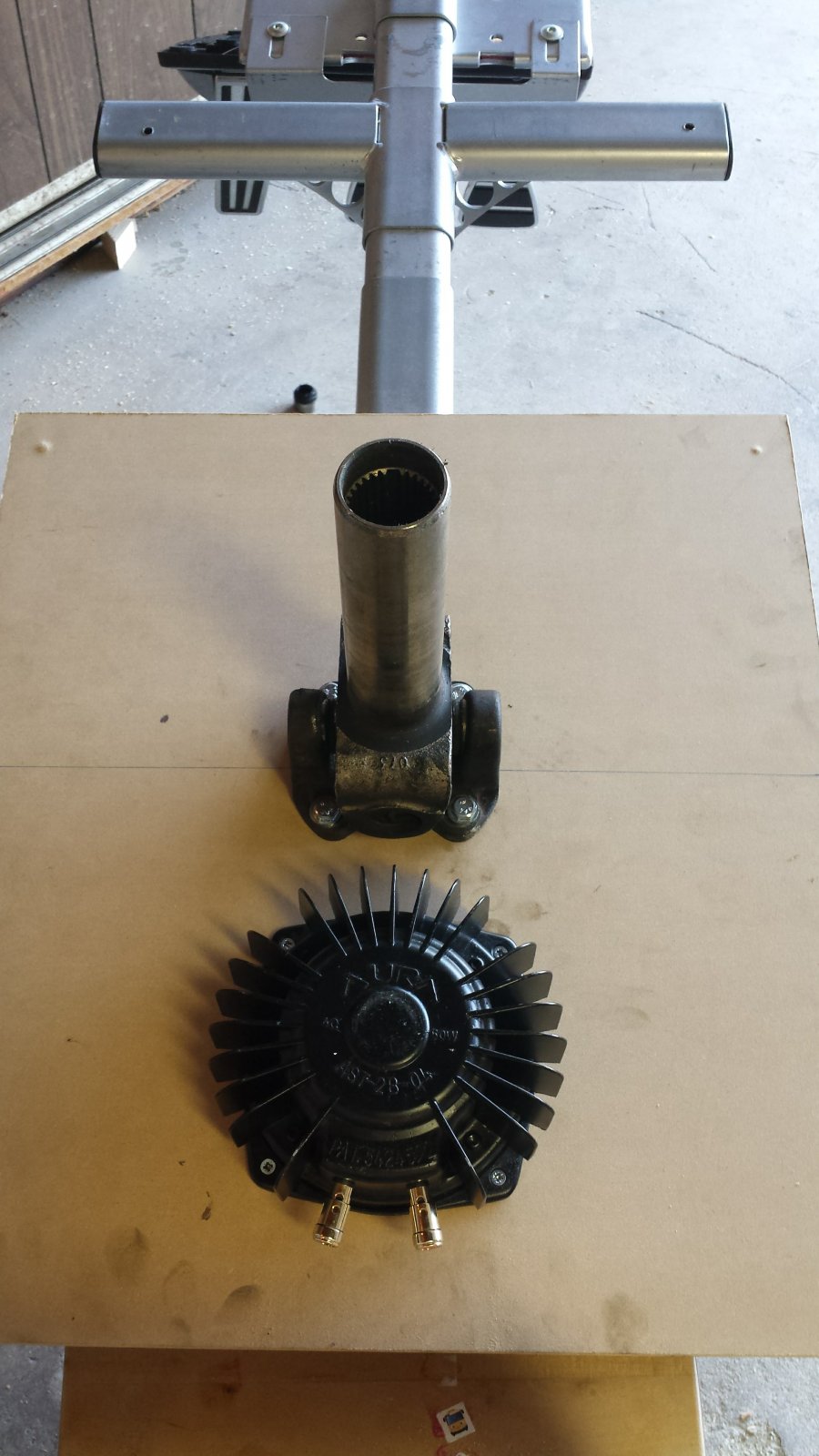

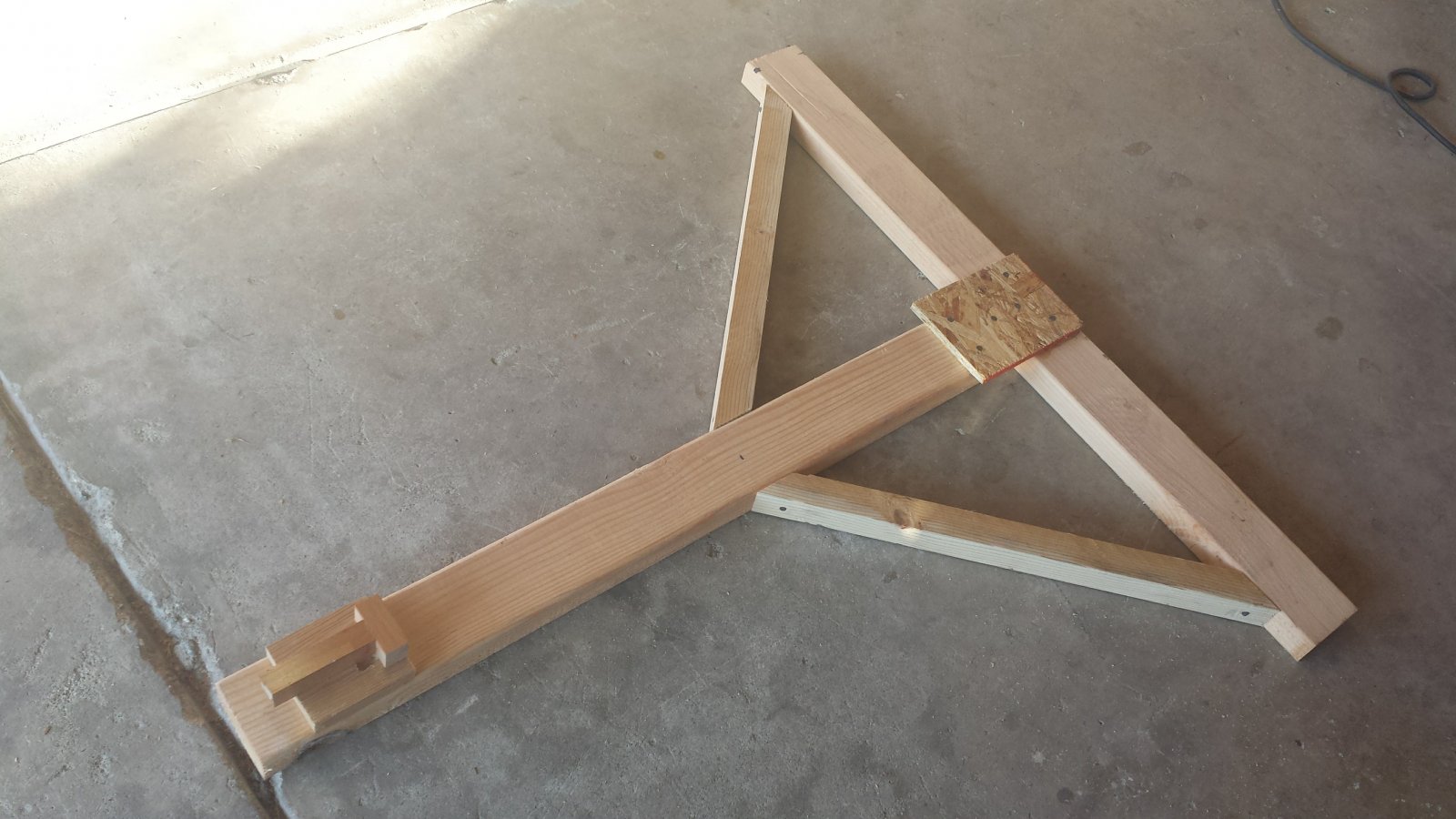

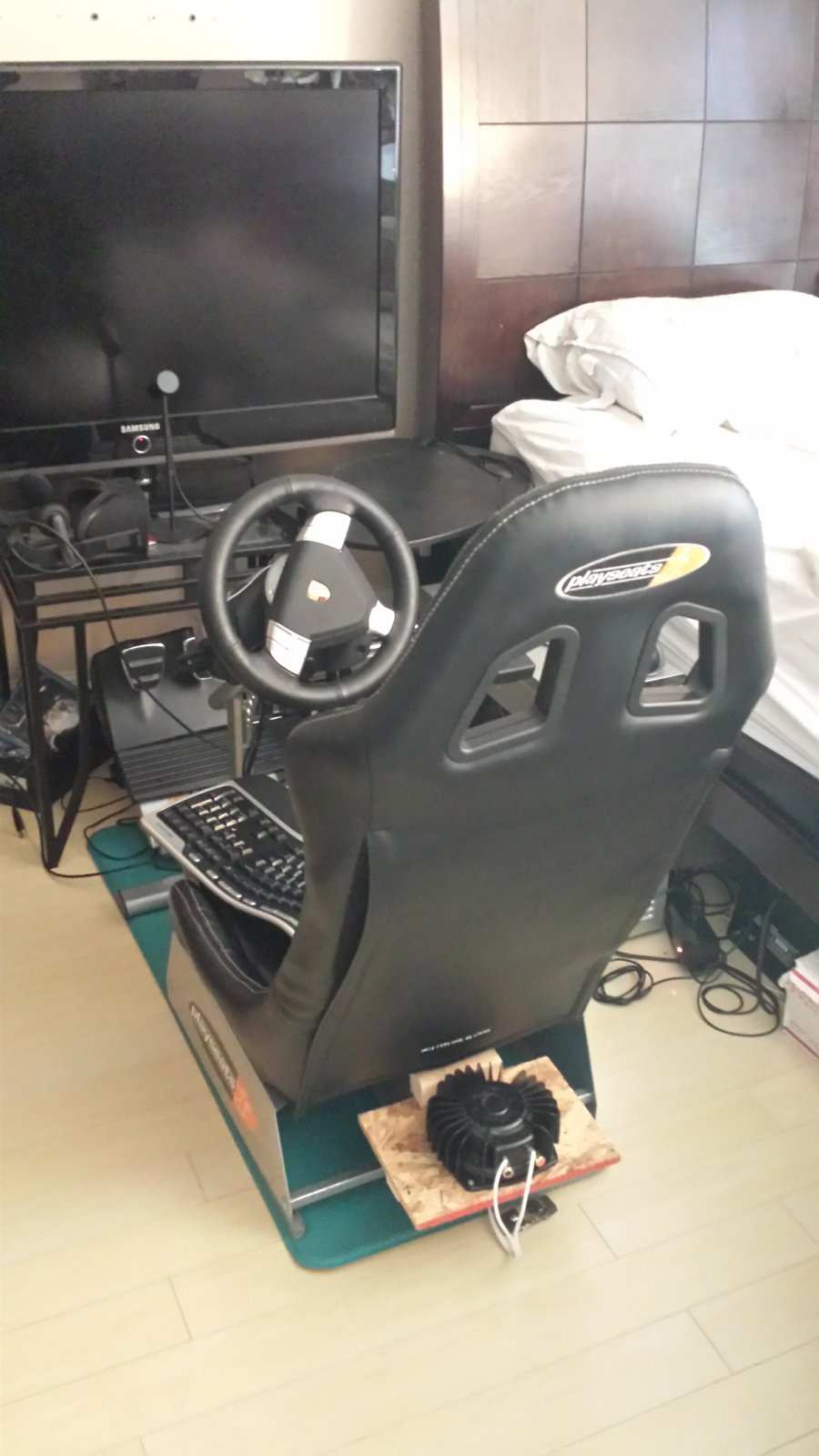

    Next small step: putting the pivot mechanism on the bottom of the racing sim seat frame.
    I attached a 3/4 inch MDF to the bottom of the racing sim frame
    Next, I attached the top of the pivot mechanism to the bottom of the board (of course, after finding out the center of gravity)
    Finally, I attached the Aura Shaker to the bottom as well. I'm not sure if this is the best spot, but it is the easiest spot for it.
    oh man, i only have an hour here and another hour there to work on this project... this project is going too slow and starting wear down my enthusiasm :( hoping i can keep it up to the end...

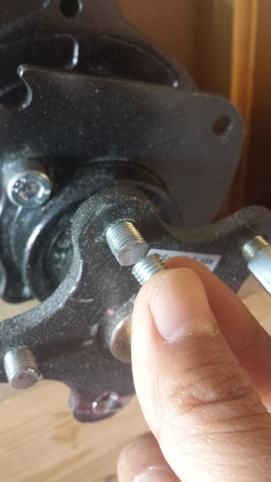

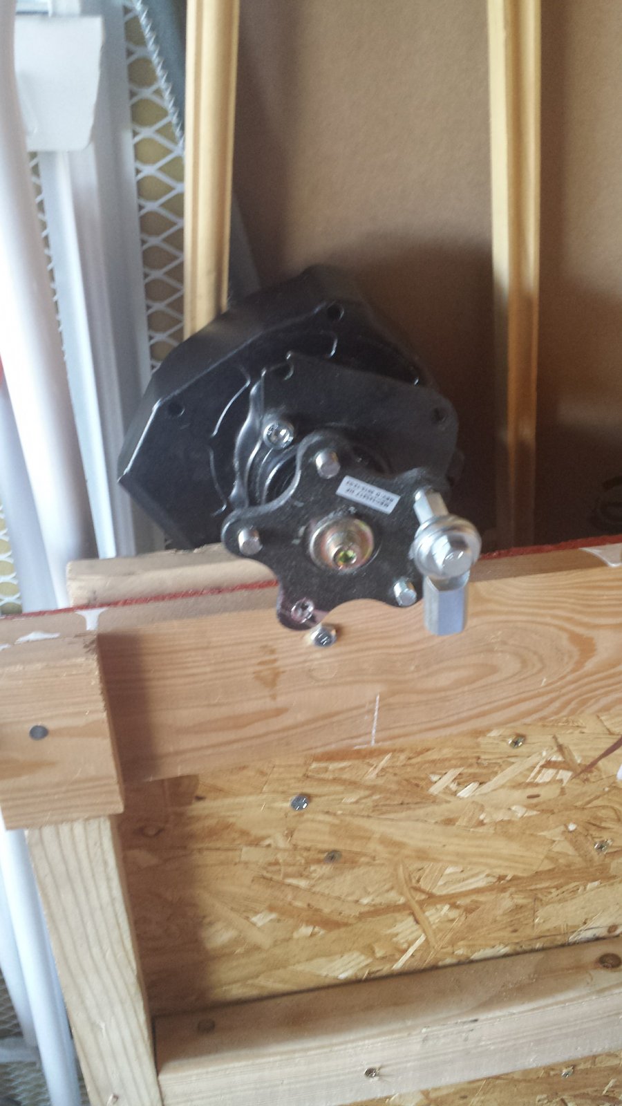

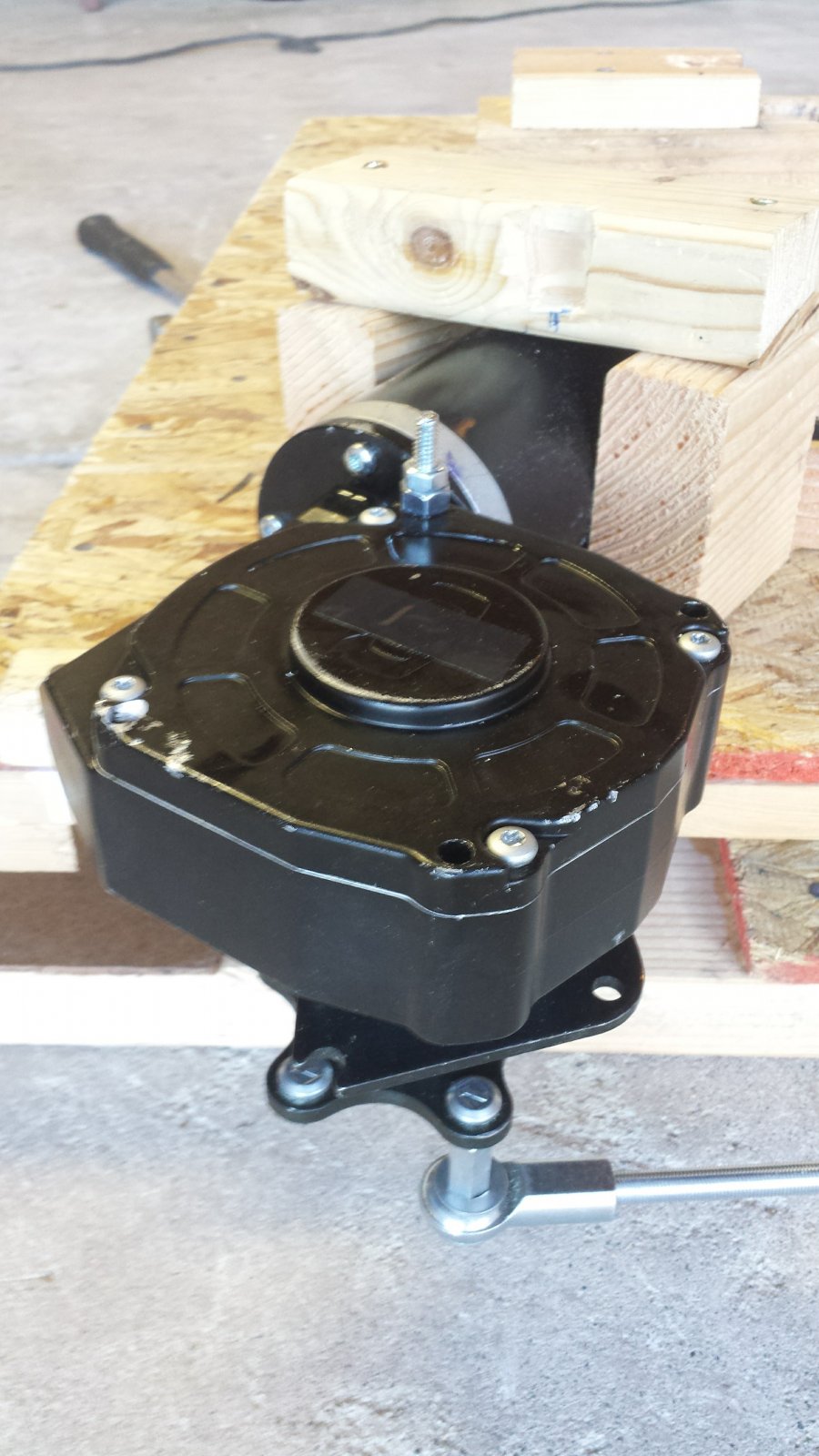

    Next, i'm installing the wheelchair motor (I got the wheelchair motor off ebay for $40)
    First, i'm sawing off the bolts except one, where the heim joint will attach to
    I bolted the motor to the base (kinda hard to see)
    I attached the pot to a piece of metal, but also sawed off the pot end because it was too long
    this is how the pot will attach to the motor (it will be upside down)
    just in case something goes wrong and the arm goes against the metal bar, i attached the metal bar with Velcro... i will also use some rubber bands to keep the pressure on the pot.
    next, although the motor is bolted to the base, i put extra wood pieces to keep it in place
    here is a zoomed out pic
    and here is the close-up of how the arm and the pot are positioned
    hmmm.... for those with experience, what is the likelihood that the arm will go outside its parameters and swing 360 degrees, knocking off the pot?
    i thought of another solution, to put the pot at an entirely different place, but then the pot will only turn maybe 50 degrees...
    another solution is to put a pot that spins infinitely at the back of the motor (where the break used to be), but i don't have such a pot, and i'm not sure which one to order (the pot has to be able to spin more than 10 times)
    i even thought maybe i can use lego wheels to make the pot turn only once, but lego wheels produce a noisy sound....
    any ideas? or is this good enough? I have about 2 extra pots...
