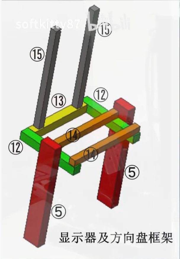

    OK,get straight to the point.This project is learned form so many Chinese diyer,Combined with my own situation, to change the scheme.

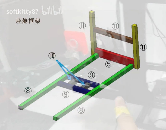

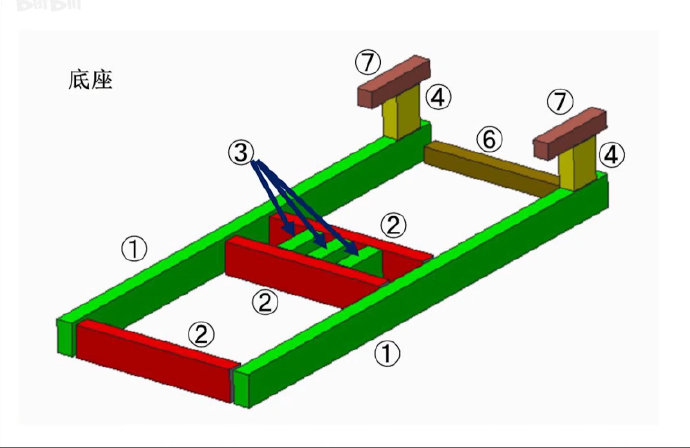

    Here are the drawings I refer to
    1pedestal
    2cockpit
    3Steering wheel bracket
    I'm going to do this with AL.Because in China, this kind of material is not too expensive.It can be fixed with nuts and bolts without welding

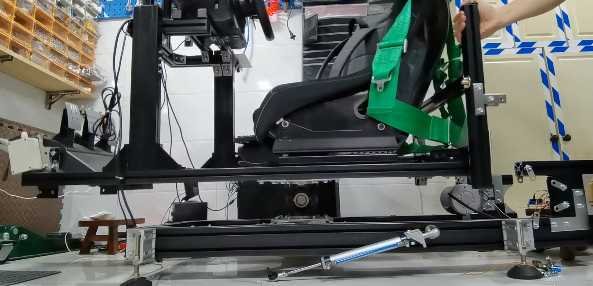

    The effect after assembly
    ps:The cockpit is connected to the base by a universal joint(Manually straighten the cockpit, there is no debugging because SIMTools is not active yet)

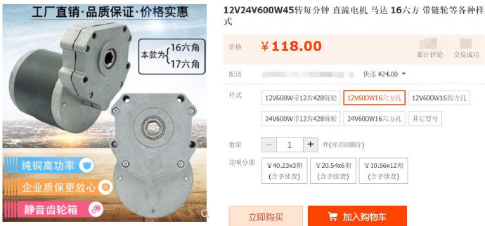

    The motor
    The motor is bought from Taobao, 12V 55RPM 600W motor with differential, the price is 118CNY
    ps:There may be false labels, but I weigh less than 50kg, which is definitely enough

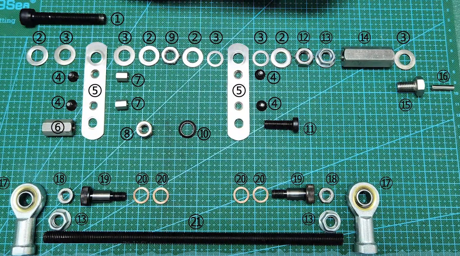

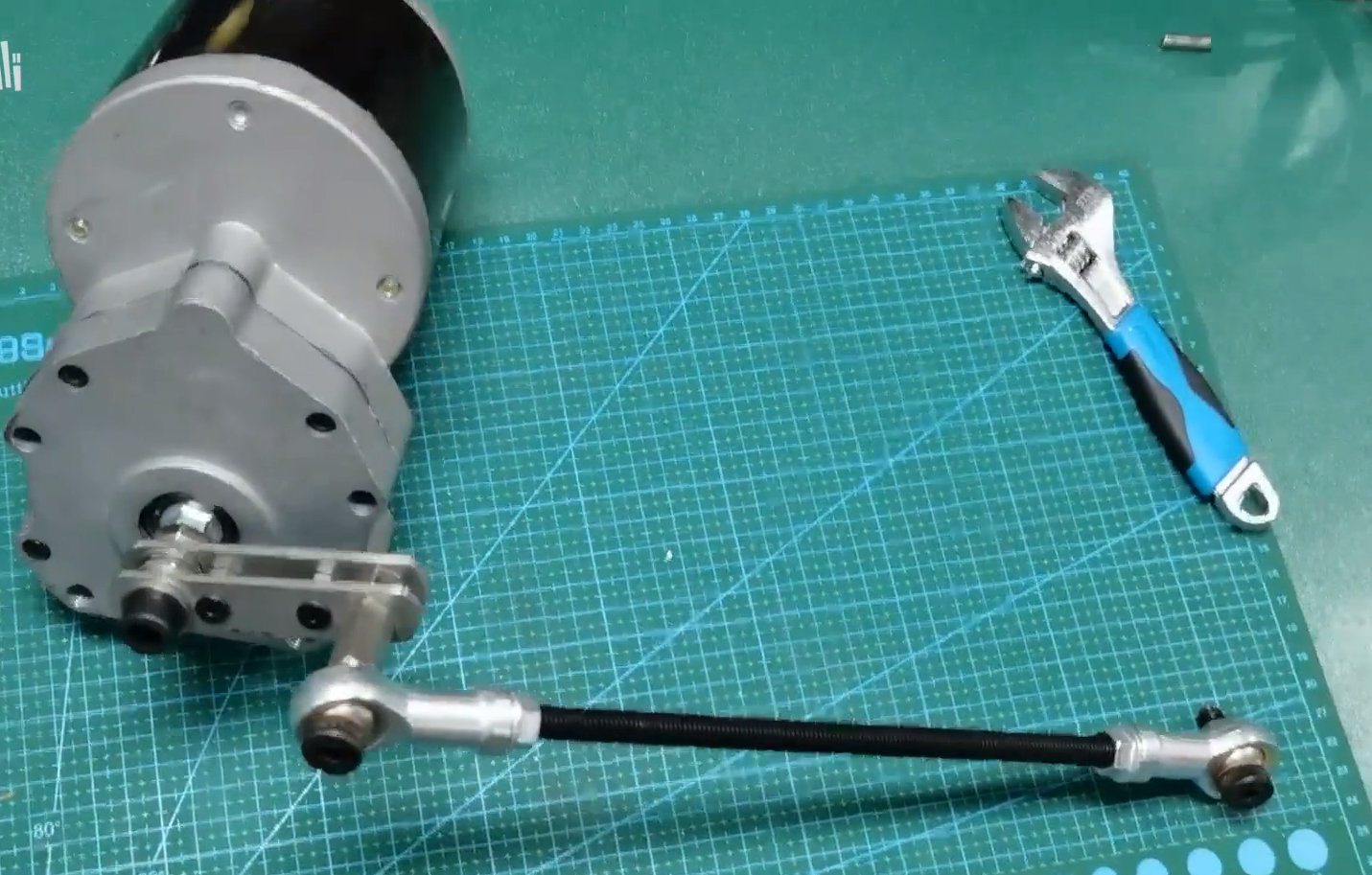

    Connecting rod required parts
    assemble
