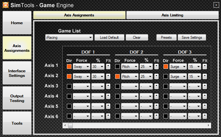

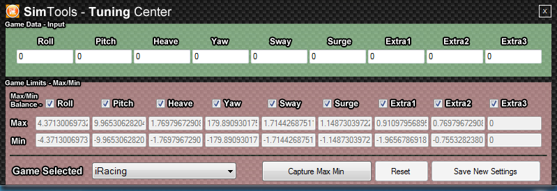

    Hi @Paul Shortland there could be more potential of the tuning parameters. The moves are rather soft and IMO not in real time - only IMHO as far I can see while watching the video. If you want you can upload your settings, perhaps we can advise you to get some better results.
  19. Paul Shortland
    Paul Shortland Active Member
    May 13, 2015
    154
    Northampton - UK
    317Coins
    +77 / 1 / -0
    2DOF, AC motor
    All help gratefully received :nerd

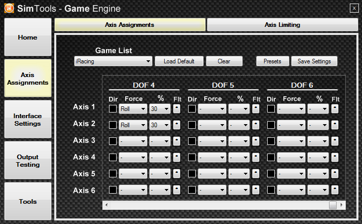

    These are my current settings...
    (Tuning Center was from a soft lap in an MX5)
