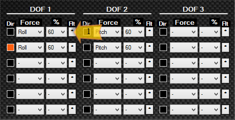

    I am getting to know how simtools work.. I reset the max/min with capture, and it is so much better now..
    Uhm.. I am a bit confused with the axis direction settings.. Does it should be opposite direction? Roll/sway, pitch/heave.. And can I get your settings as a reference??
    22,185
    154,750Coins
    +11,196 / 57 / -2
    Which way an axis moves is determined by the Dir box being checked orange or not, So in the picture the sim would roll one way and if you unchecked the orange box and check the top black box so it turned orange then the sim would roll the opposite way.
    It is far better to take your time and learn how to create a motion profile for your sim, as all sims are different and the settings someone else uses won't get the best out of your rig. It takes time but there is the SimTools documentation, the SimTool Settings Tips & Tricks and plenty of good advice from members to help you figure it all out:

    as I think, roll and pitch are related to attitude, and sway and heave are related to acceleration.. so what I am wondering is.. should "sway" be the opposite to "roll"?? and heave/pitch..
    22,185
    154,750Coins
    +11,196 / 57 / -2
    Yes sway leans away from a corner and roll should be opposite.
