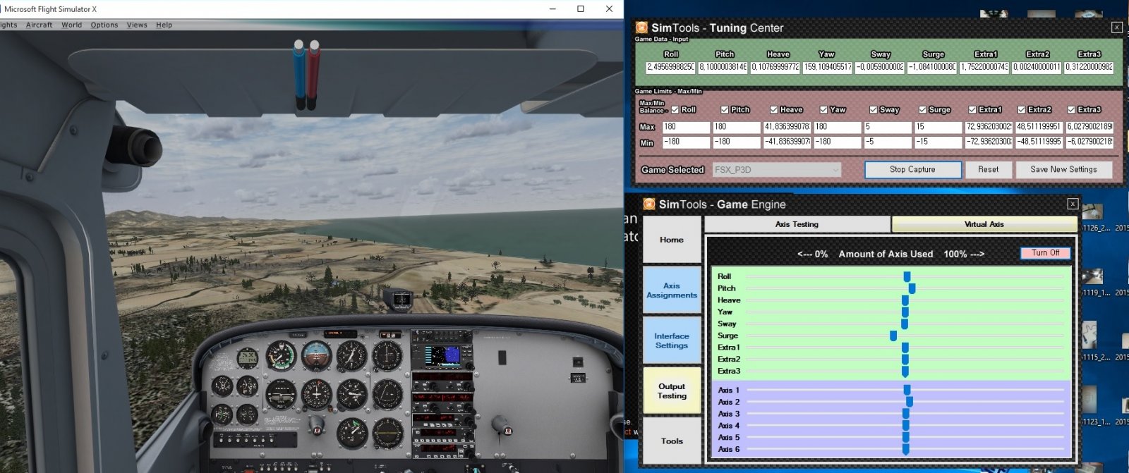

    Can someone help me to set the axis value for FSX??
    I tried with the value of
    Roll 80, pitch 90, heave 90(with smooth filter 20), sway 20, surge 20.
    I feel rolling is working.. But pitch.. Not sure it is working correctly.. Cause pitch moving is too small. When I pitch up so high, it moves a bit up. And there was no pitch movement when accelerates on the ground..I mean take off..
    I dont know what value is right.. And regarding the rolling.. If I turn to the left, does my chair lean to the left?? Or to the right like car simulation??

    +598 / 5 / -0
    What are your numbers in the tuning center?

    I am not sure what numbers you refer to.. here is the capture of my tuning center. please take a look..

    Do a base setting of the tuning center like this and then manually tweak the values further if needed: http://www.xsimulator.net/community/faq/set-base-tuning-motion-values-in-the-tuning-center.122/
    The lower the number in the Tuning Center the more responsive the movement, but too small and the movement will start to get jerky and the inversion in a roll or loop will likely be unrealistic as the rig quickly moves from one axis extreme to the other.
    Personally on Prepar3D I use Extra 2 instead of roll. Some also use Extra 1 in place of pitch, but for me I use pitch with a high % of smoothing.

    Your tuned way too high, I'm in the single digits on most
