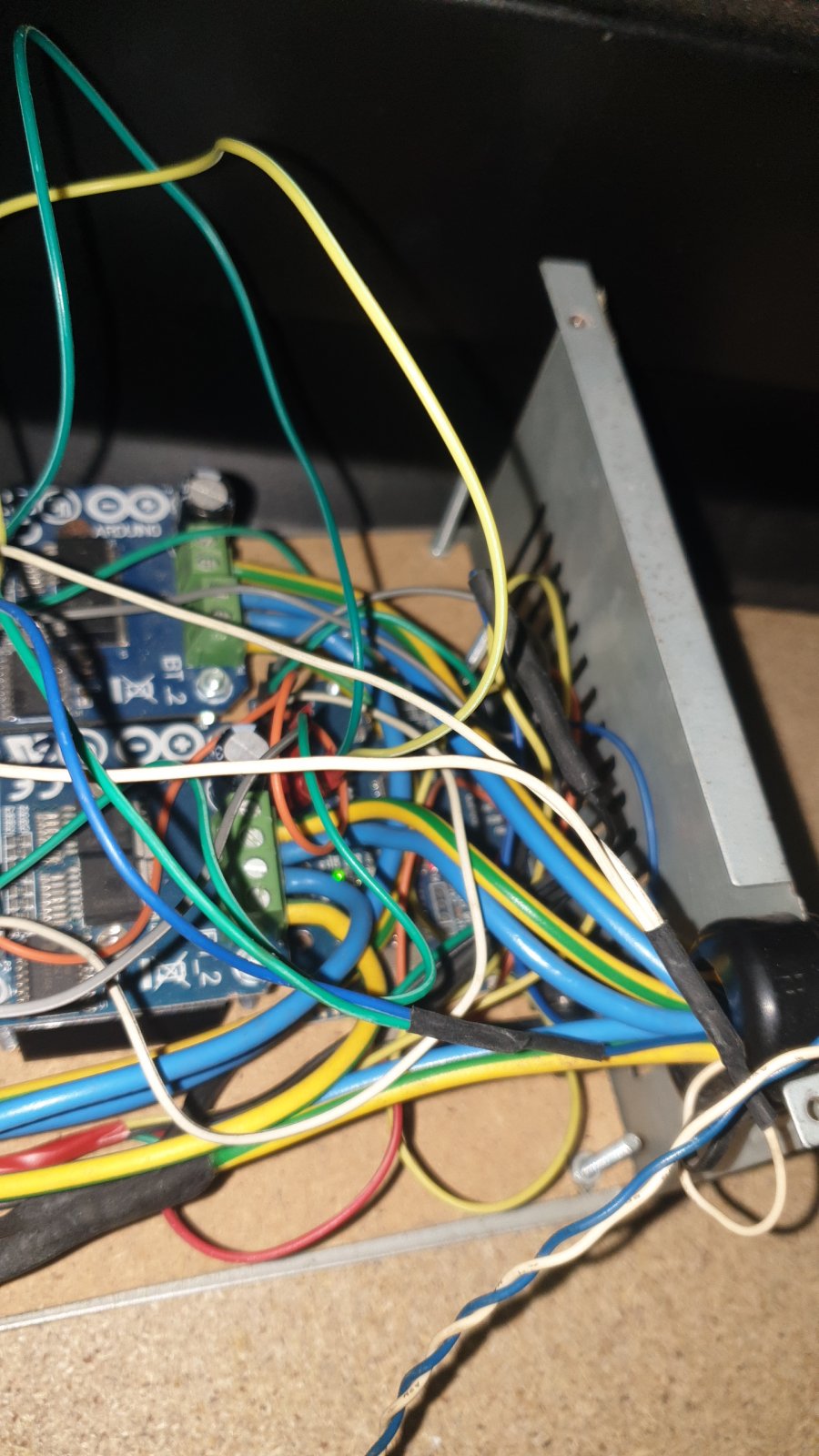

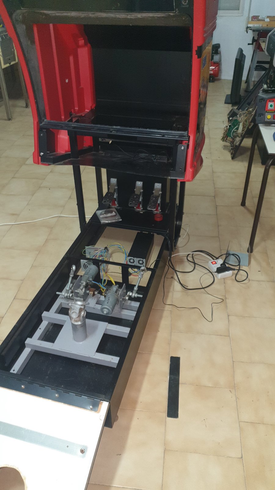

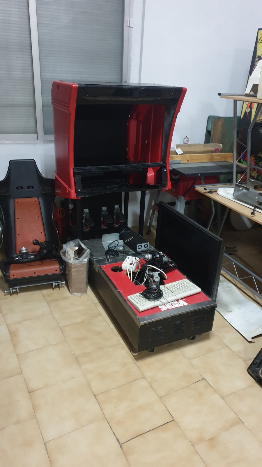

    Good morning, I have had a move and since I didn't have to dismantle everything for transport, this bug is big...haha.
    I took the opportunity to clean and check the electronics.
    Before I can assemble the seat, I want to test the software and I see that these days almost everything has to have Steam. At the moment I have rfactor for basic tests, but I'm going to get serious about this.

    Now that I'm halfway assembled, I've reviewed the electronics and everything seems to be in order...
    I am installing a couple of games and the X-sim software in my house and the next day I will connect and configure to check if everything is really correct.
    I have to start reviewing the installation of the software, right now I feel like a child on his first day of school....

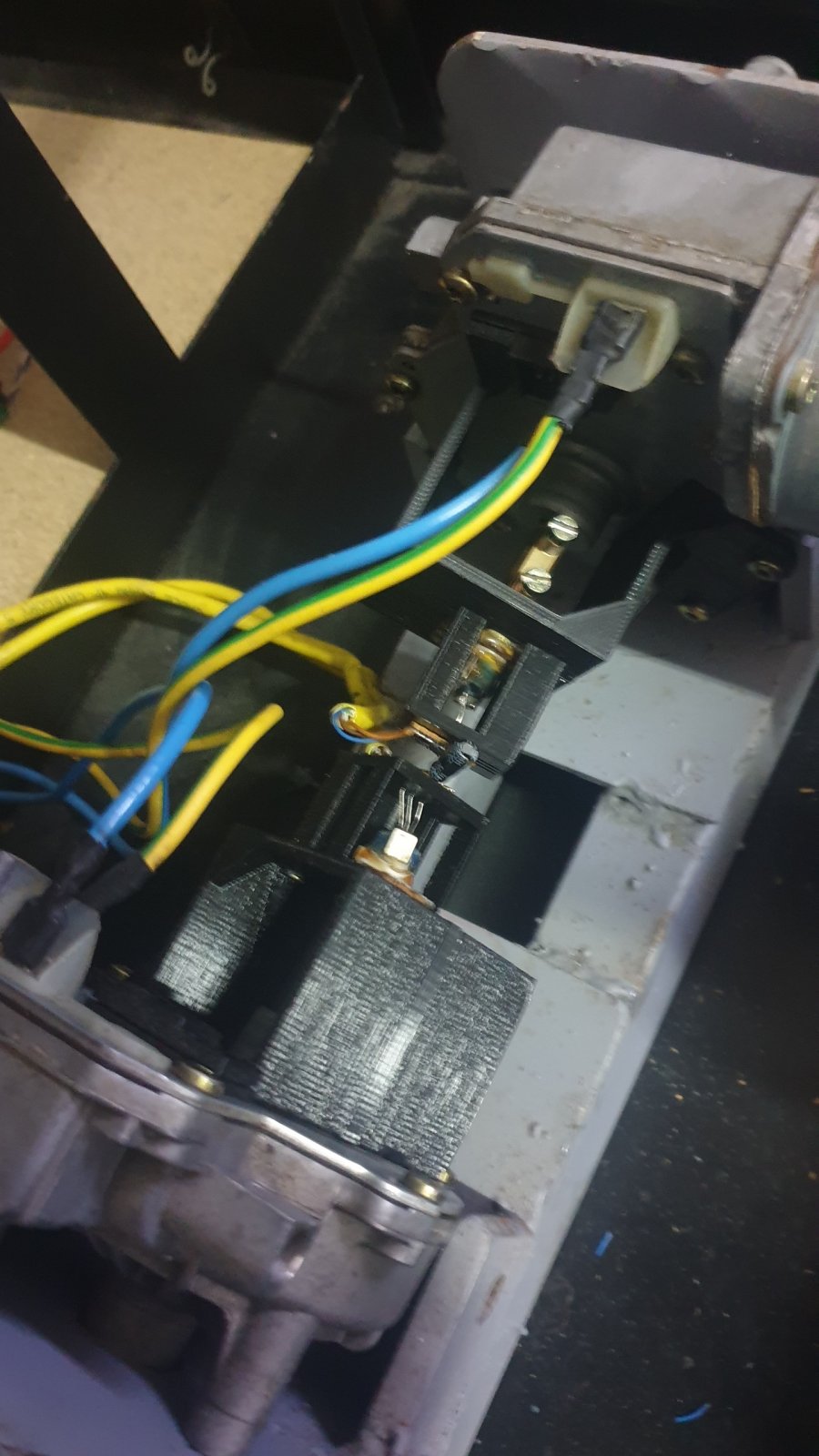

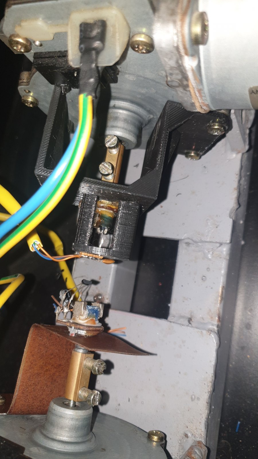

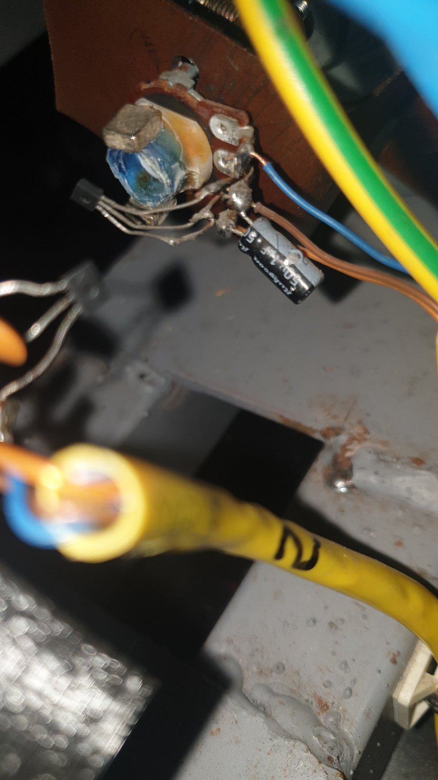

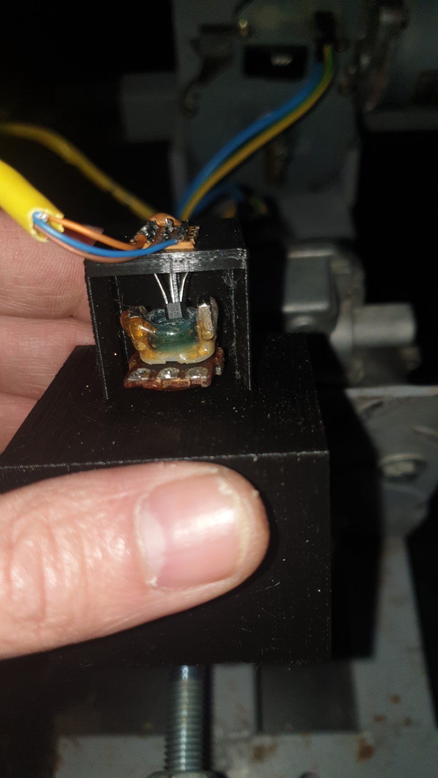

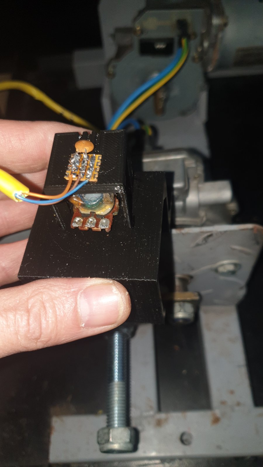

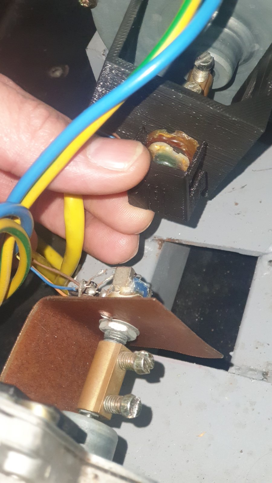

    [ADJUNTAR]101015[/ATTACH] [ADJUNTAR]101016[/ATTACH] [ADJUNTAR]101017[/ATTACH]
    First of all, happy holidays to everyone. After so much time with the project stopped, I have discovered that there are many colleagues who have made designs for motor supports, hall effect potentiometers and countless parts for 3D printing. My initial design, although functional, it was not to my liking, so I thank the authors of the designs that I have taken to update the supports for my hall potentiometers. I took the support for my valeo motors and another piece for the hall sensor that I have scaled to adapt it to my homemade potentiometer to which I glued the magnets. I hope to update it these days and show the result. I hope to have the simulator with movement soon, when they finish remodeling that part and configure my axes again

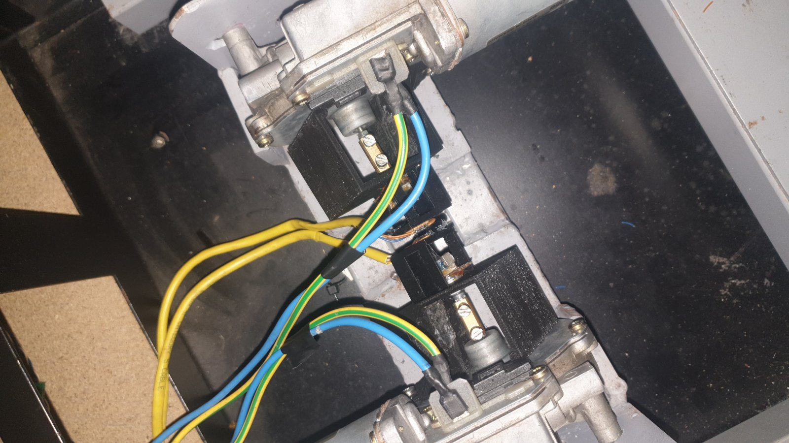

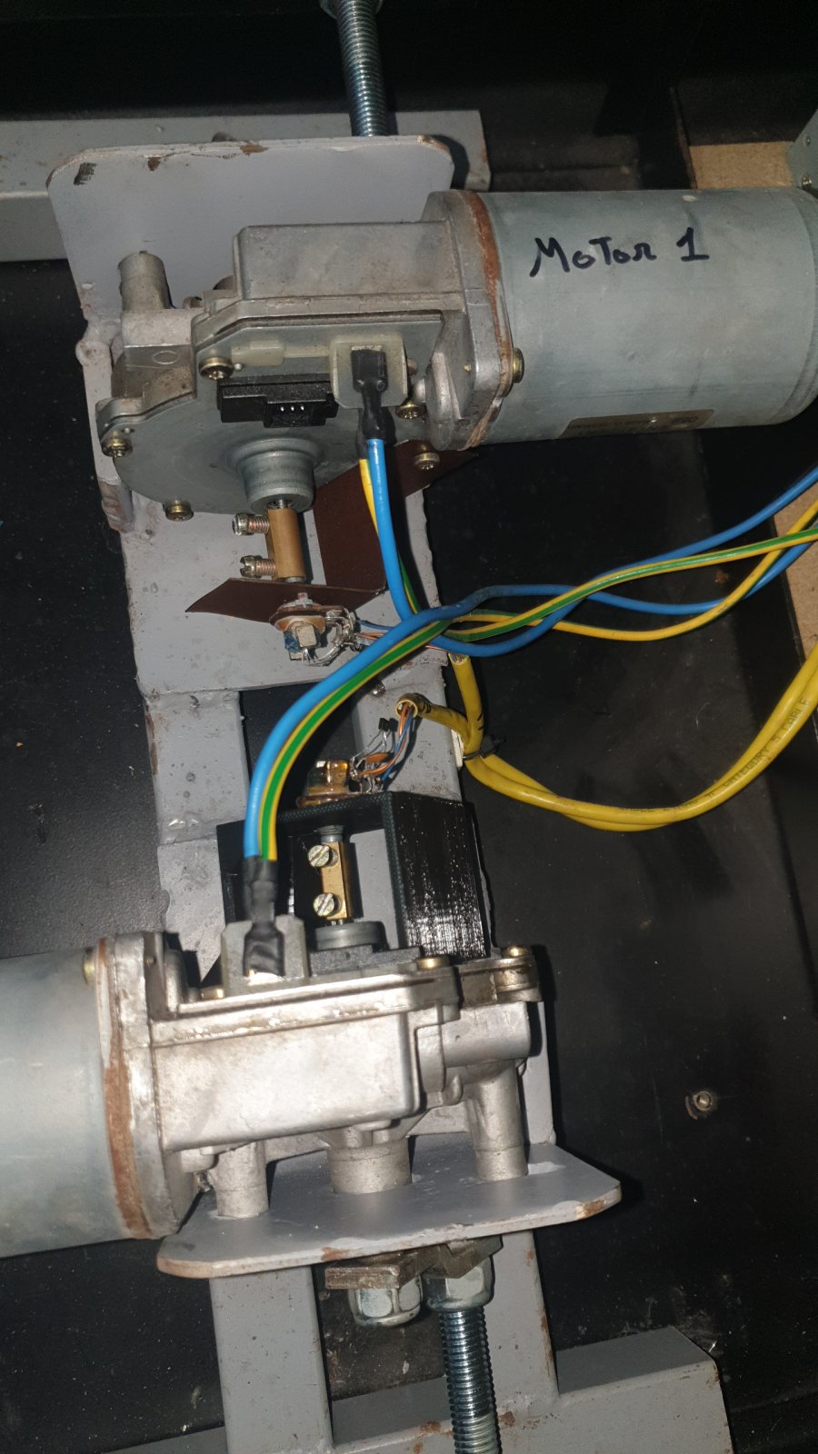

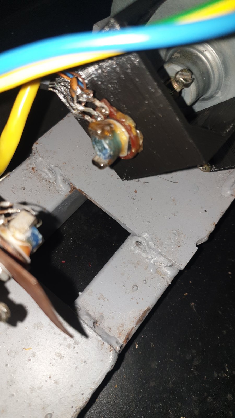

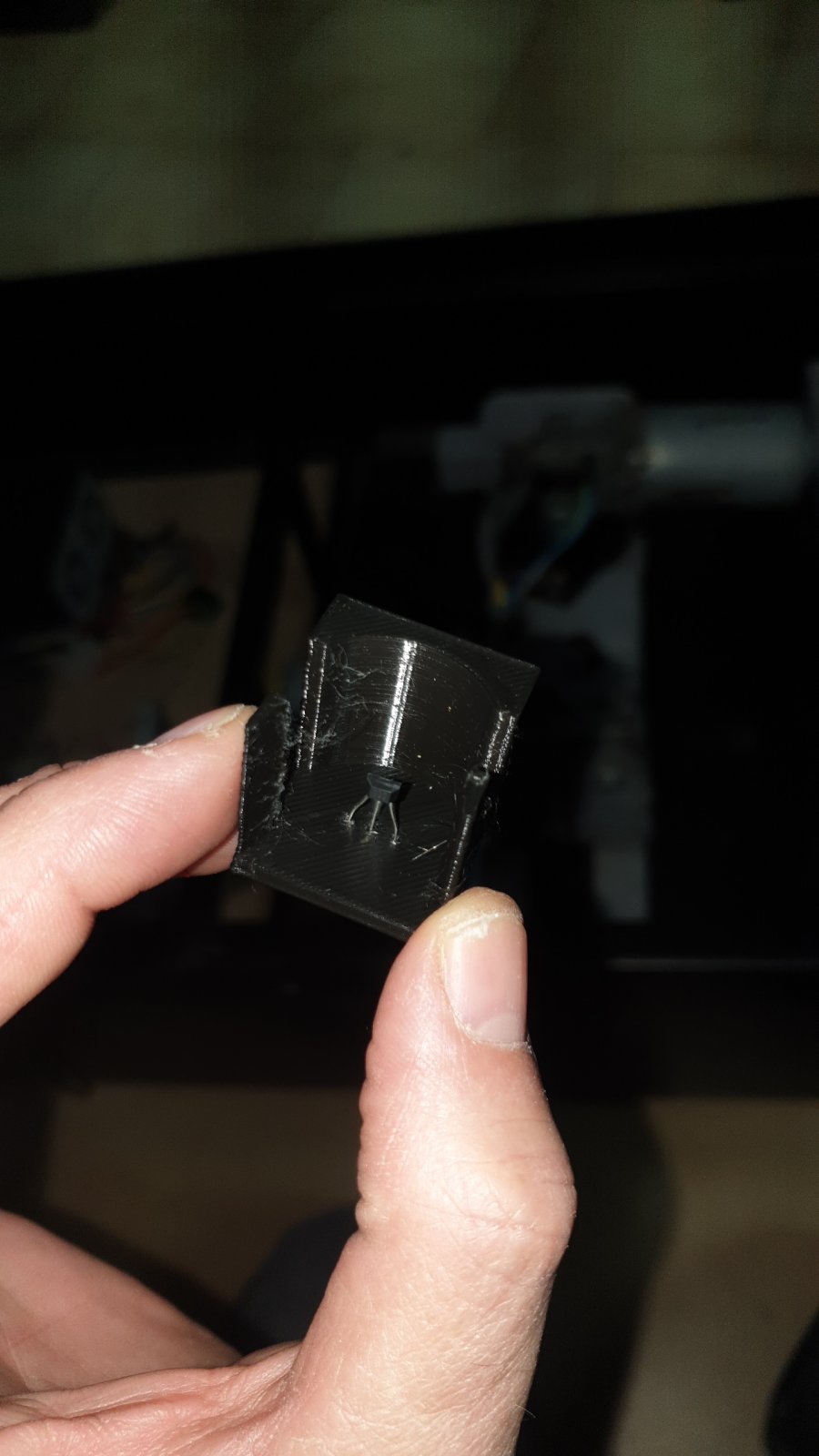

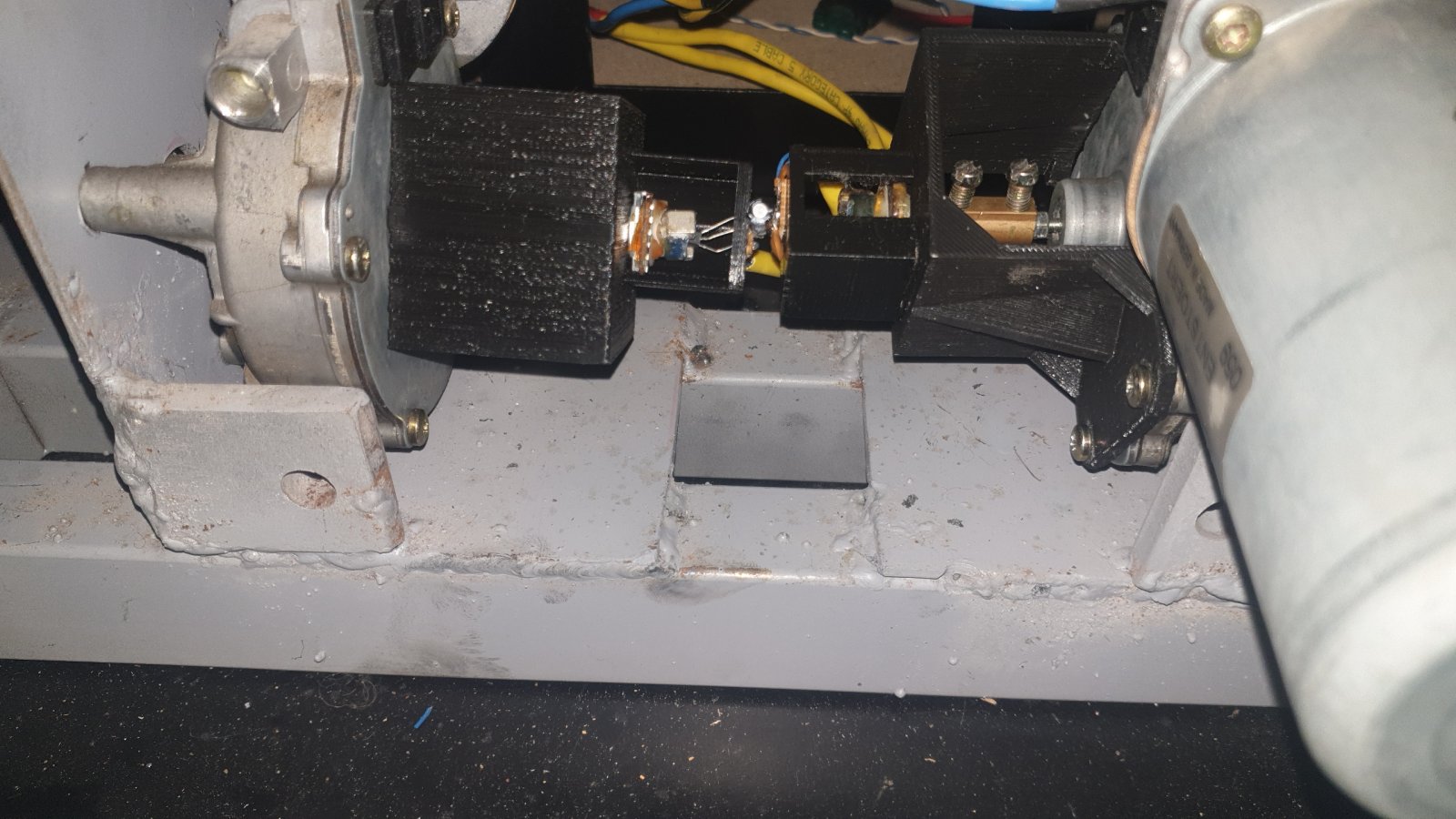

    Good evening, today I escaped for a while and started modifying the potentiometer supports.
    I have to finish centering them well and put in some shorter screws, but I'm almost ready and looking forward to trying them out.
    I will continue after the new year, and I hope to be able to try them to see if they are better with the change.
    PS: I finished both, but I had to leave quickly and I didn't take a photo of the whole
    20231230_171628.jpg 20231230_171428.jpg 20231230_171424.jpg 20231230_145623.jpg 20231230_143321.jpg

    This afternoon I left the diy hall potentiometers adjusted and I fought with the Arduino IDE, just to install smc3 and try to move the motors without result....more tomorrow and some photos of how the supports turned out

    Hello everyone, I hope you had a happy new year.
    As I already mentioned in the SMC3 arduino motor controller thread, I already have movement in motor 1 and I have already configured motor 2, it remains to adjust Kp to my liking for a slightly faster movement, I still have to learn how to correctly configure the parameters to an adequate and similar movement in both engines, but I am on the right track.

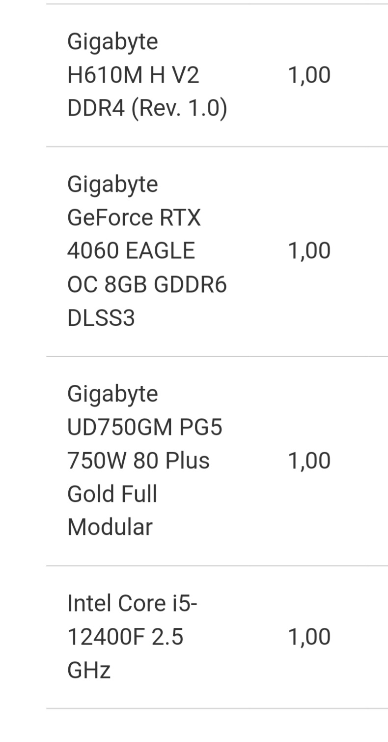

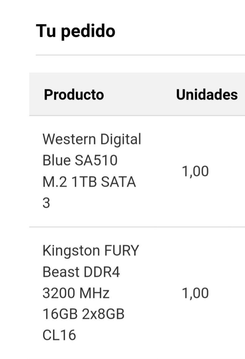

    Hello, since my PC is quite old, I have decided to upgrade to a more current one, which allows me to play more games and be able to enjoy a few more years without having to worry about that aspect.
    Tomorrow the arrival of the respective pieces of the new PC is expected
    I wonder if apart from installing Windows, arduino ide, sim tools (I think I'll try beta 3, to get familiar with the new interface).
    Is there a way to save what I already had configured in SMC, what is already recorded in the Arduino EEPROM, I understand that it will still be there, there is some folder or configuration file that I must take into account so that it remains, if possible, as Did I leave it off the last time I was adjusting?
    And here are the specifications, it is not the most powerful, but I think it will be able to handle almost all games, what do you think?

  12. ChuckyP
    ChuckyP Active Member
    Sep 21, 2020
    122
    Chicago, IL
    738Coins
    +65 / 0 / -0
    You can have both versions open at the same time, just make sure only one is active or (on) at a time.
