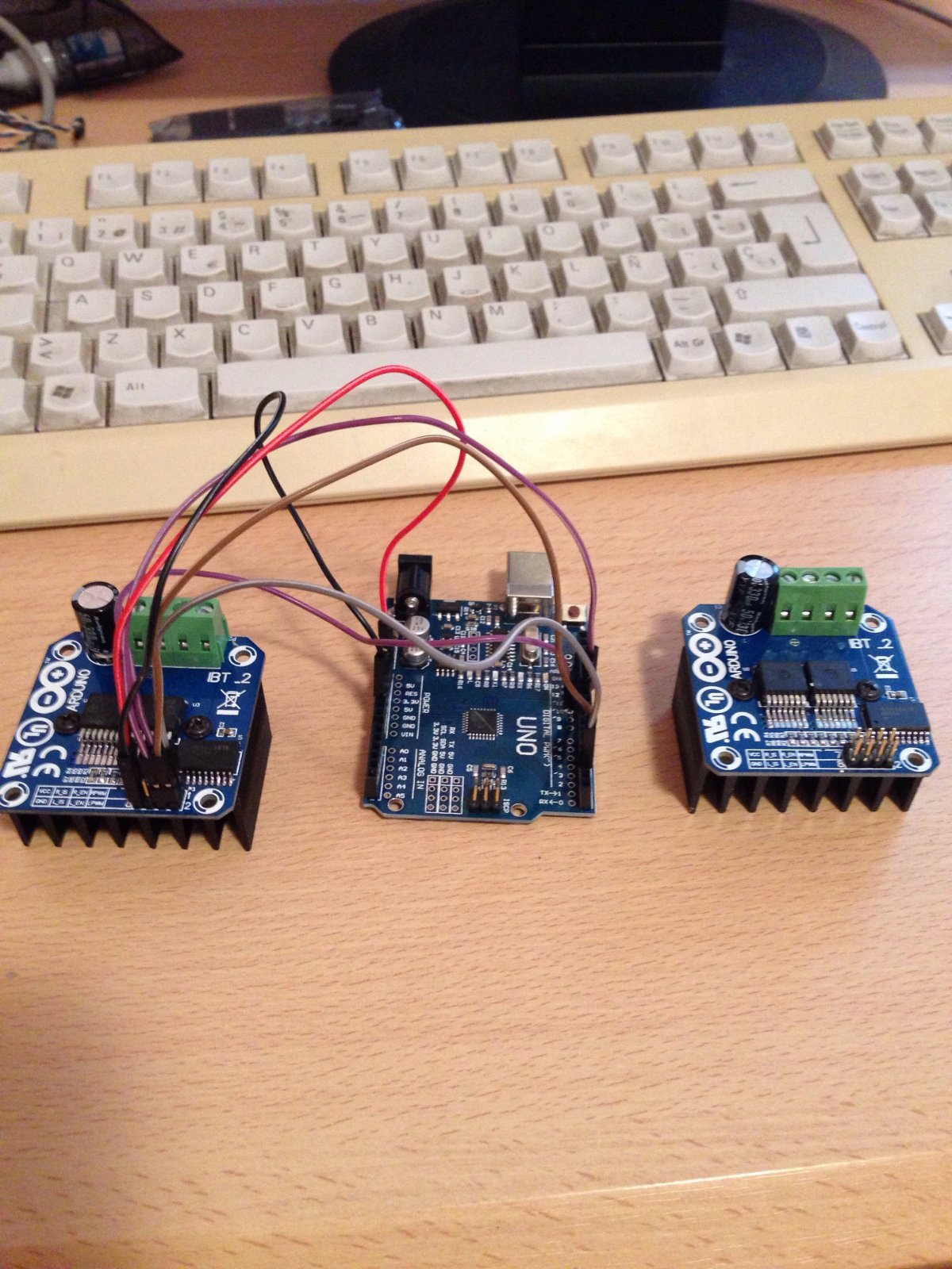

    I want to ask what code you used for Arduino, and I ask you, if you could draw a diagram of how to get involved.
    Thank you.

    At the moment I loaded the code given Prilad.
    I'm not good at drawing, if thats worth it as these bridges connect the arduino H plate, it will indicate no problem.
    But a picture is not possible.

    Thank you very much, Prilad has drawn picture, as it involved so nothing happens.

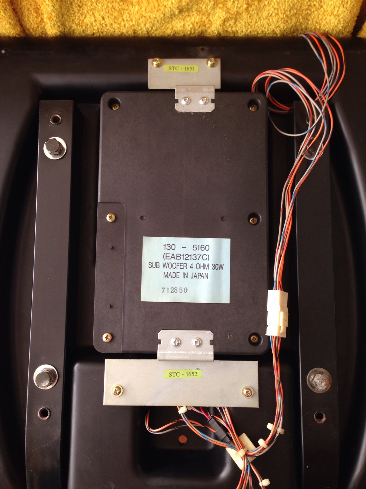

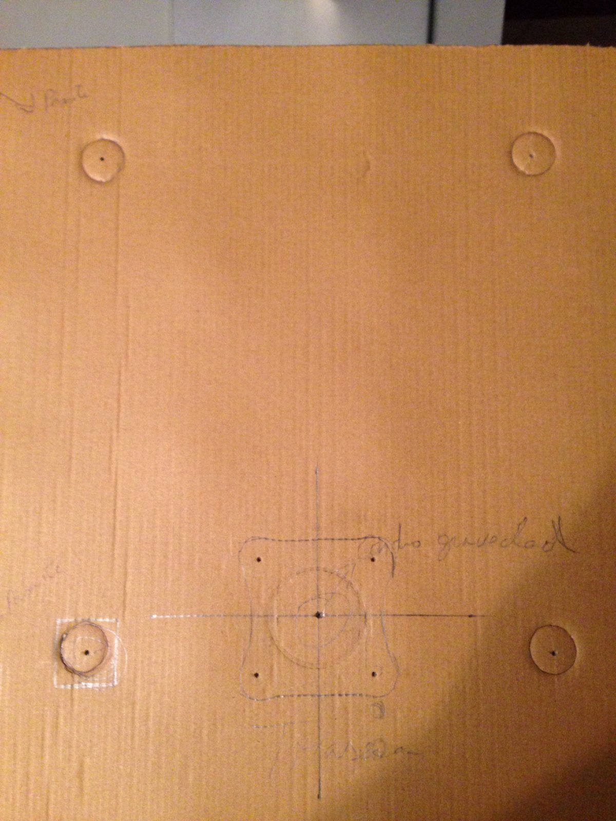

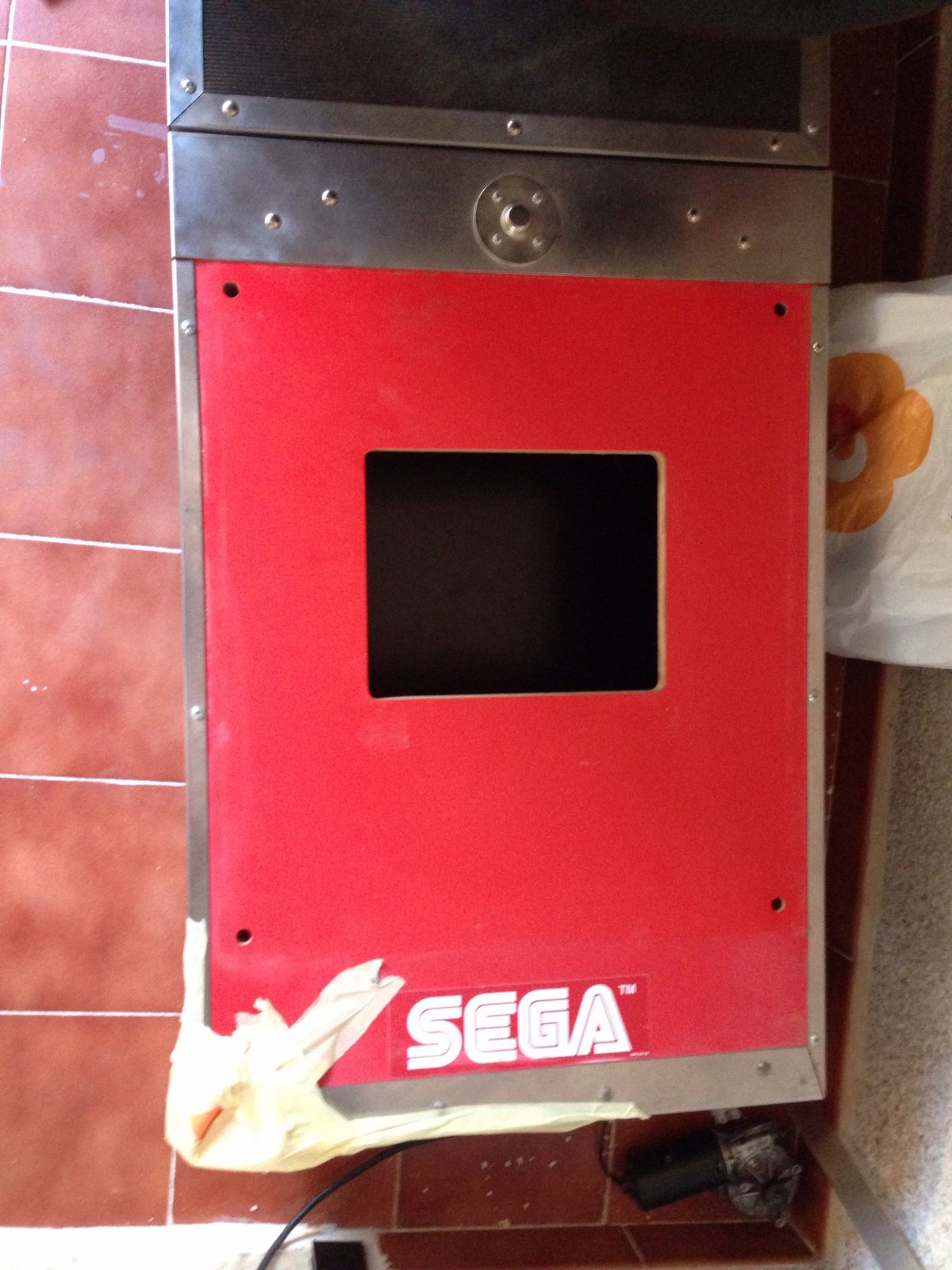

    If it has been calculated, and it has resulted in a cardboard template to send it to the blacksmith.
    Basically a 40x38 sheet ctm, and the center of gravity, in my case, it is 10 ctm of the back of the sheet.We can also see by removing the bottom plate of the seat (anger plate is attached with screws to the new) subwoofer that brings the seat of manufactures, also bears mentioning that two speakers built into the backrest. image.jpg

    image.jpg I've calculated as described BSFT, a broomstick under the seat and helping a friend until you find the balance, when you find the brands.
    In my case as I said is 10 cm from the back of the plate that holds the seat.
    Measure and adjust the seat to the center axis at the specified distance.
    After making the prototype and once calculated the center of gravity, along with the distance to the pedals.me've realized that the best way to introduce the structure in the drawer of the machine, is put forward as the engines did BSFT .
    They exploited me more space and stay closer to the engine compartment where the anger pc installed.

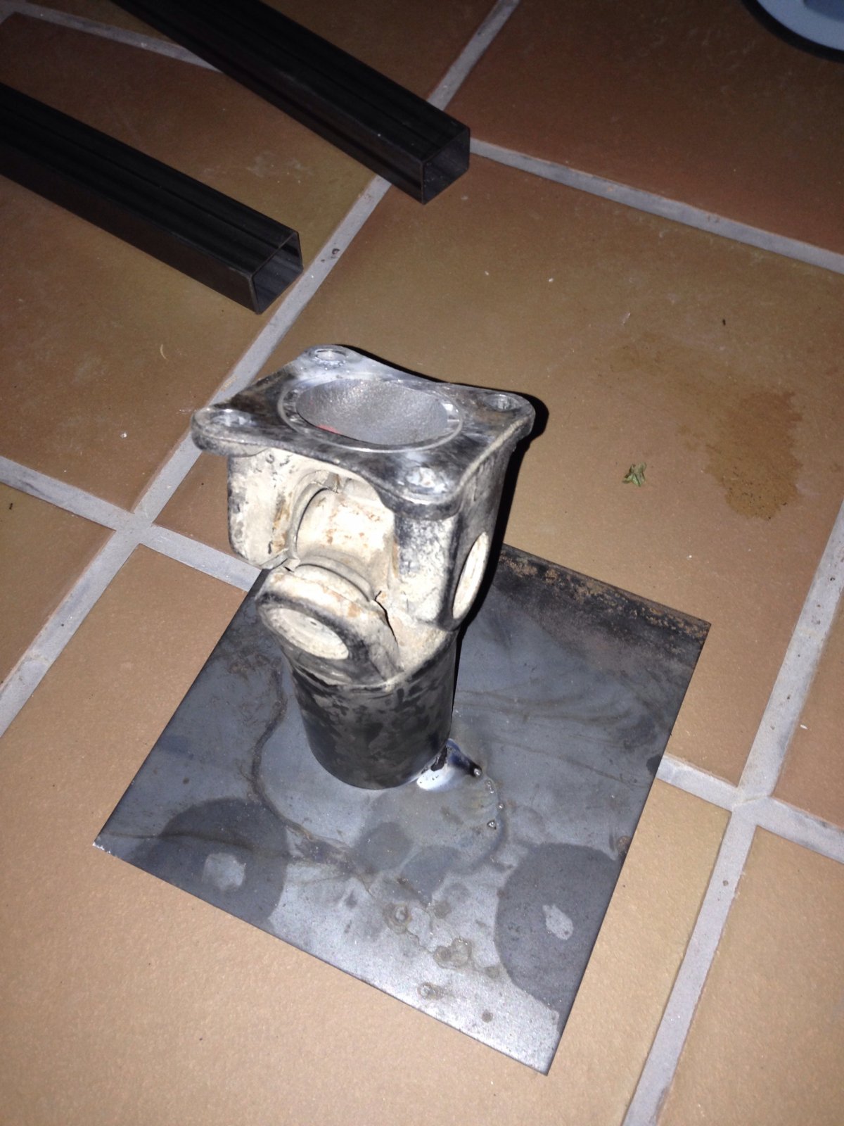

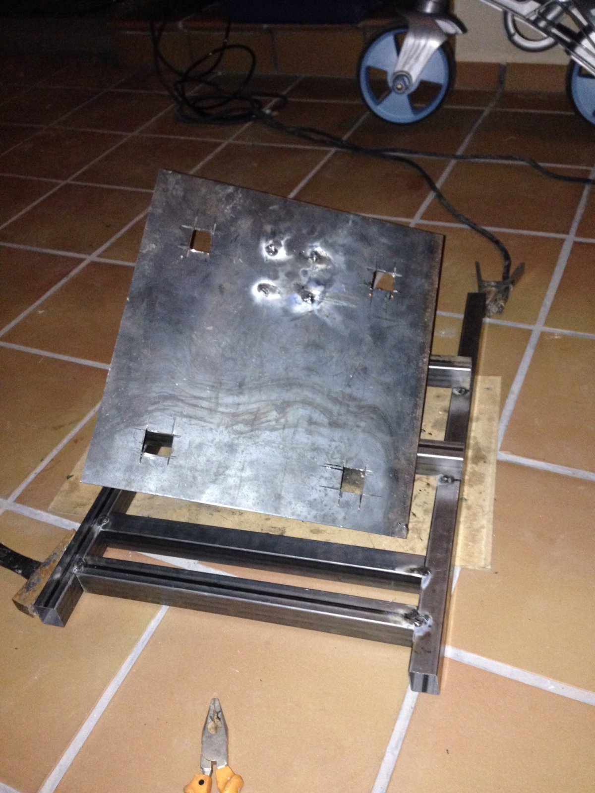

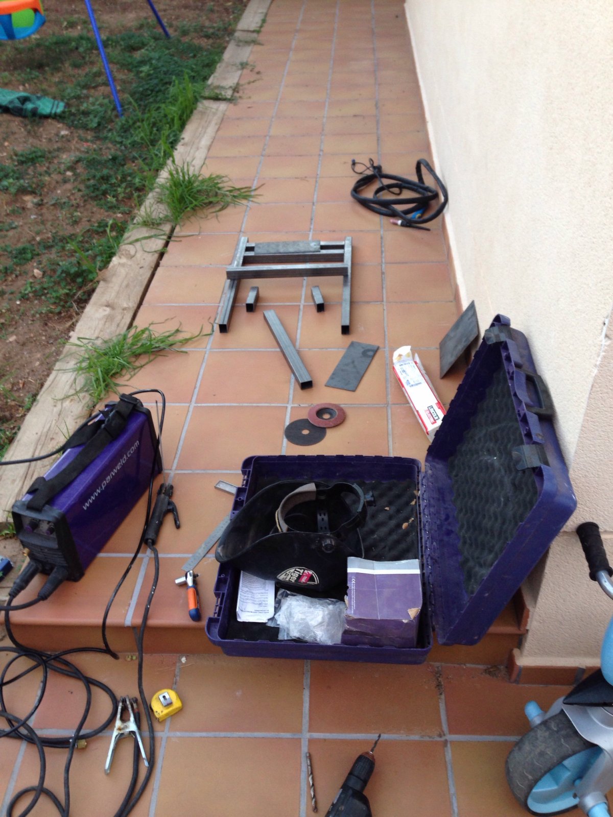

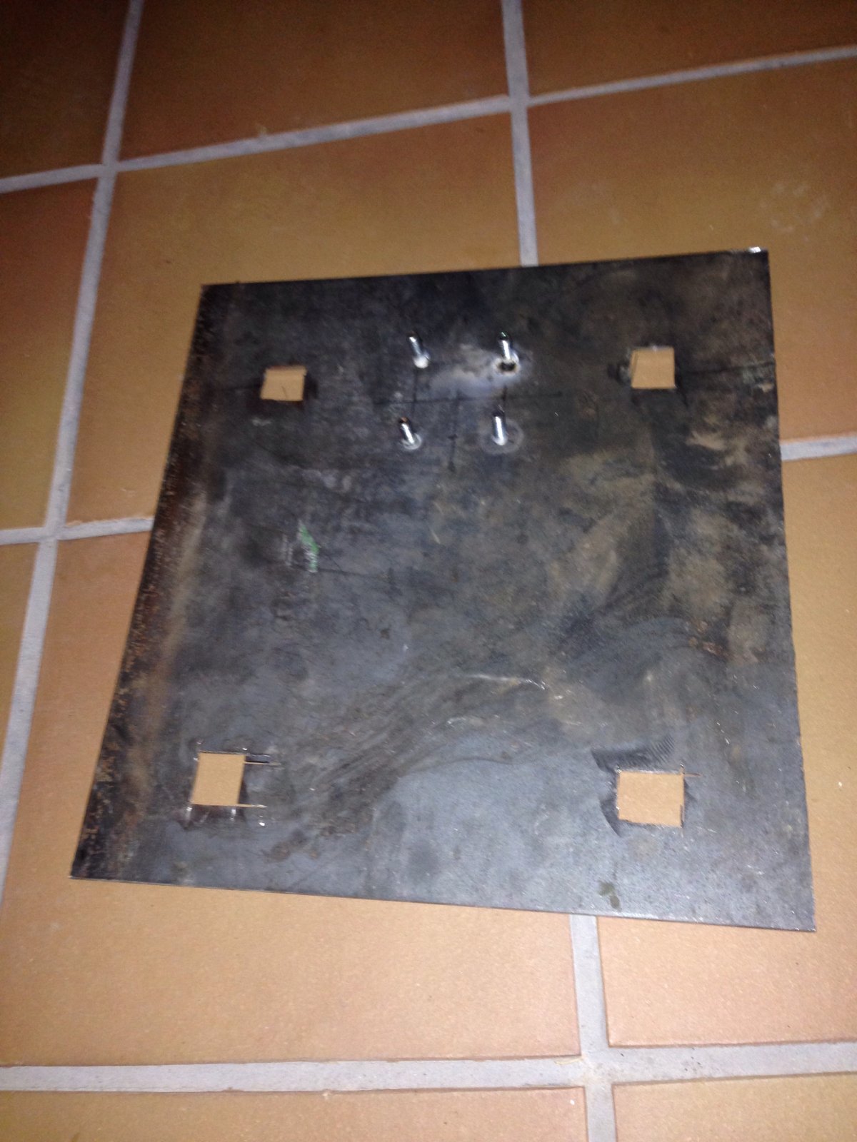

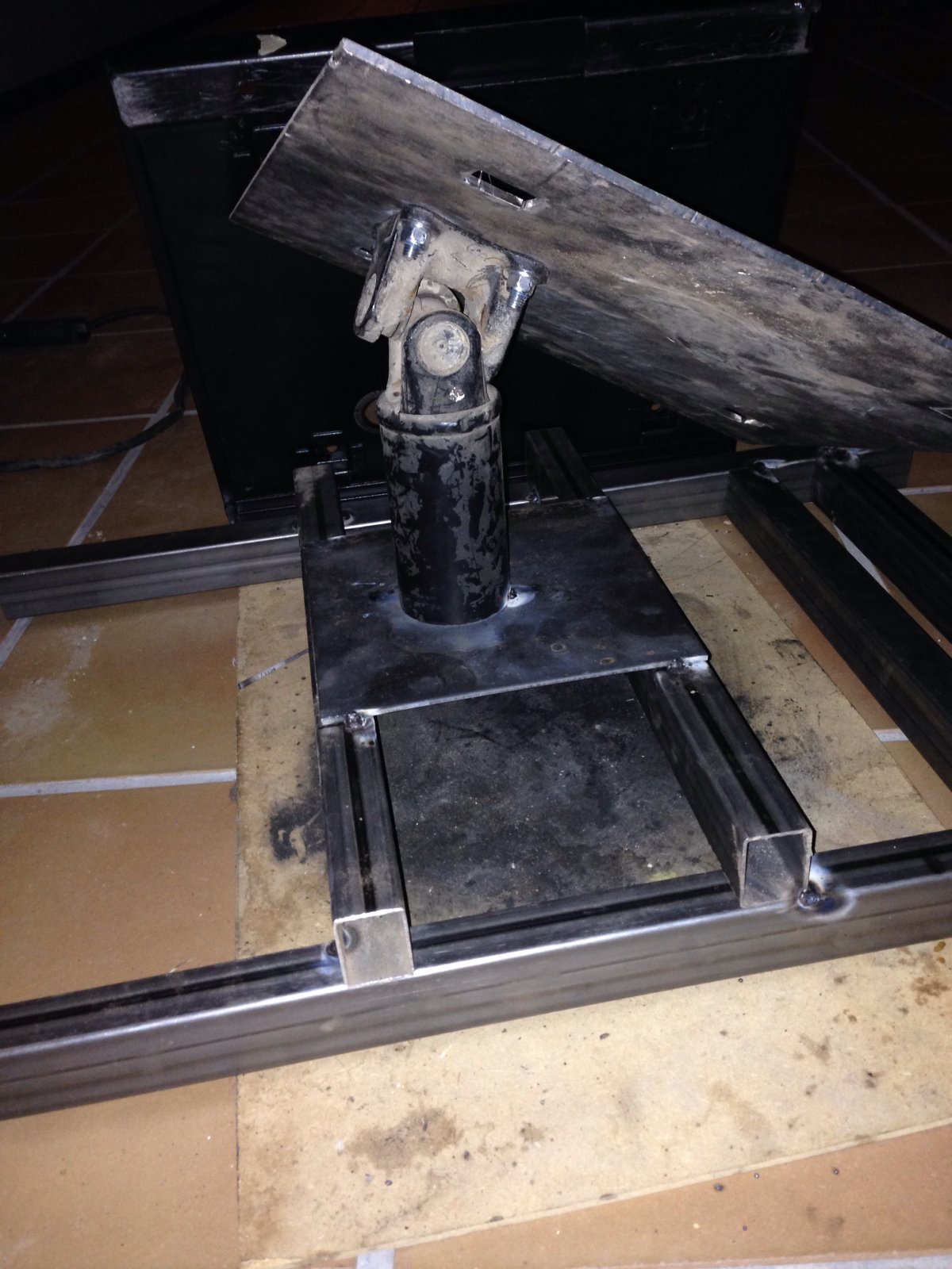

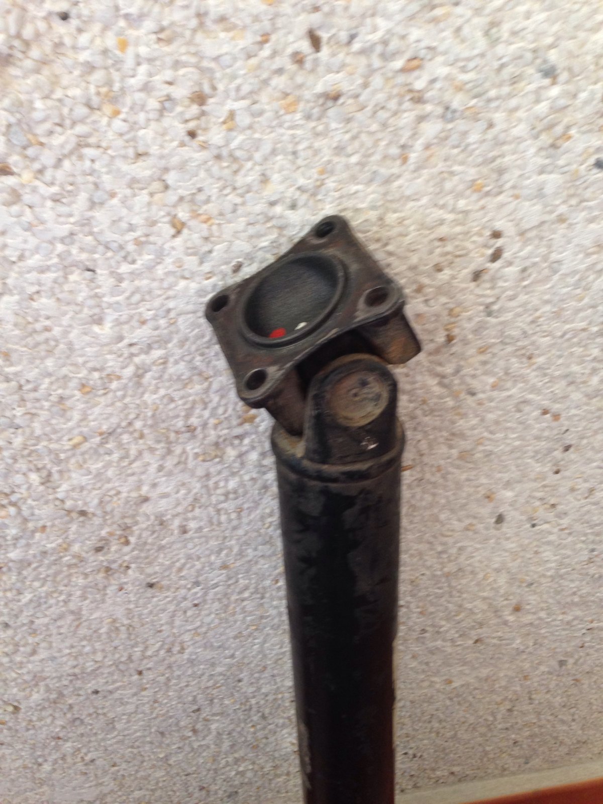

    Well, I've been a busy day, but I've finally found time to go to the blacksmith and together begin to build the structure.
    So far we have done the basic structure, failing to review all TIG welding and put the engine mounts.
    This is the result.

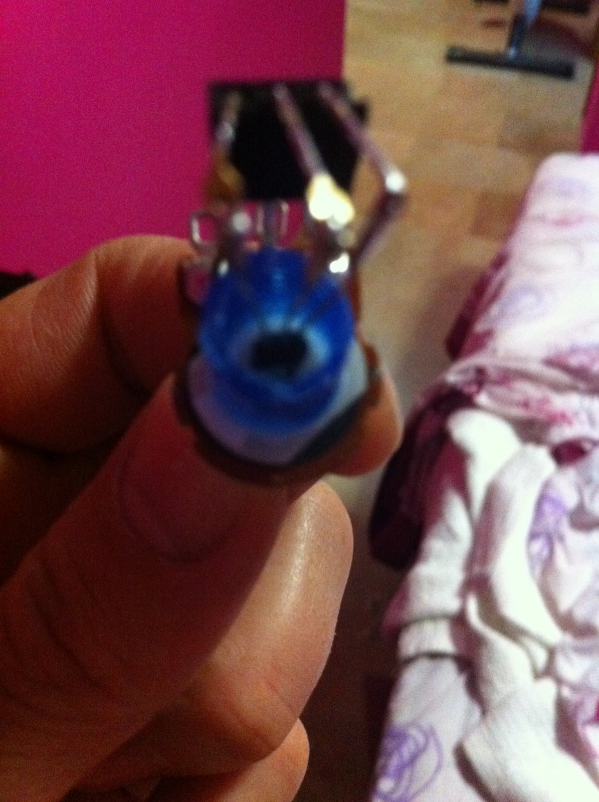

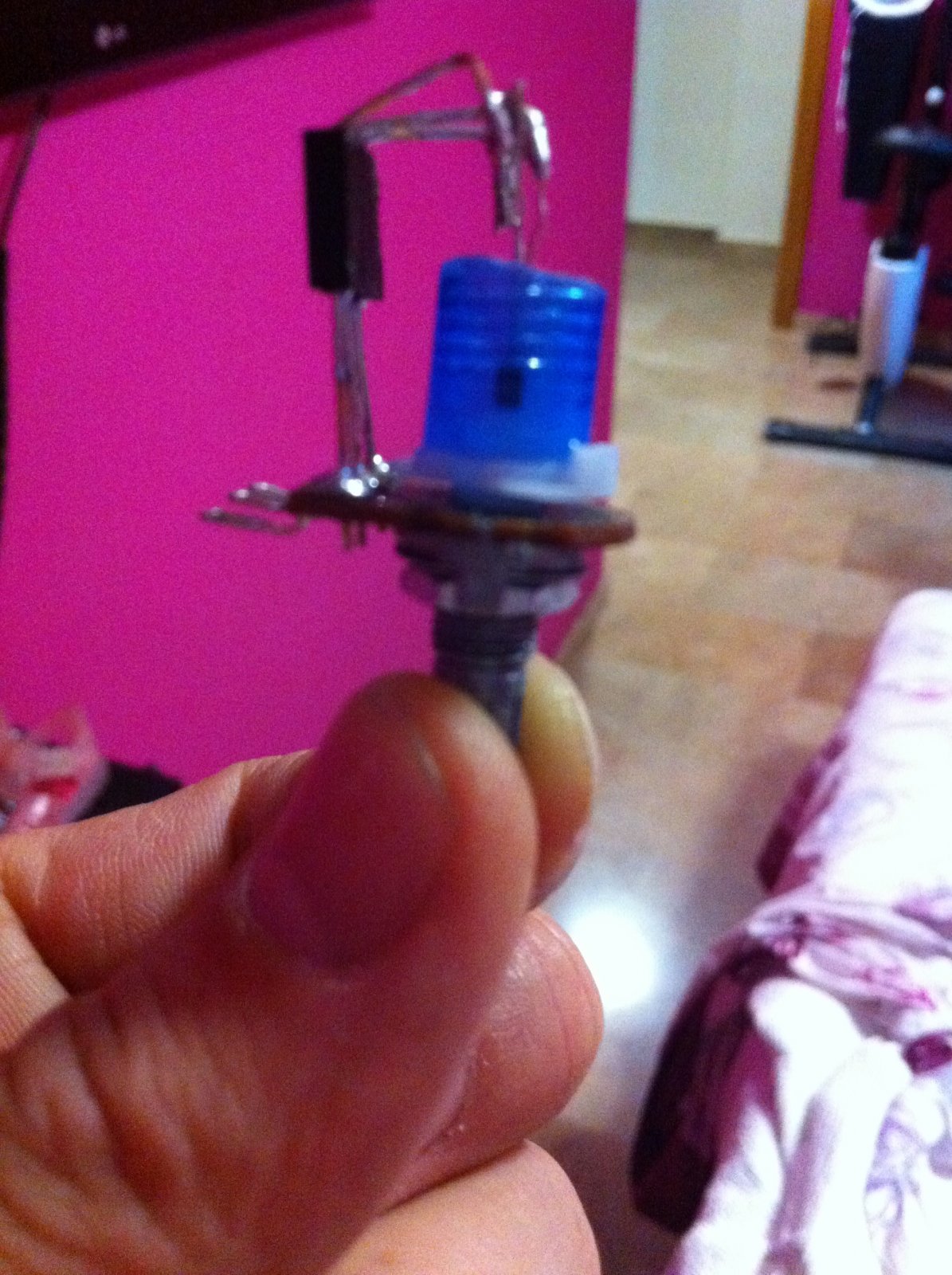

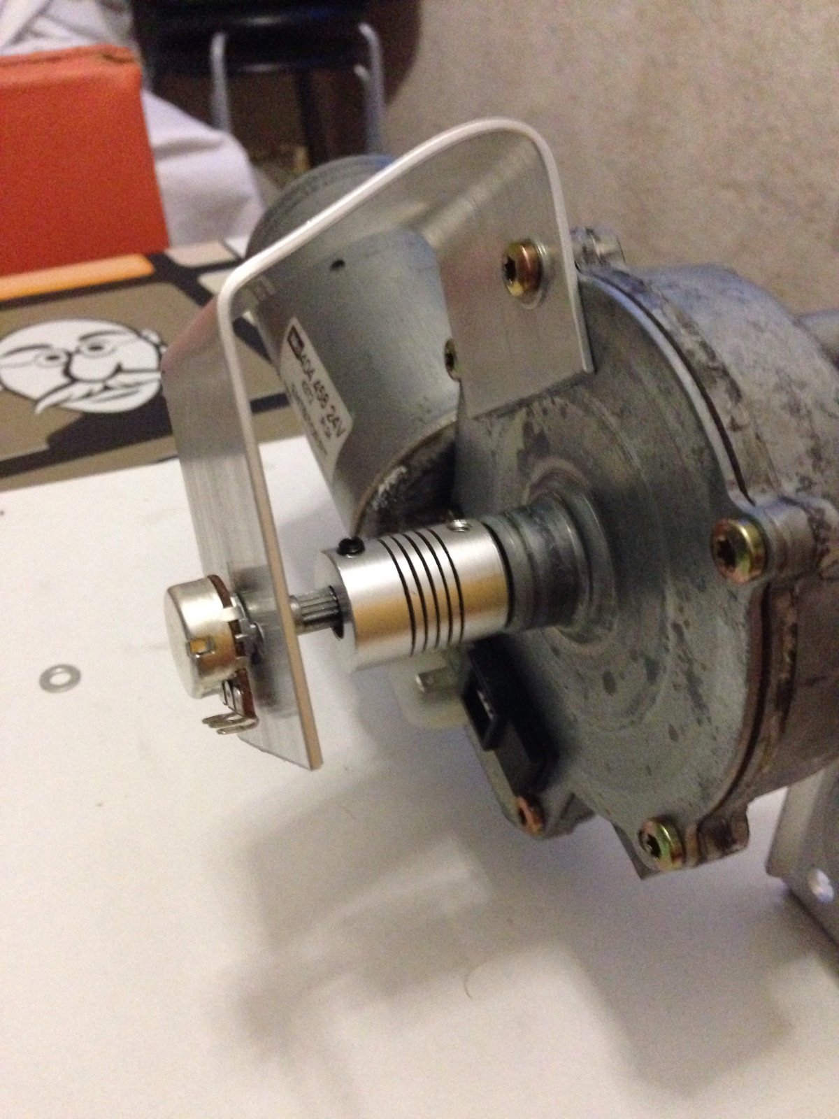

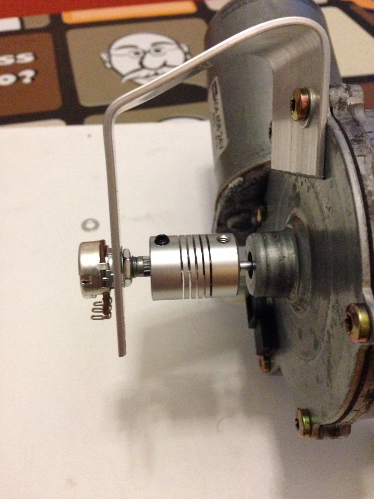

    While waiting for the Smith set aside some time to complete the structure, I decided to try a DIY hall sensor as sensor I'm using the SS495A1 and a neodymium magnet.
    For moving parts an old potentiometer.
    Here I show the prototype still unfinished.
    All this has been possible thanks to Dualin who showed us the way.
