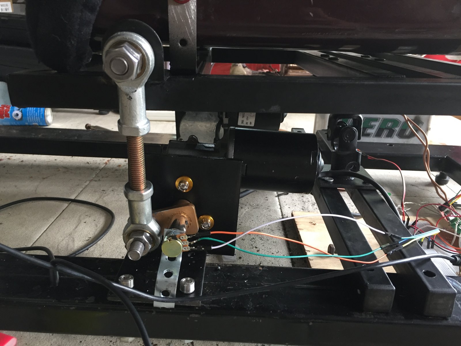

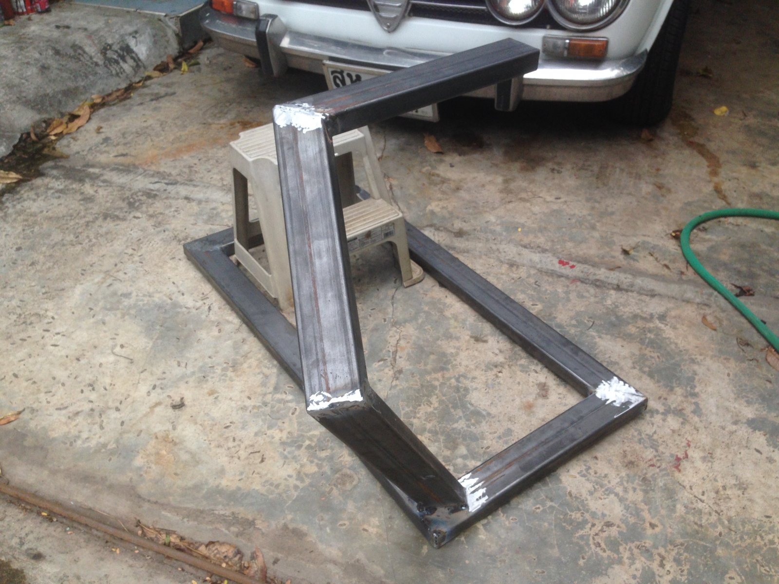

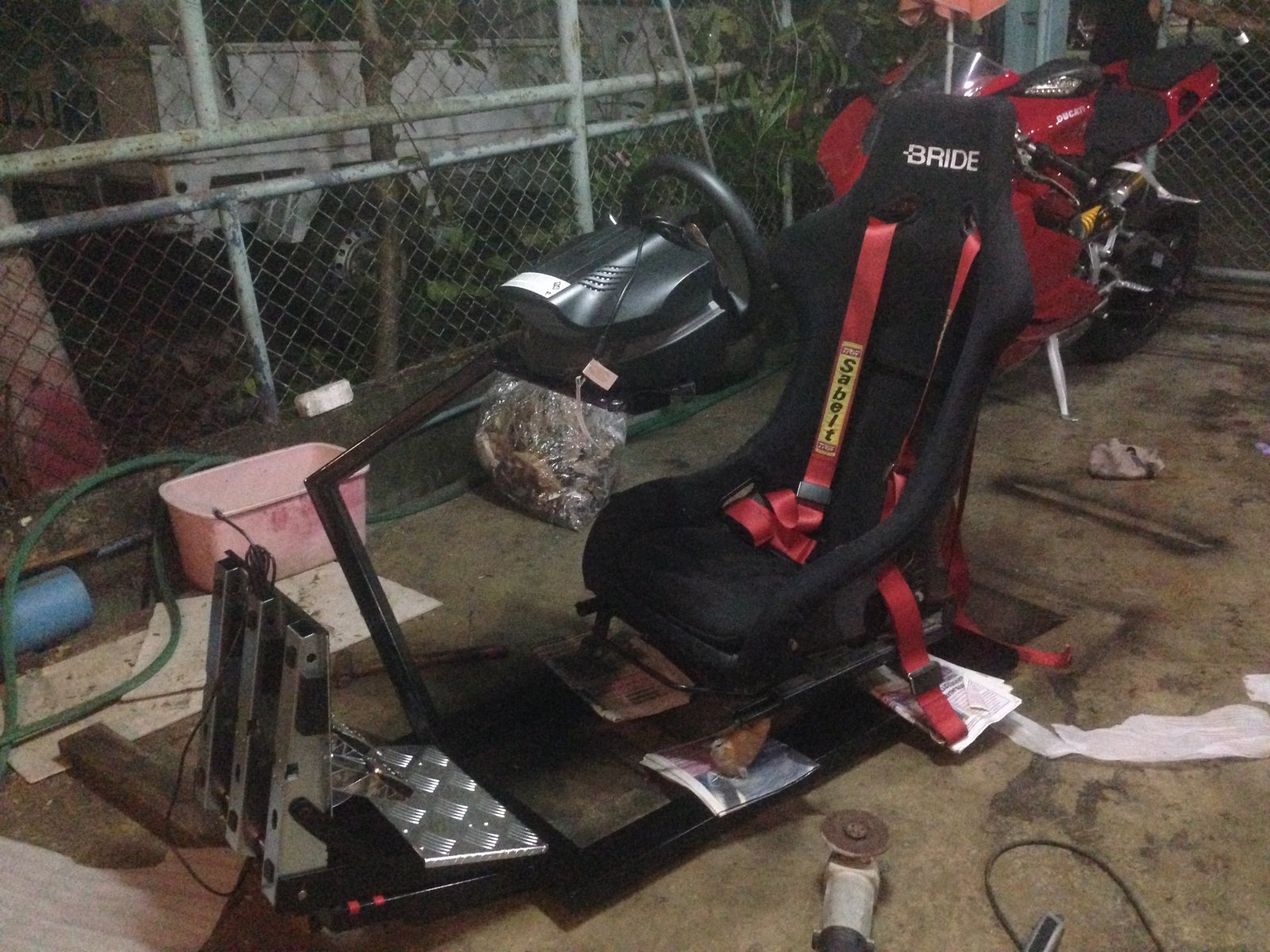

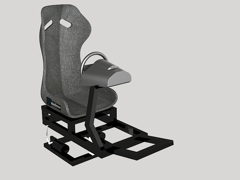

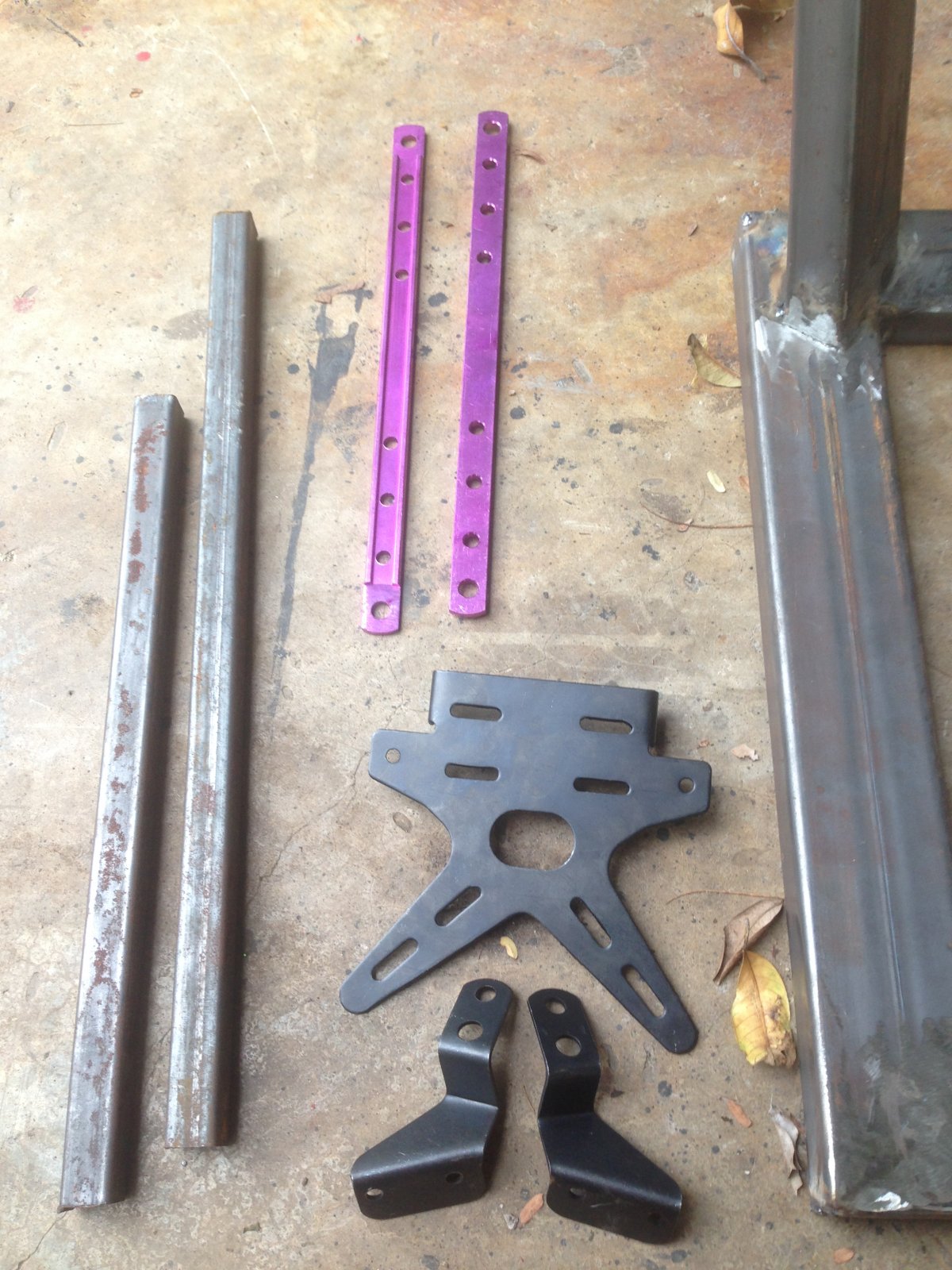

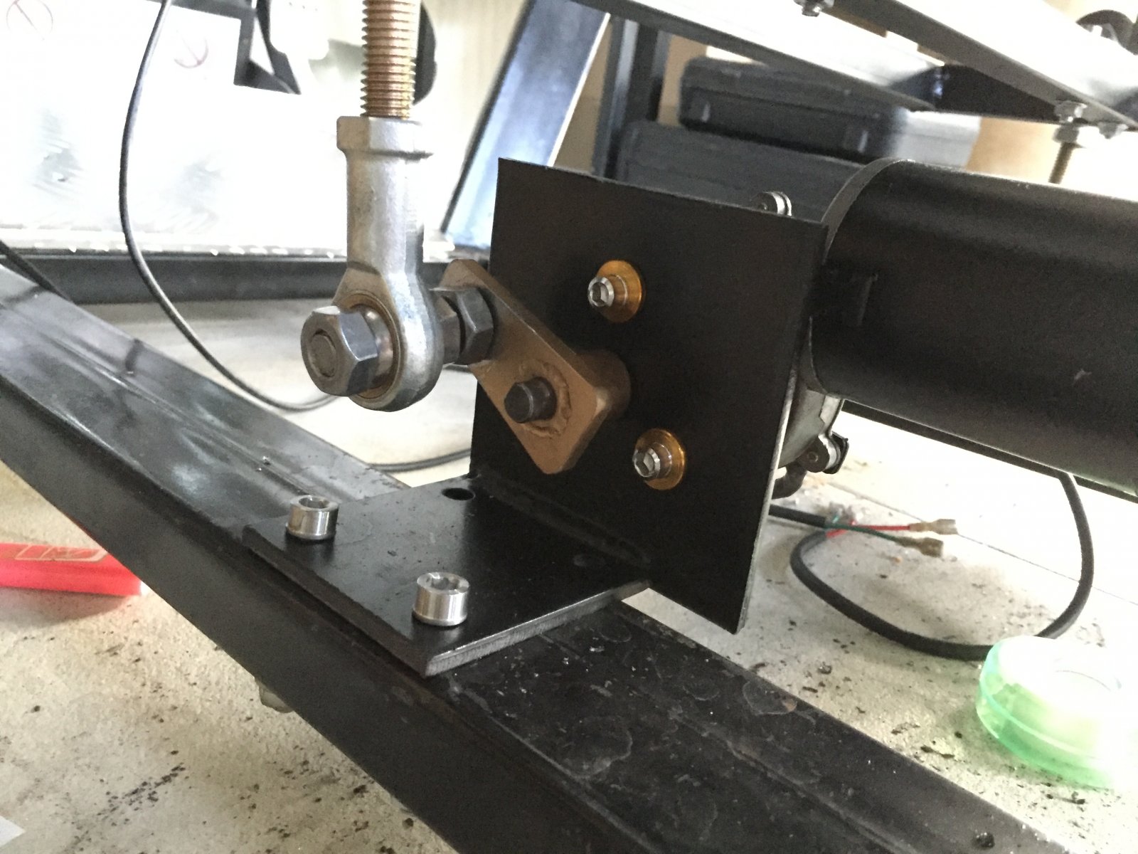

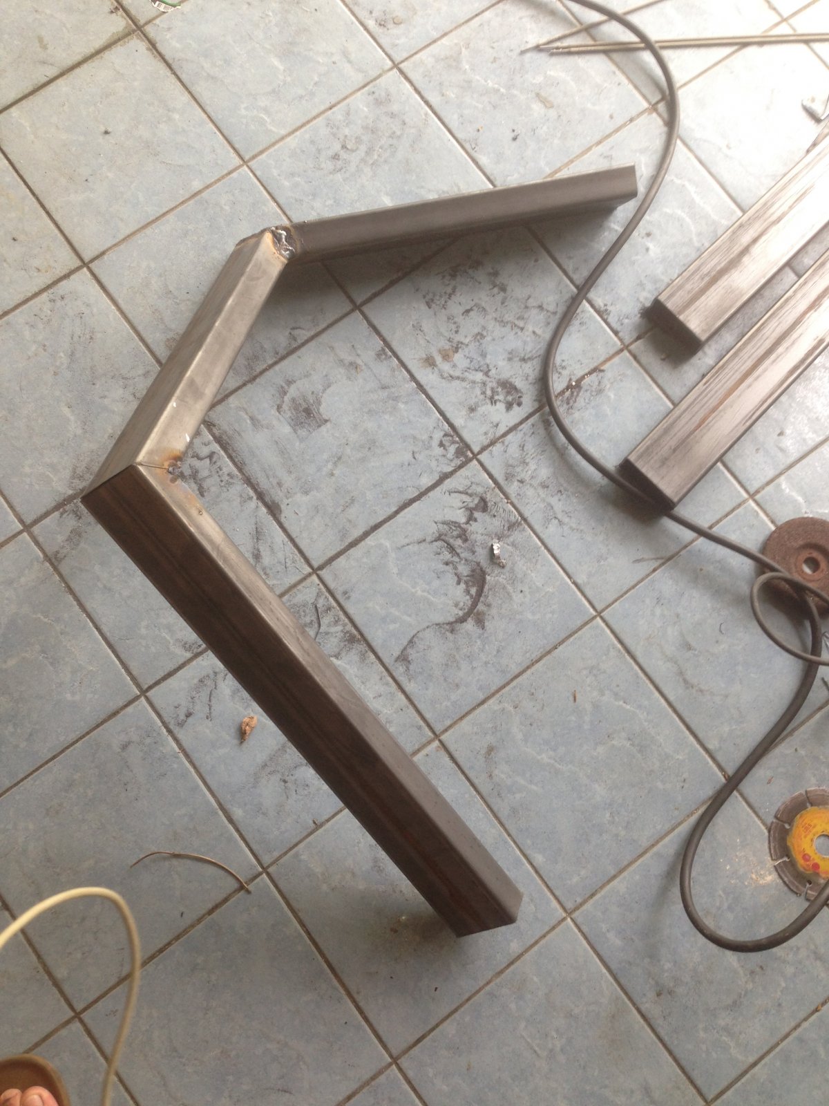

    Hi I'm Kant . I will build 2 dof motion simulator
    Now I've started doing modeling before actually motion simulator
    Now there are some obstacles, I will try to do it.
    Sorry for my English

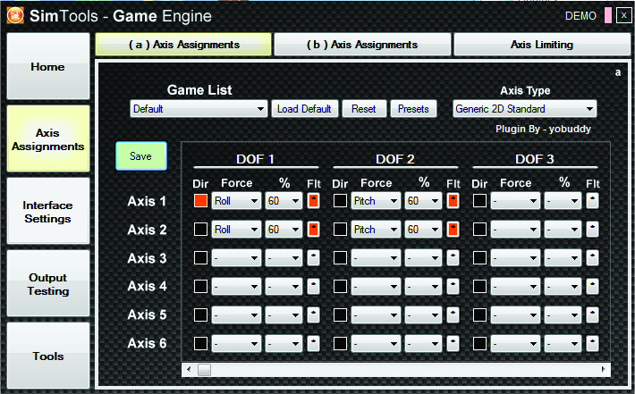

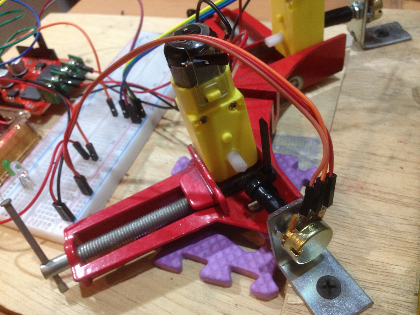

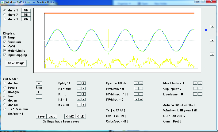

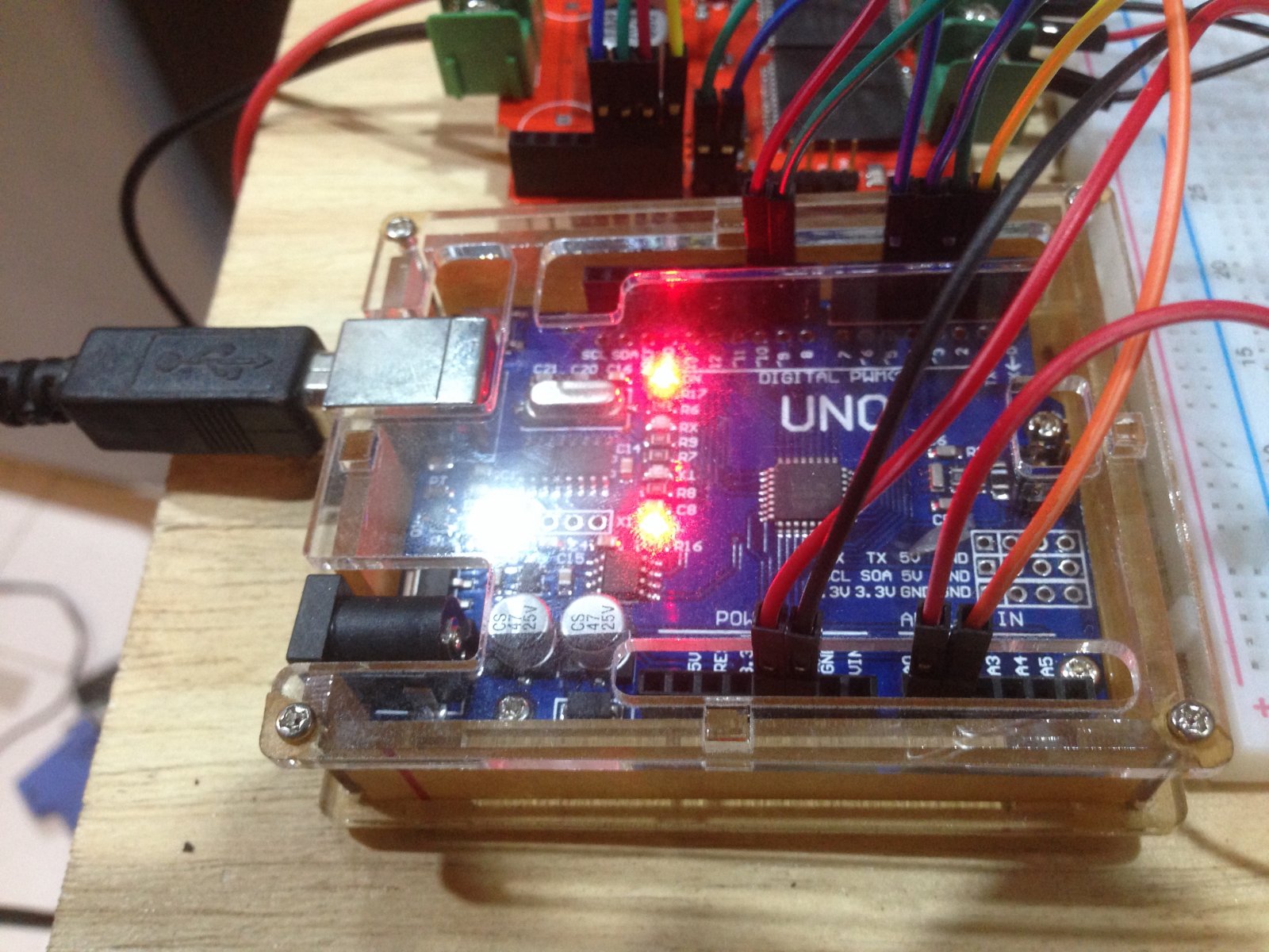

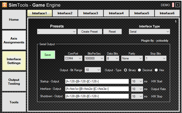

    MY SMC3 and Simtools Test
    Center position of Simtools is not correct.Simtools was't start at center of Pot motor and Motor 1 was jerk.
  5. insanegr
    insanegr !N$@n€
    Jan 14, 2014
    503
    Athens
    16,726Coins
    +499 / 1 / -0
    you should not run Simtools and SMC3utils at the same time.
    first configure SMC3utils and close it and then run Simtools alone.

    lised
    Yes i closed smc3 before start simtools
    Motor 1 out put
    foward 7.57 V
    backward 3.35V

    2DOF, 3DOF, DC motor, Arduino
    It's start 45 degree clockwise from center of Pot(surge output 0)
    and can't move over in this way (Surge 0,-30 is freeze in start )
    at Surge 0 to 30 it move to 45 degree counterclockwise
    I use car 12 v batterry for motor drive

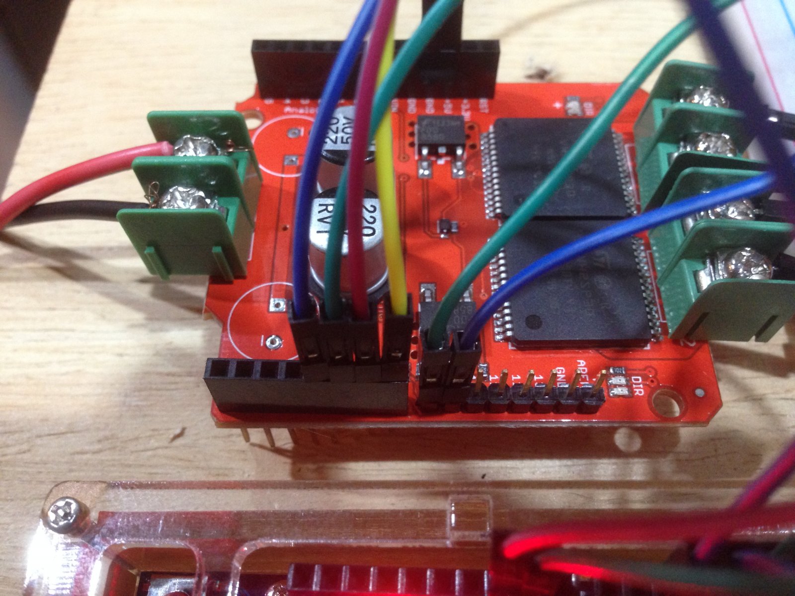

    before going into simtools configuration you have to set SMC3utils first. do you have proper movements in SMC3utils. and again my opinion is that you have a faulty MM but provide some clear screenshots with your wiring to see if something is wrong (watched your vid again and i think your pots are wrong but can't see it clear in the video)

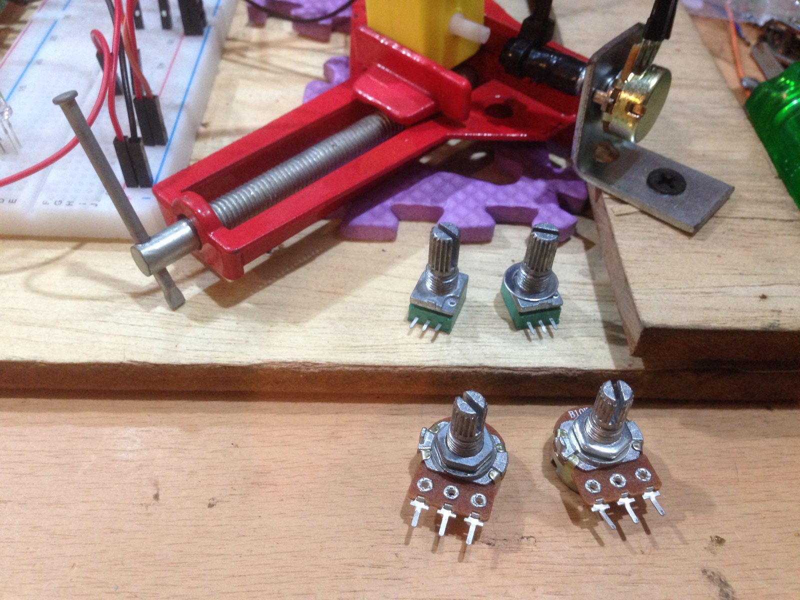

    May be this problem from resolutions of mini motor or Monster Motor drive is't match with mini motor.
  11. Schopfer
    Schopfer Member
    Jul 20, 2017
    48
    Thailand
    86Coins
    +14 / 0 / -0
    I try with big motor it's not has problems.
    Correct position and work well.

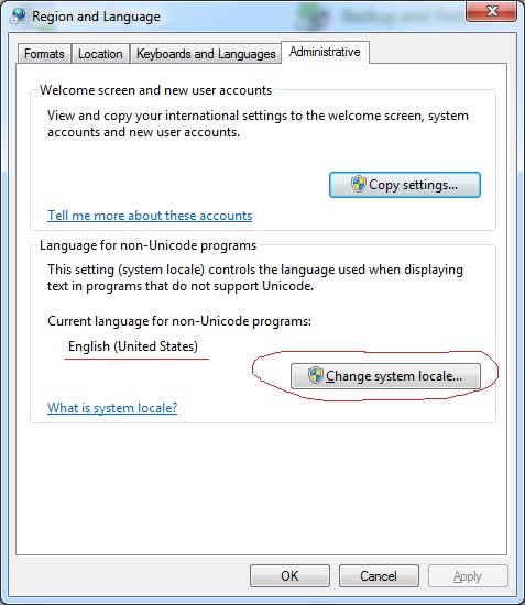

    Probrem in SMC3 is work fine but in simtool is not smooth and incorrect start position same SMC:(

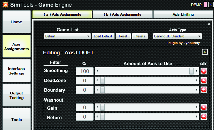

  16. yobuddy
    51,582Coins
    +5,204 / 19 / -0
    Please try this to make sure its not a windows thing...
  17. Schopfer
    Schopfer Member
    Jul 20, 2017
    48
    Thailand
    86Coins
    +14 / 0 / -0
    Thank you very much. It’s work. I’m forgot to change it for new windows.

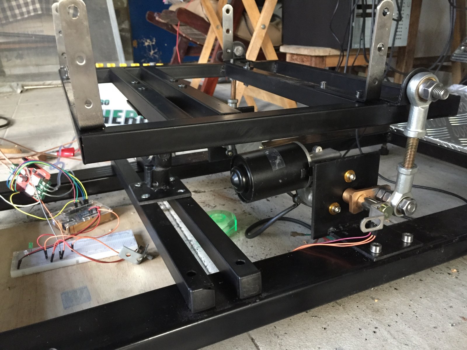

    Today test with 1 motor
    Pot has broken 1.I will full test later.
