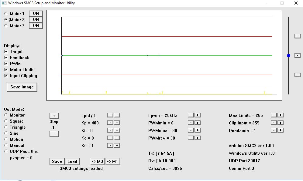

    I have attached SMC settings as well

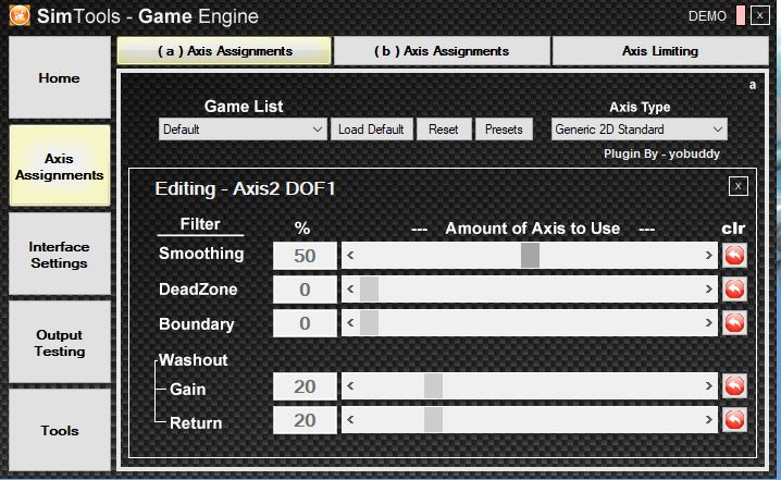

    Just had a quick question, been searching around for game engine settings as I have been testing my rig for the first time today with LFS.
    So just testing my 2DOF with live for speed and using the sway or extra1 setting and everything moves but it never goes back to centre.. for example if you turn left the motors move left but then stay there they don't return to physical center..so the move you turn left it the more it keeps moving the platform left until you run out of physical limits.
    How do I get the motor to move left and then when the turn is finished in the game it centers back?
    I have been playing around with washout and smoothing but cant figure it out
    Cheers

    If it is a 2DOF just use sway.
    Can you please post pictures of your all your SimTools settings.

    First check SMC3 only if manual moving works. PWMmax=30 is very low, too low for my motors at least. If SMC3 shows no issue you can shift to SimTools.

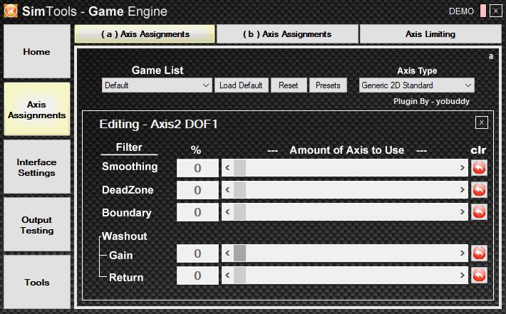

    Hi @Pit and @noorbeast
    Thanks so much for your quick response, yes I have checked it in SMC3 at PWMmax=30 (its not really carrying a load at the moment) so it moves slowly but no problem back and forth, and I am only testing 1 motor at a time as I go to remove any potential errors from me. I have three motors setup and they all work (well expect I have blown one side of my monster moto on one motor so it only goes one way at the moment, so I have switched to the second motor to play with first whilst I solder up another moto later)
    So it also goes back and forth (manually by me) when I test it using the simtools engine with the output testing DOF on.
    so it must be in the axis setup I think...
    here are my setups (one motor and one DOF sway) I had the filters on zero and then tried some random settings on washout and smoothness to try and figure out what Im doing wrong. so here ya go :)

    Short comment about SimTools, don't use washout for now, especially if you don't know what to do with it, I suggest not to use any filters as long as you don't get your rig properly working.
