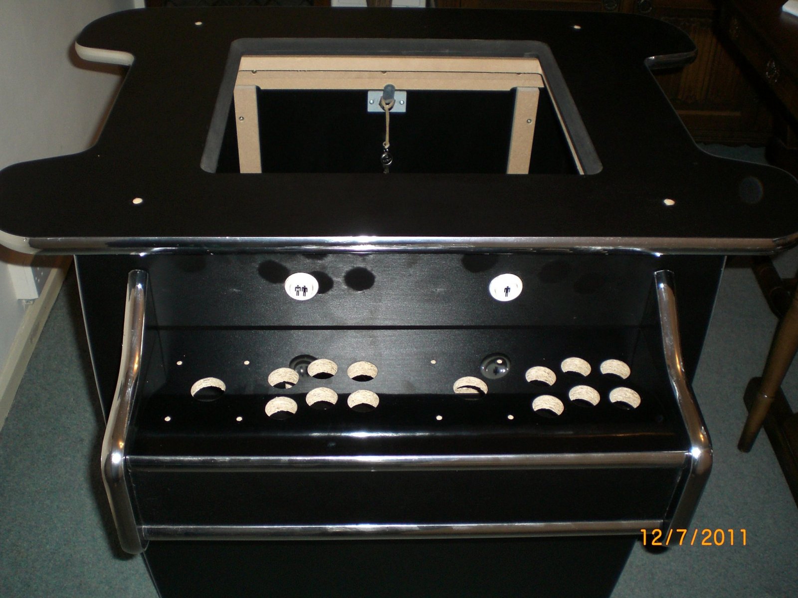

    Anyway I bought a cocktail arcade table in kit form with a view to adding a PC and Mame but once as I was building it I kept thinking of other stuff to do.
    I bought a 22"touchscreen for it as I fancied playing with touchscreen stuff and having a touchscreen jukebox in my racing room at the time.

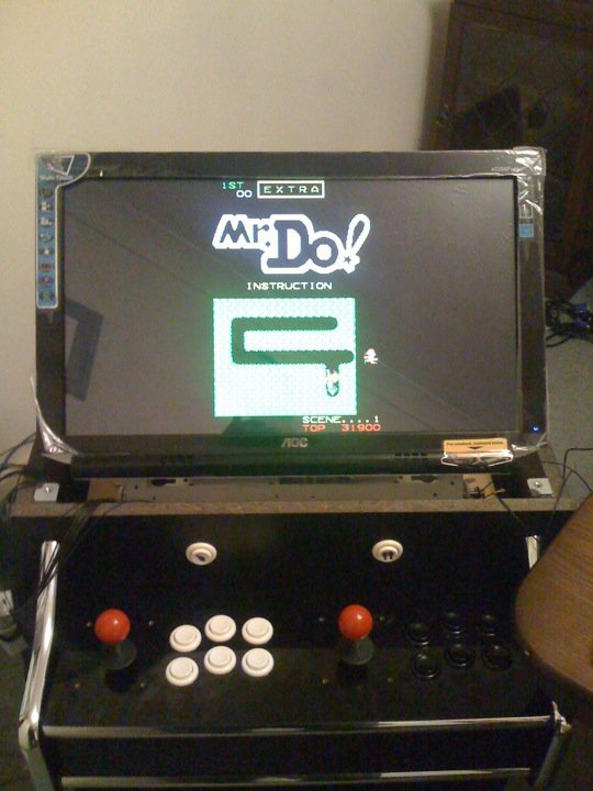

    I hadn't really thought the table through and ended up with 2 players on the same side, I felt this may be annoying if we were playing 2 player side by side hunched over the screen so the obvious solution was to motorise the screen so it could be upright when playing.

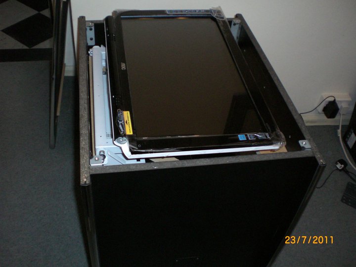

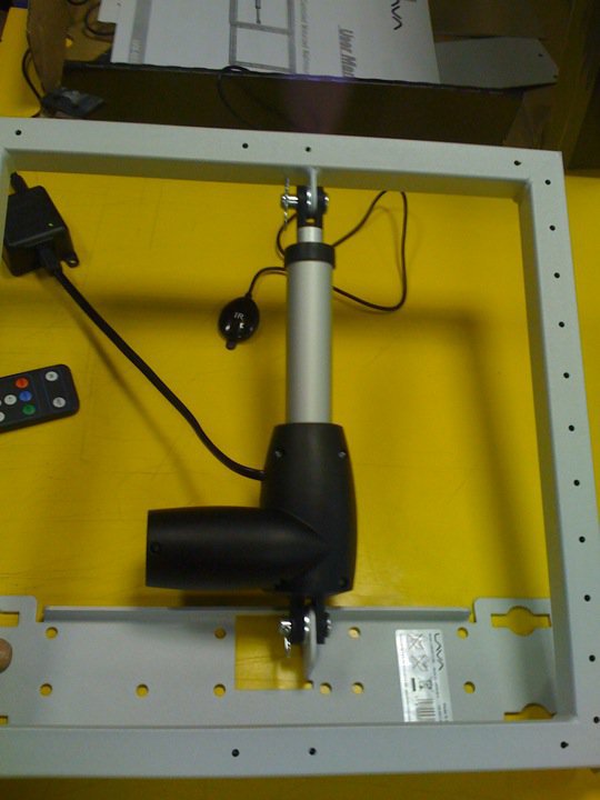

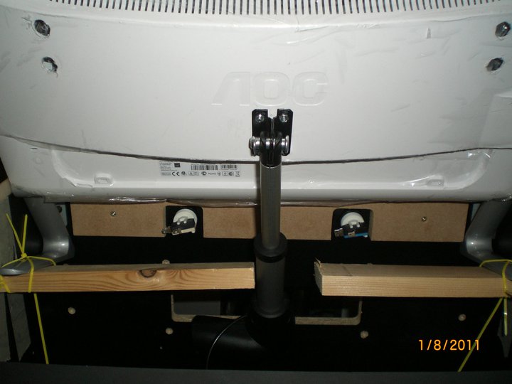

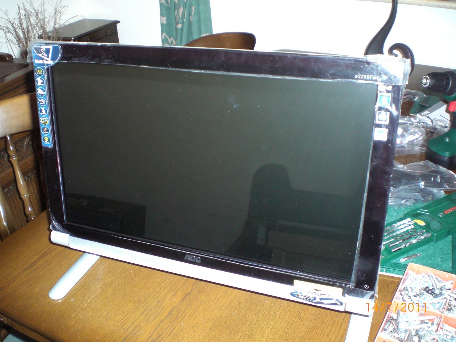

    I found a motorised TV bracket and adapted it to fit inside the cabinet and after a week of swearing and a bit of blood it fitted. It took some head scratching to attached the screen to the bracket and keeping the screen looking complete from all sides.

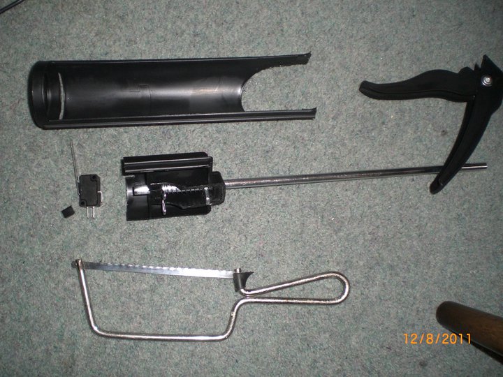

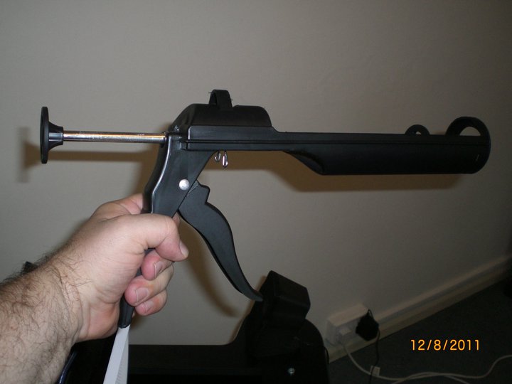

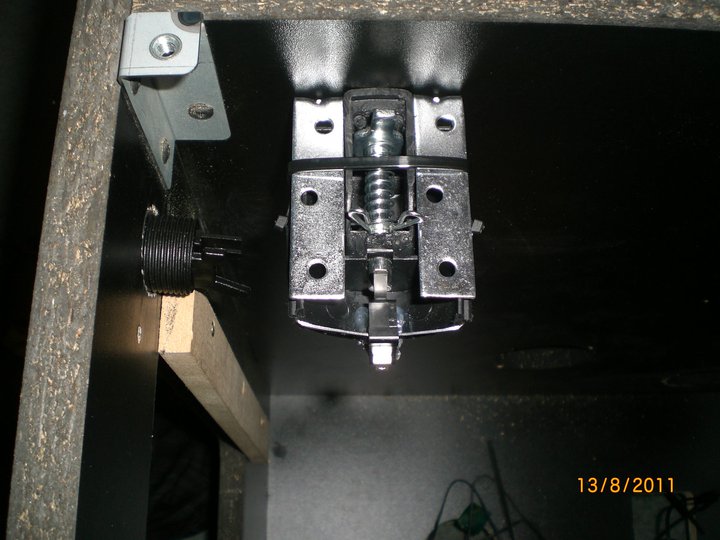

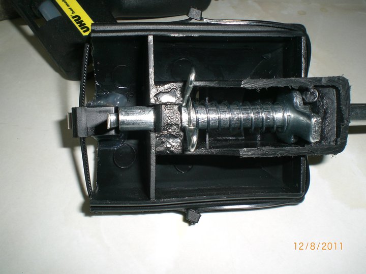

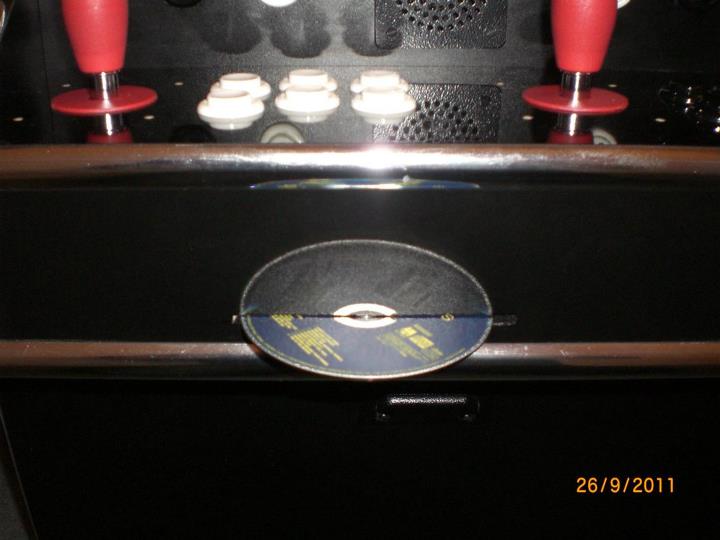

    Once this was working I thought I was done, but at around the same time I came across something that was new to me, digital pinball. So after a bit more head scratching I decided to install the software and add a couple of buttons to either side of the table, that was all good but I needed a plunger. My solution was to chop up a sealant gun for the plunger mechanism and hook it up to a leaf switch. Rudimentary but the spring of the plunger felt great and it all just worked. I added a CD slot to the front just to give me options for every occassion.

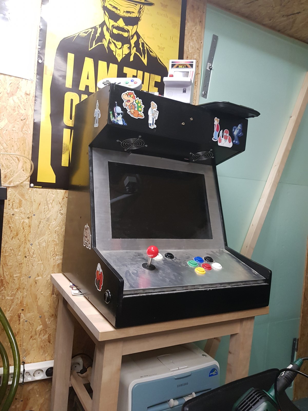

    Looks like a very nice table. I also built an arcade cabinet during Covid lockdown and had a ton of fun making it and now playing on it. I'd really like to build a virtual pinball to go next to it later on this year.
