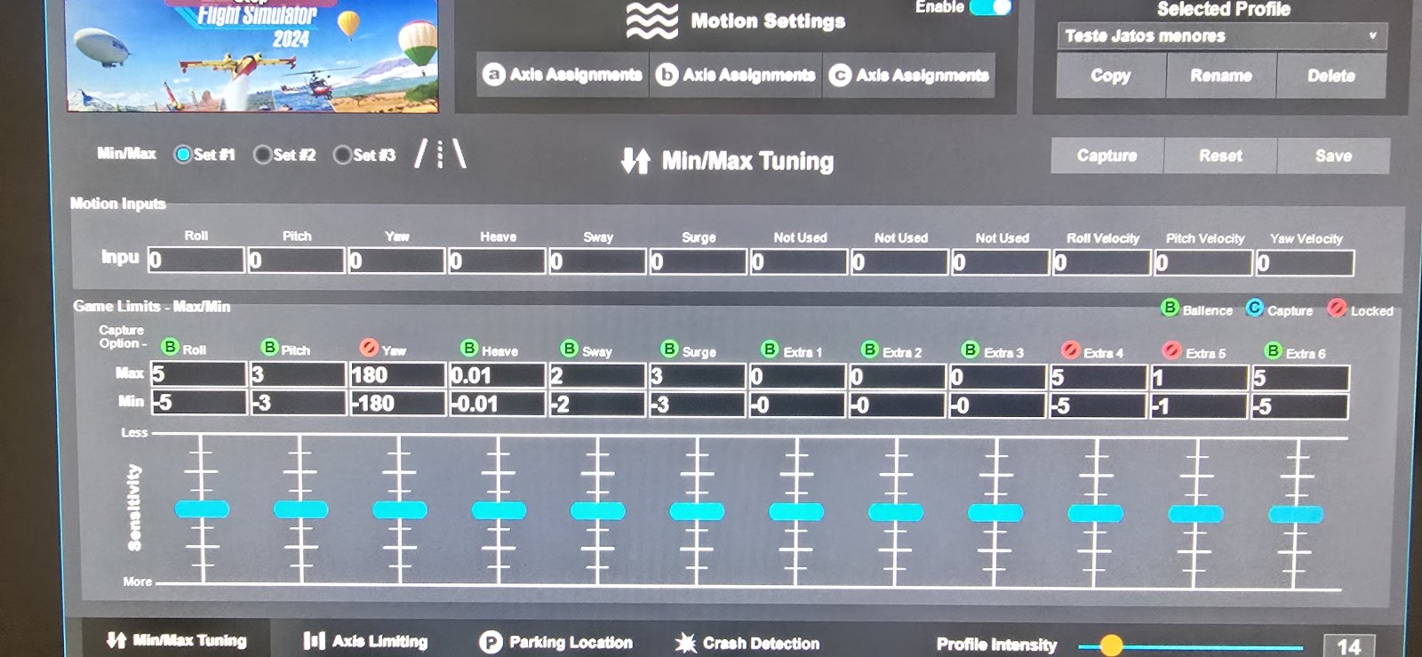

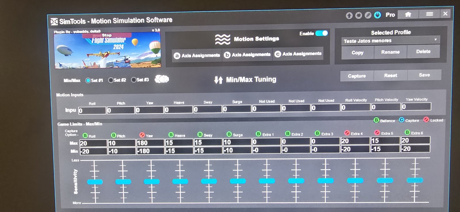

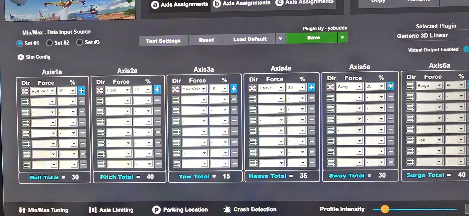

    Hello friends!
    I have a 6dof platform and using SimTools on FS2024. Everything is working reasonably well, but I'm not able to make it 100% smooth. There are always some hiccups, like moderate turbulence. I've tried setting everything to 100% soft, lowering the intensity, etc. Any suggestions? Sounds like "noise"
    22,090
    154,148Coins
    +11,172 / 57 / -2
    Hard to say without seeing your settings and a video of the issue, it could be electrical interference.

    Thanks for the answer. Apparently I have no electrical interference. When I turn on simtools, even before I have entered the flight itself, the platform starts to make small random movements. Does this happen to you too? It's like there, you were already receiving data, and in my opinion this should only happen, at the entrance of the flight itself.

    At first I didn't see anything wrong. Why do you think it's the configuration? And a doubt. In your case, the platform moves, small jerks, as soon as the simtools or flypt move are connected? To me this doesn't make sense, as it shows that data is going well, even though the flight hasn't started yet.
