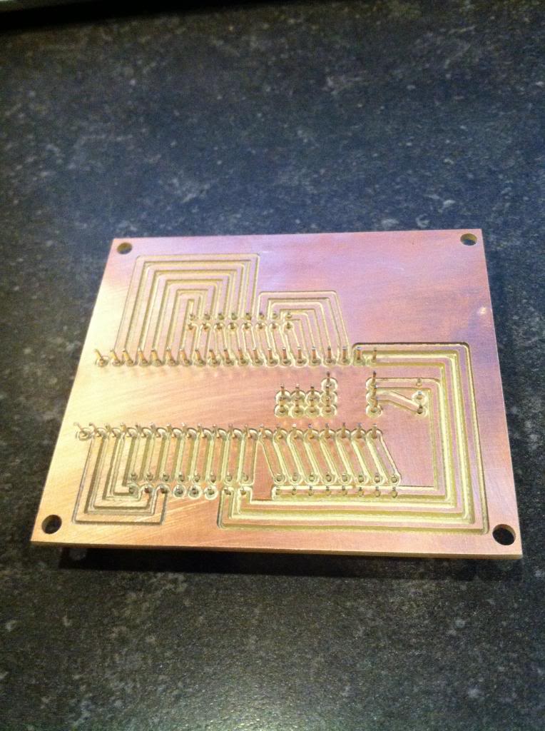

    I built my CNC table from MDF and used the outfeed table on my table saw. I have since moved it to it's own table but it is unbelievable how often I use it now. The software is a bit pricey but VCarve Pro makes creating tool paths, and drawings for that matter, idiot proof....wait...er.... :D

    Is that your CNC? Looks awesome, wish i had room for such a giant beast.
    Isnt the resolution on the x axis not too low when you use a chain for powertrain?
  11. Historiker
    2,163
    9,212Coins
    +2,177 / 19 / -1
    Not really, it is fairly precise to about .001 of an inch. That really depends on how fast you are running it though.
    This is about 1.5" square or so. The drill pattern is perfect, the traces look a bit odd because they were hand drawn.

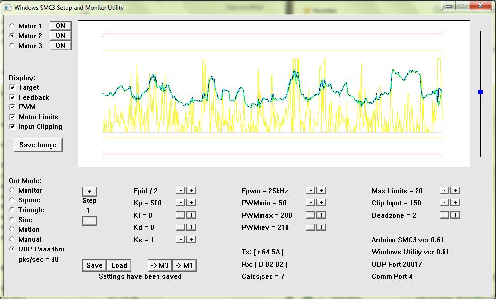

    I have been spending some time fine tuning my seat mover. I am getting pretty close (never completely happy ;)).
    Here is a snapshot of the motion tracking as captured in my SMC3Utility program... As you can see the green line (the feedback position) is tracking the blue line (the target position from simtools) very well. Each pixel in the horizontal direction is 25ms, in other words 40 updates per second on the chart.
    The other line on the chart that I am very happy about is the yellow line which is the PWM duty cycle for the motor. The bottom of the chart is 0% or off and the top of the chart is 100% or fully on - I have it limitted to 200/255=78% max. Note how most of the time is is sitting below 50%. This is why I have commented in the past my H-Bridges don't tend to get very hot.
    Still need to spend some time on the traction loss - it doesn't run as well yet.
