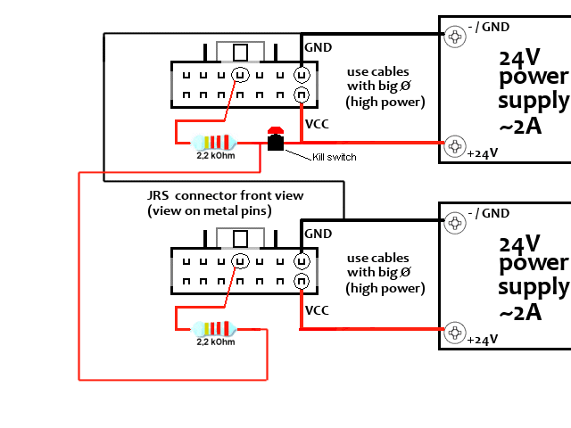

    Thanks for your response.
    So i will buy tie rods even if it very expensive!!
    I have 2 another questions... :uups:
    It is very important to put a kill switch?
    If yes it is possible to put the kill swith before the power supply instead of before the iks pin (like in this picture)?
    My other question:
    Witch power supply should i buy between these 2:
    http://fr.farnell.com/sunpower/s-100f-2 ... dp/1254975
    http://fr.farnell.com/tracopower/txl-12 ... dp/1441234
    Thanks you for your response.

    I would not buy any of those 2 power supplies unless you have a cabinet (the industrial kind) to put them in. I think those are supposed to be on rails in such cabinets. If you get 2 power supplies that are the type use for laptops (with the required volts/amps) you can cut one end and make your connections. They you don't have to worry about electrocuting yourself.
    A killswitch is technically not required to have the seat working. But it's a good idea in case something happens. You decide what it's worth to you.

    The power supplies that you have shown ARE good options because the provide over-voltage protection. Mr. Burns suggestion of a laptop power-supply is a mistake in my opinion because laptop power supplies do NOT provide overvoltage protection. The SCN5's are known to be susceptible to voltage variations. I would highly suggest the 24V 4.5amp option that you listed.

    The schematic above is an old one btw.
    It lacks the 27V zener diode for additional overvoltage protection. The PSU built-in ovp is not reliable enough for SCN5s...
