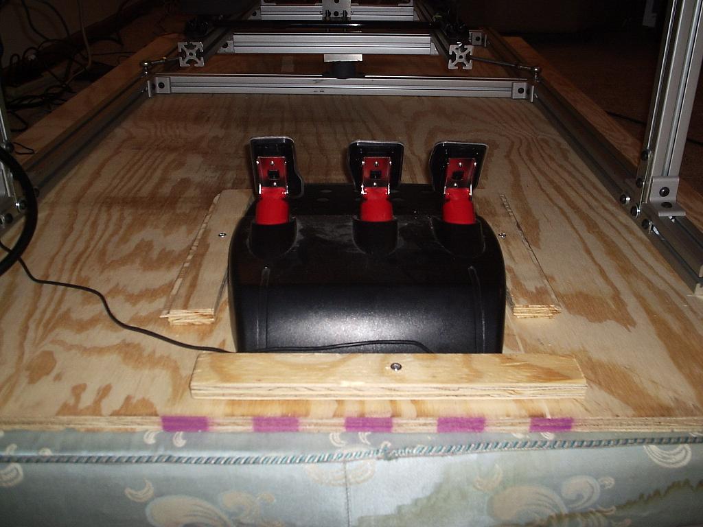

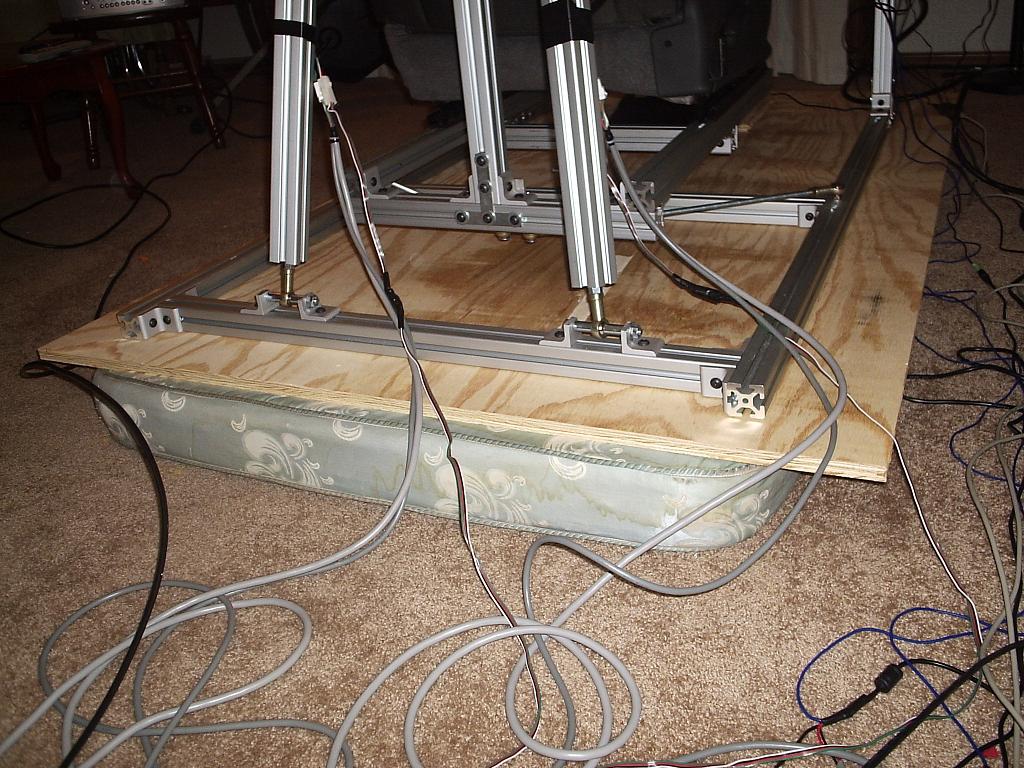

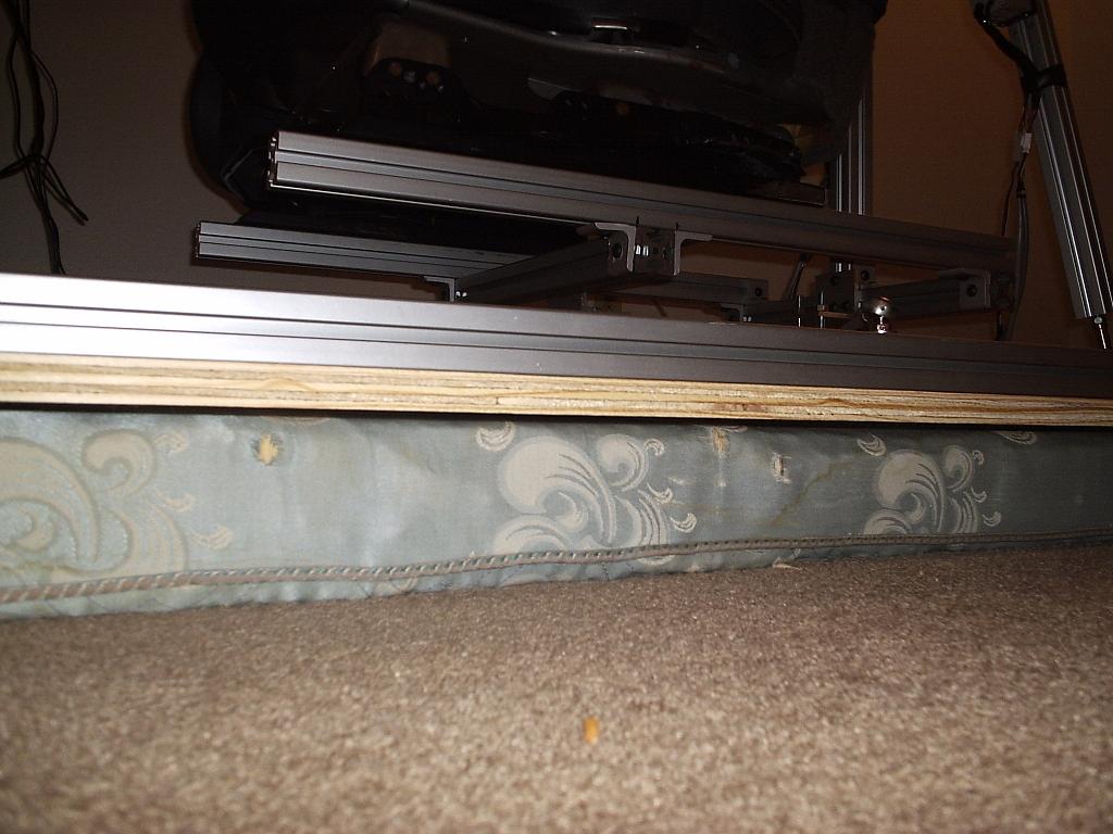

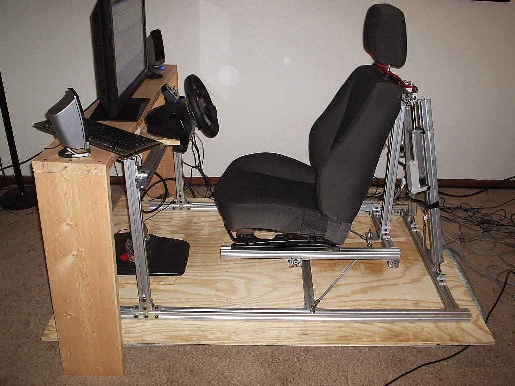

    After trying all sorts of things I put a soft mattress with a piece of wood under it and I have no more complains from the neighbors. Please ignore the wire mess, the location is not yet final and the mattress is from a furniture store garbage that's why it looks the way it does :rofl: . I provisionally mounted the pedals with some wood, it works good :D .

    you could add a leg on each corner of the wooden plate. If the length of each leg just would be e.g 1,5cm shorter than the mattress, you'd hav some addiitional safety while stepping in and out to your simulator.

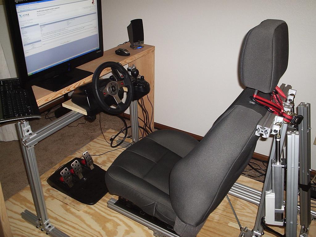

    As well it seems the acutator arms are placed too much vertical still, I think.

    I have some space to decrease the vertical angle by moving the chair and steering wheel forward, i have seen people use around 80 degrees or so, what would be a good angle (besides 45 deg)?

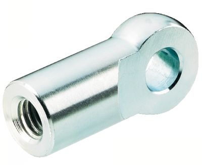

    In order to connect the actuator to the seat and other, should i use:
    this element 1
    or this element 2
    Patrick

    you definitely should use element 2 / joint heads !
    The actuators must be able to move in all directions. You have to take these parts for the side stabilizers as well (to avoid distortion of the seat unit).

    Yes, the 2nd one or similar (with a movable inside) - the inside needs to be able to move so it can bend on the rod that you connect the actuator to.

    Dont forget to order a rod end with matching fine thread pitch!
