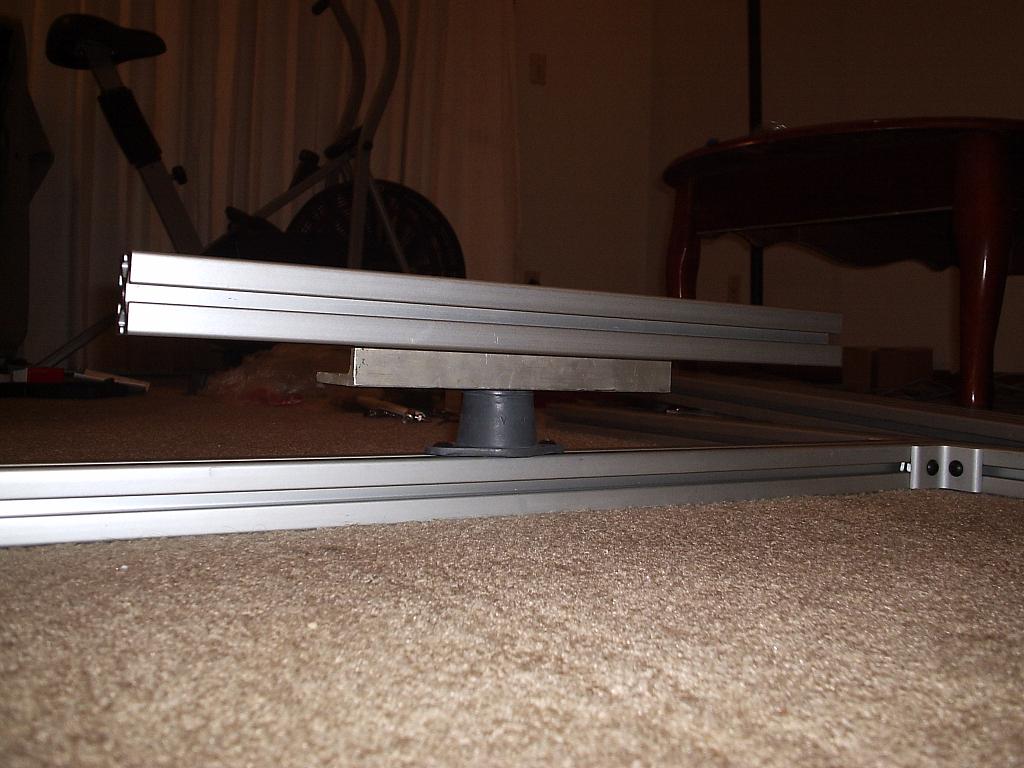

    So, after reading for a week, I decided to start work on a moving chair. (Ich kann auch deutsch ein bisschen, war 4 Jahre in Heidelberg auf der Uni).
    It's a little messy with the instructions :eek: , so I'm not 100% sure what I'll need, I guess I'll find out as I go :cheers: .
    For now I have the following:
    Aluminum profiles (hopefully enough for the chair part - won't do the wheel or pedal part for now, just the moving chair frame part) and brackets to connect all the stuff together. A seat from the junk yard that can be adjusted forward/backward and up/down.
    I am missing all kinds of plates,rods and dampers I see in the drawings around here. No actuators yet, not sure what to go with here, does anybody have any suggestions? I don't want to spend more than $500 per actuator.
    I will try to post pictures as I am building it, I'm sure I'll come across things where I'll need help. Thank you

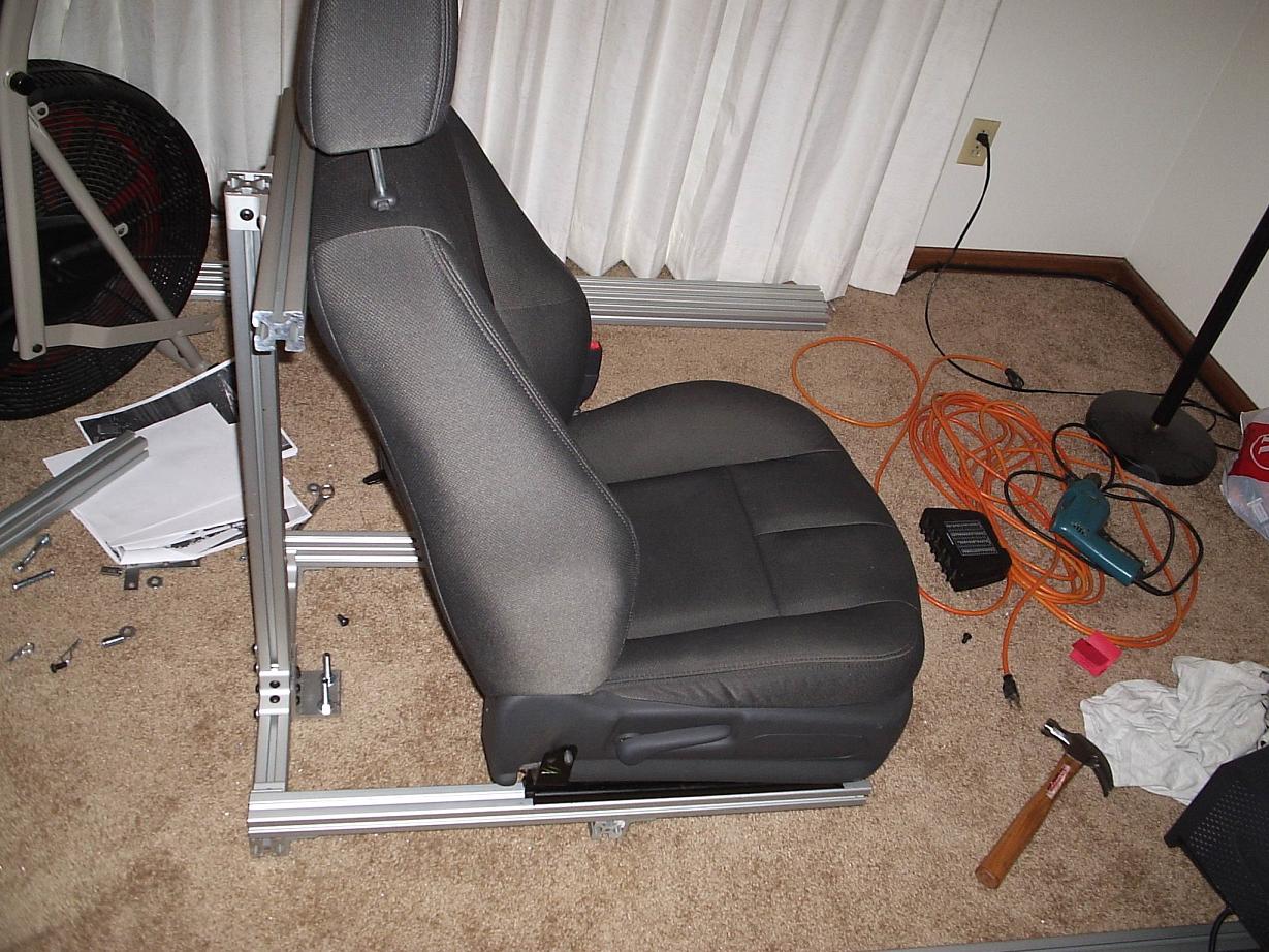

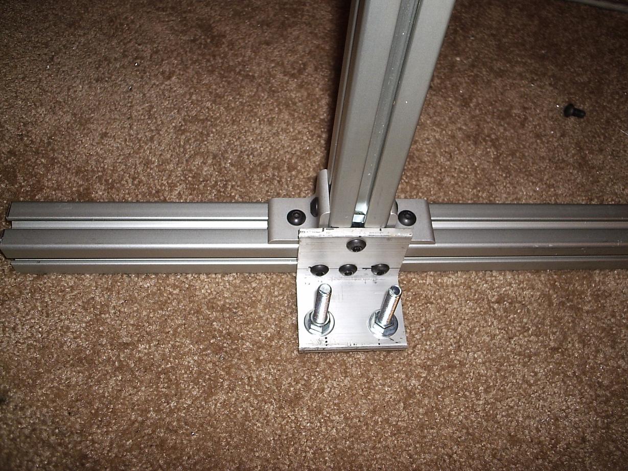

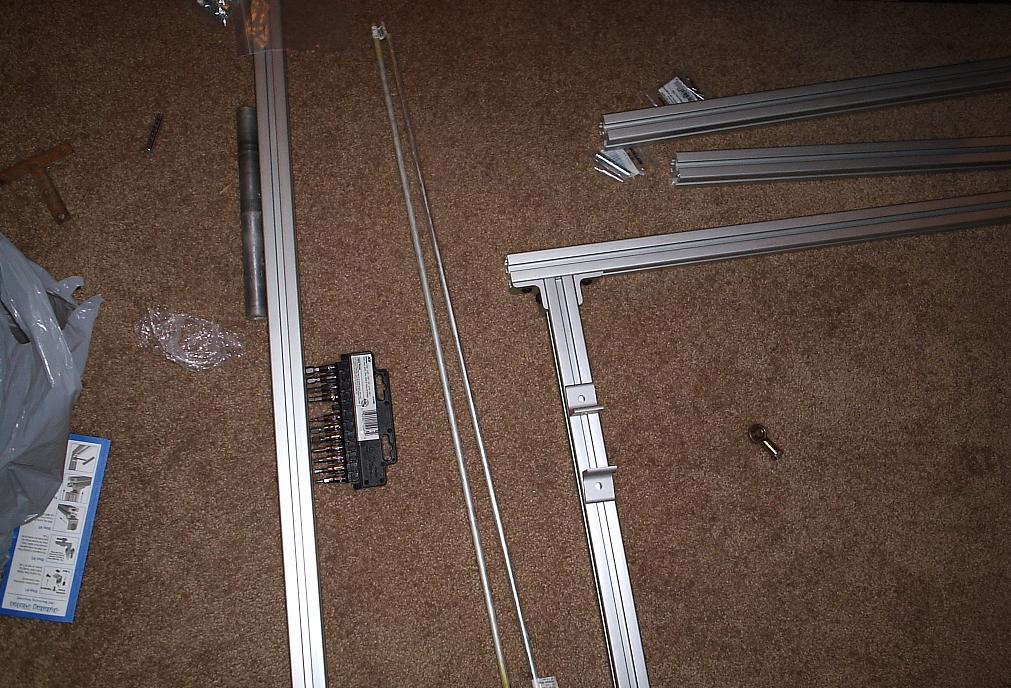

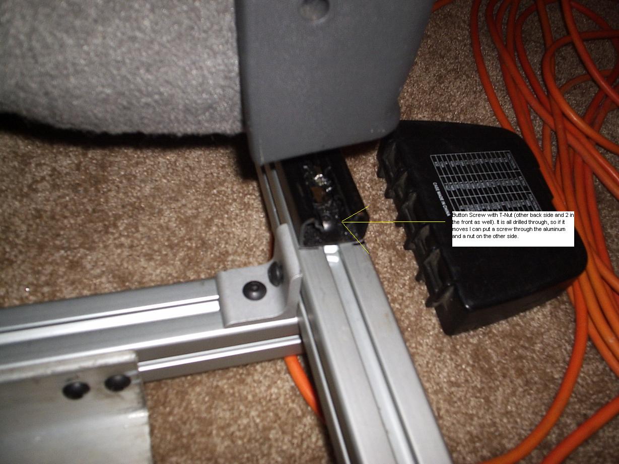

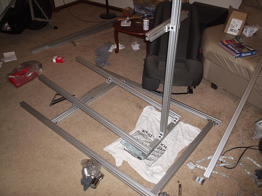

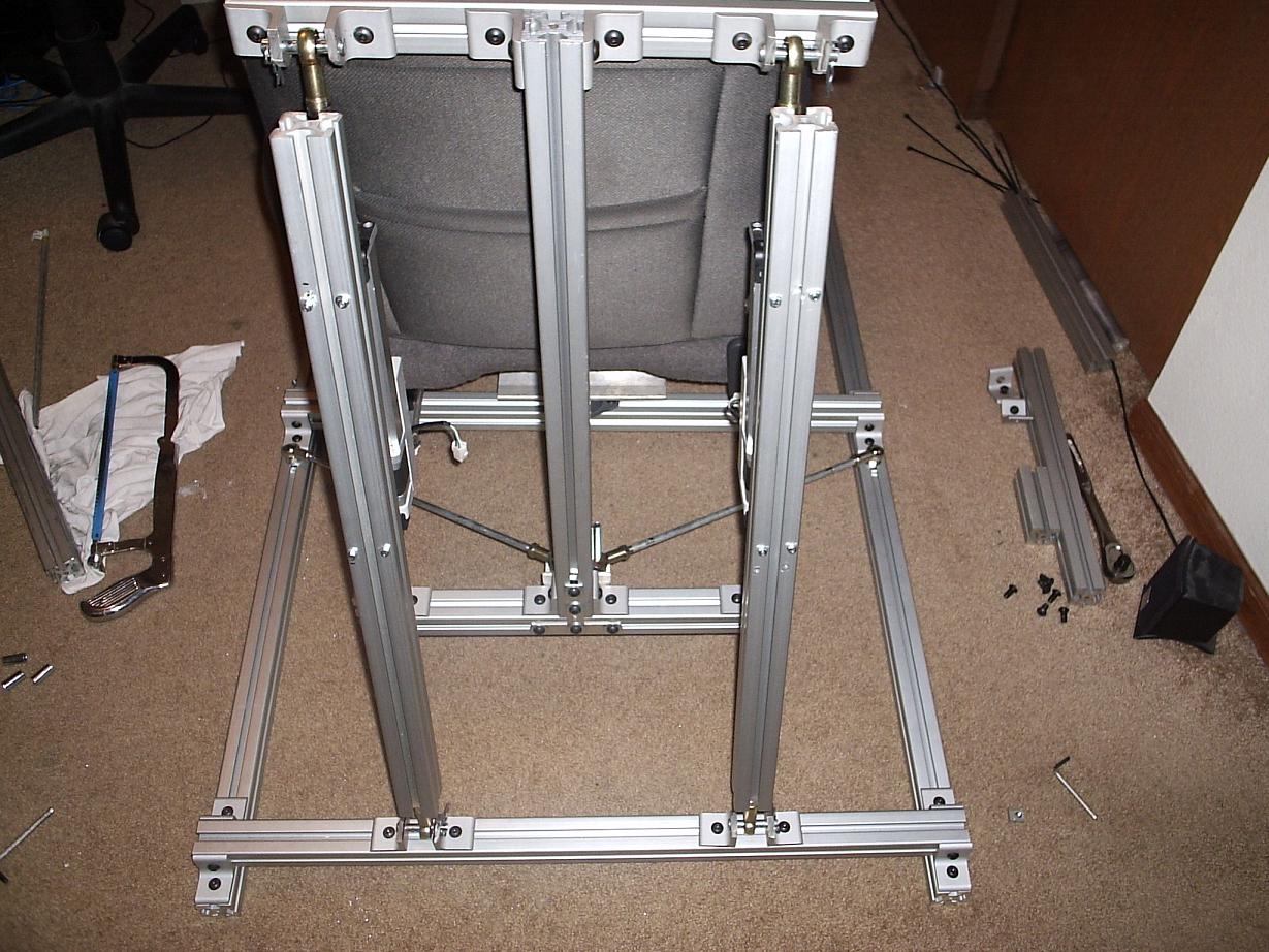

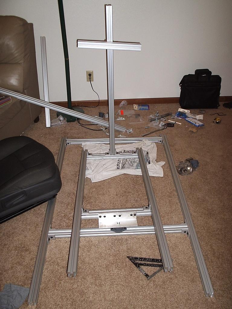

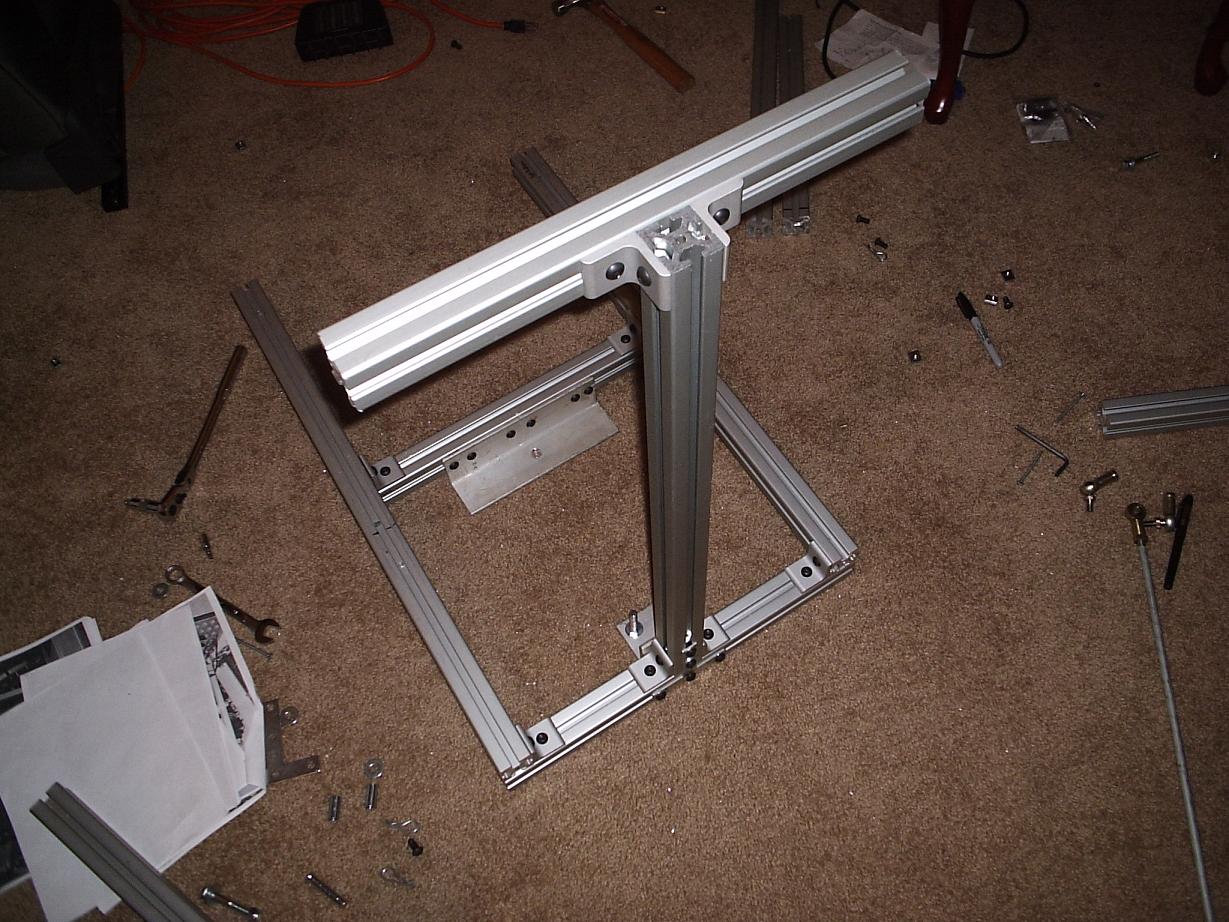

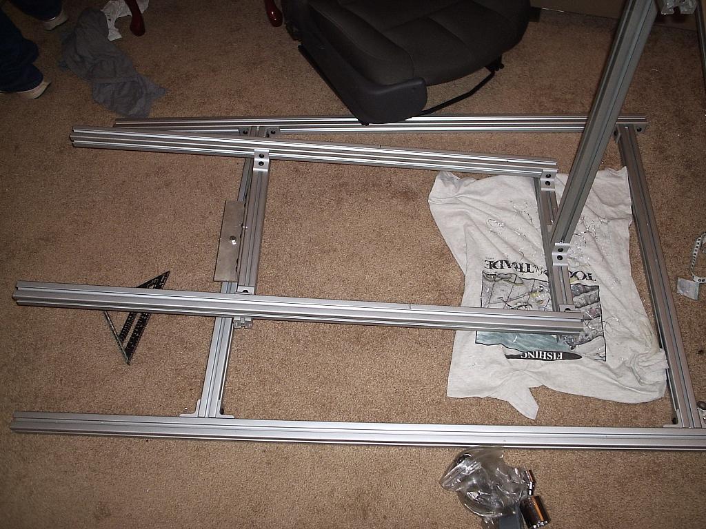

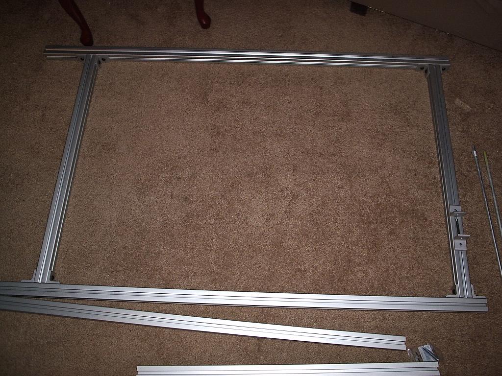

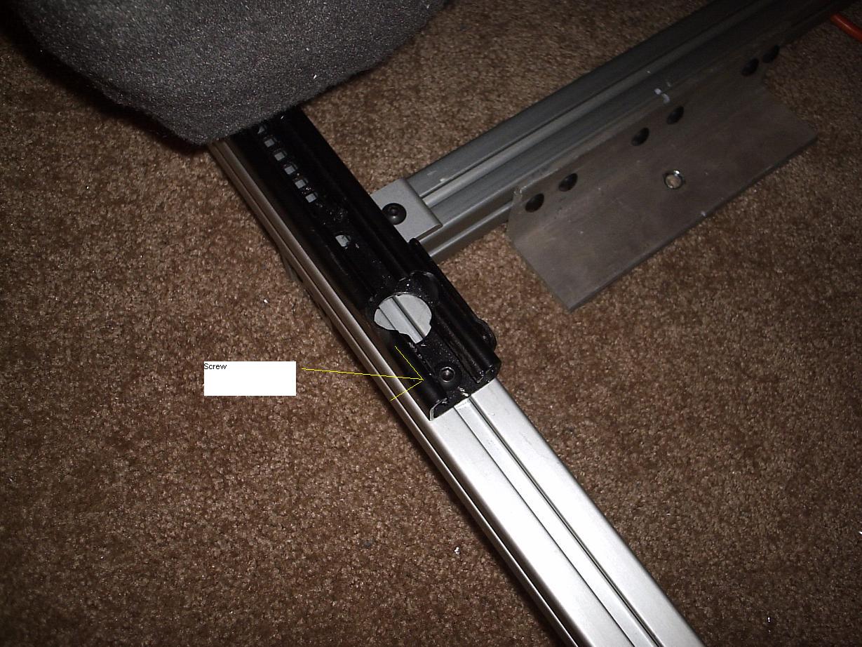

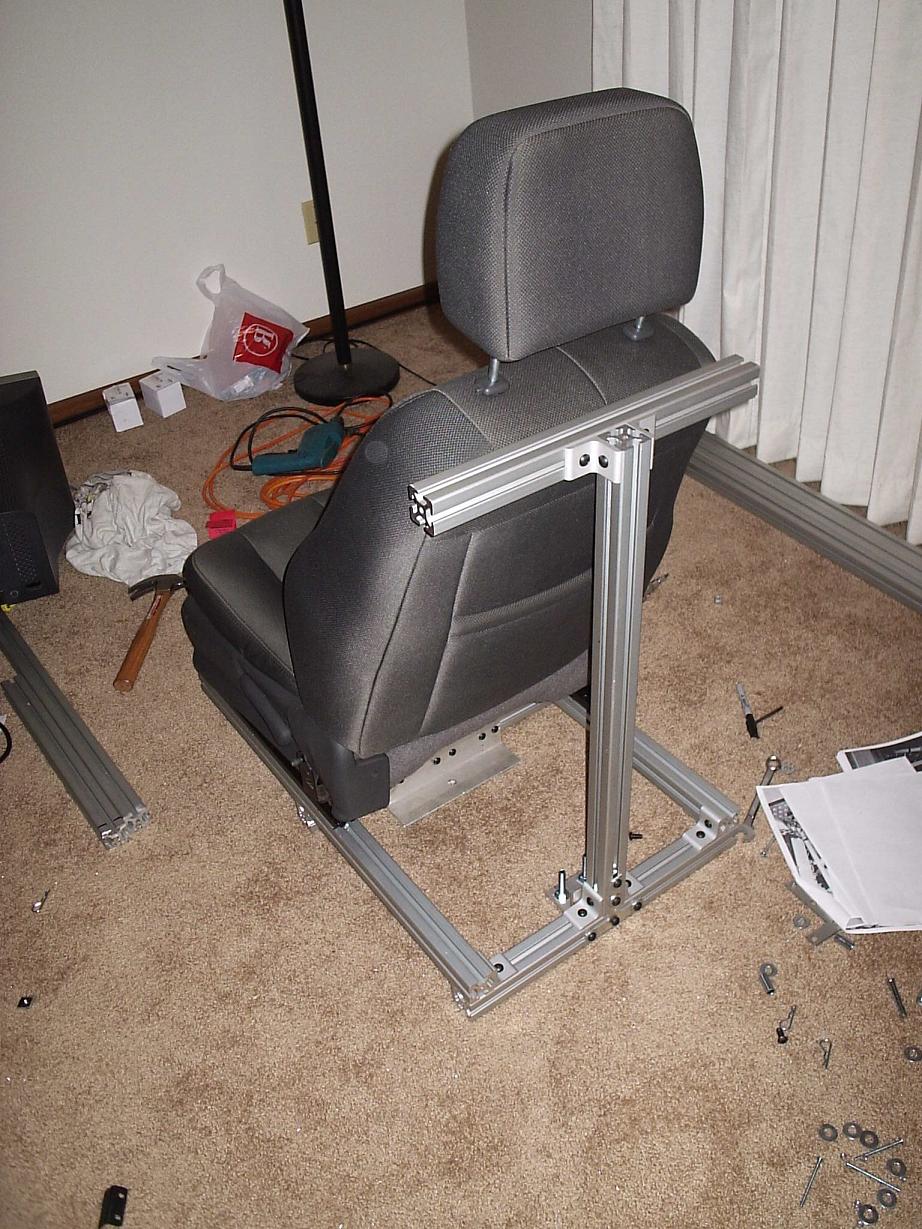

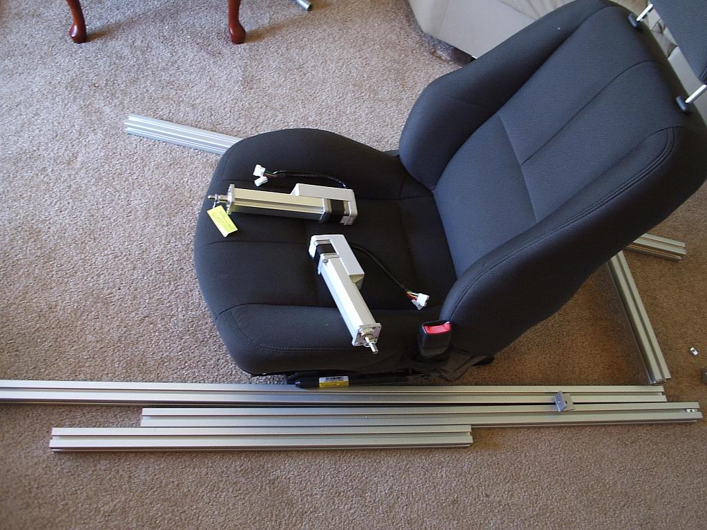

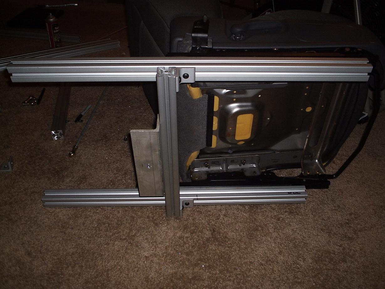

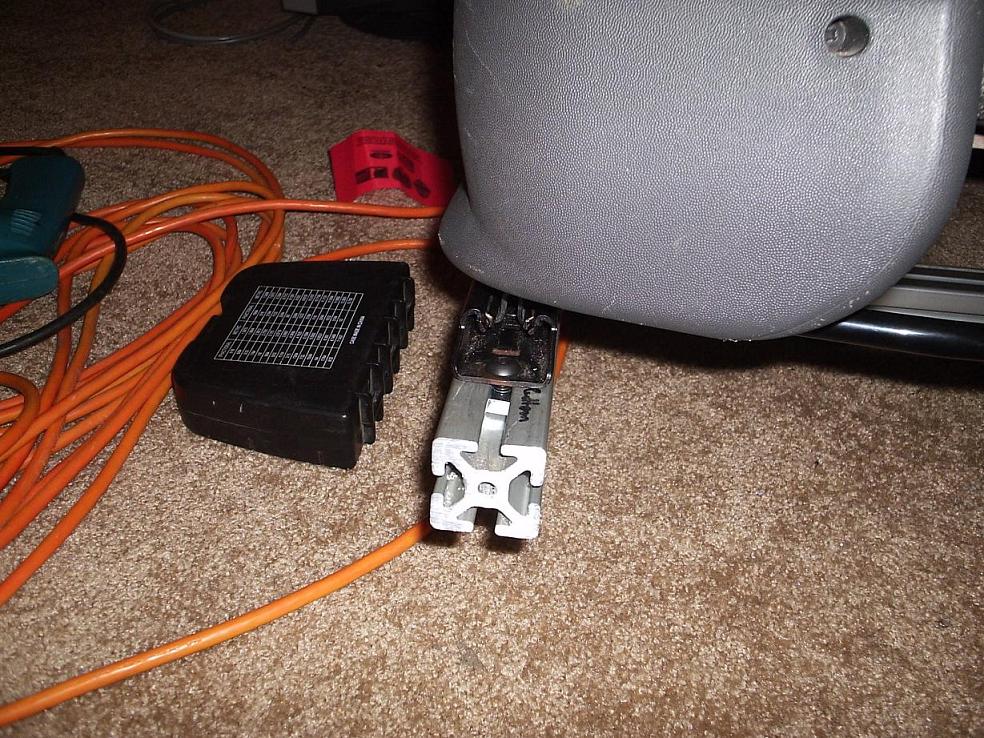

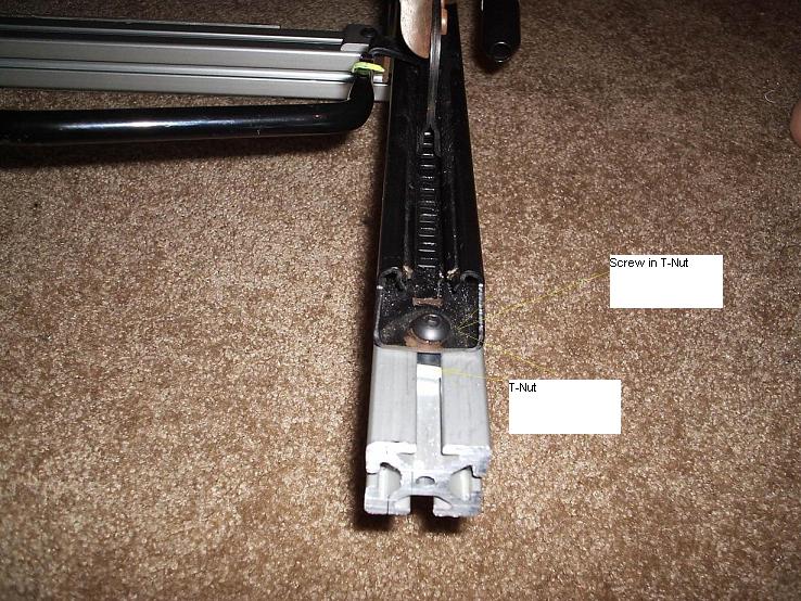

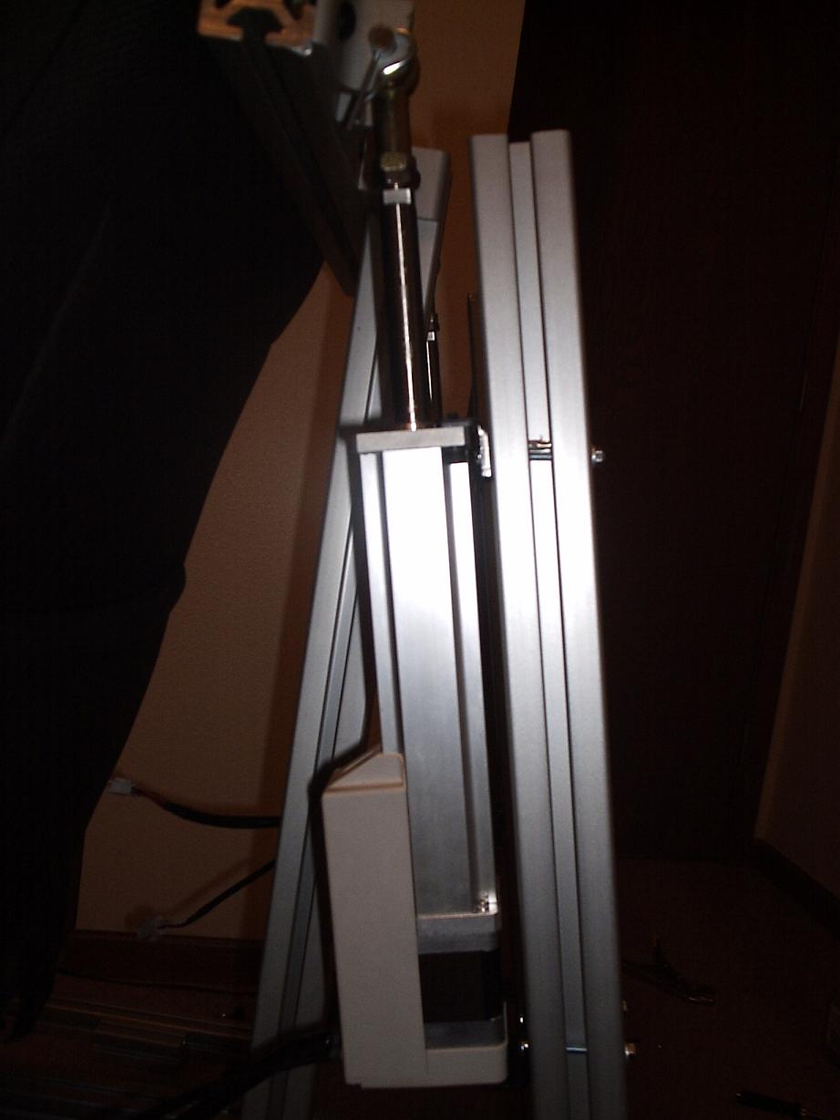

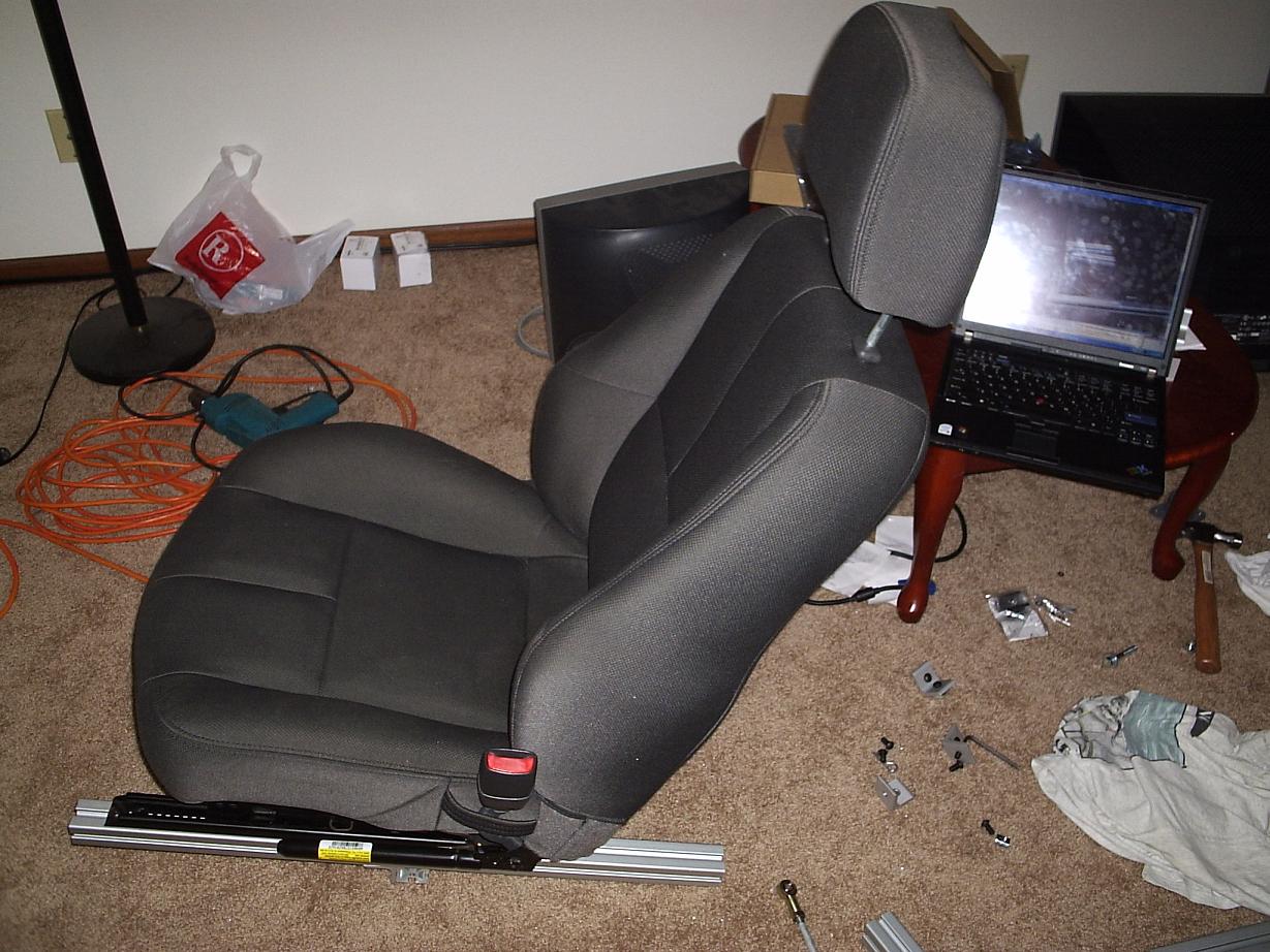

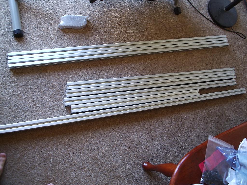

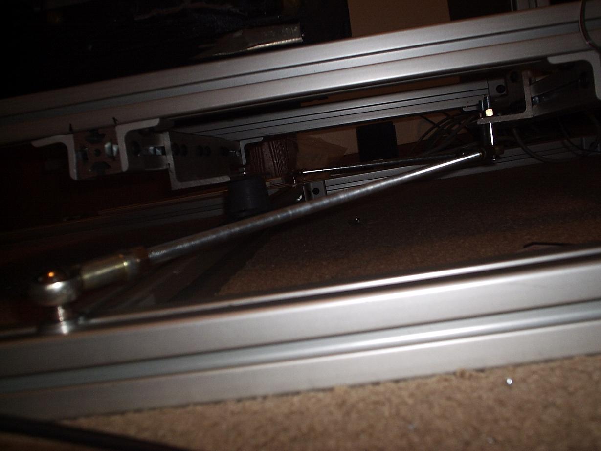

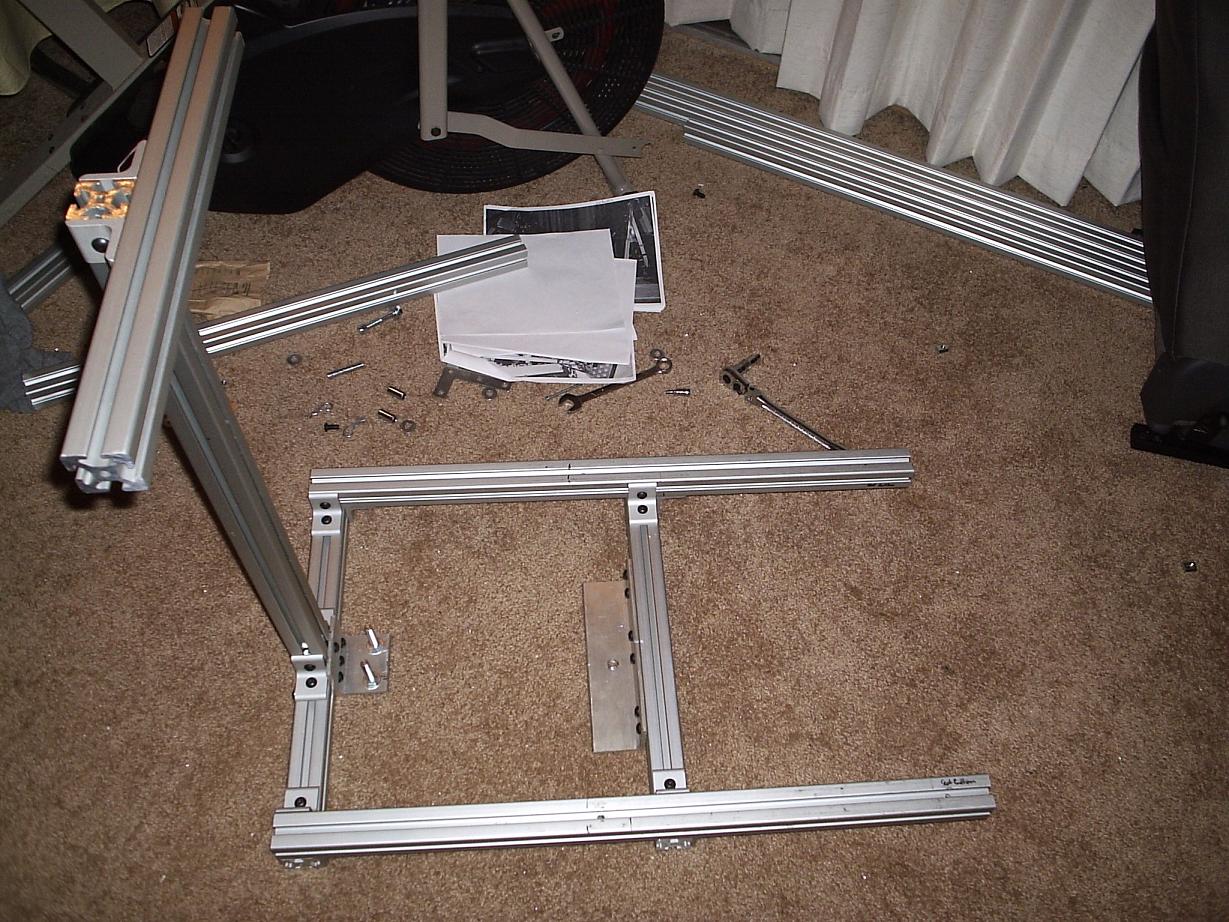

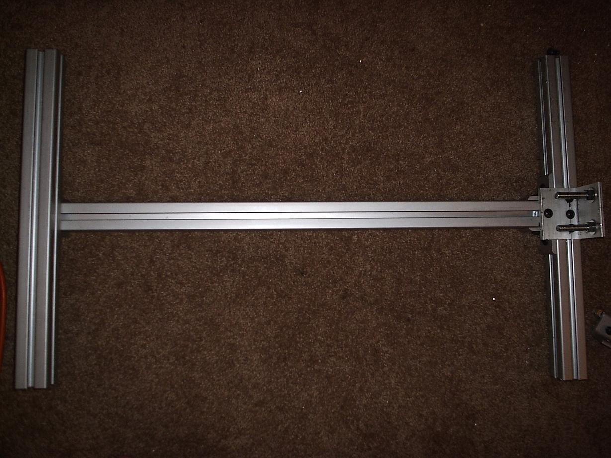

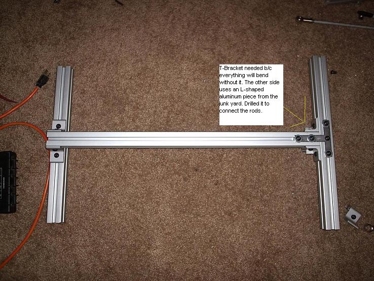

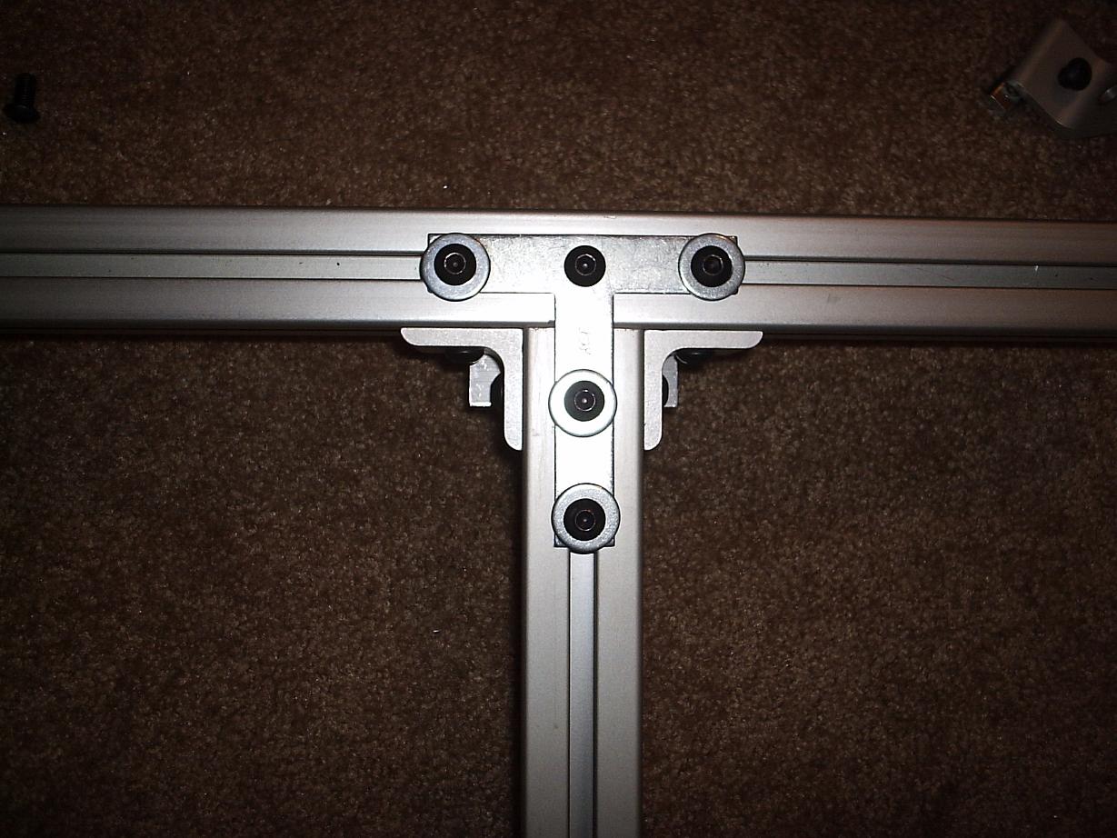

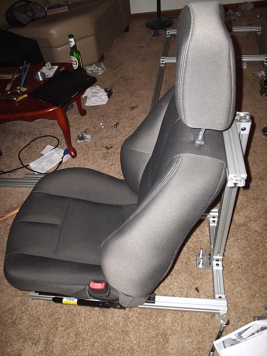

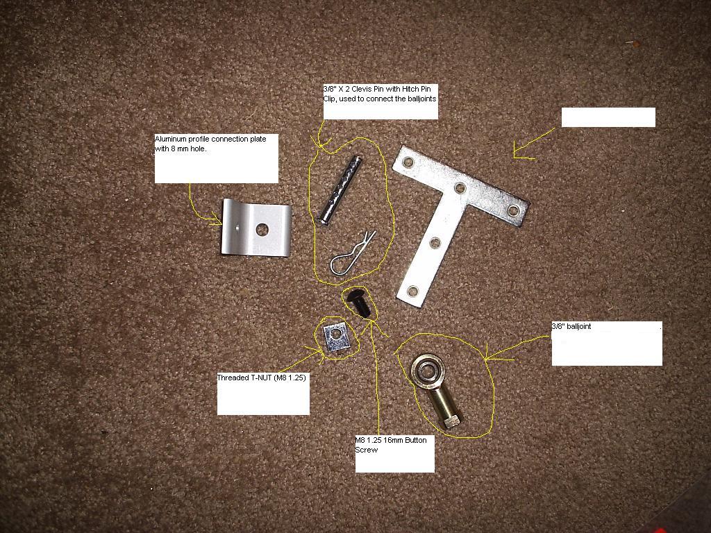

    First, something I should say about metric components in the US. If you don't have to get metric stuff, don't. It's a nightmare to find anything in metric sizes that fits. You will have to tap and rethread some screws and/or bolts in order to make everything fit. Also, don't underestimate the cost of scews, bolts, washers, whatever. It all adds up fast .
    To start:
    1.) 7332 mm of 40X40mm aluminum profiles. They are in different lenghts, I was trying to avoid having to cut too much, but some cutting will be needed.
    2.) 40-50 M8 angle brackets to connect all the profiles
    3.) 50-100 M8 1.25 16mm button scews to connect the brackets to the profiles (this was a nightmare to find, the stores would have 5 metric scews and that was it).
    4.) 5-8 clevis pins with pin clips to connect balljoints (from the actuators to the base, rods that need to move etc).
    5.) 6-7 T Plates
    6.) 50 T-Nuts to use inside the profiles to connect them together with the brackets and screws, as well as anywhere else that they are needed.
    7.) Female balljoints and female balljoints with studs. 2 of these need to be rethreded to match the 10mm scn5 actuator connections, the rest can be used the way they are.
    8.) Seat from a Pontiac Grand Prix
    9.) 2 scn5 actuators
    Missing some bolts and washers to connect the seat frame (Sitzramen) to the base (Grundgestell). I have a plan on how to connect them, but I don't know what to use for the part that bends with the seat frame? Any advice? I was thinking some sort of U-Joint (universal joint), but they seem to be huge and heavy. Any advice?

    For the seat-frame/base-frame connection you should use a rubber silent block with threads on both sides
    Mine have M12 threads. Dont know the corresponding size in inch.
    Have fun!
    Christian

    Thanks for the help. How does the rubber hold up to the constant movements, does it need to be replaced once in a while?
    Edit. Got one from vibrationmounts - http://www.vibrationmounts.com/RFQ/VM02015.htm (V10Z52-FB0550DD). It should hold up ok I think.

    yes, that model should do the job.

  6. bvillersjr
    bvillersjr Active Member
    Oct 11, 2008
    1,174
    Ohio, USA
    438Coins
    +23 / 1 / -0
    I'm not sure how important it is, maybe someone else can chime in here, but if you're designing what I think you are, then allowing the seat to slide forward / back on a traditional slider mount will alter your center of gravity and place alot of undue stress on the actuators. I'm designing my own seat base, and the entire mechanism, including actuators slides forward and back, keeping my center of gravity the same, and placing the minimal load on the actuators.
    Also, U-Joints can be purchased in a variety of sizes (Not just car / truck sizes) like small tractors etc.. I am planning to use a smaller on that I found, which will alleviate the need for tie-rods to prevent rotation and if I am correct, will hold a larger amount of my weight than other designs that I have seen.
    Good luck with your project,
    Bernard (bvillersjr)

    That's correct, the seat can't be moved forward/backward unless the actuators will move with it and preserve the center of gravity. For now it will not be moved, might make changes after it's done for movement. The wheel and pedals can be moved forward, backward so it's not a big deal.
    I have seen smaller U-joins, but most people don't seem to use them. Tom Theison posted a video here (http://www.megaupload.com/?d=N10ODDH0 and the thread my-future-motion-cockpit-t132.html?hilit=vibrationmounts). He is using one of the diamond rubber mounts and doesn't need to use any straps, I guess I'll do something to the design if it wants to start spinning :eek: .

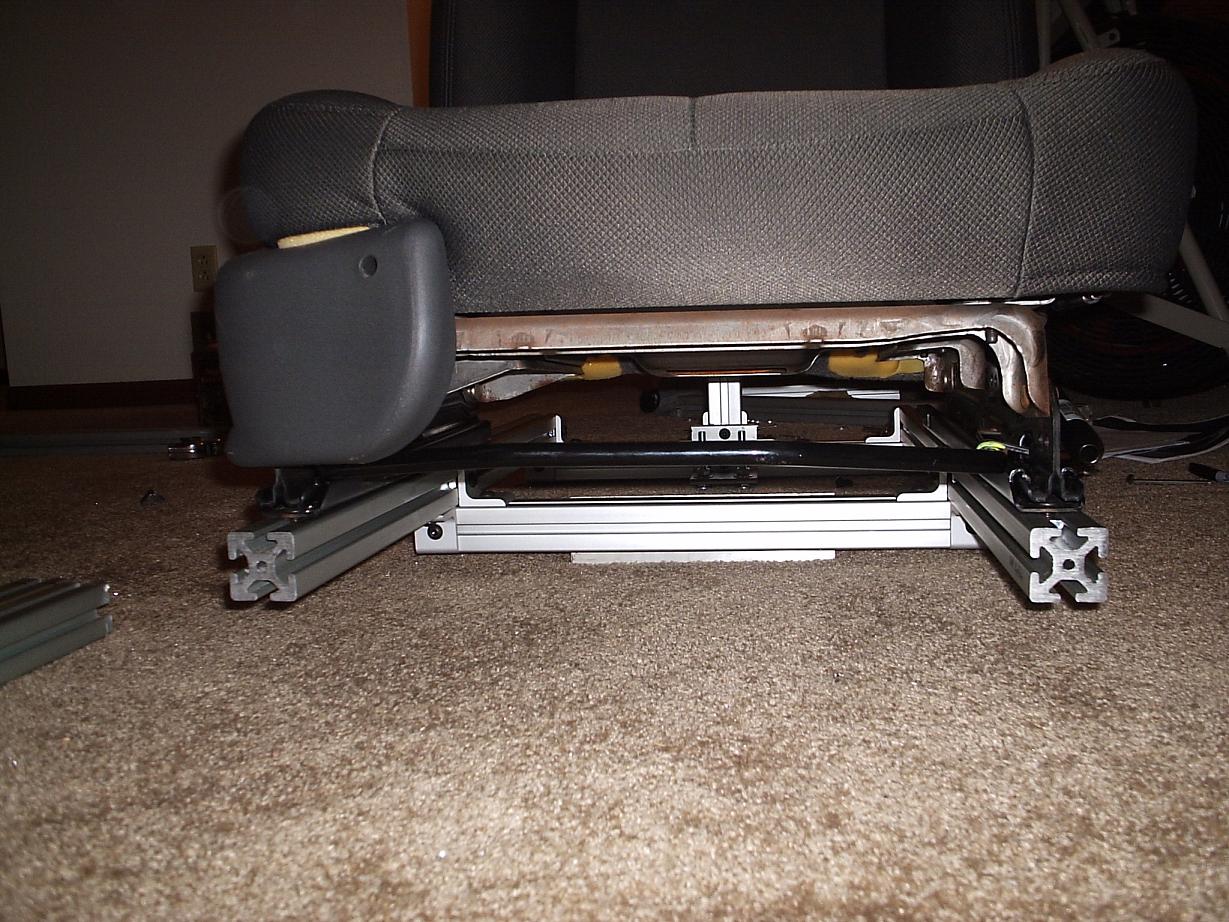

    0Coins

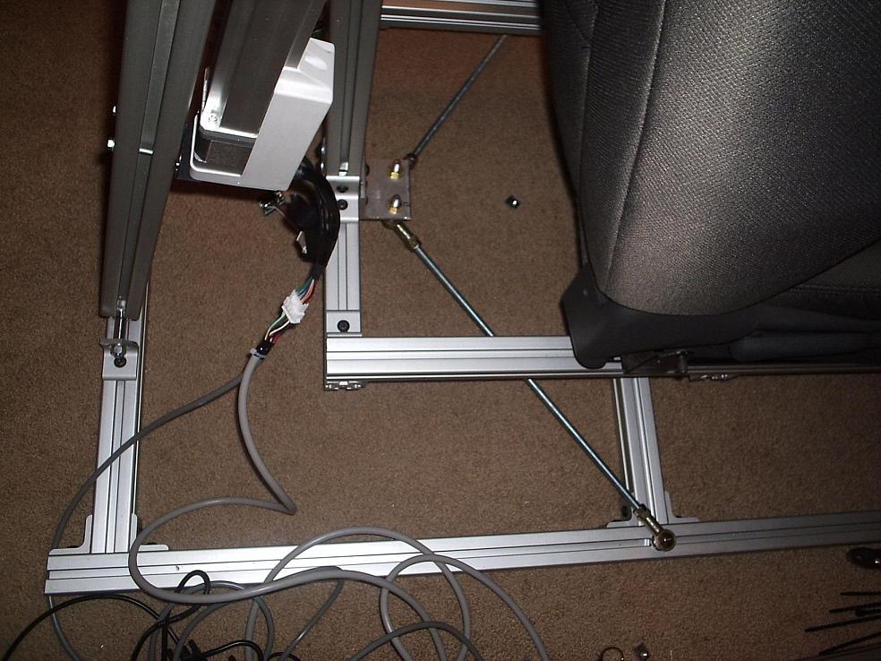

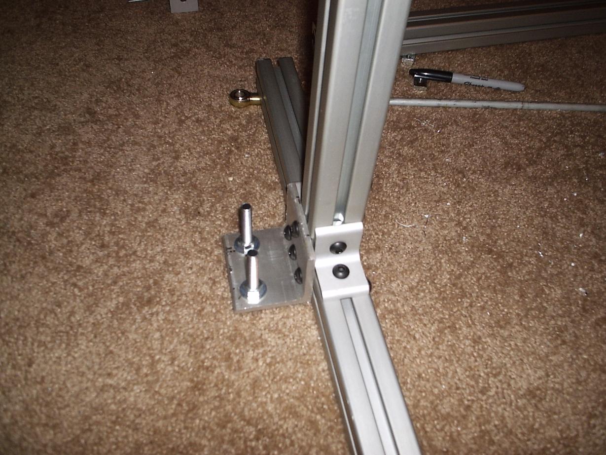

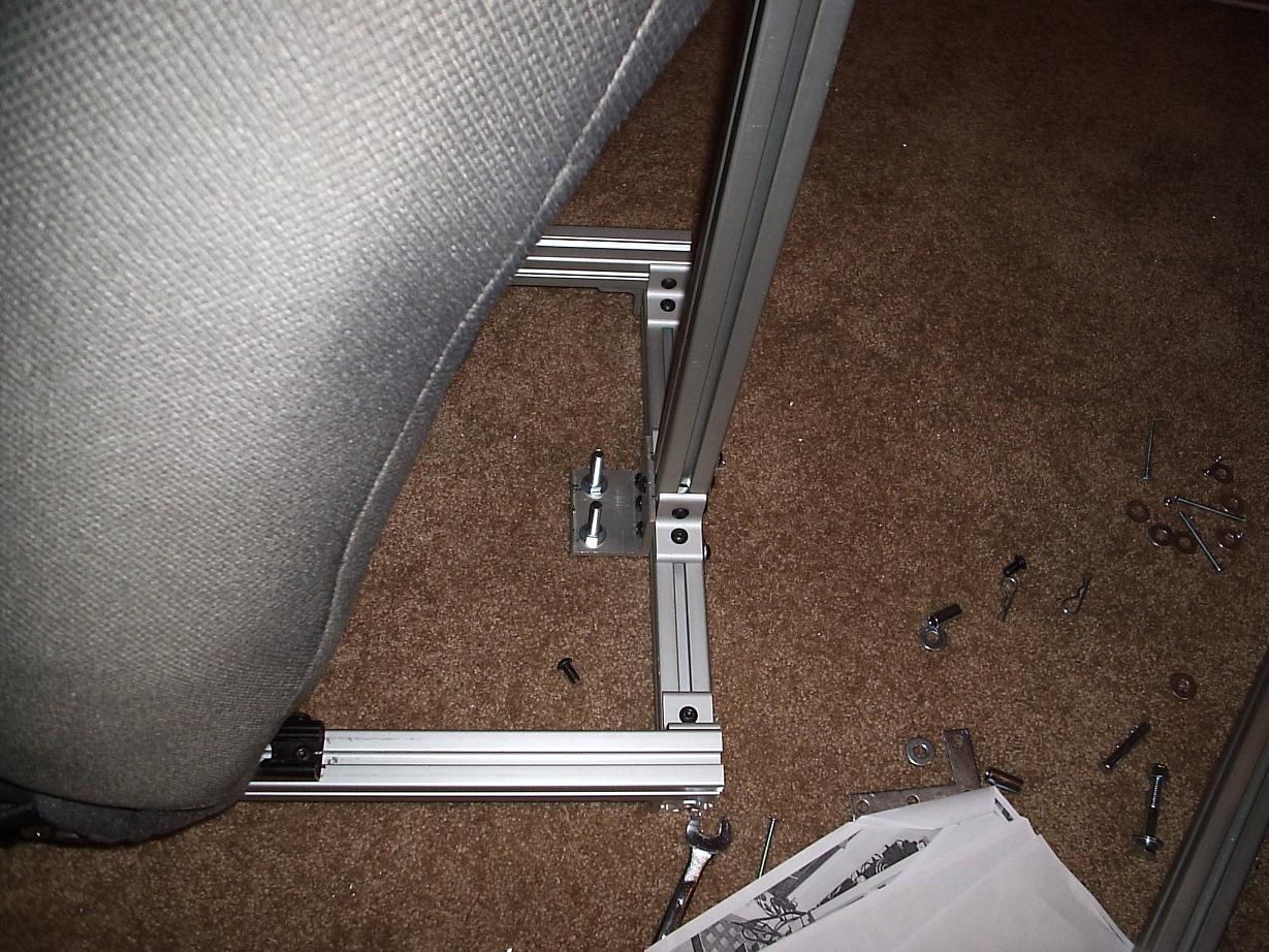

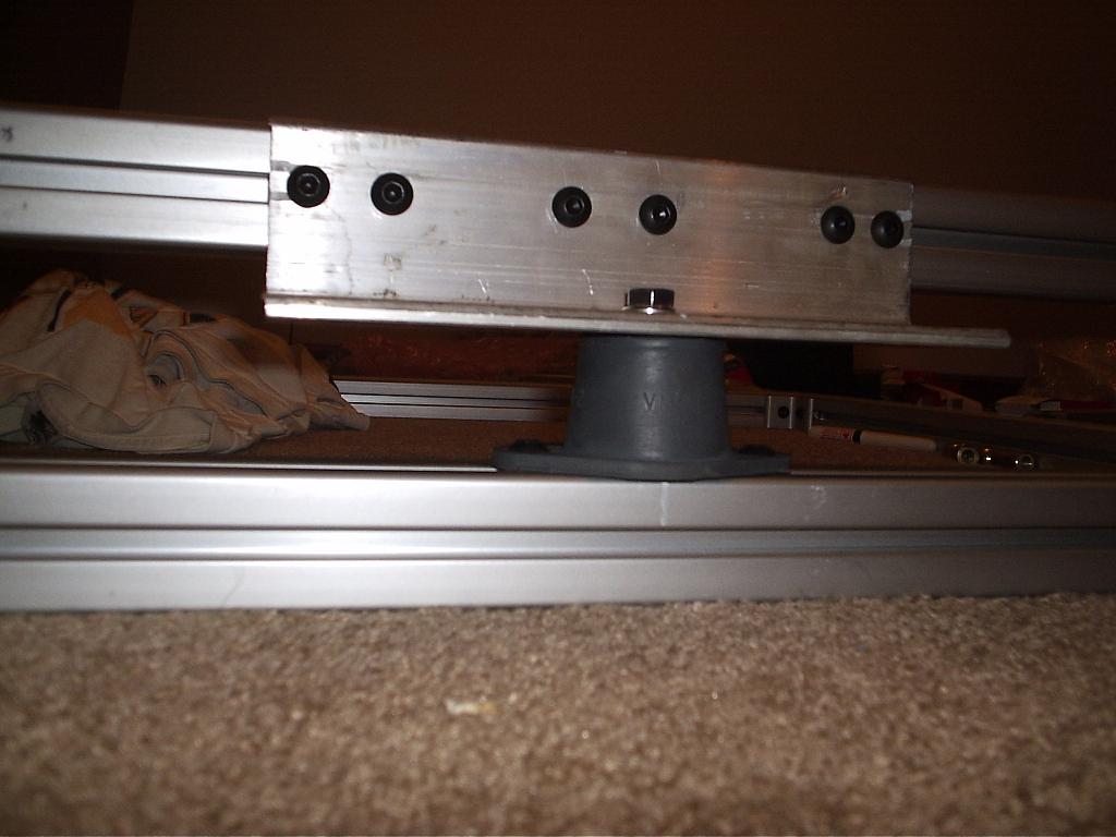

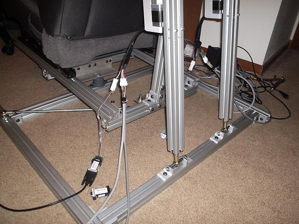

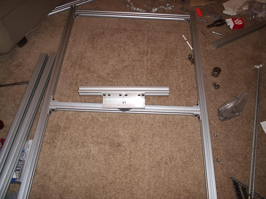

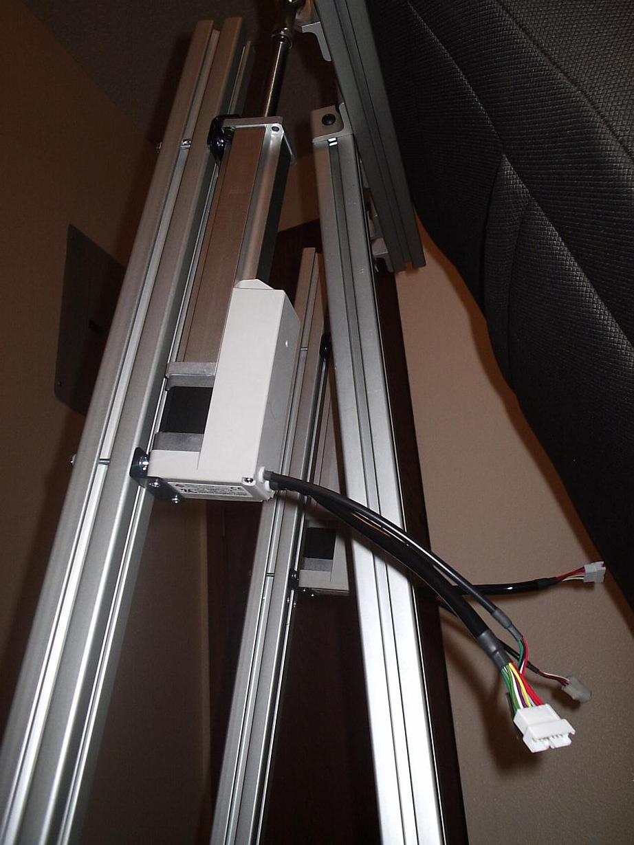

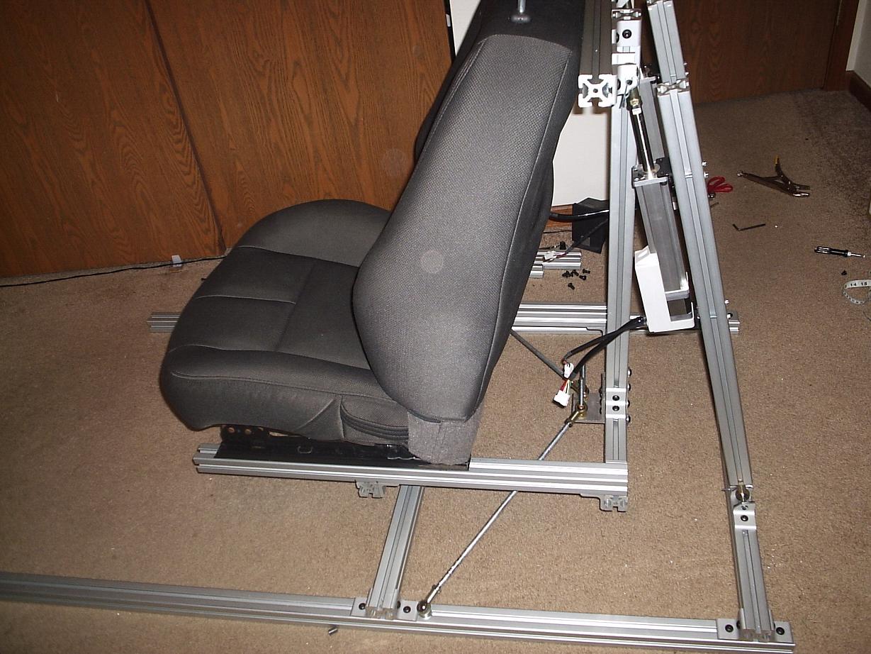

    Some more pictures and a question. We are out of t-nuts and can't find them anywhere, so will have to wait for some.
    I don't know how to balance the seat on the seat frame? The back of the seat frame with the cross-like section that pushes/moves the seat around is heavy (and it's not even complete yet), the seat with the seat frame will always fall backwards because of that (even if I sit in it), no matter how I move it around. When I add the actuators arms with the actuators in the back, that will hold it straight, but I don't think there should be any weight on the actuators and it should be balanced. So how to do that? Are the actuator arms supposed to hold it at all?

  9. dre99gsx

    I'll be going down the same route as you. We should think about putting some instructions together with the dimensions of the TSLOTS, seat frame position, etc. I'll put something up when I get to it, but great work so far.
  10. Mr Burns
    Mr Burns New Member
    Oct 16, 2008
    139
    0Coins
    Thanks, I'm almost done with it, will write some detailed instructions after that. If you're in the us don't get metric aluminum t-slots for sure.
    To make it balance straight I am thinking of connecting everything together, moving the actuators arms in the middle (they are 150 mm), so at 75mm and then having the seat be level. Put the pivot towards the rear of the seat but not too far. And then adjust from there if it's going to work.

    You are right, you want as much of the weight balanced as possible. My design is a bit different from yours, and I used a universal joint as the mounting point. I had to balance it on the universal joint, but that balance is a little different than it at first appears. Remeber that you will be sitting in the seat with your arms and legs extended, which definitely alters the balance in a major way.
    I look forward to hearing more about your progress.

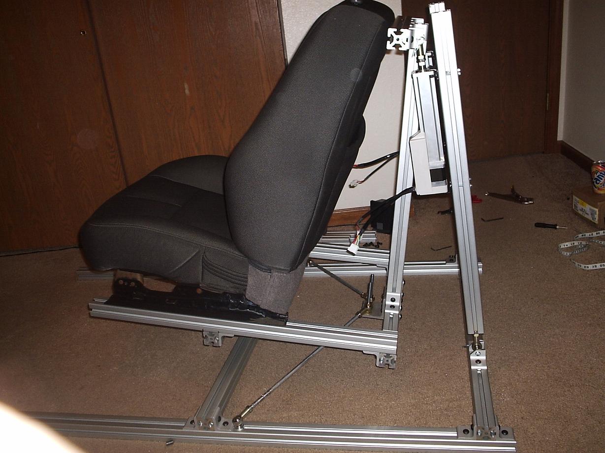

    More pictures with the seat frame in pieces and the seat attached to the frame. The seat frame with the seat can now be connected to the base and the 2 rods can be connected, then attach the back to the actuators.

    Hi guys here a tip as to the way i balanced my car seat on my platform ..Basically it is also mounted on CAR prop shaft Universal joint .. i monted the seat to a flat piece of 18mm MDF and placed a round tube under the MDF and onto a FLAT surface ( My imitaion pine wood Floor :blush: ) i then sat in the seat and with my legs lightly supported and arms forward mimicimg grabbing steering wheel, and gently rolled the whole setup back ward and forward to find the balance point then marked a on the board transferred it to the seat mounting bracket ... seems to work ok but will put a weight scale behind the seat to see how much force it exerts on the motor arms when my 110KG lump is sitting in the seat :yippiee: just a thought sorry to chip in on your posts :cheers: still have a small bracket to weld to my prop shaft support bar but will post pics on saturday

    The base is 33 and a little bit wide (840 mm or 84 cm) but it's the same width all over, I'm not sure what you mean by 28 center width.
    The profile with the pivot is about 24 (610 mm or 61 cm) from the end and the pivot is right in the middle of that and I put the pivot almost toward the end of the seat for now.

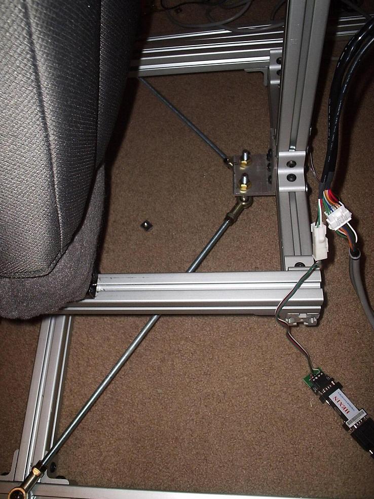

    I connected the actuators to the arms today by drilling through the aluminum and putting some screws through it but it didn't end up looking very good. :thbd: (used some aluminum to connect to the scn, didn't drill through them of course), I have to change some of the mouting tomorrow to make it better.
    For the ball joints that connect the actuators I used the same 90 degree mounting plates that are all over the place but I cut the edges off so the ball joints won't hit the sides. You will need something smaller if you use the normal 90 degree plates for that.
    Sorry, I'm not very good with us measurements, that was why I got the metric stuff, I can't really work with non-metric numbers. :no:

    Made some changes, lowered the seat b/c the stabilizer rods angle was too high and they were touching the side of the seat frame when one actuator was at 0 and the other at 150mm. I know they won't be used on the whole range, but it was a little odd. Also moved the base rods connection to be in line with the pivot and fixed the seat leaning a little to the left because of more weight on that side.
    Added some spacers on both sides of the actuator ball joints (top and bottom) so that they won't move horizontally.
    Moved the pivot a little back b/c the front was hitting the aluminum profile when both actuators were at 150 mm.
